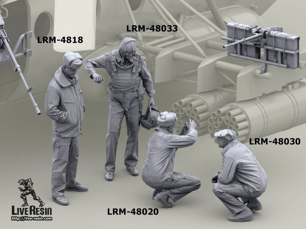

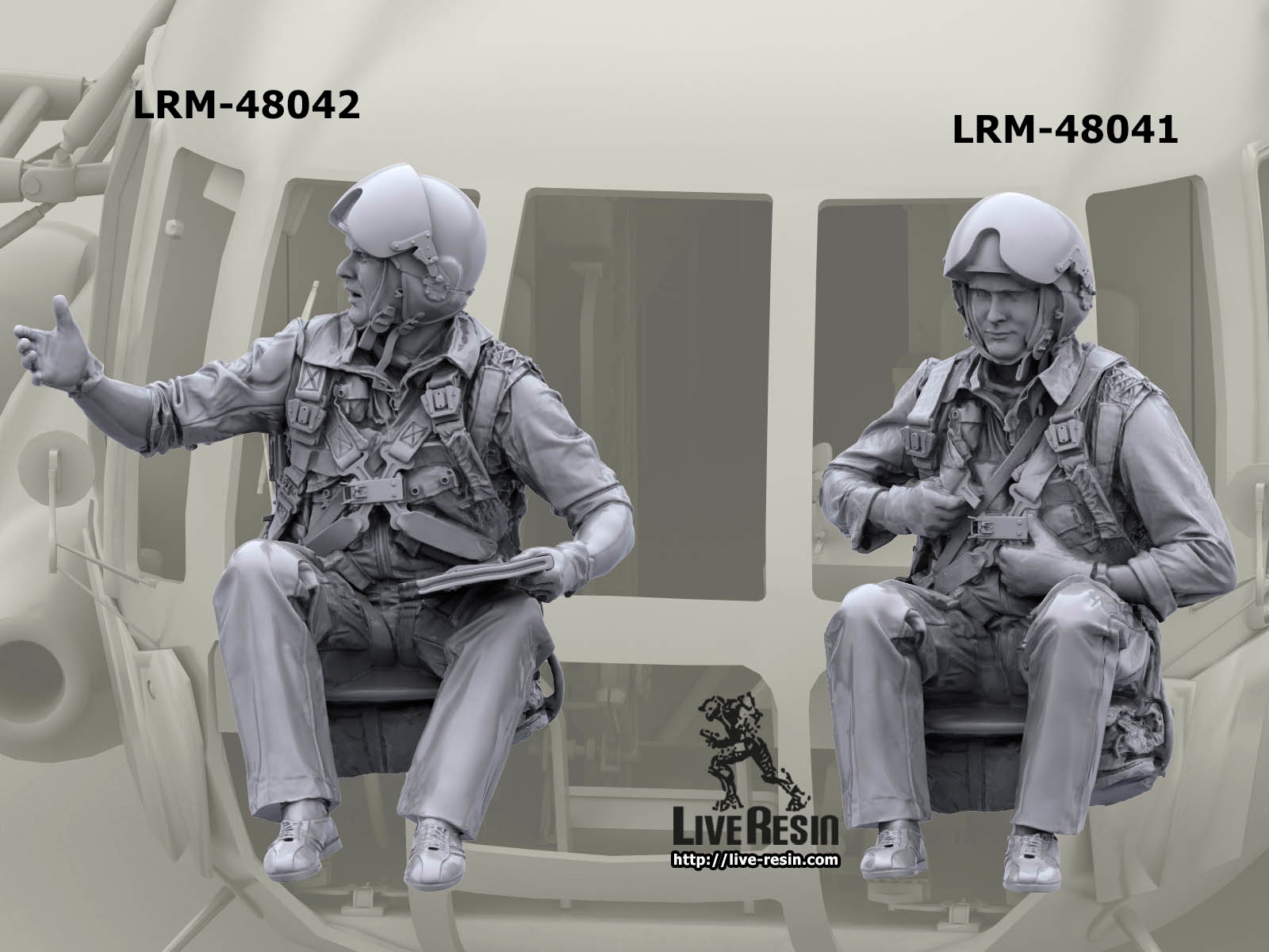

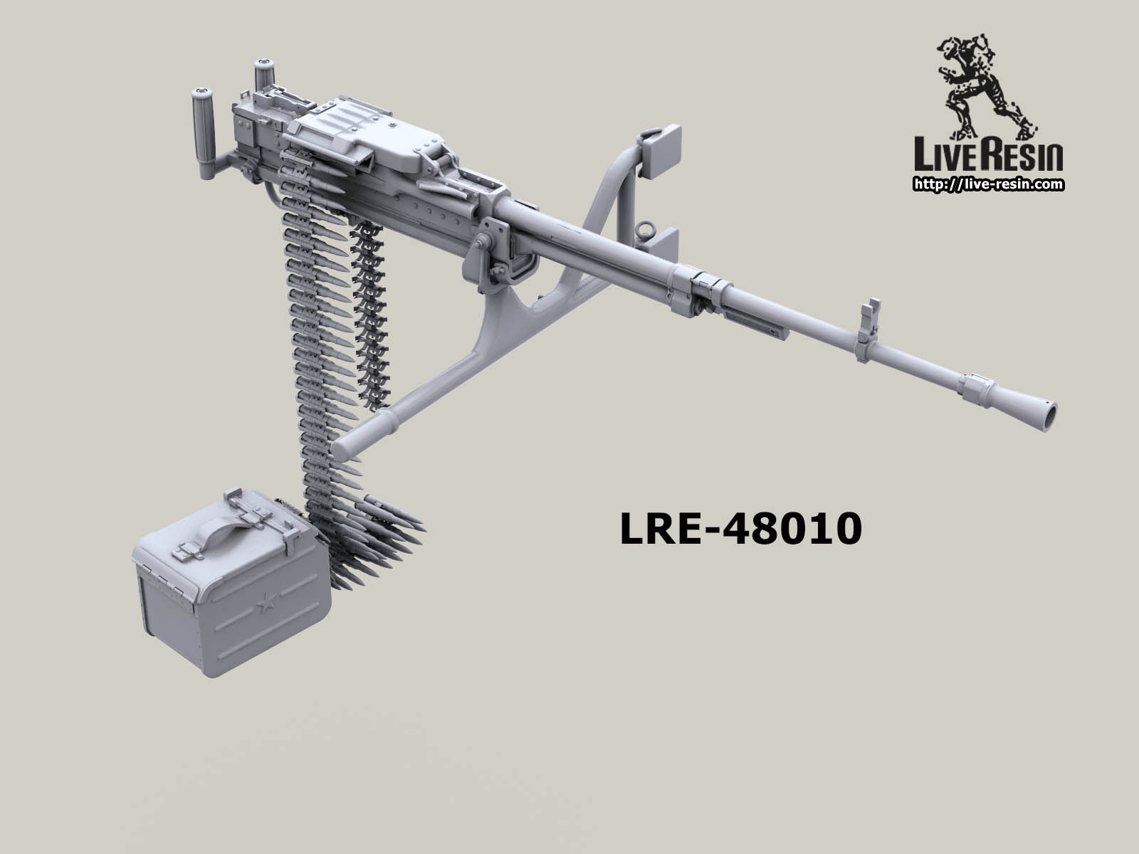

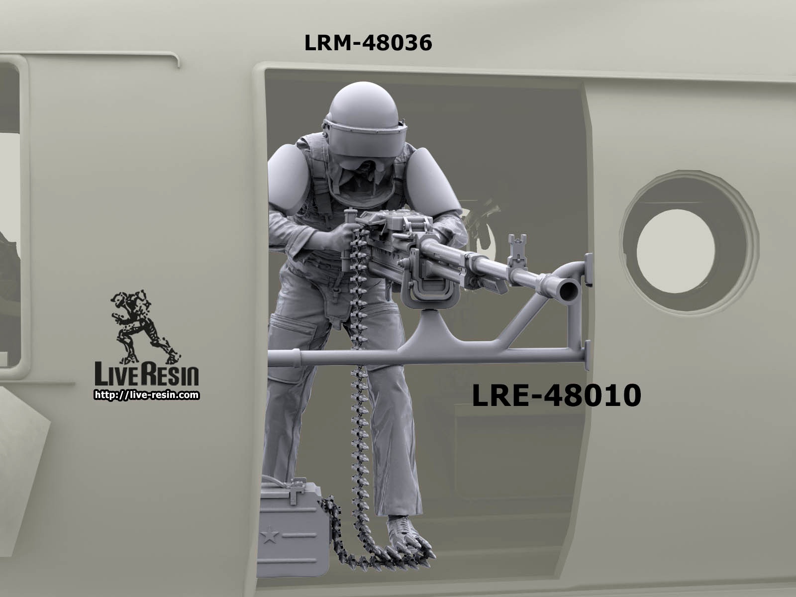

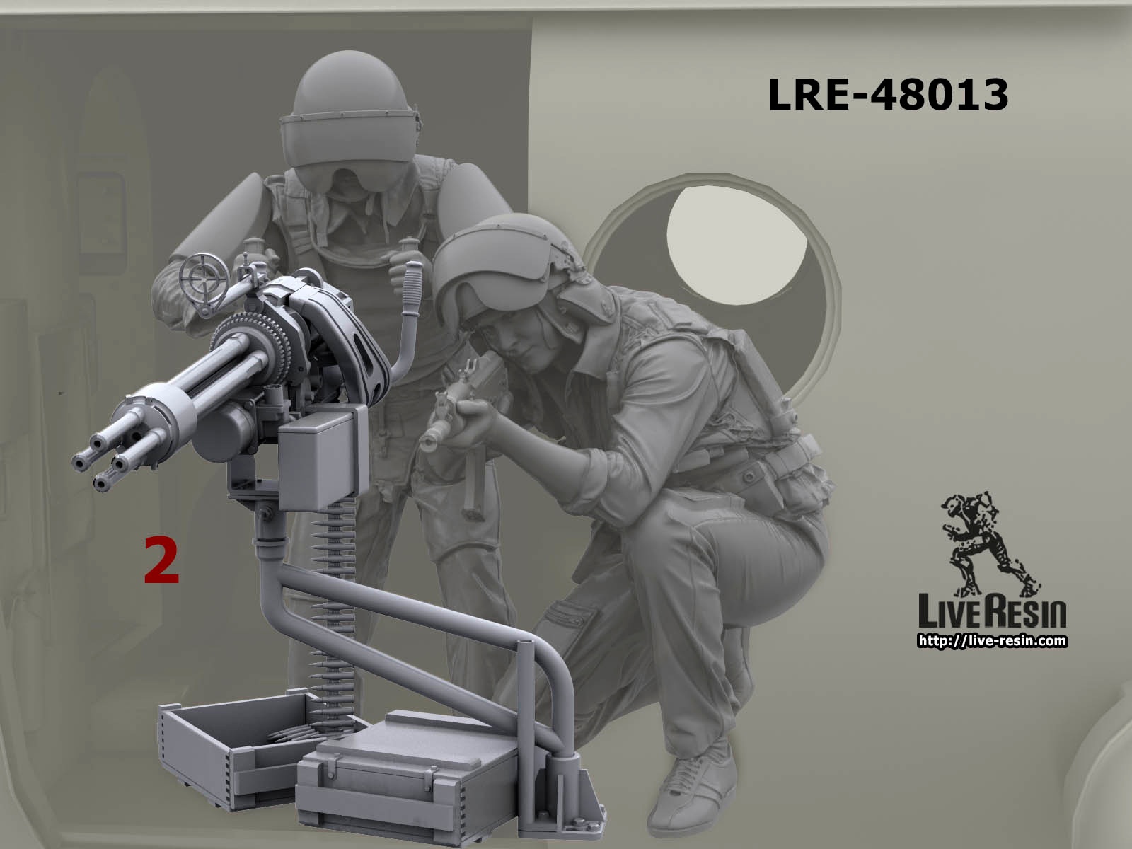

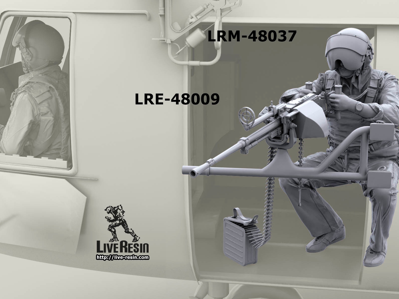

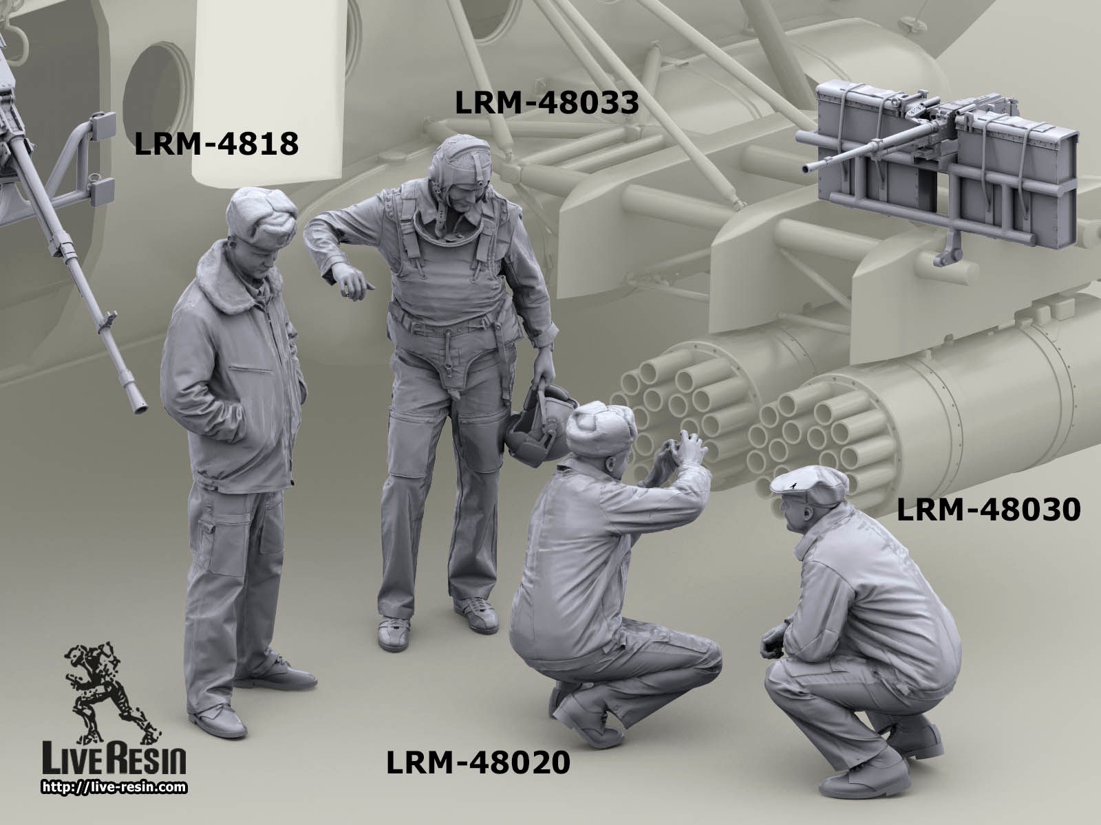

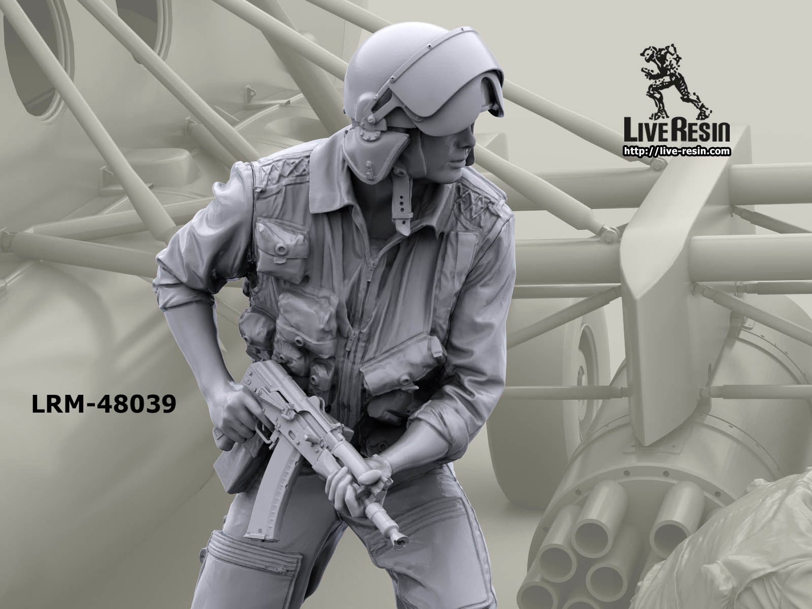

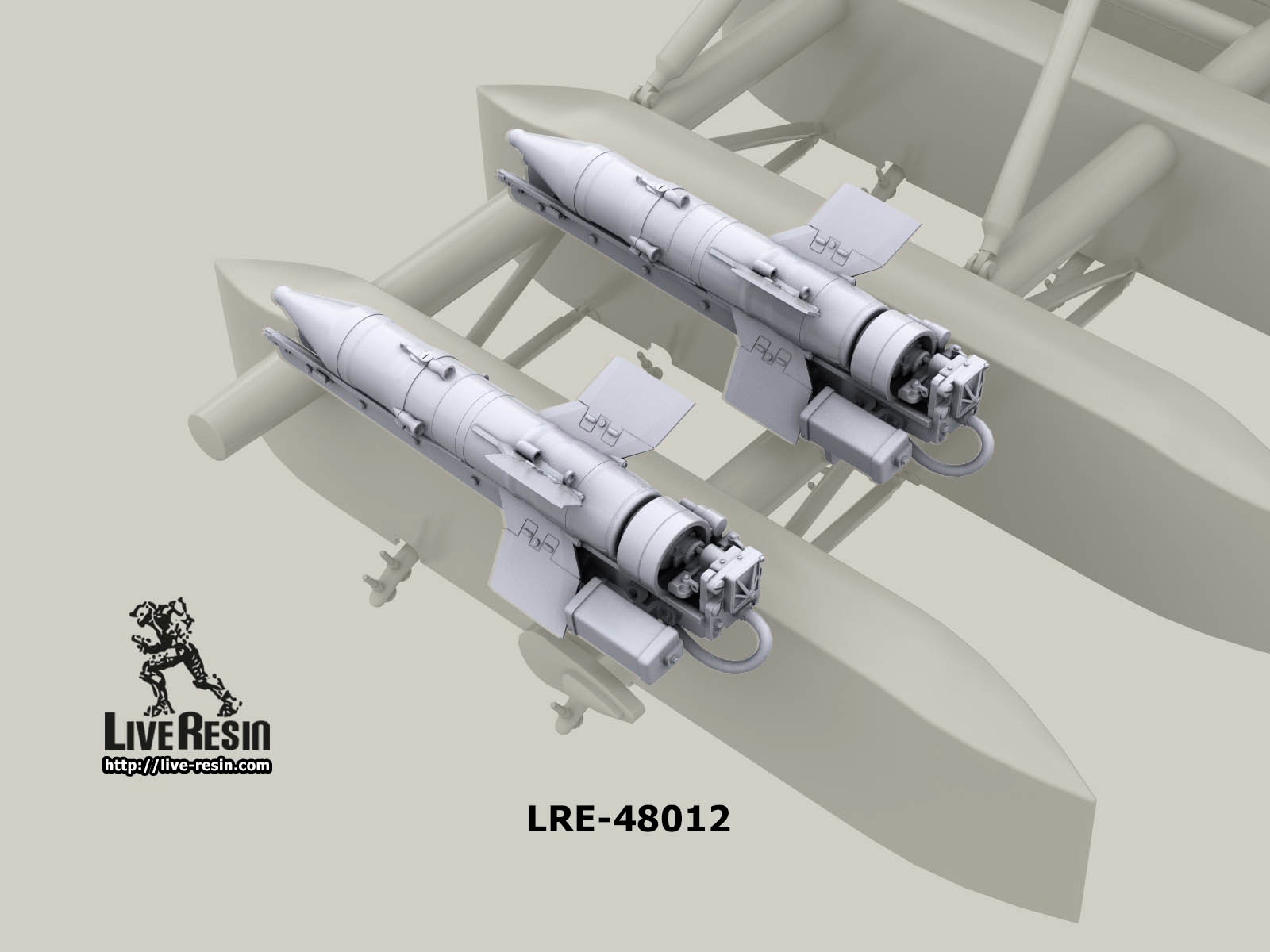

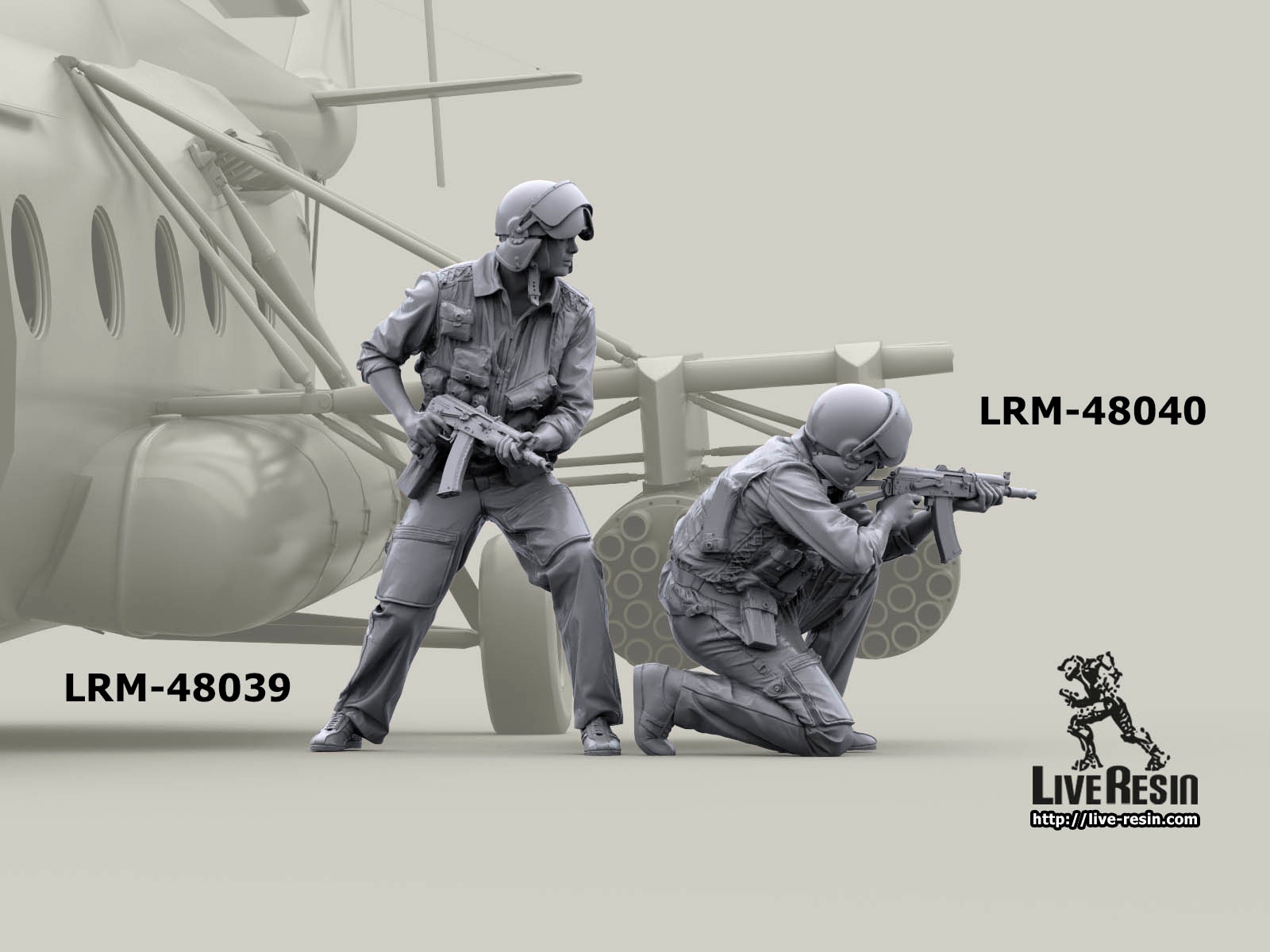

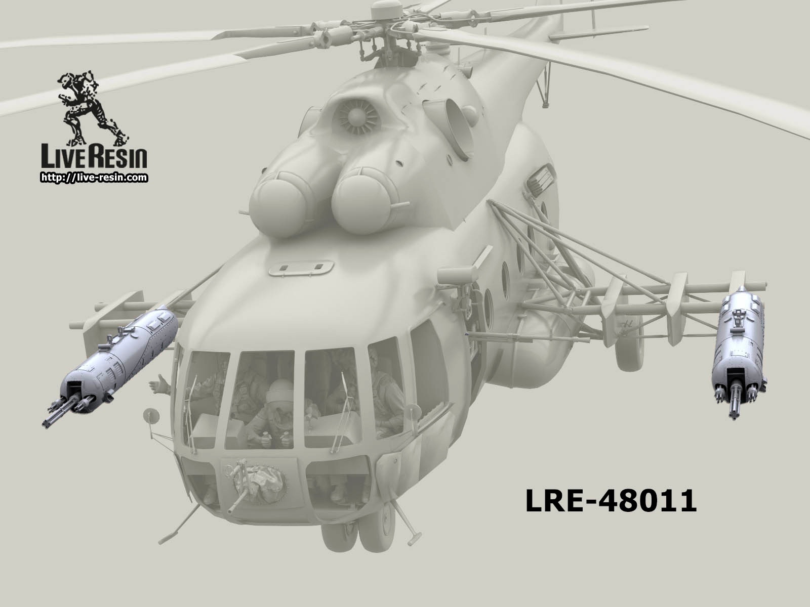

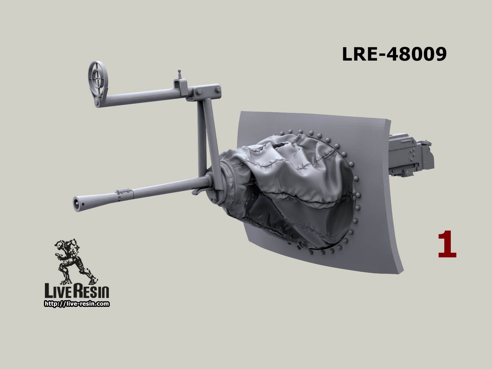

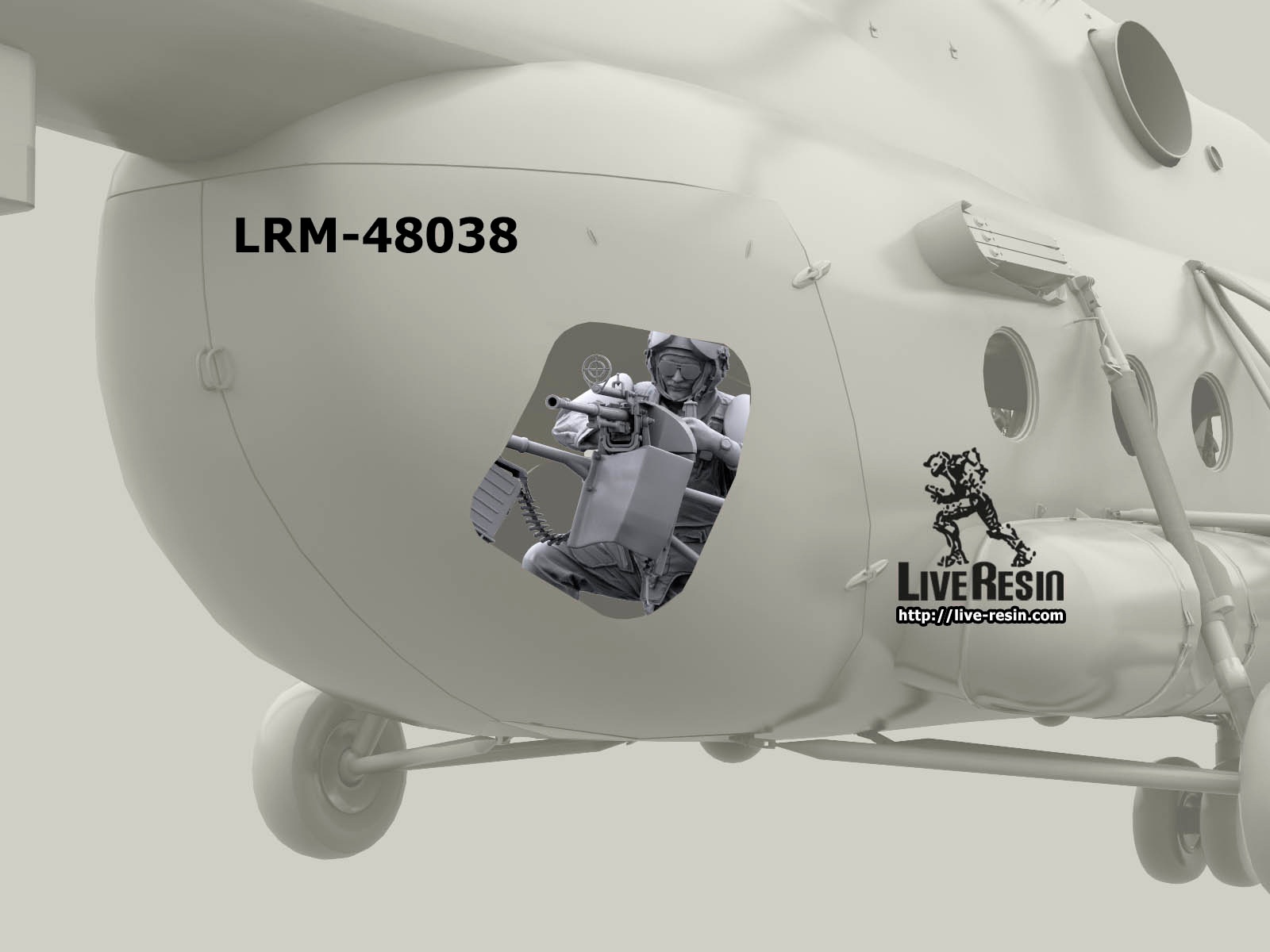

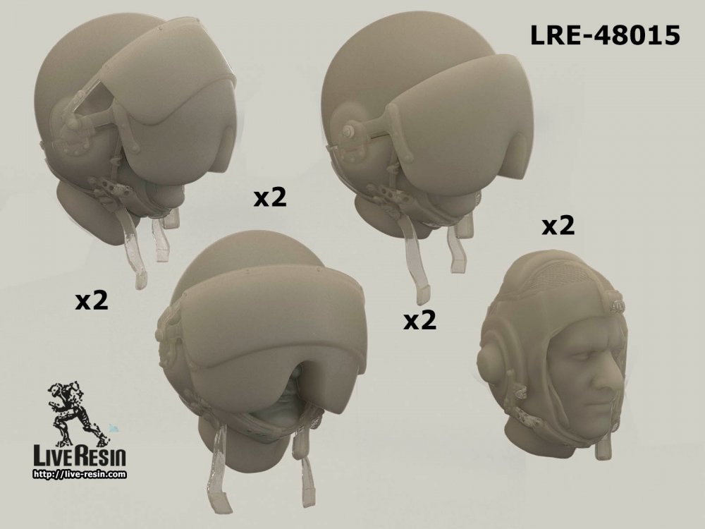

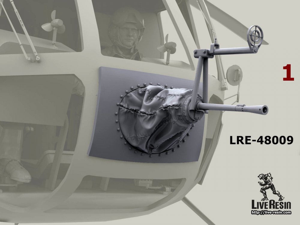

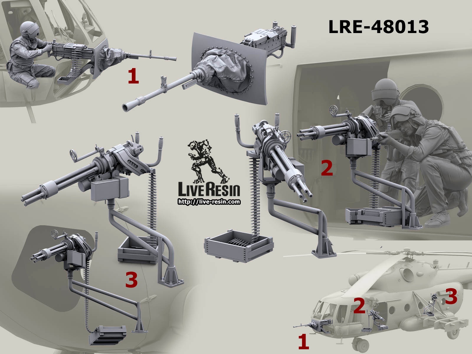

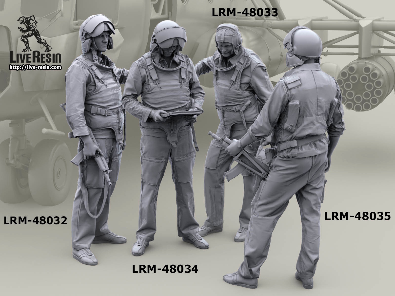

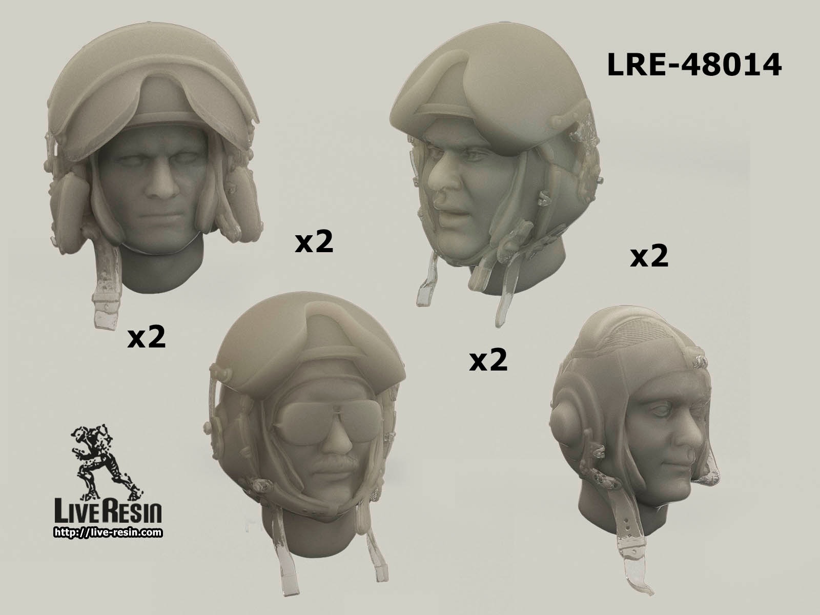

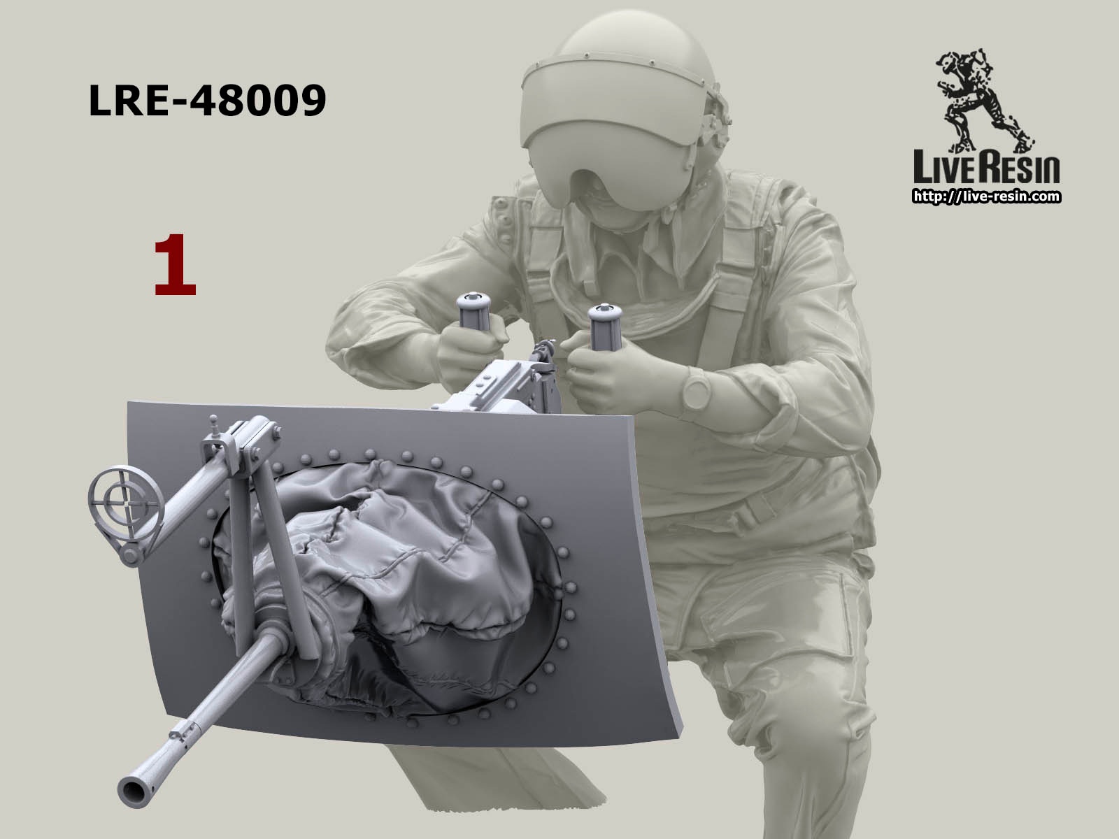

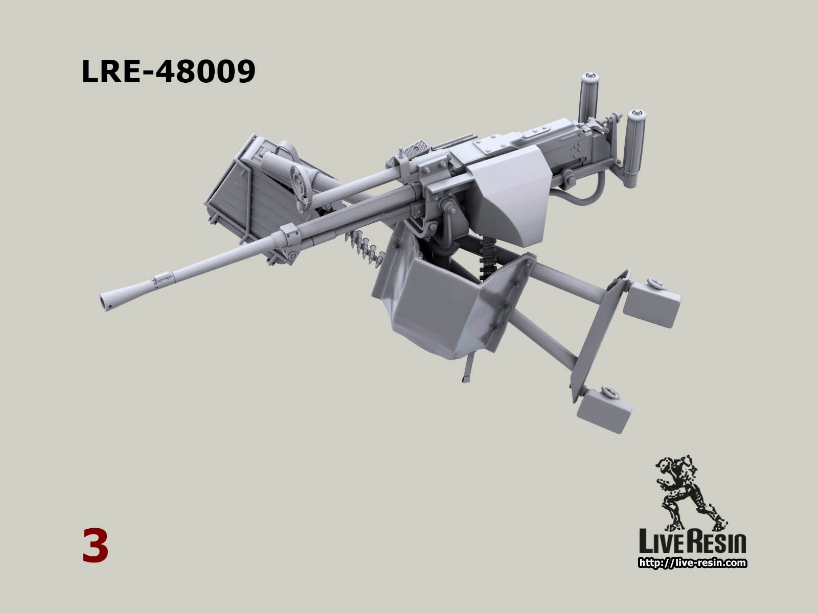

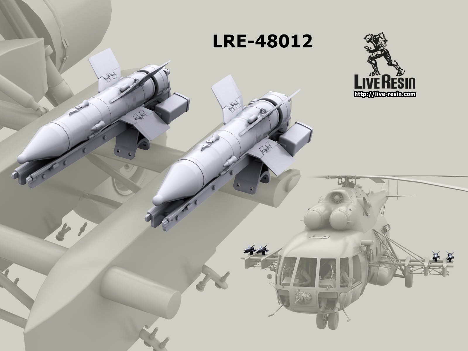

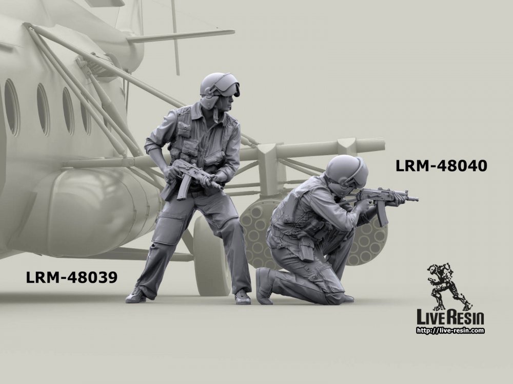

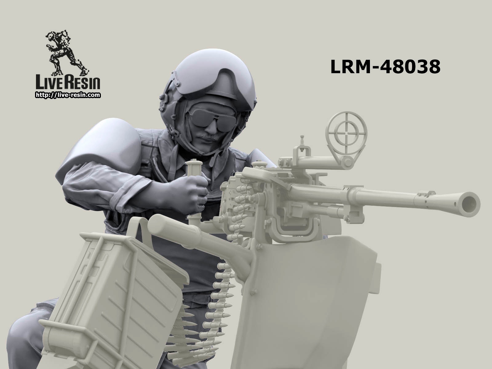

Sergei Galicky, Russia Posted December 7, 2022 Share Posted December 7, 2022 Exclusive additions and figures to the Mi-8MT model by Live Resin. The period of the War in Afghanistan in the 80s. Quote Link to post Share on other sites
