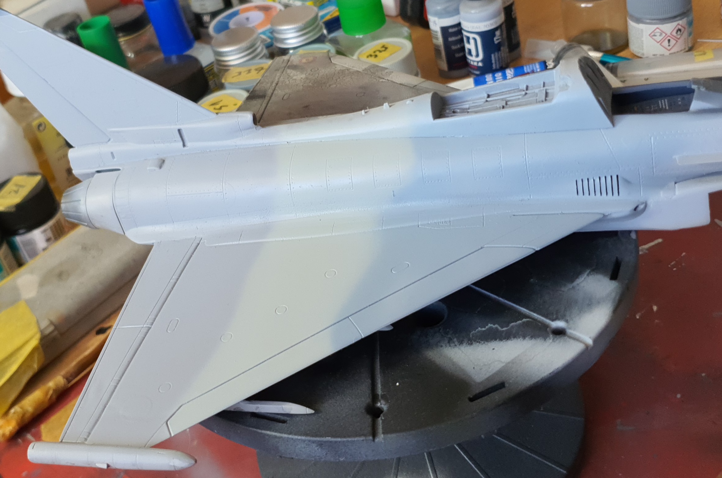

Wolf_el_Real Posted January 16, 2023 Share Posted January 16, 2023 Finally made this test with Mr Hobby paints 305, 306 abd 307. Colors direct no fade or other technics (Tested over and old 1/48 Eurofighter kit) Quote Link to post Share on other sites
scotthldr Posted January 17, 2023 Share Posted January 17, 2023 They look pretty spot on for a freshly painted and clean aircraft. Quote Link to post Share on other sites
Wolf_el_Real Posted January 17, 2023 Share Posted January 17, 2023 Yes, the real job will be fading, motting and another effects to the real-weathered aircraft. Regards Quote Link to post Share on other sites
