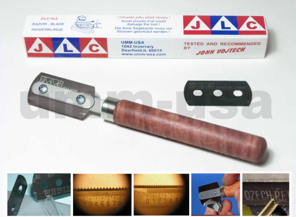

I use the JLC razor saw. Not only can it scribe very thin lines, it can be used as its original intent, cutting. With a little practice, you can actually scribe a straight line without any straight edge aid. There are various manufacturers make these razor saws, JLC, CMK, HQT. But serve similar functions. I think they are all interchangable also. UMM-USA carries them in stock.
http://umm-usa.com/onlinestore/product_info.php?cPath=21_28&products_id=35
