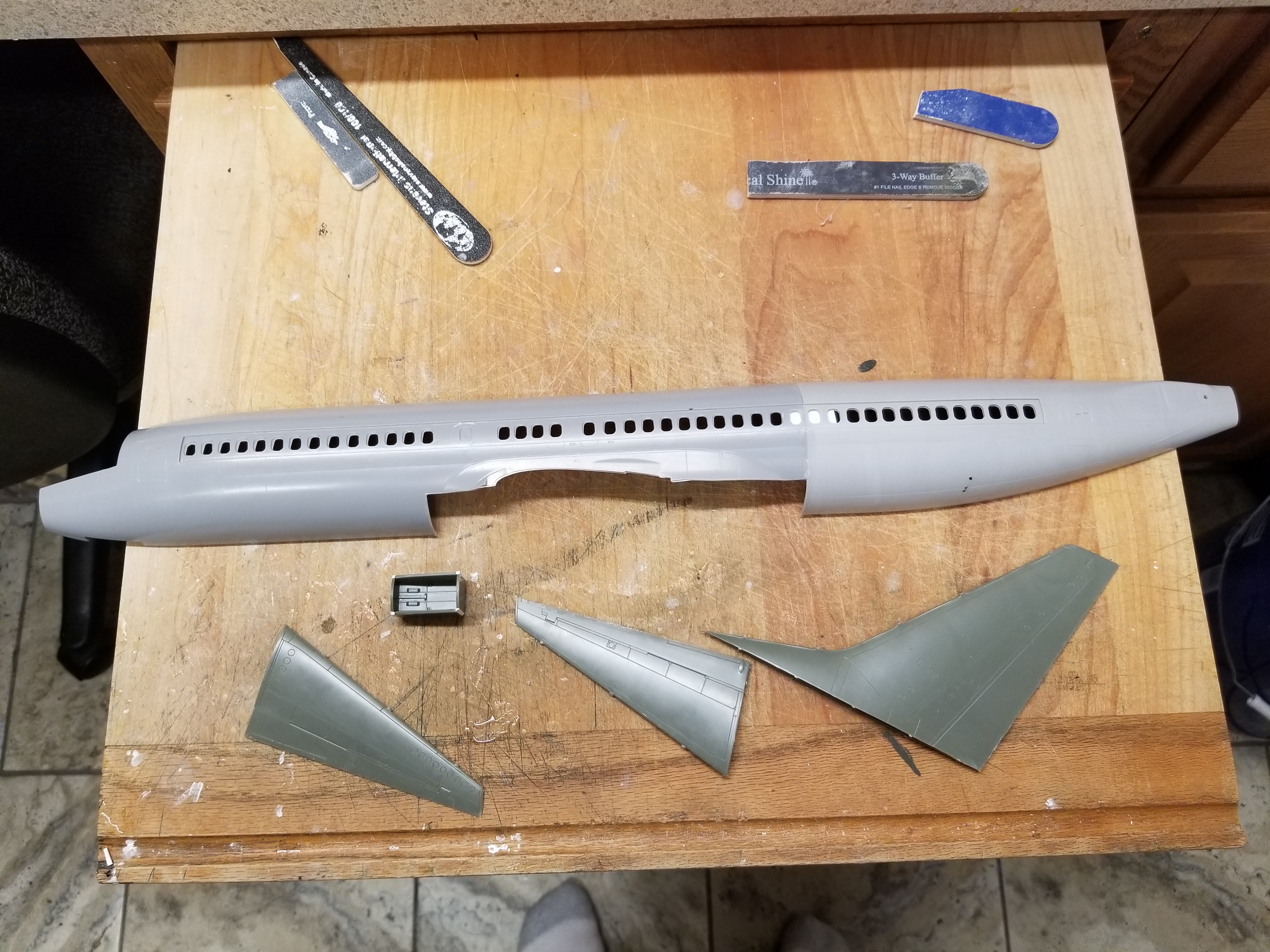

f5guy Posted December 4, 2022 Author Share Posted December 4, 2022 Hi all, I got a little bit done last night. The stabilizers and tail halves are together, as is the nose gear bay, and cockpit flight deck. I also got one of the forward and rear fuselage halves together. Since its just a butt joint, I reinforced it with some scrap plastic sheet. Now its solid as a rock. All for now. Fred. Quote Link to post Share on other sites
Trojan Thunder Posted December 6, 2022 Share Posted December 6, 2022 Good start, did you drill out all those windows? Quote Link to post Share on other sites

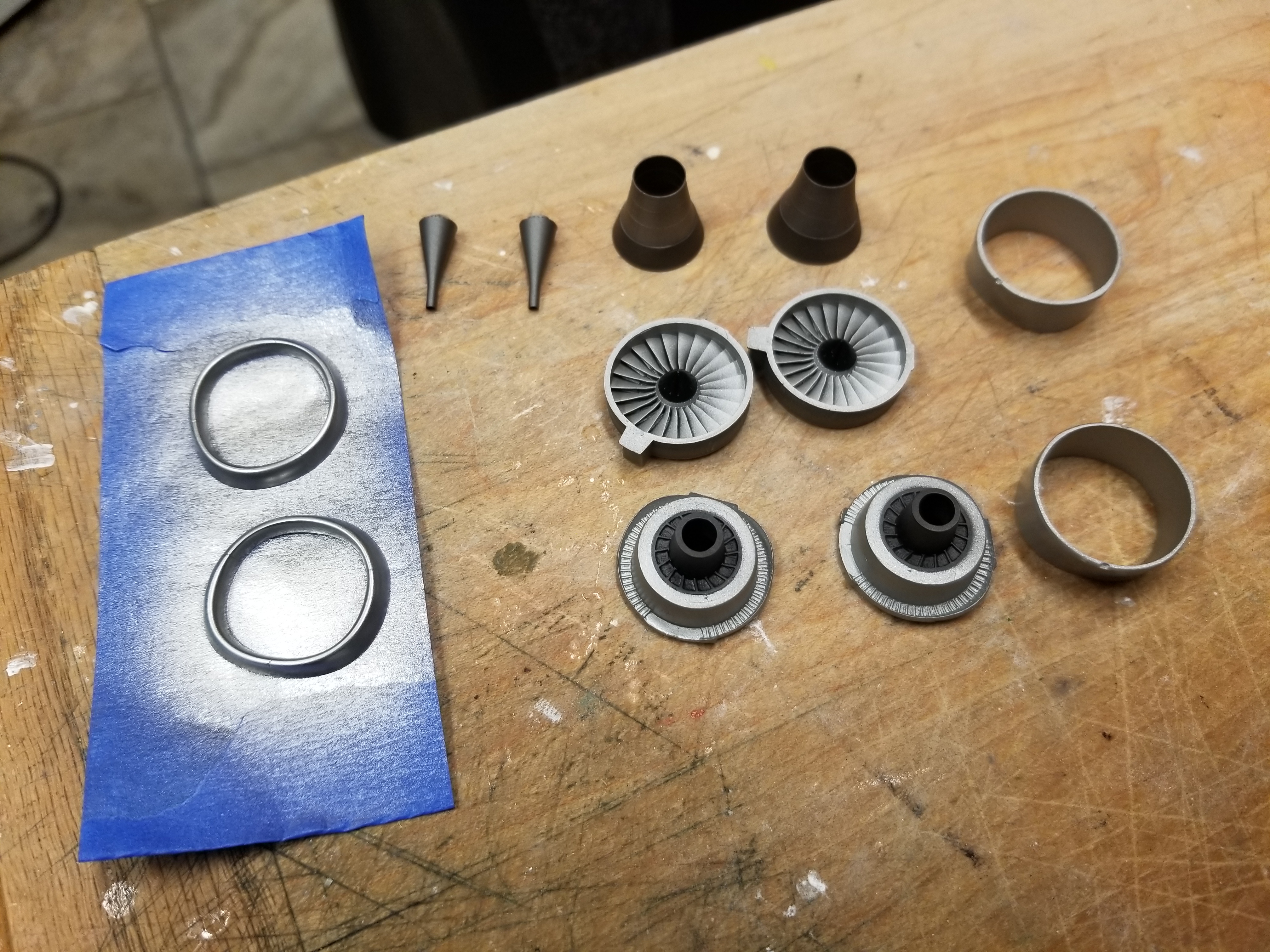

f5guy Posted December 8, 2022 Author Share Posted December 8, 2022 Hi everyone, I had a little free time and got the engine parts painted up. I'm hoping to get them assembled this weekend. Regards, Fred. Quote Link to post Share on other sites
Trojan Thunder Posted December 8, 2022 Share Posted December 8, 2022 That is some lovely paint work Fred, some nice masking there. Quote Link to post Share on other sites
f5guy Posted December 8, 2022 Author Share Posted December 8, 2022 3 hours ago, Trojan Thunder said: That is some lovely paint work Fred, some nice masking there. Thanks! The front part of those compressor faces were a bit tricky, but I'm happy with how they came out. Fred. Quote Link to post Share on other sites

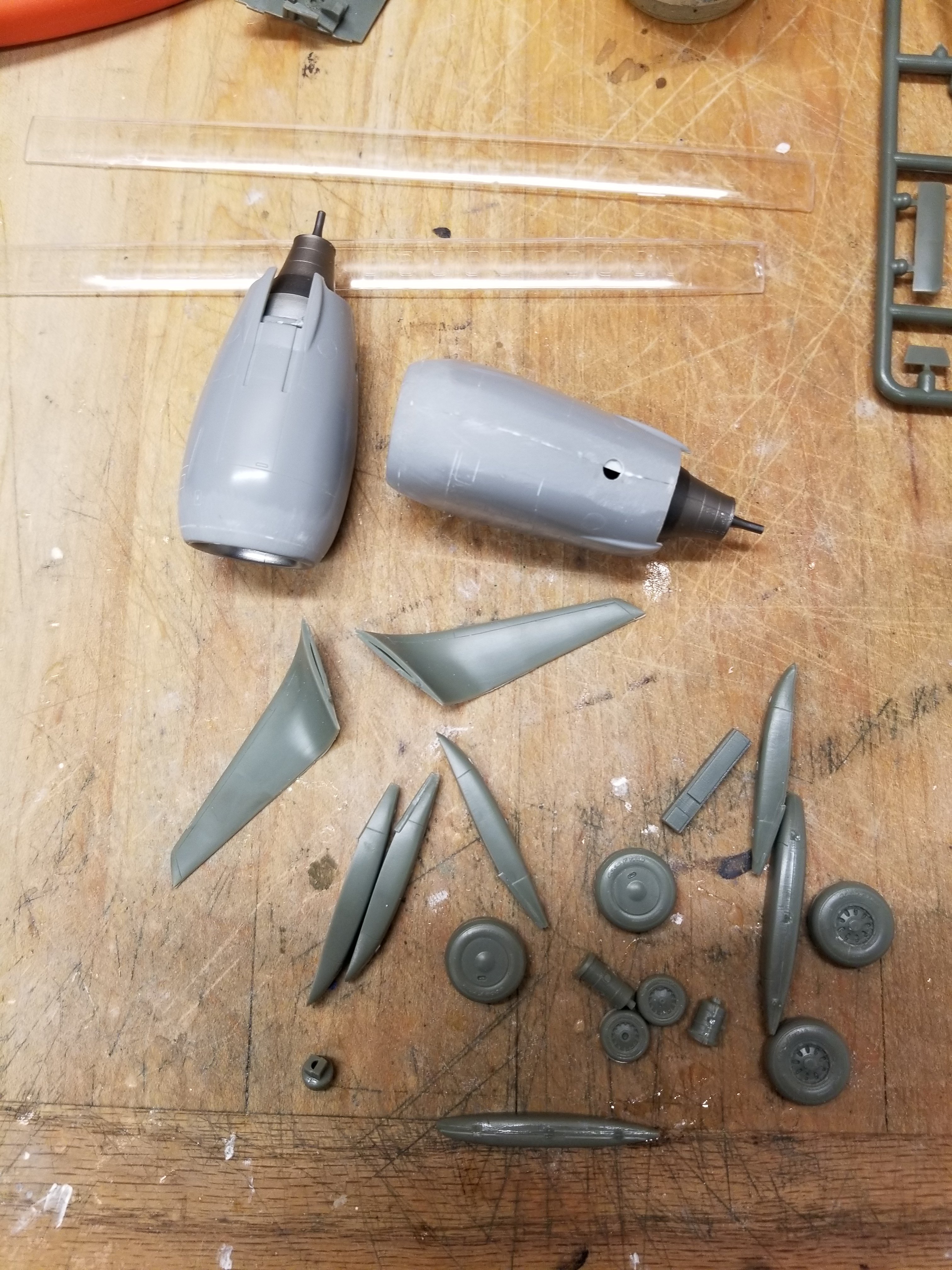

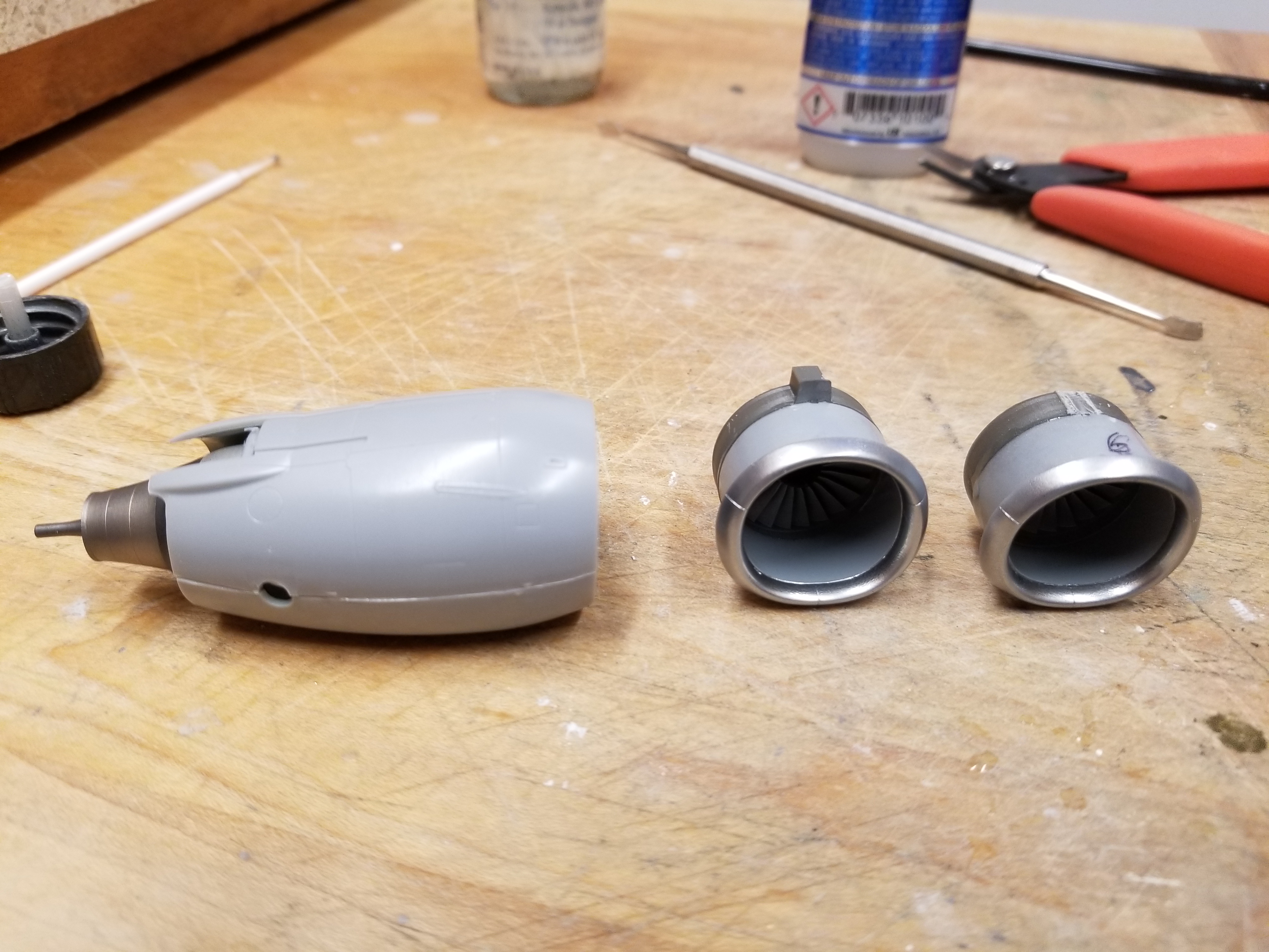

f5guy Posted December 18, 2022 Author Share Posted December 18, 2022 (edited) Over the last few days I've managed to get many of the smaller parts that have to be glued together, glued together, including the wings, and remaining fuselage half (front to rear). I also got the engines assembled. With the engines there a tab on the resin fan blade section that is supposed to be glued to the interior of the upper engine halves. The rear exhaust section is also to be glued in the same manner, then the lower half of the engine section is to be glued to the top section in a clam shell manner. You can see the tab on the left engine front in the second pic. I glued the exhaust section in without any problems, but if glued where its supposed to go I found that the forward fan section doesn't fit too well. Specifically the chrome ring to the forward edge of the pod. I decided to cut the tab off and then glue the engine halves together and once dry, file the forward face of the engine pod flat with a file, then gently squeeze the pod halves together to get the finished forward fan section inserted. That worked great, but there is still much filling and sanding ahead. Before closing up the engine halves, I glued a small piece of thin plastic card behind the circular holes on each side of both engine halves. There is a chrome vent insert that goes in there. I figured that it would be much easier to paint them later, then insert them once the engine has been painted blue, instead of some tricky masking. Fred. Edited December 18, 2022 by f5guy Quote Link to post Share on other sites

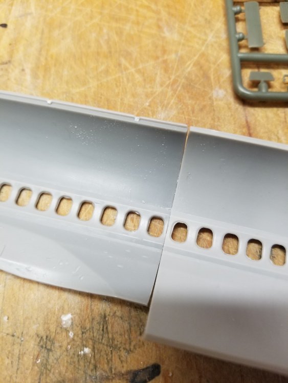

f5guy Posted December 18, 2022 Author Share Posted December 18, 2022 On the forward fuselage halves there is a raised ridge that must be filed off in order to get the two fuselage halves flush against each other. The rear fuselage section doesn't have it as can be seen in the picture. Fred. Quote Link to post Share on other sites

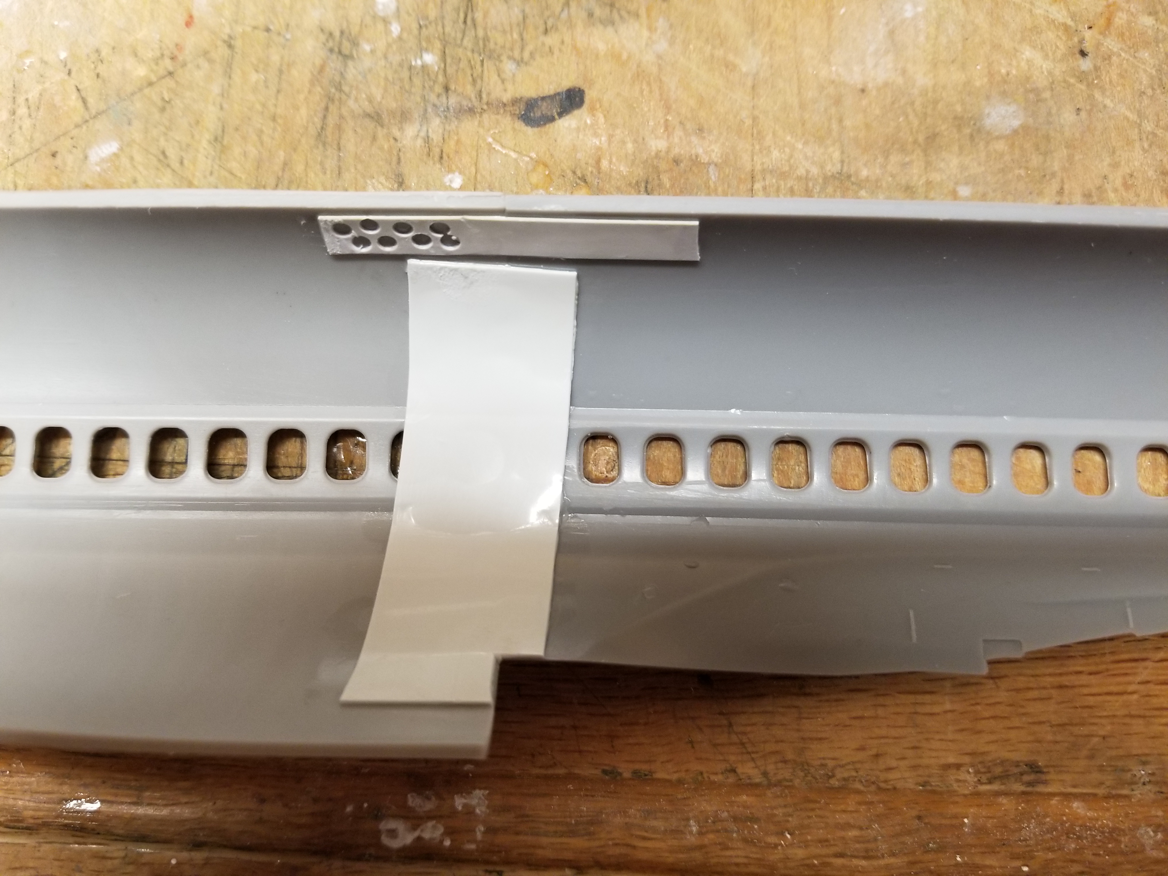

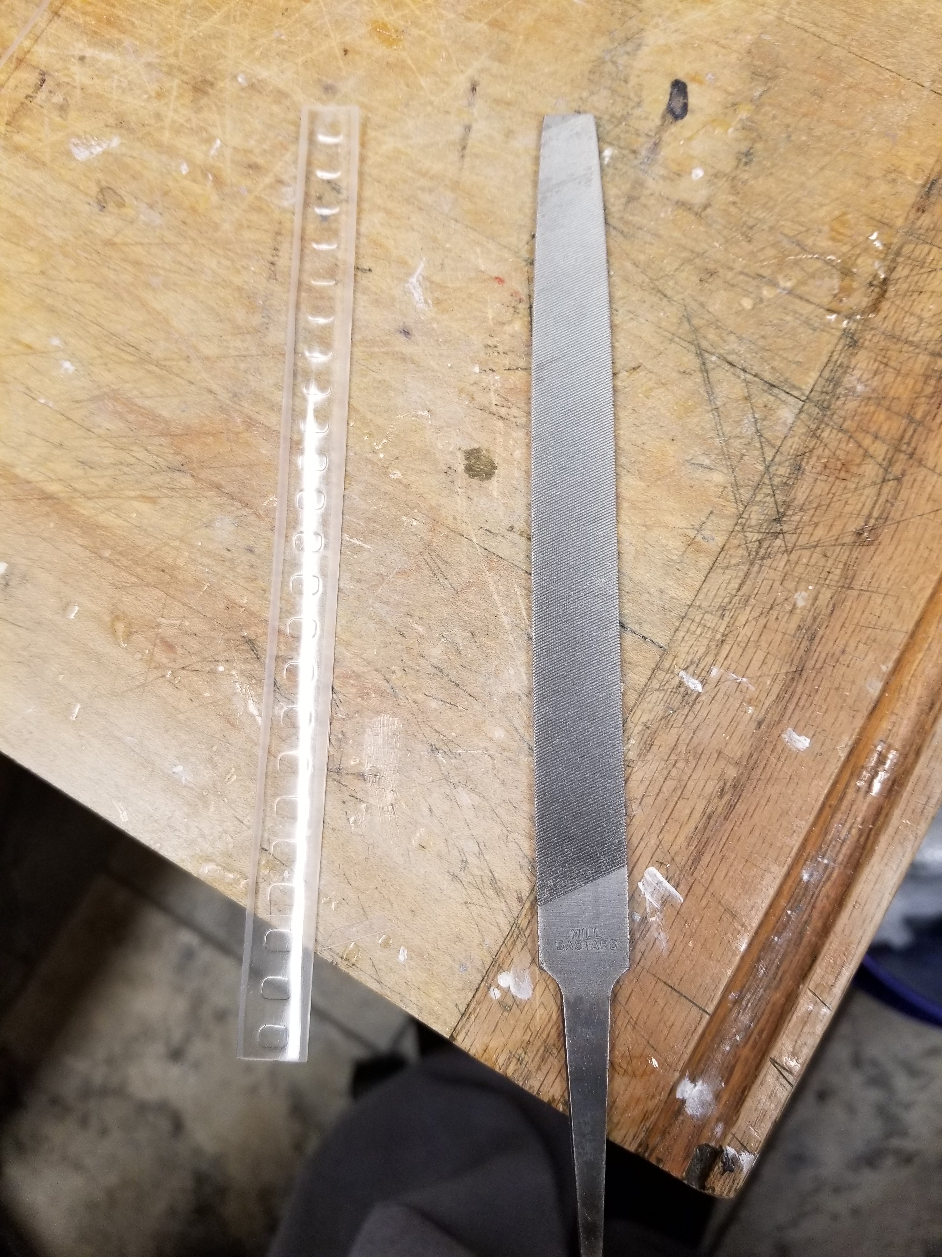

f5guy Posted December 18, 2022 Author Share Posted December 18, 2022 (edited) I started to work on the window inserts today as well. As I mentioned before, this is my biggest gripe with BPKs otherwise very nice 737 kits. I really wish that they'd have just made the fuselage halve sides smooth, and let the modeler use decals to represent the windows. This is standard in 1/144th scale airliner kits, and still looks good in 72nd scale. Besides, its not like there's an interior passenger cabin anyway. It just makes for a lot more unneeded filling and sanding. One thing that I noticed is that the instructions call for window inserts for the right side of the aircraft to be parts B1 and B2. If you do this though, it will leave a 1/4" gap between the clear window parts. It shows the same thing for the left side, C1 and C2. In reality, you need to swap the rear window sections from side to side. So that would be C1 and B2 on the right side and C2 and B1 on the left side. It may sound complicated, but with a quick test fit you'll be able to figure it out. The pic shows one of the clear inserts along with an essential modeling tool for these BPK kits. Everything needs to be trimmed to fit! All for now, Fred. Edited December 22, 2022 by f5guy Quote Link to post Share on other sites
