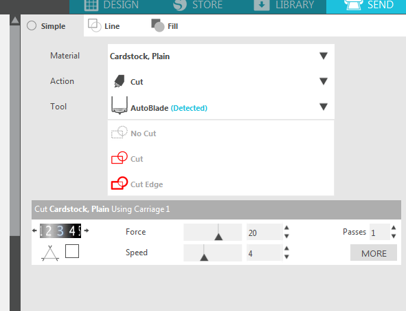

Gator52 Posted May 21, 2024 Share Posted May 21, 2024 Drew, I might have missed it, but can you elaborate on cutting paint masks for the SJ tail codes? What masking material did you use in your cutter, and did you use default settings? Thanks, Chris Quote Link to post Share on other sites
Drew T. Posted May 24, 2024 Author Share Posted May 24, 2024 Hi Chris, I used Oramask 810 for all of my masks. Below are the settings I use. Hope this helps! Drew Quote Link to post Share on other sites
Gator52 Posted May 25, 2024 Share Posted May 25, 2024 Thanks, I’ll give it a try. Chris Quote Link to post Share on other sites
