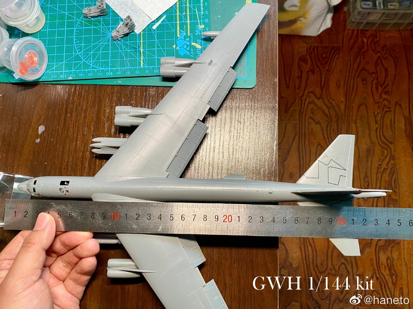

On 12/28/2022 at 1:33 PM, haneto said:
Academy kit is wrong in its scale(bigger than 144 scale), and the nose cone shape is inaccurate(too pointy).
My vote goes to GWH.

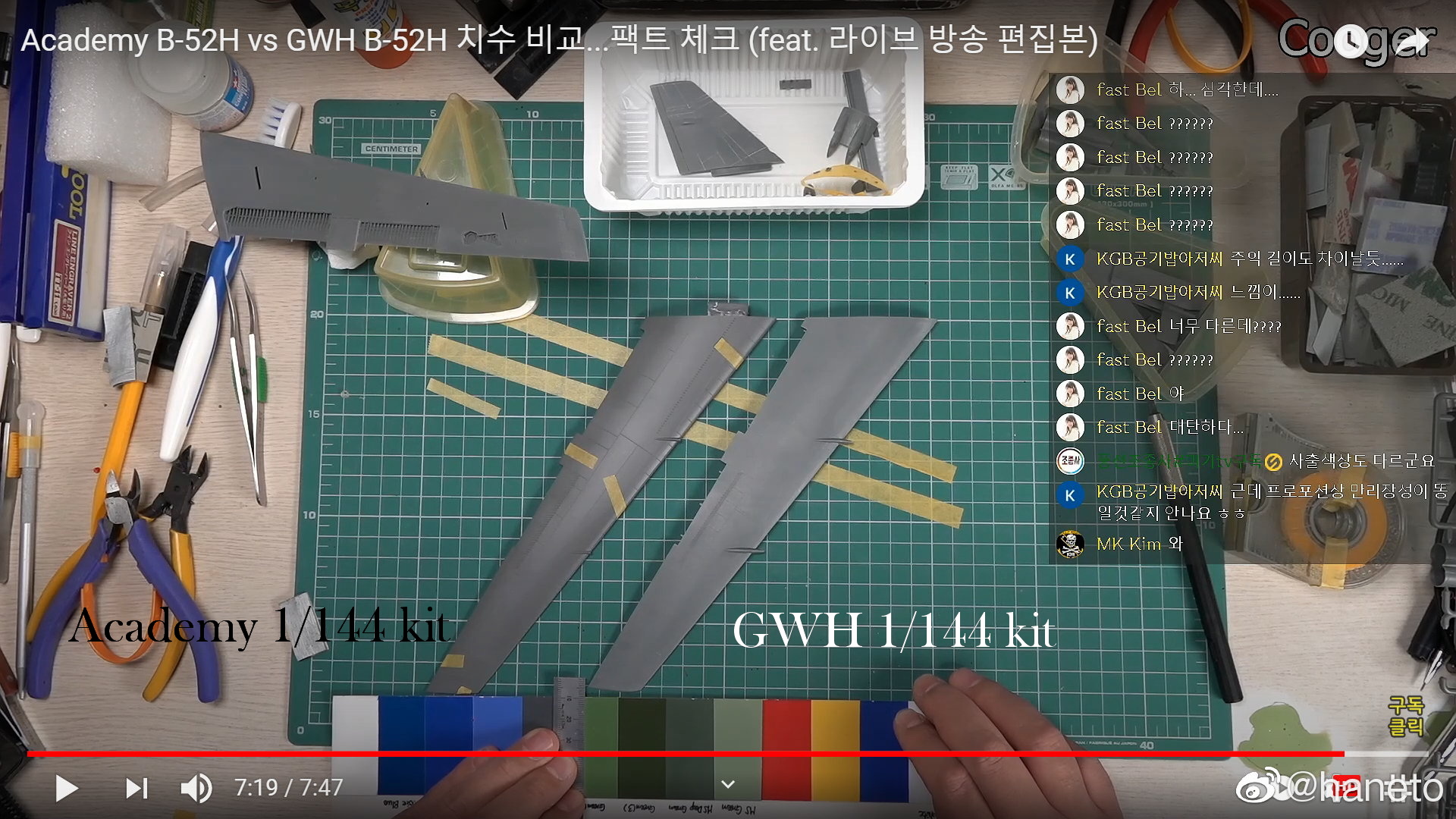

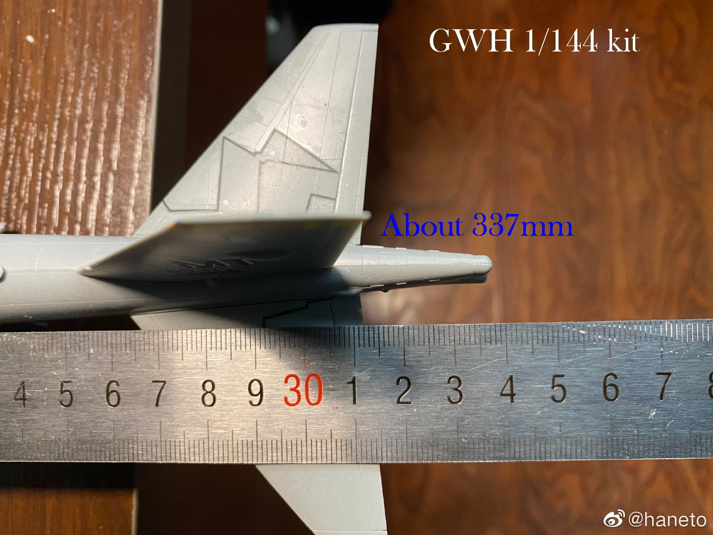

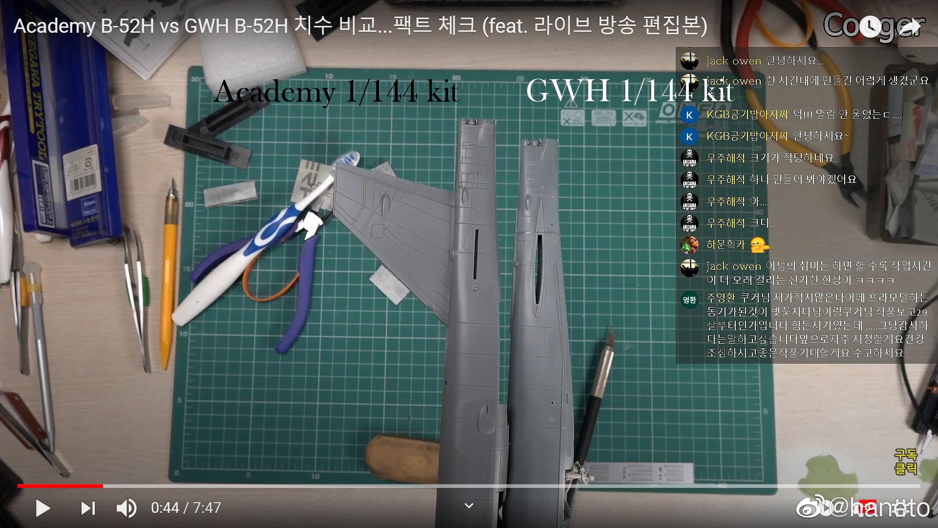

No, GWH is wrong in its dimension in terms of length and wingspan. The B-52H's fuselage was extended rearward after the phase IV upgrade program by 1m. Look at the diagram below.
Then, the correct fuselage length of B-52H in the 144 scales would be around (48(fuselage length prior to Phase IV upgrade)m+1m)/144 = 34cm, which is closer to the Academy's.
 There are more issues with the GWH kit, including incorrect details in the front landing gear bay and the fuselage shape. All the problems are also present in the Modelcollect's 1/72 scale kit, from which the GWH kit was significantly affected for some reason.
Edited by not2p

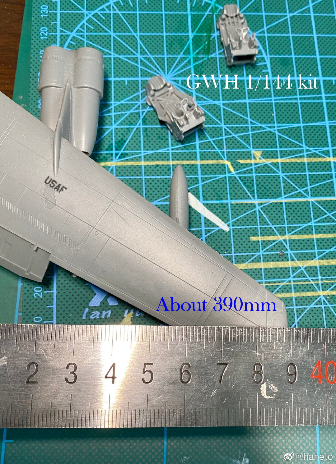

  Also, the GWH kit's wingspan is longer than it should be. The nominal wingspan you find on the web, 56m, i.e., 38.9cm in the 144 scales, is for the flight position. In the landing position, the wingspan is shorter than the value since the wings are drooped (This video shows how the wings move upward as the bomber takes off.). The GWH kit's wingspan is about 39cm, and the Academy's wingspan is shorter than that by about 1cm. Both kits depict the bomber in the landing position.

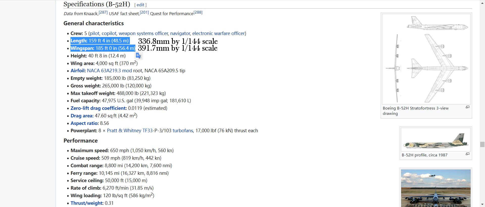

Thanks for explanation.
I simply compared the kit size with data from Wikipedia, and found GWH kit size is closer to the data in 144 scale.
The academy kit has longer fuselage and wider wingspan compared with GWH, so I though its scale is wrong(according to Wiki data).
01.thumb.jpg.2c18df8fe5f42f31a431d53a6c1b2006.jpg02.thumb.jpg.eab76d779e8f0749446264d1c6dd2442.jpg03.thumb.jpg.8062092feec91591759069d90374a306.jpg04.thumb.jpg.1ad8c843047151135f7fbaf524e03598.jpg05.thumb.jpg.57dd0a22544884622061c59683357b23.jpg06.thumb.jpg.bcdb863b8df70ac7aa02b073bc3ef56b.jpg07.thumb.jpg.1cf54946751776437821ce1d02d0b4ff.jpg
Or maybe the Wikipedia data could be wrong......
I think the big question is what configuration does the oft-referenced length of 159ft 4in refer to?  Is it the length of the B-52 as originally built?  Is it the length after the 40 inch Phase VI tail extension?  Does the length include the 20mm cannon, which has been removed for many years now?  There could be three valid lengths:
  • as originally built
  • with Phase VI and tail gun
  • with Phase VI but no tail gun
The Squadron B-52 in Action (1992 version) and Aerofax B-52G/H book both list 159' 4" as the B-52H/Phase VI length, and also agree on 156' for as-built.  Both books pre-date the M61 removal, and interestingly, the B-52 fact sheet on www.af.mil also lists 159' 4", so some dated info there it seems.
For what it's worth, the B-52G/Phase VI length was 160.91' per both books, so very close to 160' 11".
