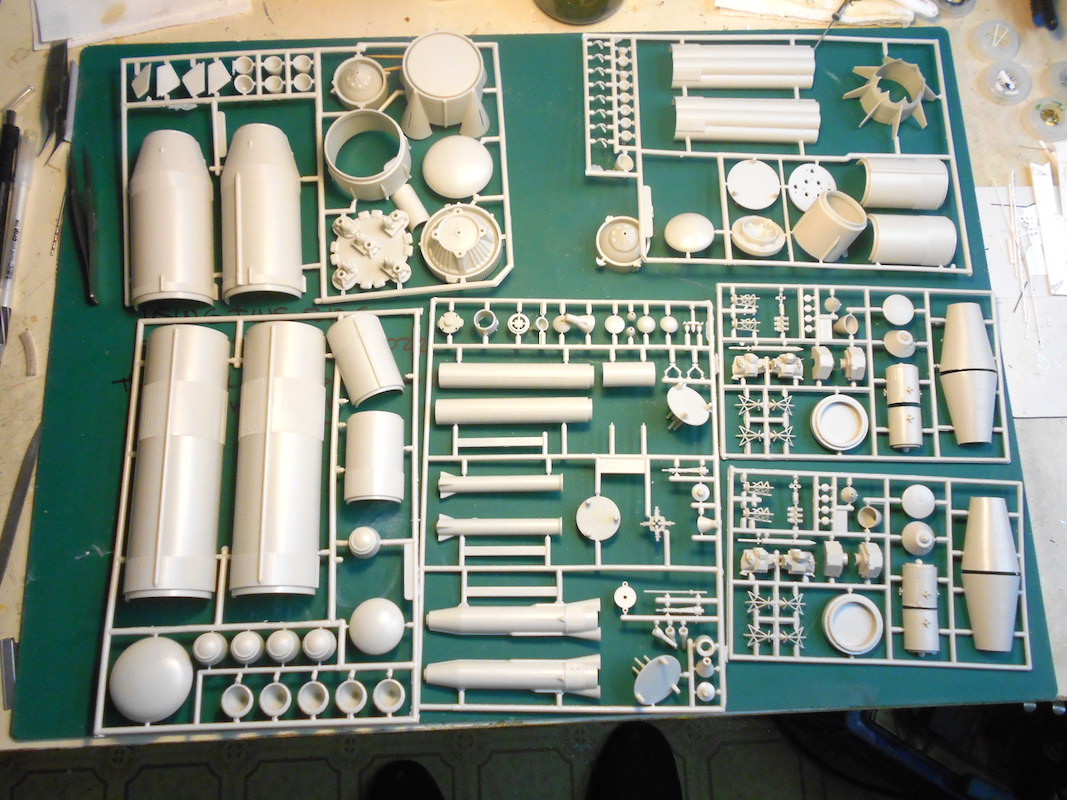

Over these past Christmas holidays, I selected this kit from my small stash and wanted to just build it, right outta the box, no mods, no corrections ... just build 'er for the pure FUN of it!
I won this kit in my 1st Group Build here on ARC 12 or 14 years ago. I bought the improved decals from Tango Papa about 10 years ago ... so-o-o this should be a quick build!
I had never even taken the sprues out of the cellophane packaging before ... and there's the Mercury Redstone, Mercury Atlas, Gemini Titan, Saturn 1B and Saturn V. I'm curious to see how tall the Saturn V is ...

These are going together really quickly ... and the fit of these parts is very, very nice!
Bearing in mind what I'm accustomed to building and their poor fit plus the small size of these bits
Nice fit!

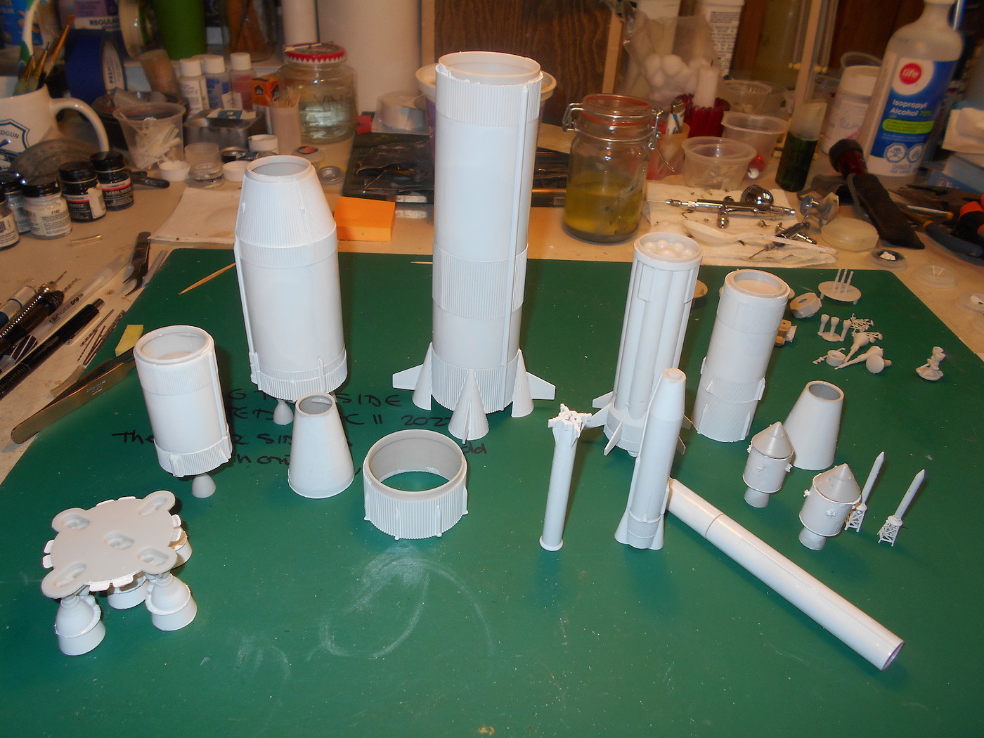

And they're already glued up!
And this 1/200 Saturn V is surprisingly tall!

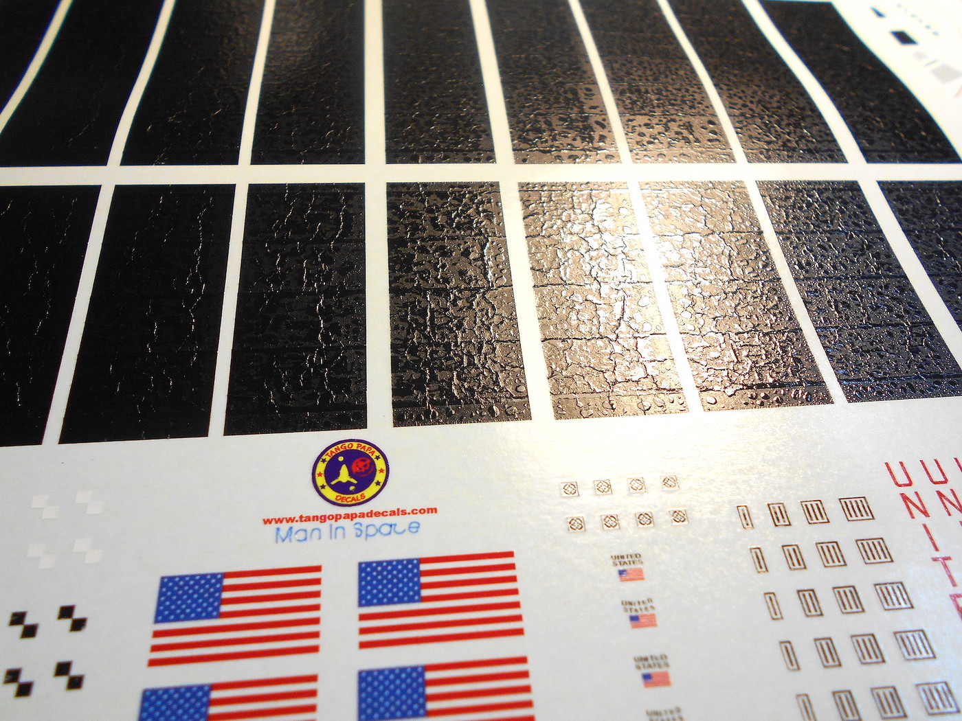

These Decals are ALPS printed ... and reading the instructions from TP, I sprayed 'em with Krylon Clear as I always do with my Inkjet decals an-n-n-d, this happened.
That warpage and buckling occurred. Do ALPS decals not need to be sealed? Did I damage these Decals?
I contacted Tango Papa, who got bought out last year, and they were of no help at all ...
I haven't tried applying one yet, yes there are extras, but I don't wanna waste 'em in case I ruin one when applying 'em to the models ...
Any advice you ALPS users can provide would be most appreciated!

I'm not sure what TangoPapa coats his decals with, but the ones I've used I didn't overcoat them with anything.  However, if I'm working with old decals I'll apply a layer of Microscale Decal Film just in case.  When I print my Alps decals I apply a layer of the Microscale Decal Film and they hold up quite well. I hope you can save the decals.
Randy

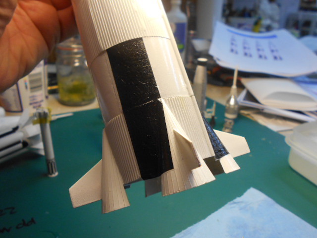

So, I wanted to knock some rust off of my Masking skills on the Saturn V and the Tamiya Tape allowed a lot of seepage under it ( yeah, I know it's not the Tape's fault ...  ) The Paint job was so poor that I spray bombed White paint over it and tried again. Man oh man, I'm lousy at this. So I sprayed Easy-Off to remove the 3 layers of paint on the first Stage and started over ... with the intent to use the decals.
Easy-Off applied and in the bag for 24 hours ...
I masked off the S1-B and the tape, while lovely stuff, isn't contrasty enough for my old eyes and I couldn't tell if I had cut the tape accurately.
.... but it was good enough, with touch-ups incoming. In this image, you can see that I've applied decals to the Redstone, Titan and Saturn V first Stage an-n-n-d ...
... YIKES! ...now, while looking at the decal sheet, I did wonder how the black rectangles would translate onto the cone shaped Fairing and ... they didn't !
Who in Hades designed this decal?
So, seeing as these models are ALL incorrect and these decals are just an exercise in frustration, I shall just paint 'em up, and relegate them to being blown up come Fireworks Day.
