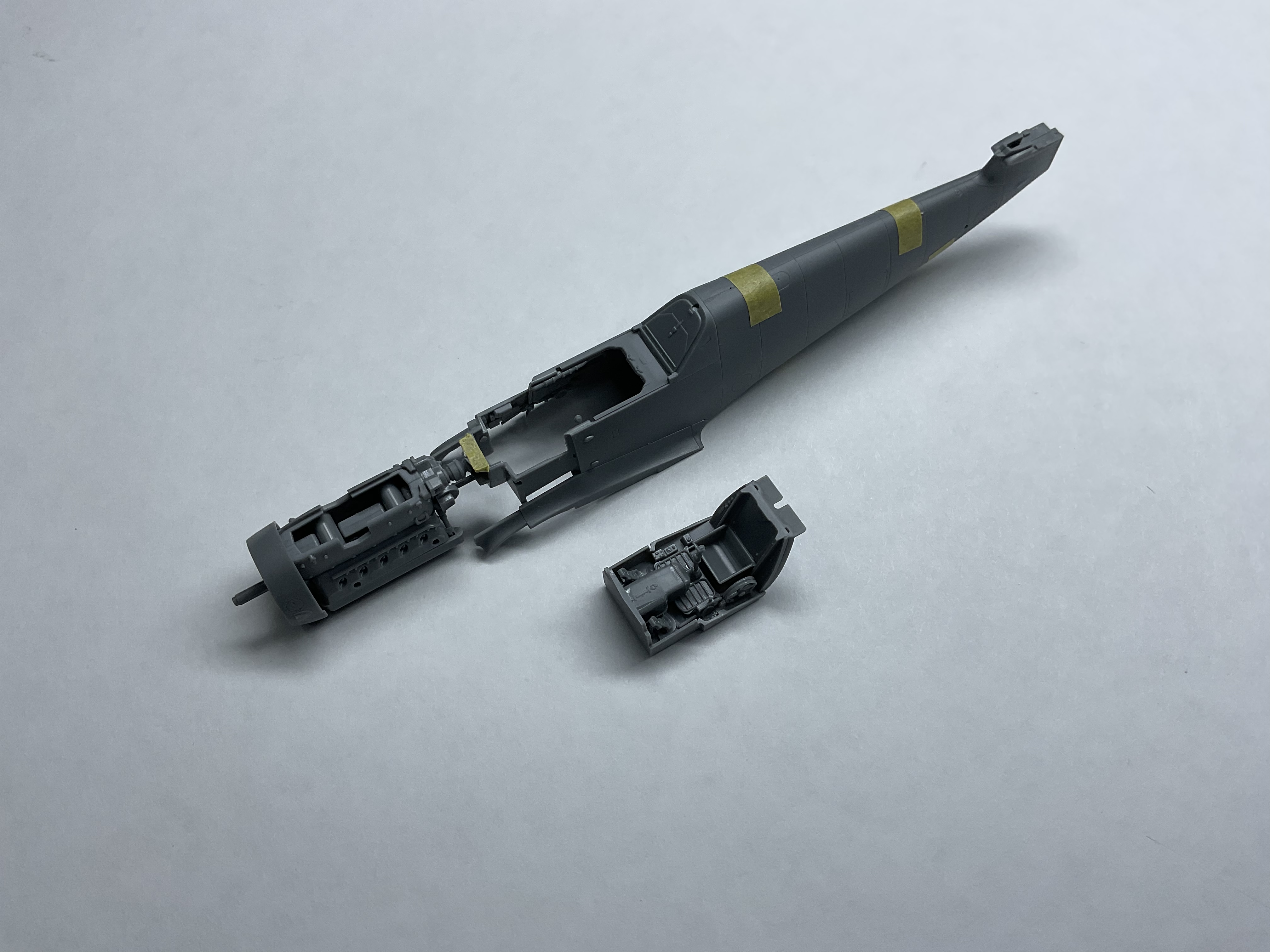

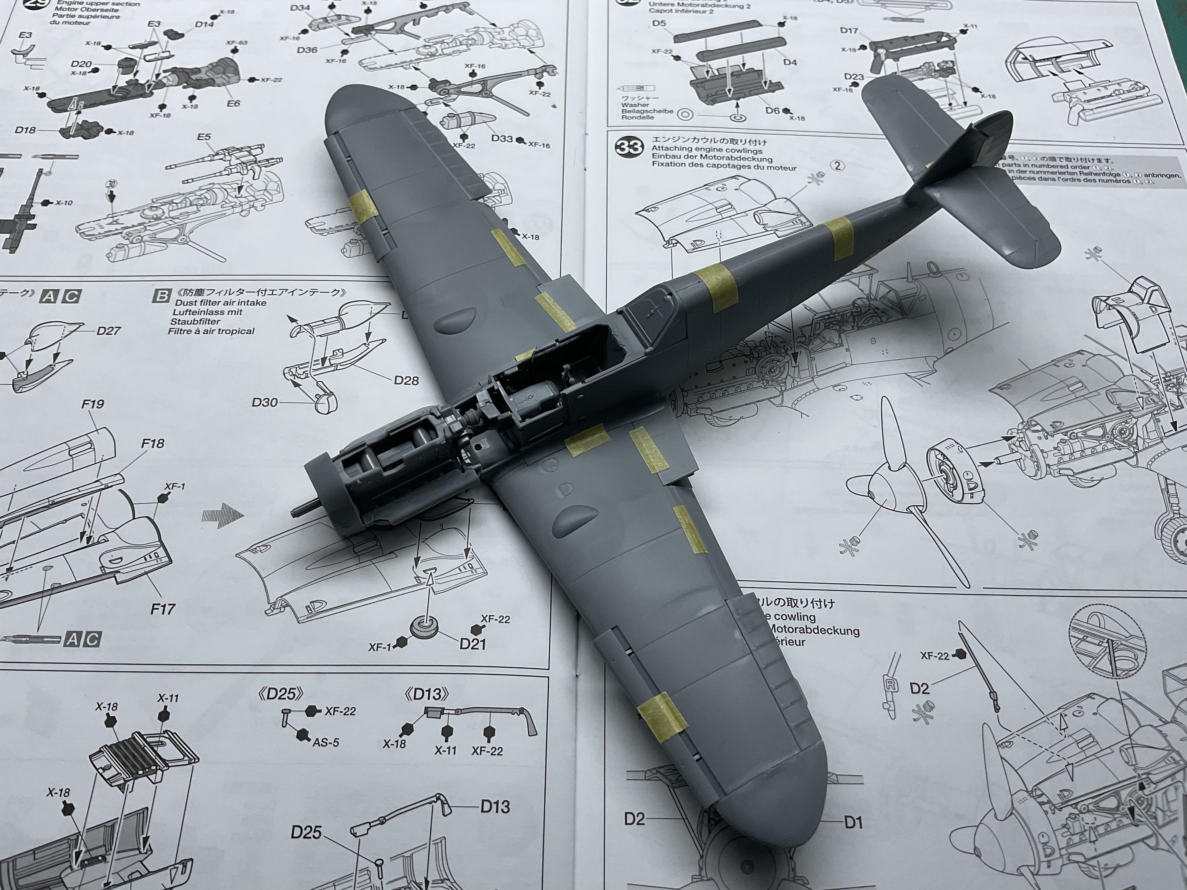

dai phan Posted January 10 Author Share Posted January 10 (edited) Hello all… Started building tonight and waiting for the paints to arrive. The Tamiya kits are such a joy to build. The parts fits so well like a fine Swiss watch. The tolerance is so tight that seams tend to disappear and that is not good if they fall on the panel lines. The 109 has a top and bottom seams that likely will be eliminated if you apply thin cement over the joints. I will apply from below. Dai Edited January 10 by dai phan Quote Link to post Share on other sites

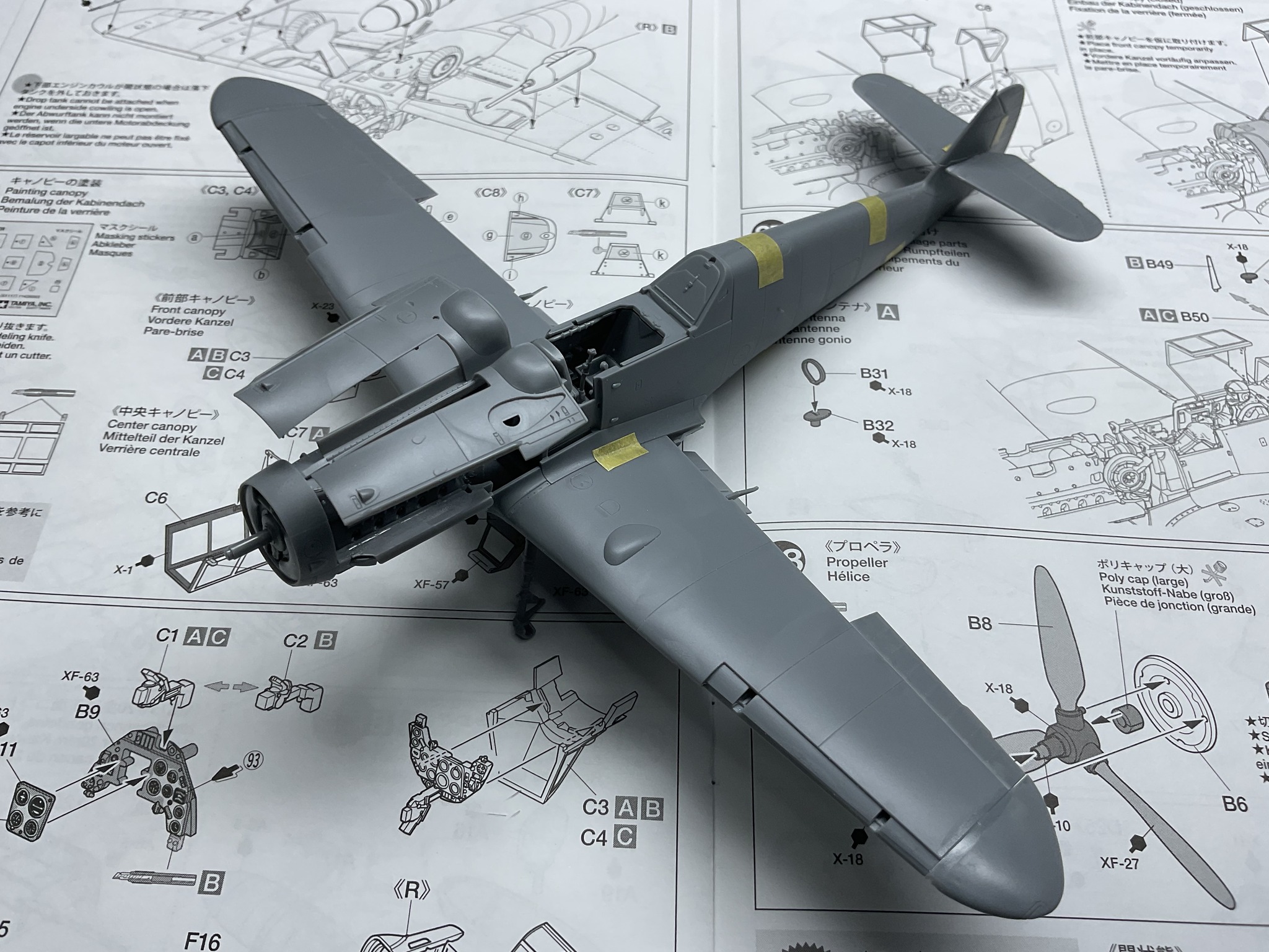

dai phan Posted January 11 Author Share Posted January 11 (edited) Hello all, While waiting for paints, went ahead and assembled the main components. A few points to note, the attachments of the pedals are tiny and thus you should use thick cement for strength. Also when glueing the wing tips, install the airelons so you can check the correct position of the tips. The trailing edges of the wing tips should follow the contour smoothly. The assembly went very fast due to the excellent engineering and fit of parts. This is what modeling is all about. Really I cannot see anything better than this… Dai Edited January 11 by dai phan Quote Link to post Share on other sites
dai phan Posted January 11 Author Share Posted January 11 One more thing. Some comment on the Net about the magnets allowing either open or closed cowls at anytime as “gimmicks”. I beg to differ. Gimmick is about something what seems to be but it is not. This novel feature from Tamiya is a working feature and it delivers what it says. Gimmicks ???? I do not think so. Although in the closed cowling configuration, some shimmings are needed to make the joints tight. Dai Quote Link to post Share on other sites

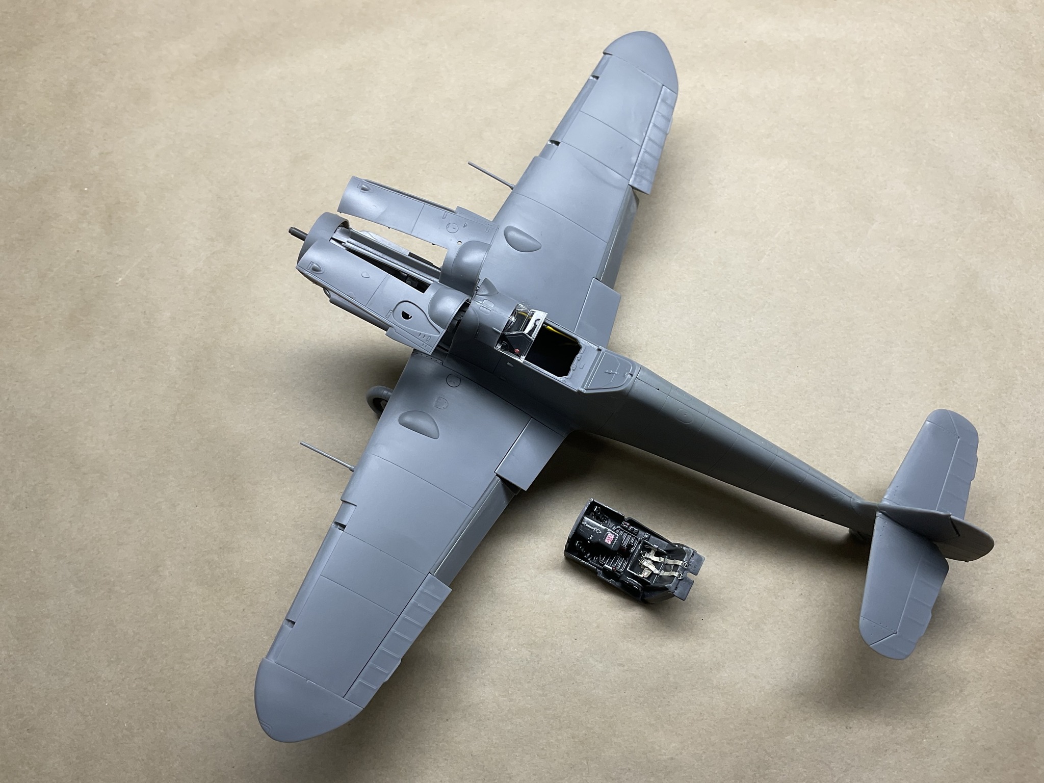

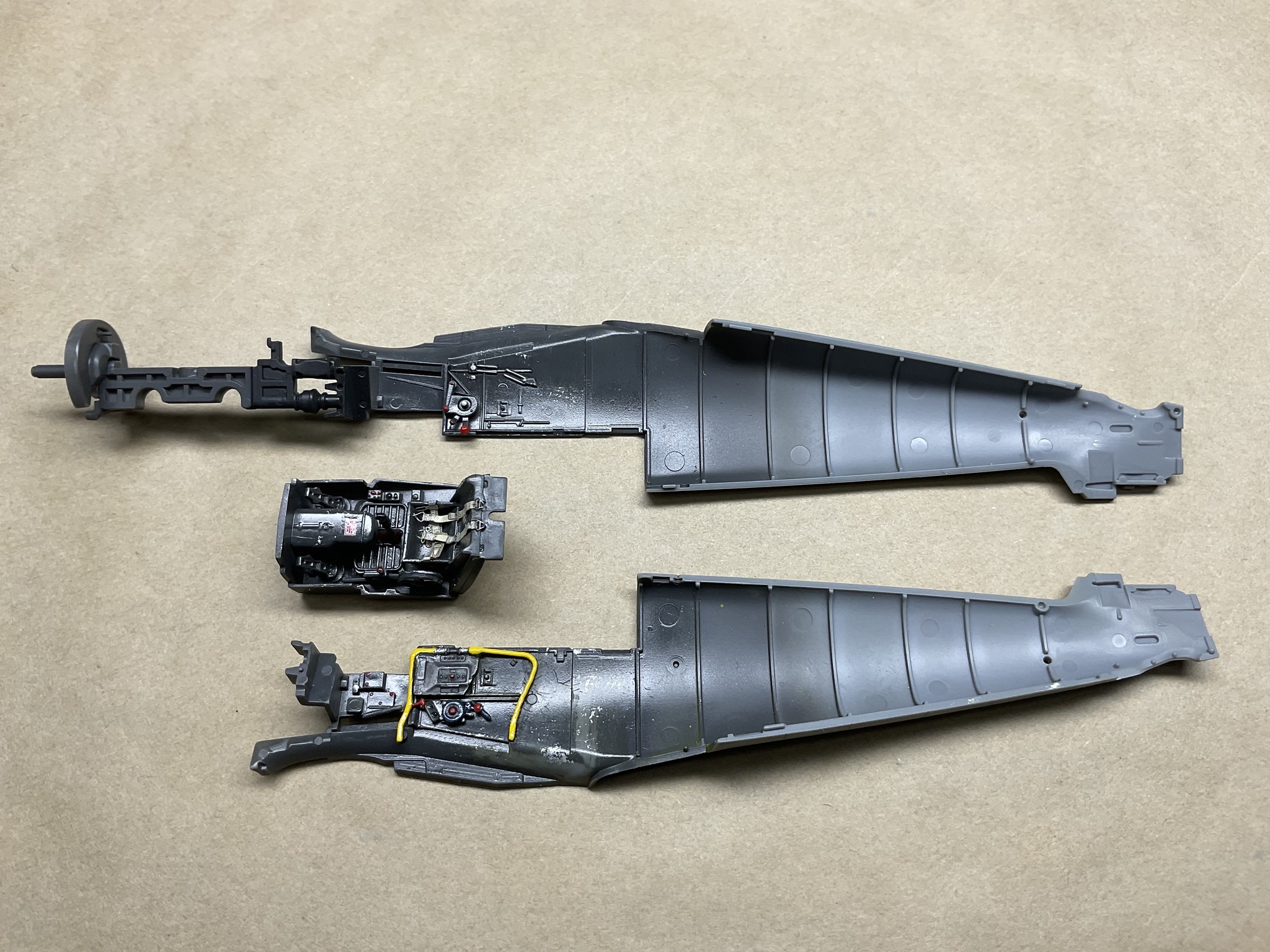

dai phan Posted January 12 Author Share Posted January 12 (edited) Hi all, Working some more while waiting for paints. A rarity here... I had to trim on the landing gears mounting tabs so they sit flush onto the wheel well. With Tamiya's drop fit without questions asked I had to wonder if I mucked up? A warning here, the gun pods halves have a VERY FINE raised line along on the seam line. Watch out or you will sand it off like I did. Luckily I have 3 back up kits to correct my mistake. Dai Edited January 12 by dai phan Quote Link to post Share on other sites

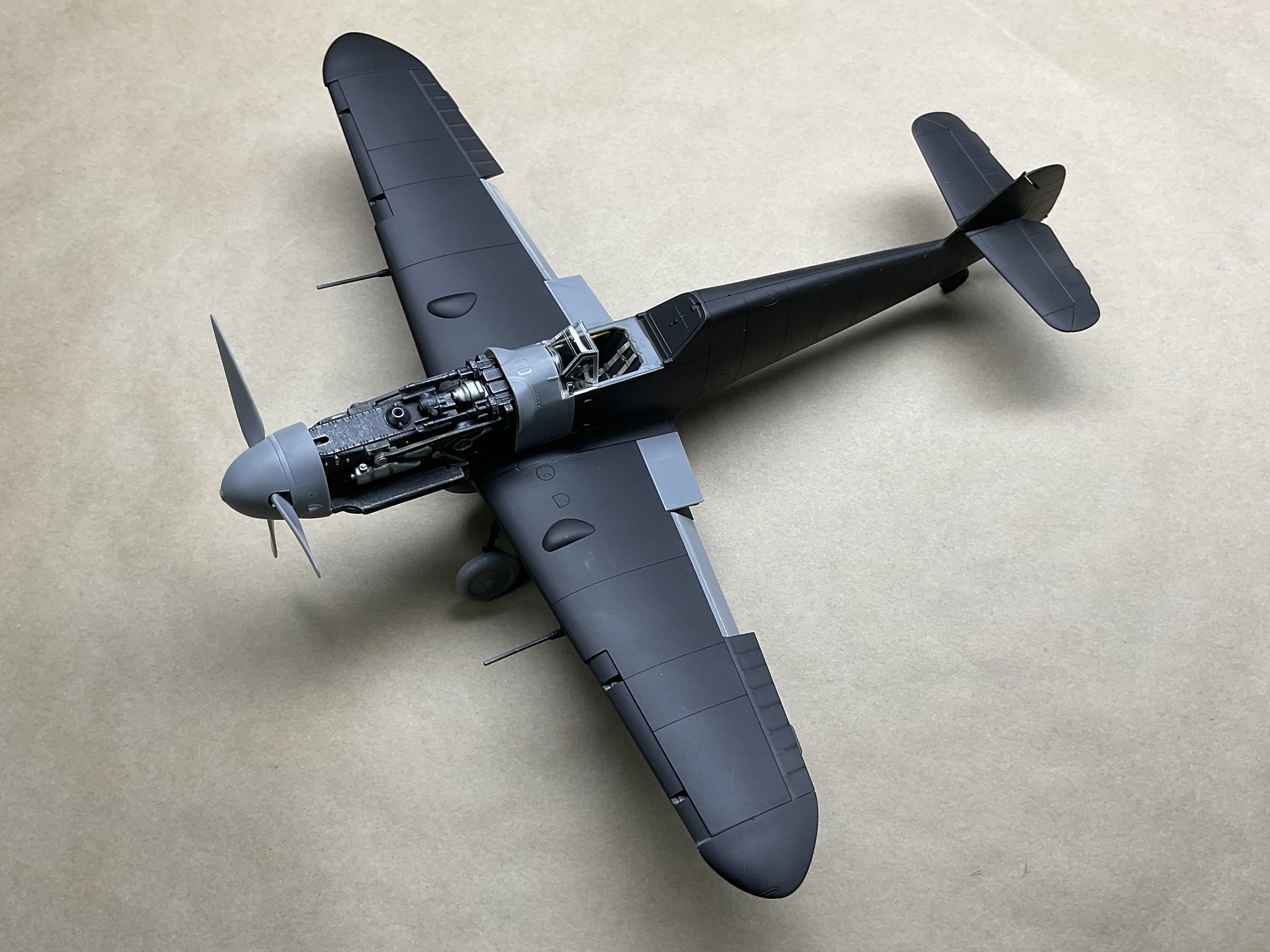

dai phan Posted January 15 Author Share Posted January 15 (edited) Hello friends, Started painting today. I remove the kit hose (yellow) and fabricate from sprue to make them longer and so I can paint it seperately. The rear fuselage deck is slightly smaller then the fuse causing a slight step at the seam lines. Accurate or blunder ? The tolerance is so good that what you see here is press fit. The coat is gloss so I can remove unwanted wash easier. Later the parts will be dull coated. Dai Edited January 15 by dai phan Quote Link to post Share on other sites

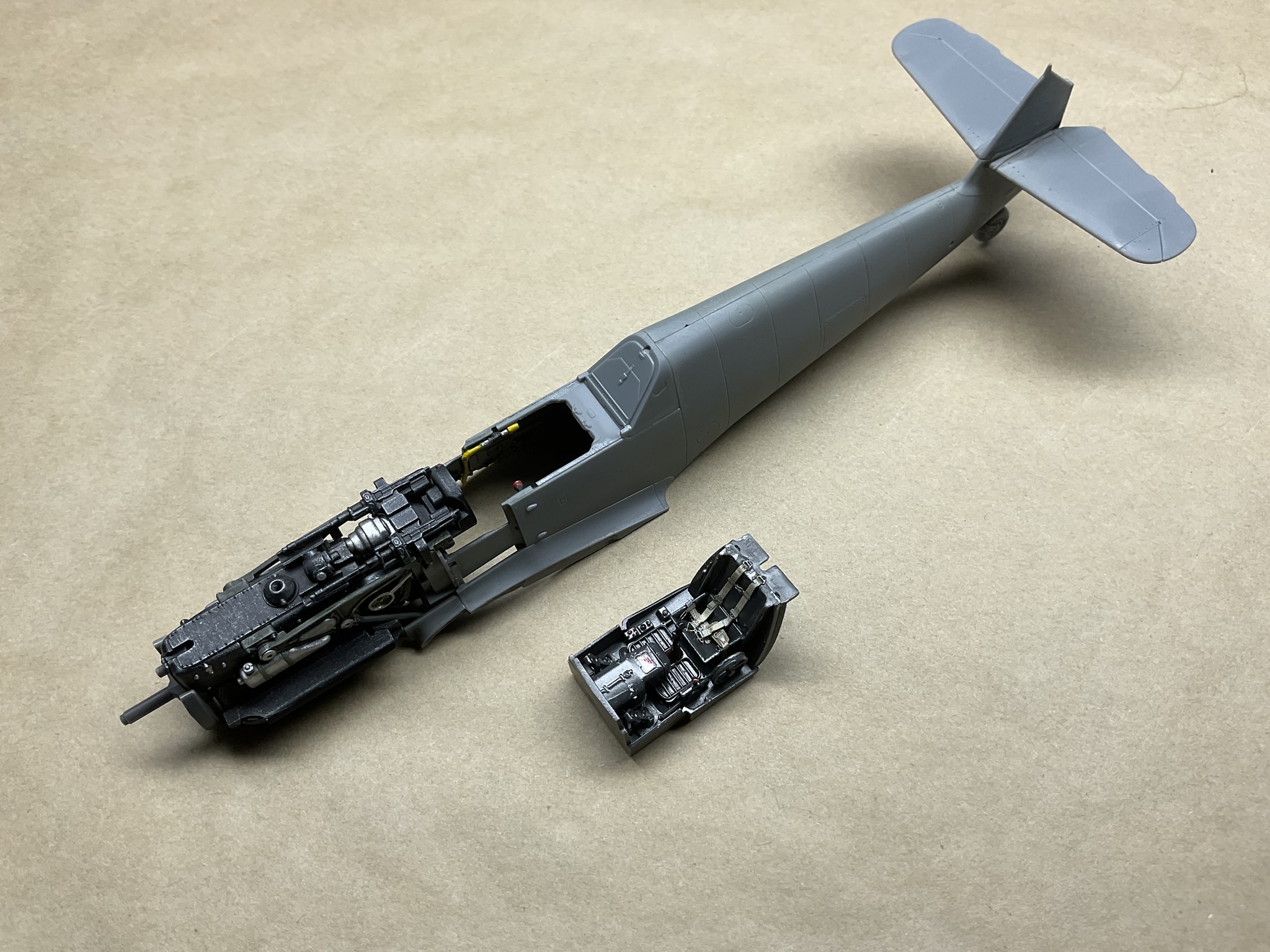

dai phan Posted January 15 Author Share Posted January 15 Greetings Sunday everyone... Tne engine is not quite detailed like Eduard's after market set but still impressive. I hope Tamiya will keep this trend in future releases. Dai Quote Link to post Share on other sites

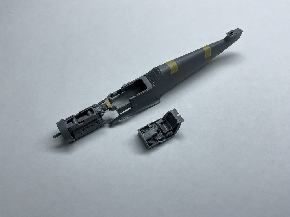

dai phan Posted January 16 Author Share Posted January 16 Hello all, Primed the model. The fit is so perfect that no clean up is needed. Tomorrow will be application of the main colors. Dai Quote Link to post Share on other sites

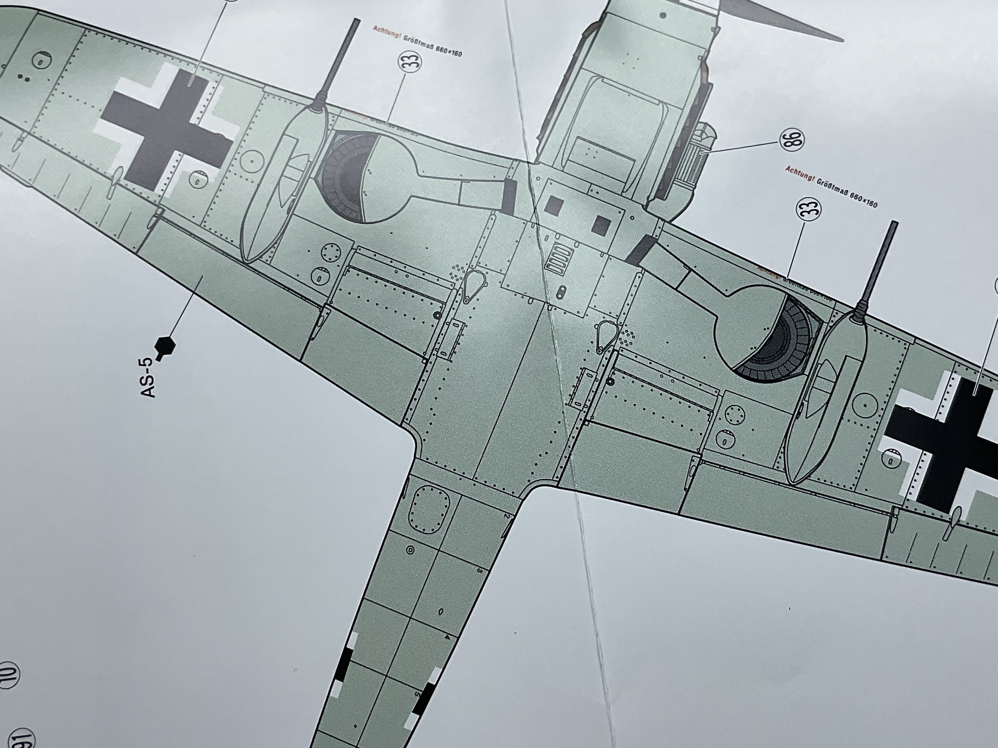

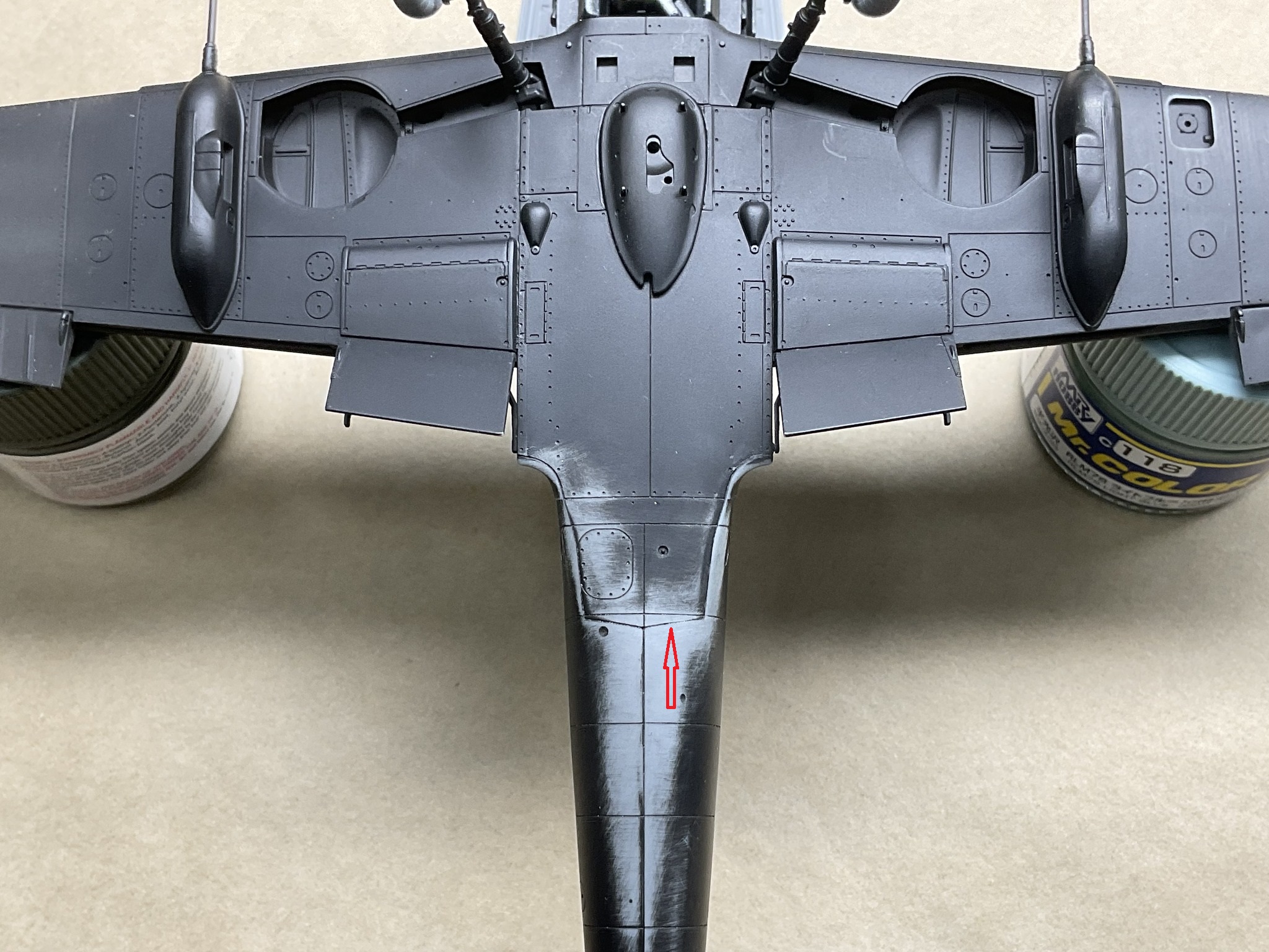

dai phan Posted January 16 Author Share Posted January 16 (edited) Howdy all, I may have spoken to early about no seams to clean up. Here is an odd one. Tamiya is known for placing the joint lines at the panel lines so there is no need to fill and file the unwanted seams. On the bottom, rather than placing at the panel line, Tamiya decides to place the joint line away from the actual panel line! That will require some work that could be easily avoided. In addtion, the other joint line happens to be right on the oval inspection panel that will need to be rescribed. Totally unwarranted here. I check the refrences and there is no V shape panel line as seen on the red arrow. I find it odd that a company well known for masterful engineering can make blunder like this. I do not get it . Do you? Dai Edited January 16 by dai phan Quote Link to post Share on other sites

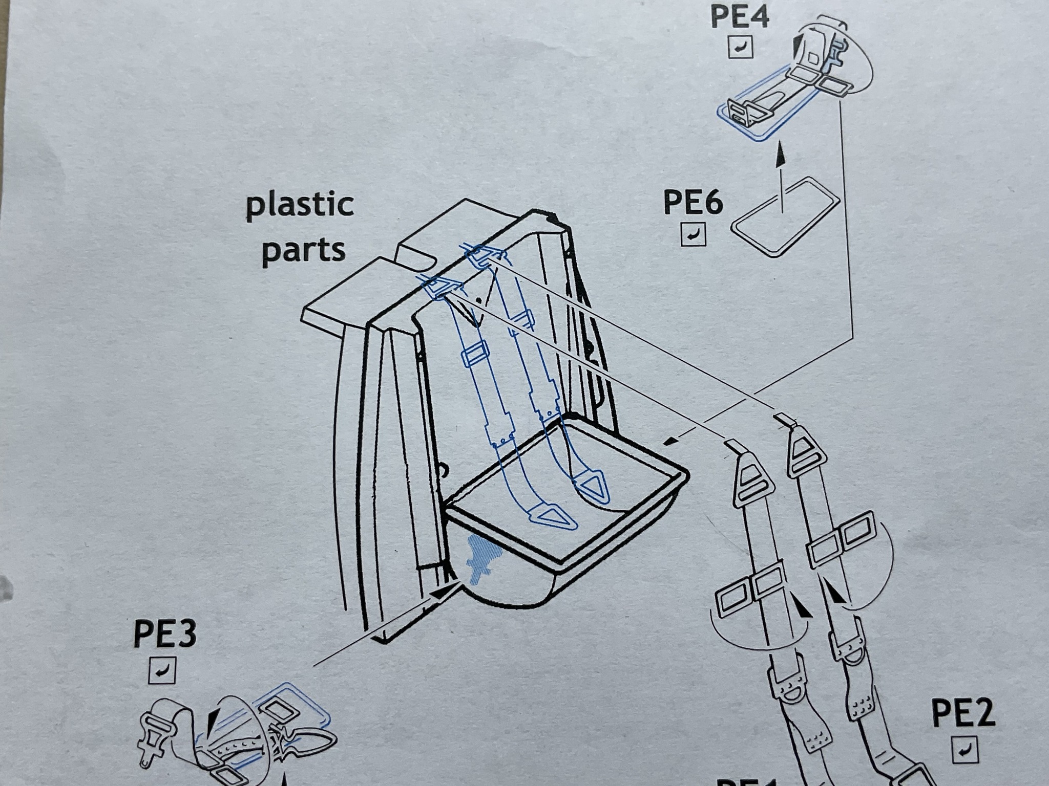

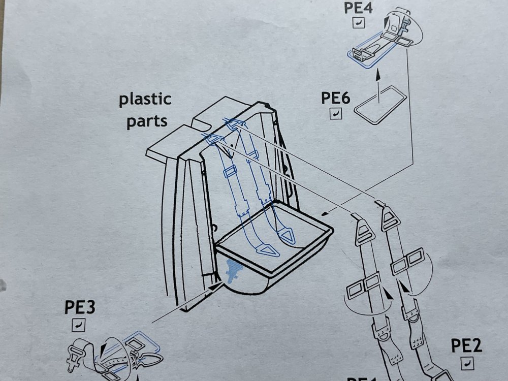

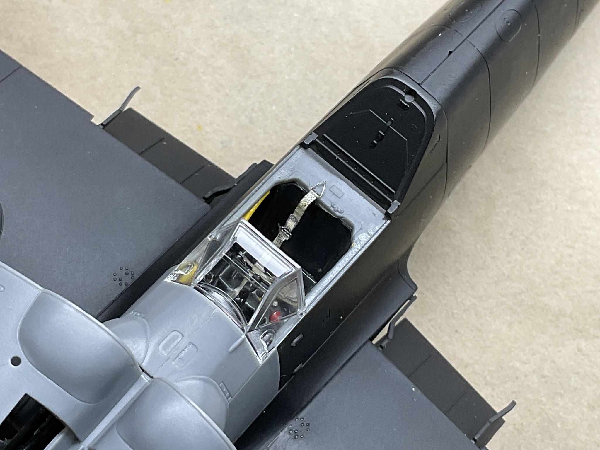

dai phan Posted January 16 Author Share Posted January 16 (edited) OK friends, On the Eduard's Look set, the instruction on the seat belt placement is wrong. The illustration shows how they are attached to the seat assembly before it is placed in the fuse. This is not correct. The right way is to apply the belts after the seat is joined to the fuselage as the attachment points are not on the seat itself but on the rear panel. I place the belts to show the correct position. This will be done after everything is painted. Dai Edited January 16 by dai phan Quote Link to post Share on other sites

barkin mad Posted January 22 Share Posted January 22 On 1/16/2023 at 6:50 AM, dai phan said: I find it odd that a company well known for masterful engineering can make blunder like this. I do not get it . Do you? Dai Tamiya are not the be all and end all that many seem to make out. Yes, they assemble very well, but like all model companies, they do make mistakes & inaccuracies. ------------ Quote Link to post Share on other sites
