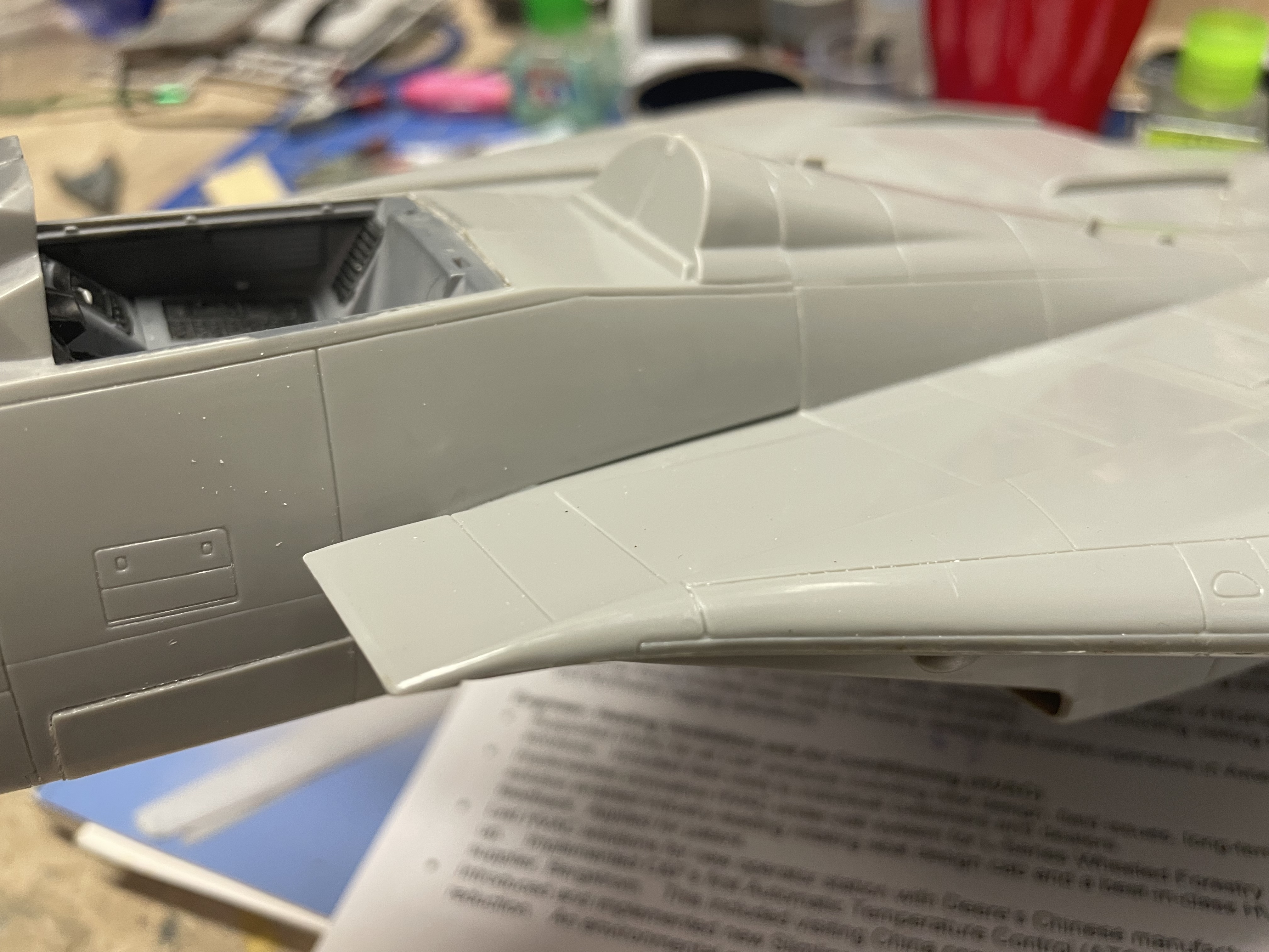

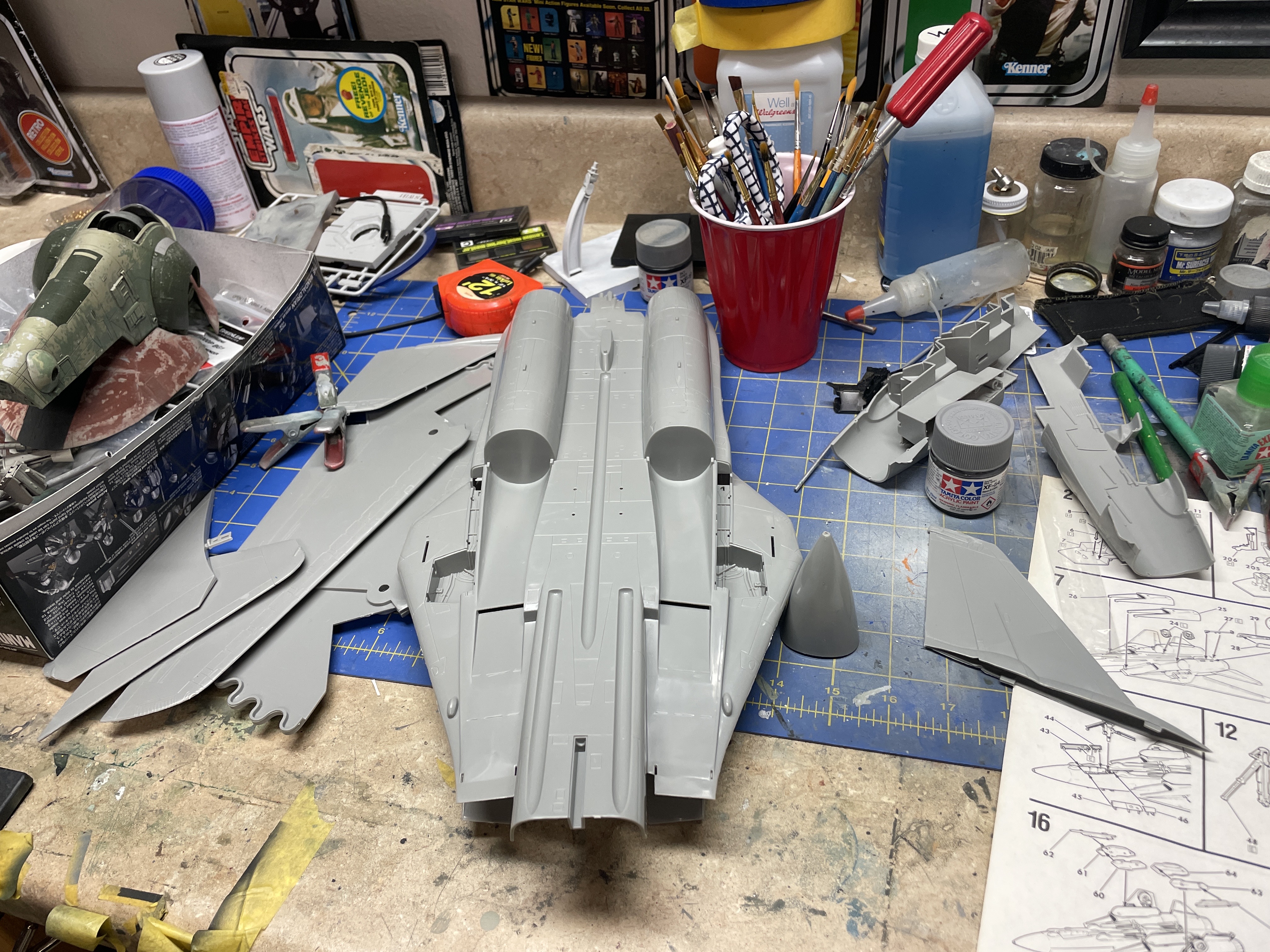

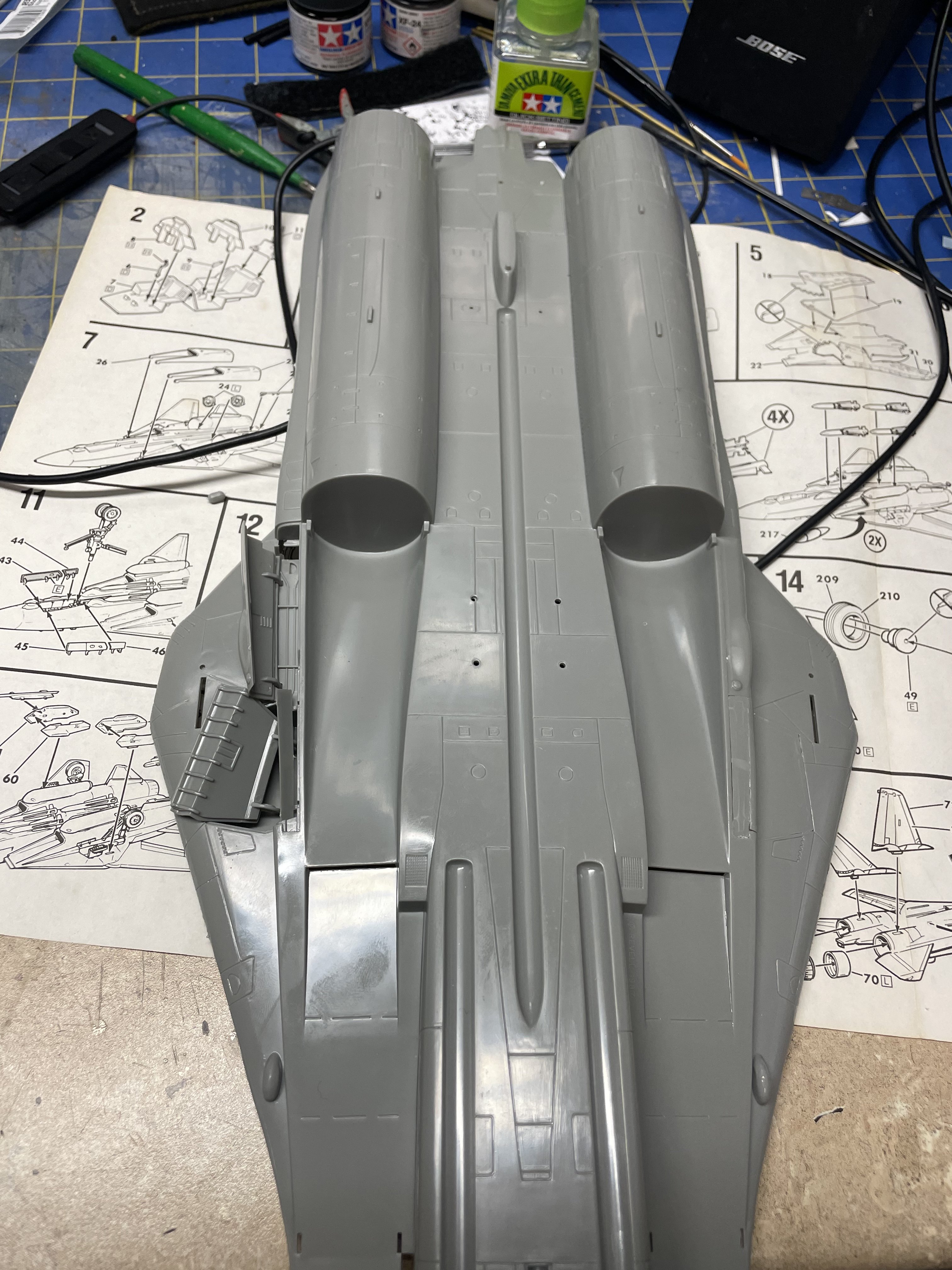

toadwbg Posted January 8 Author Share Posted January 8 (edited) I started slapping together the main assemblies of wings, stabilizers and forward fuselage. For an older kit, this does go together quite well. I think the simplified kit engineering and lower part count contributes to this and is a welcome change from modern Uber-kits. Sure there’s a touch less detail or accuracy but for this subject matter it’s perfect! I'm also doing this “wheels up” and cockpit closed, I’ll add some pilots which will be the GI-Joe characters Ace and probably Ripcord in the rear as these were the figures my toy had in them as a kid! The Revell kit again impressed me with its easy fit of the gear doors in the closed position. Cockpit panel detail is nicely molded and really won’t need much improvement. I’ll do a little scratch work on the cowls since they are very visable under the canopy. Edited January 8 by toadwbg Quote Link to post Share on other sites

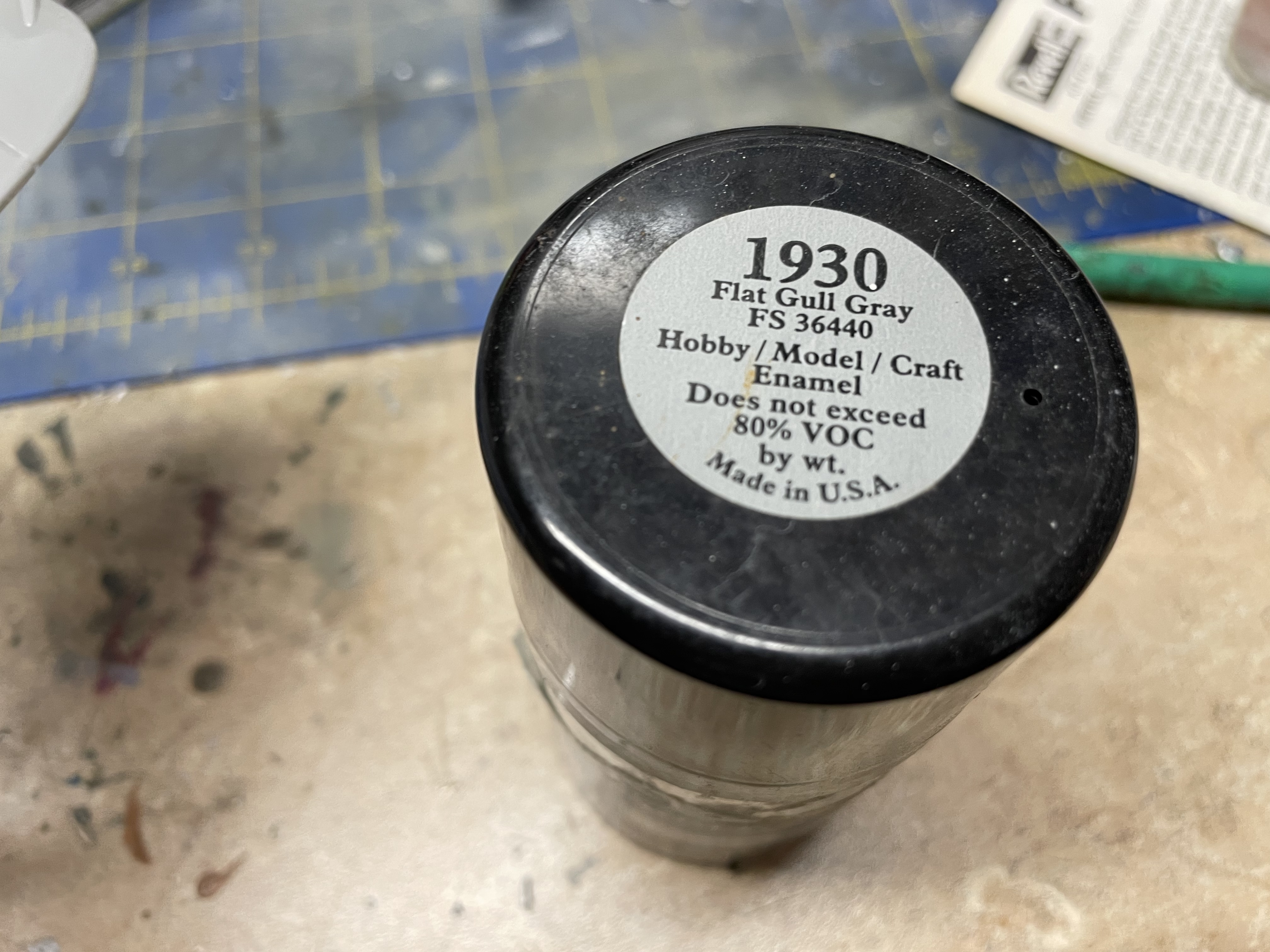

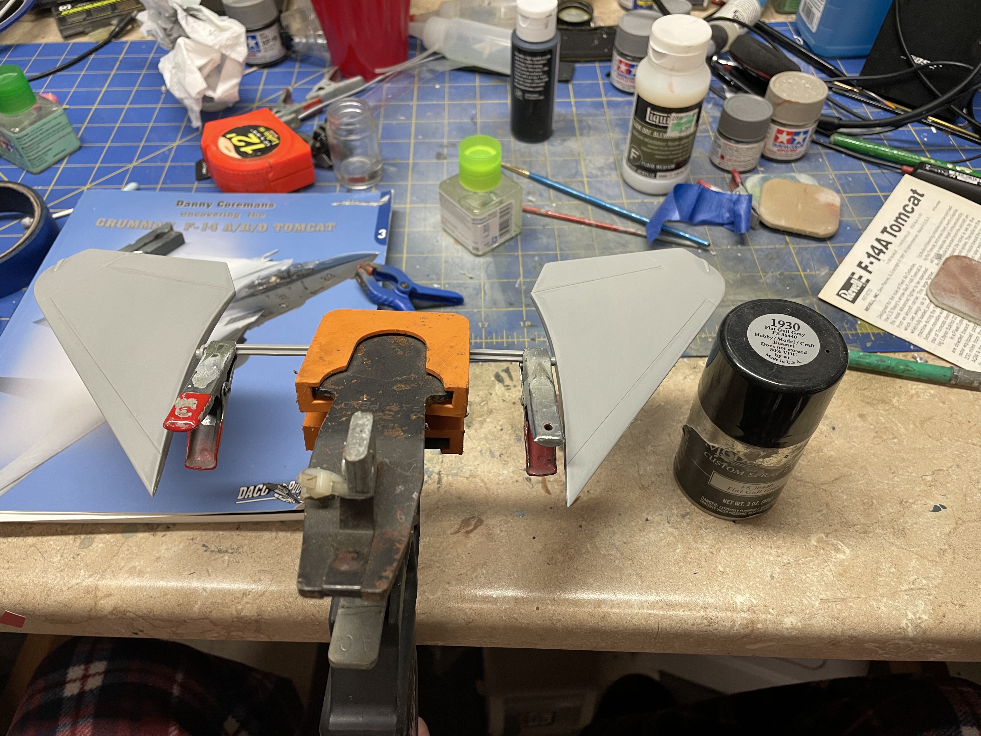

toadwbg Posted January 8 Author Share Posted January 8 I’ll be painting the wings and stabilizers soon. As there’s a LOT of surface area on a 1/32 Tomcat, I’ll be using a spray can bomb. What color to paint the fuselage? I’m not feeling the need to be 100% real life accurate on this build and trying to find the right balance in the spirit of the 80s toy. Doing a little research I’ve decided to target FS 36440 Gull Grey. I even found an old (maybe 20 years!) can of Testors in the cabinet to do a color test with. Unfortunately the propellant has leaked out. So I’ll be buying some new cans of probably Tamiya AS-16. Quote Link to post Share on other sites

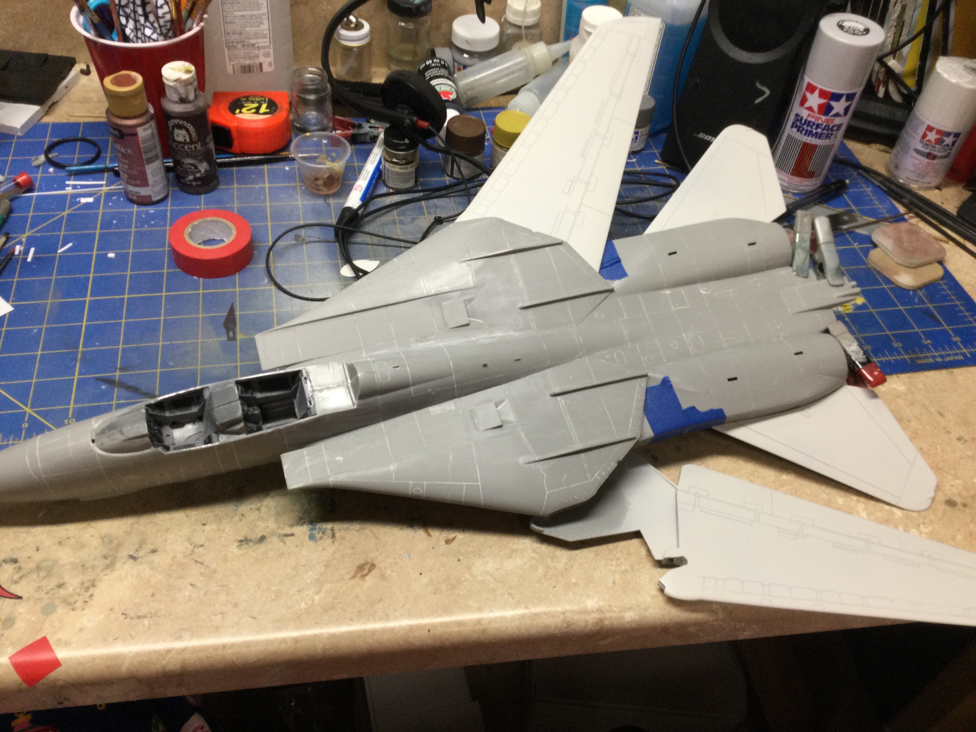

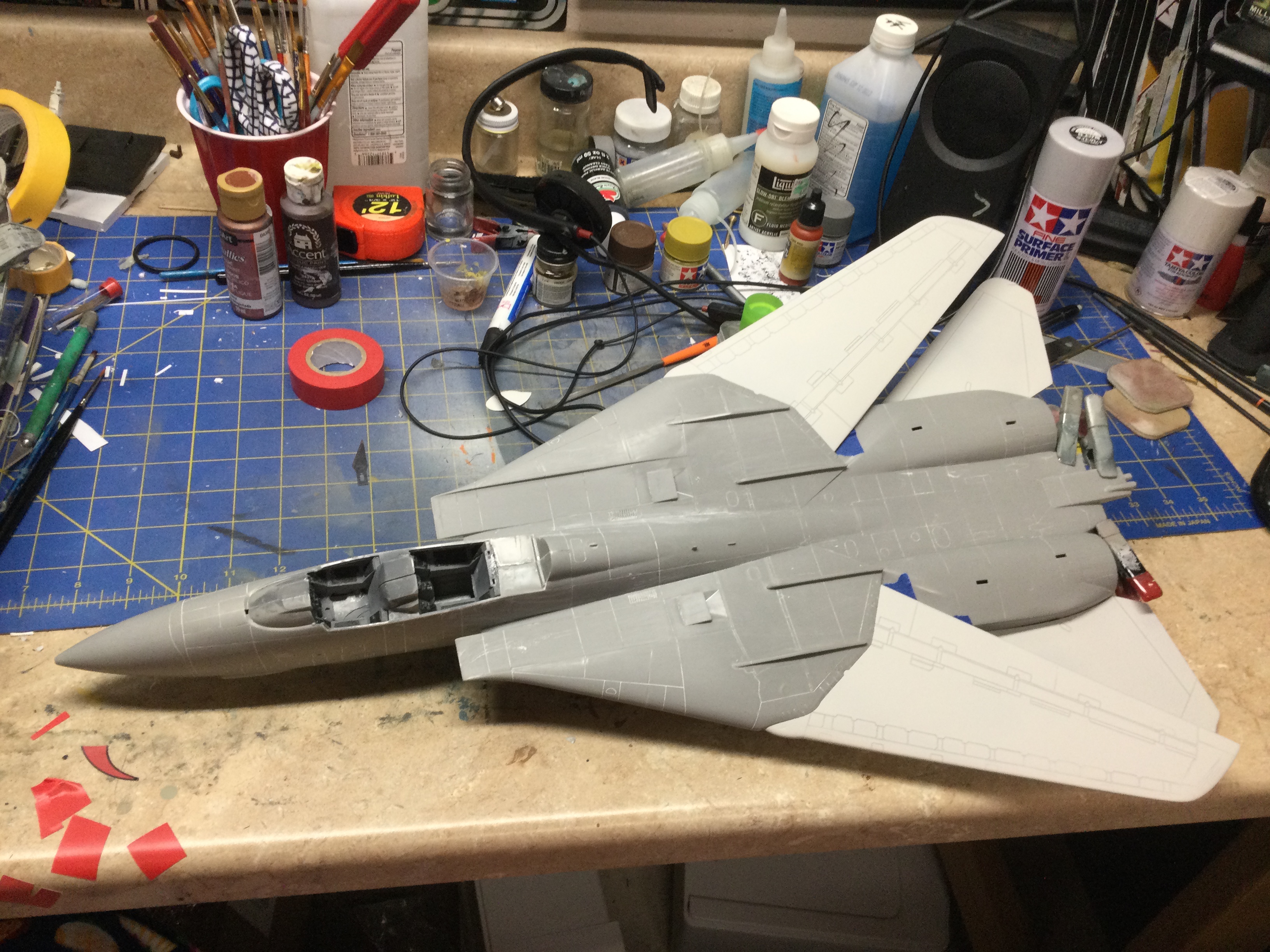

toadwbg Posted January 9 Author Share Posted January 9 (edited) I tried out the AS-20 insignia white over the molded grey plastic on the horizontal stabilizers, I like it! With some weathering I think it will be a great color for the Skystriker Edited January 9 by toadwbg Quote Link to post Share on other sites

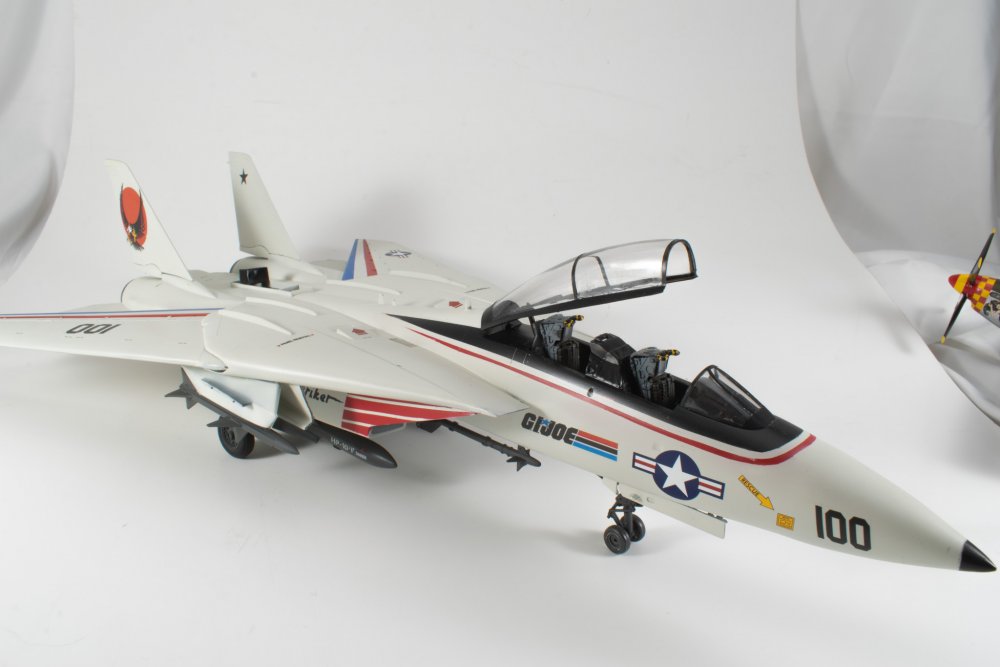

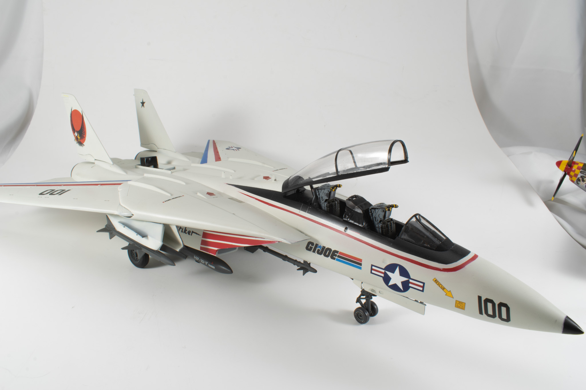

Kurt H. Posted January 11 Share Posted January 11 (edited) Since you asked, here is mine: I worked with 3 amigos decals to make the decals. I painted the red trim on the intakes, and around the canopy. I also painted the red, white and blue stripes on the trailing edge of the wings. It was a fun project, I hope you have as much fun as I did. Edited January 12 by Kurt H. Quote Link to post Share on other sites
toadwbg Posted January 11 Author Share Posted January 11 15 hours ago, Kurt H. said: Since you asked, here is mine: I worked with 3 amigos decals to make the declas. I painted the red trim on the intakes, and around the canopy. I also painted the red, white and blue stripes on the trailing edge of the wings. It was a fun project, I hope you have as much fun as I did. Love it! Thanks for posting. Quote Link to post Share on other sites

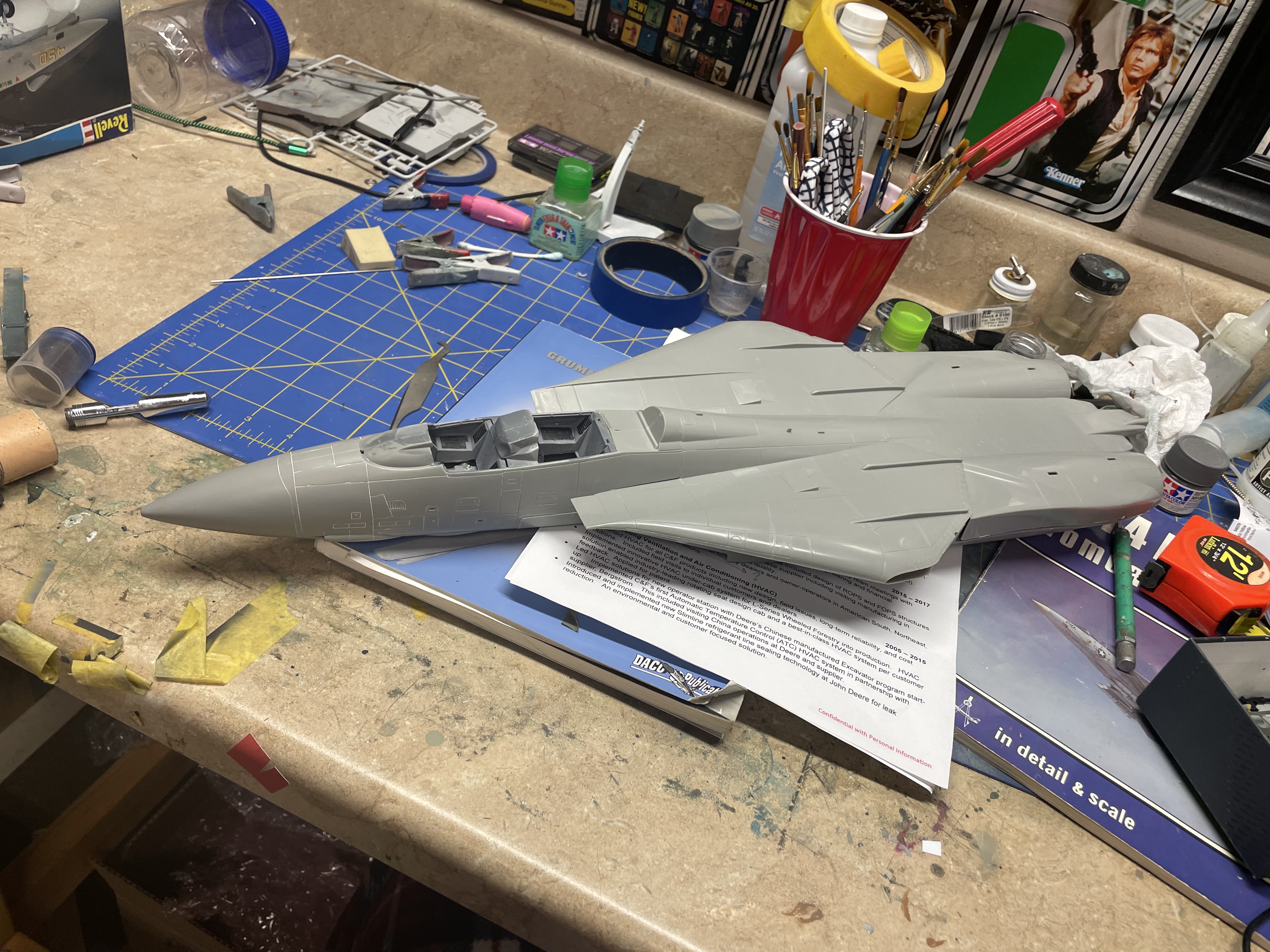

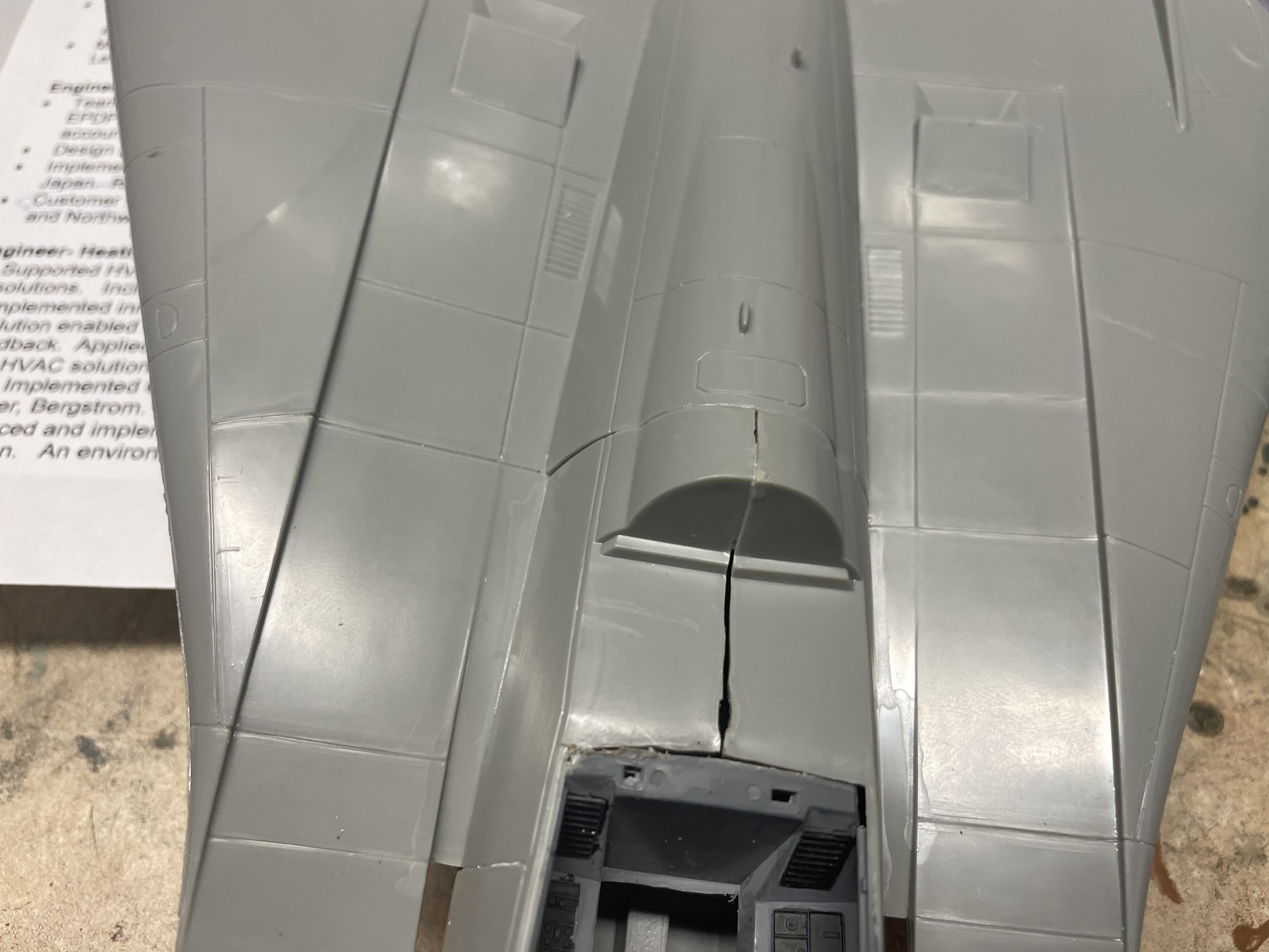

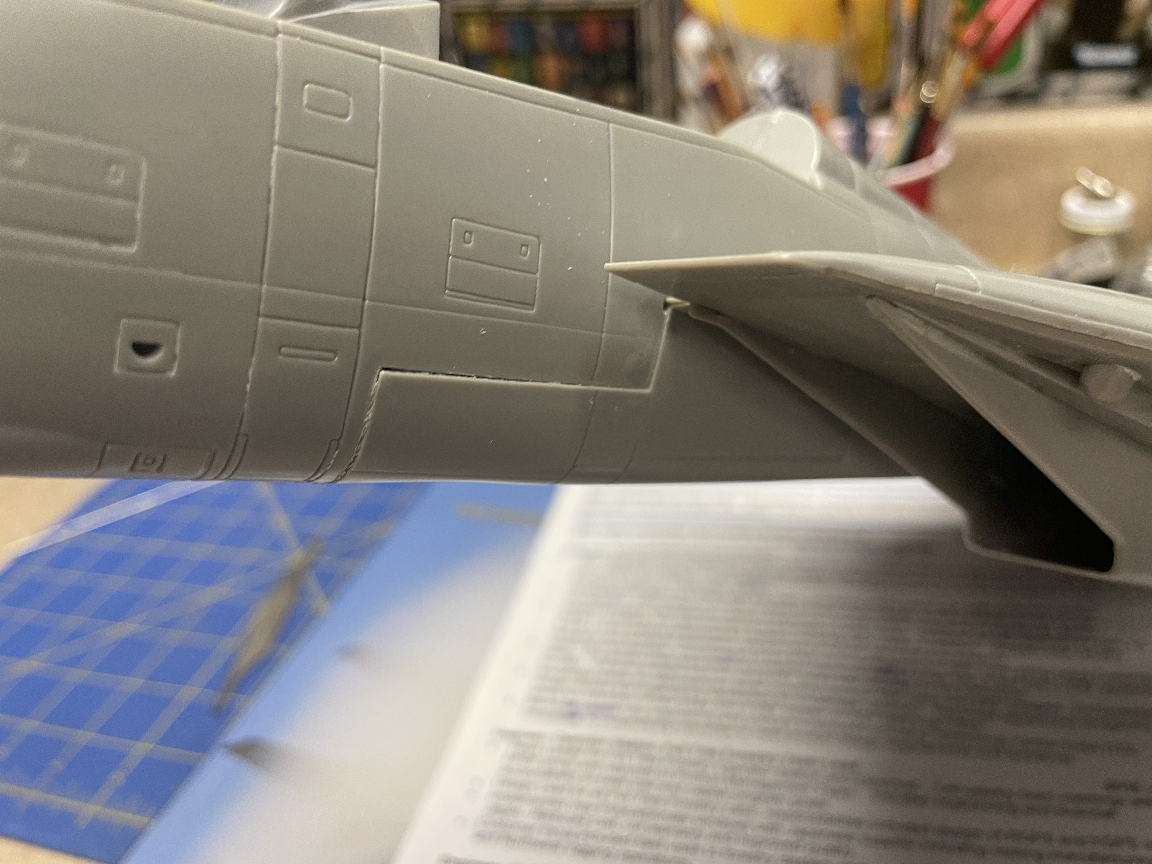

toadwbg Posted January 13 Author Share Posted January 13 Progress is moving along. Forgot how big 1/32 jets are! I did some test fitting of the forward fuselage with the rear upper/lower halves and it looked pretty good. But because this is such a large beast, it can fight you some. Got a little seam work to do Quote Link to post Share on other sites

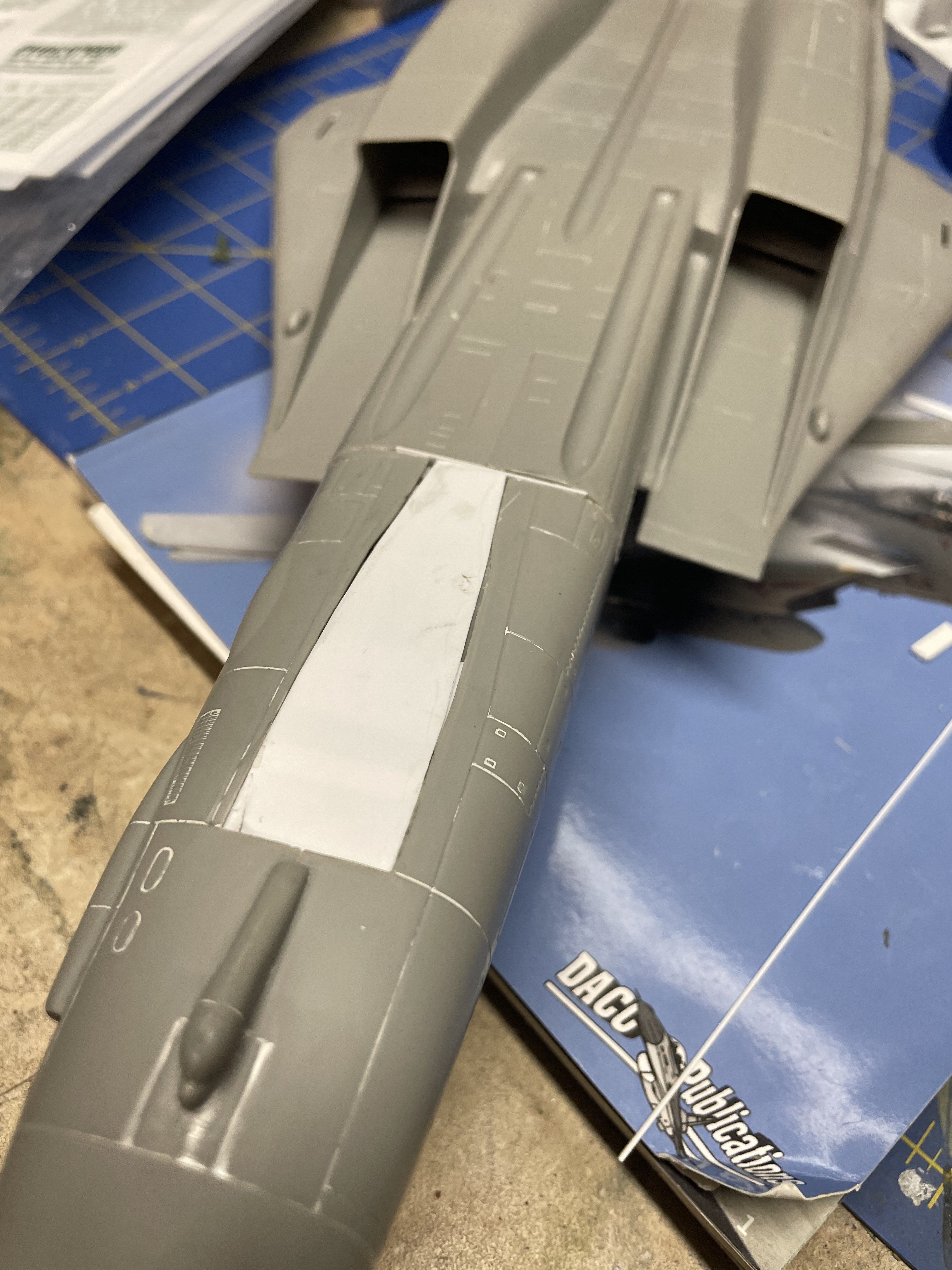

toadwbg Posted January 14 Author Share Posted January 14 Landing gear and their gear doors has always been a thorn of mine. While the main gear doors fit close extremely well, the multi-peice front is a PITA. Solution, cut a new “plate” to patch it up out of sheet styrene. I added some reinforcement ribs underneath Also. I’ll scribe the door edges back. Quote Link to post Share on other sites

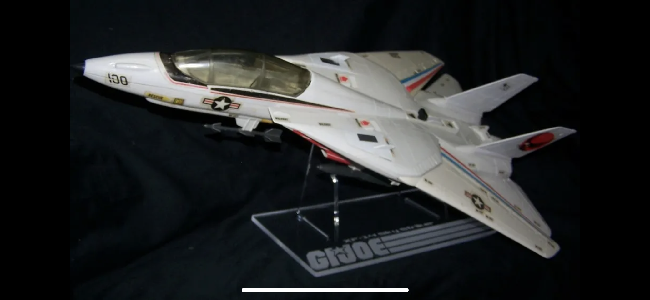

toadwbg Posted January 18 Author Share Posted January 18 Bodywork is almost complete, sorta polishing a turd. Been thinking a lot how I’m going to display the Skystriker since I’m doing it gear-up/in-flight. Saw this in a Joe Facebook group and ordered one for my model display https://www.ebay.com/itm/263705460745?mkcid=16&mkevt=1&mkrid=711-127632-2357-0&ssspo=nBQ99HP0SAi&sssrc=2349624&ssuid=hJCpufZ9R3W&var=563973071269&widget_ver=artemis&media=COPY Quote Link to post Share on other sites

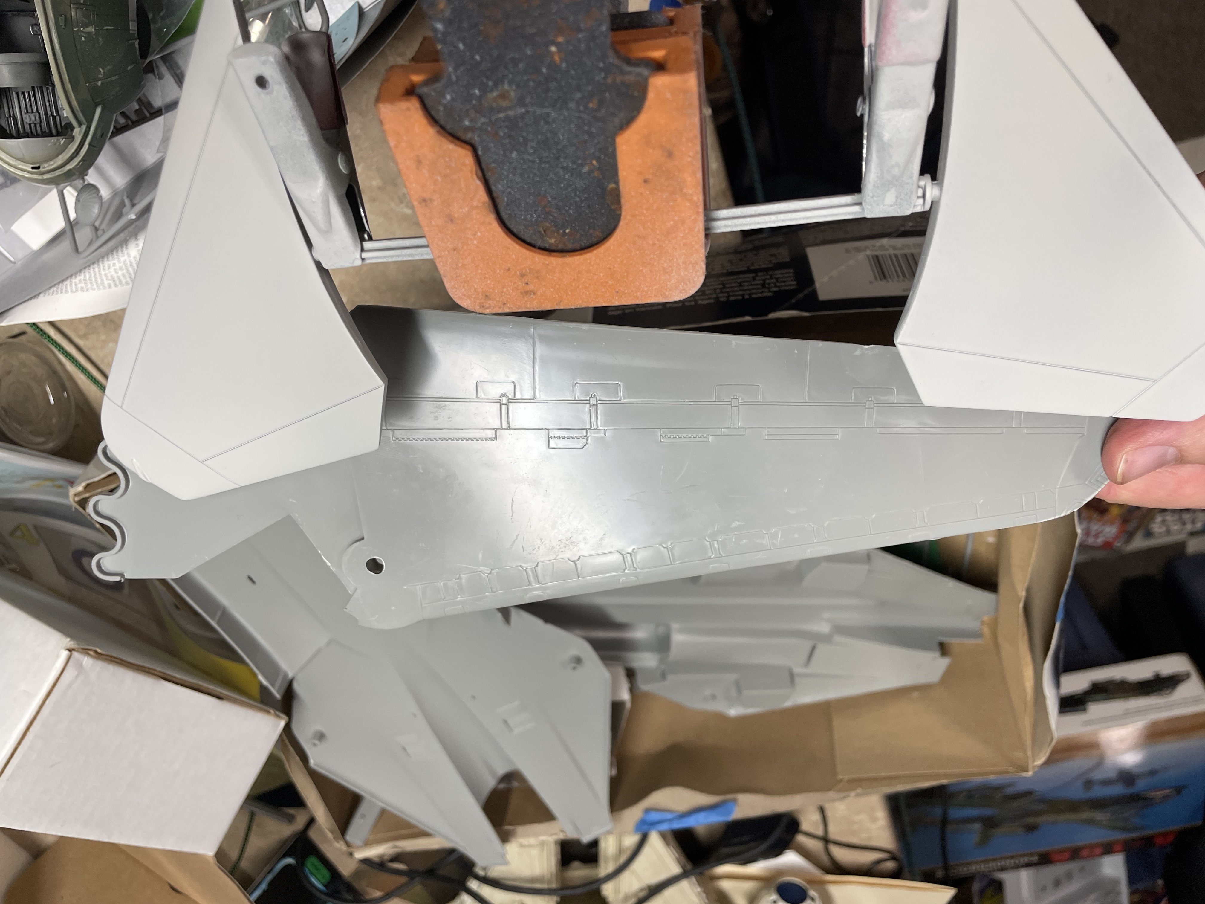

toadwbg Posted January 18 Author Share Posted January 18 Did some test fitting of my wings before I fully commit to zipping up the rear fuselage. You can see in one of the photos where I slotted the wing pivot to enable this. tight, tricky, and sorta like a puzzle, but they can fit in. Quote Link to post Share on other sites

colargol Posted January 20 Share Posted January 20 On 1/18/2023 at 3:38 AM, toadwbg said: Did some test fitting of my wings before I fully commit to zipping up the rear fuselage. You can see in one of the photos where I slotted the wing pivot to enable this. tight, tricky, and sorta like a puzzle, but they can fit in. Hello ! Is it normal that your wings are upside-down ? colargol Quote Link to post Share on other sites
toadwbg Posted January 22 Author Share Posted January 22 (edited) On 1/20/2023 at 11:57 AM, colargol said: Hello ! Is it normal that your wings are upside-down ? colargol Yes, this is a GI Joe Skystriker after all! LOL good catch but it was just an early fit-up and I’ll get hem right before final assembly Edited January 22 by toadwbg Quote Link to post Share on other sites

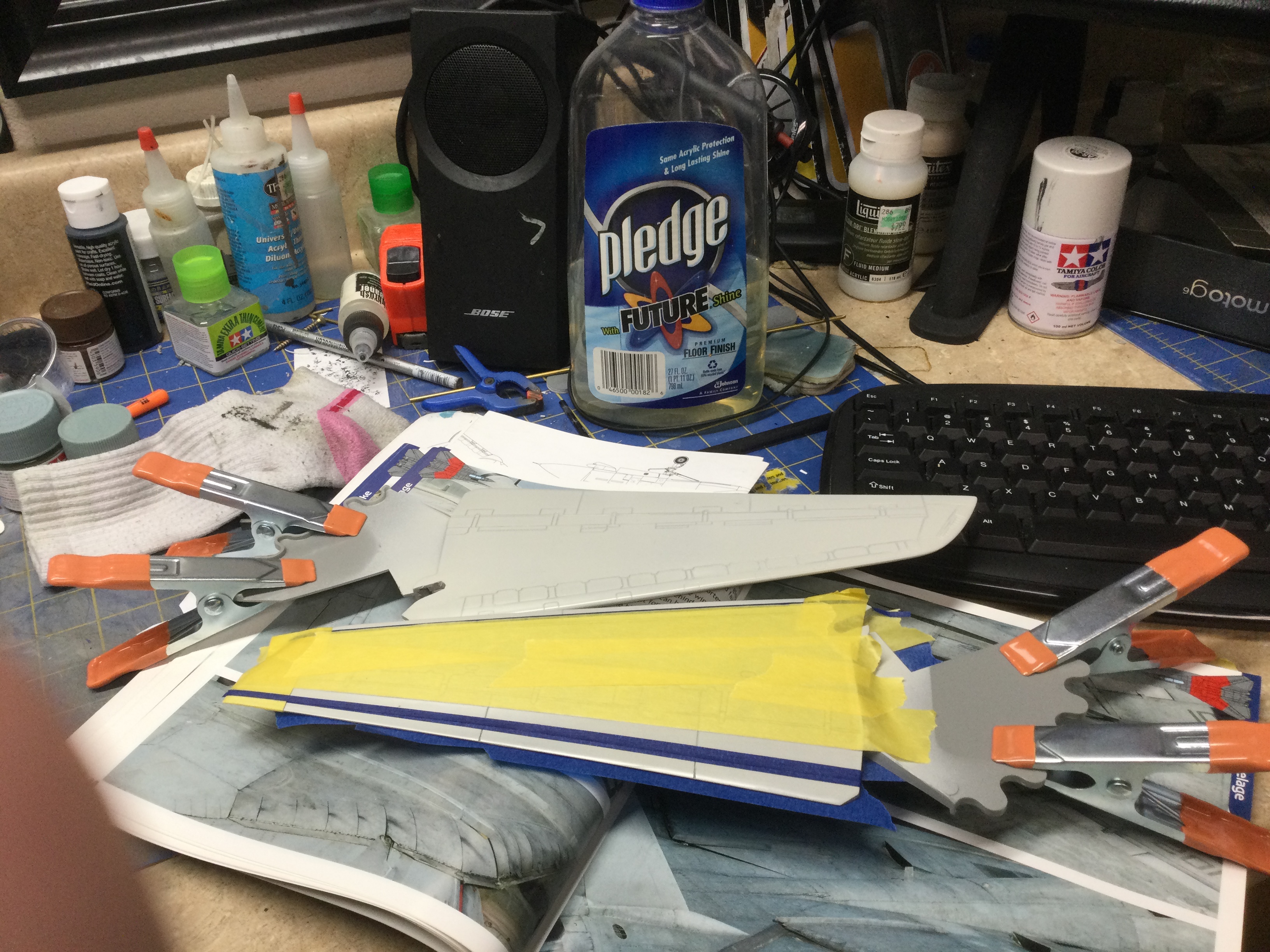

toadwbg Posted January 22 Author Share Posted January 22 (edited) I hand-brushed a coat of Future on the wings prior to masking and painting the Red, White, and Blue stripes. I also masked for the aluminum leading edge. Lots of tape but it will mostly get re-used. Here is a good example of why it’s best to keep the wings separate and treat them as their own sub-assembly. My bottle of Future (Pledge with Future shine) is probably over a decade old! I can’t find a date on it. There is some slight yellowing but I’m not going to sweat it on this off-white/grey Skystriker subject. I looked for a new bottle in local stores and online and it appears this stuff is out of production? Anyone know of a modern substitute? In my approximately ~40 years of modeling, I’ve only owned 2 bottles of Future in 30 of those years since I first heard about it and have used it hundreds of times! It has been bulletproof. I’ve always brushed it on. Only problems I’ve ever had is with it is when it dries too fast in usually drier winter air in the hobby room. I forgot about that and will add a touch of Windex to my brushing bottle which helps with that. Edited January 22 by toadwbg Quote Link to post Share on other sites
crackerjazz Posted January 22 Share Posted January 22 Hi toadwbg, cool build. My 10+yr old Future also shows signs of yelllowing in the bottle but still works great and the yellow tint doesnt show at all whenever I use it. Canopies still end up nice and clear. Future is now called Pledge Floor Care or Pledge Revive It Floor Gloss. Quote Link to post Share on other sites
