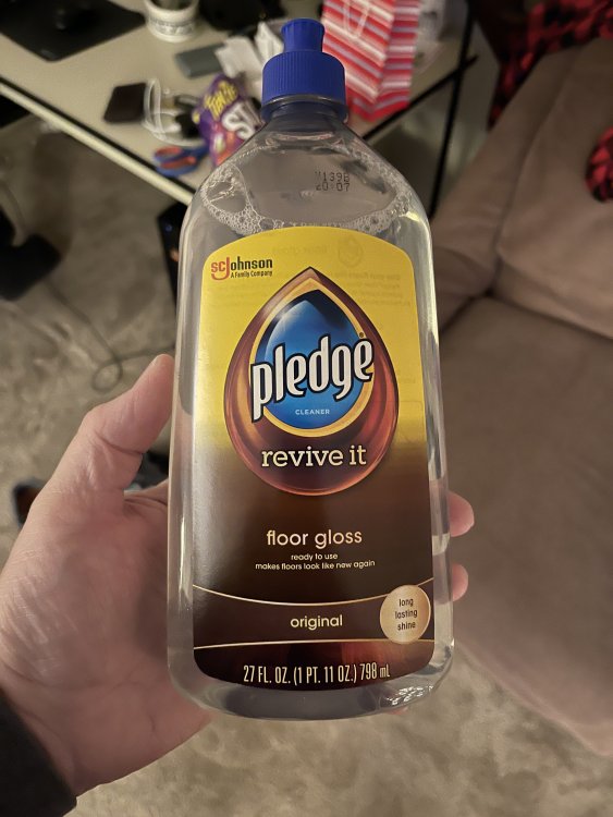

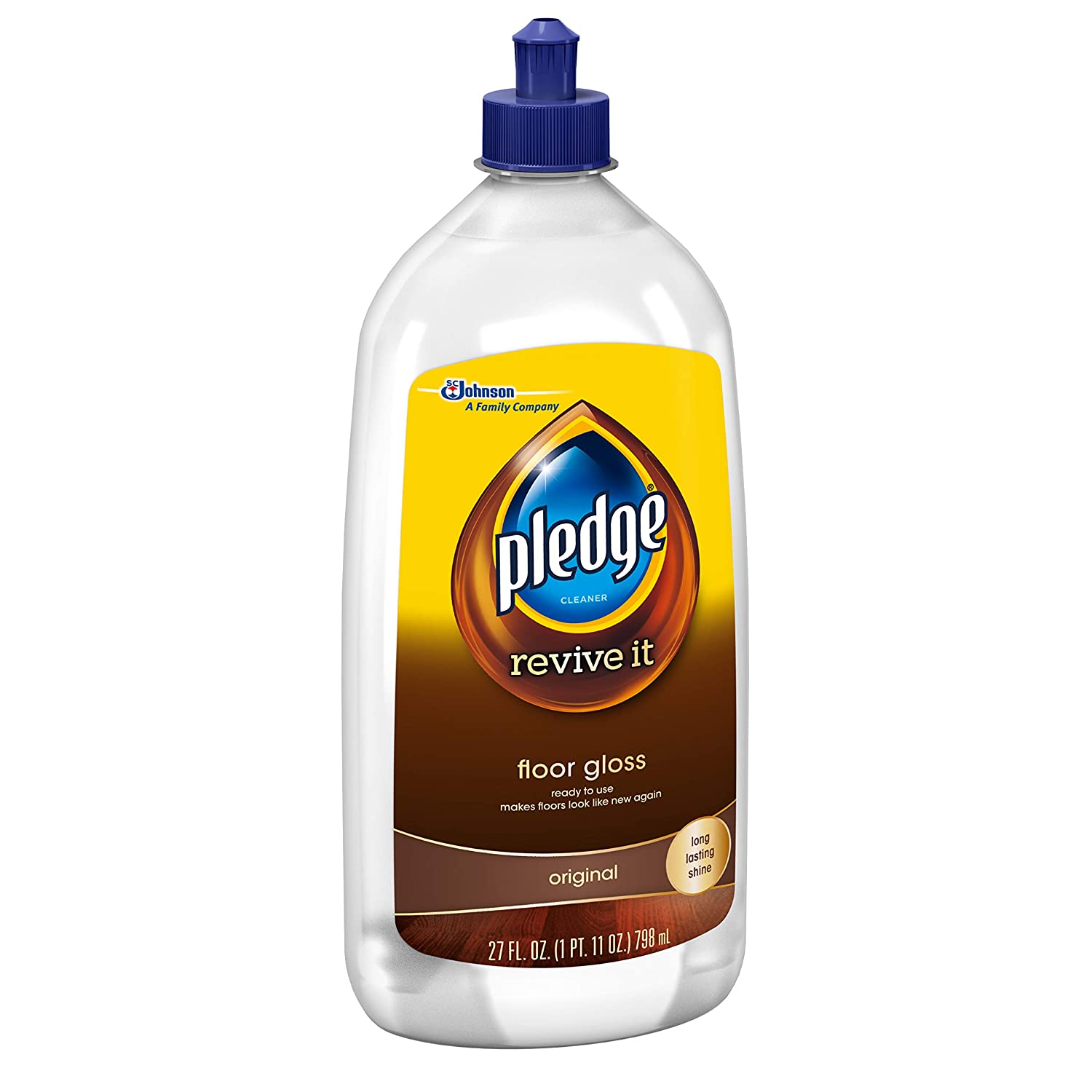

scotthldr Posted January 10 Share Posted January 10 This is what I now use. It’s probably better than Future, although I’ve not tired dipping canopies in it yet. Quote Link to post Share on other sites
habu2 Posted January 10 Share Posted January 10 You can't ask a future question in the present, you must wait until the future to ask your question... Quote Link to post Share on other sites
Kurt H. Posted January 10 Share Posted January 10 (edited) 7 hours ago, scotthldr said: This is what I now use. It’s probably better than Future, although I’ve not tired dipping canopies in it yet. This is the product which was discontinued. It is the final incarnation of what was originally called Future. I have seen some people on youtube use a product called Quick Shine , but it does not seem to be exactly the same, it looks like it is a little thinner and it is milky when applied, but dries clear. Edited January 10 by Kurt H. Quote Link to post Share on other sites
scotthldr Posted January 10 Share Posted January 10 I did wonder with the date, as I thought Future as discontinued years ago. Quote Link to post Share on other sites

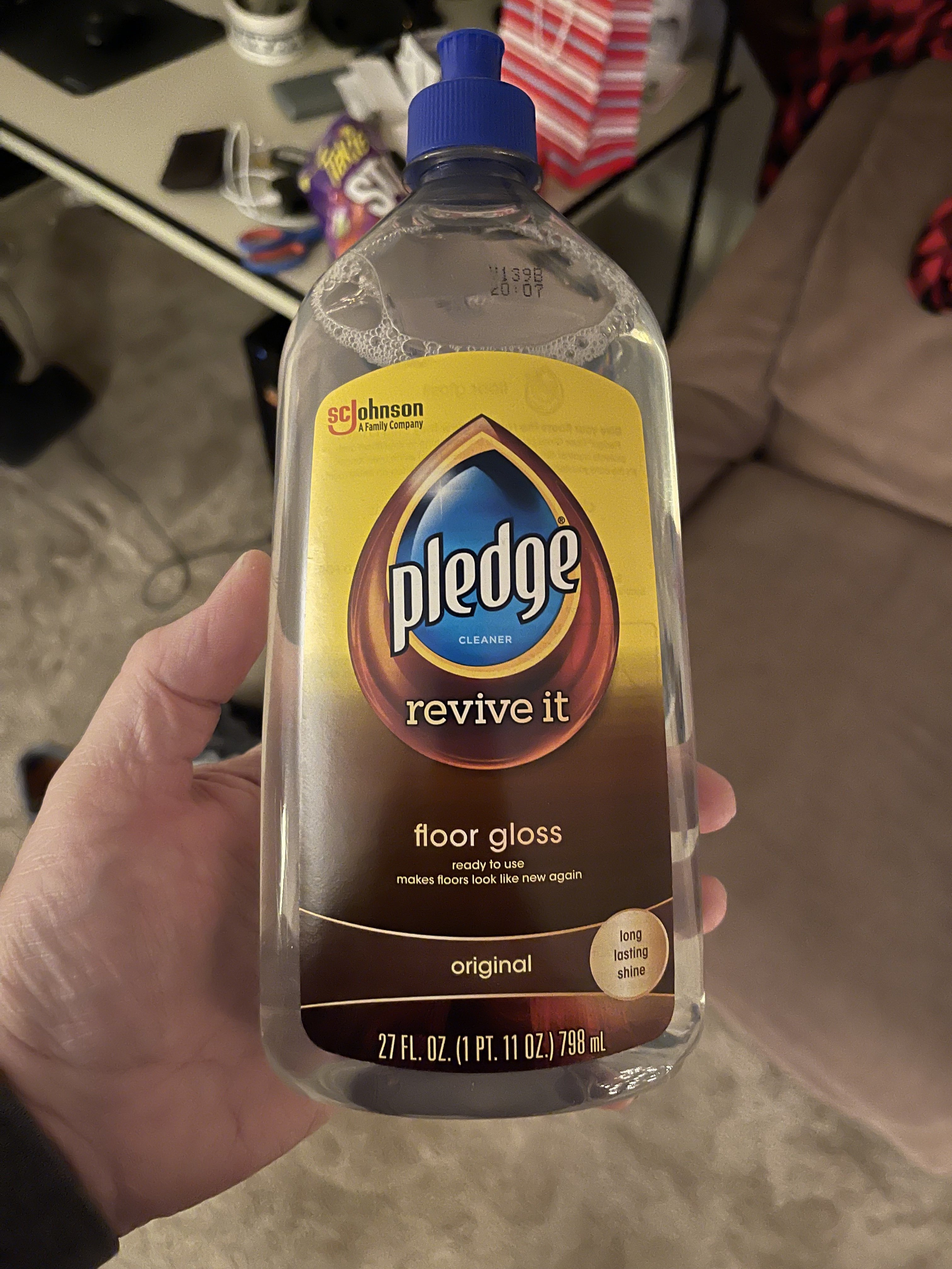

CFster Posted January 20 Share Posted January 20 I found a bottle two weeks ago at a local grocery store here in CT. Quote Link to post Share on other sites

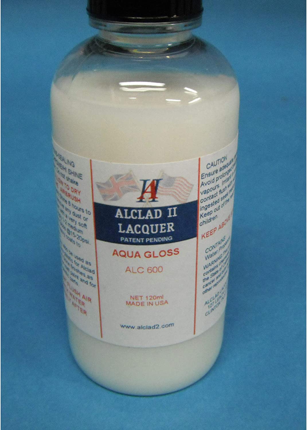

chukw Posted January 22 Share Posted January 22 Future/Pledge is rather unpredictable, but this stuff is gold. Quote Link to post Share on other sites
CFster Posted January 22 Share Posted January 22 1 hour ago, chukw said: Future/Pledge is rather unpredictable, but this stuff is gold. How is it unpredictable? Quote Link to post Share on other sites
chukw Posted January 22 Share Posted January 22 Offhand, I've seen it be a nice gloss- or pebbly, blotchy- even dry lakebed cracks over certain paints. Quote Link to post Share on other sites
CFster Posted January 22 Share Posted January 22 17 minutes ago, chukw said: Offhand, I've seen it be a nice gloss- or pebbly, blotchy- even dry lakebed cracks over certain paints. Well I suppose just like with any other chemical, there are people who don’t know how to apply them… Quote Link to post Share on other sites
chukw Posted January 24 Share Posted January 24 Shots fired! Why so salty? I see you have 4 posts here. I'm simply offering a different and, imho, better option. Surely there could be even better? I still keep a "travel bottle" of Future on my desk top, for glossing instrument dials and other quick, brushable options. Open minds beat closed doors. Quote Link to post Share on other sites
CFster Posted January 24 Share Posted January 24 (edited) Better? Because I just joined your little club doesn’t mean my opinion isn’t valid. For example, I have enough experience to know that if you’re getting cracking, then you didn’t wait to let your base coat cure. Edited January 24 by CFster Quote Link to post Share on other sites

Hooker169 Posted February 10 Share Posted February 10 (edited) @pminerI’m also becoming concerned since I’m down to my last few ounces of “Pledge with Future Shine”. I’ve used it as a gloss coat for decals, as a setting solution and of course dipping canopies since being introduced to it in the early 2000’s here on ARC. While researching possible replacements I came across this post which demonstrates clearly that the formula has changed with each iteration, and not for the better. So maybe it’s time to finally put Future out to pasture once and for all…….. On 3/27/2021 at 12:15 AM, RichardL said: I believe MY2014 was still a good model year for Future. Finally have some extra time to test four different versions. From left to right: Original Future 1993, Original Future 2000, Pledge with Future Shine 2008, Pledge Revive It 2021. I got four plastic spoons sprayed with two coats of Tamiya XF-1 Flat Black, let dry for 24 hours, then sprayed with three coats of Future straight from each bottle: light first coat, wait 5 minutes, medium second coat, wait 5 minutes, wet final coat. All sprayed from the same day. The original Future from 1993 gives the smoothest finish and the best gloss, even only after two coats. The Future from 2000 is roughly the same as the original. Pledge with Future Shine from 2008 shows some degradation as it is not as glossy as the the two original, but not too bad. The current Pledge Revive It is noticeably thicker than the others, so I had to bump up my air pressure by 2 psi to spray it straight from the bottle. It dries patchy in a few spots to a more satin finish. The finish is not as smooth as the other three. Edited February 10 by Hooker169 Can’t spell Quote Link to post Share on other sites
