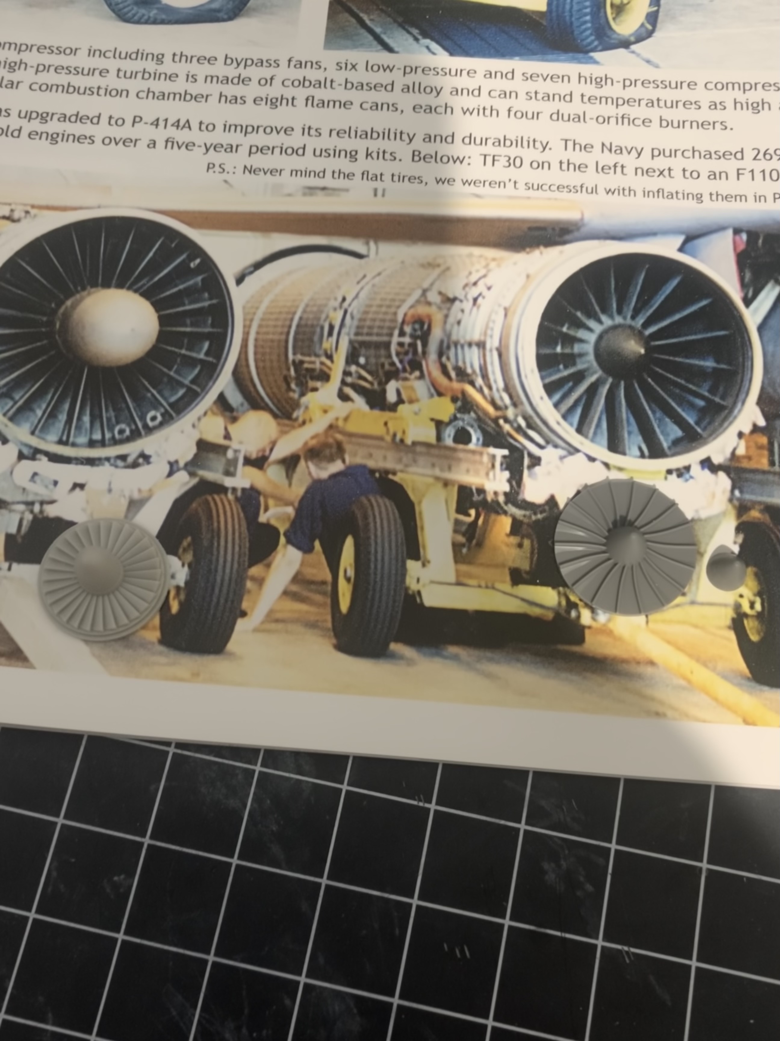

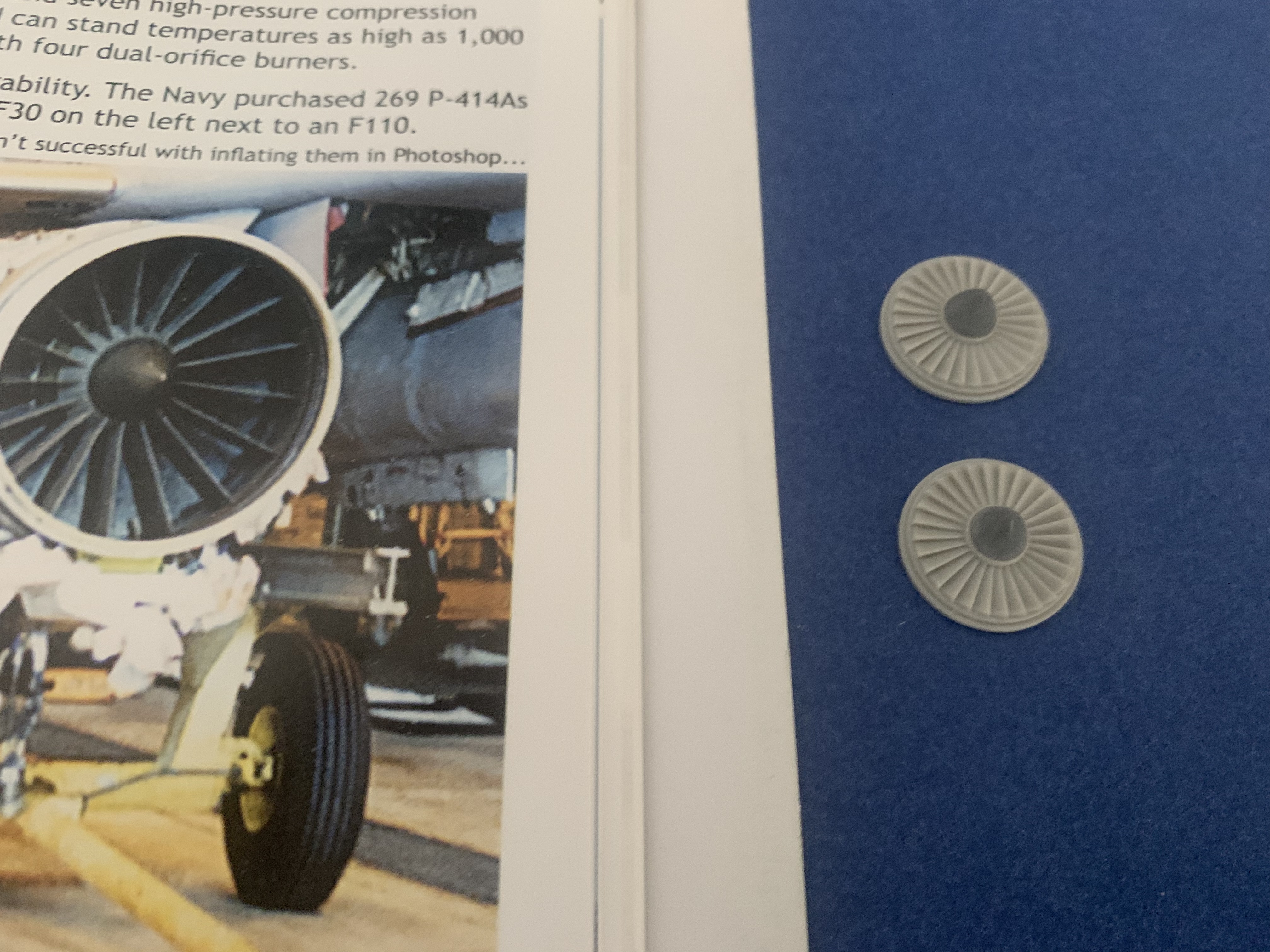

The only issue I know of the the front of the engines as shown below.
My fix was to use a spare part from a 1/32 hornet, and I think it’s not to bad!

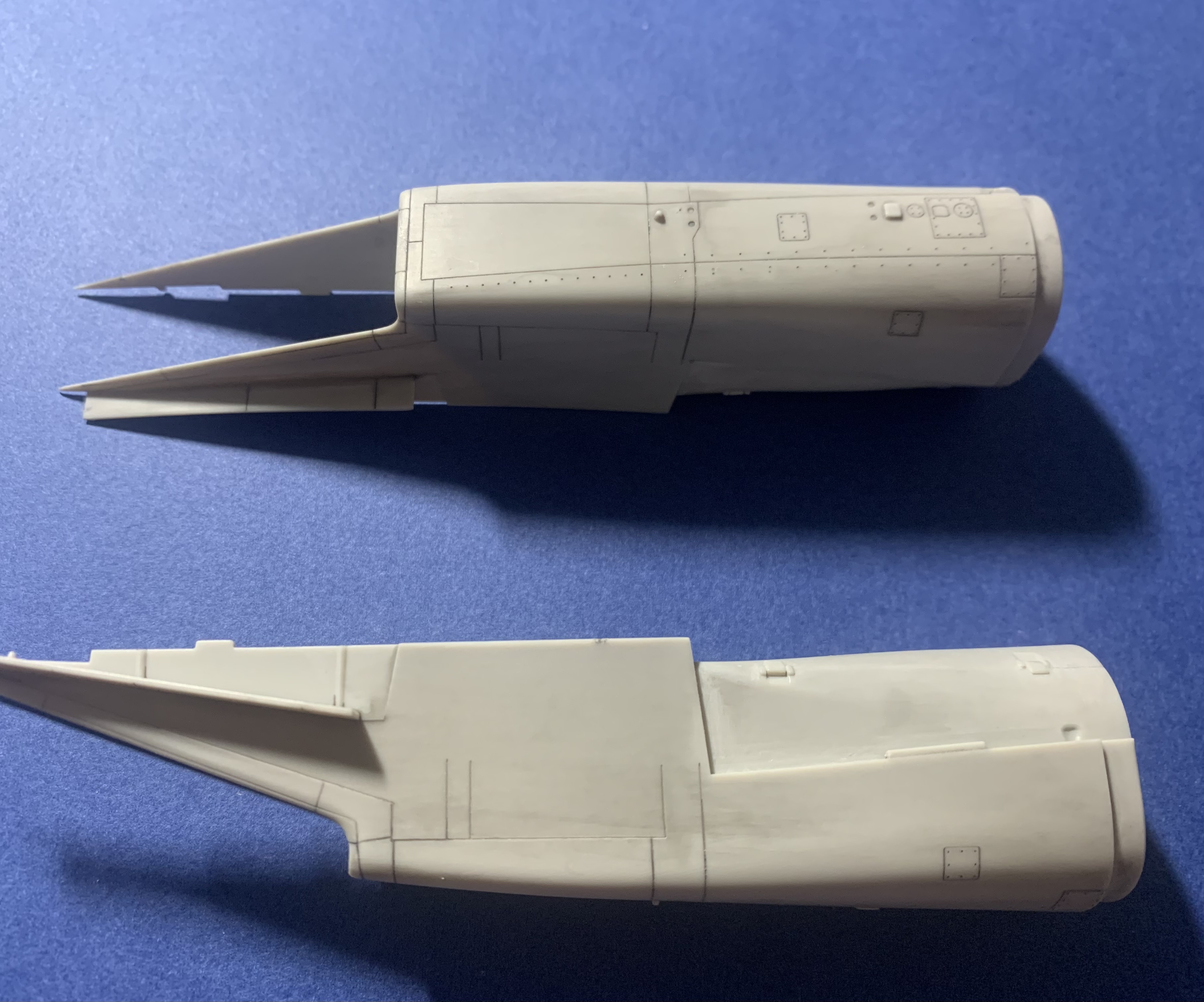

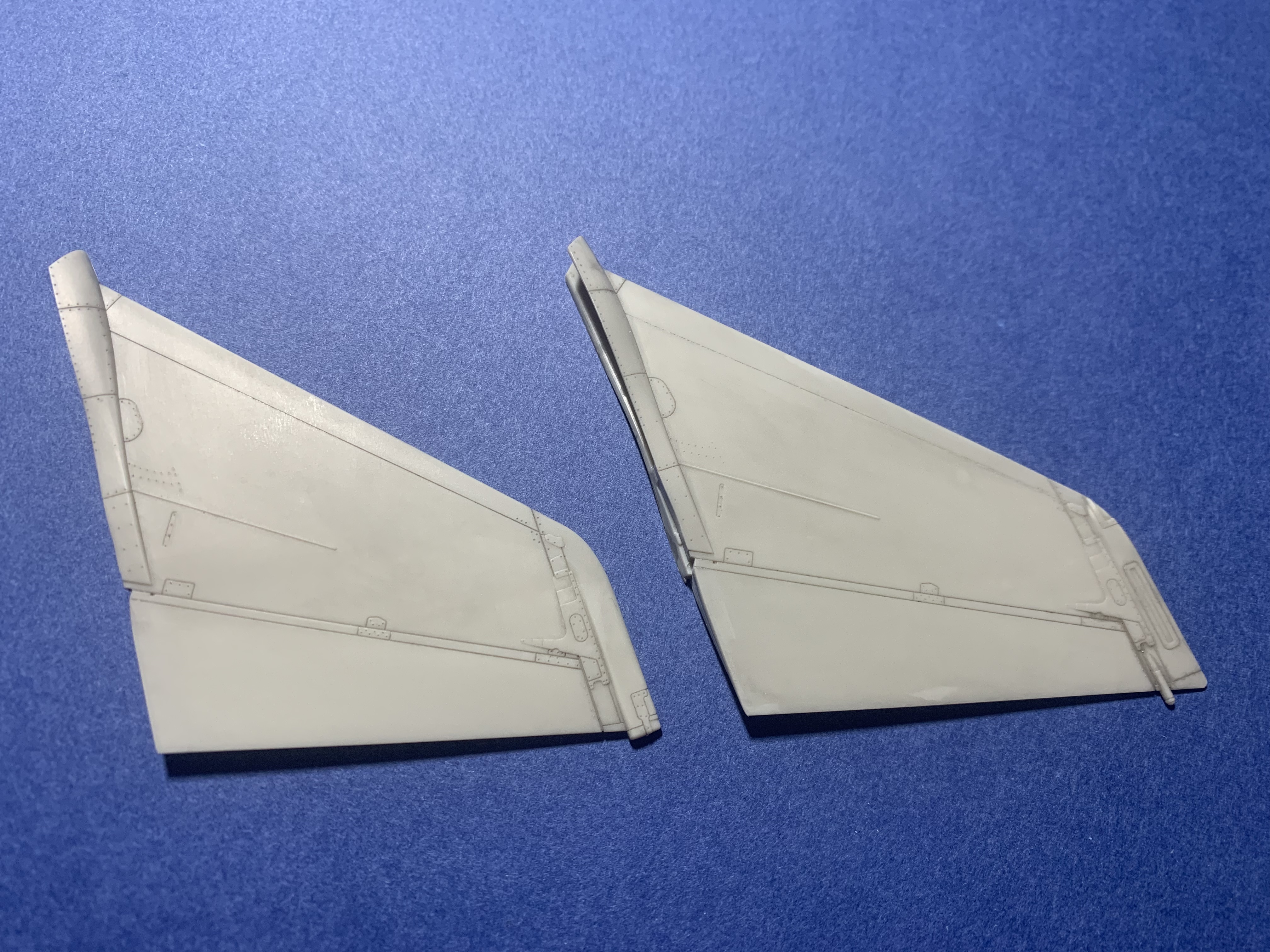

I’d also got going on the intakes and some othe bits and pieces whilst waiting for the cockpit to arrive. But as it’s been stated before, this kit does just fall together, it’s an amazing kit, and so far, a very enjoyable build!
The only issue so far with the kit was one side of the intakes ere missing some panel lines, a simple rescribing job, and I was happy with the results!
