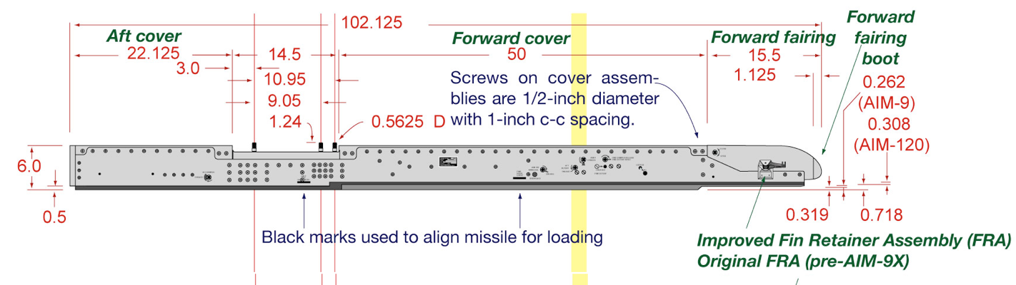

kernsc Posted February 1 Share Posted February 1 (edited) Hope you don't mind if I pile on to the rail discussion. I'm building the Hasegawa 1/48 F-16C Block 30 but want to update to an ANG aircraft operating during OIF, so I need the LAU-129 rails. It looks like the best option is the Hasegawa Weapons Set E, but those aren't readily available in the US right now (same with Kopecky) so I'm leaning towards either the Eduard IRIS-T missile set, which includes a pair of LAU-129 rails, or, per above, the Flying Leathernecks LAU-127E/A as a "good enough" option. I'm tempted to rob my Tamiya CJ kit, but the build I have in mind for that kit will use all four LAU-129s. Any other options I should consider or general advice on offer? Edited February 1 by kernsc Quote Link to post Share on other sites
mrvark Posted February 1 Share Posted February 1 49 minutes ago, kernsc said: Hope you don't mind if I pile on to the rail discussion. Any other options I should consider or general advice on offer? The LAU-127 (F/A-18), LAU-128 (F-15) & LAU-129 (F-16) are very similar to each other, the main differences being the bolt patterns, the recess on the LAU-129 where it attaches to the F-16 wingtips and pylons, and the bulge at the back of the LAU-127 for the N2 cooling bottle for USN AIM-9Ms. Since the bolt pattern won't be very noticeable in 1:48 scale, I think I'd go with the LAU-128, since neither the F-15 or F-16 rails use the N2 bottle (USAF AIM-9Ms use an internal Argon bottle for seeker cooling). Quote Link to post Share on other sites
