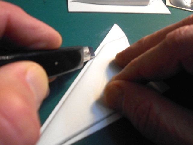

I'll start cutting out the larger parts, Fuselage, Wings and leave the NLG and MLG till a bit later ...
... just score and bend ...
... so far, pretty easy ... now I just need to sand off the extra thickness.

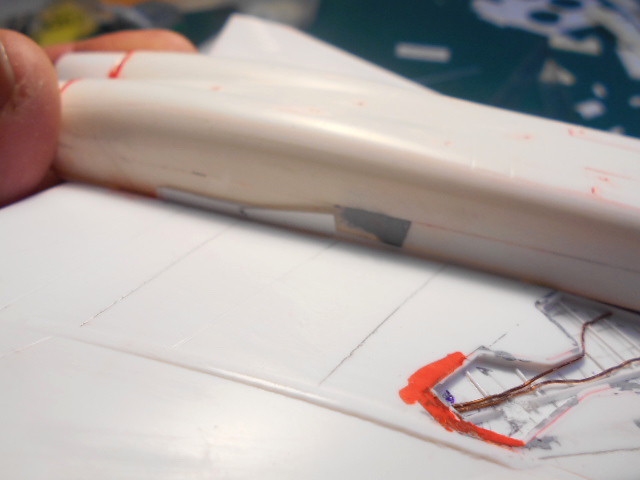

I want the model to have its landing gear deployed, so I need to cut out the doors ... drill some holes and saw it out by connecting those 'dots' ...
The MLG bay part will get some detailing but first I'll need to file the opening so it'll fit.
.. test fit, file, test fit, file ...

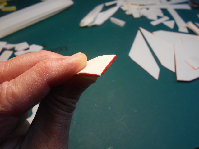

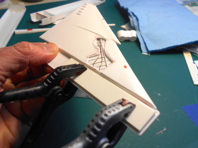

The wings' trailing edge won't sand down more than this, so I'll glue 'em together and sand them to a nice knife-edge ... after installing the MLG bays.
The ruff cut  ... lots o' filing to come     ;^ D

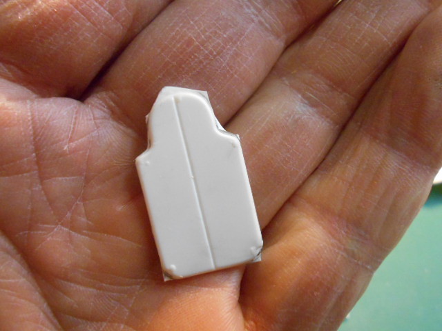

I'll hafta sand down this MLG bay part by half to fit inside that really thin wing. I've already cleaned up the cut    ;^ D

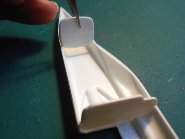

This is gonna be an image heavy post ... this being my 1st Vacuform build, I'm making a lotta mistakes and I wanna show 'em to y'all. Please, feel free to make suggestions and comments on what to look out for.

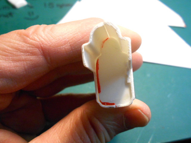

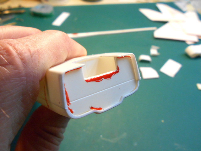

An interior view of the  cockpit section, the fwd former is too big ...
... an end view ... that's quite a gap ...
Yes, the instructions say to split the formers apart, but I didn't understand the 'Why" ... now I do ...
I cut the fwd former in half and filed it down by about 2 mm ...
The aft former was already glued in so I had to file it down in situ ...
... ah-h-h-h, that's much better!
The result ...

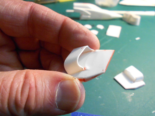

The MLG bay needs a lot of shimming. I like to fill the gaps with styrene scraps and will trim after they dry.

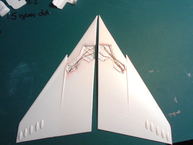

The wing undersides with some detailing in the MLG bays. I still need to do some fine tuning like filler putty and still more sanding.

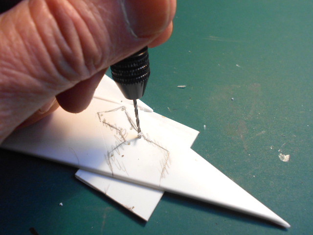

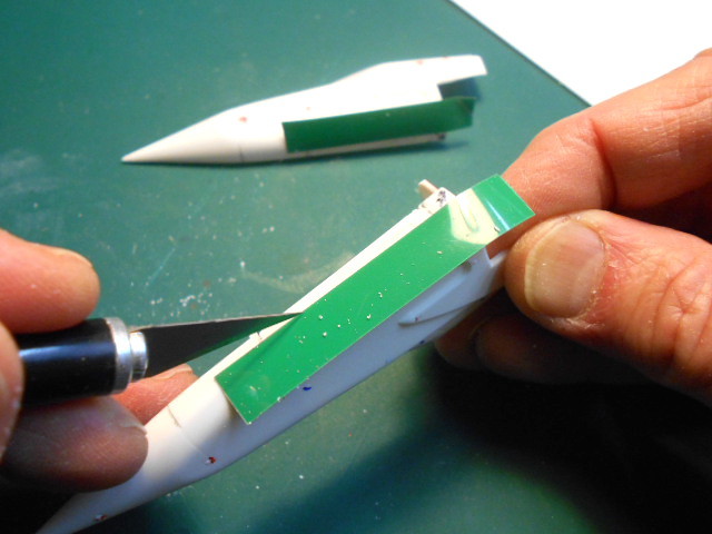

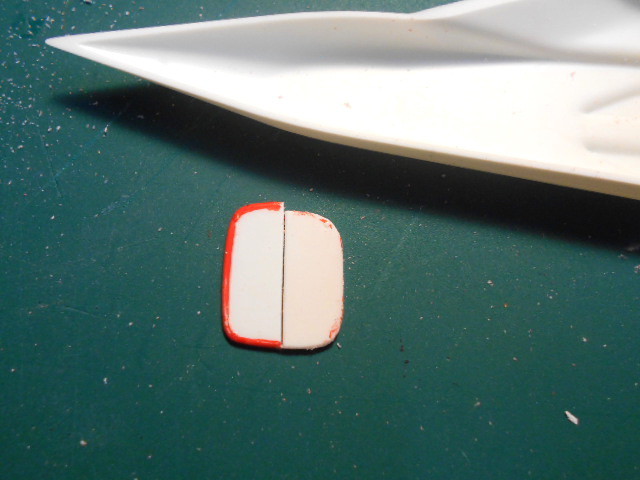

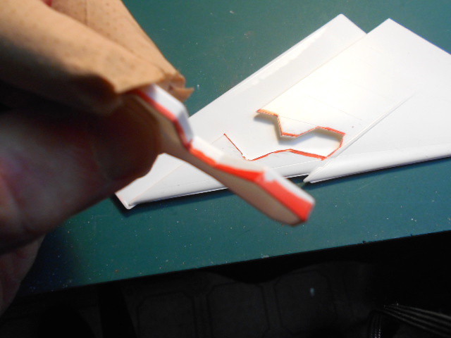

To cut out the NLG door, I used a bit of Dymo tape as a guide and followed the scribed lines on the kit
I sanded off too much of the Nose Gear Bay and needed to shim it. I used .040" scrap styrene.
I also added a thick shim to the inside surface of the MLG bay to add some thickness to the Wing when it gets assembled.

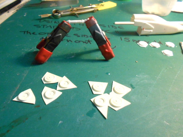

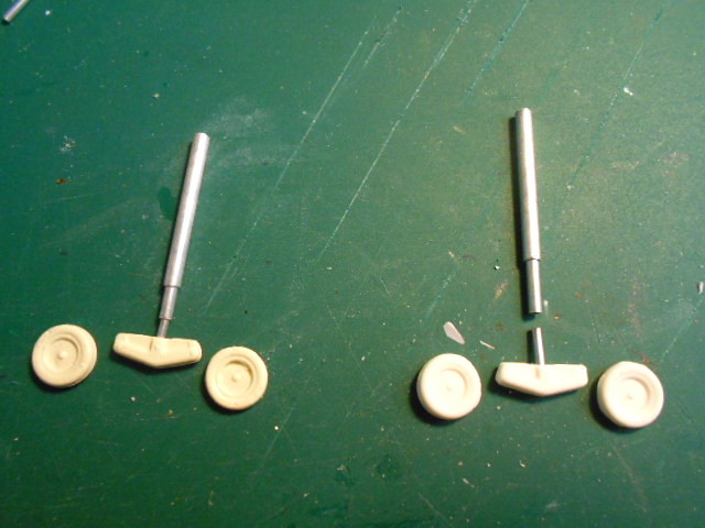

On to the Landing Gear ... the Nose Gear strut is in clamps in the background and the Wheels are separated ready to get sanded down ...
I won't use the kit's parts but will rebuild the MLG with Aluminum tubing. I'm using 3 different diameters of it.
It'll be nice and strong to support the weight and I'll detail it as much as I can ...

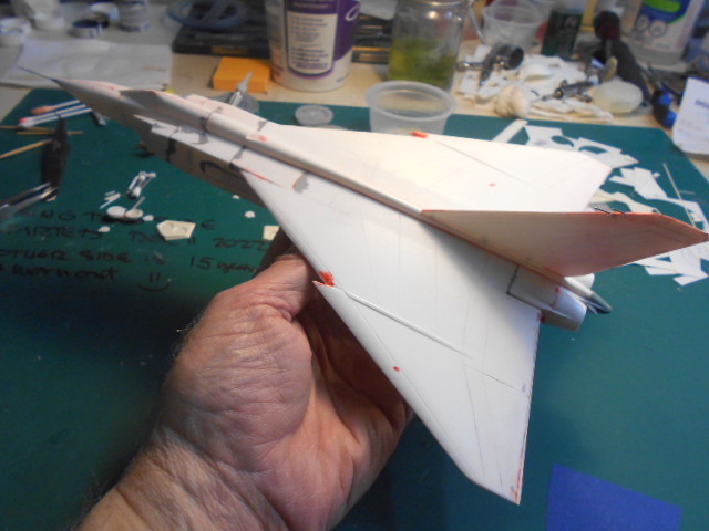

I'll start putting the sub-assemblies together ... still, only about 55% done.

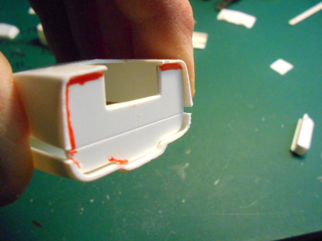

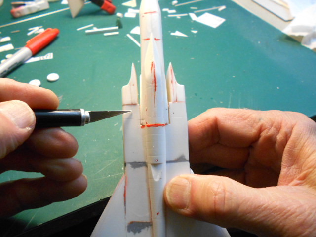

It turns out that I've sanded too much material from EVERY part   ;^ P   and this Aft part was a little too low. I thought of sanding and filing it down to match the Wings but that didn't sit well with me, so, while sleeping, it occurred to me to remove this part and shim it with a strip of .010" styrene ... and it worked a charm!
The Red Sharpie indicates to me, where I need to file or sand ...
Removing it ...
... the shim ...
And that Aft piece now stands a little proud and the Exhaust cones won't sit flush, so I'll sand it smooth ...
With that done, back to the MLG ... the Torque links are ruff cut out.
... and with all the various struts and links. I just need to give them a fine tune sanding and then glue 'em up.

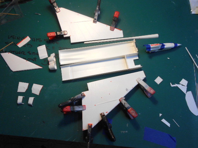

It's almost time to glue up all the subassemblies and get to the final sanding steps ...

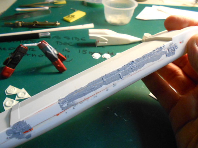

The seams need some attention ... time for some putty ...

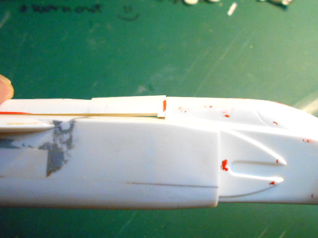

The gap between the lower fwd spine and front section was filled with a piece of scrap styrene ... I guess I sanded off too much ...
Glued it and clamped it down. The step at the joint will get attended to, later ...
Edited by K2Pete

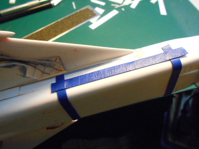

The fwd spine was glued down and this rather large gap was at the aft end ... I thought it was supposed to be flat, the tail needs to be placed on it ...
But after finding some photos, there is a downward bend to this area, just not as pronounced as it is here. I may have to fill a gap between this spine and the vertical tail ... so I glued and clamped it to make sure it didn't spring back up

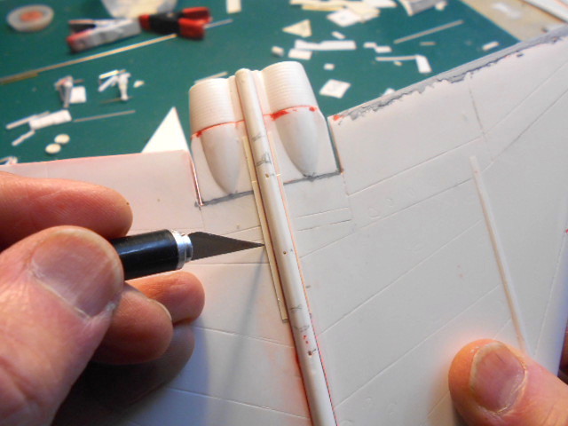

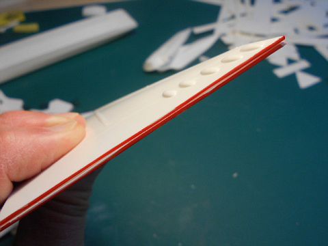

A long gap at the wing root was patched with 0.005" styrene strips
After the aft spine was glued down, there was a gap formed where this plastic bowed up.
I stuck a couple of strips of very thin styrene in between.
As you can tell, I'm doing a lotta sanding and filing ... after gluing the Intake splitters, a small step appeared. It was too big to file, so I'll patch it and sand it.
But there's also gaps between the fuselage and splitters ... those'll get patched too.
... a nice, crude patch. filing and sanding will make 'er look pretty!

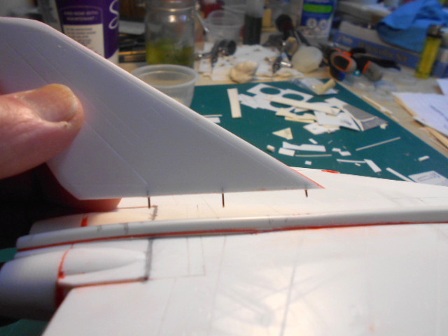

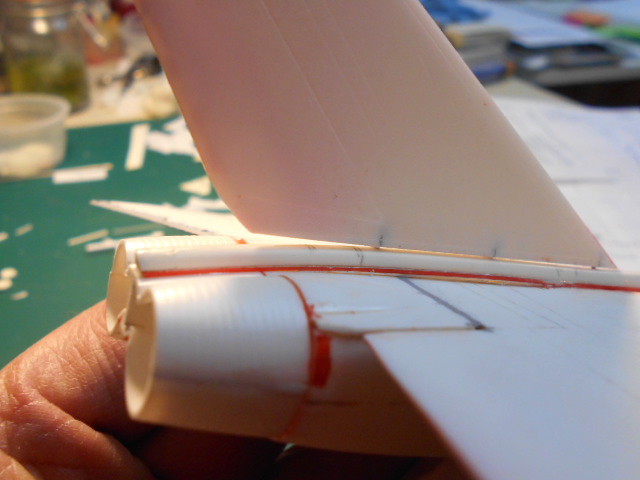

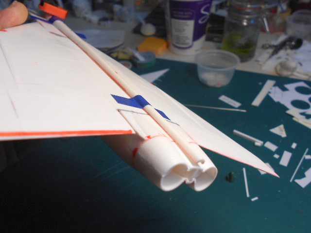

The stinger at the aft end doesn't seem to fit ... at all!
The exhaust cones don't line up ...
And after patching and trimming the spine, I'll attach the tail.
The locator pegs are piano wire
And there will be a gap that'll need to be filled under the vertical tail's aft bit.

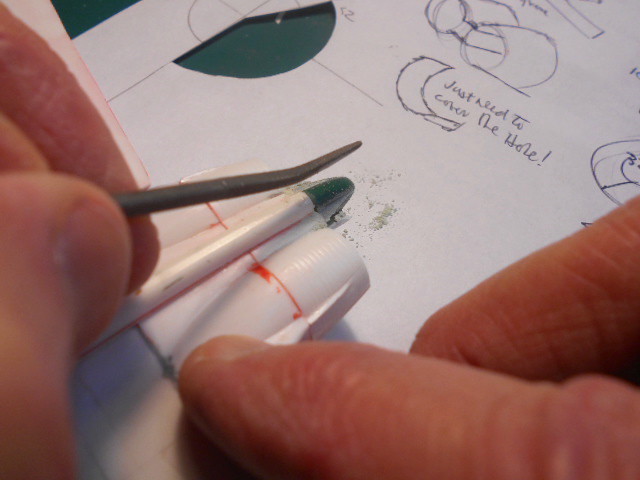

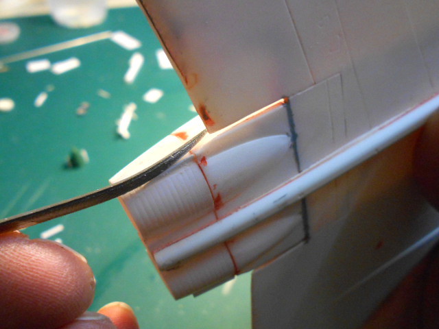

This little fairing had to be done ...
Here's a reference photo of the aft end and you can see this little structure on the exhaust cone.
... I'll just file and shape it.
The Tail didn't seat correctly, so I glued on a patch and will file and sand ... some more!
... file ... test fit ... file ... test fit ... file ...
... and that'll do nicely!

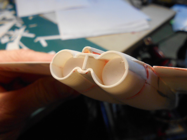

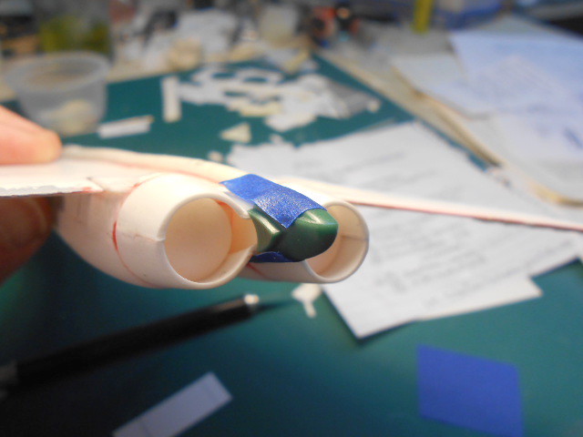

While dry fitting the 'stinger', I realized that the Engine Bay has a HUGE gap between the top and bottom halves.
So, with a small length of 0.010" styrene and a cone calculator, a little patch was made ... it'll block that gap.
The cone calculator suggested the arc cut out you can see in the background.
After the styrene patch on the intakes, I puttied it up and sanded 'em down ...

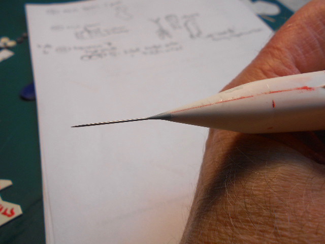

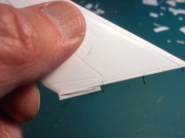

Added the Tail Data probes and the Nose probe. The Nose used a sewing needle and the Tail's were piano wire.
There was a tiny step where the needle met the plastic so I added a bit of styrene and will file it down ...
... and that'll do ... just ... fine!
She's glued up and now, the landing gear get my focus.
This'll get a coat of Flat White as its Primer.
