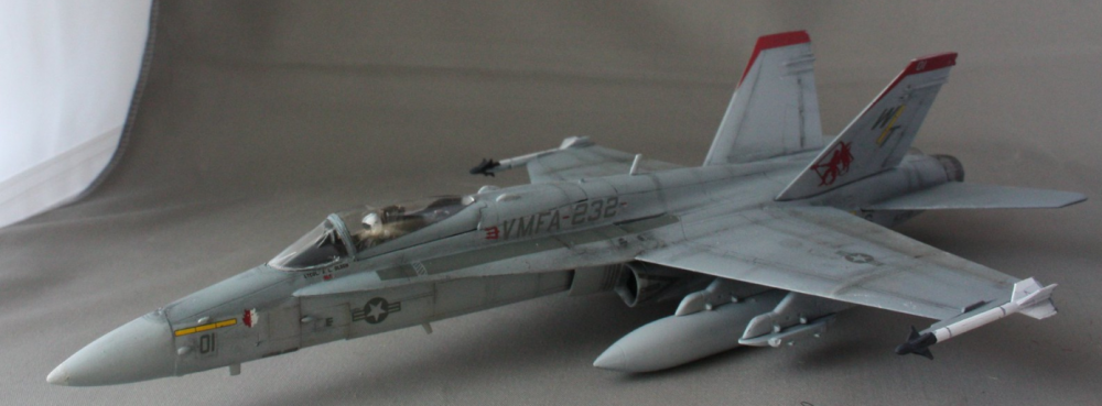

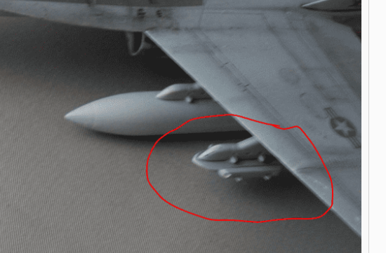

blakeh1 Posted February 1 Share Posted February 1 This was one of the first military jets I had built and I built this right out of the box following the kit instructions without much thought or concern for what might go on there Turns out the kit did not provide a full loadout, so the question is, what would be appropriate for this style pylon? The pylon is glued on pretty securely and taking it off would be a pain Forgive me if I am using the wrong terminology as I do not know much about the actual hardware Quote Link to post Share on other sites
Joe Hegedus Posted February 1 Share Posted February 1 Can't go wrong with a couple of MK-82 low-drag bombs there. Quote Link to post Share on other sites
Crash Test Dummy Posted February 1 Share Posted February 1 A pair of any 500lb bomb can be an option, plain dumb bombs, JDAM or LGB. I'm not sure about heavier weapons. It may be possible, but not common. Quote Link to post Share on other sites
Joe Hegedus Posted February 1 Share Posted February 1 (edited) 2 hours ago, Crash Test Dummy said: A pair of any 500lb bomb can be an option, plain dumb bombs, JDAM or LGB. I'm not sure about heavier weapons. It may be possible, but not common. Depending on the time period of his markings choice, JDAM or LGB may not be options. Plus, the JDAM requires a BRU-55 and the LGB a BRU-33A/A CVER - the kit (that appears to be a Hasegawa 1/72 Hornet) only supplies the BRU-33/A VER although he might be able to fudge that by rotating the bombs away from each other on the rack to at least give a visual impression of how they hang under a CVER. MK-82 is a safe choice that will be correct under pretty much any circumstances in the case of what he showed - just make sure they're the same type of MK-82. Edited February 1 by Joe Hegedus Quote Link to post Share on other sites

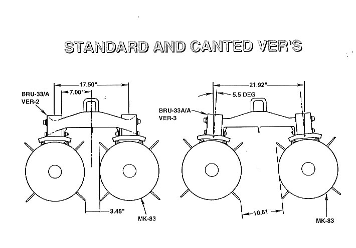

spejic Posted February 2 Share Posted February 2 (edited) Here is the difference between a BRU-33A and a BRU-33A/A: In 1/72 it would be hard to tell the difference in pylon shape, so you can slightly angle the bombs away from each other to get the look of the later VER and thus be ok with putting laser guided bombs on it. Edited February 2 by spejic Quote Link to post Share on other sites
blakeh1 Posted February 2 Author Share Posted February 2 Thanks for all the responses, MK-82 it is Also good to know what pylon type was on there as well as the angles for the bombs I have some of those in one of my Hasegawa sets Quote Link to post Share on other sites
blakeh1 Posted February 2 Author Share Posted February 2 (edited) and I wanted to add, yes it is the Hasegawa 1/72 F-18C kit I am using the Red Devils markings This is apparently the plane it is based on. Although there is nothing on that pylon so I could not get any info there, and the other pylon has missiles instead of the drop tank I did not come across this until after I finished the build otherwise, knowing what I know now, I would have gone for a different configuration with the drop tank and used different launchers Edited February 2 by blakeh1 Quote Link to post Share on other sites

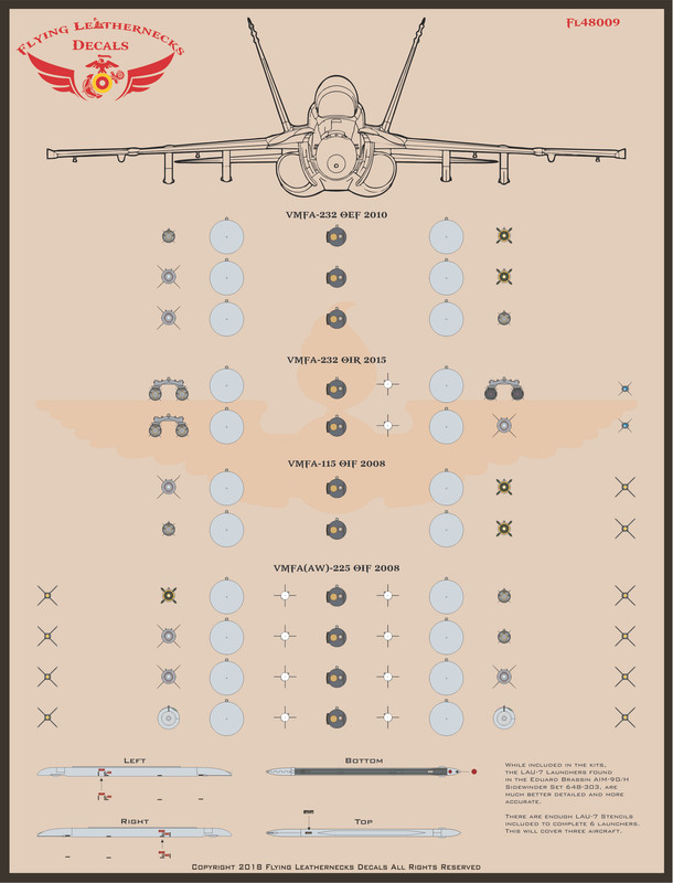

Dave Roof Posted February 21 Share Posted February 21 Not all inclusive, but here are several ordnance configurations you can use on your F/A-18 Hornets from Desert Storm through Inherent Resolve. Quote Link to post Share on other sites
