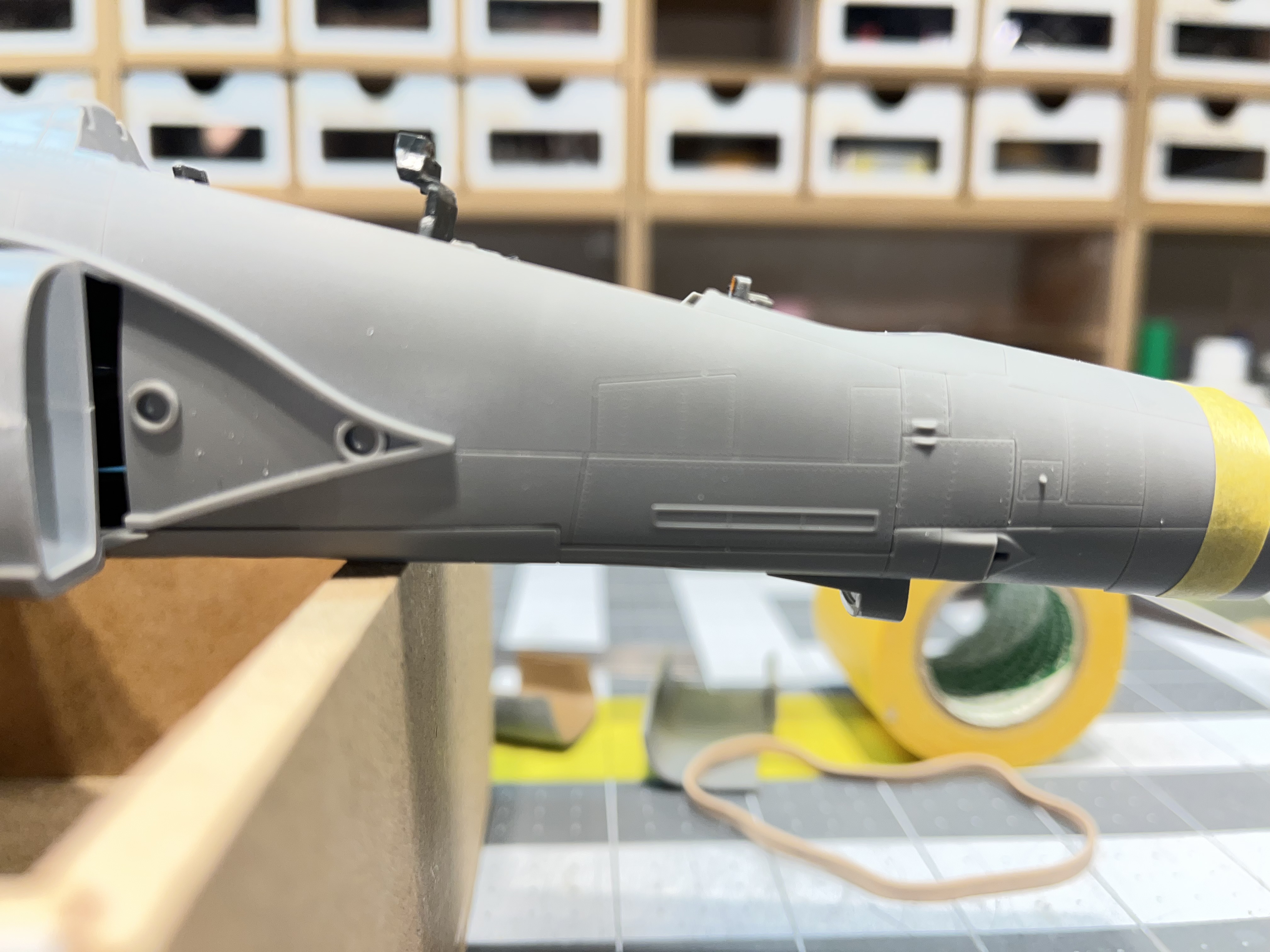

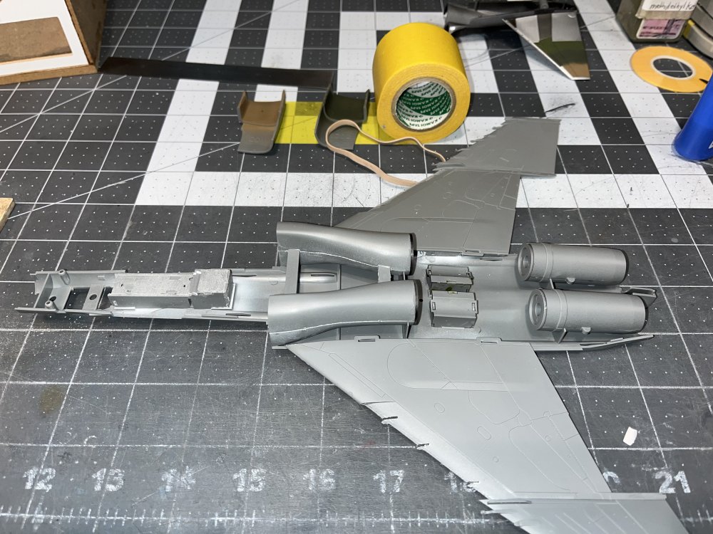

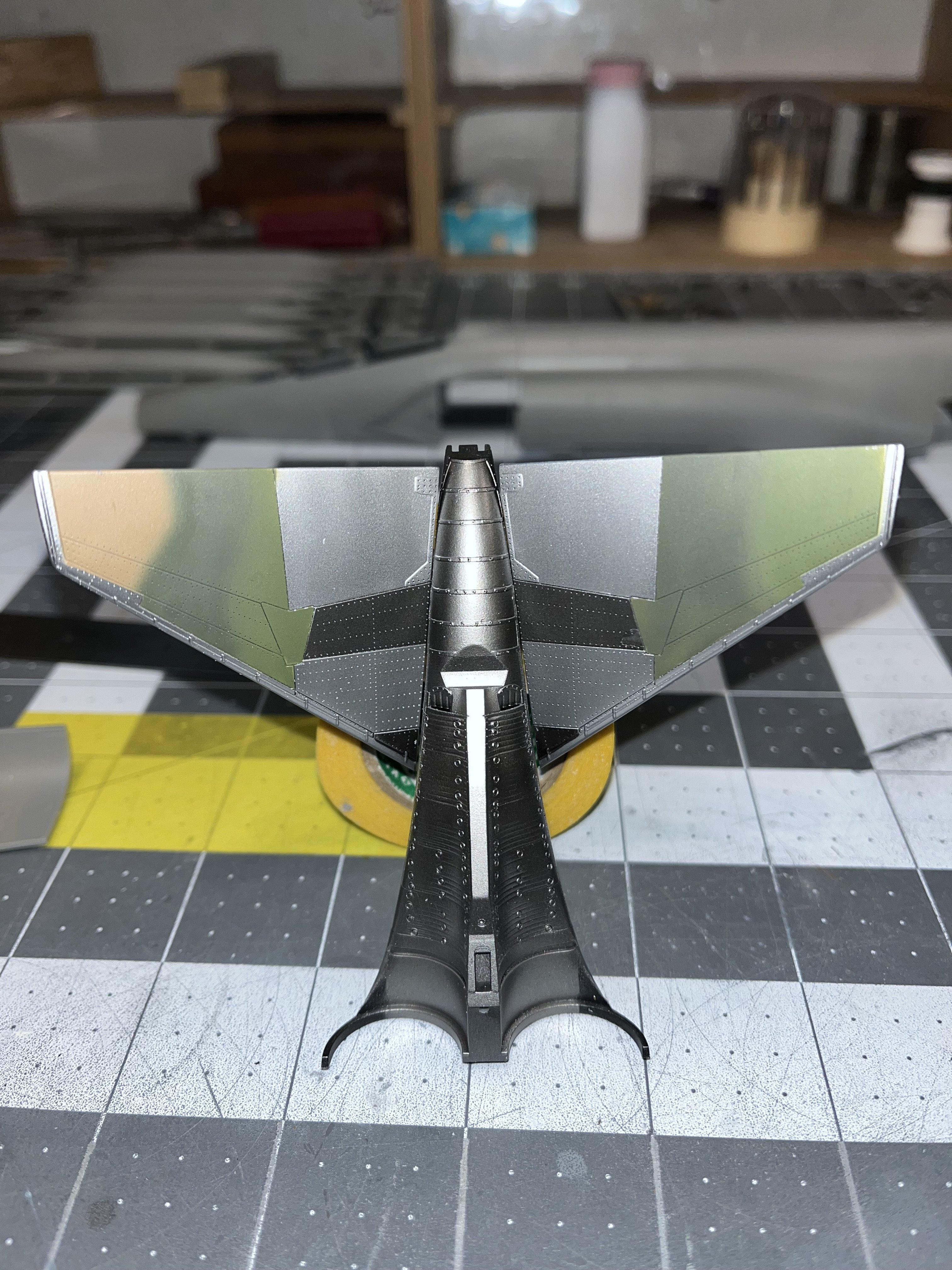

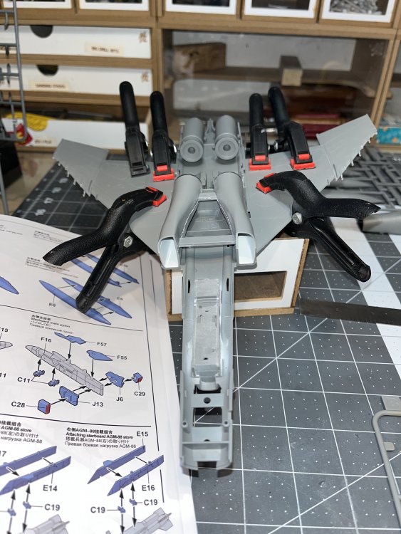

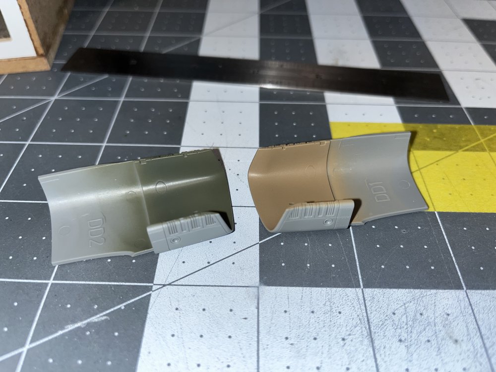

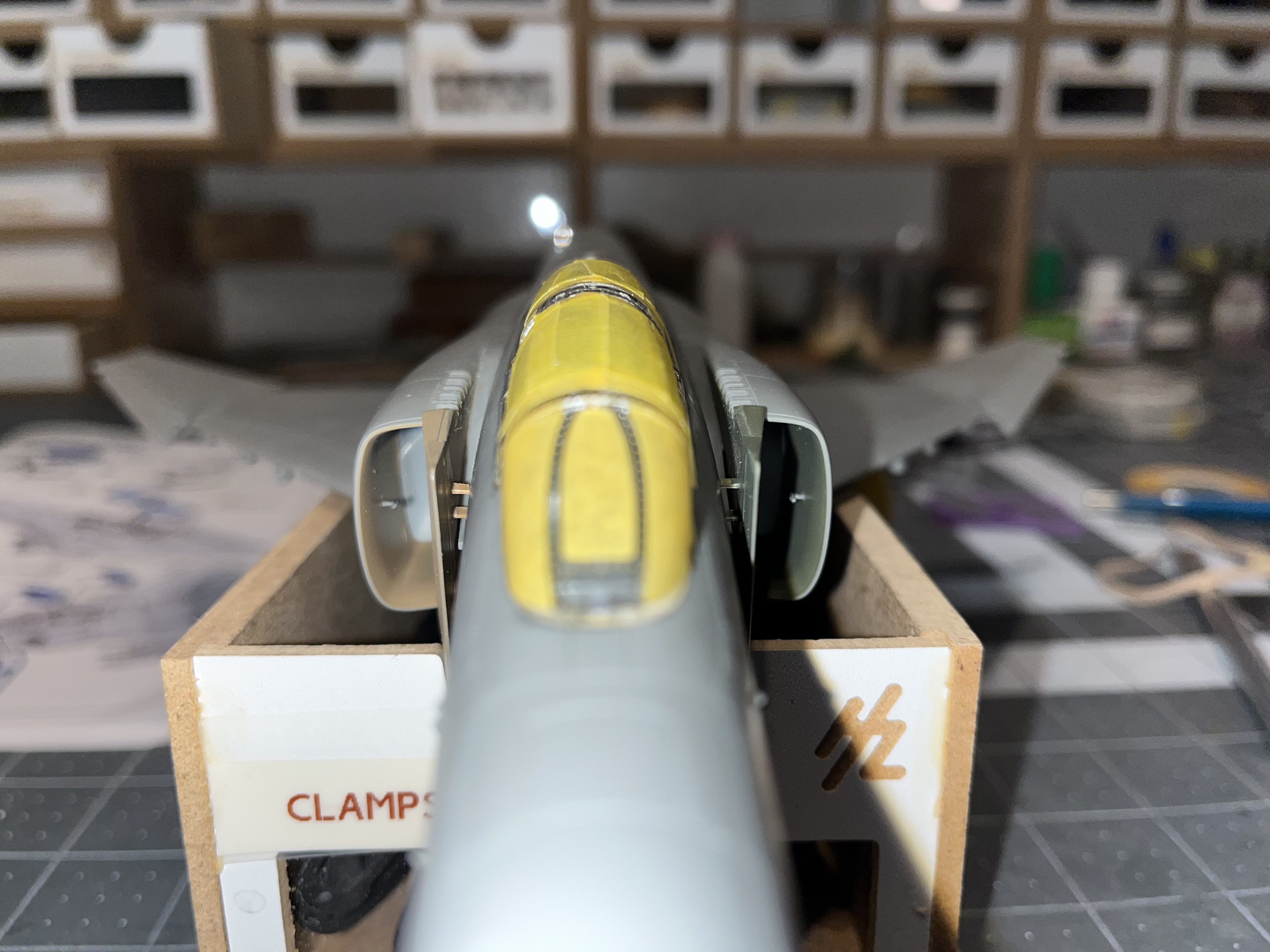

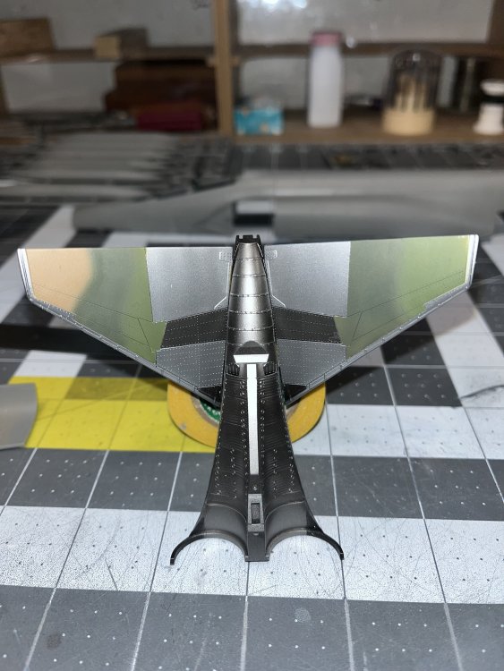

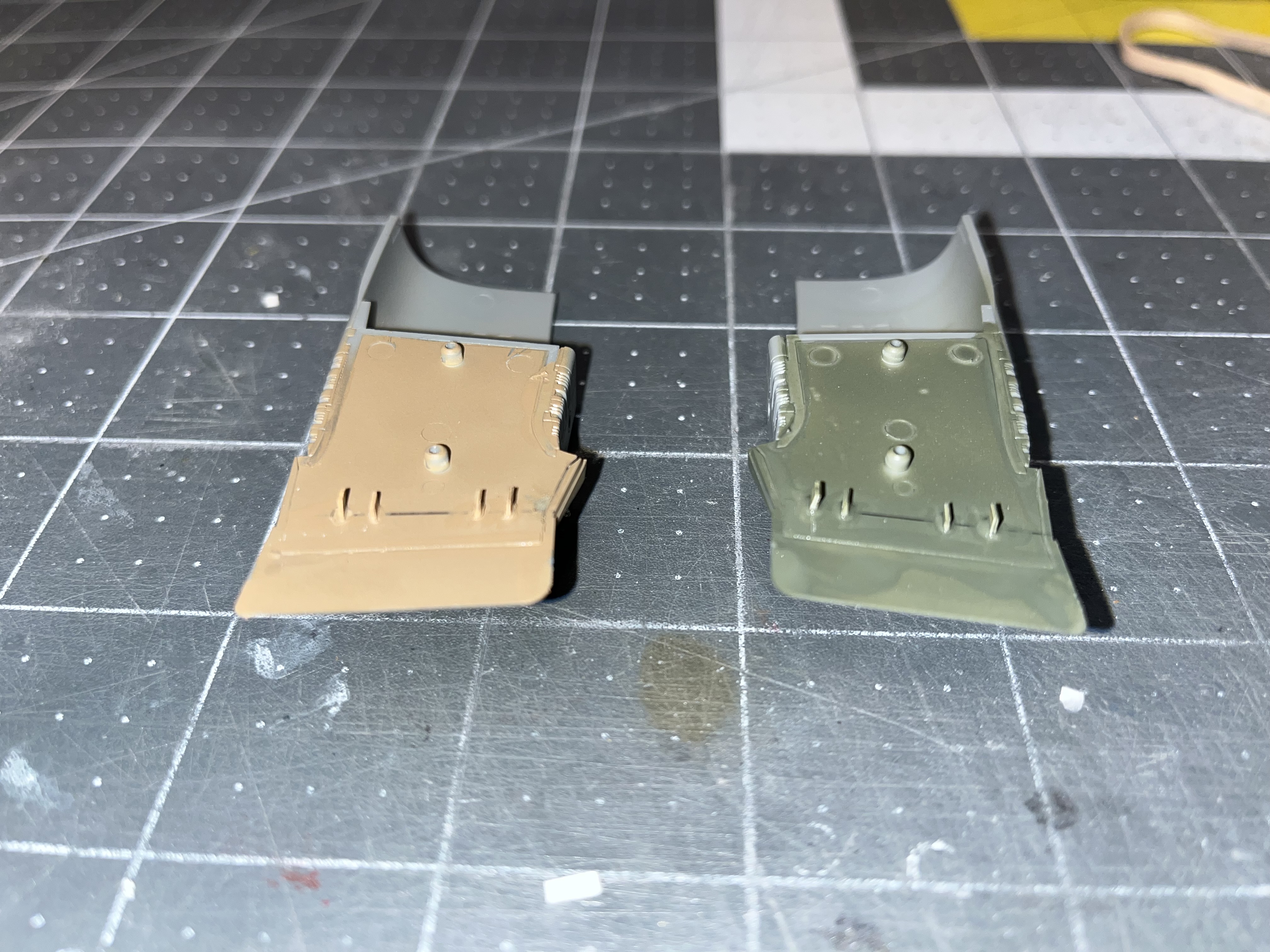

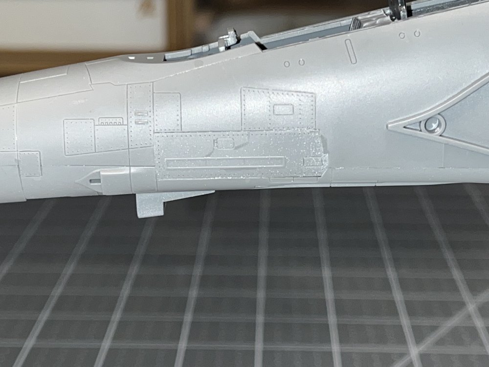

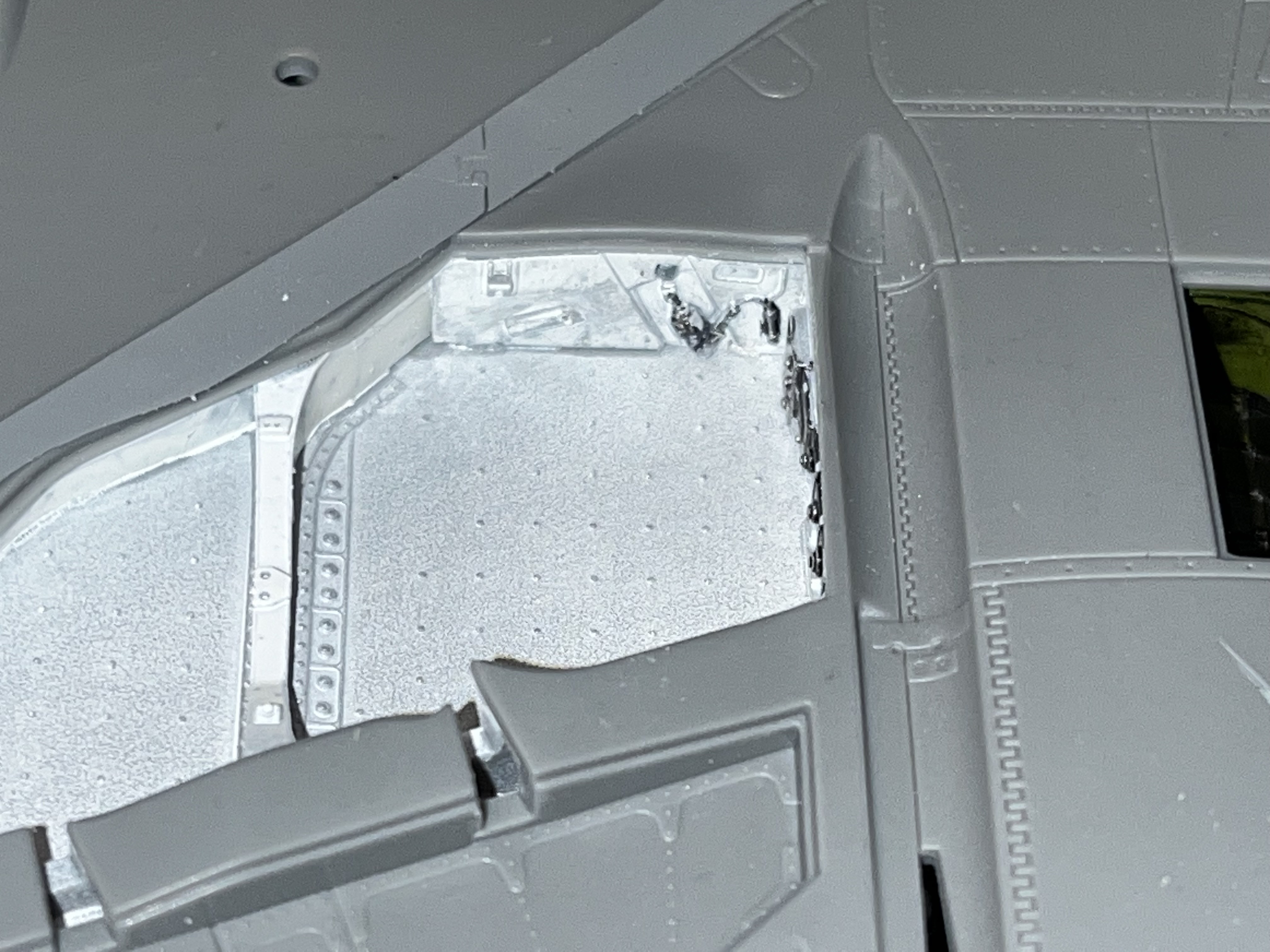

Geoff M Posted February 12 Author Share Posted February 12 (edited) Right now I am able to post pictures and then come back and add some text. The gap Between the upper and lower fuselage disappears after clamping. Clamping the wings made sure there weren't any gaps in the wheel wells. Outer wings fit perfectly. Lower fuselage ready to attach to upper. Nice clean joint after gluing and clamping. Panel in the middle is an panel that can be left off if desired. It fit well. Slight buffing with a scuff pad will make it look fine. The 4 braces added to the intake ramps. Lots of trial and error to get these adjusted correctly. Dry fit of the intakes Dry fit of the intakes. This is usually a trouble spot on phantom kits for me. This look like drop fits. This kit has been a pleasure to build. I am trying to show areas that would normally be troublesome. Thanks for watching. More to come. Edited February 12 by Geoff M Quote Link to post Share on other sites
RichB63 Posted February 12 Share Posted February 12 (edited) Nice update Geoff, kit coming together nicely. I like how you added the braces between the intakes and the fuselage, a curious omission from Meng. I can appreciate what a challenge it was to get them aligned properly! Rich Edited February 12 by RichB63 Quote Link to post Share on other sites

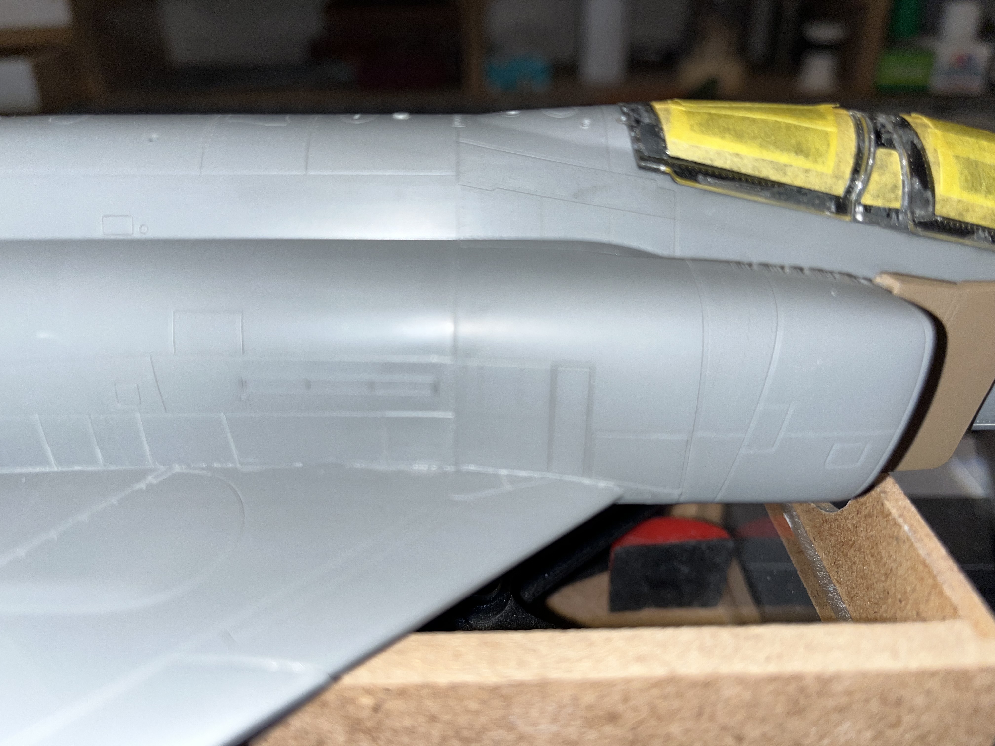

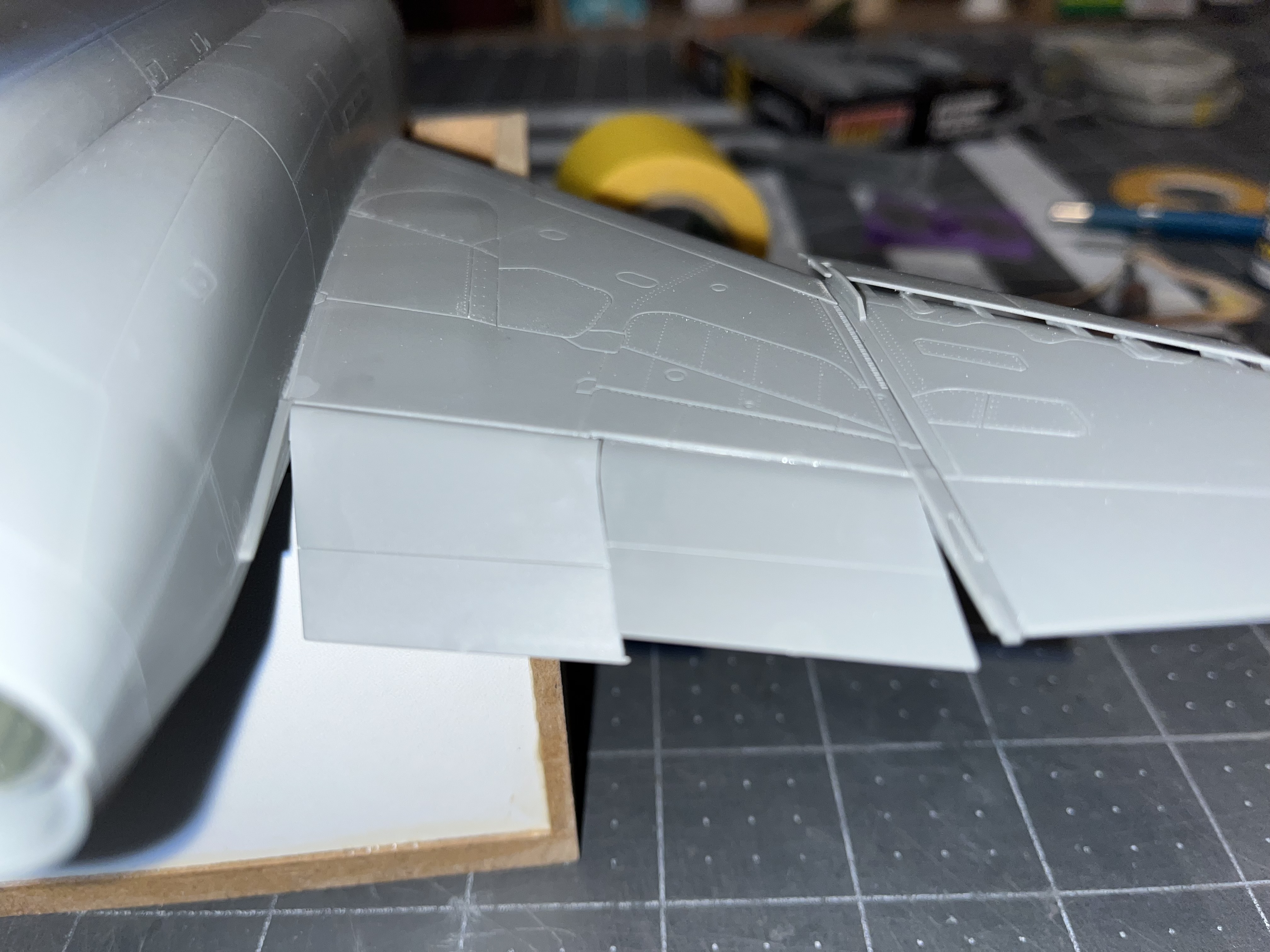

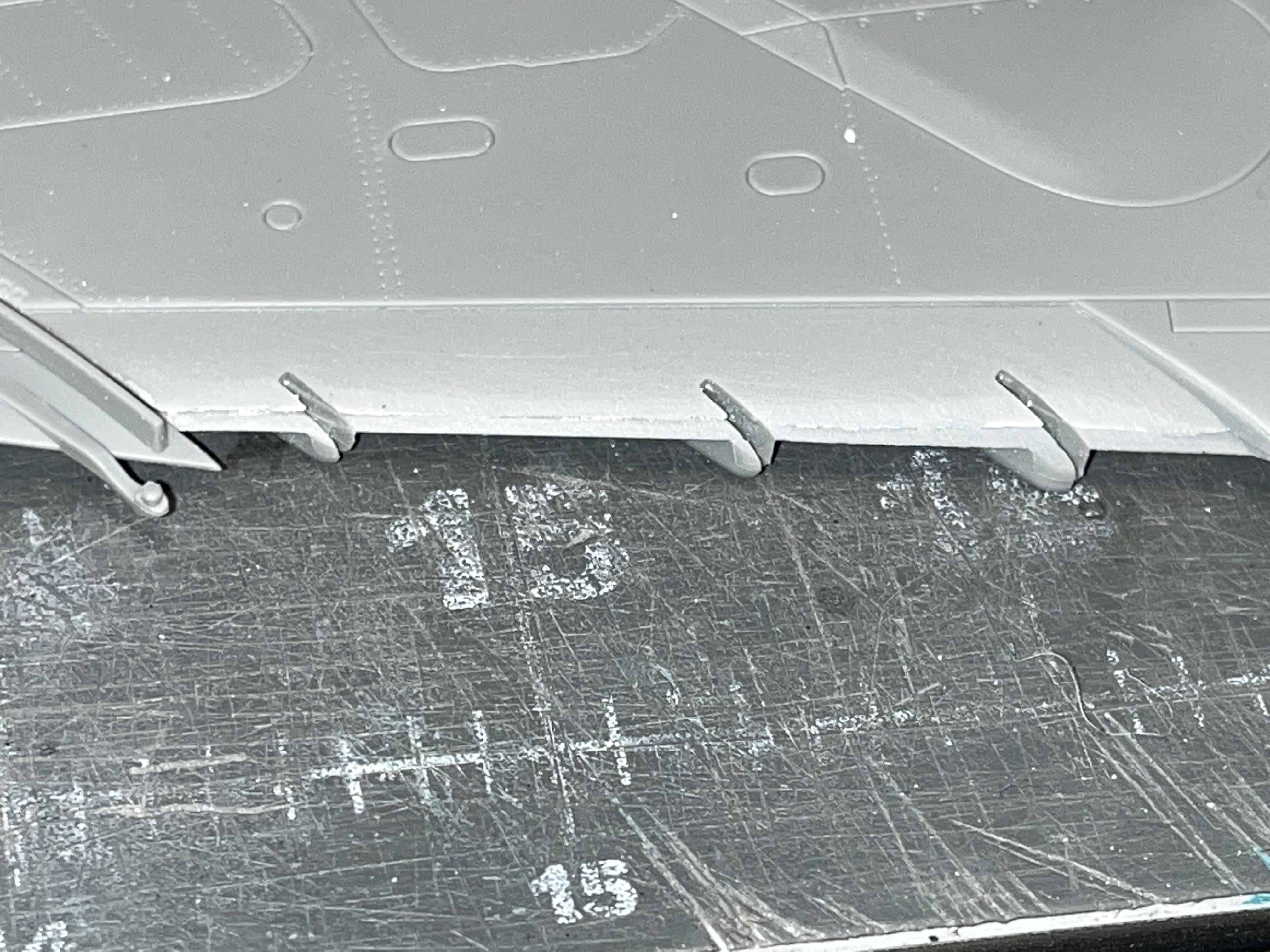

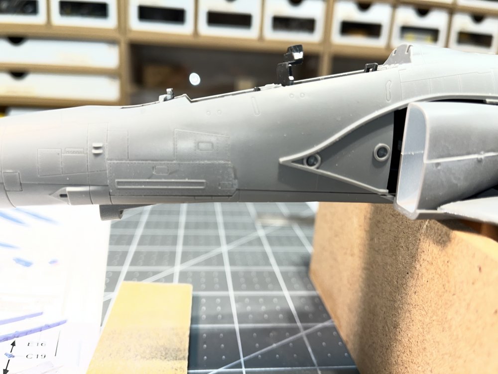

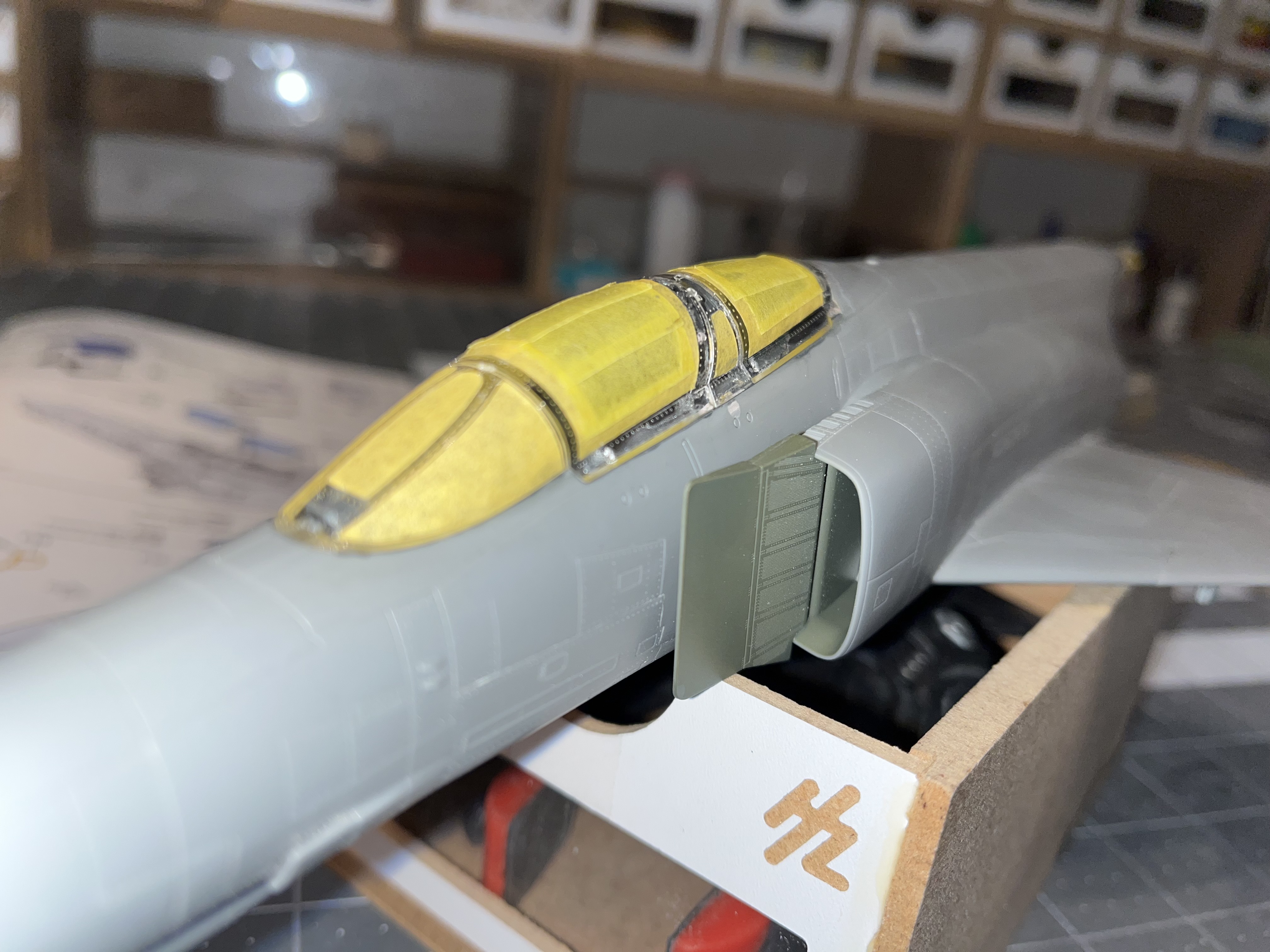

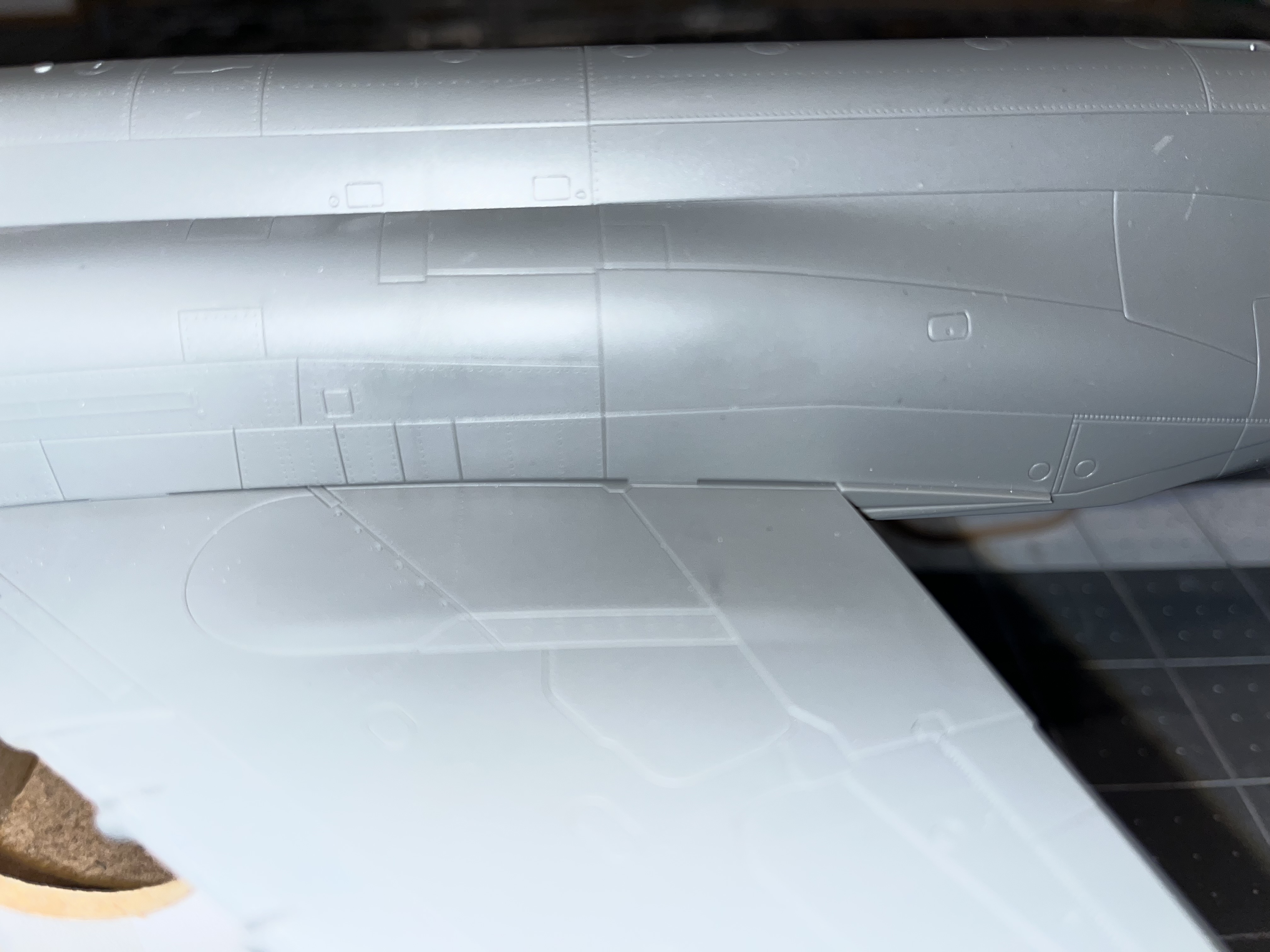

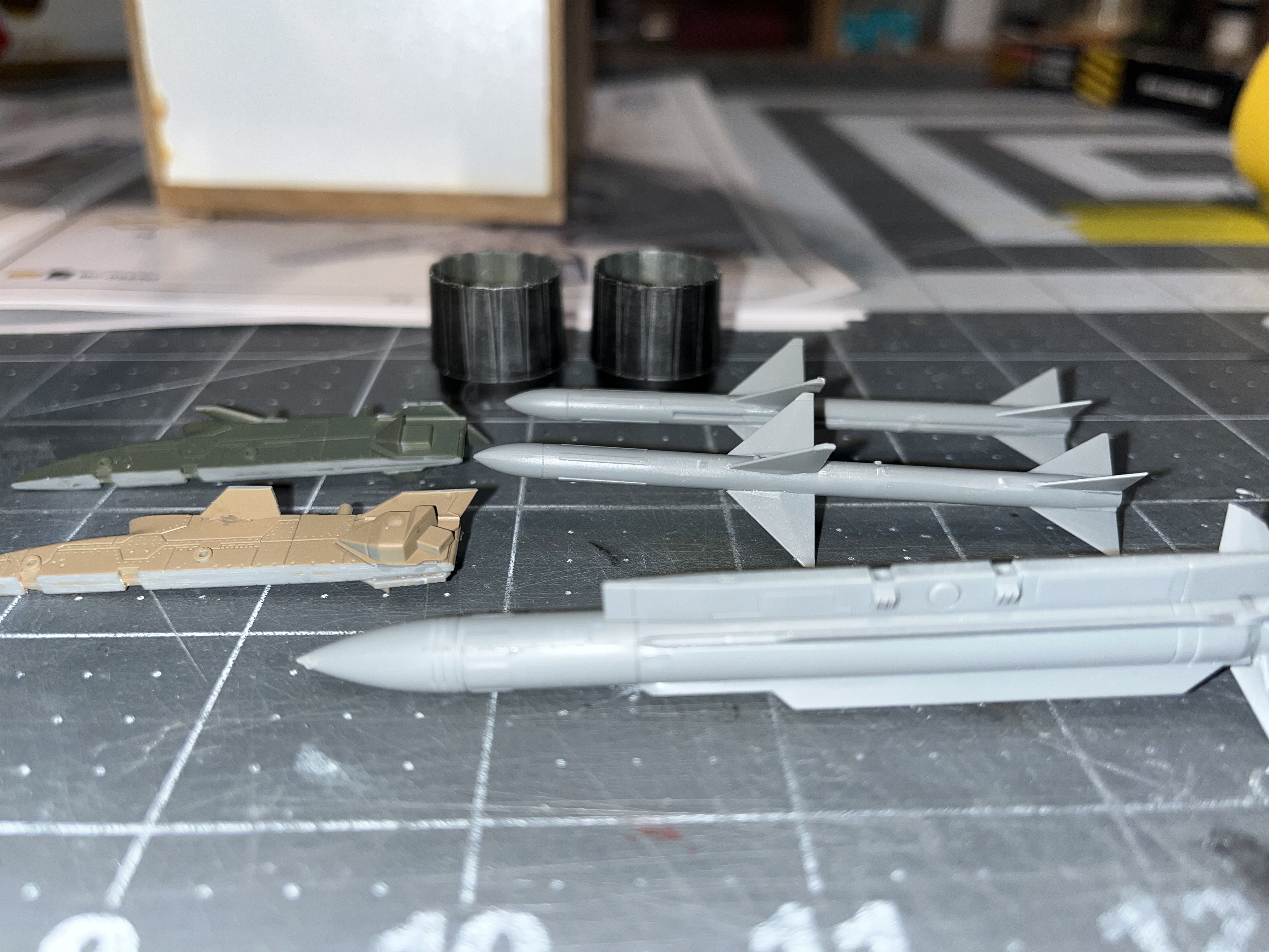

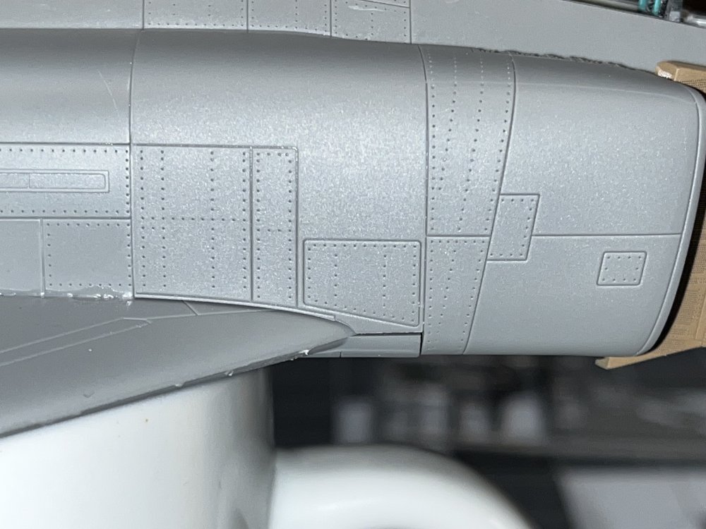

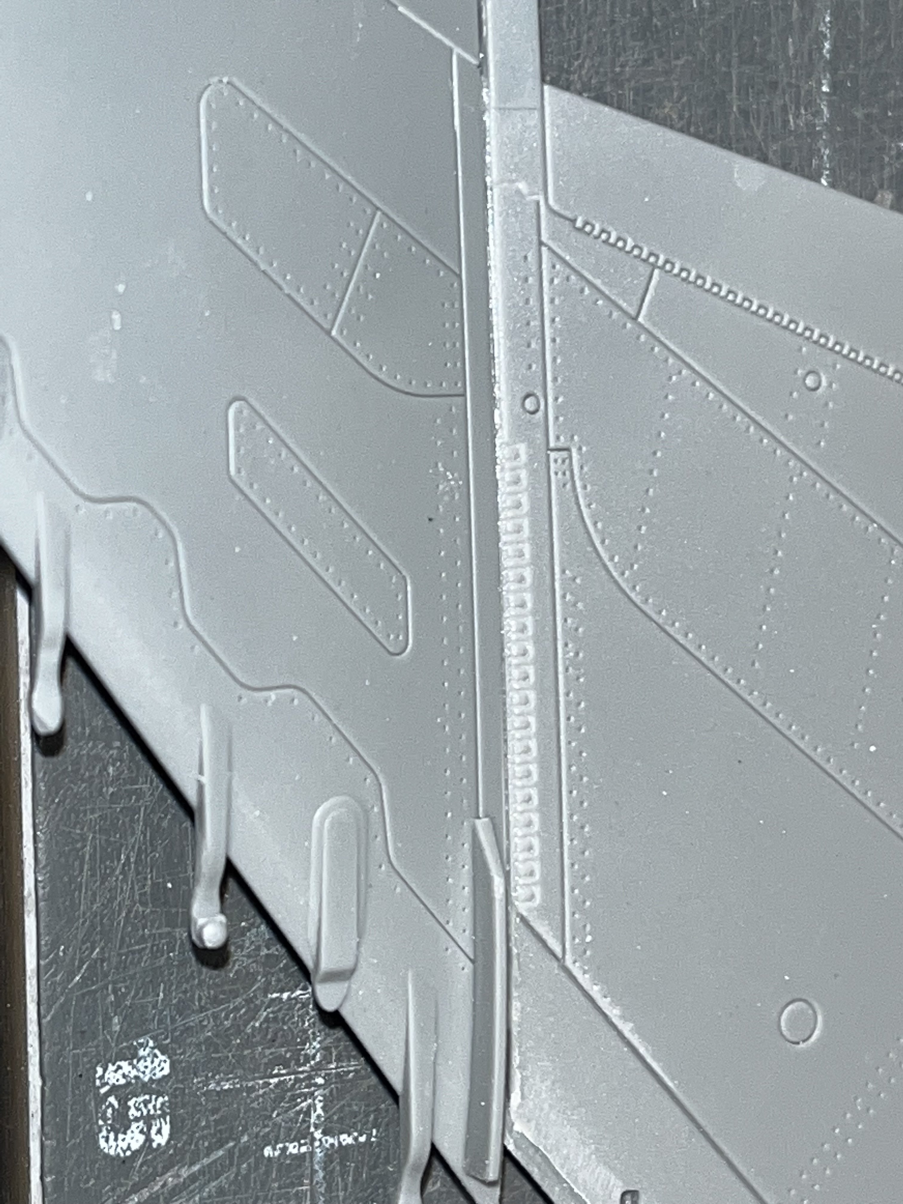

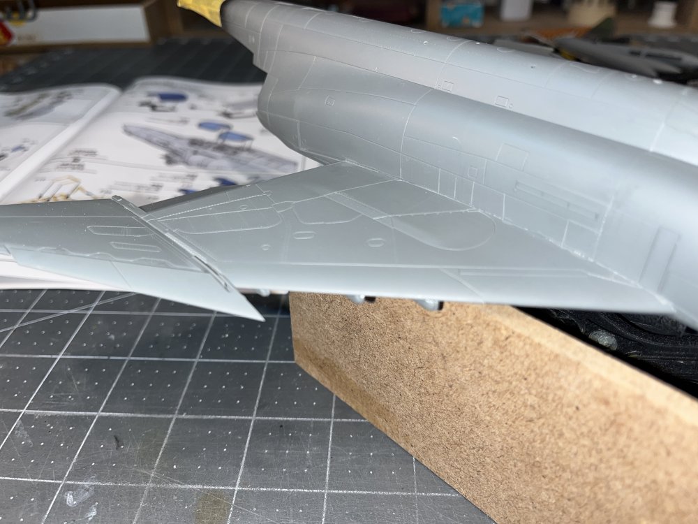

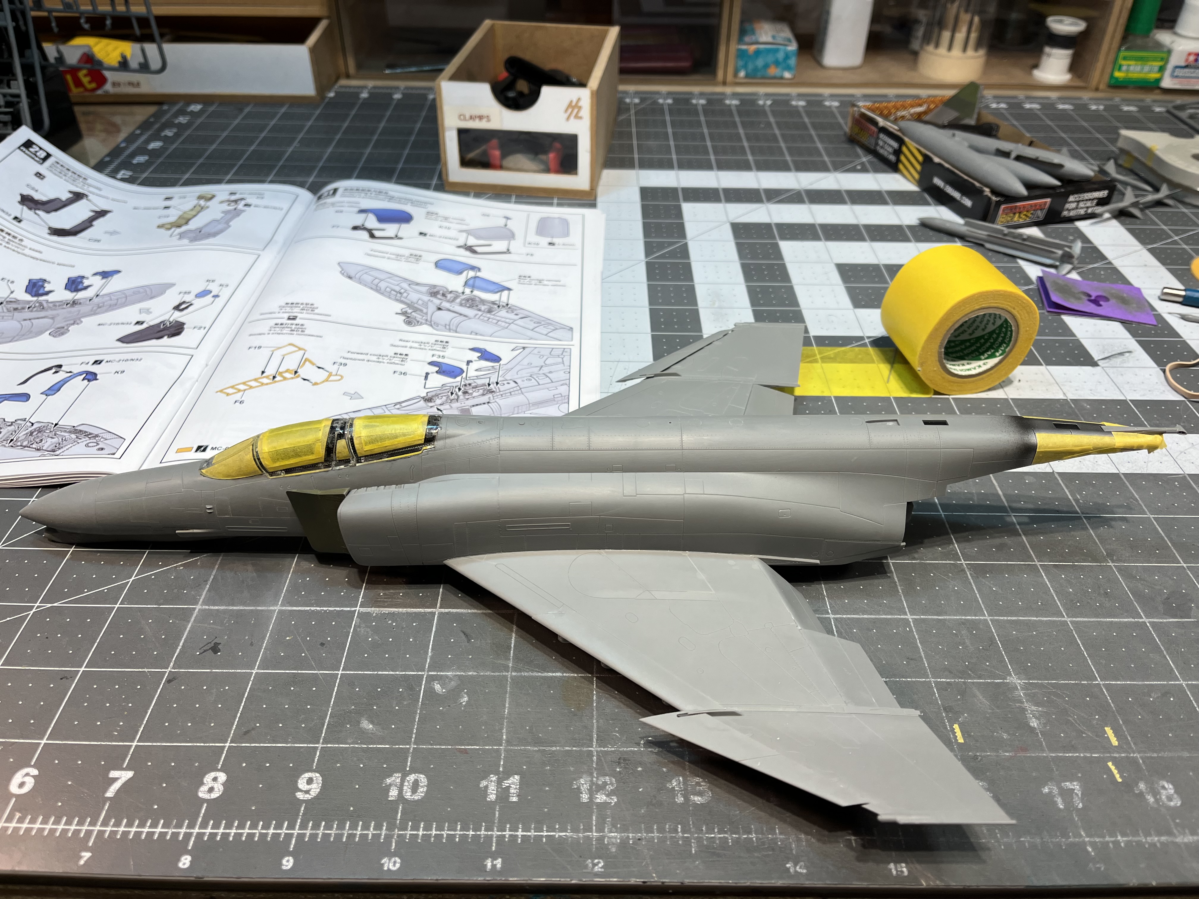

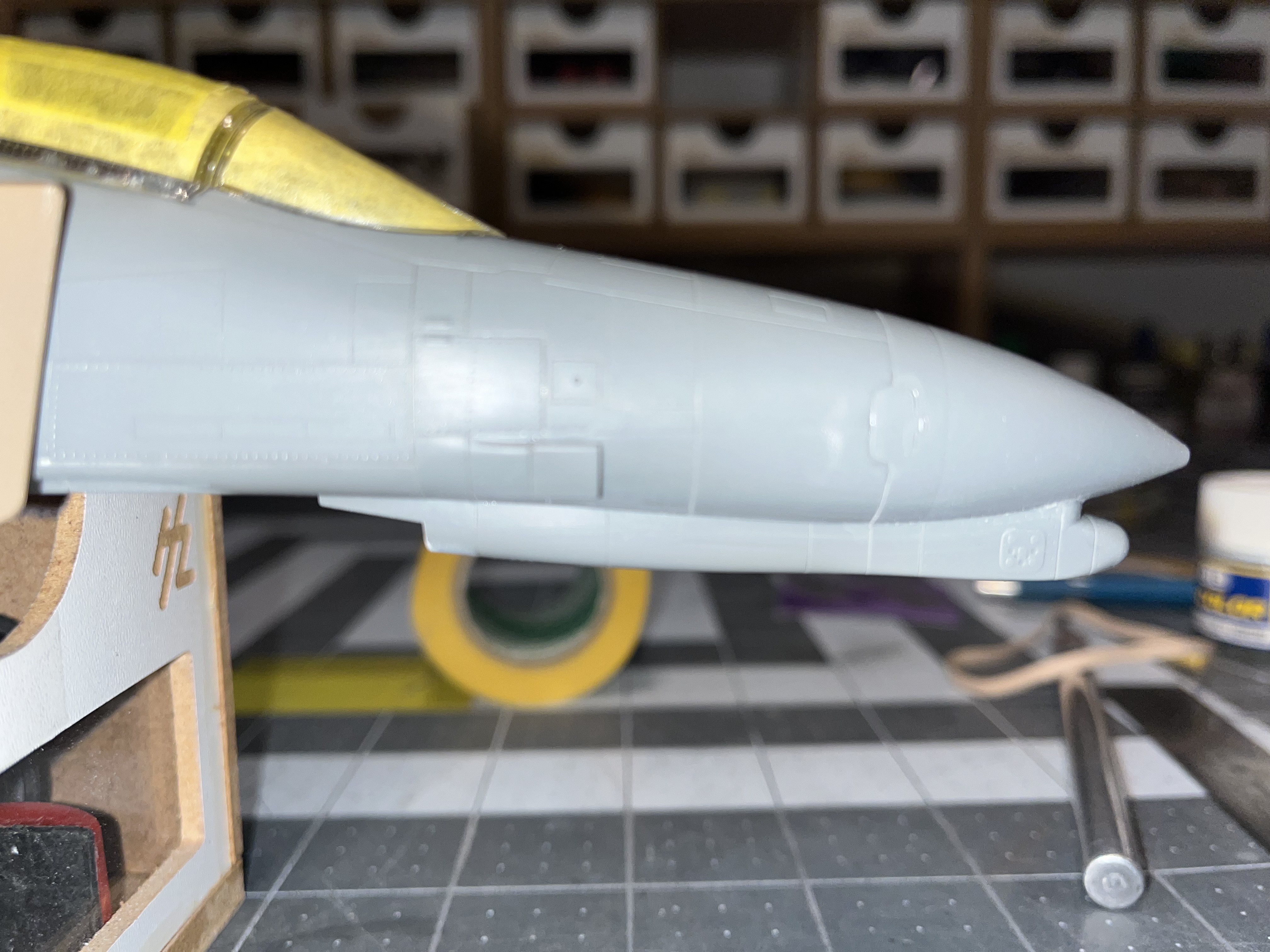

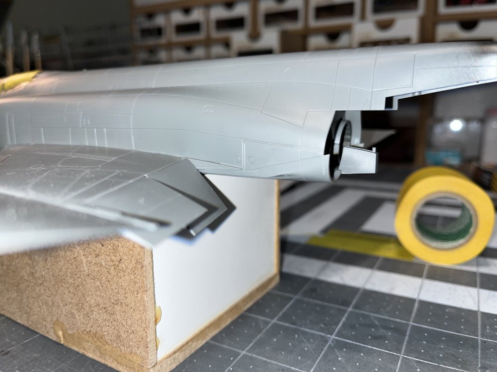

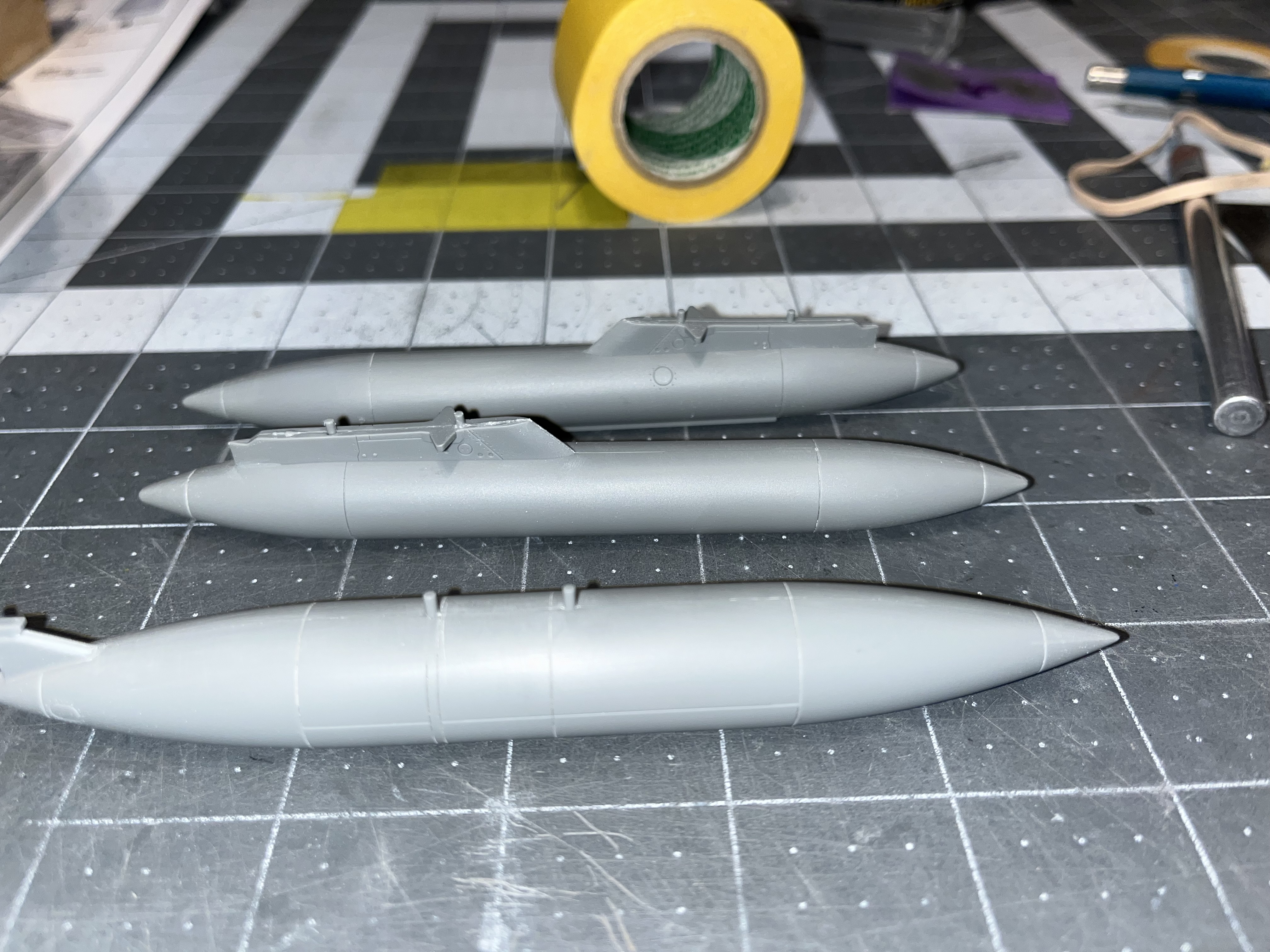

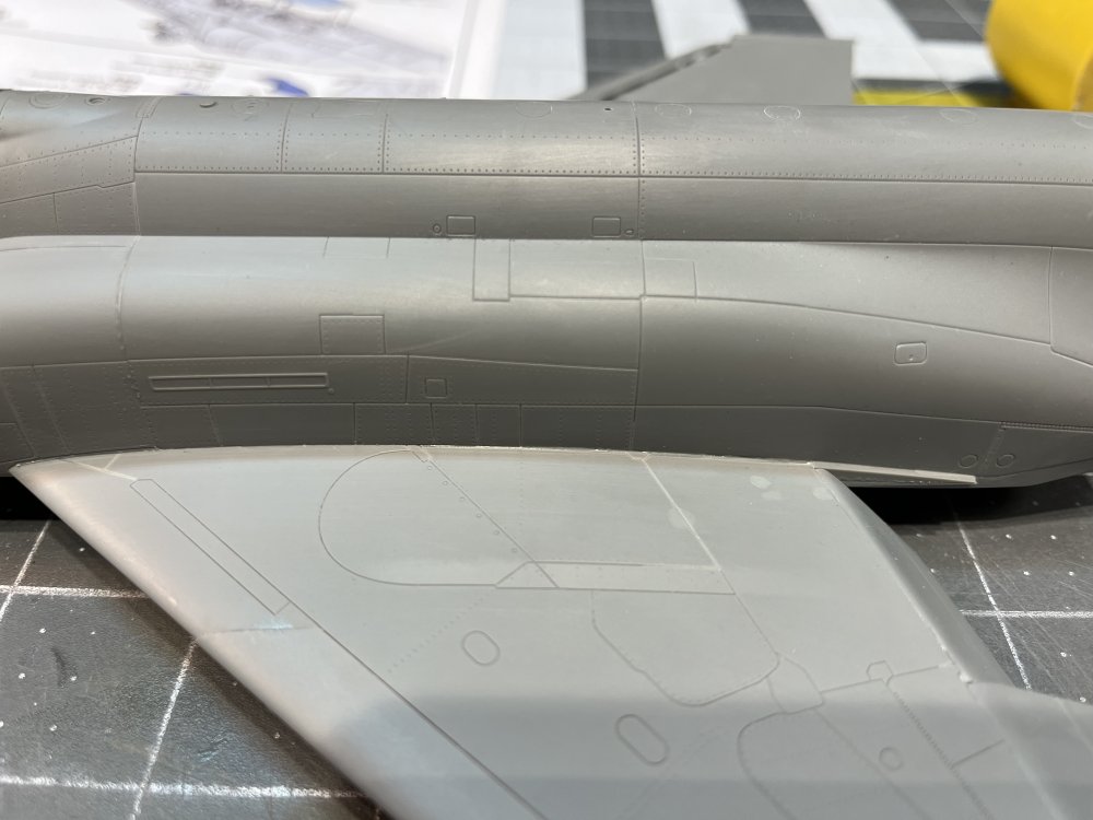

Geoff M Posted February 13 Author Share Posted February 13 (edited) Another update, Catching up after the last few days. This is where I am at right now. Fuselage to wing joint. No gaps or filler needed Upper and lower fuselage seam disappeared. The chin pod literally snaps into place. I glued the windscreen and the small section between the canopies in place. The canopies themselves are just snapped into place secure enough for painting. Later I can mount them open. Intake seam has just the slightest step at the top otherwise it fits very well. Seam at the rear fuselage is on a panel line. No step. Again intake seam is on a panel line and fits flush and smooth. Fuselage wing joint. The slats are optional positions. Again another snap in place fit on the inner slats and a well designed attachment for the outer slats. Optional positions for the flaps and ailerons. I am going to mount 3 tanks, a Standard ARM and a Shrike and 2 Sparrows. This should go with my time frame of a mid 80's F-4G Thanks for checking it out. Edited February 13 by Geoff M Quote Link to post Share on other sites

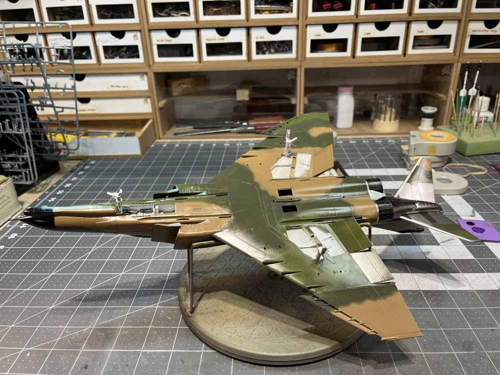

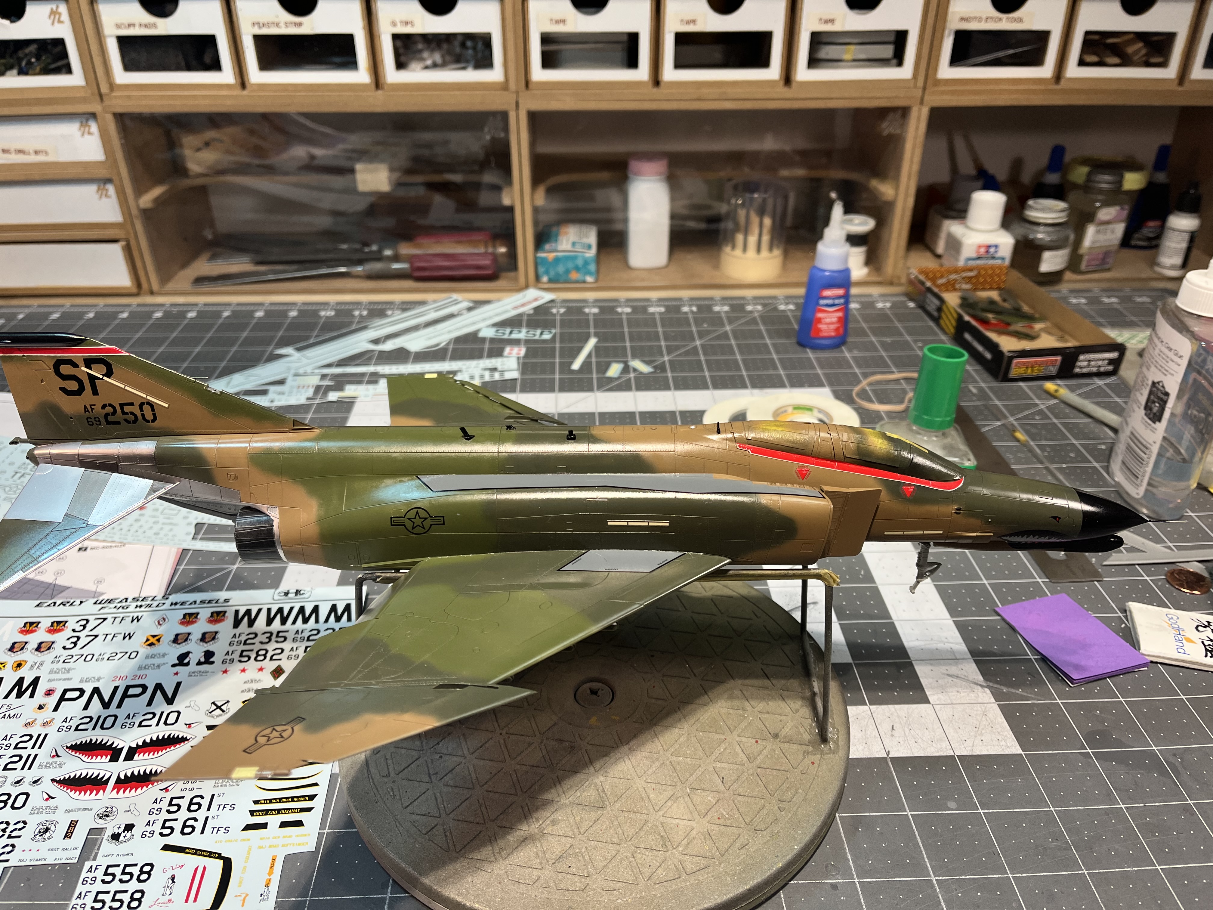

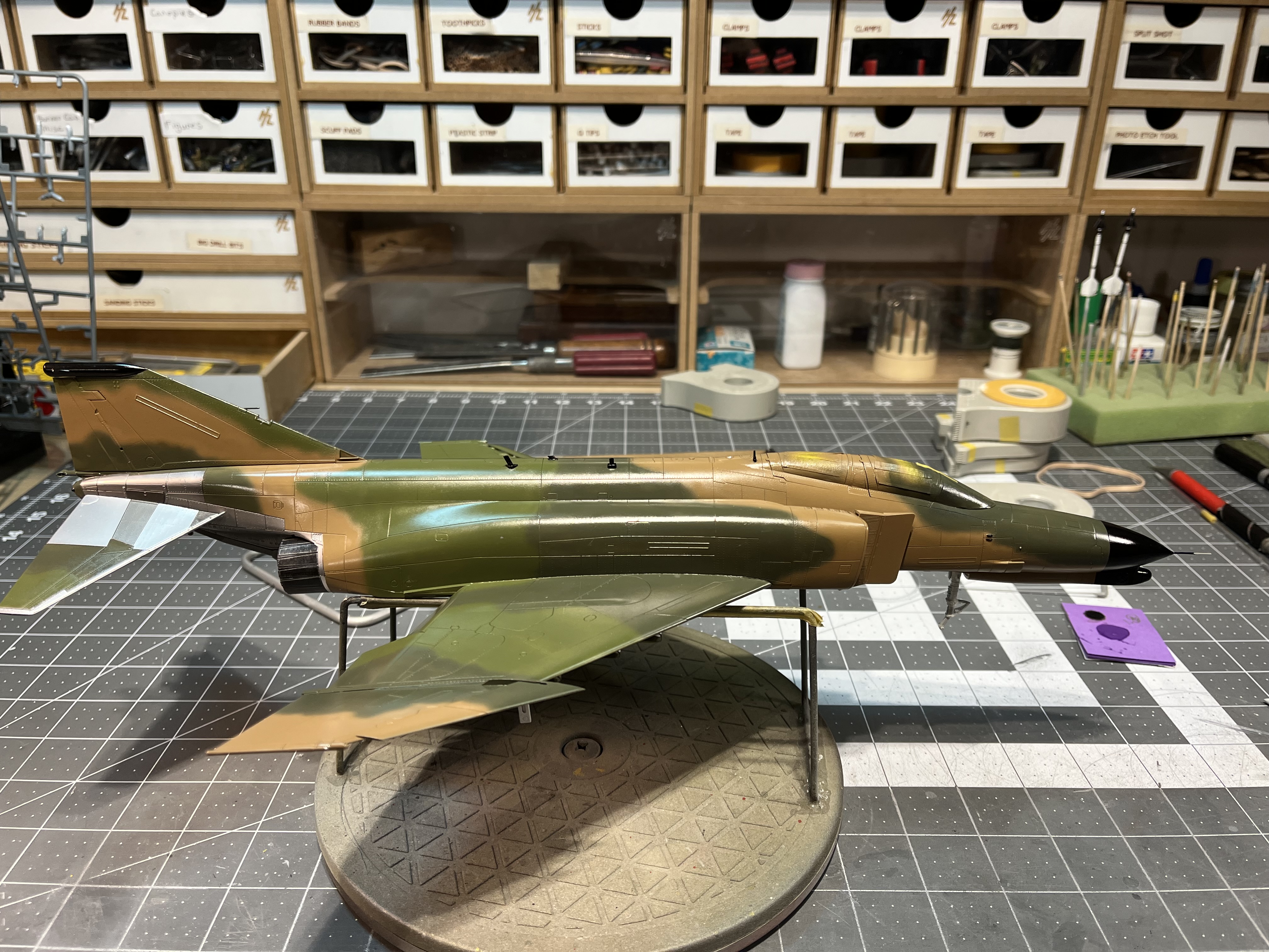

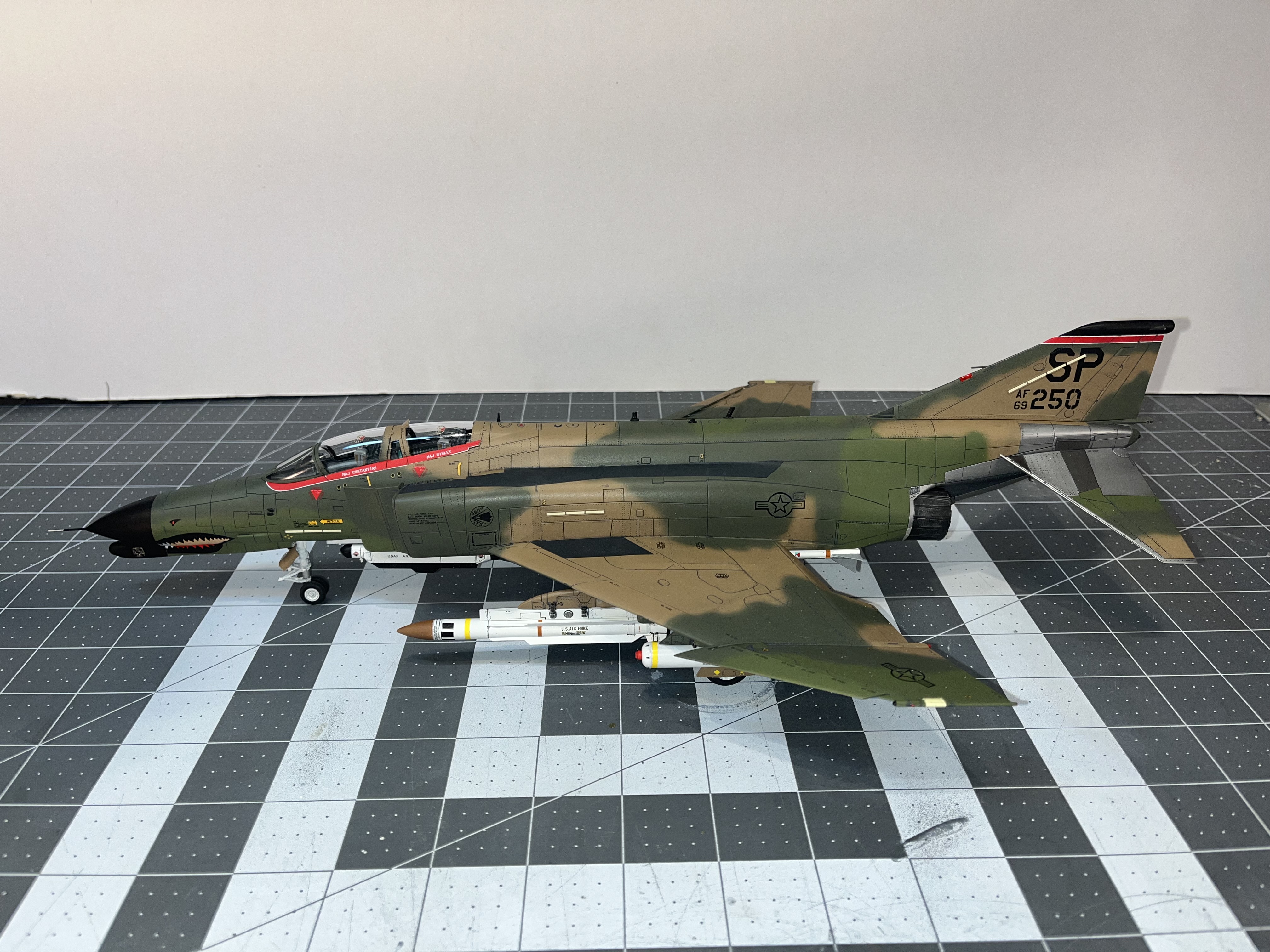

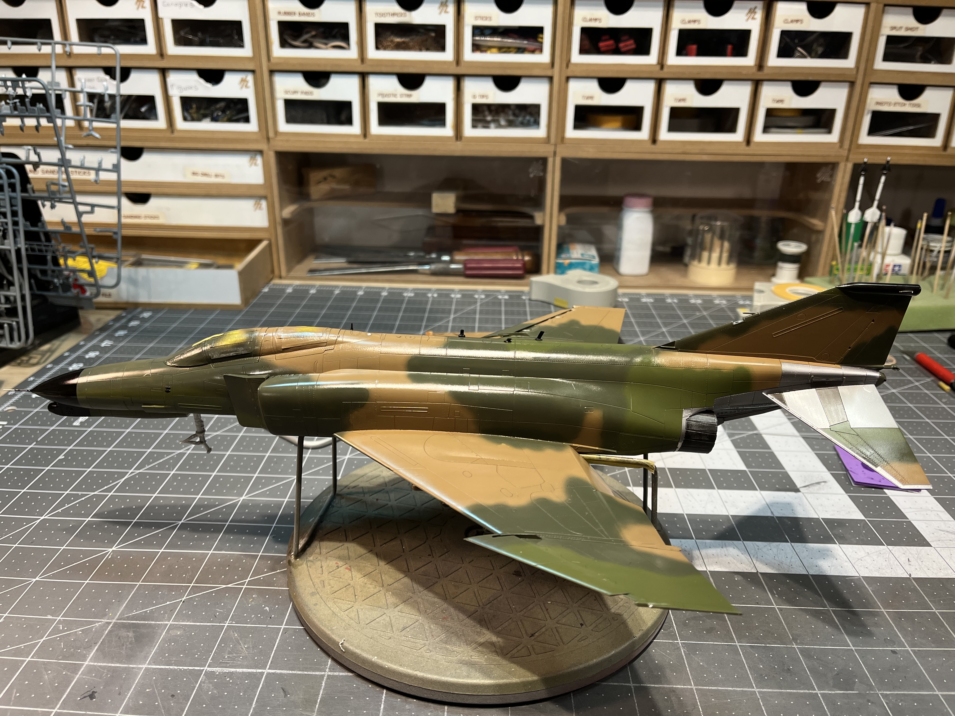

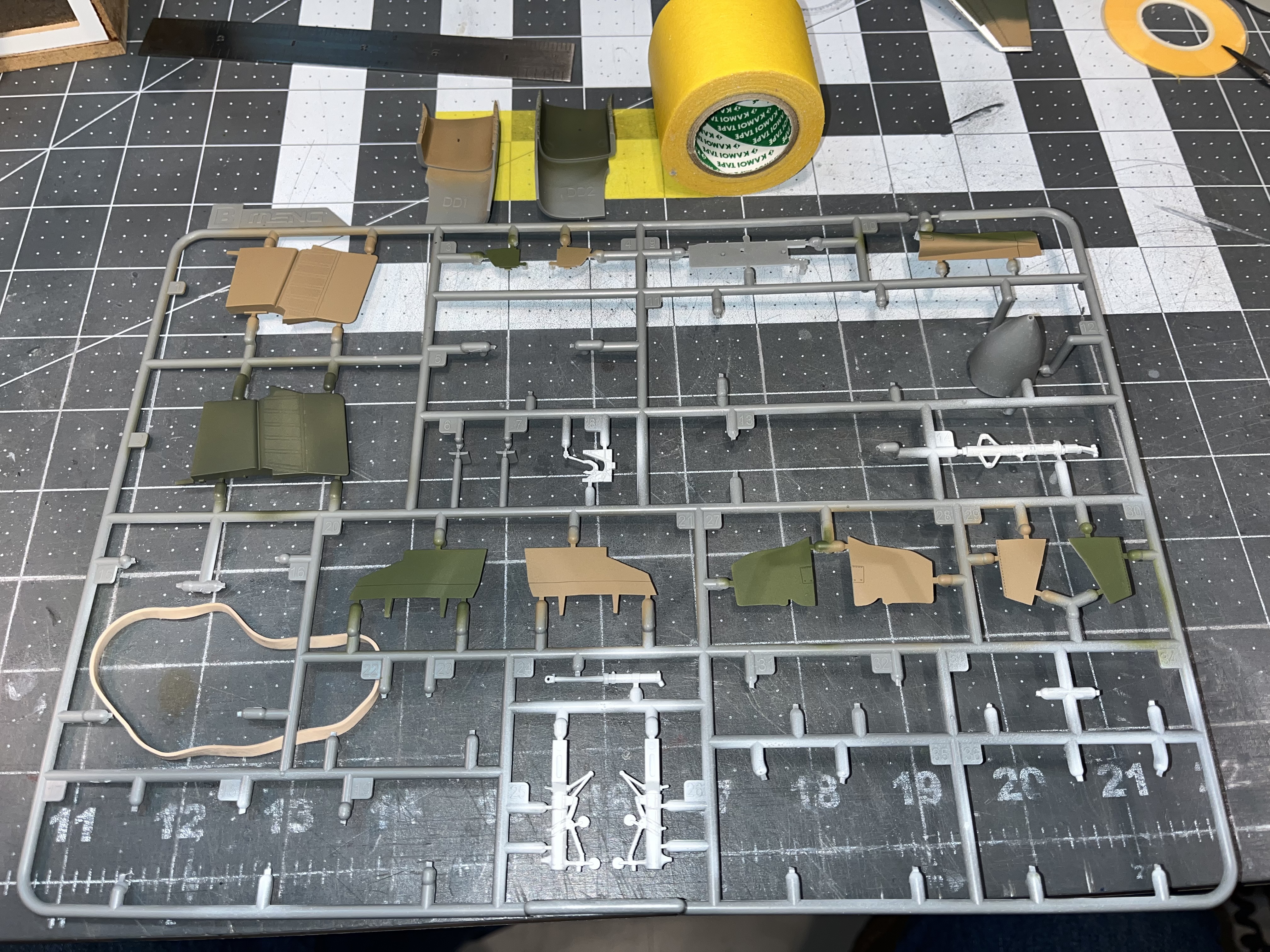

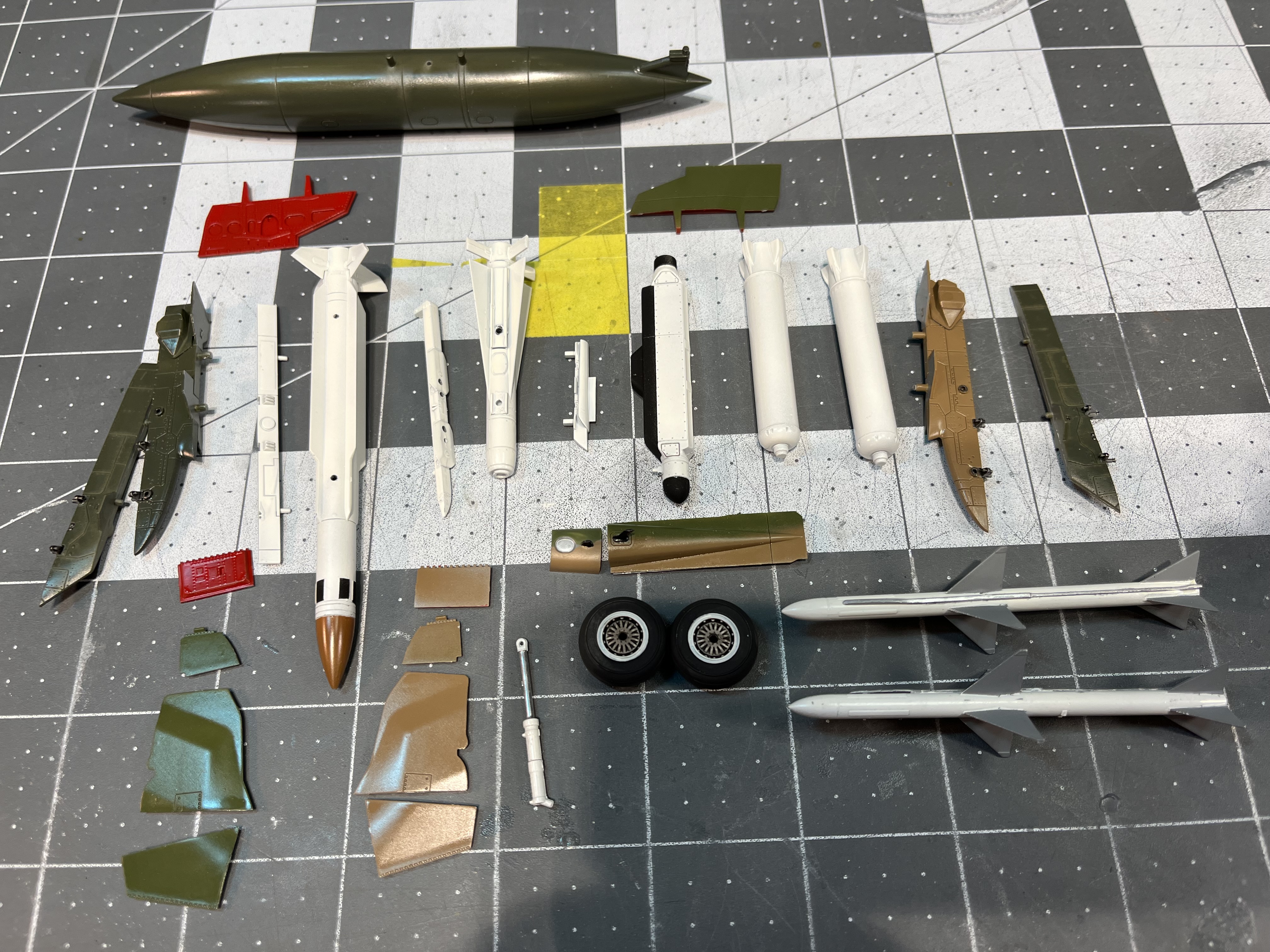

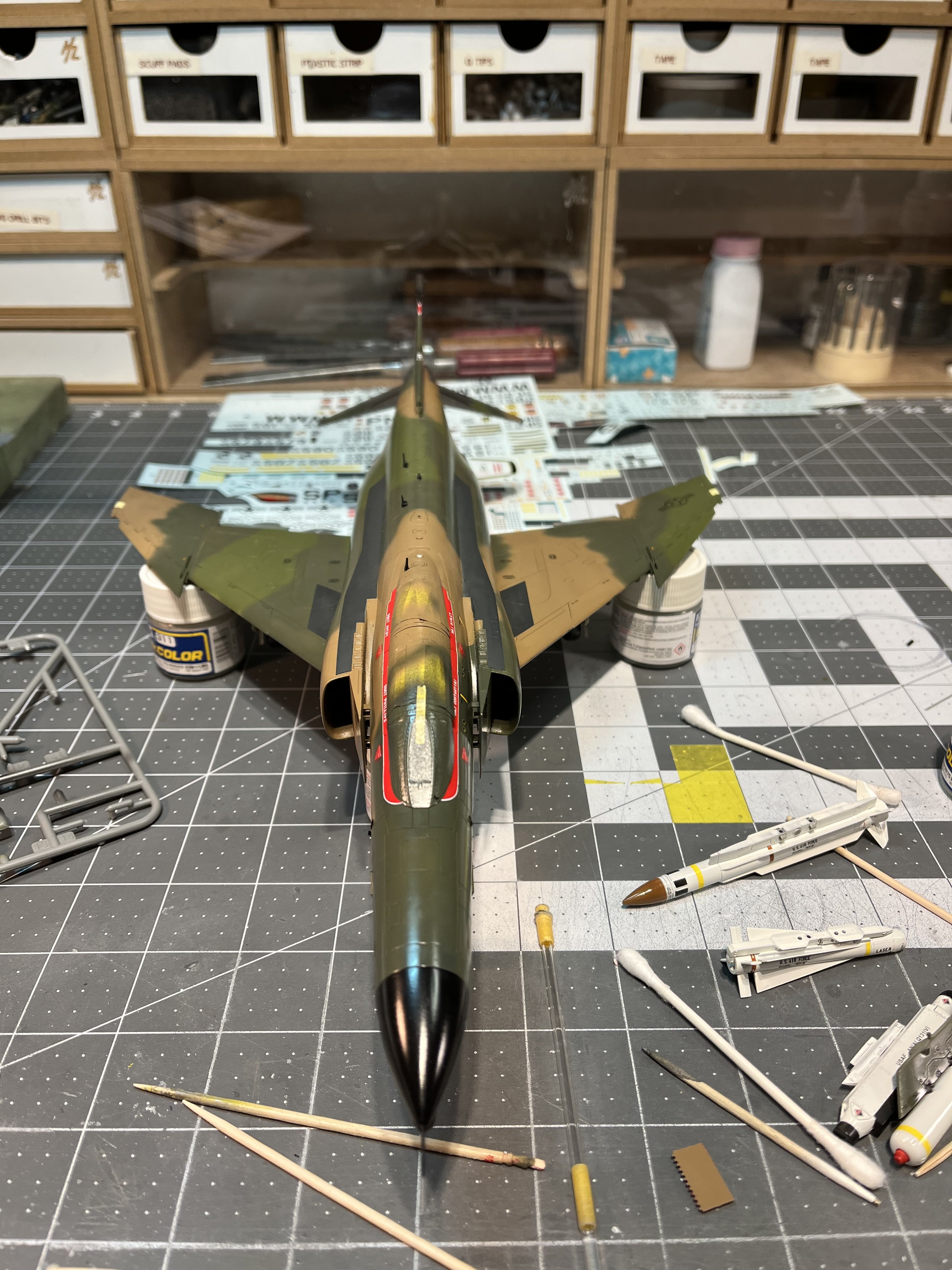

Geoff M Posted February 15 Author Share Posted February 15 I am really liking this kit. The fit is very good, detail is excellent, the way the kit is designed makes it go together very precisely. On to the update. I have finished painting the plane and have been working on the things under the wings. Decals are the next big thing on the list. Quote Link to post Share on other sites
A-10 LOADER Posted February 15 Share Posted February 15 Jeez, that was fast !! Colors look good, I see CBU's nice ! Steve Quote Link to post Share on other sites
RichB63 Posted February 15 Share Posted February 15 The colors look great! What kind of paint did you use? Quote Link to post Share on other sites
Geoff M Posted February 16 Author Share Posted February 16 All Mr Color. Quote Link to post Share on other sites
ExchefAndy Posted February 16 Share Posted February 16 Damn... That looks fantastic, really nice work! Looks like I'll be adding one of these to my future Andy Quote Link to post Share on other sites
BastianD Posted February 16 Share Posted February 16 She’s a stunner, nice result on the SEA camo! Quote Link to post Share on other sites

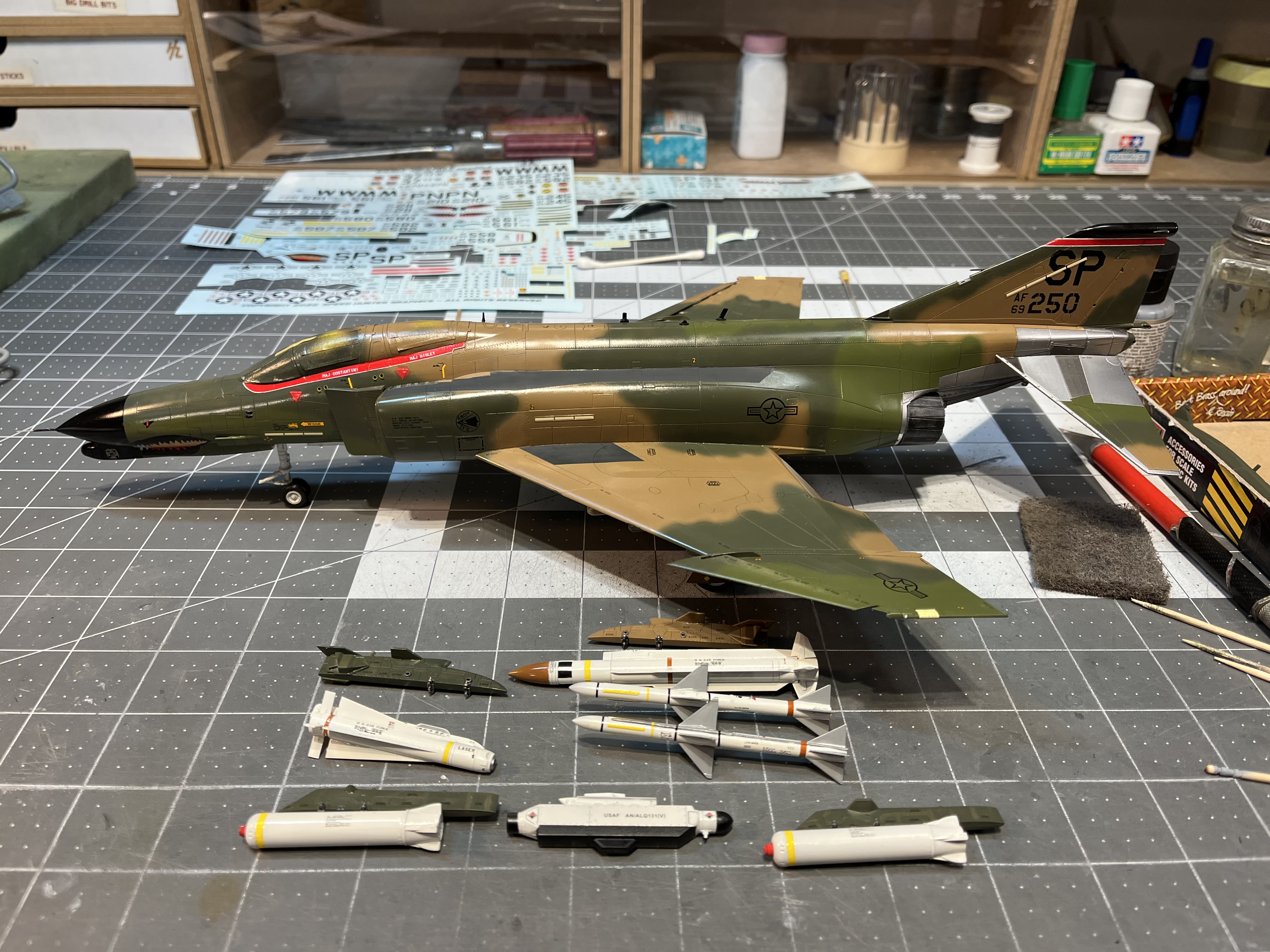

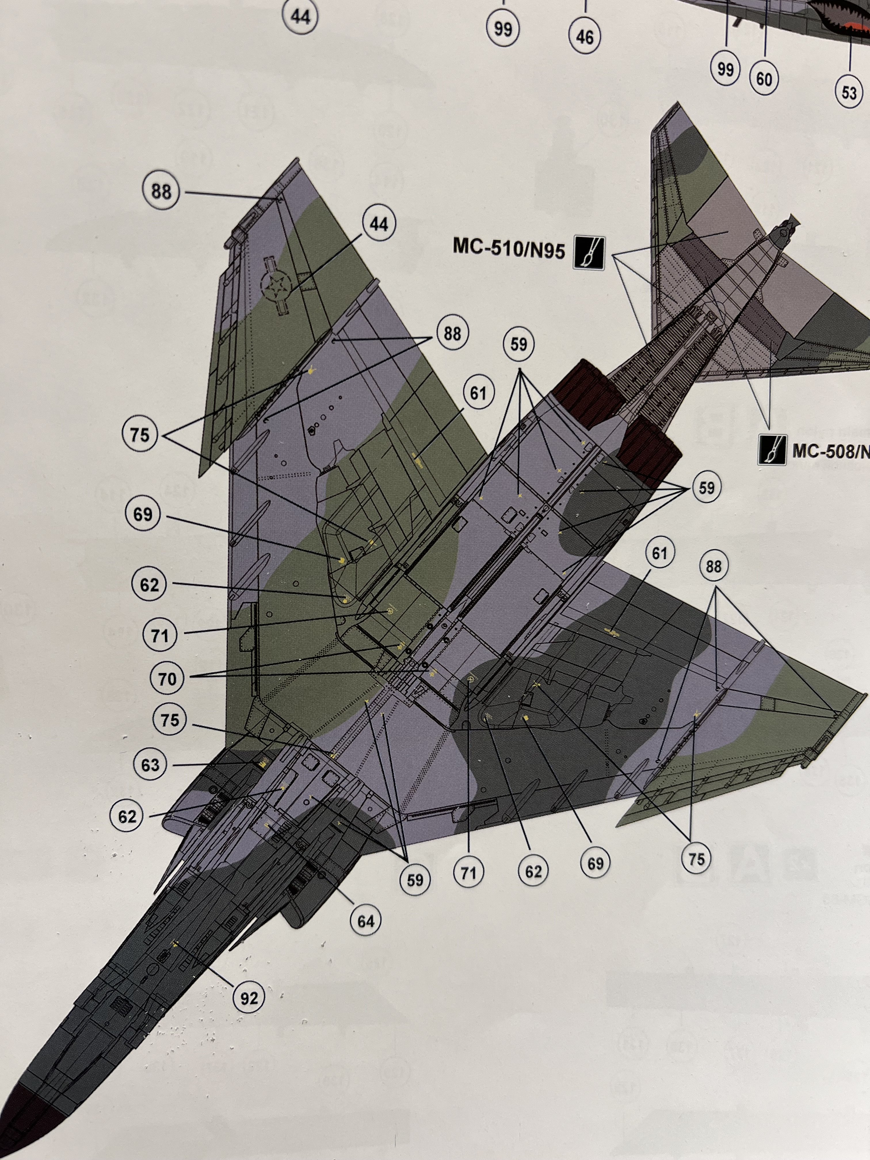

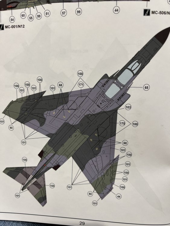

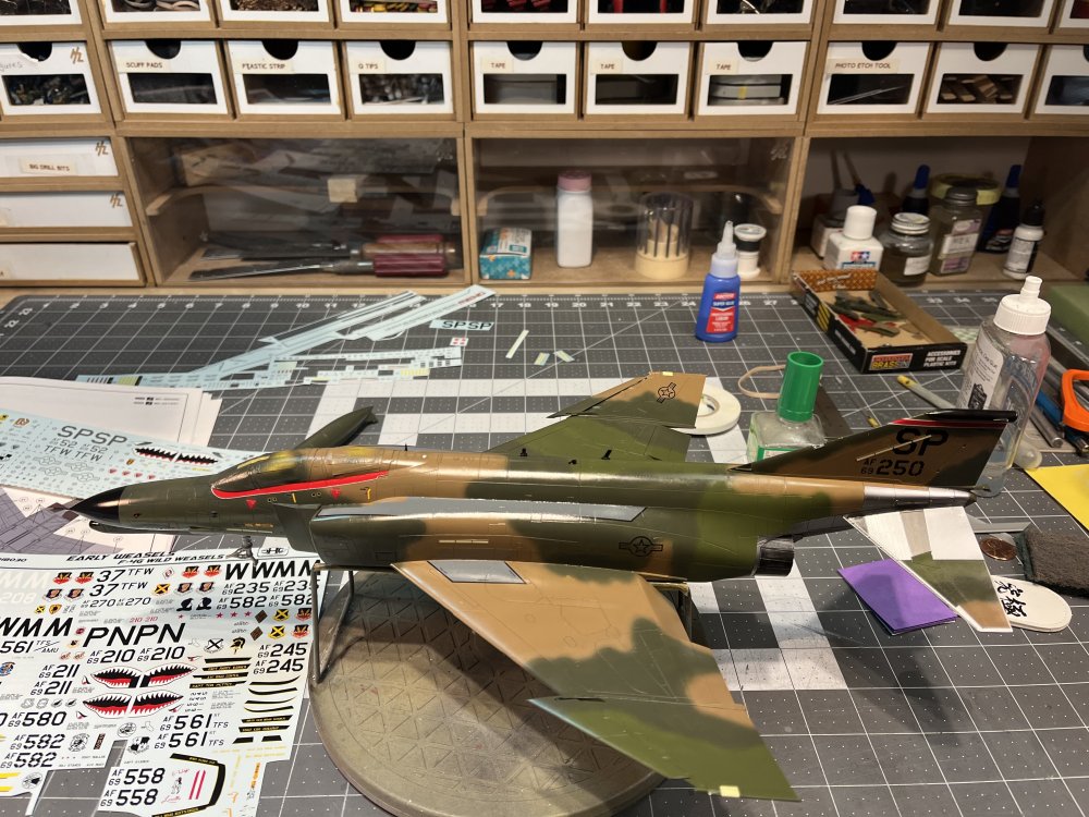

Geoff M Posted February 18 Author Share Posted February 18 (edited) Latest update. Started the decal process using a mixture of the kit and Speed Hunter Graphics latest release for the F-4G. These are excellent decals and fit this kit perfectly. I used the kit decals for the walkways. After looking at them for a while I decided they are not right. You will also notice that the star and bar is on the wrong (right) wing. A couple of problems to fix! I was using the kit instructions to do the general markings and stencils. If you look close they have the star and bars on the wrong wings. Unfortunately the SHG doesn't provide a top and bottom view for decaling. I carefully masked around the walkway decals and repainted them with a darker gray. I used Tamiya Nato Black. That looks better. Then I soaked the wrongly place decals with warm water and scubbed them with a stiff brush until they started to lift. They eventually came up but were destroyed in the process. Fortunately, there were more of the same on the SHG sheet. I touched up the paint where they were and put the new decals on the right correct wings. Edited February 18 by Geoff M update Quote Link to post Share on other sites

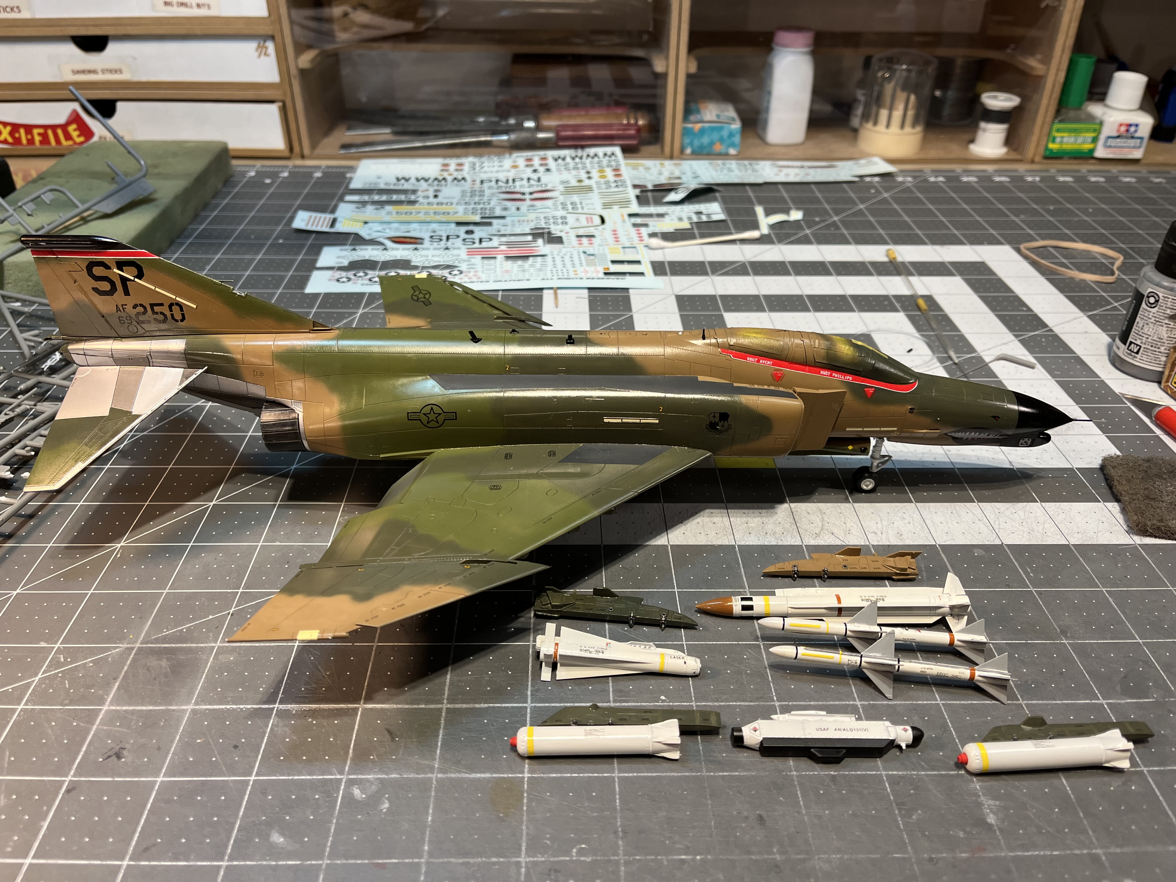

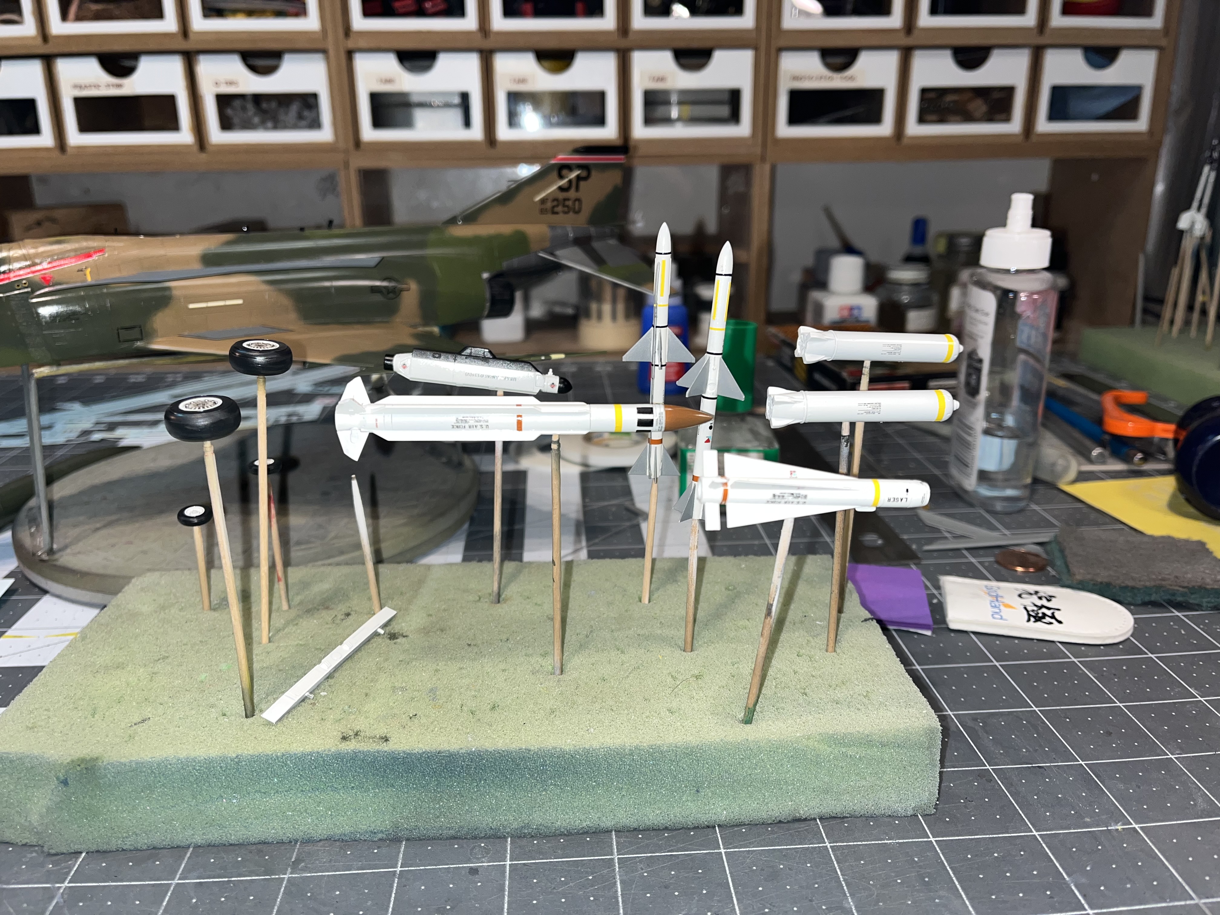

Geoff M Posted February 18 Author Share Posted February 18 I am having trouble posting again. It won't let me add anymore text to my last post. Anyhow, Meng supplies a nice set of decals for the wing pylons and weapons. I scrounged up a pair of CBU's to round out the weapons load. I just need to add a few small parts and touch up some paint. Then I will add a panel line wash and this one will be ready for a final flat coat. OH YEAH! I almost forgot I still need to do the ejection seats, DOH! Quote Link to post Share on other sites

Geoff M Posted February 21 Author Share Posted February 21 (edited) Finished this up yesterday. More pics in the Display Case. Edited February 21 by Geoff M Quote Link to post Share on other sites
A-10 LOADER Posted February 21 Share Posted February 21 Jesus Geoff that was FAST !! Very nice, she looks really good. Steve Quote Link to post Share on other sites
Curt B Posted March 16 Share Posted March 16 Great looking F-4G...really! I have both this kit, and the Zoukei-Mura F-4G, and am looking forward to building both. If either of mine turns out as nice as yours, I'LL BE THRILLED! Quote Link to post Share on other sites
