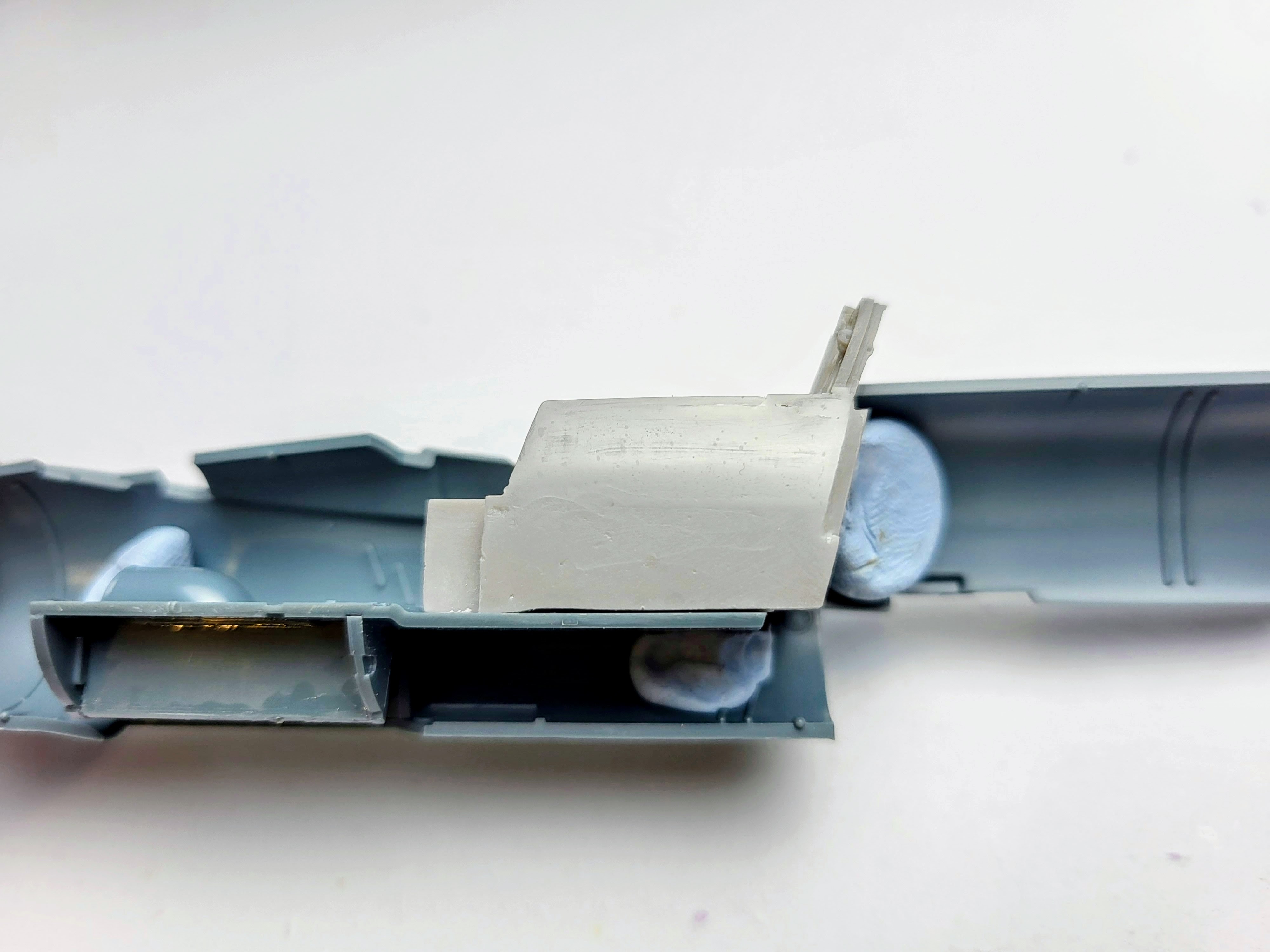

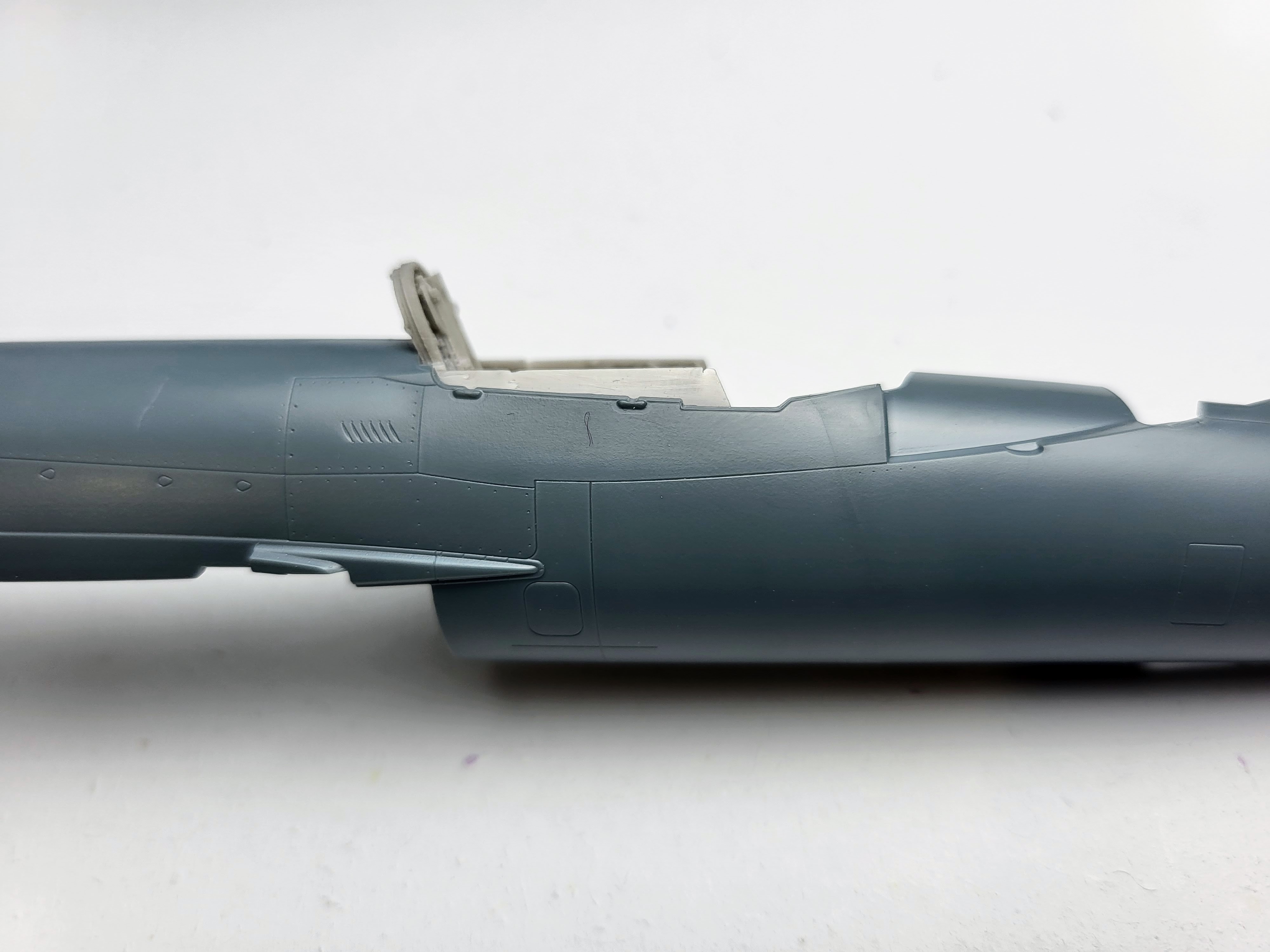

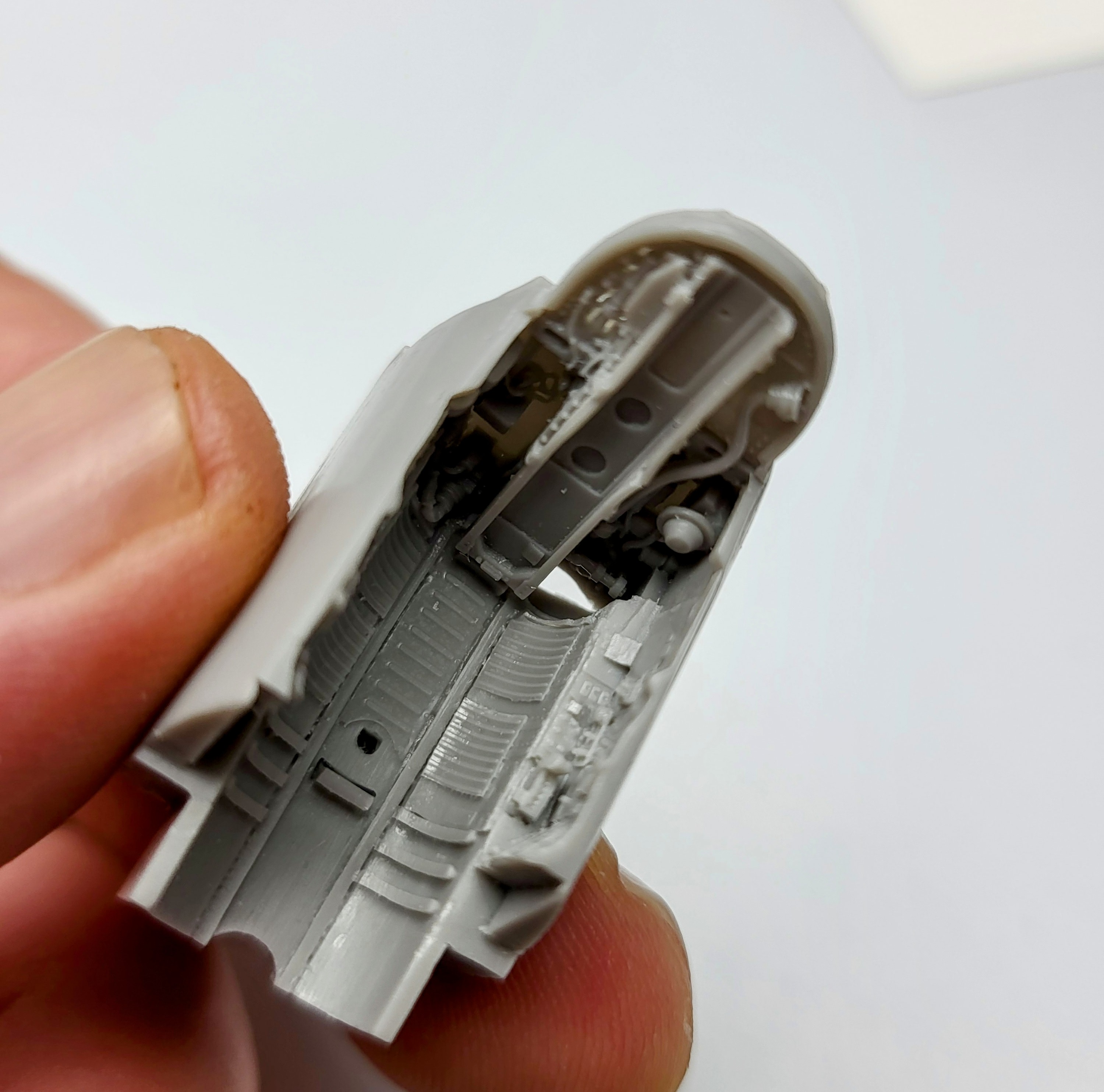

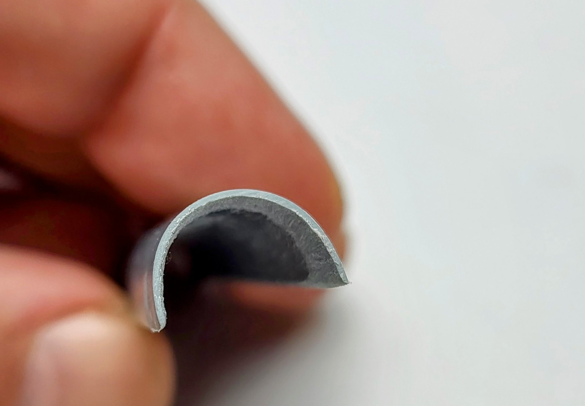

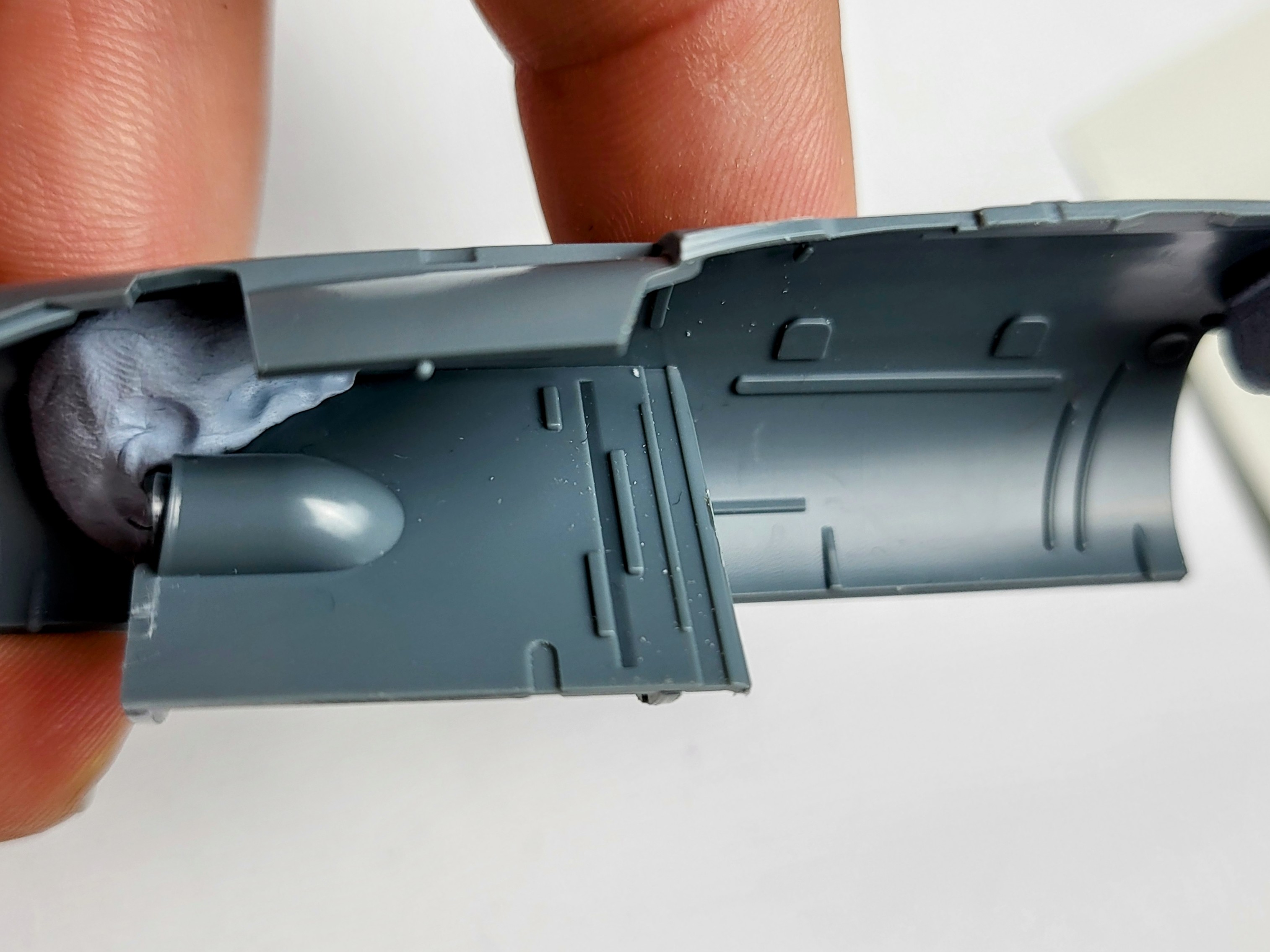

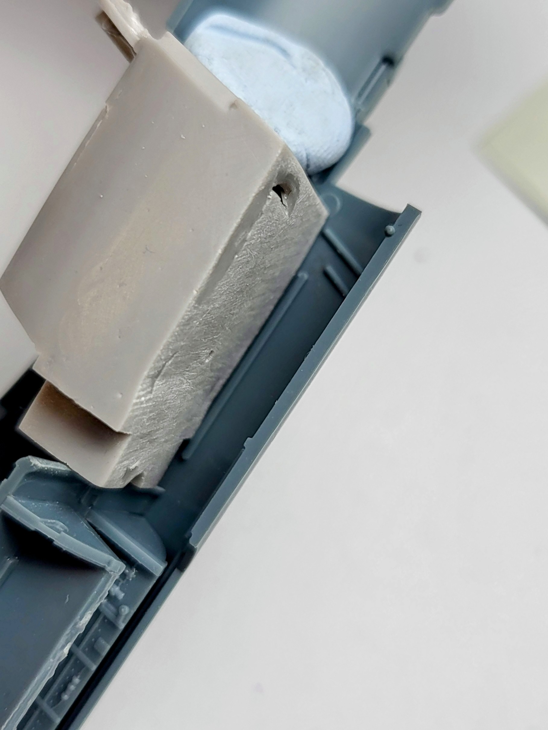

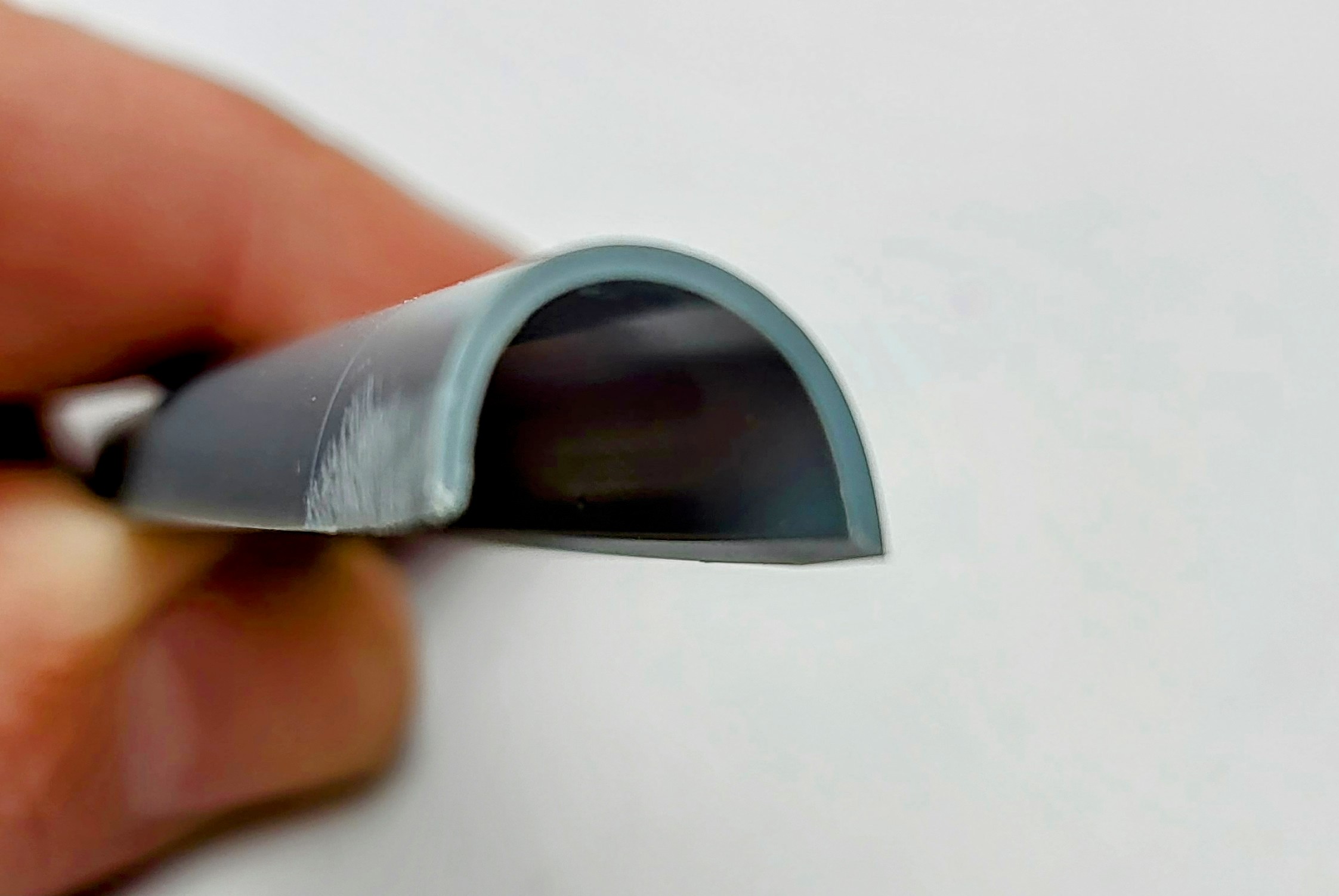

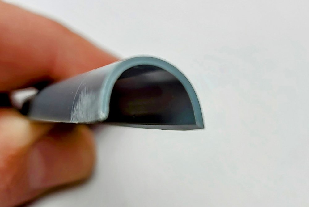

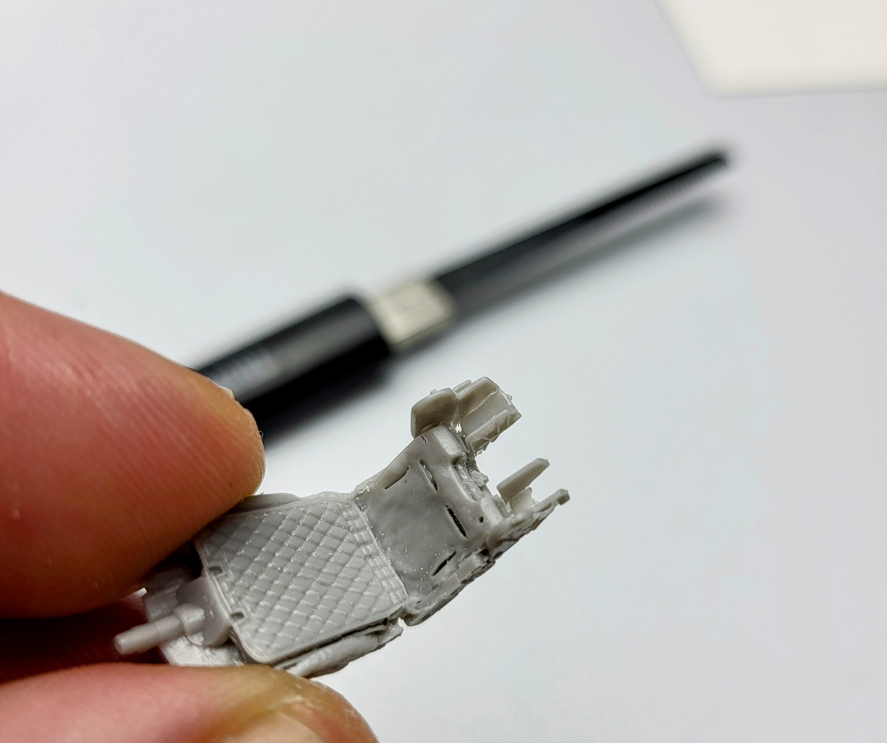

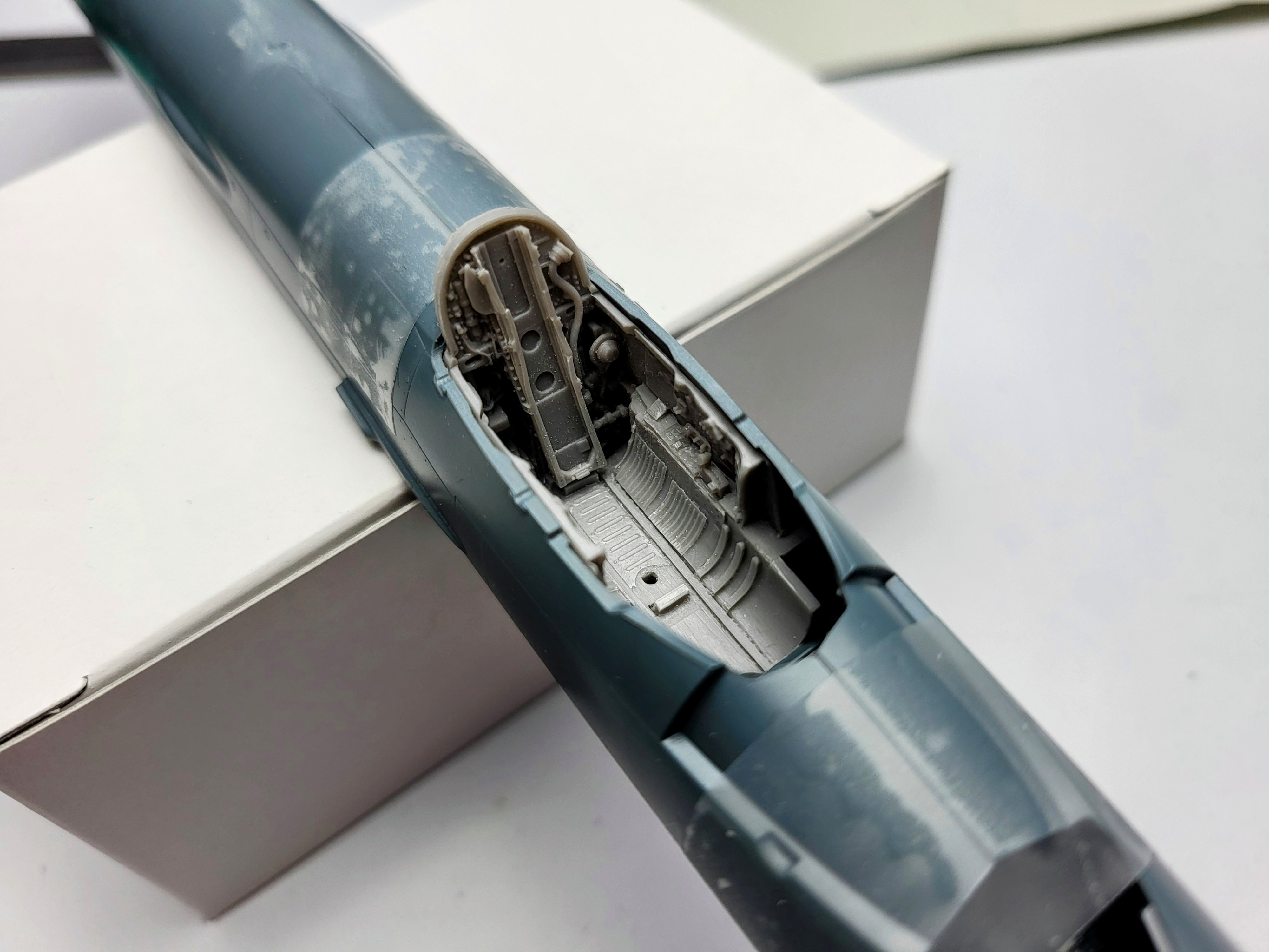

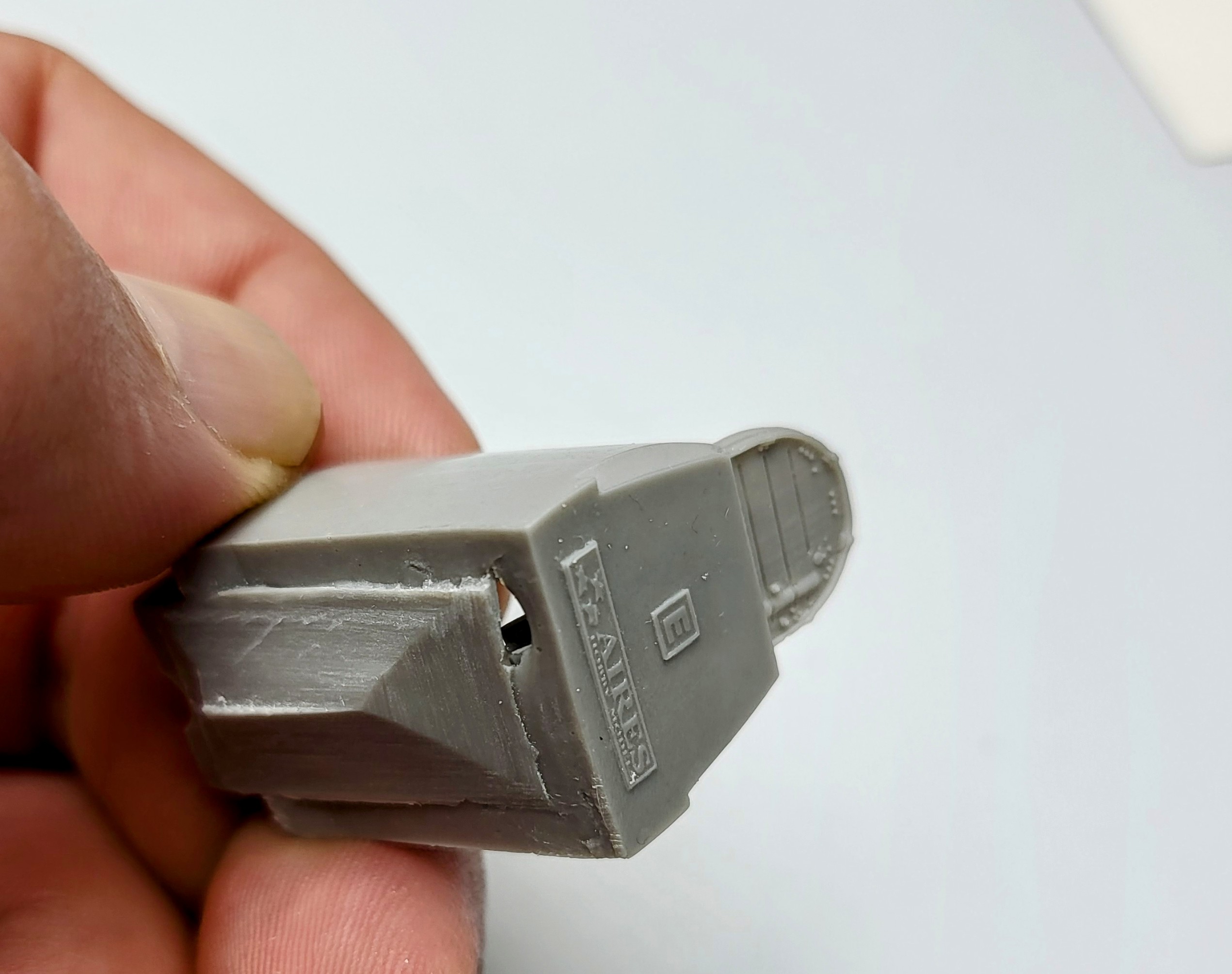

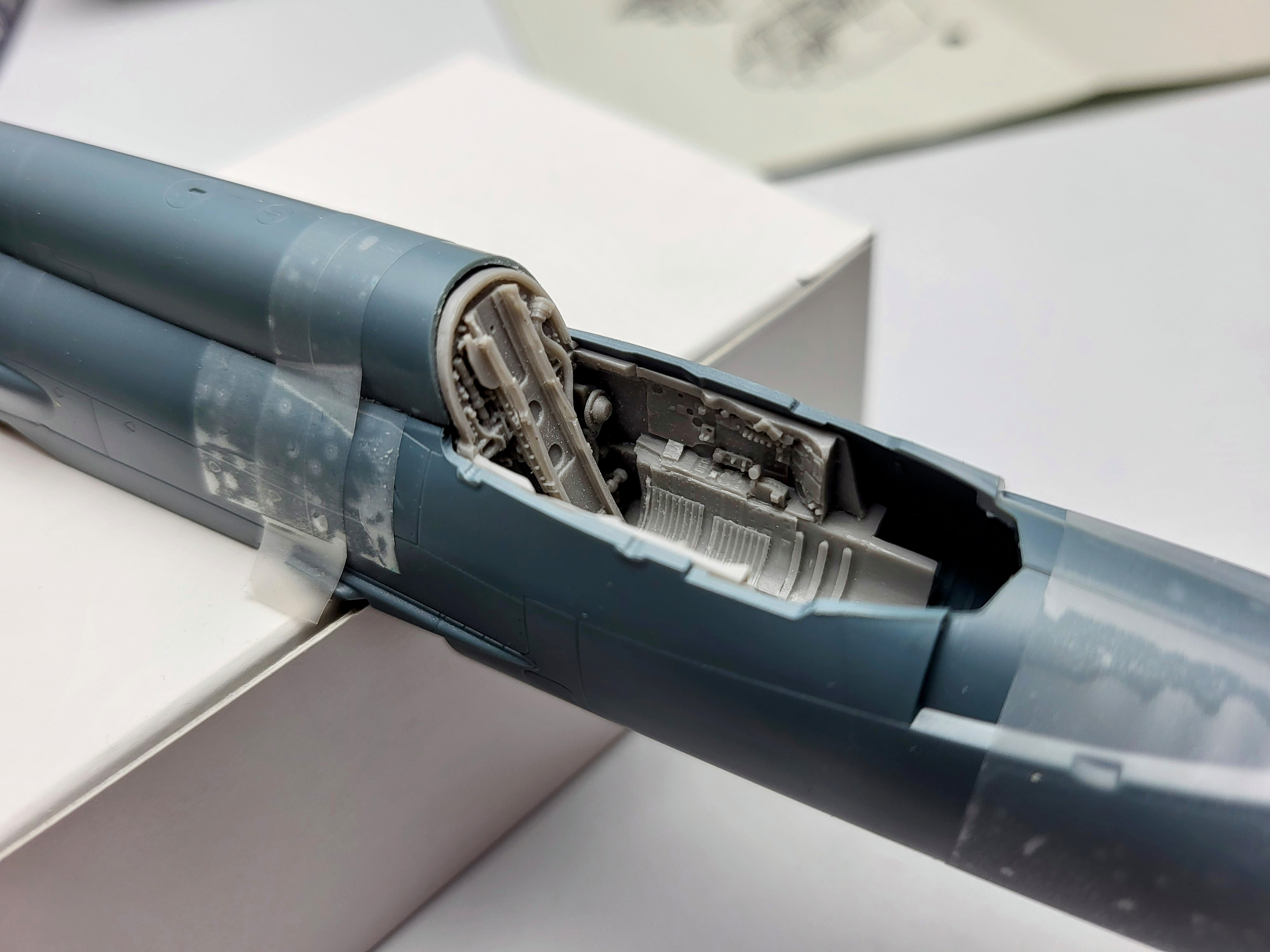

Architecto Posted February 7 Share Posted February 7 (edited) After many years of hobby inactivity, trying to get back with this 1/48 scale kit. Eduard Mig 21MF, Aires cockpit, metallic pitot tube, masks and ladder for diorama. First cut of the resin didn't go as I wish.. the Aires cockpit seems like it doesn't fit, not specified in the instructions so i have to cut the half bottom floor and make some adjustments to fit it correctly. I cut the eduard floor and supported the aires cockpit on the kit's plastic rail I thinned the spine with a round file and test fitt everything. All looks good.. Edited February 7 by Architecto Quote Link to post Share on other sites

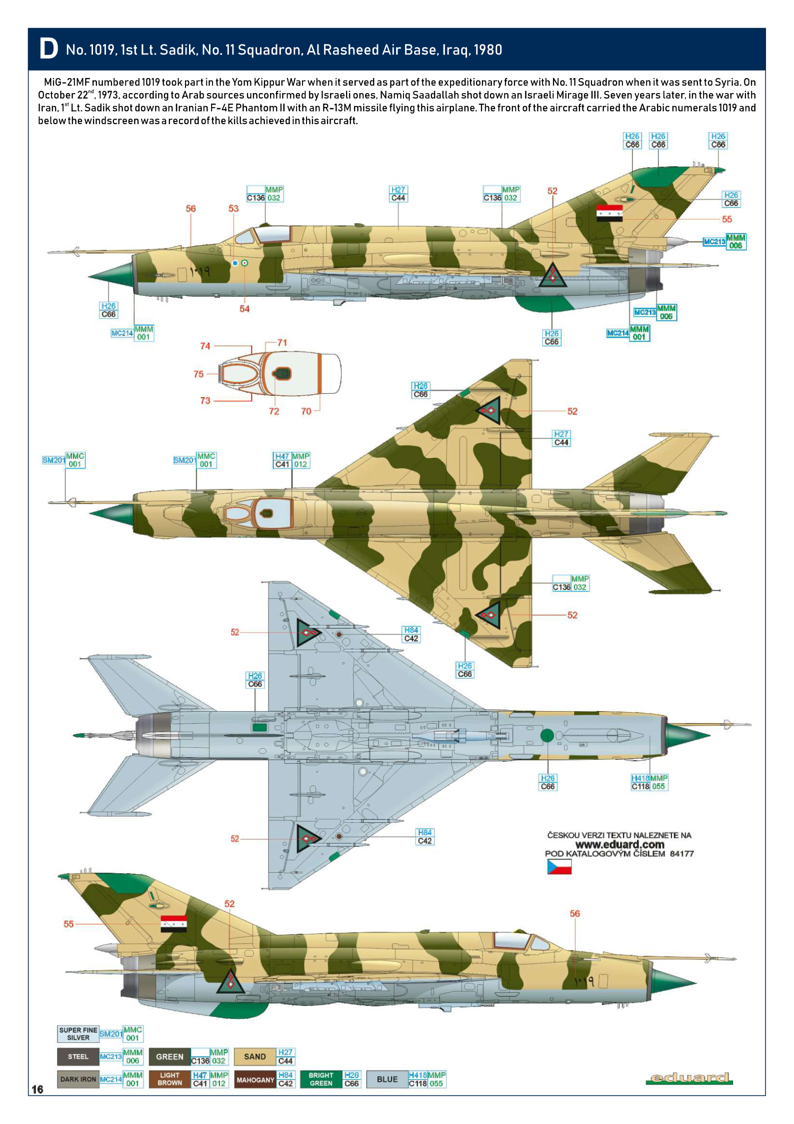

Architecto Posted February 8 Author Share Posted February 8 Hi RichB63 thank you, i am planning a camouflage Sand-Green-Blue used by Iraquis numbered 1019. Any further information about it would be helpfull. Image provided by Eduard instructions Quote Link to post Share on other sites
JackMan Posted February 8 Share Posted February 8 Welcome Architeco Good start. Aires cockpits always seem to have fit issues. Great solution when you thinned the spine. Quote Link to post Share on other sites
Architecto Posted February 8 Author Share Posted February 8 (edited) thank you JackMan yes i agree, they are beautifully detailed cockpits. I think they are customizable to each build. Edited February 8 by Architecto Quote Link to post Share on other sites

Thadeus Posted February 19 Share Posted February 19 Nice start. It looks like You have the cockpit handled. Nice work. Quote Link to post Share on other sites
