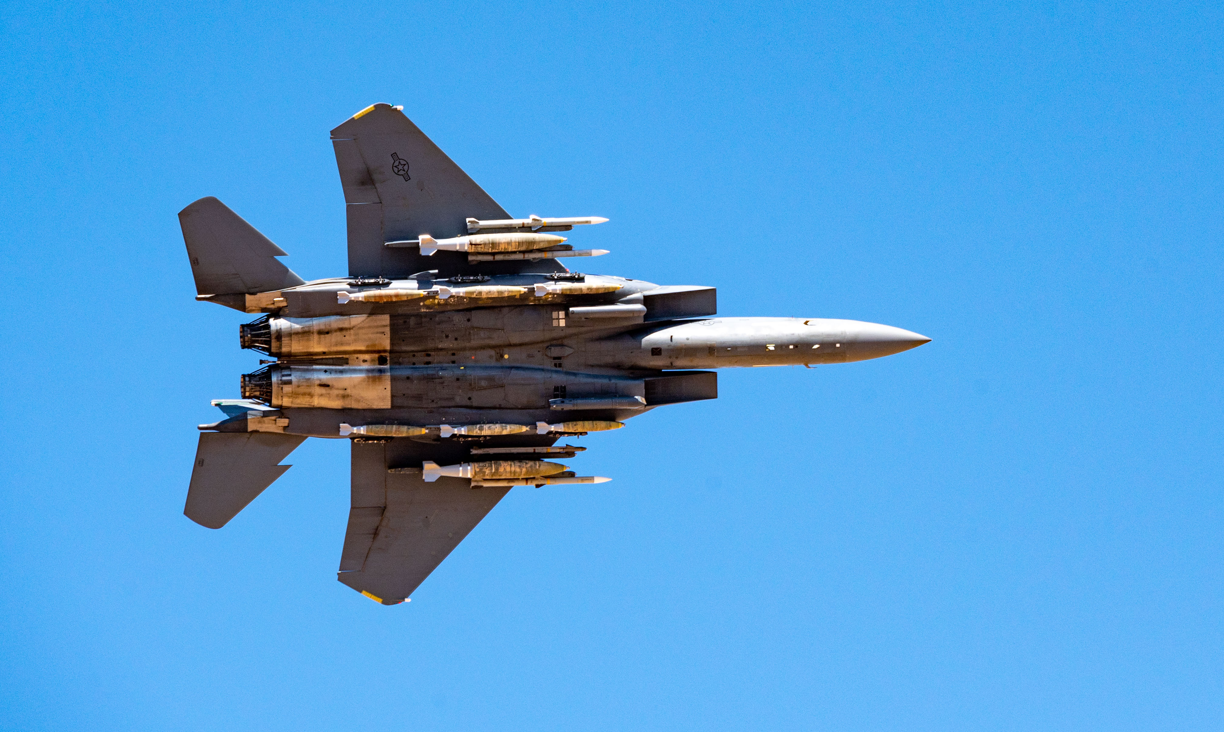

16 hours ago, Countess Isolde said:
Here's what I was thinking to start with:
    R wing                       R CFT                   Center                     L CFT                          L wing
120C    9M                   GBU-31 x2                  Fuel               GBU-12 x 4                    9M    120C
 GBU-39 x 4                                                                                                                   GBU-39 x4
Put the fuel tanks on the wings and GBU-39 on centerline, and you have a real life loadout as carried during ops over Syria. Photos on www.af.mil to support this loadout. Alternatively substitute the GBU-31 for GBU-38/54's.
This one is straight from the USAF central command FB page today, showing one of the currently deployed F-15E's from 389FS
Facebook
Edited by Niels
Facebook
Do you have a way I can find a picture of that exact loadout? Just to be sure?
Thanks for the ideas everyone. If my JDAM+SDB loadout is real (admittedly with SDBs on centerline) I'll use that I think.
