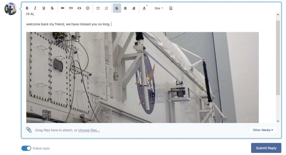

Hi Al,
welcome back my friend, we have missed you so long. :clap2:
Hope you can follow my short istructions. :whistle:

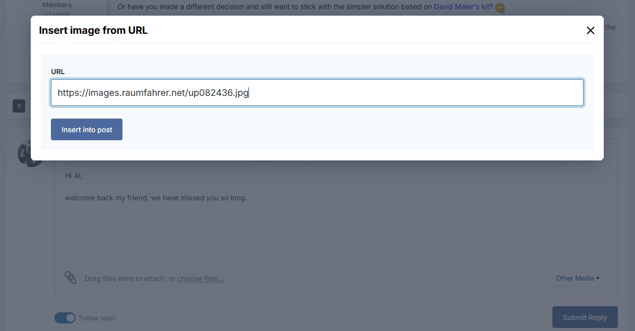

Klick into this Edit field and write your text.
Insert the URL of an uploaded image,
as I did with an own image of my Payload Canister, up040577.gif.b341536ce58742632bc215a5023ac6b3.gif
or choose an image file from your PC as I did with this last image Edit-6, and drag it then from the bottom to the place in your text, or copy the image below and paste it into the text.
Then put on Submit Reply. That's all.
Edited by spaceman

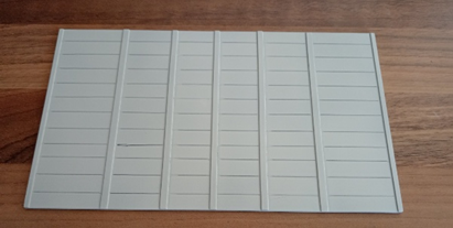

Hi All, It does seem a very long time since May 2023! where does the time go? many things have happened along the way, but now I am back to the Crawler again. Many Thanks Manfred for all your help. This brief update shows the completion of the roof. The base styrene had yellowed over the time.
This is the original roof, this showed signs of "yellowing"
Some primer applied and lines scribed.

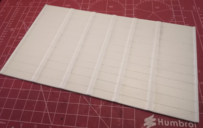

A thin coat of flat white applied, needs to appear weathered
Finished roof cover now placed on the Crawler, onwards and upwards. Let's get these walkways on the go..... till the next update soon.
