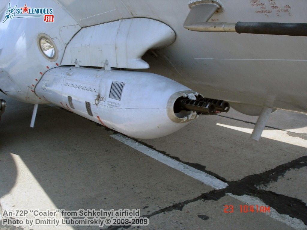

f5guy Posted February 20, 2023 Author Share Posted February 20, 2023 Hello again! So here's some pics of subjects that I am considering. Unfortunately, to my knowledge, none of these aircraft have been represented in decal form. Being one of those kits that one seldom sees built, there is virtually no aftermarket for this kit other than a few decal sheets from BS Model. Some resin wheels would be most welcome. Hello, Res-Kit, Armory?! All of the aircraft pictured I am considering as my subject. The biggest problem is going to be finding sufficient reference pics for the camo.... specifically I'll need a left and right side shot, and at least some elevated shots for the upper camo. Thus far I have only come across a limited number of pics, so if you've got some of any of these aircraft, please feel free to share! Thanks, Fred. Here are the contenders: Quote Link to post Share on other sites

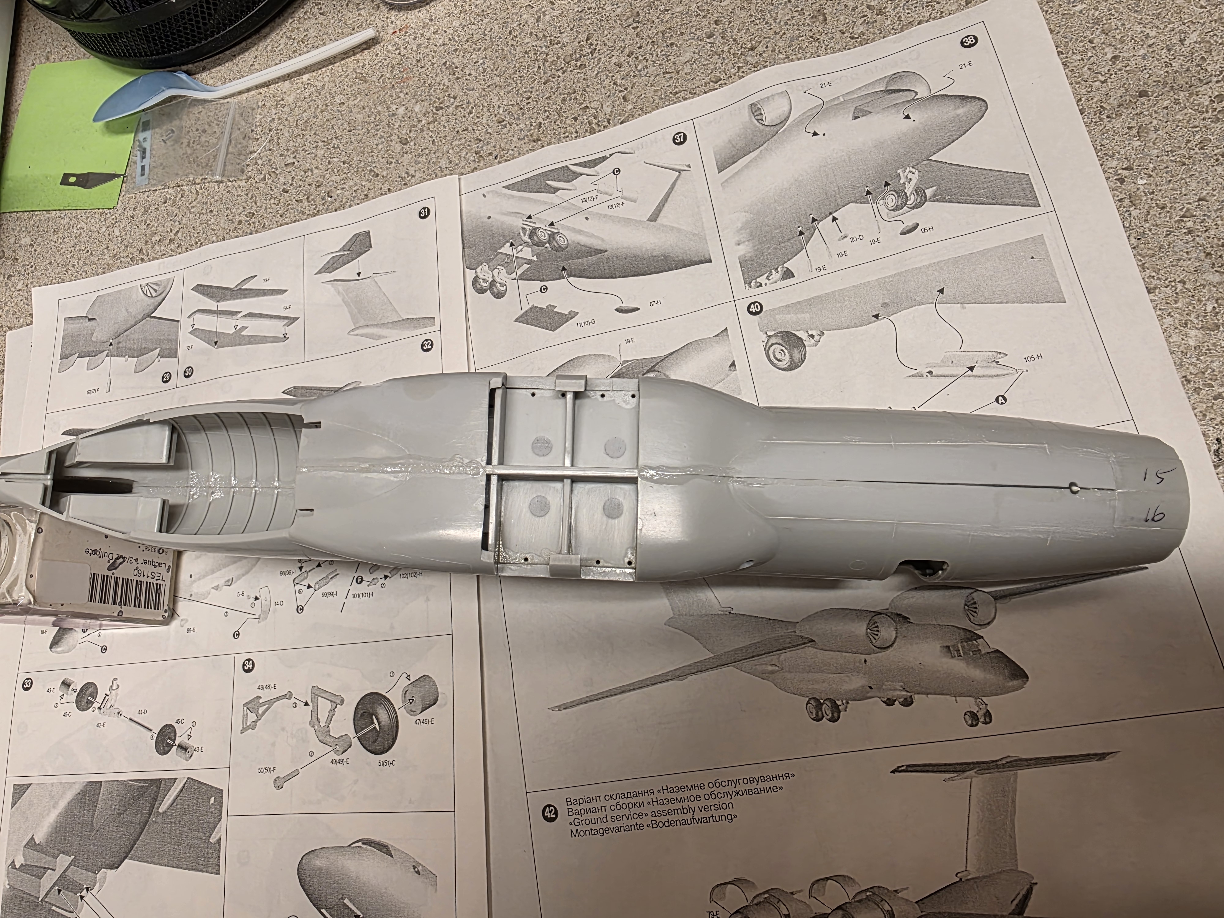

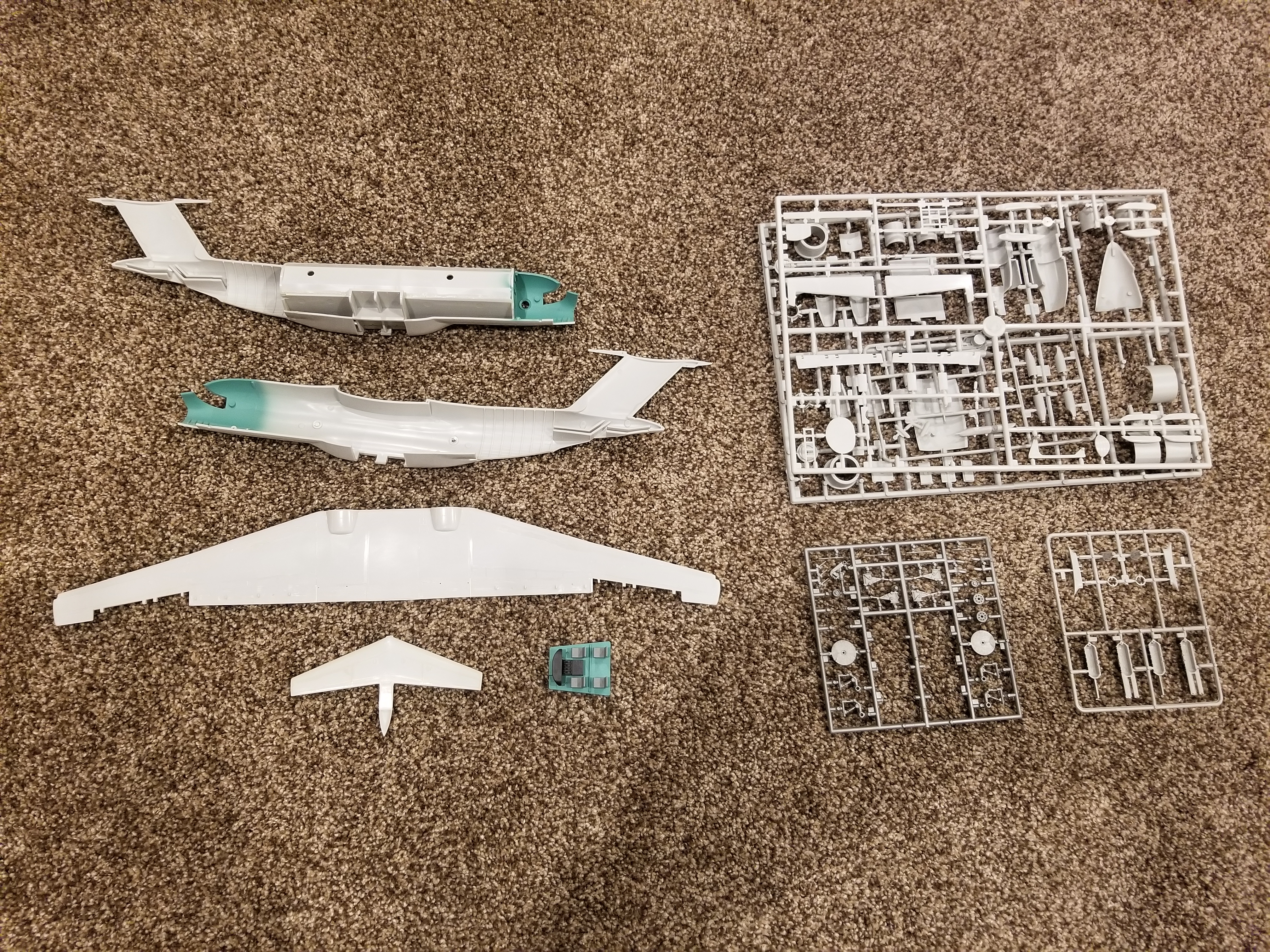

f5guy Posted February 20, 2023 Author Share Posted February 20, 2023 (edited) So here's where I'm restarting at. The cockpit is largely done. Having built these "airliner" type jets before, you can see virtually nothing in the cockpit once its done, so its usually pointless to go crazy with the detail. The kits control columes are grossly oversized, being more like 1/48th scale. But again, you won't be able to see much, so I'll use them anyway. The rear cabin door will be closed, so I didn't even bother to paint its interior. However, the kit detail in that area is surprisingly good should you choose to leave it open. There is an APU unit located in the right rear sponson that will have to be replicated, and the landing lights in both forward sponsons will have to be enlarged. I will use MV lights for these. Last night I rescribed the bottom of the wings, and will work on the top tonight. The stabilizers had already been rescribed 23 years ago! I had to file down the forward right side of the rear cabin section to get the fuselage halves to fit properly. The cabin is a really tight fit into the fuselage. Also, you may have noticed that the main gear well is a little offset to the front for the door openings, leaving a gap at the rear. I'm not sure how I'll tackle this, but likely I'll just extend the rear fuselage bottom to cover the gap and adjust the gear doors if necessary. Otherwise it might turn into a really complex fix. All for now. Fred. Edited February 20, 2023 by f5guy Quote Link to post Share on other sites

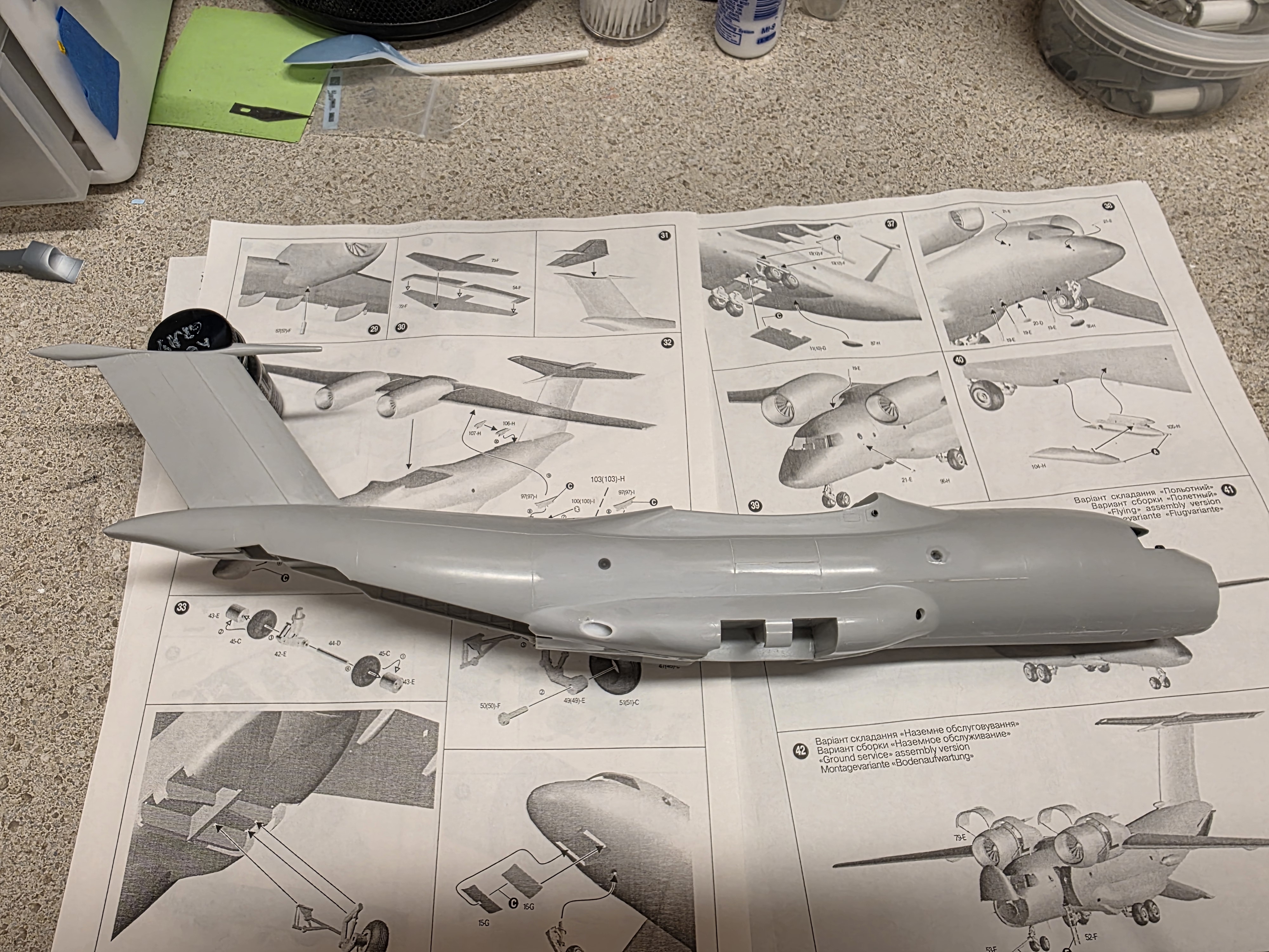

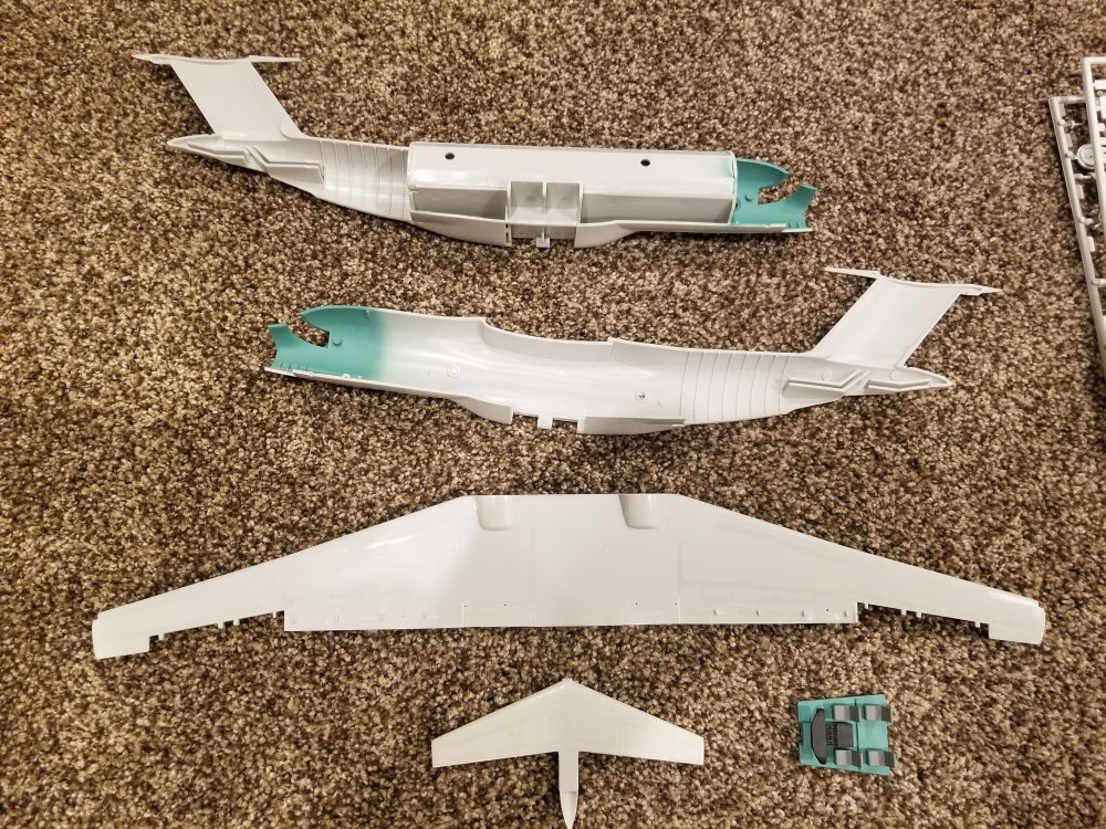

f5guy Posted October 5, 2025 Author Share Posted October 5, 2025 (edited) Hi everyone, Now that I am retired, I finally had some free time to make the local model club meeting for the first time in 15 years. They are currently having a "Trash Hauler" group build that includes all variants of any cargo aircraft. I decided to jump in with this An-72 build after considering several other options first. To that end, I have been chipping away on this build for the last several days now. I got the fuselage halves together after a LOT of gap filling super glue and accelerator (pic 2). In the side view you can see that I added the APU vent towards the rear of the left gear sponson. Also added were small vents at the forward shoulder area of the wing root. This was done with stainless steel tubing. Both were done before manhandling the fuselage halves together (pic 1). I also got started on the engines, and in the last pic you can see that test fitting them to the wings reveals more gap filling fun ahead 😂 All for now, Fred. Edited October 5, 2025 by f5guy Quote Link to post Share on other sites

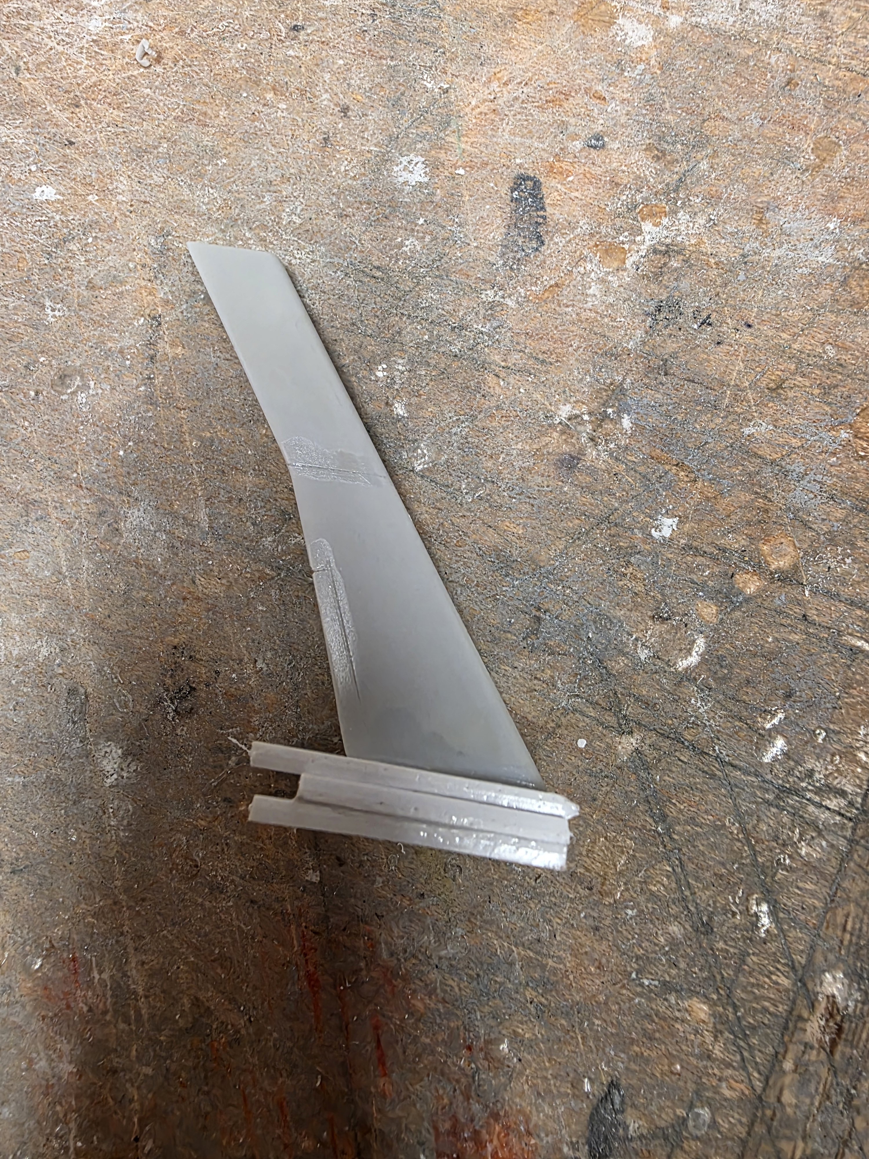

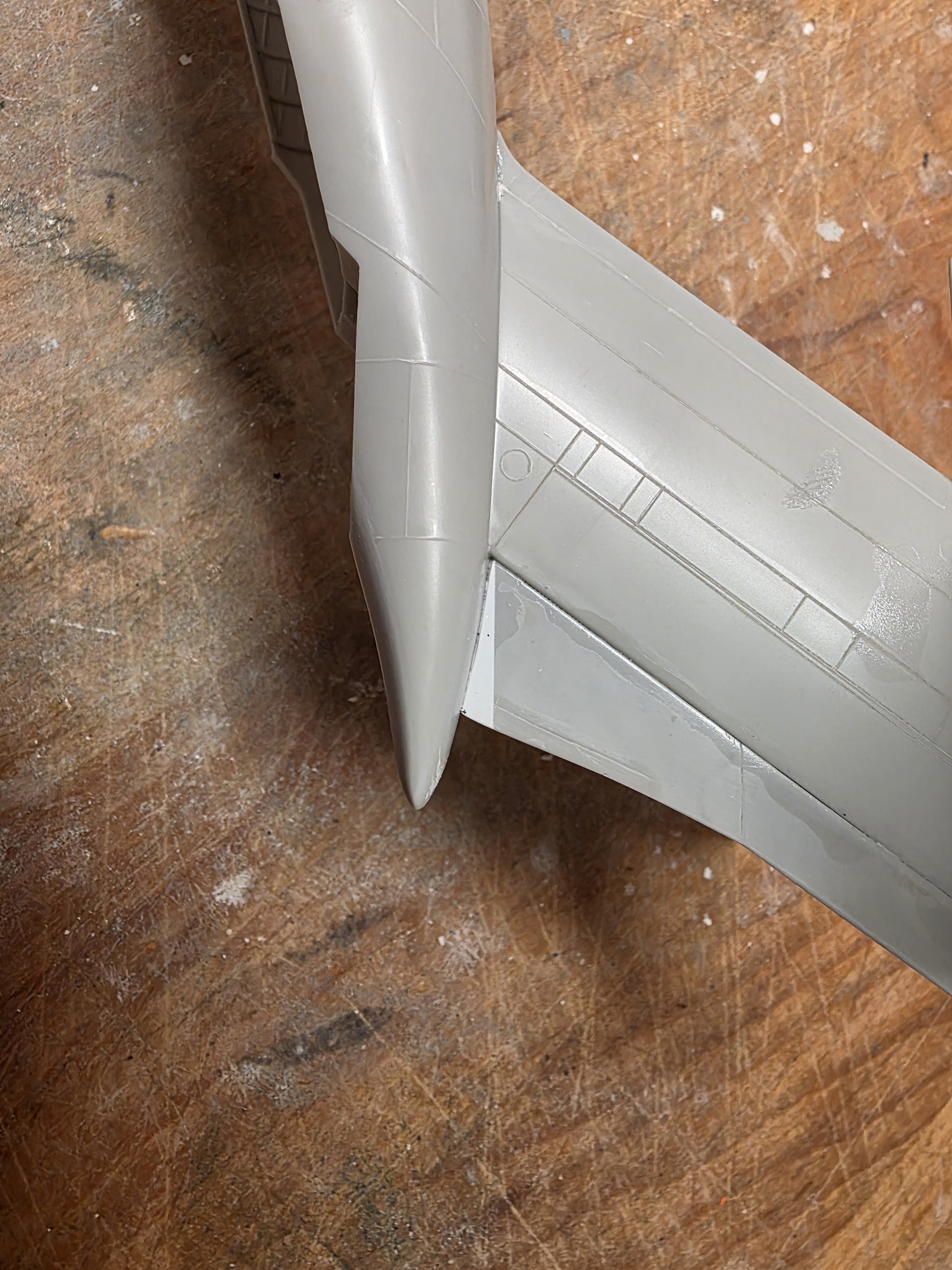

f5guy Posted October 12, 2025 Author Share Posted October 12, 2025 Hi everyone, A quick update on this build.... For whatever reason, the kits rudder does not extend all of the way down to the tail sponson, so a new one had to be made. I used several layers of scrap plastic to do so (pic 1). And the result (pic 2). This kit is a real slug fest, but should be quite eye catching when done 👍 Fred. Quote Link to post Share on other sites

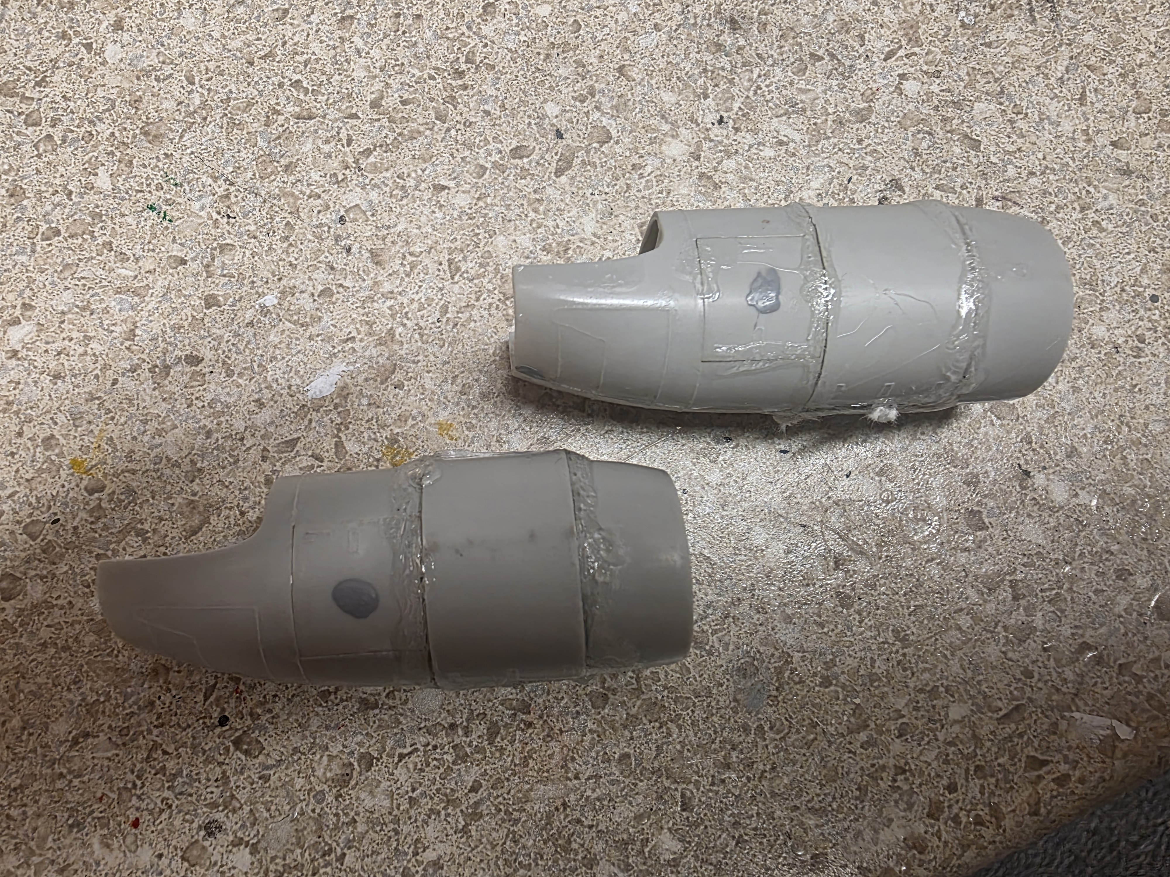

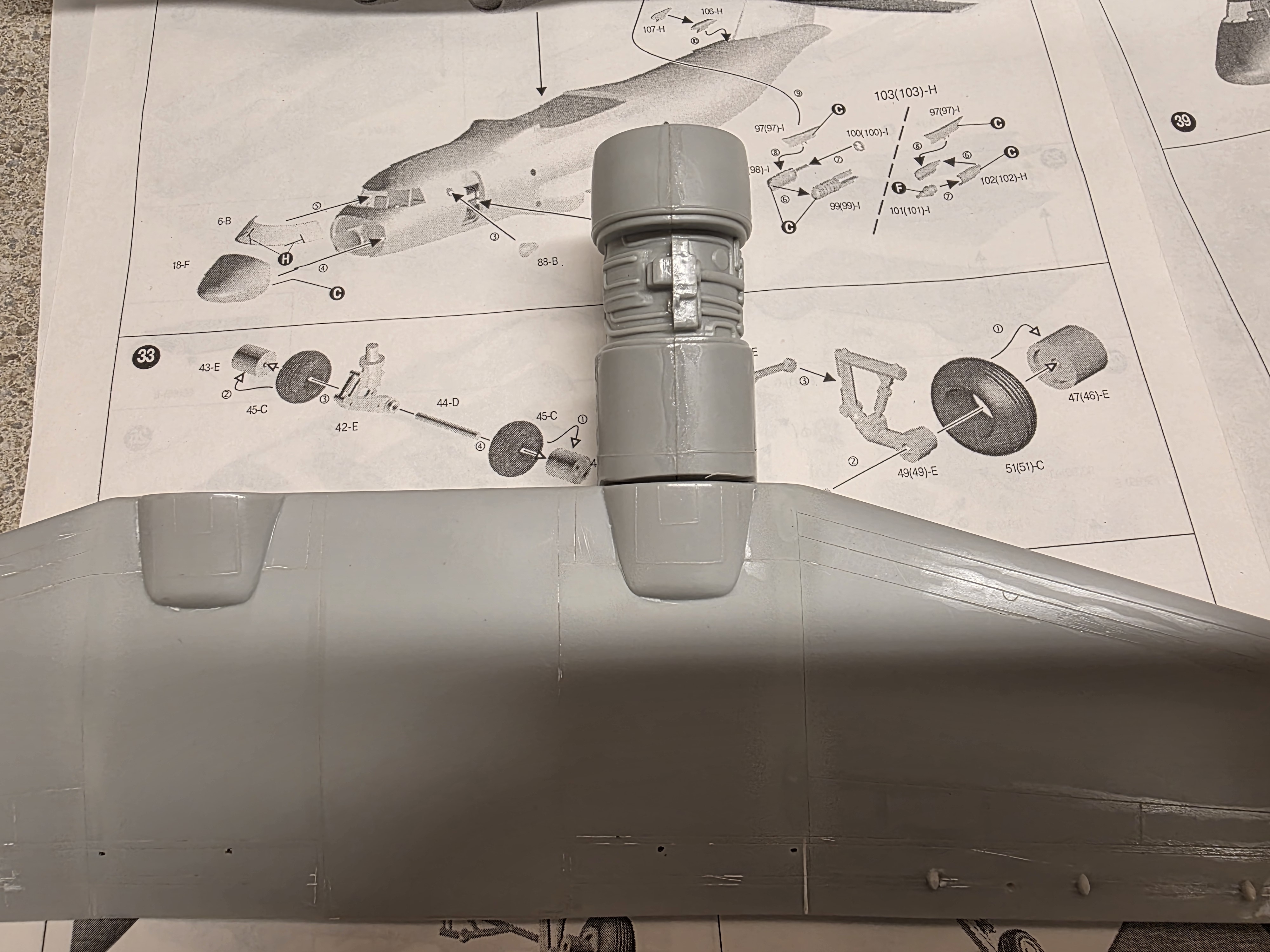

f5guy Posted January 26 Author Share Posted January 26 (edited) Hi everyone, I've been slowly chugging along on this build while finishing other projects. I've got the fuselage re-scribed now, and all parts except the engines ready for final assembly. Ahhh yes..... the engines... The kit provides three individual maintenance doors per engine. Only one of them fits reasonably well. The large one on either side of the engine cowling... not so much. Okay, barely at all. These are far and away the worst fitting parts of a kit that doesn't fit that well anyway! See pic below. Not much to do but slather on the gap filling super glue, hit it with accelerator, and grind away. I ended up using a file to grind away all of the glue and excess plastic from the ill fitting doors. After two hours of filing, and grinding with the coarsest sanding sticks that I had, the engines were looking pretty reasonable. Next will be a primer coat, sanding, and rescribing. I thought about building another one of these Border Guards "Coalers", but after this one.... I think I'm done, and will just sell off the kit that I bought. All for now, Fred. Edited January 27 by f5guy Quote Link to post Share on other sites
Dutch Posted January 26 Share Posted January 26 Fred, This looks worse than a Mach 2 kit! Ouch! Courage, Braveheart! 😉 Dutch Quote Link to post Share on other sites
