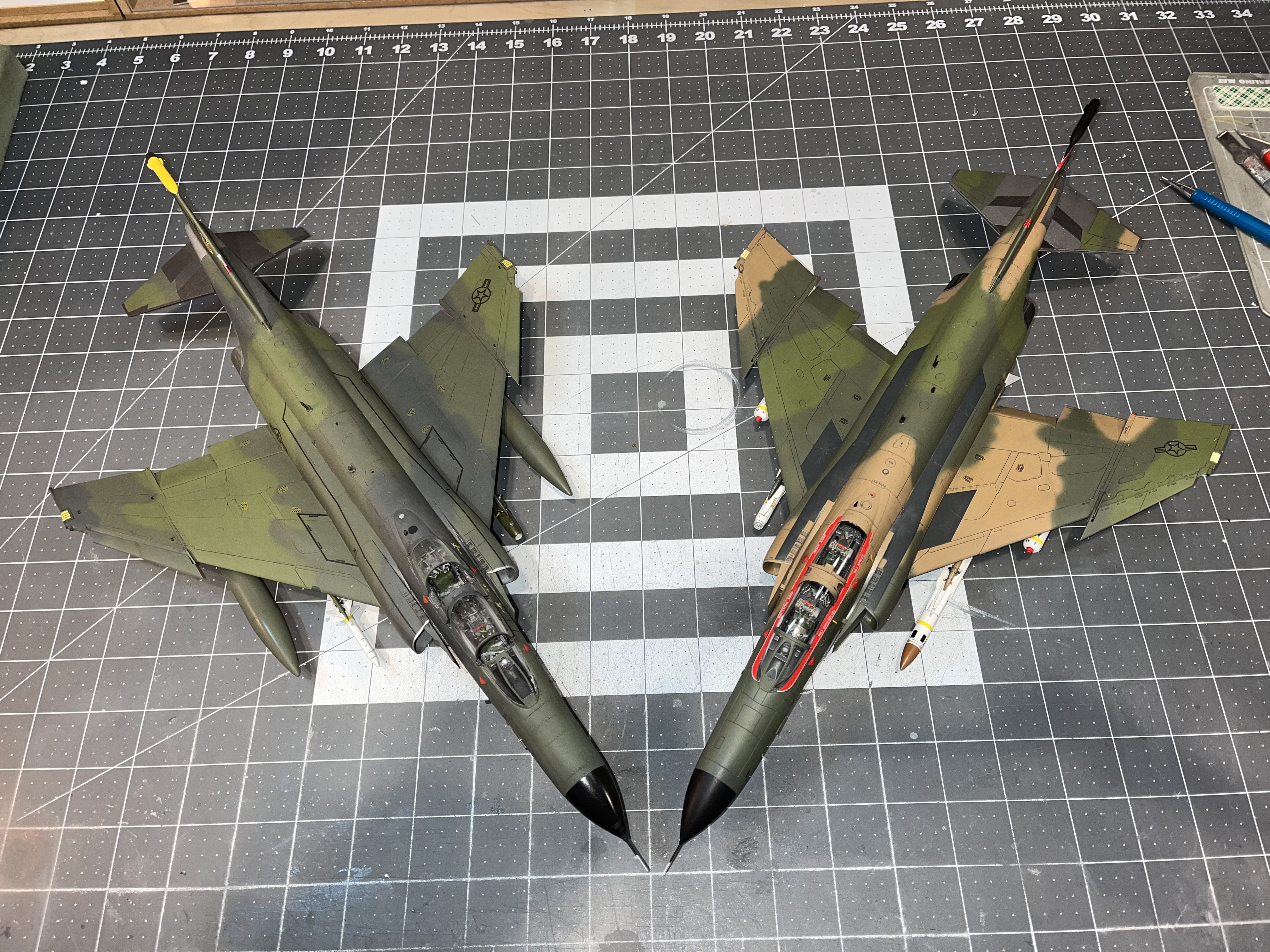

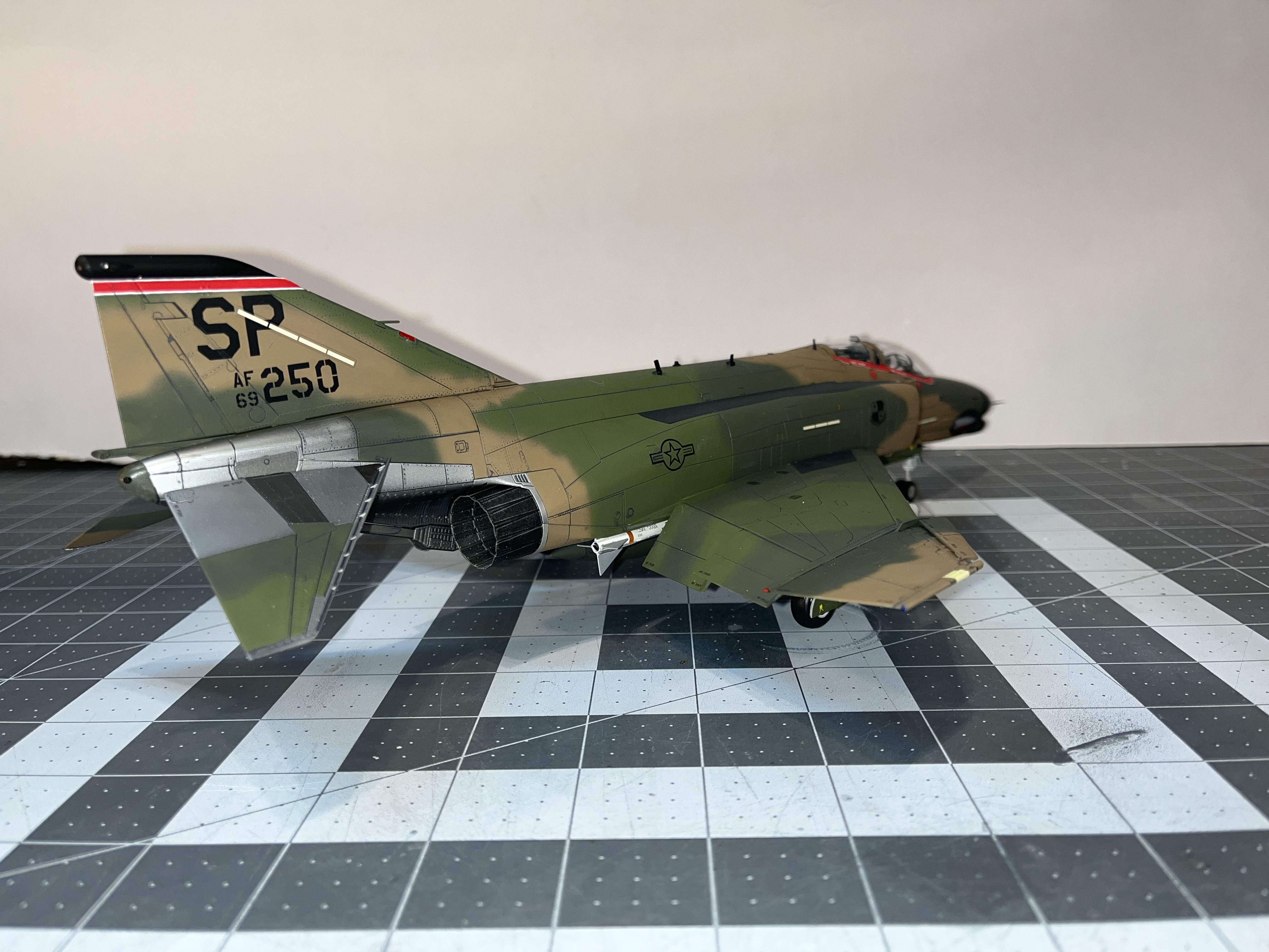

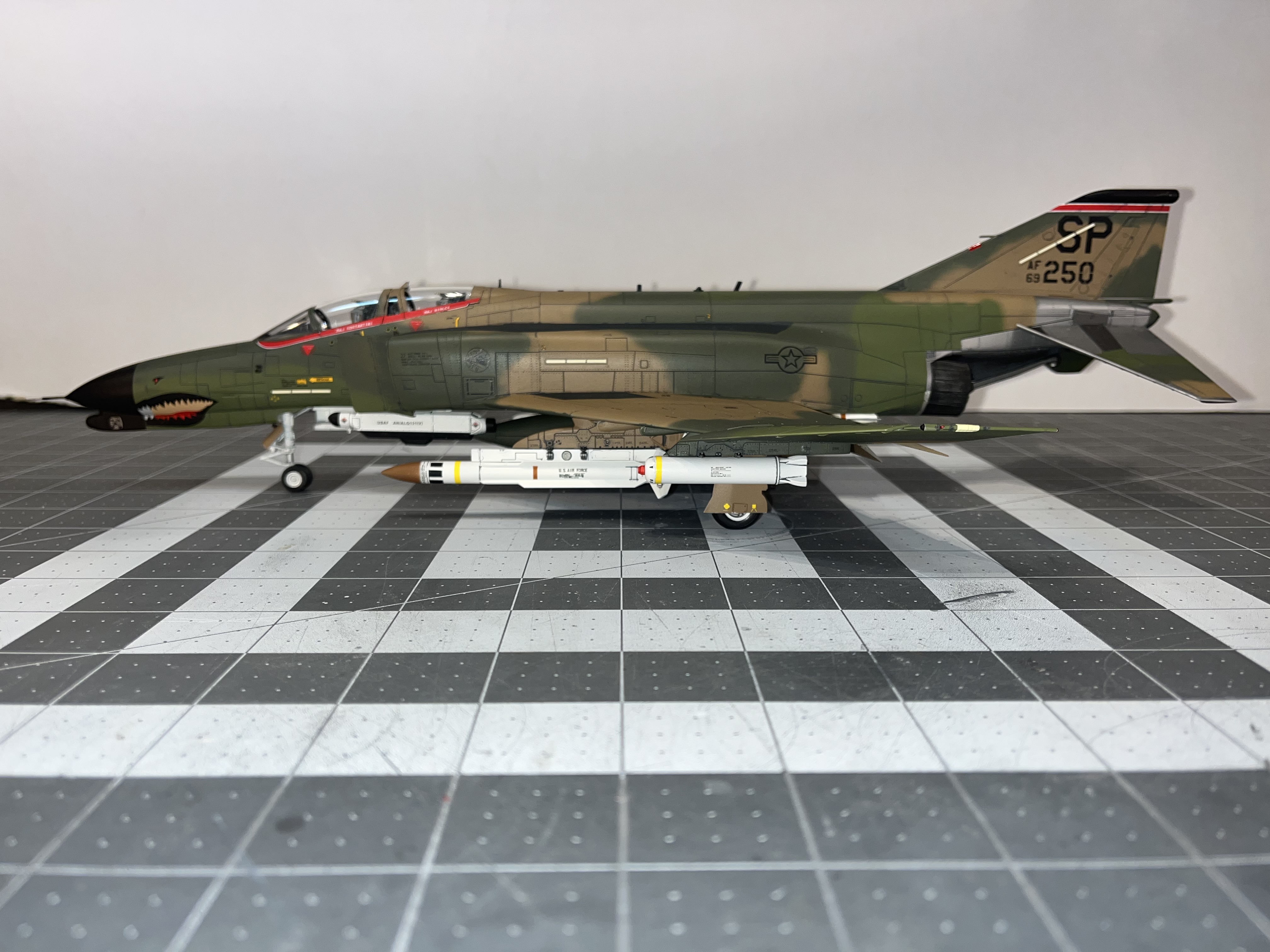

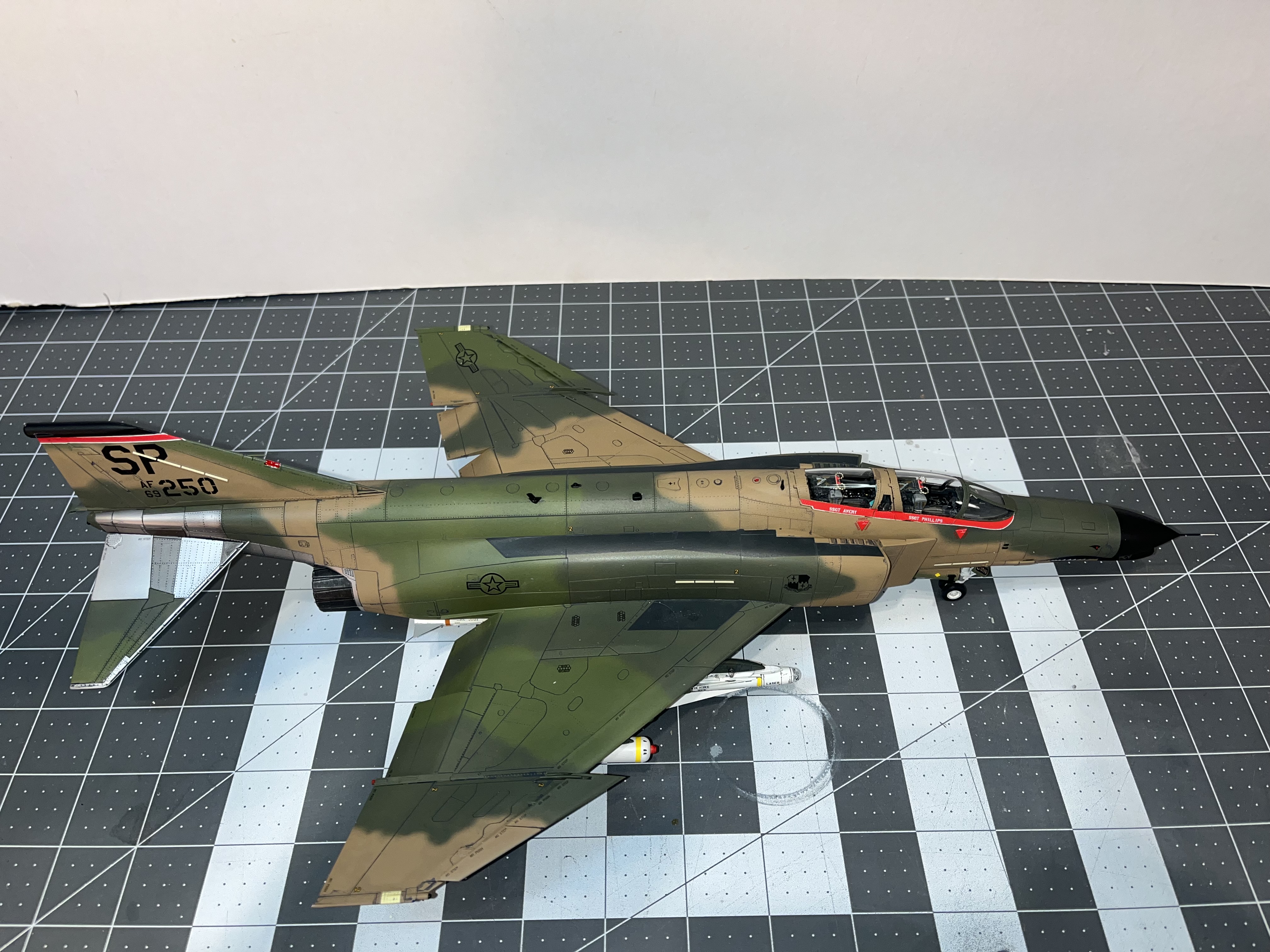

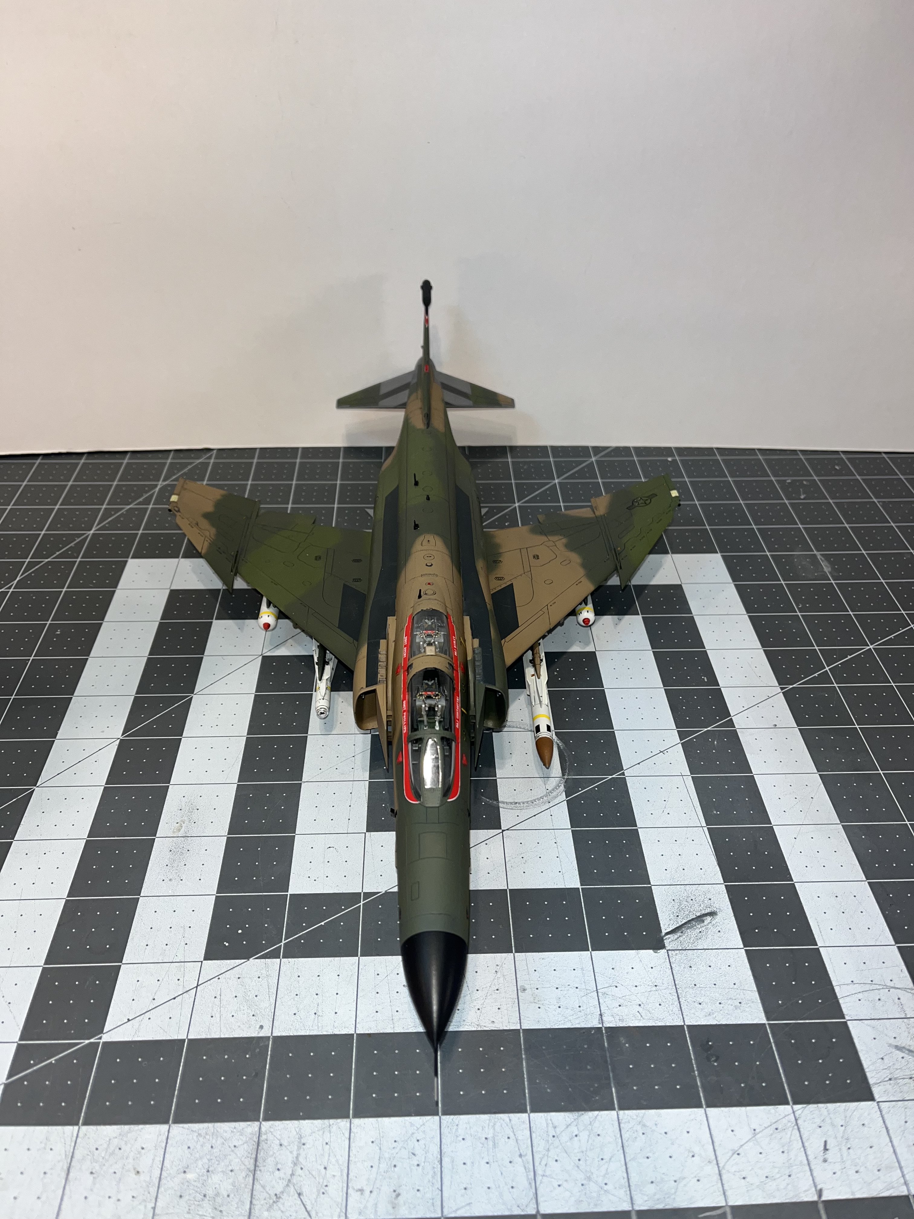

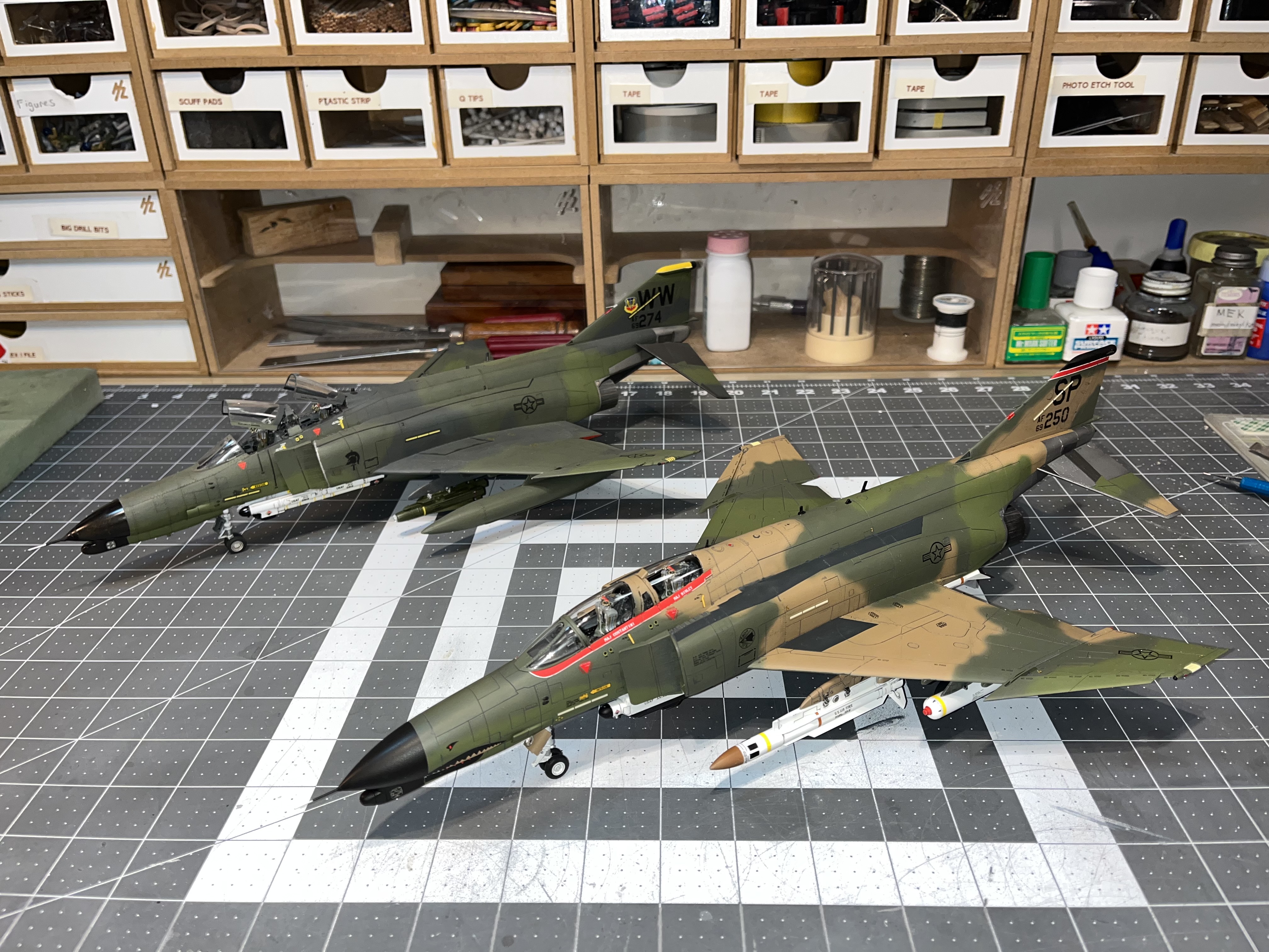

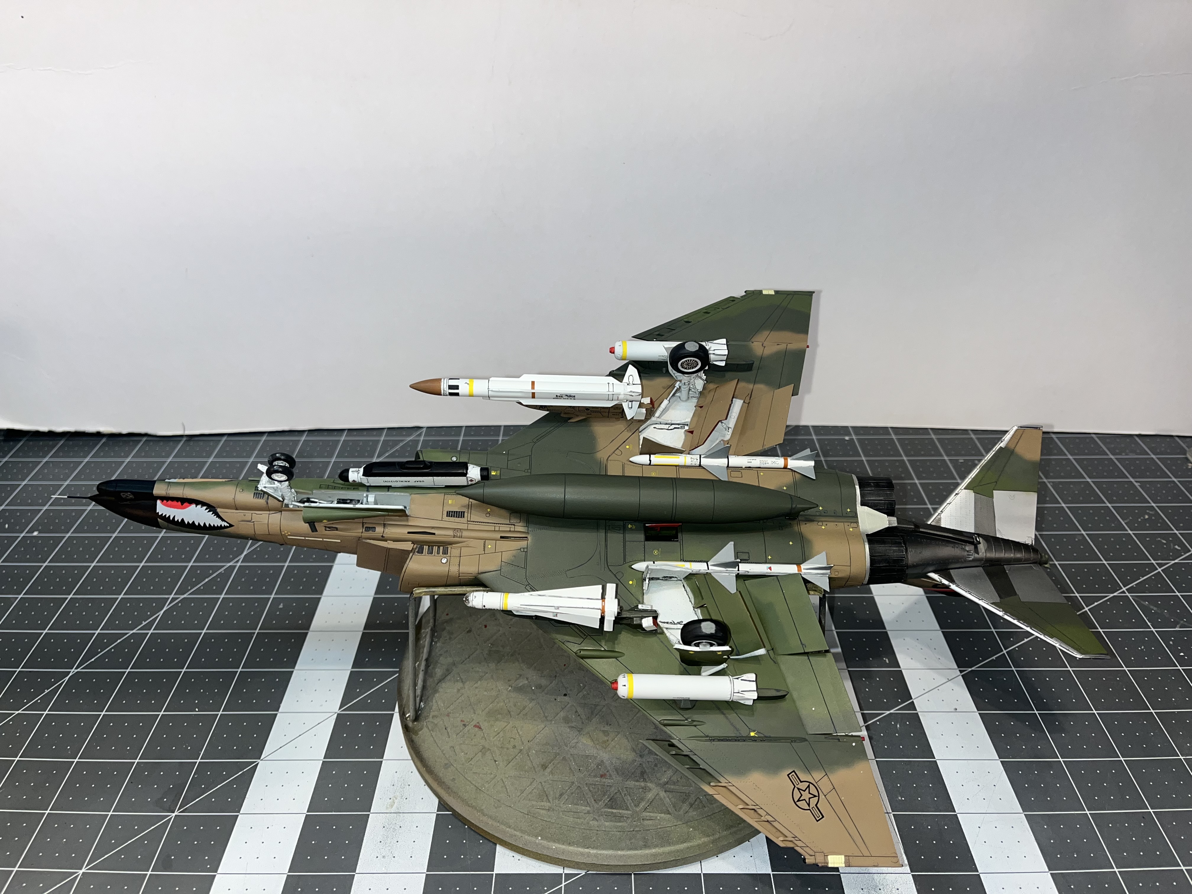

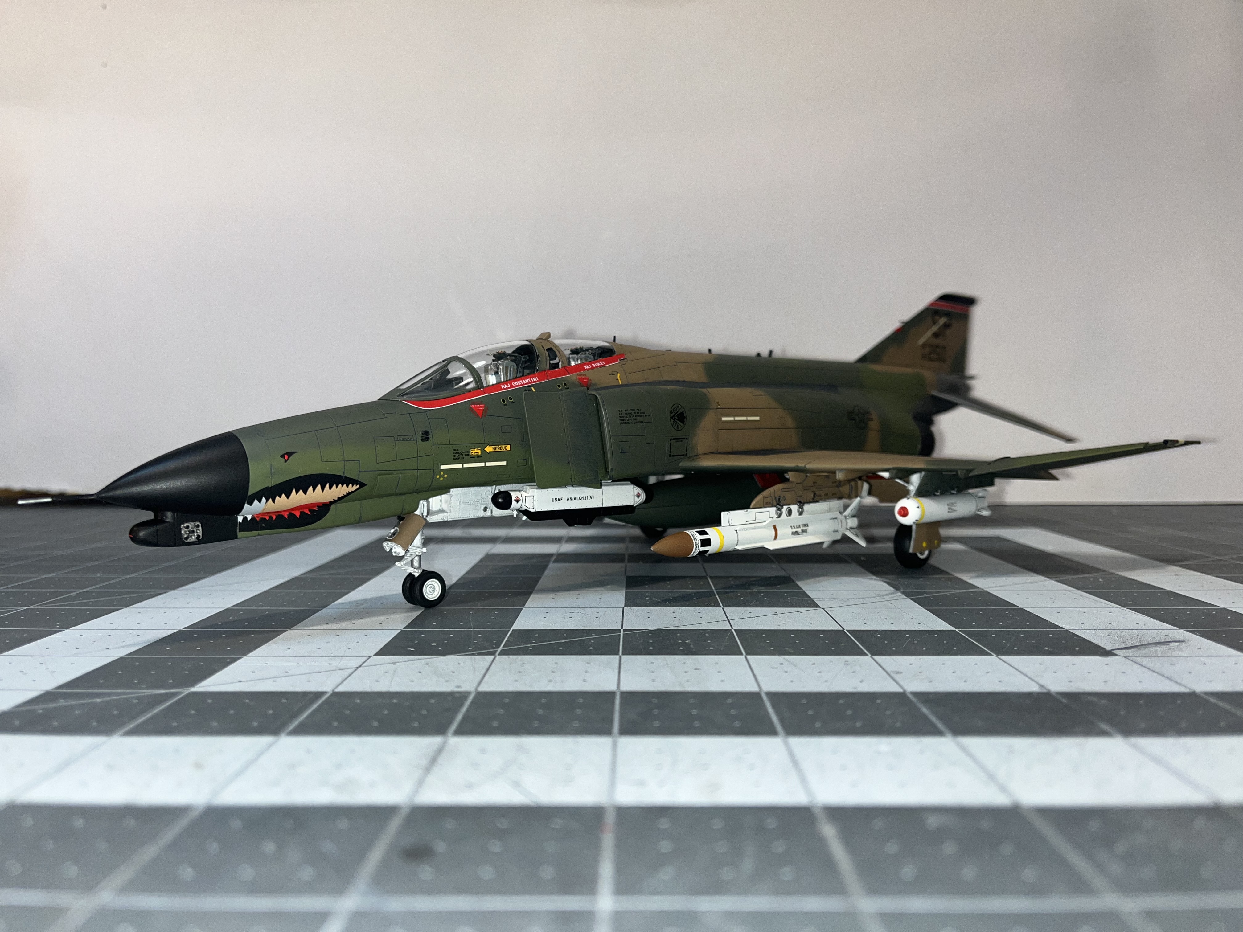

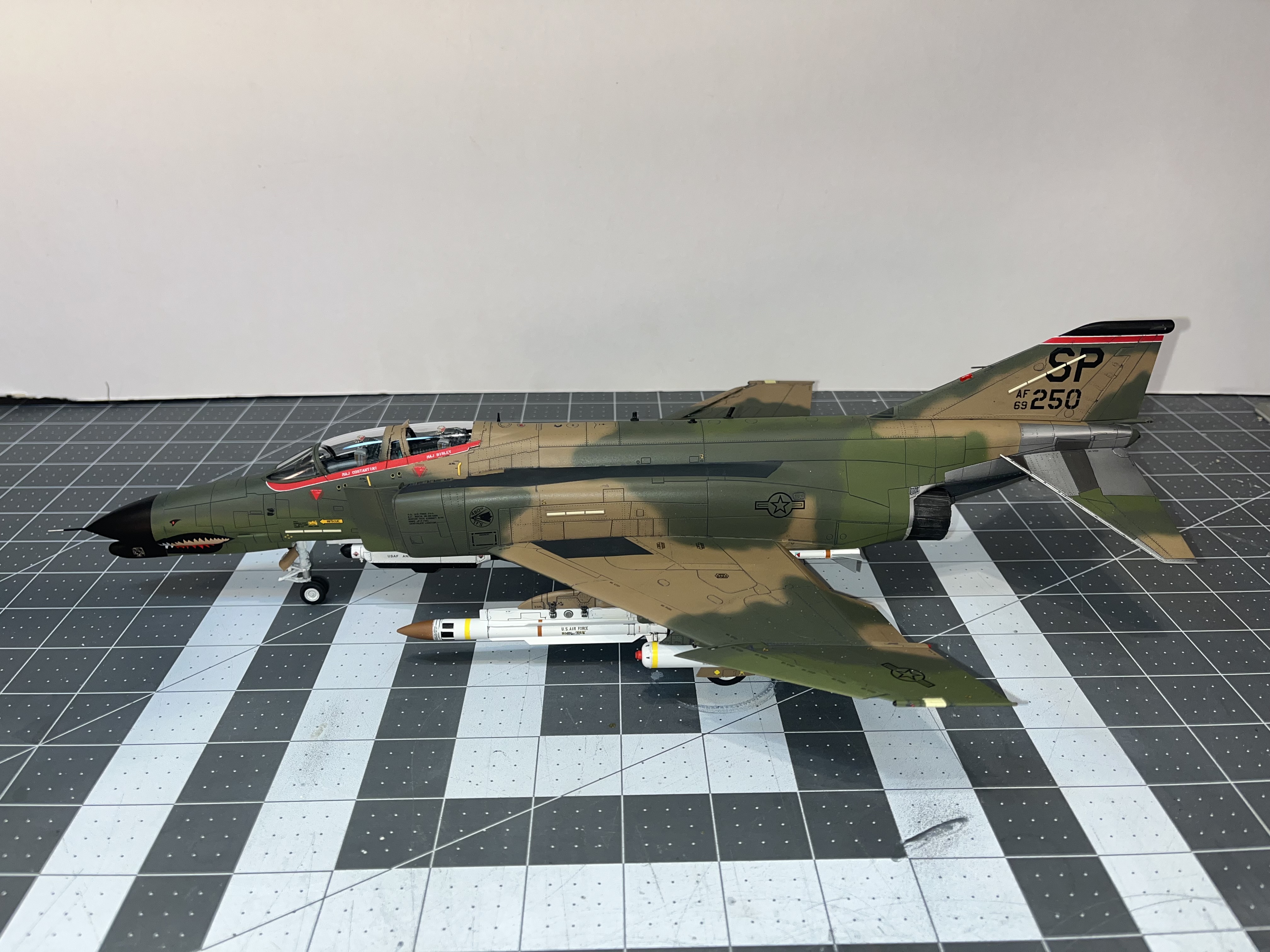

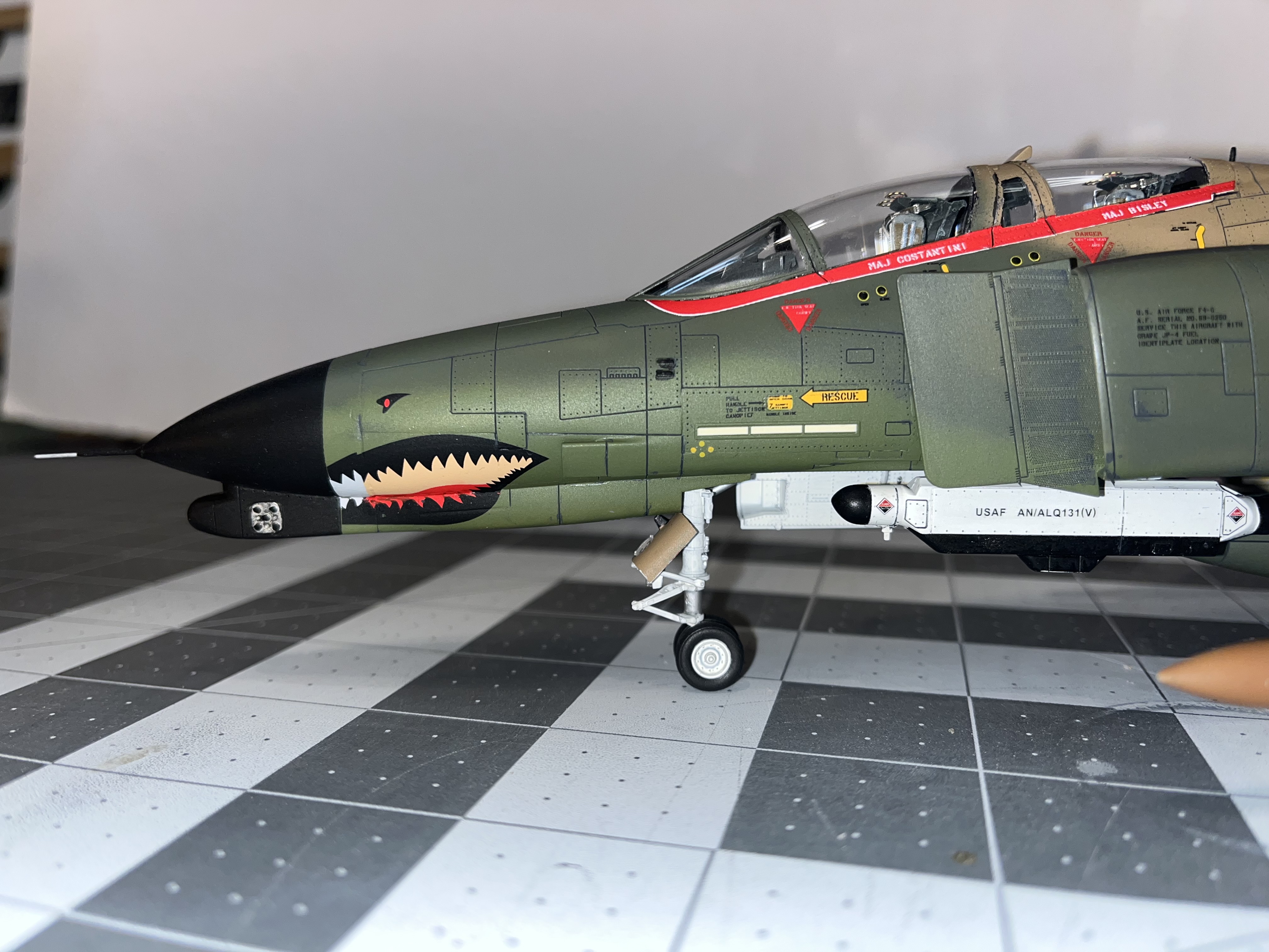

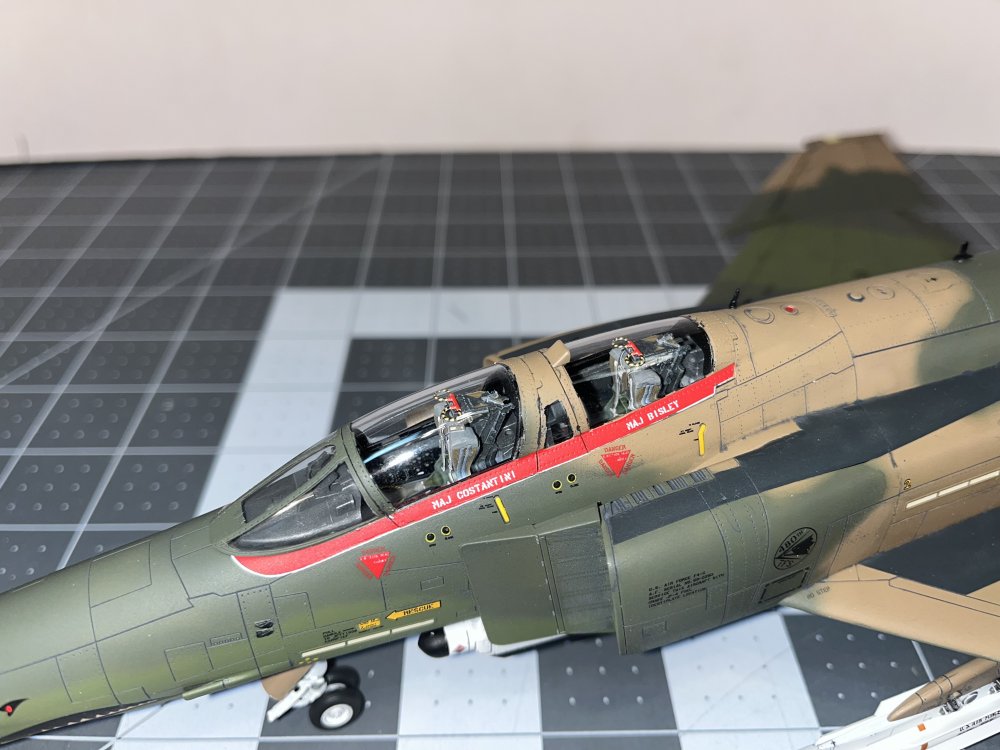

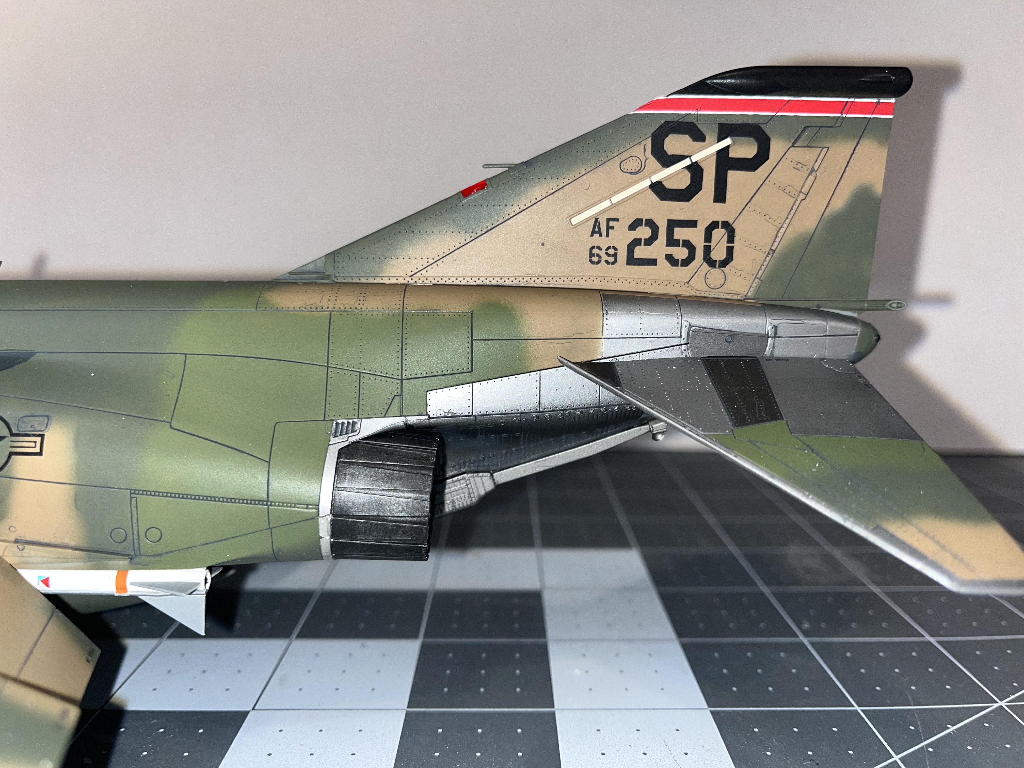

Geoff M Posted February 21 Share Posted February 21 (edited) This is my first Meng kit and it was an enjoyable build. It certainly looks like a Phantom. I have built quite a few Phantoms and I will rate this one high on the scale of true phantomness. I do have a few nits: All F-4G's had the belly strap, Meng does not supply it; The ejection seats look like an afterthought, no seat belts and no pilots to cover the lack of seat belts; The G models have the characteristic 3 antennas on the spine and Meng has the spots to place the antennas but only supply 2 of the antennas omitting the middle one. The wing tips look more like the wings on C, D, B models lacking the small extension for the ECM warts. The gun gas vent is engraved on the nose (easily remedied with a little putty). Lack of the stationary intake braces. On the plus side; the horizontal tails (though they aren't horizontal) are an ingenious design, moveable, and very sturdy. Parts fit is excellent, and detail is too. Many parts snap into place and glue is unnecessary in many cases. It is especially nice that the canopies fit so well that they can be attached without glue and removed later to mount open if desired. The rear lower fuselage can be done in your favorite bare metal finish and be attached after painting the rest of the plane eliminating the need for masking. A full complement of weapons (Mavericks, Standard ARM, Sparrows, 2 different ECM pods) dating from the early days of F-4G operations up to the current AGM-88 HARM with full appropriate markings supplied. The Speed Hunter Graphics decals were excellent as usual with a bunch of offerings from each of the operational users. I will be using them again on my Z-M F-4G. Here are some photos: Here is the current effort along with a Hasegawa F-4G I did late last year. Edited February 22 by Geoff M Quote Link to post Share on other sites

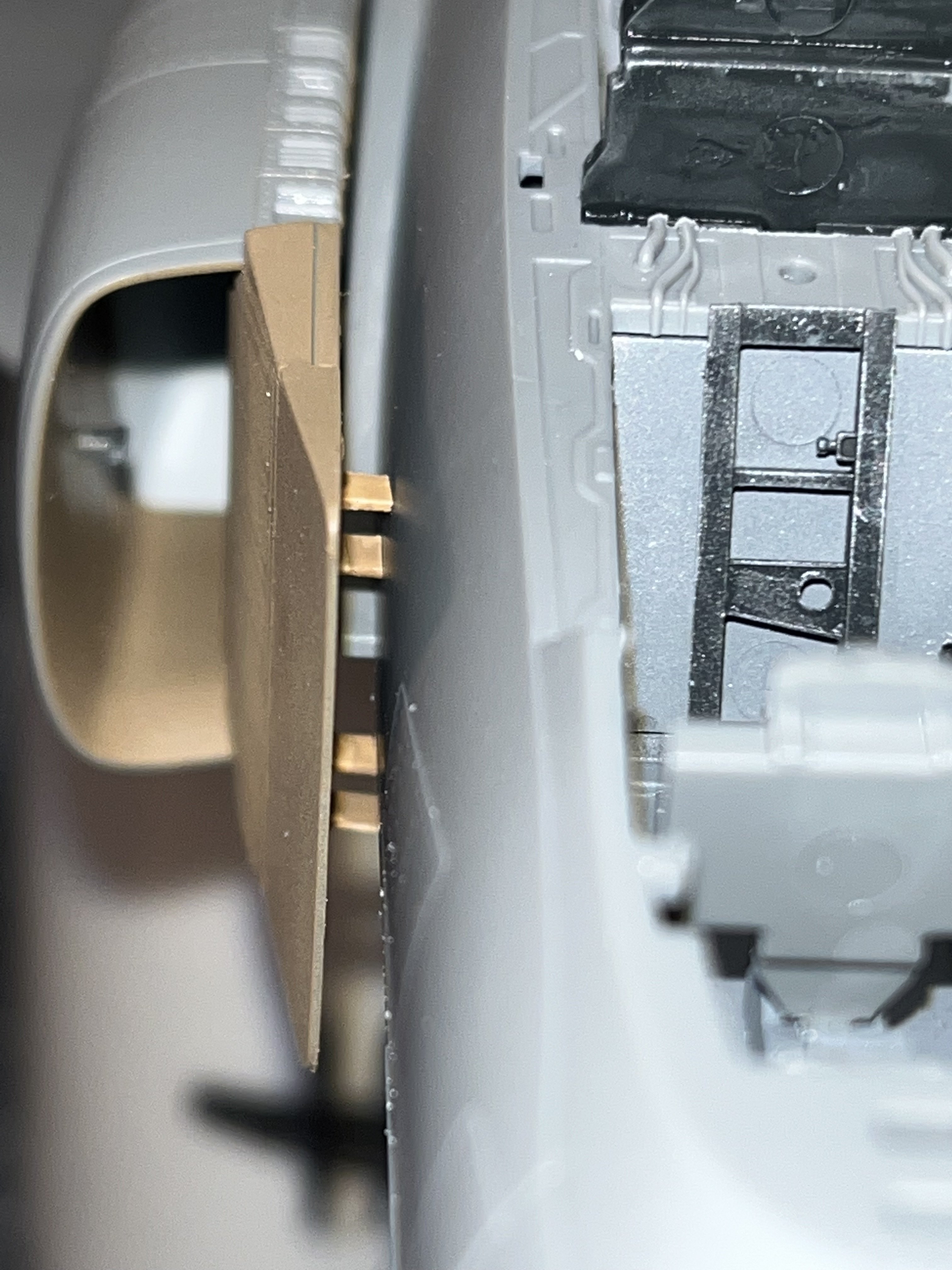

arnobiz Posted February 21 Share Posted February 21 Very nice build, thanks for the detailed list of things that need fixing! What are the stationary intake braces? Quote Link to post Share on other sites
Geoff M Posted February 21 Author Share Posted February 21 (edited) There are 4 of them on each side of the fuselage, attaching the external section of the intake (stationary intake) to the fuselage. Easy to miss but once you know what to look for you can't not miss them. HTH. Here is my effort to replicate them: Edited February 21 by Geoff M Quote Link to post Share on other sites
