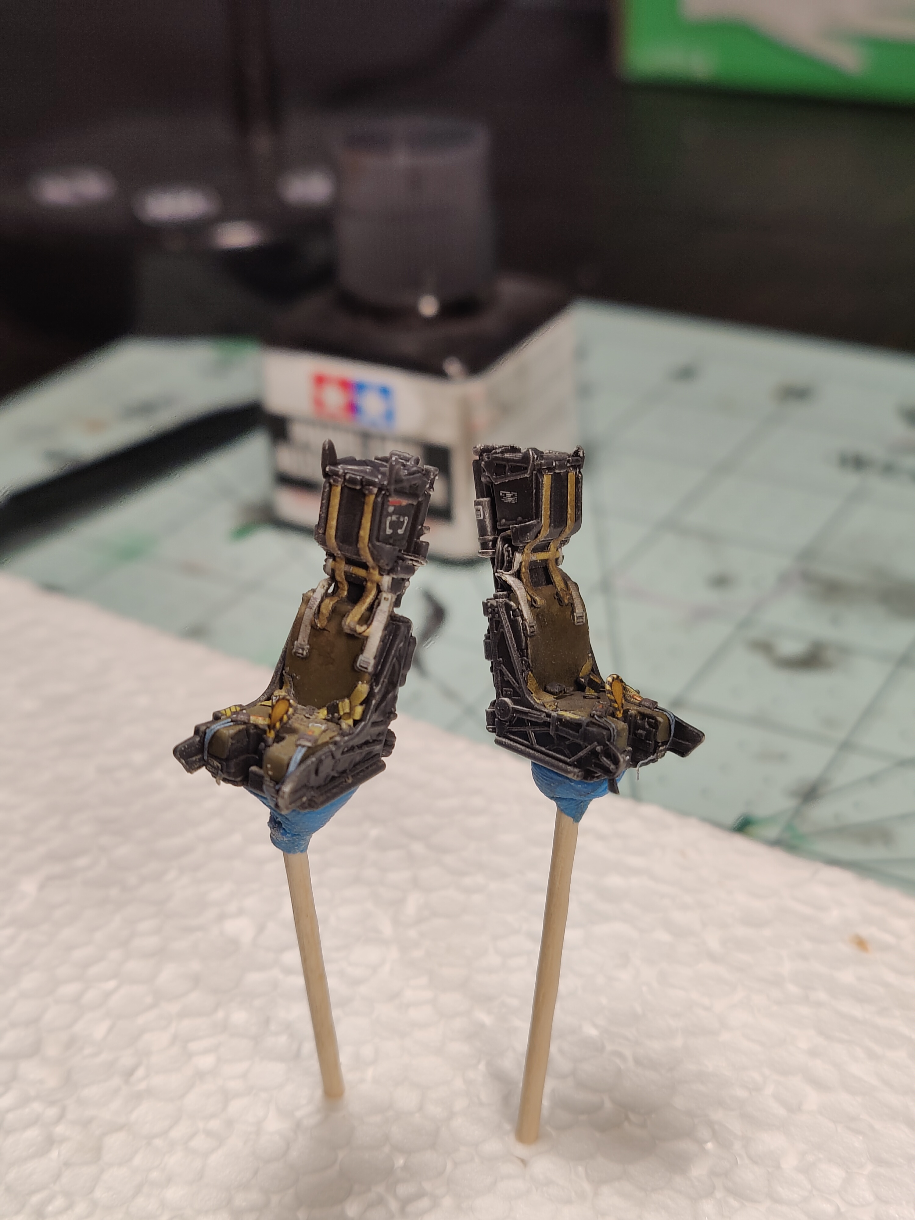

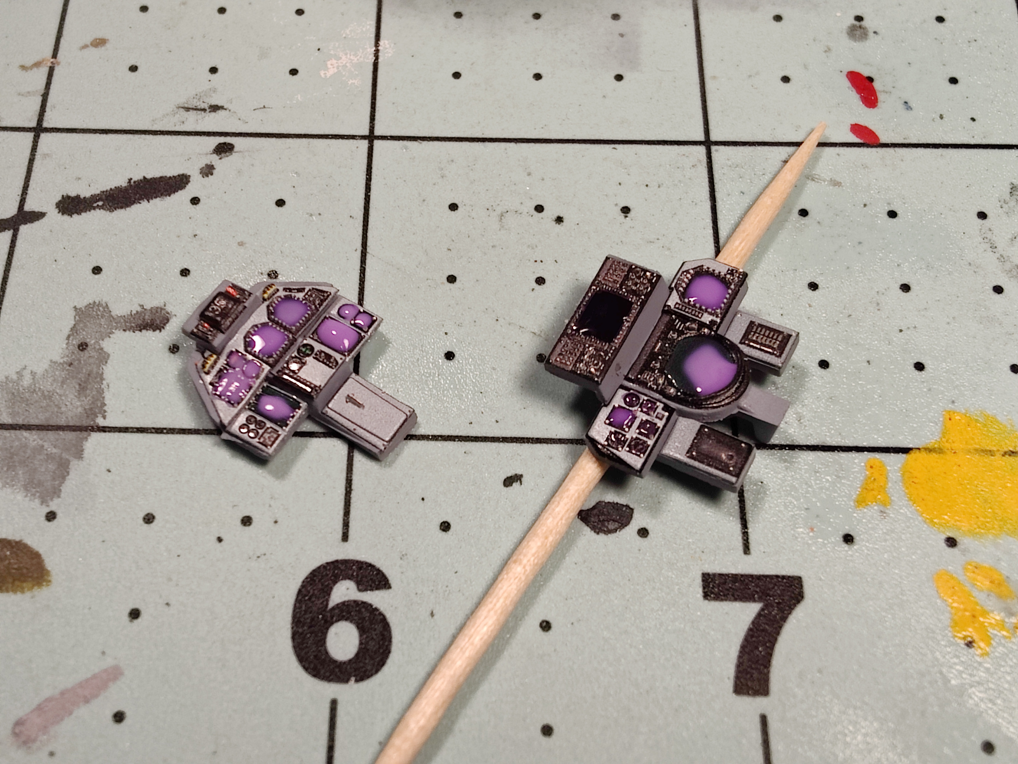

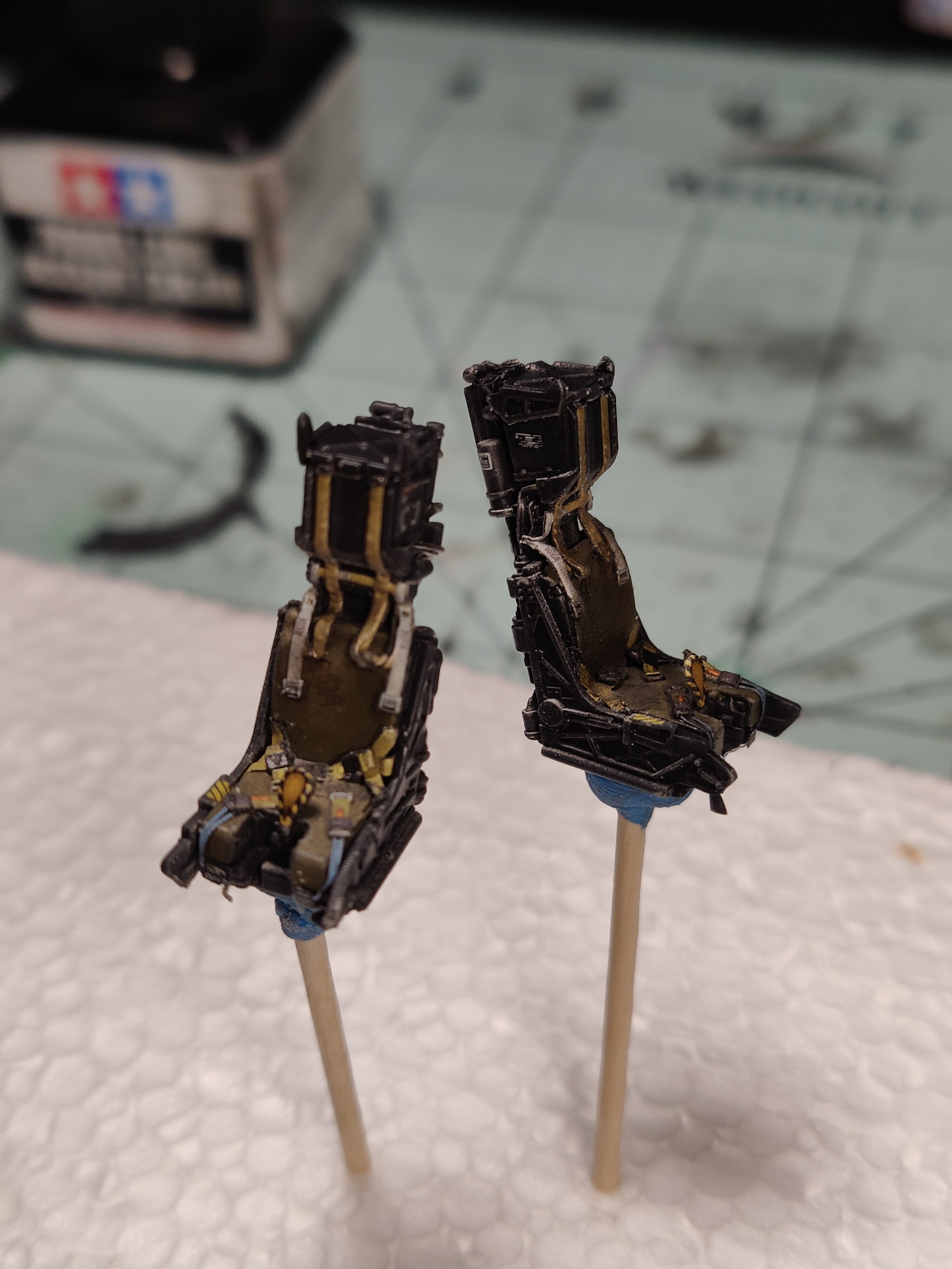

Micro Posted February 27 Author Share Posted February 27 Seats done. I used the Quinta risers, ejection handles, and lap belts repurpose as leg restraints. The photoetched Eduard 3-point lap were more accurate and thus used. I also used the placards that came with the Eduard seats. Quote Link to post Share on other sites

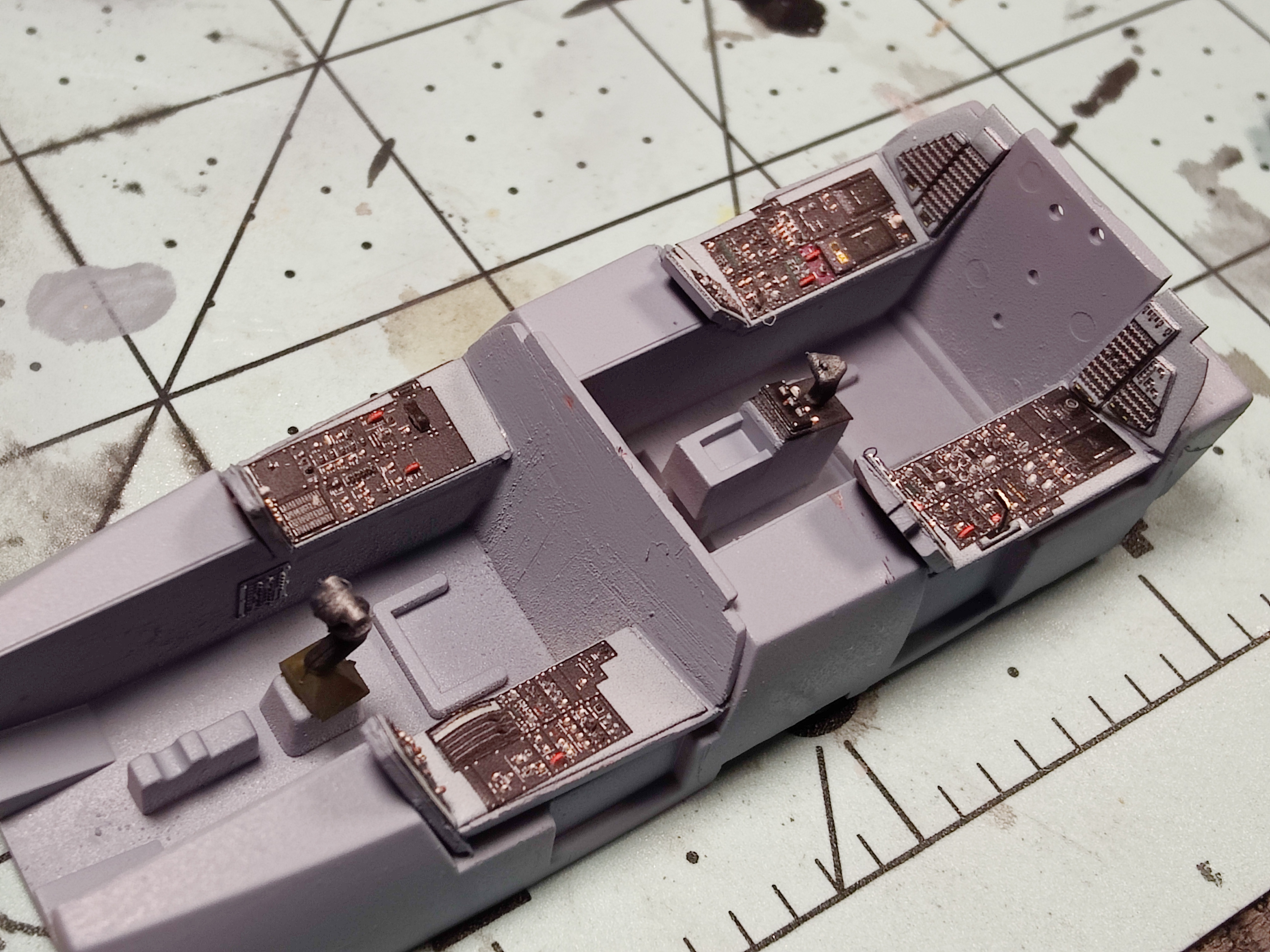

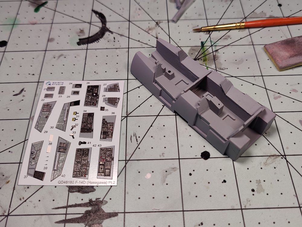

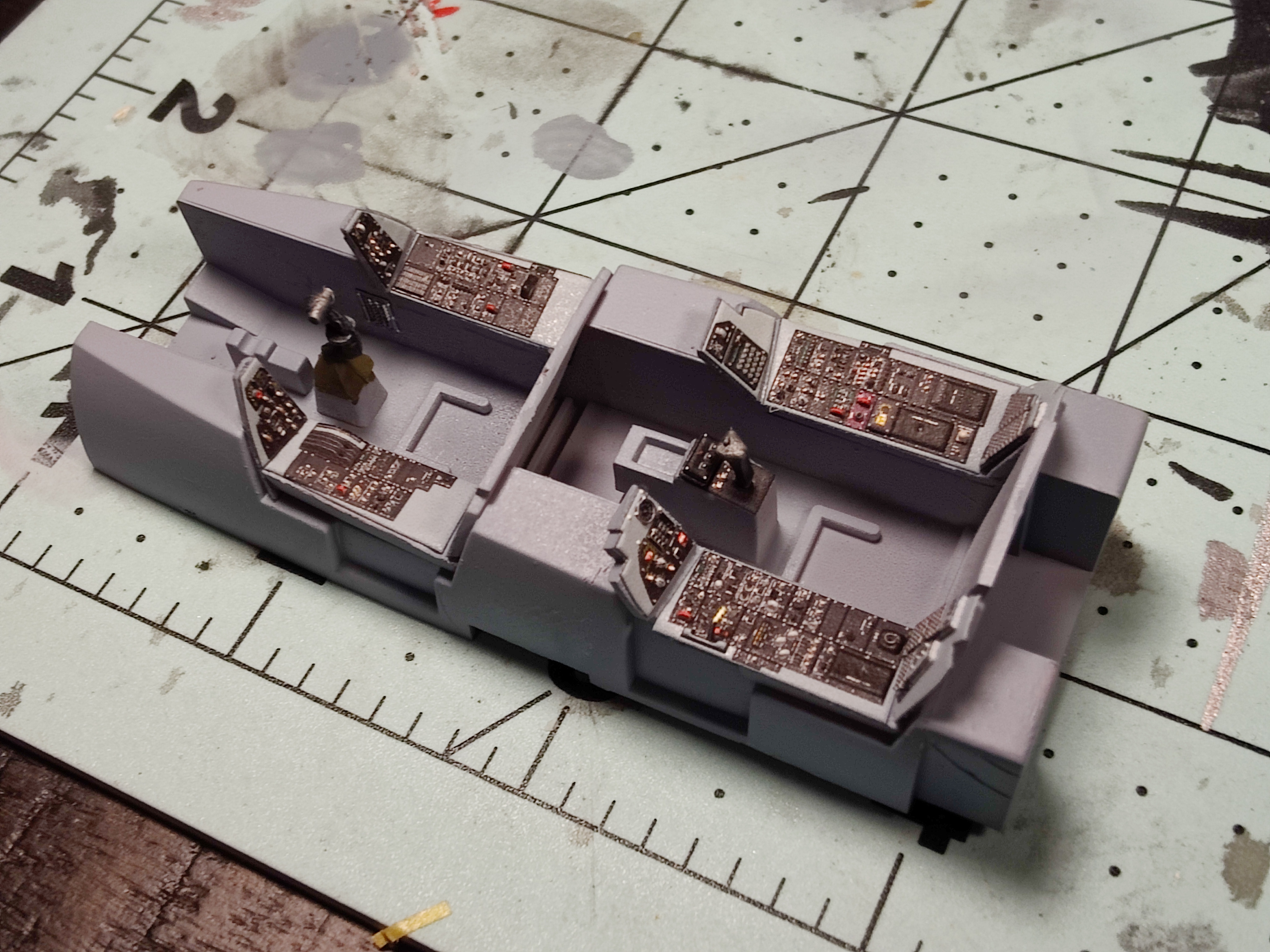

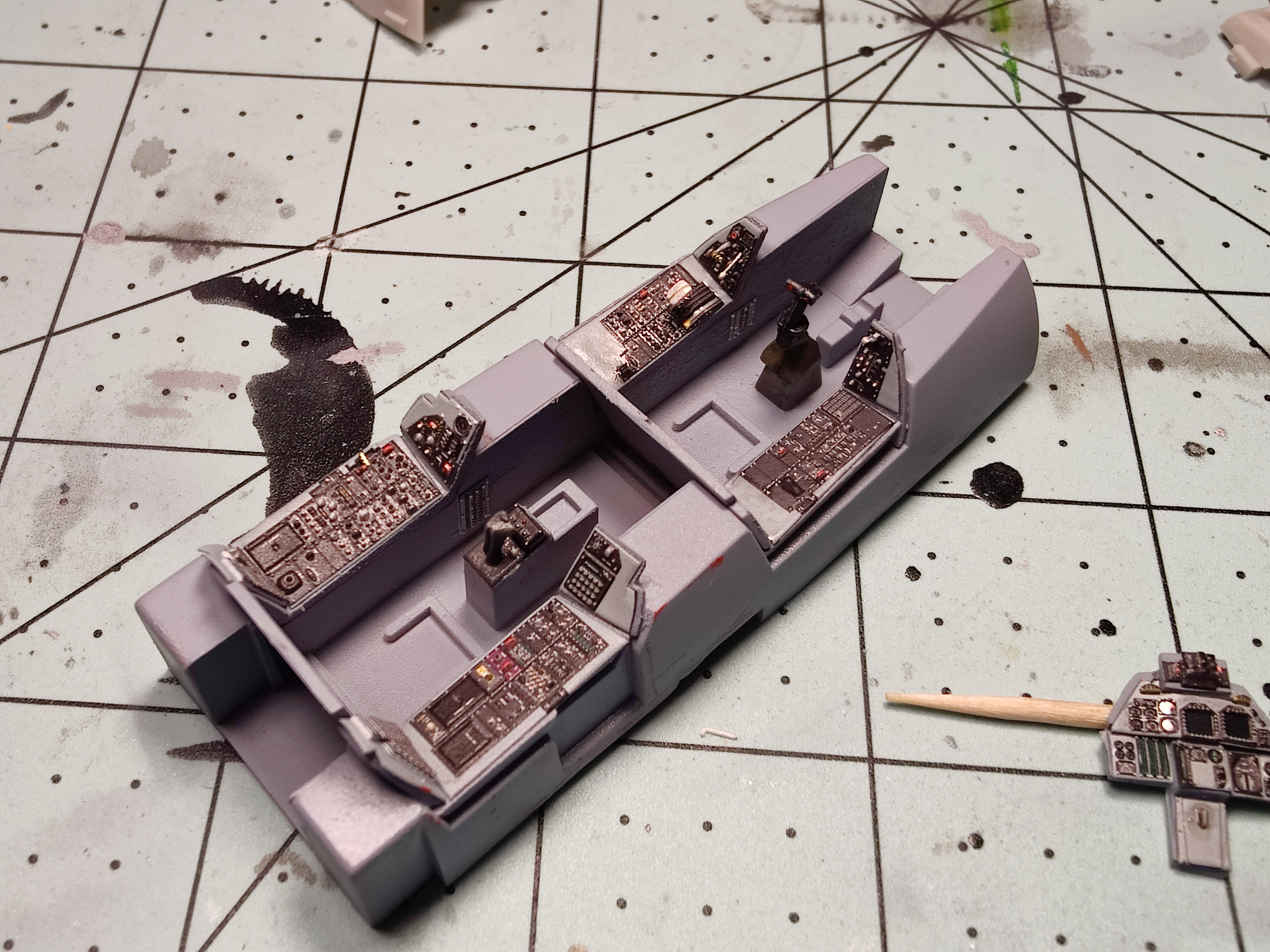

Micro Posted February 28 Author Share Posted February 28 Thanks, Bastian. Working on the cockpit tub now. I'm using the kit tub with the Quinta 3D decals. Scraped off all the raised details from the molds. Laid down Tamia dark ghost Gray which matches the Quinta set. The fit of these decals is absolutely superb. They go right into place. They are pretty glossy so they need a flat coat after being applied. I'm masking off the glass portions because they have a really nice shine to them. Quote Link to post Share on other sites

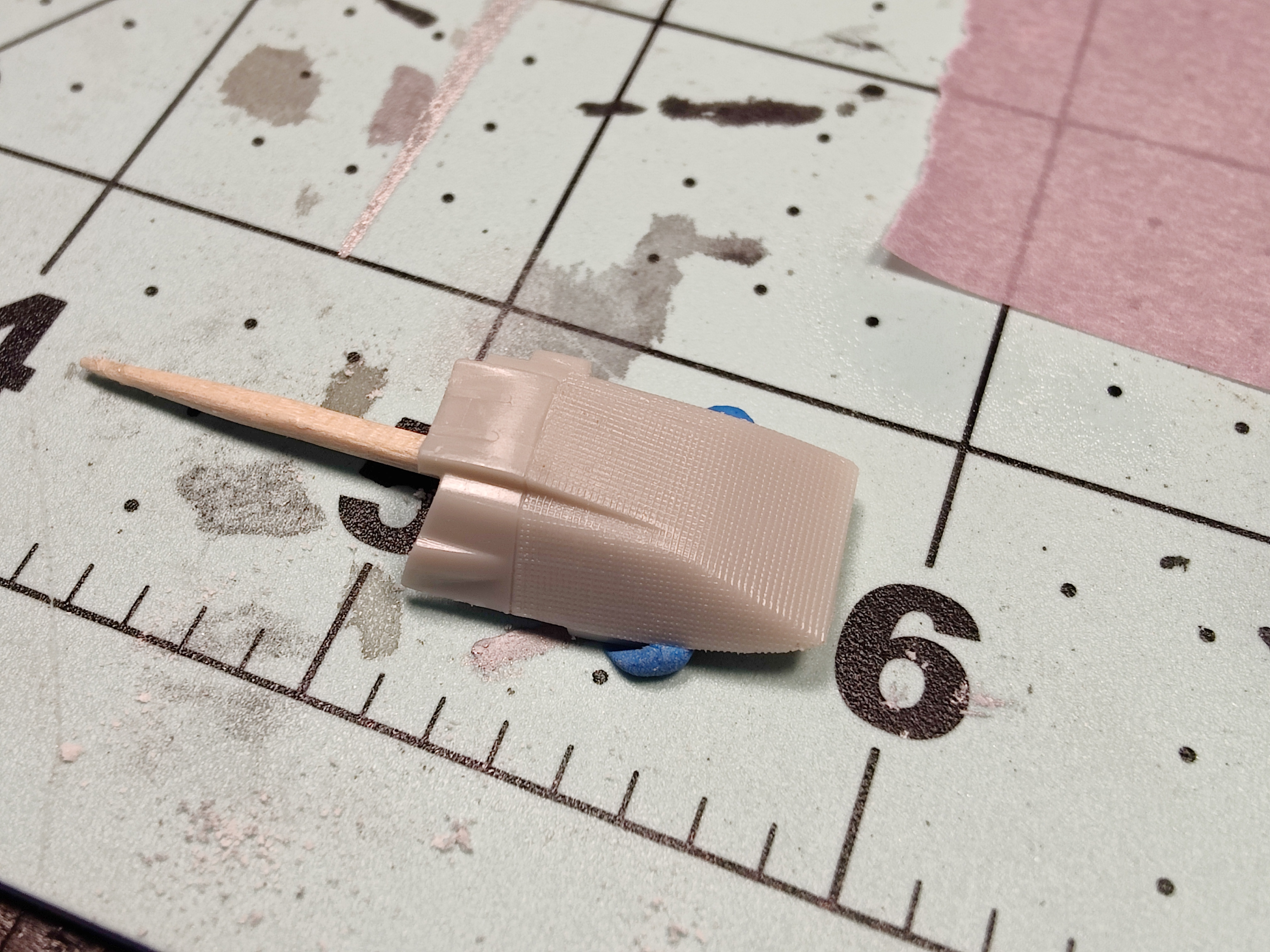

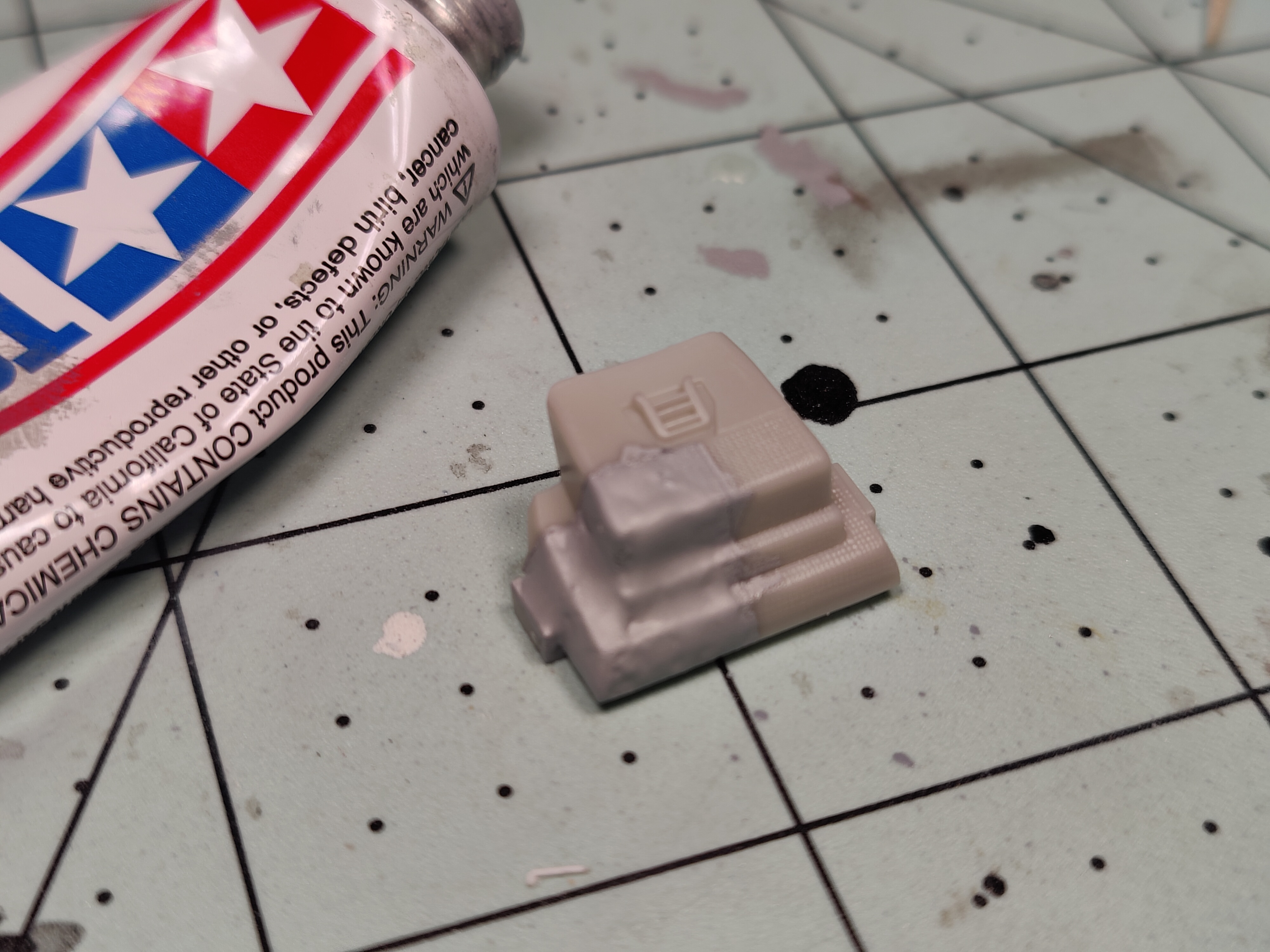

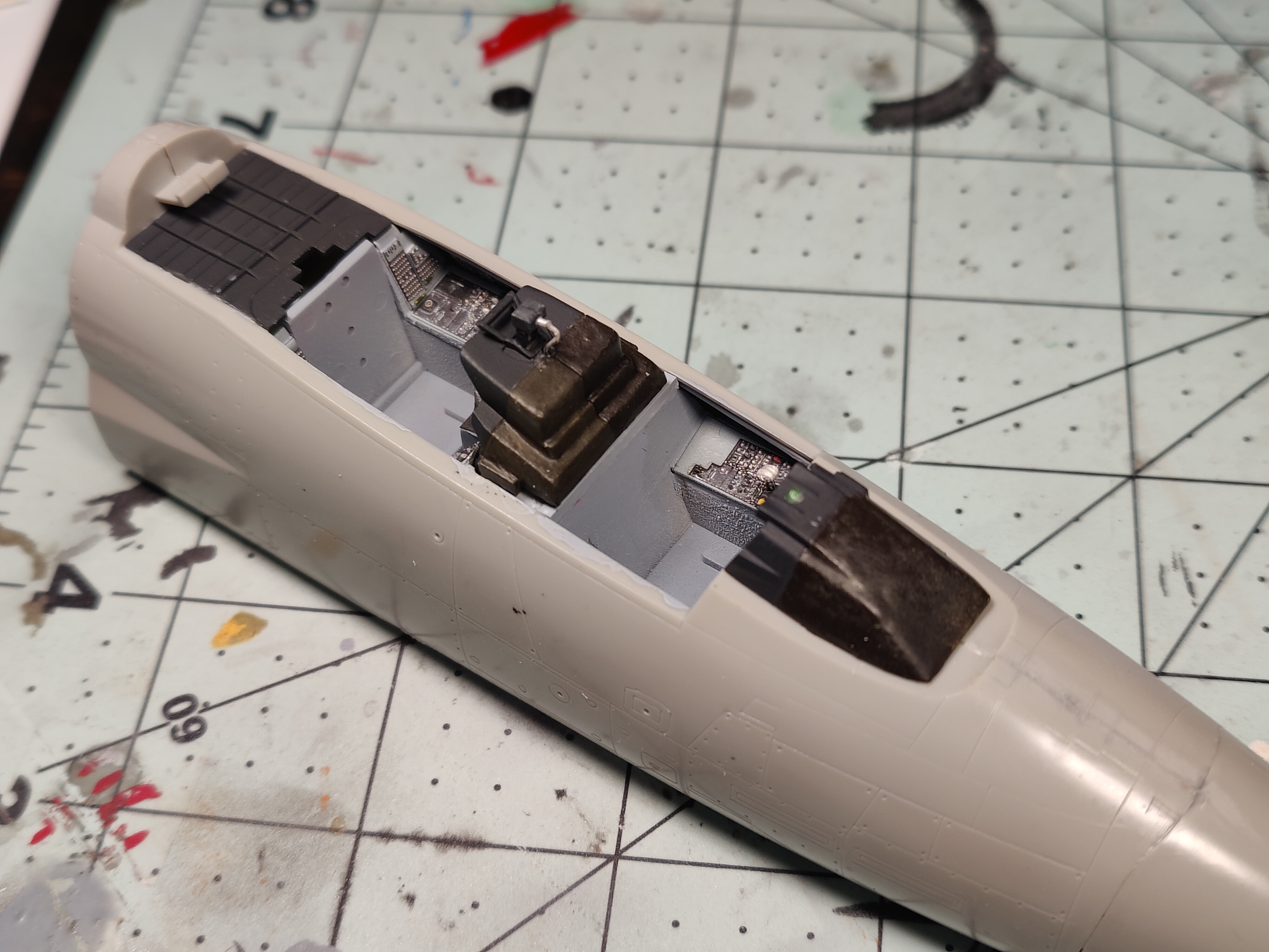

Micro Posted March 7 Author Share Posted March 7 Quick update. Working on the instrument shrouds. The kit ones are a little too chiseled and unrealistic. So I'm taking some Tamiya putty send with lacquer thinner and creating a more fabric look by dabbing it on the shrouds. Quote Link to post Share on other sites

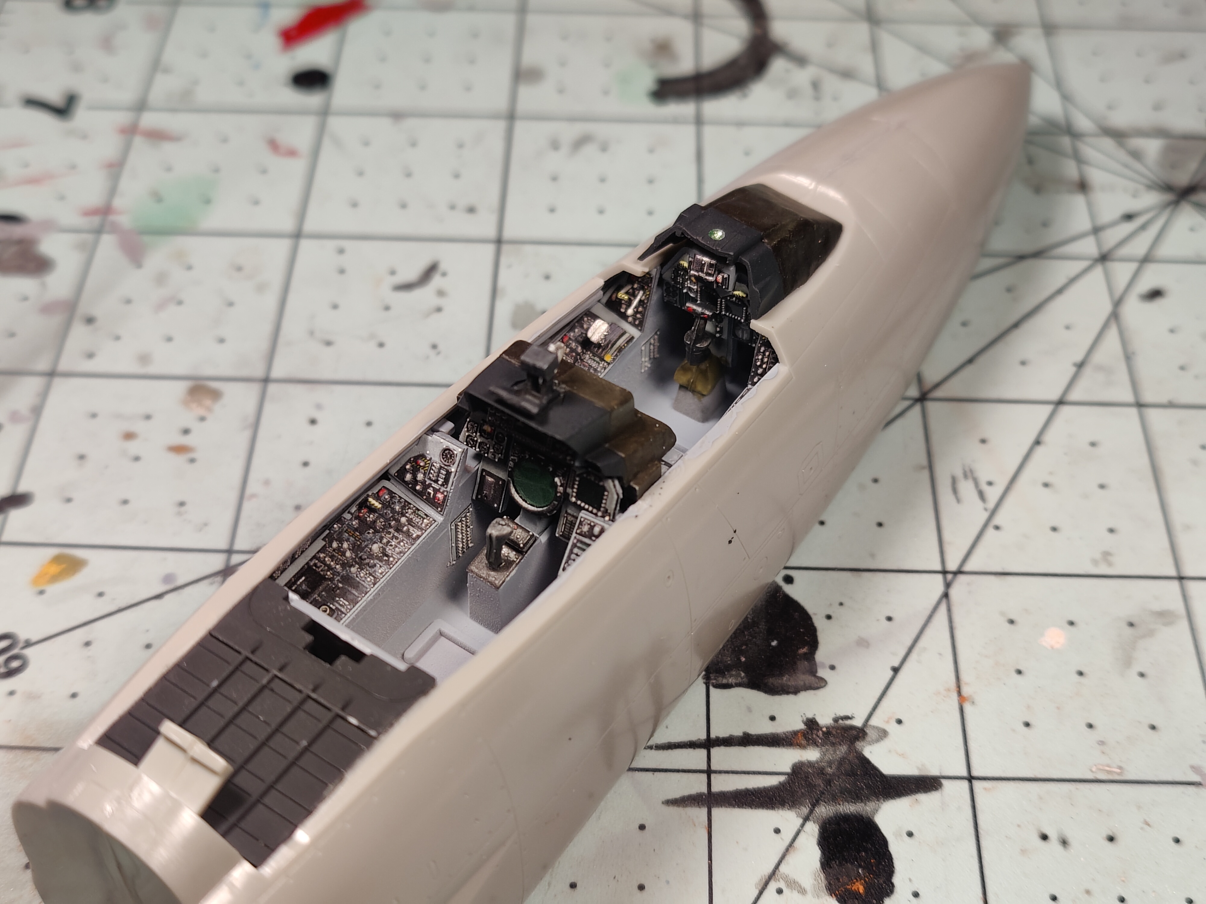

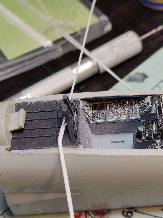

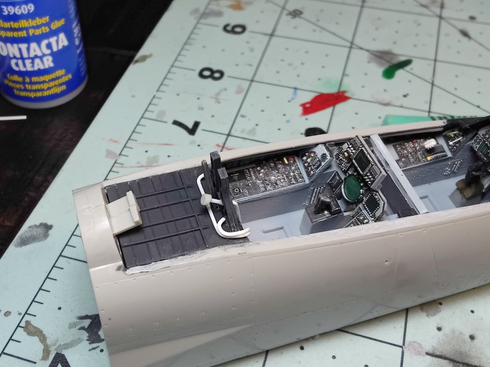

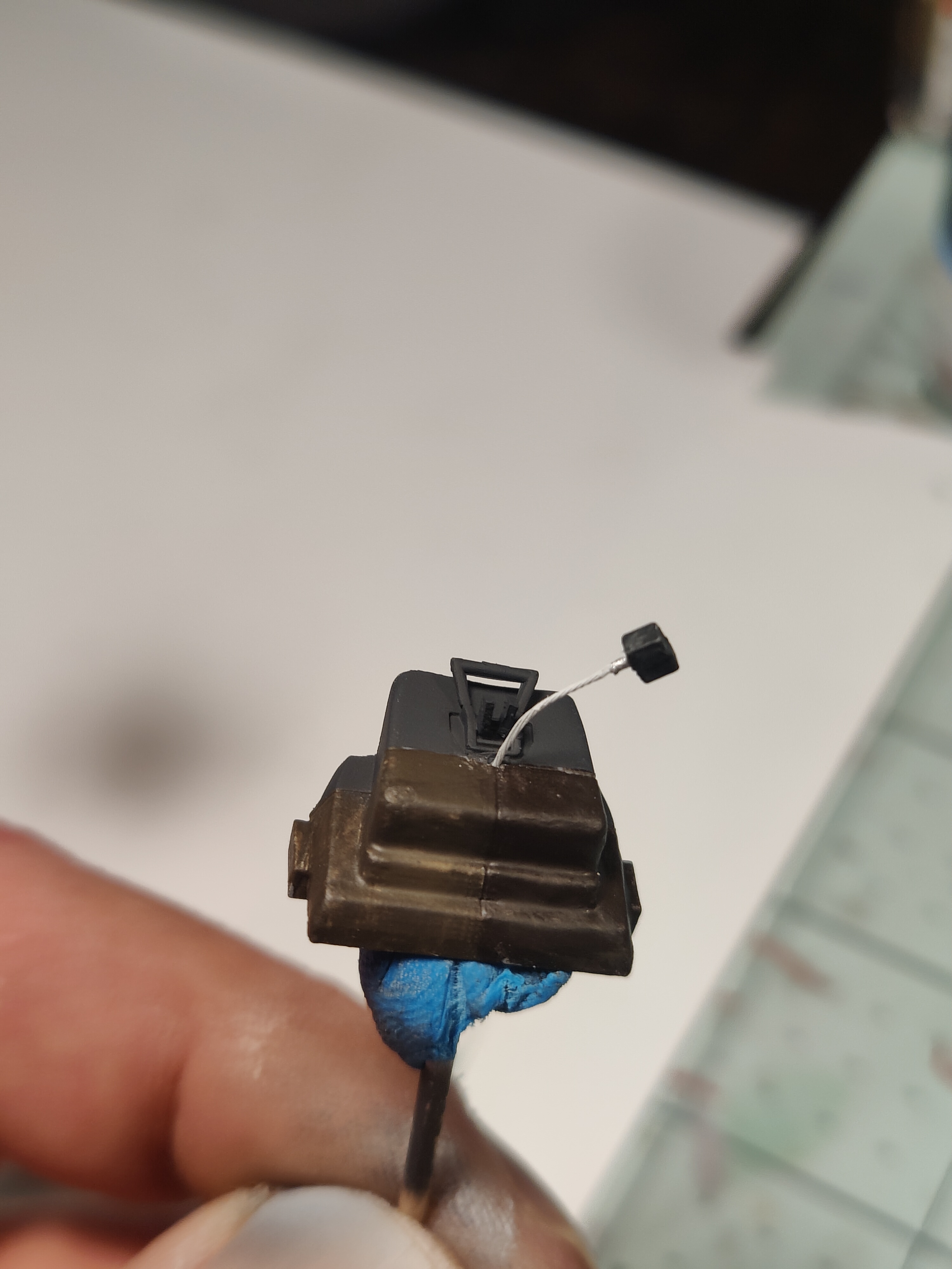

Micro Posted March 10 Author Share Posted March 10 Thanks, Thadeus. Slowly but surely moving along. Forward fuselage assembled. I didn't like the plastic piece fitted to the SSP so I took some ultra fine wire twisted it and created a cable. Drilled out a section for the HUD projector. Filled it with chrome paint first then clear green. Next step is to touch up the comings and build the HUD. Quote Link to post Share on other sites

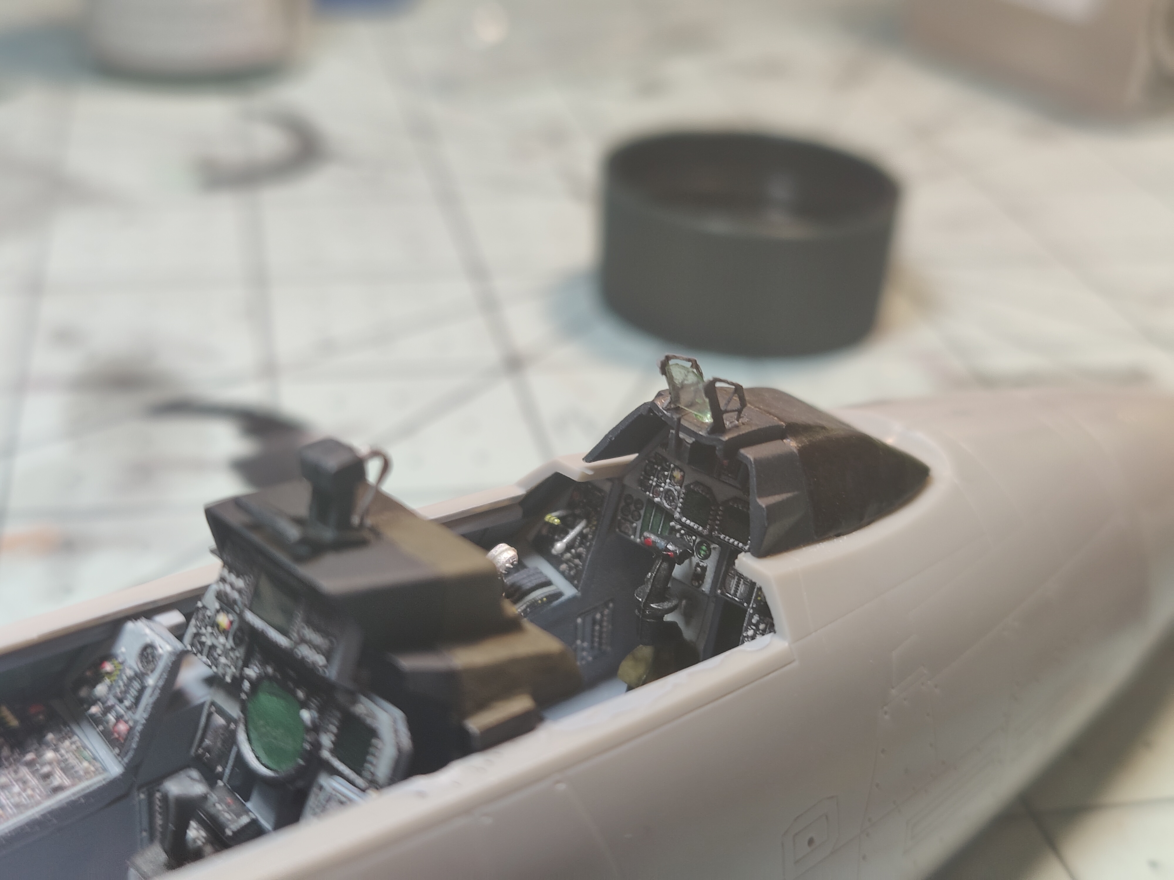

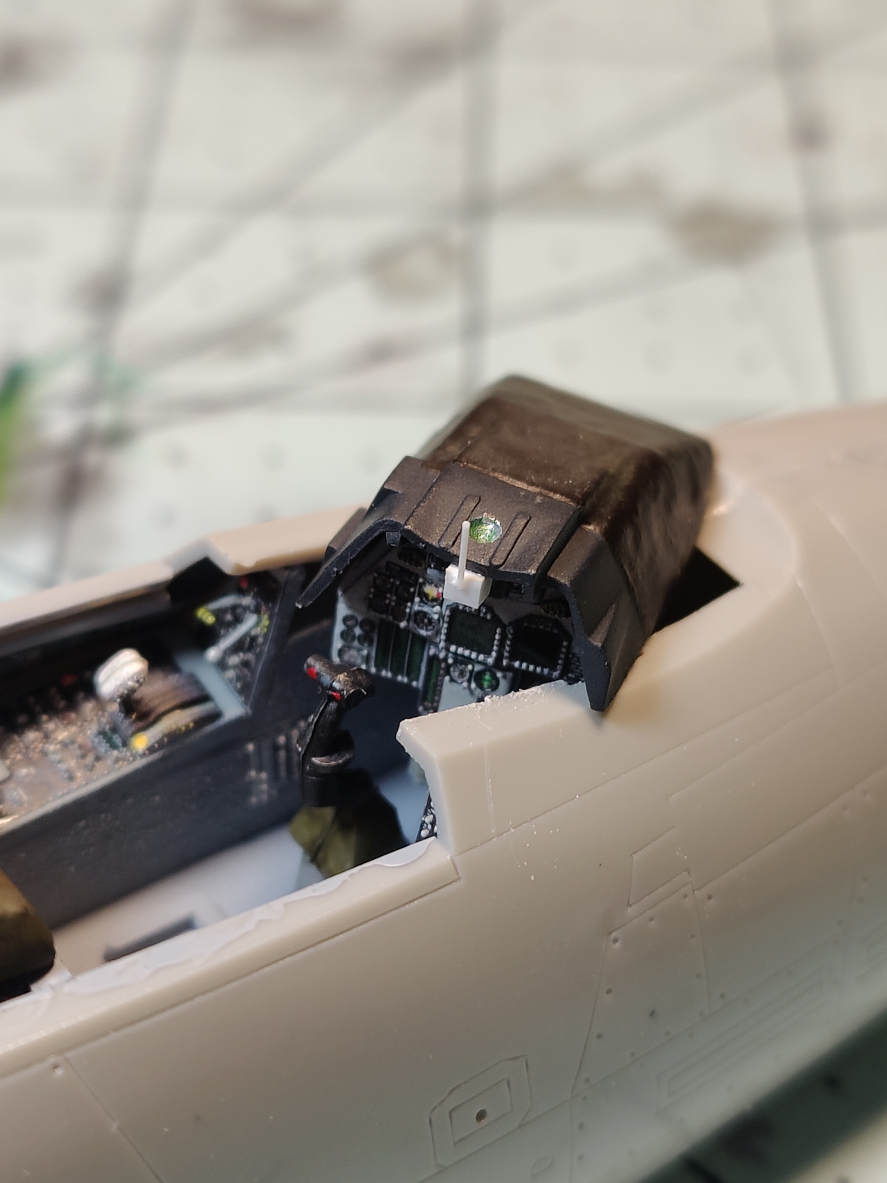

Micro Posted March 12 Author Share Posted March 12 Added the piece under the shroud for the HUD camera, and the hood camera itself with a little piece of styrene. I ordered the HUD for the Harrier from Flying Leathernecks. Modifying it to fit and look like an F-14 HUD. Quote Link to post Share on other sites

A-10 LOADER Posted March 12 Share Posted March 12 Looking good so far. FYI, the HUD had two pieces of glass in it. You need another one at the front edge of the frame. Steve "TOMCATS FOREVER, BABY...!" Quote Link to post Share on other sites

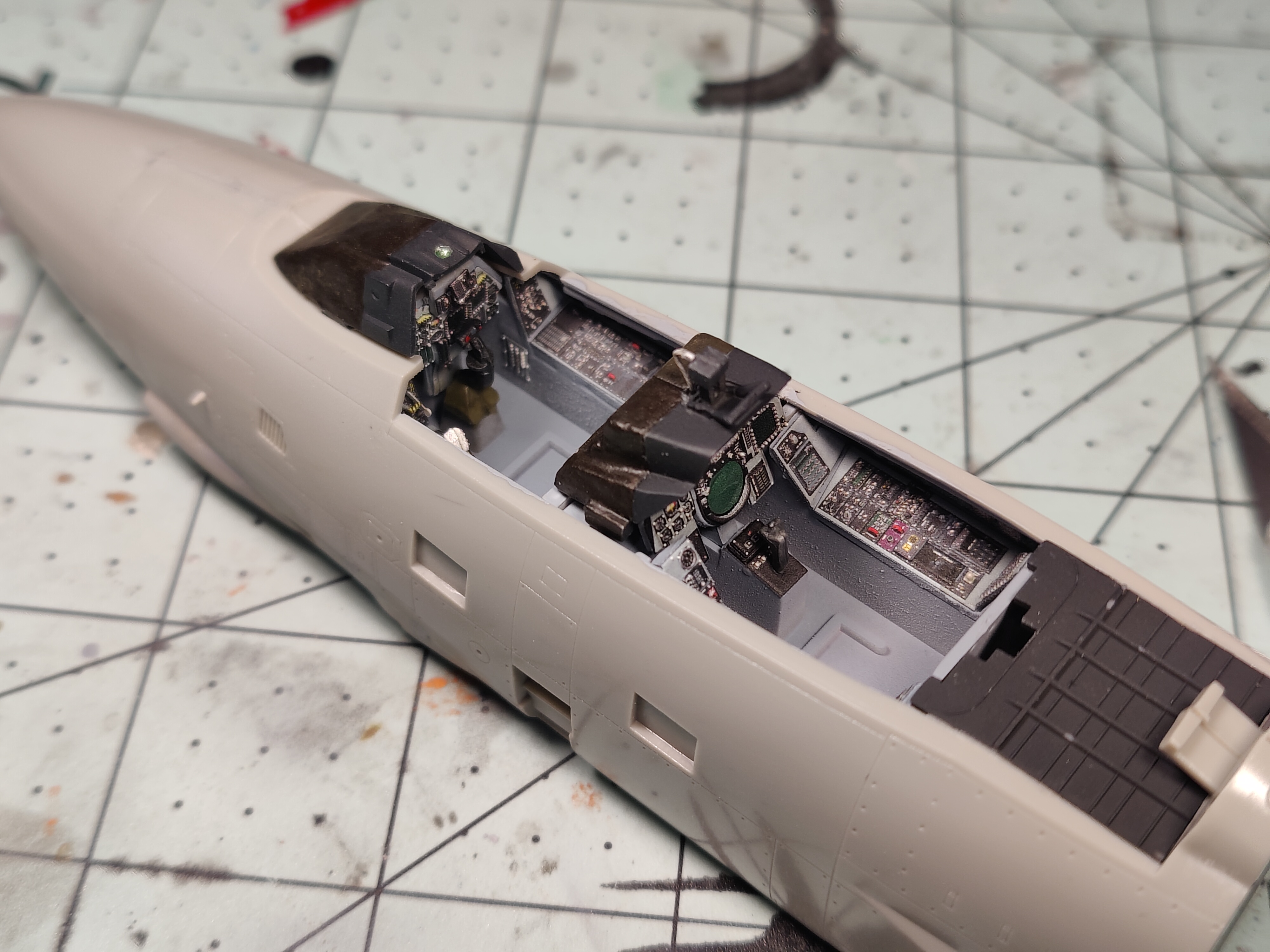

Micro Posted March 13 Author Share Posted March 13 Thank you very much gents. I'm flattered. Steve you were absolutely right and I appreciate you reminding me. I just took a picture at the end of the night before I completed the HUD. That little delicate thing took a few months off my life. It's now got its second piece of combiner glass. Now I'm starting to add the scratch details around the cockpit including ECS plumbing. Quote Link to post Share on other sites
