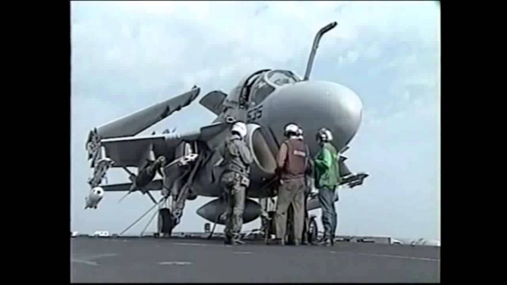

Raptor.777 Posted March 6, 2023 Author Share Posted March 6, 2023 So weird they would only put 1 weapon on a station that can hold 6 Quote Link to post Share on other sites
Collin Posted March 6, 2023 Share Posted March 6, 2023 My buddy flew in that squadron during DS1. Two reasons....they didn't want to download the MERs. 1. The aircraft were using heavy MK-82/MK20 loads w/MERs so they kept them on the planes (much to the rejoicing of the AO's). 2. Bring aboard weight (max trap) limit didn't allow full weapons load and enough gas "on the ball" after a traditional double cycle event. Landing back onboard the ship with a huge weapons load means you have to have less gas in the aircraft to meet max trap weight (tradeoff). I didn't deal with it much in the S-3 since even with 3-4k of fuel onboard (and full weapons) on the first pass to the deck we still have 4-5 looks at the back of the boat (because the S-3 has such efficient engines). 3-4K in a Tomcat or Hornet (or A-6/EA-6B)....not so much with those big thirsty noise makers. Cheers Collin Quote Link to post Share on other sites
