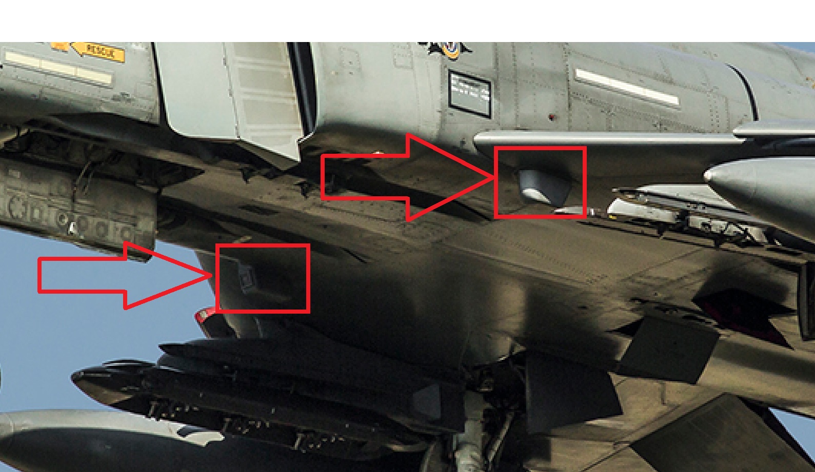

Mustang381 Posted March 12 Share Posted March 12 (edited) Hello friends, Can someone please, tell me what is these two parts near wing root? I have marked it on photo. And, does anyone have any close view of specific detail , so that I can make that part for my model kit. Thank you. Edited March 12 by Mustang381 Quote Link to post Share on other sites
VADM Fangschleister Posted March 12 Share Posted March 12 (edited) Camera fairings. I used to work D's E's and G's. The D's had these but not all of them. One (the starboard one) has it's flat-pane looking forward and the port one looks aft. That may be a Navy B model? Edited March 12 by VADM Fangschleister Quote Link to post Share on other sites
JeffreyK Posted March 12 Share Posted March 12 Strike cameras. Port facing aft, starboard facing forward. Sitting on the panel where on Navy Phantoms the catapult hooks were. The Zoukei Mura F-4E kit has them in the kit, a slightly more accurate version is contained in my F-4E slat conversion set (for the same kit). The best close-up detail references can be found in this book: http://eagleaviation.gr/work/rf-4e-f-4e-phantom-ii-phantom-under-the-skin-vol-ii/ J Quote Link to post Share on other sites
GreyGhost Posted March 12 Share Posted March 12 Not a Navy jet, Air Force style pylons and no "Danger Air Intake" warning triangle ... -Gregg Quote Link to post Share on other sites

Mustang381 Posted March 12 Author Share Posted March 12 2 hours ago, scotthldr said: RoKAF, F-4E Yes sir,it is. Quote Link to post Share on other sites
