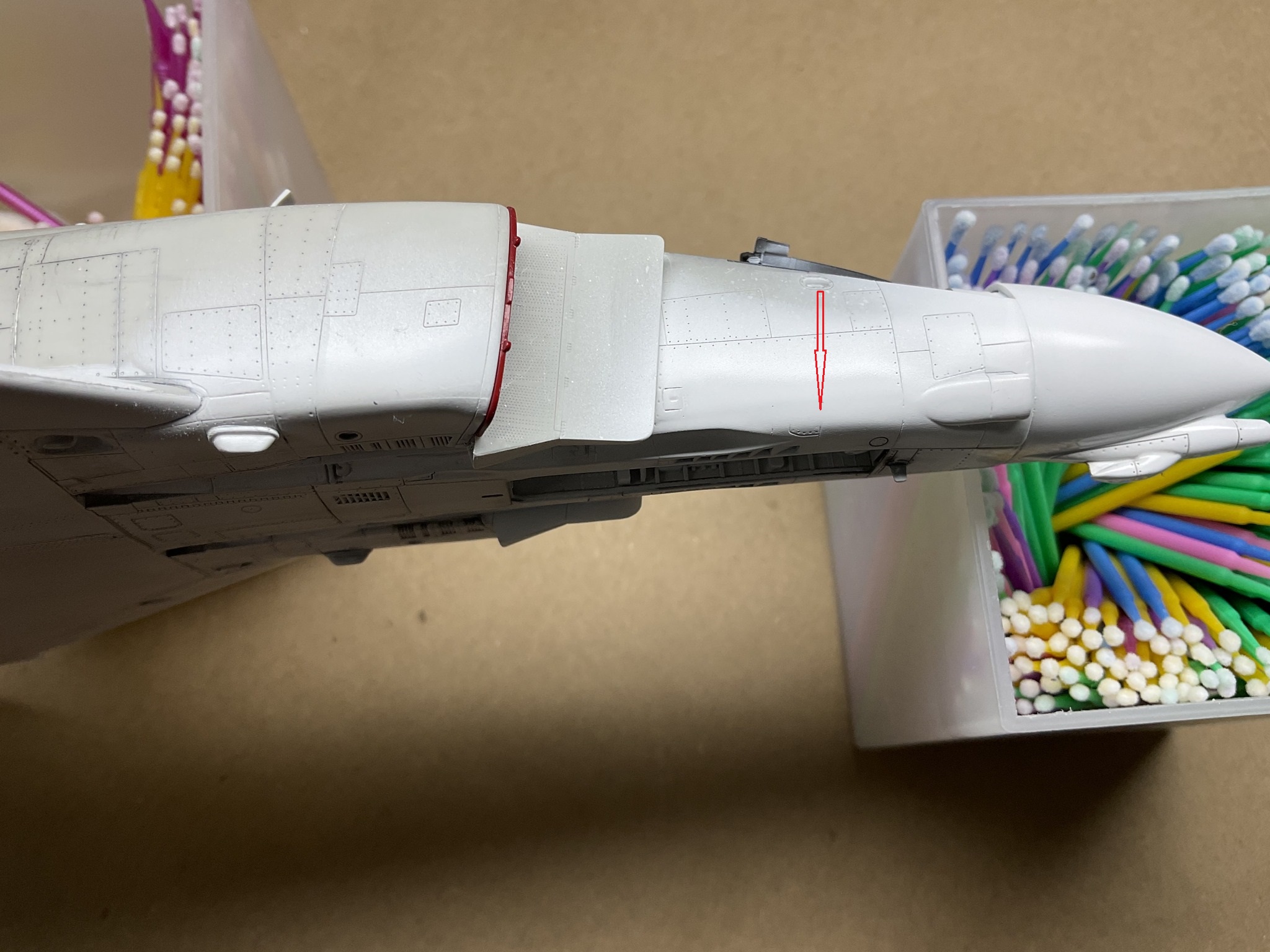

dai phan Posted March 19, 2023 Share Posted March 19, 2023 (edited) Hi all, It could be me but I could not get the lower panel to fit well to the fuse of the excellent F4B 1/48 so some sandings were done. As you can see I lost the panel lines and rivets. What is the besr way to restore/simulate these lost details? I am horrible and rescribing and placement of the sunken rivets is even worse. This lost details happen to be at the demarcation line so maybe just leave it alone? I await your expert replies. Dai Edited March 19, 2023 by dai phan Quote Link to post Share on other sites
Geoff M Posted March 19, 2023 Share Posted March 19, 2023 I feel your pain. On many phantom kits that area can be a problem. I use Dymo tape as a guide for rescribing and large sewing needle chucked in a pin vise for restoring lost panel lines. I use the same pin vise for restoring the rivet detail. I also learn from the experience and next time I add a spacer to make the two parts match better. Quote Link to post Share on other sites
dai phan Posted March 19, 2023 Author Share Posted March 19, 2023 (edited) 6 hours ago, Geoff M said: I feel your pain. On many phantom kits that area can be a problem. I use Dymo tape as a guide for rescribing and large sewing needle chucked in a pin vise for restoring lost panel lines. I use the same pin vise for restoring the rivet detail. I also learn from the experience and next time I add a spacer to make the two parts match better. There was a panel with 6 rivets and I want to refine them so I use compass needle. Examine 10 times then went for it. By the time I am done the panel has 12 rivets !!! I cannot seem to place the needle right on the center of the sunken rivets !!! Any tips? Dai Edited March 19, 2023 by dai phan Quote Link to post Share on other sites
viper730 Posted March 20, 2023 Share Posted March 20, 2023 Not going to help on this one but for the next one. What I do is deepen the existing lines and rivets where I know detail will be lost when sanding. I also place tape over details near where I need to sand to prevent excessive loss. Quote Link to post Share on other sites
bashace Posted March 20, 2023 Share Posted March 20, 2023 Just let it be and press on, nobody will notice when it's finished. Quote Link to post Share on other sites
Geoff M Posted March 20, 2023 Share Posted March 20, 2023 Sounds like a case of visual resolution. Get an OptiVisor or vision aid if you don't have one yet. It really helps with seeing small details Quote Link to post Share on other sites
dai phan Posted March 21, 2023 Author Share Posted March 21, 2023 (edited) On 3/20/2023 at 8:52 AM, Geoff M said: Sounds like a case of visual resolution. Get an OptiVisor or vision aid if you don't have one yet. It really helps with seeing small details I have everything but still off the target. Dai Edited March 21, 2023 by dai phan Quote Link to post Share on other sites
Cloud in the Wind Posted March 22, 2023 Share Posted March 22, 2023 I’m not sure how much help I can be as my methodology is common and probably already at your skill level. I place masking tape along the intended line then lightly scribe a number of times before going for it. For rivets I premark using a pencil to get the spacing and number. This takes me a few tries though. Quote Link to post Share on other sites
dai phan Posted March 22, 2023 Author Share Posted March 22, 2023 49 minutes ago, Cloud in the Wind said: I’m not sure how much help I can be as my methodology is common and probably already at your skill level. I place masking tape along the intended line then lightly scribe a number of times before going for it. For rivets I premark using a pencil to get the spacing and number. This takes me a few tries though. I have tried using the best scriber like Tamiya's. But the lines are not even, always crooked. Yes I score lightly a few times. Somehow I struggled so much when comes to this type of job. Dai Quote Link to post Share on other sites
ElectroSoldier Posted March 24, 2023 Share Posted March 24, 2023 Use some Tamiya masking tape to guide you where you want the line. Tamiya scribe tool, or even their extra fine cutting blade to make the new panel lines. A rivet tool is good, Trumpeter make one that is quite cheap. Quote Link to post Share on other sites
