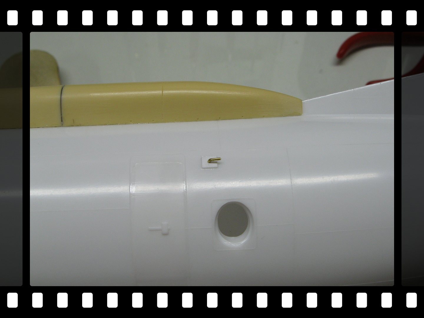

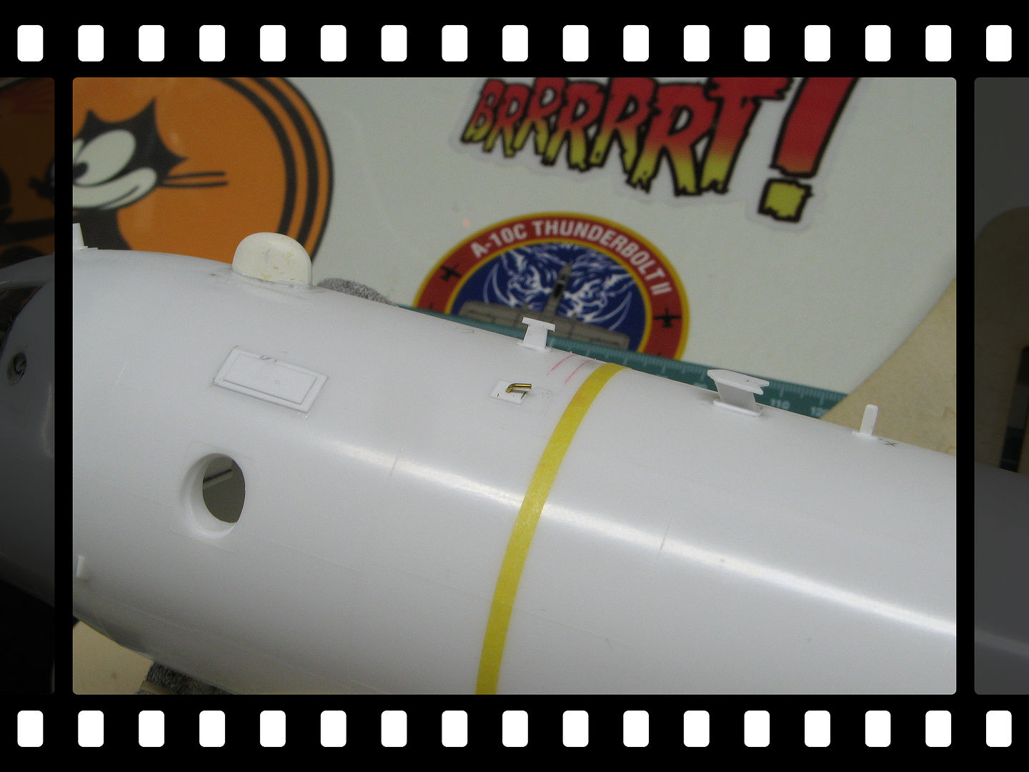

A-10 LOADER Posted June 15, 2023 Author Share Posted June 15, 2023 Since I'll be using E-Z Line for the antenna wires I watched some videos on how to use it. A good strong connection point is recommended so, I added some small brass wire connections, at certain areas of the fuselage, where the antennas will connect. The same will be done for the top front area of the tail and the edge of each horizontal stab with small, straight pieces. Steve Quote Link to post Share on other sites

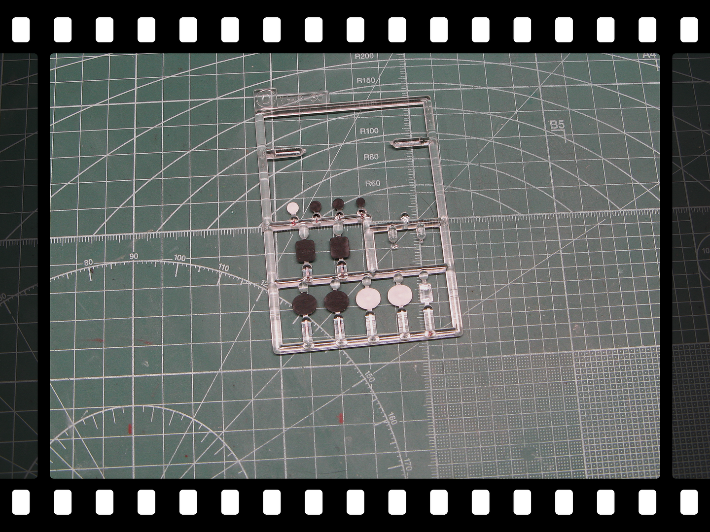

A-10 LOADER Posted June 21, 2023 Author Share Posted June 21, 2023 On 6/19/2023 at 3:51 AM, cpoud117 said: This is mighty impressive! Thank you. Progress update for the EP-3. I painted the backsides of the various fuselage windows. The three white ones mimic the ones with the shades drawn. The windows were installed using some Testors clear parts cement and, they fit perfectly. Getting closer to putting this fuselage in primer. Steve Quote Link to post Share on other sites

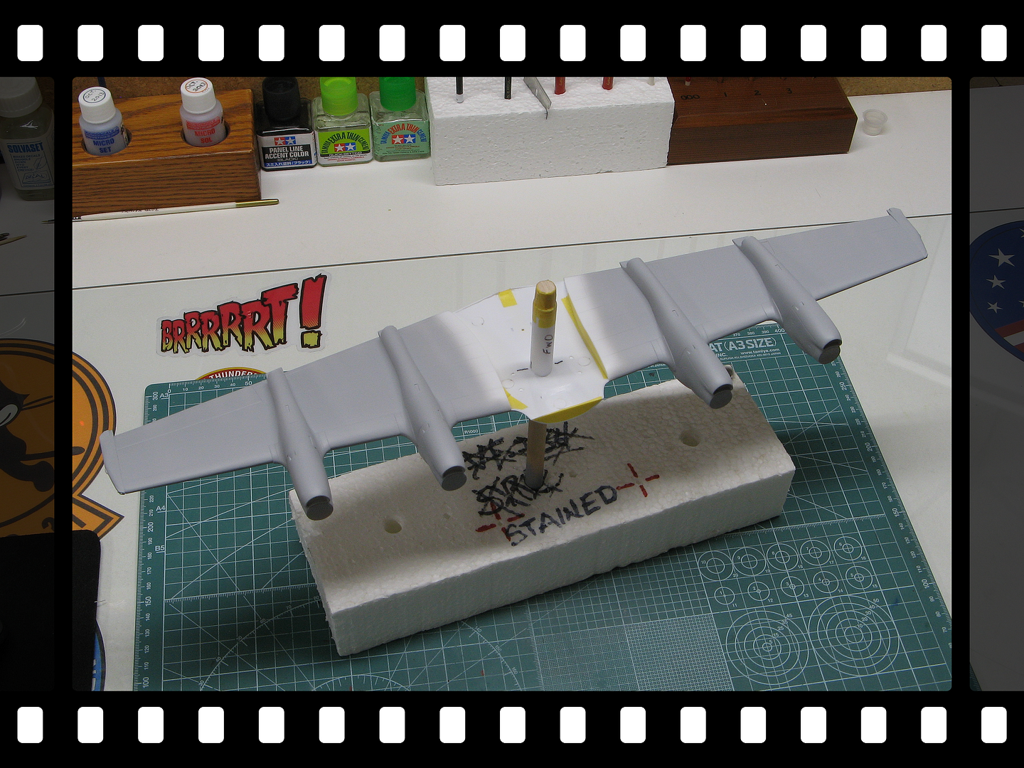

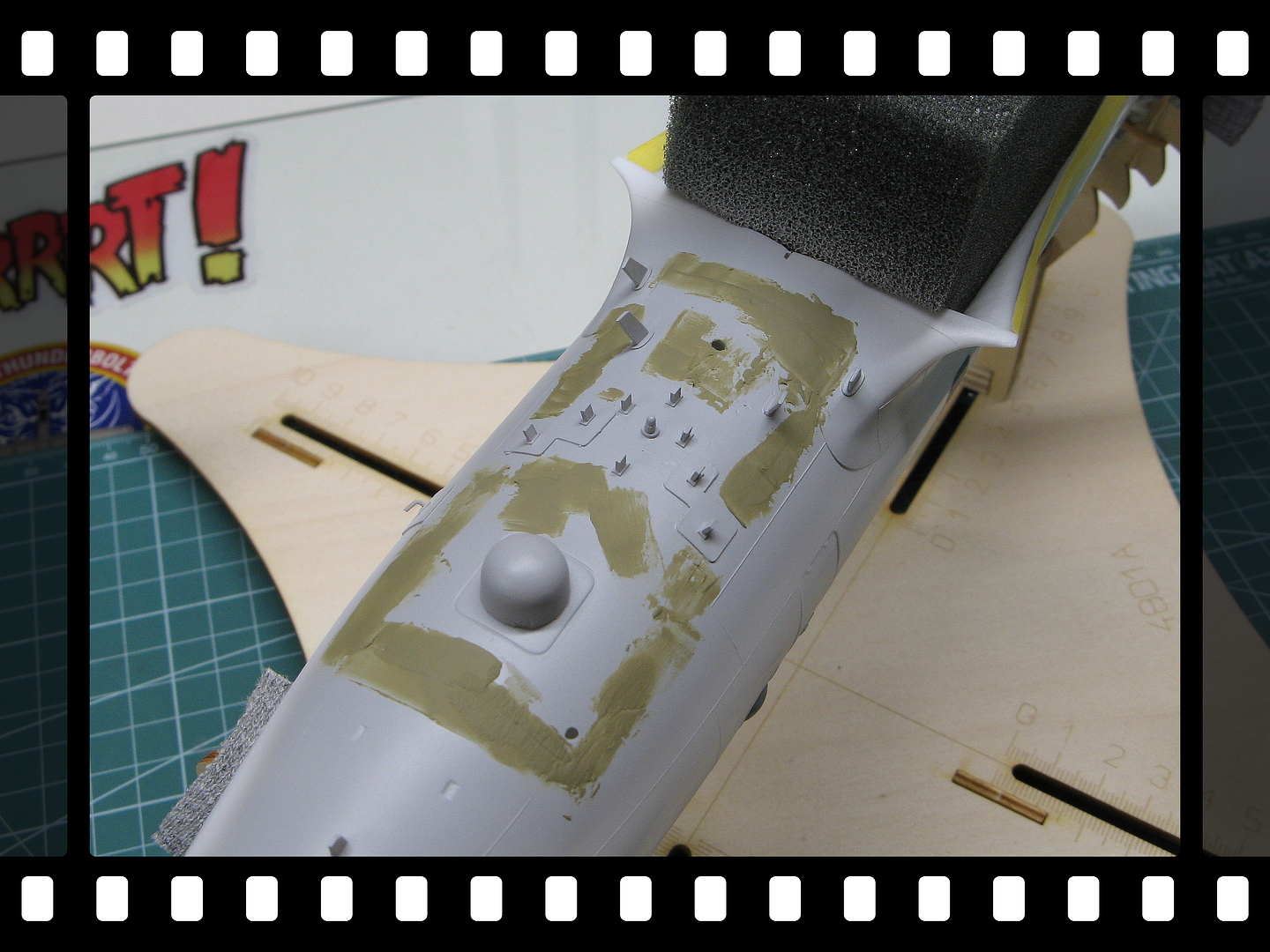

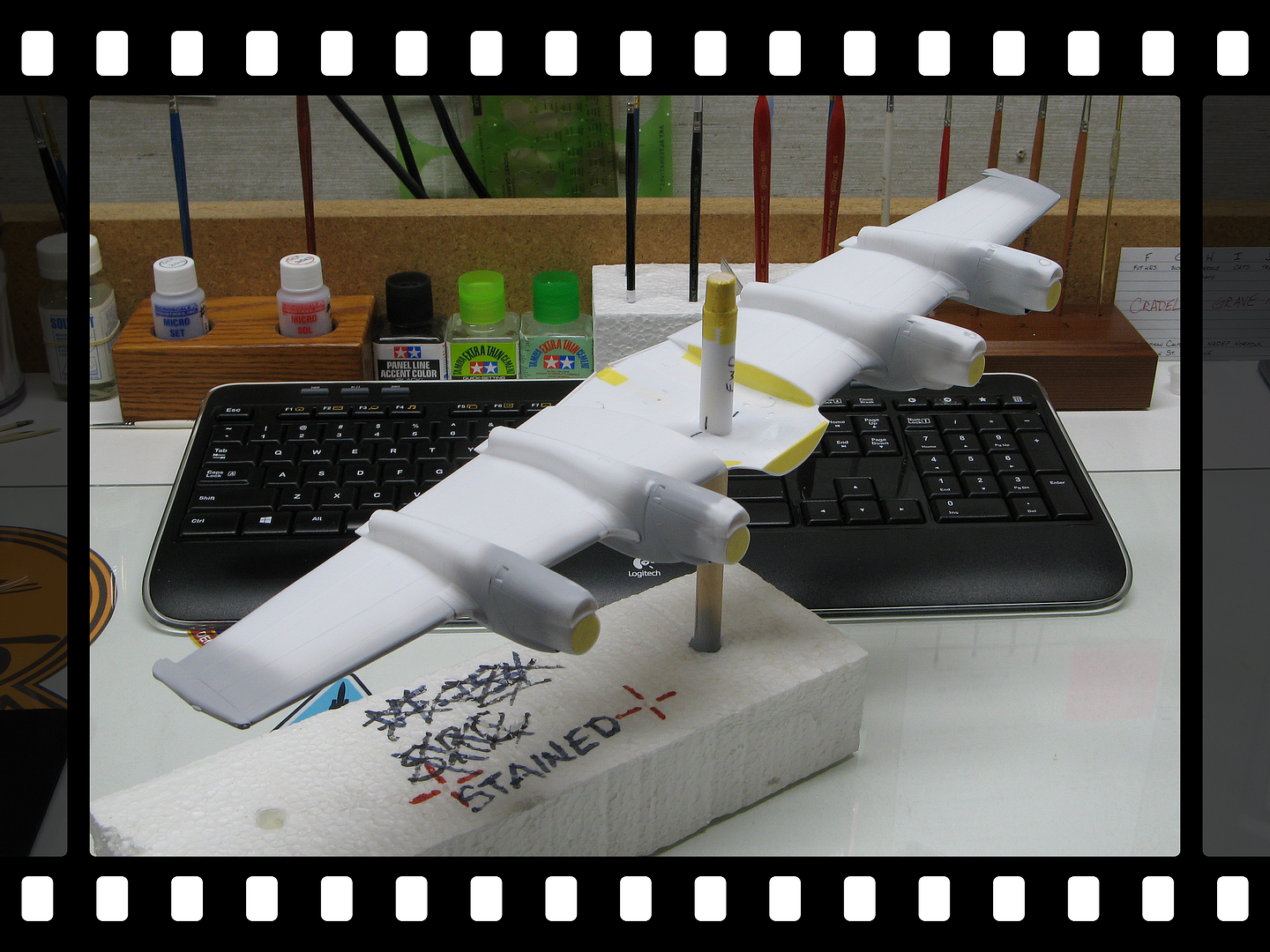

A-10 LOADER Posted June 26, 2023 Author Share Posted June 26, 2023 Progressing along on the EP-3. The fuselage is almost ready for primer, I still need to make the attachment points, up near the fin cap, for the antenna cables. If anyone has a good closeup of this area please share. The green stuff on the windows is Mr. Masking SOL R, great stuff. The "bodyworked" areas on the wings got some primer to see how they looked and, just as I thought, they will need more attention. I had to sand away a small amount of the raised details around them, on the underside of the wings, to get things to blend in better but, it's on the bottom and won't be seen a lot. Another coat of primer and we'll see how things look then. Steve Quote Link to post Share on other sites

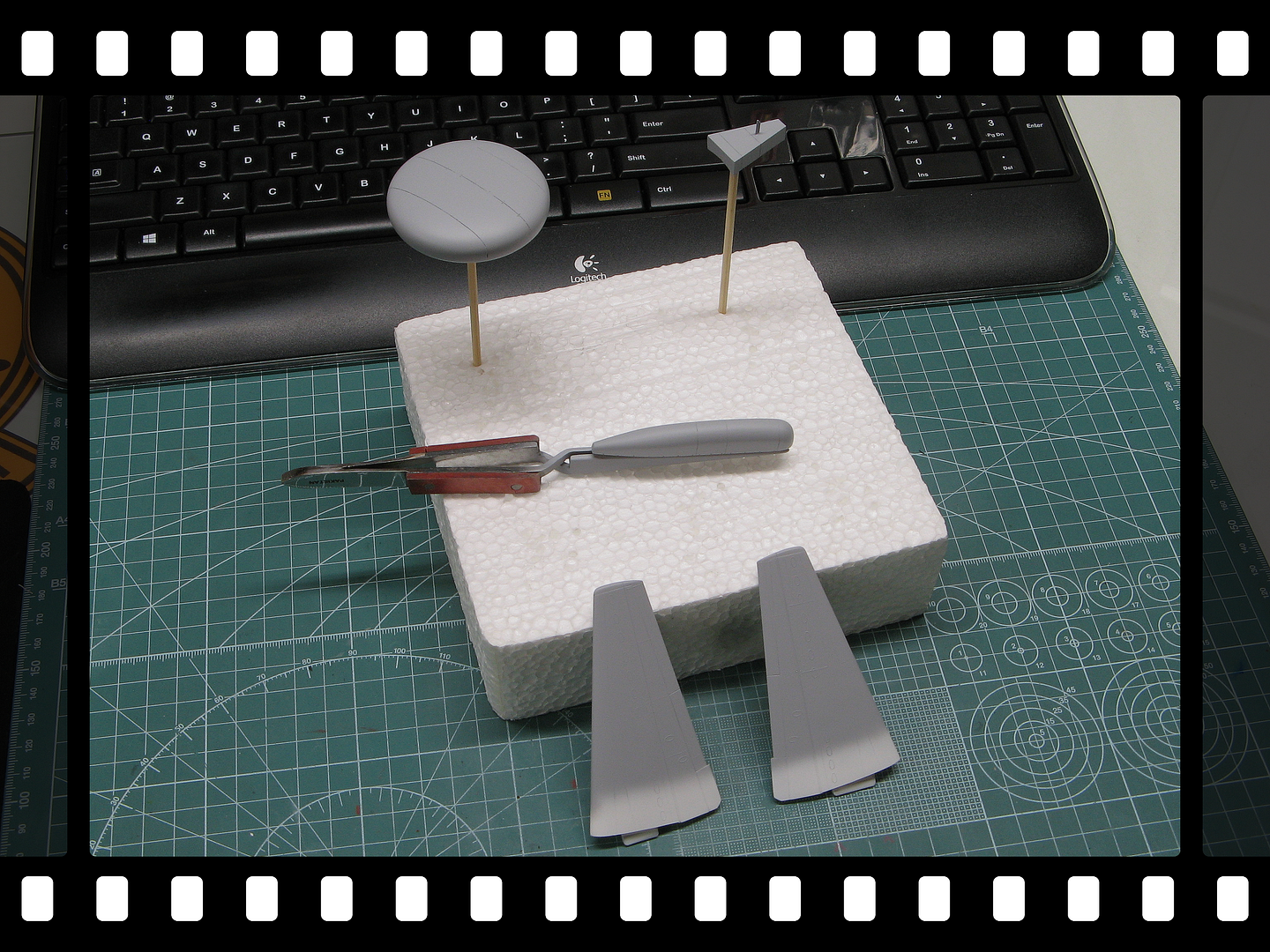

A-10 LOADER Posted June 27, 2023 Author Share Posted June 27, 2023 19 hours ago, RichB63 said: Fun watching this come together…I love all the extra detailing. 👍 Thanks very much Rich. Managed to get some primer sprayed on a few new things while other areas got re-primed to check the "worked" areas. Some will need further attention especially the belly radome, it has a ton of very small pinholes in it. Anyhow, some progress made. Steve Quote Link to post Share on other sites

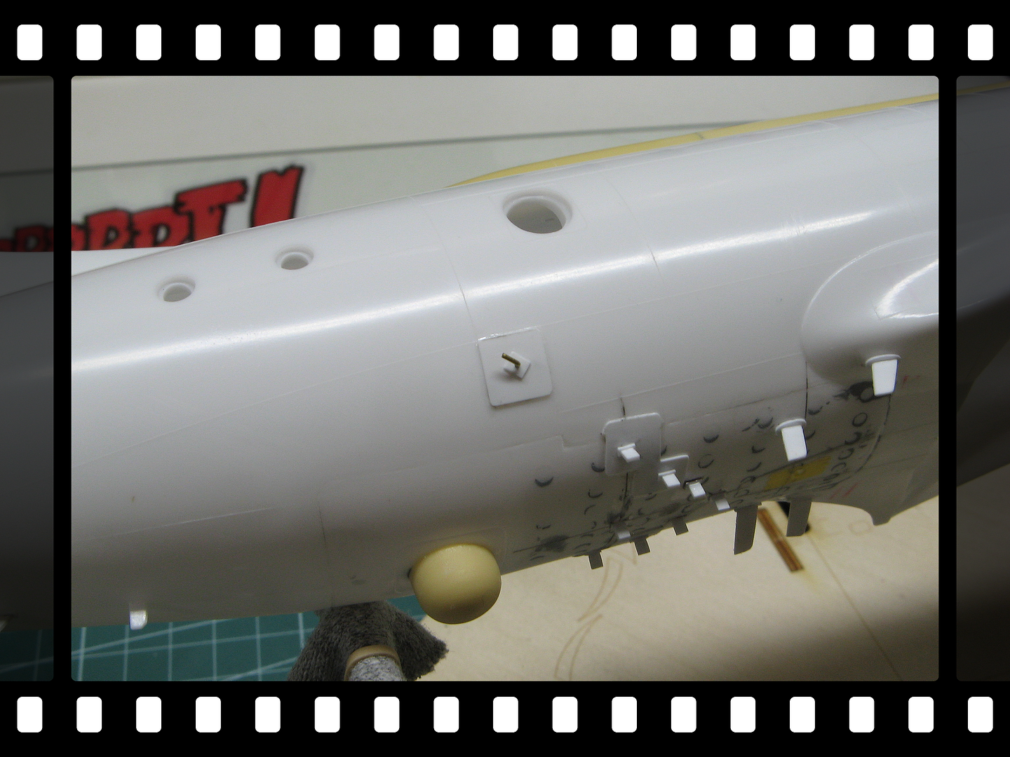

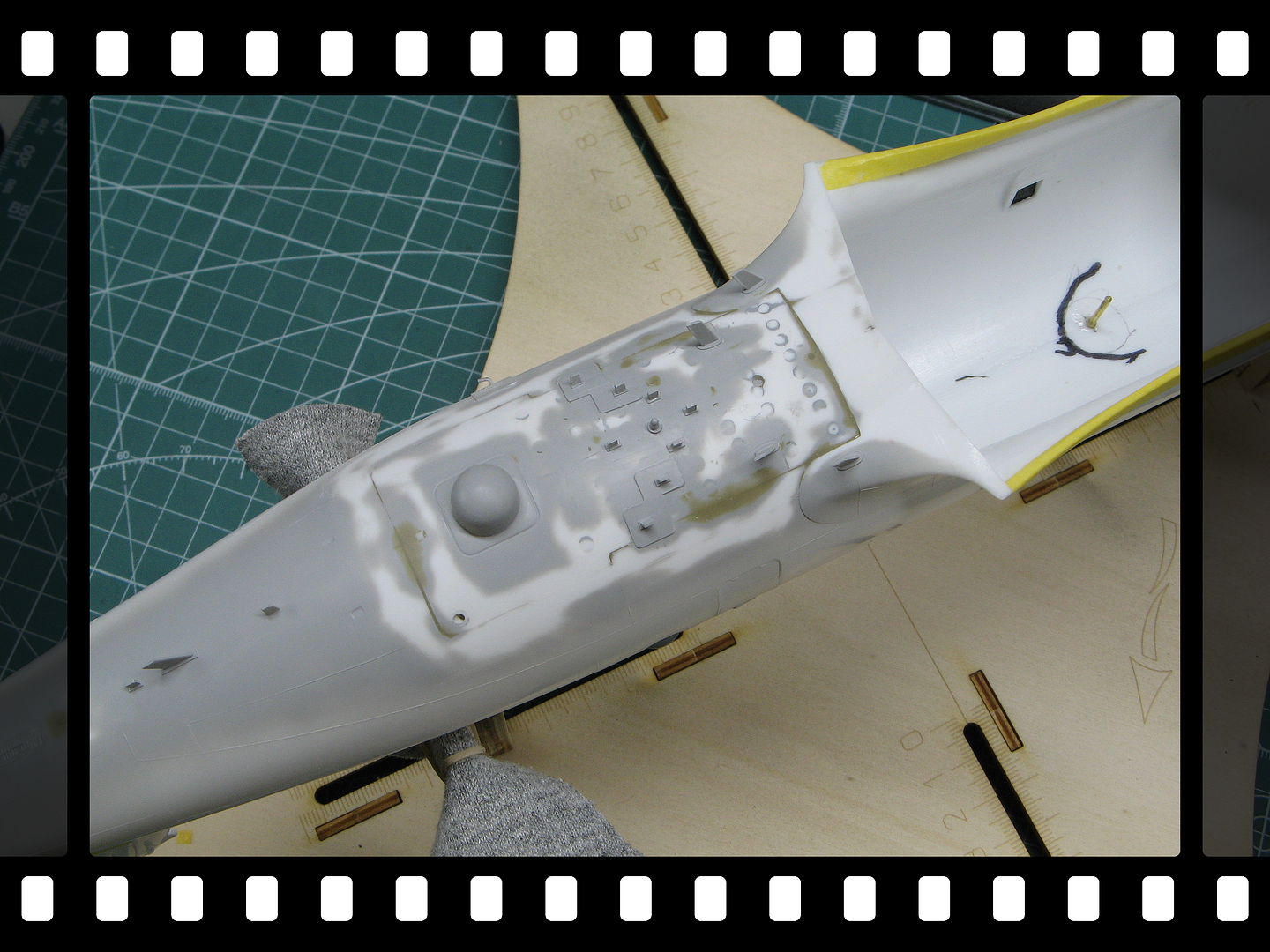

A-10 LOADER Posted June 29, 2023 Author Share Posted June 29, 2023 Added the HF aerial cable connections to the tail, again probably too big for the scale but, I couldn't go smaller and hold / work on them. Because I screwed up big time, I spent a lot of yesterday wet sanding the sonobuoy area. To do this again, I would have attached the panel, primed it, wet sanded the area clean, then when everything looked good, added the antennas. Not really sure what I was thinking but, I believe things are finally coming together. This time everything will get a coat of primer, not just certain areas. Thanks to all those who are following along. Steve Top seam sanded in nicely. Some small imperfections on the AMT-50 dome to address yet. I had to sand away more details than I would have liked to on the underside of the wings where I closed up the pylon openings but, now these areas are much flatter and, since everything will be glossy any imperfection will be amplified. The horizontal stabs had a opening on the underside to add a antenna, which is on the P-3C. The EP-3's did not have these so they had to be filled in. The resin parts that Hasegawa included in the kit are nice however, they need to be sanded really well before you prime them, I used 320 grit. All the resin got a soapy bath but, the belly radome and fairing were not thoroughly sanded. When I started to wet sand them the primer wouldn't feather, it just came right off. So I sanded all the primer off and primed them again, much better this time. Quote Link to post Share on other sites

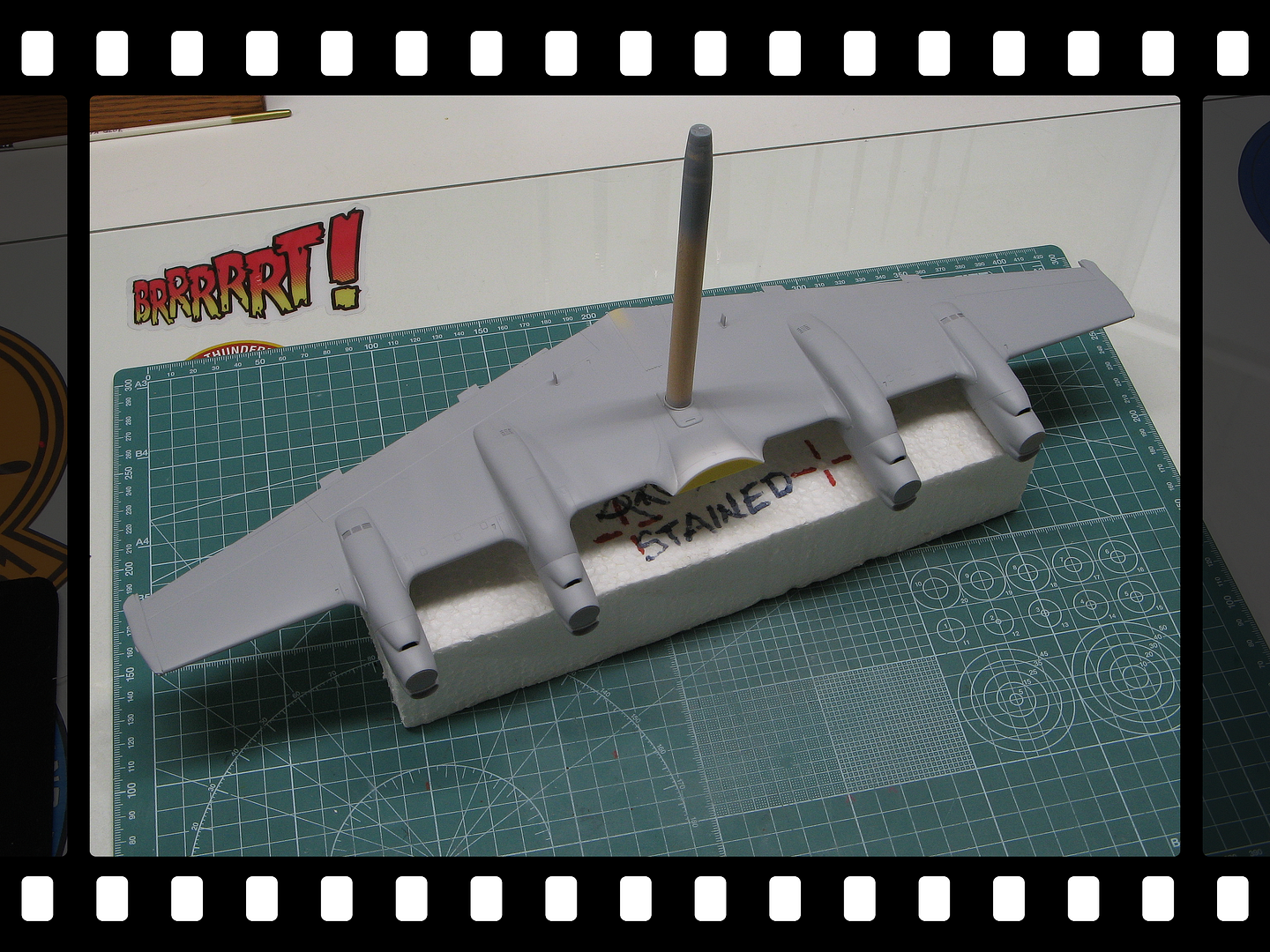

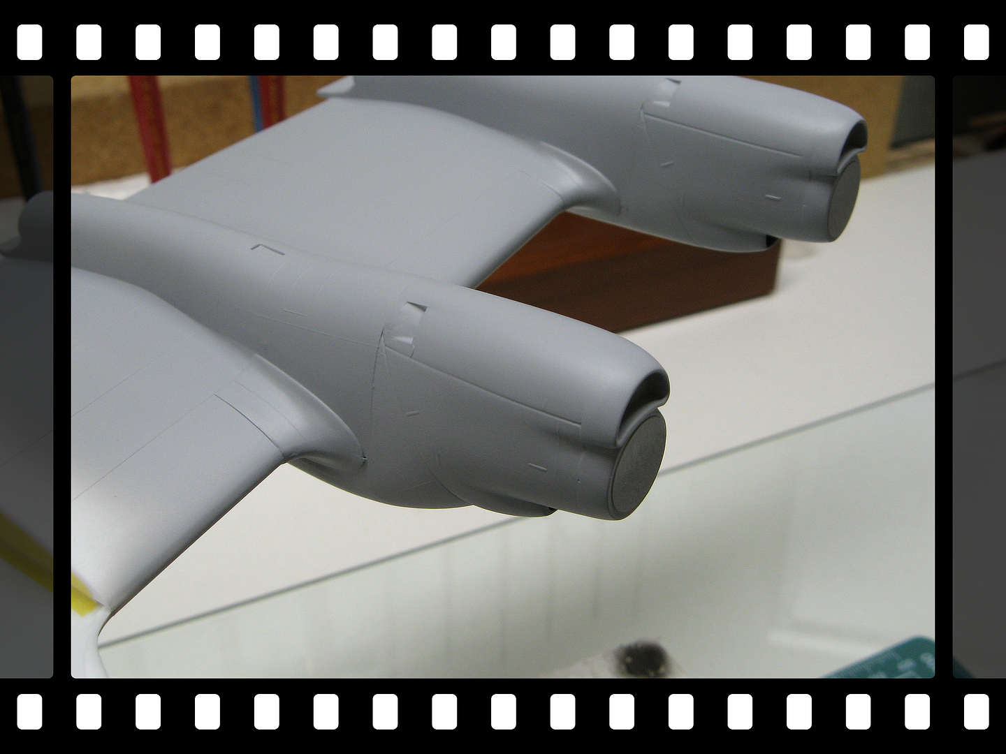

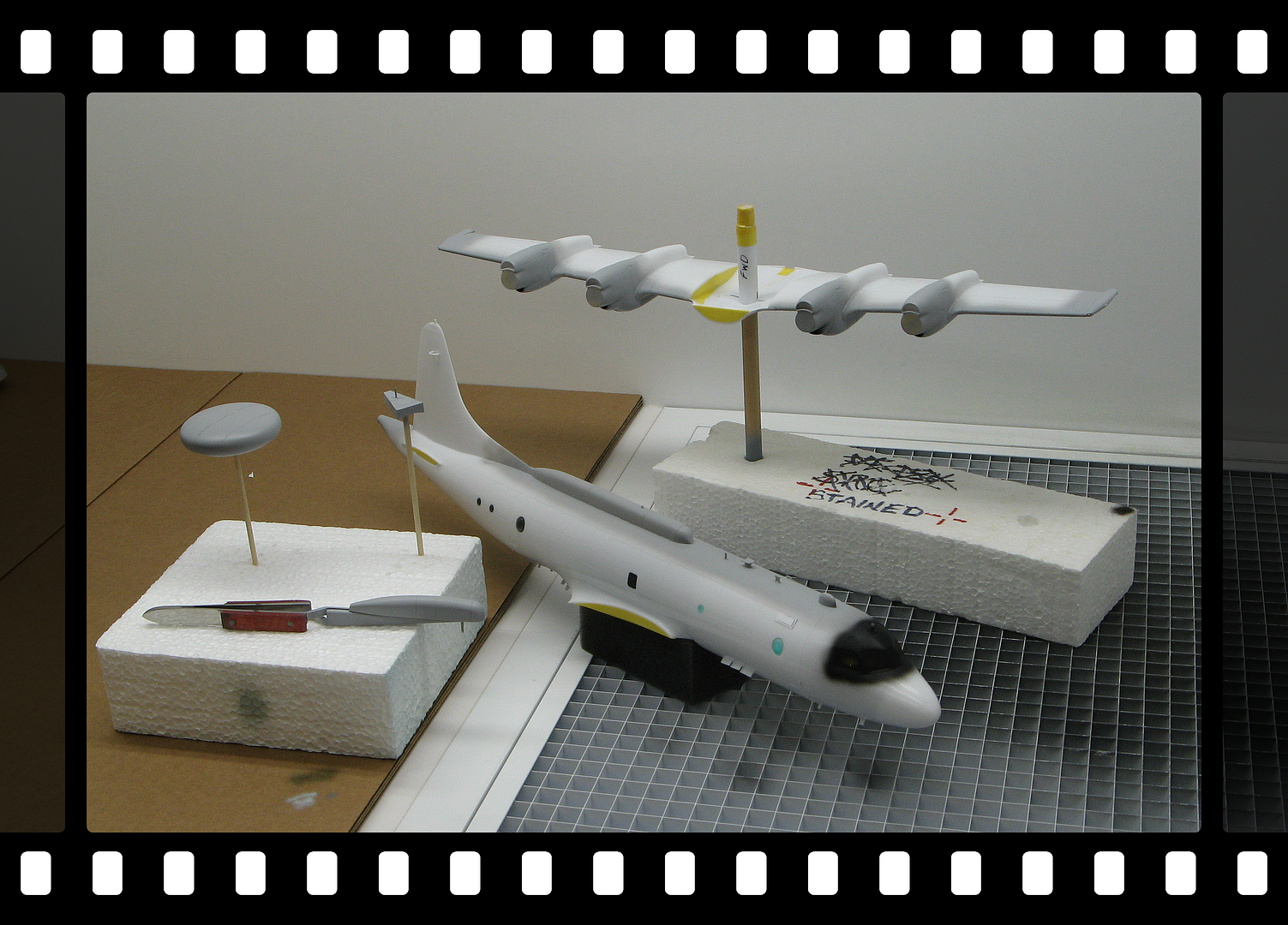

A-10 LOADER Posted June 30, 2023 Author Share Posted June 30, 2023 Some EP-3 progress for today. I managed to get the wings and the other parts primed this morning. I'm pretty happy with how everything looks so far except for the belly radome. There are still some tiny pinholes that will need filling, again 😡. Hopefully this will be the last go around with it. The engine nacelle's look much better than I thought they would, everything seems to have blended in nicely. The fuselage didn't get primed because I had to re-apply the Mr. Masking Sol R to some of the windows because it peeled off during the wet sanding process. I've decided to paint the wings and fuselage separate, like AWACS-RESIN did with his E-6B Mercury build. This will allow for a more cleaner paint job for those "tight areas". The wings fit really well to the fuselage so the plan is to paint, gloss coat, decal ( which Caracal is supposed to be doing later this year 🤞🤞 ), gloss coat then I'll attach the wings and blend everything in at that point, that's the plan anyway. I hope everyone has a safe and happy holiday weekend. Steve Quote Link to post Share on other sites

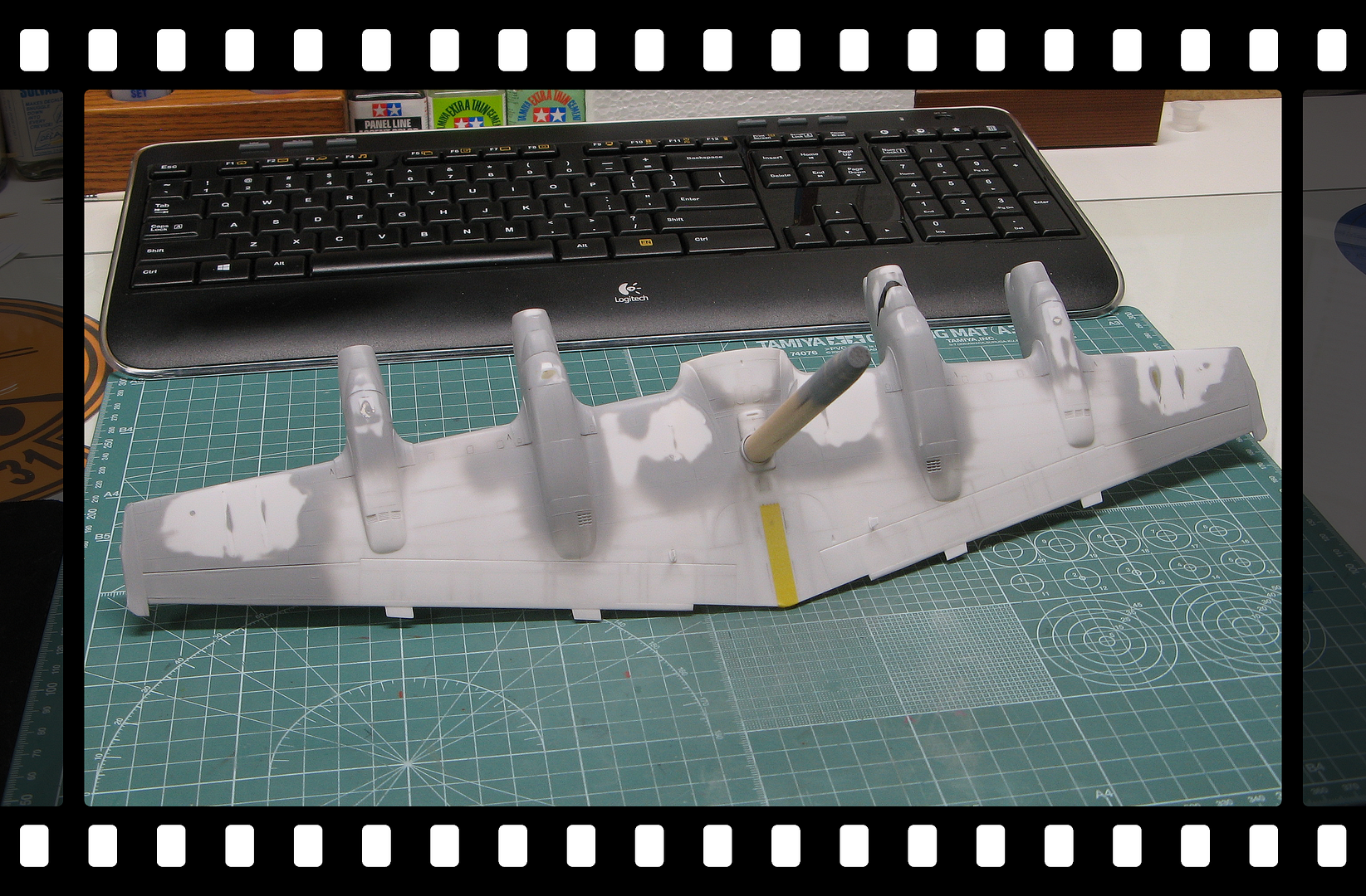

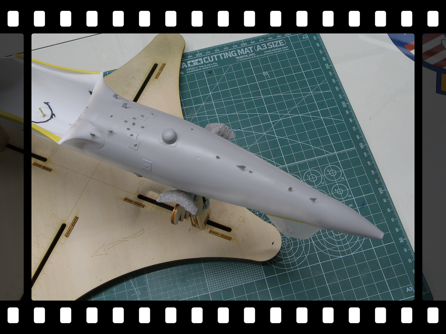

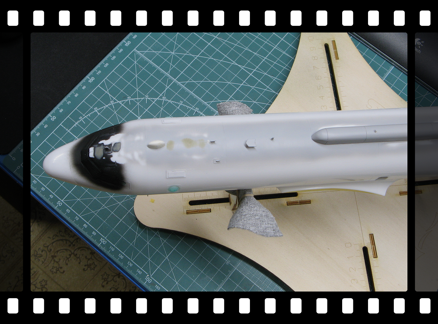

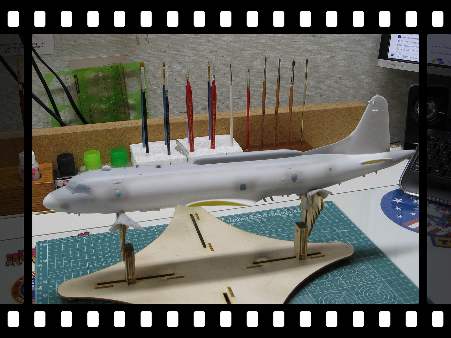

A-10 LOADER Posted July 5, 2023 Author Share Posted July 5, 2023 The fuselage, like the wings, got some coats of Mr. Primer Surfacer 1000 sprayed onto the "body worked" areas. This was my first time using this stuff and, it's really a great product, just like their primers. It fills in all those minor imperfections really well. I feel like I'm back at the body shop prepping a car for paint. I had a few trouble spots on the AMT-50 Antenna Dome so I applied some Tamiya White putty. Once that dries I'll sand the entire fuselage and hopefully put on the final primer coat before paint 🤞. We're slowly getting there. Steve The underside, with all the filling and sanding for the sonobuoy holes, looks much better now. Quote Link to post Share on other sites

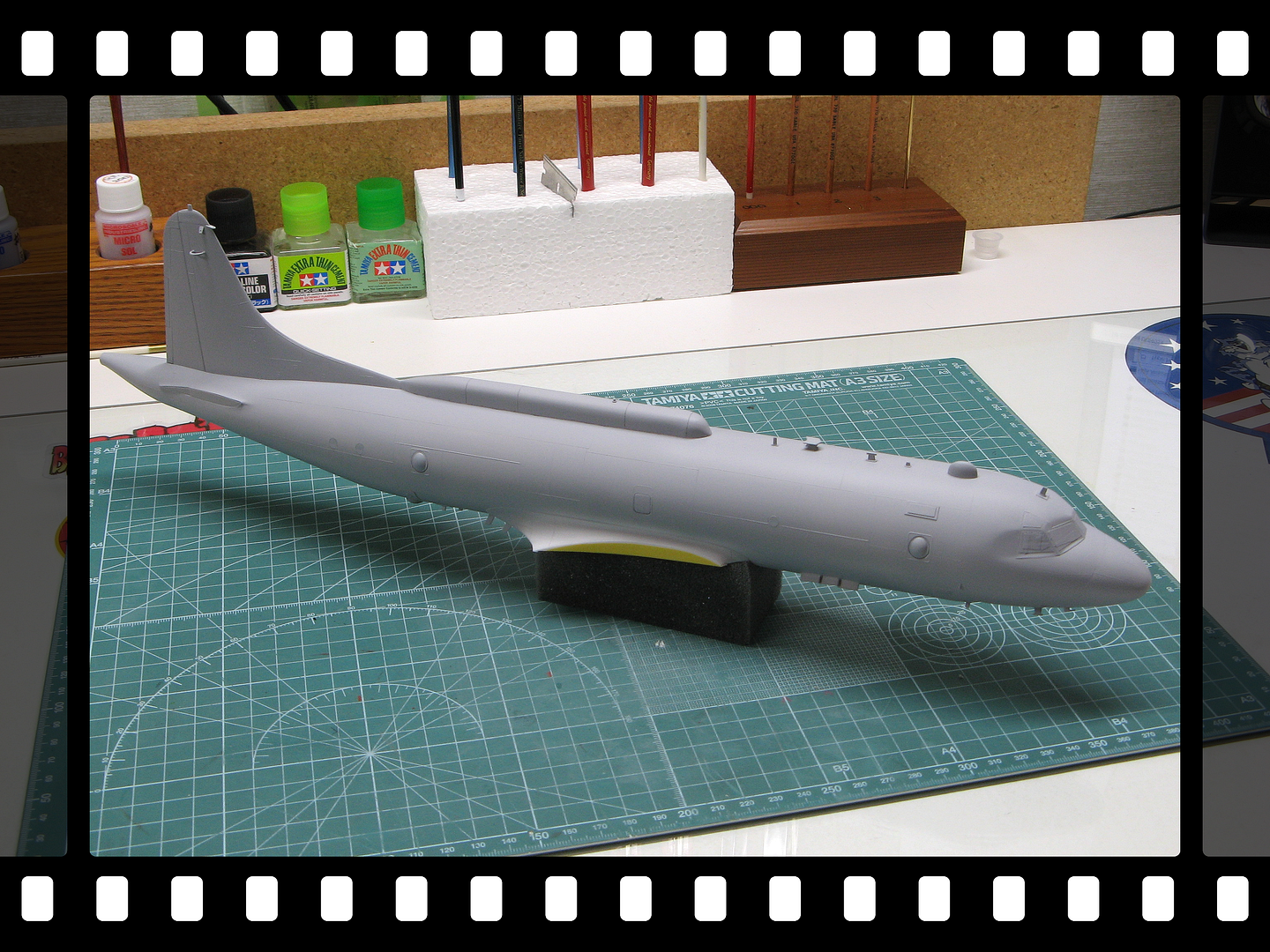

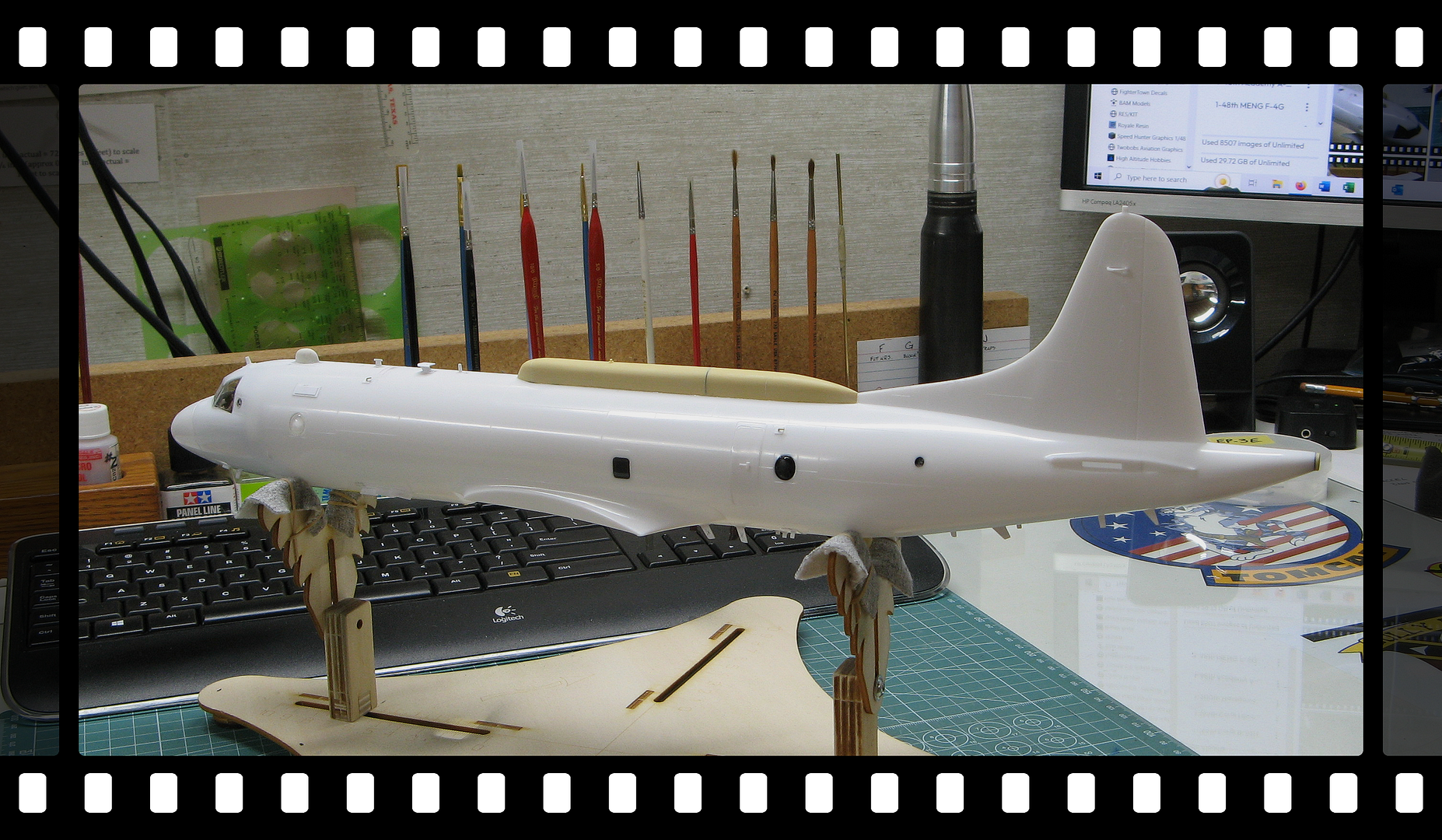

A-10 LOADER Posted July 6, 2023 Author Share Posted July 6, 2023 17 hours ago, Dutch said: Wow, Steve! You are making tremendous progress of late. Thanks very much Dutch, very much appreciated. The fuselage is finally in primer and, everything looks ok. Next up will be some color. Steve Quote Link to post Share on other sites

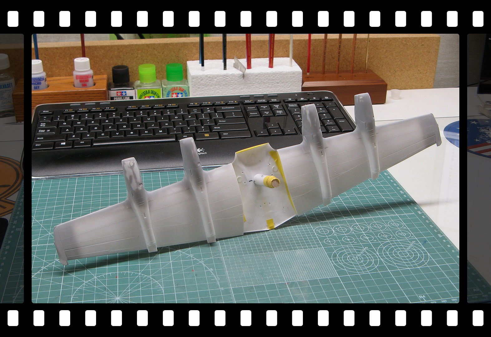

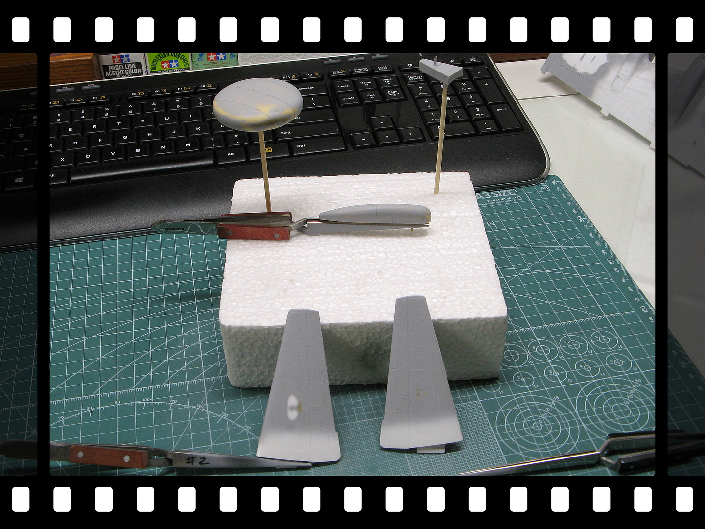

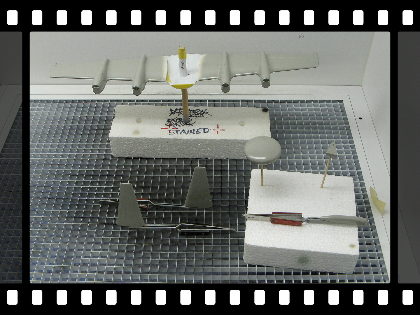

A-10 LOADER Posted July 7, 2023 Author Share Posted July 7, 2023 Managed to get the Gloss Gull Gray on most of the parts today. I found two minor imperfections around the nose area which will need attention before I can spray the fuselage. She's getting there. Steve Quote Link to post Share on other sites

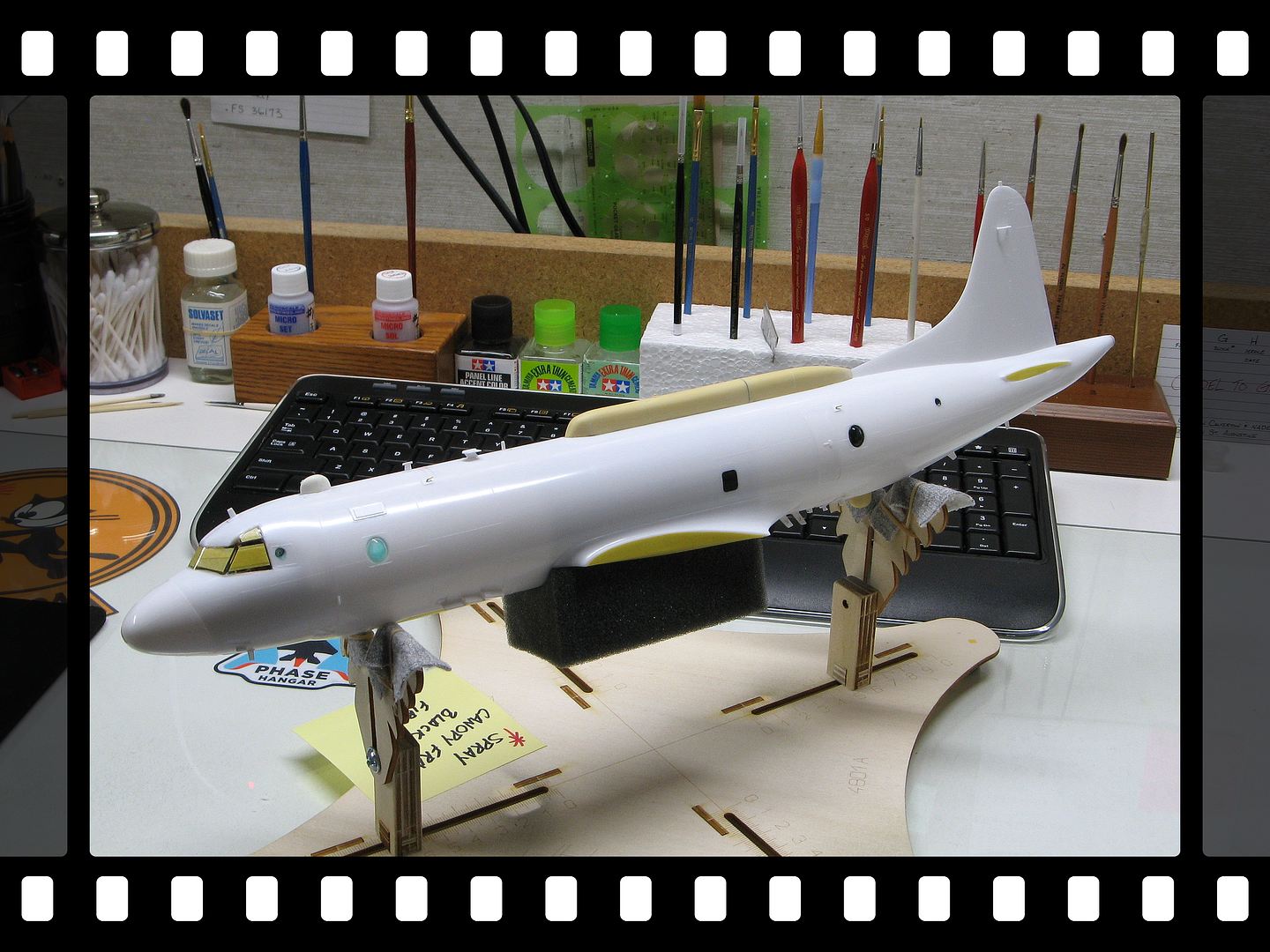

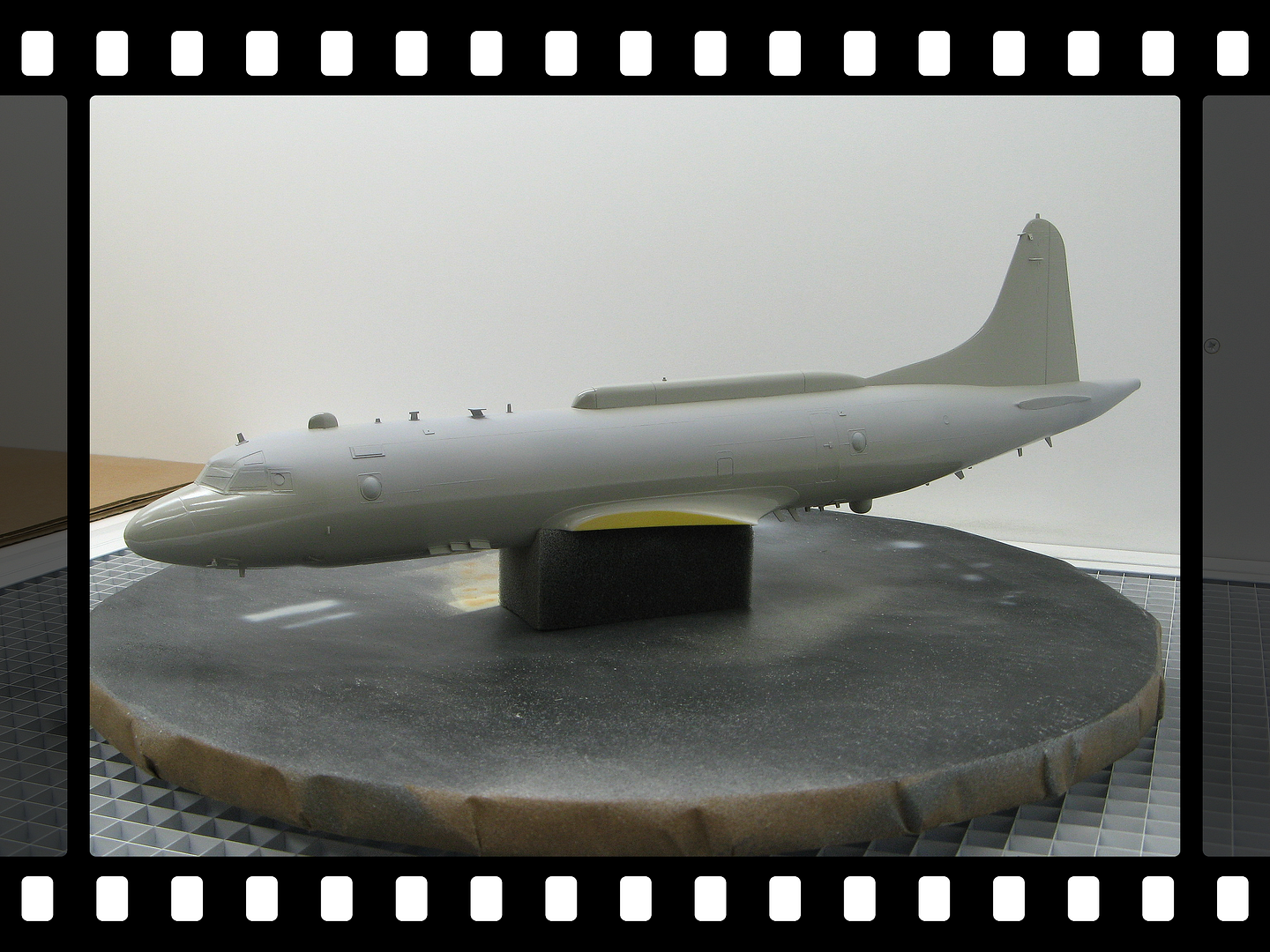

A-10 LOADER Posted July 10, 2023 Author Share Posted July 10, 2023 (edited) 1 hour ago, RichB63 said: Looks great Steve! What kind of paint are you using for the Gloss Gull Gray? Rich Thanks very much Rich. The GGG is Model Master Enamel. Another small step closer to the finish line, I got the Gloss Gull Gray applied to the fuselage this afternoon. I'll give this a couple of days to dry really well before I mask off for the white. No sense of rushing things at this point. Steve Edited July 10, 2023 by A-10 LOADER Quote Link to post Share on other sites

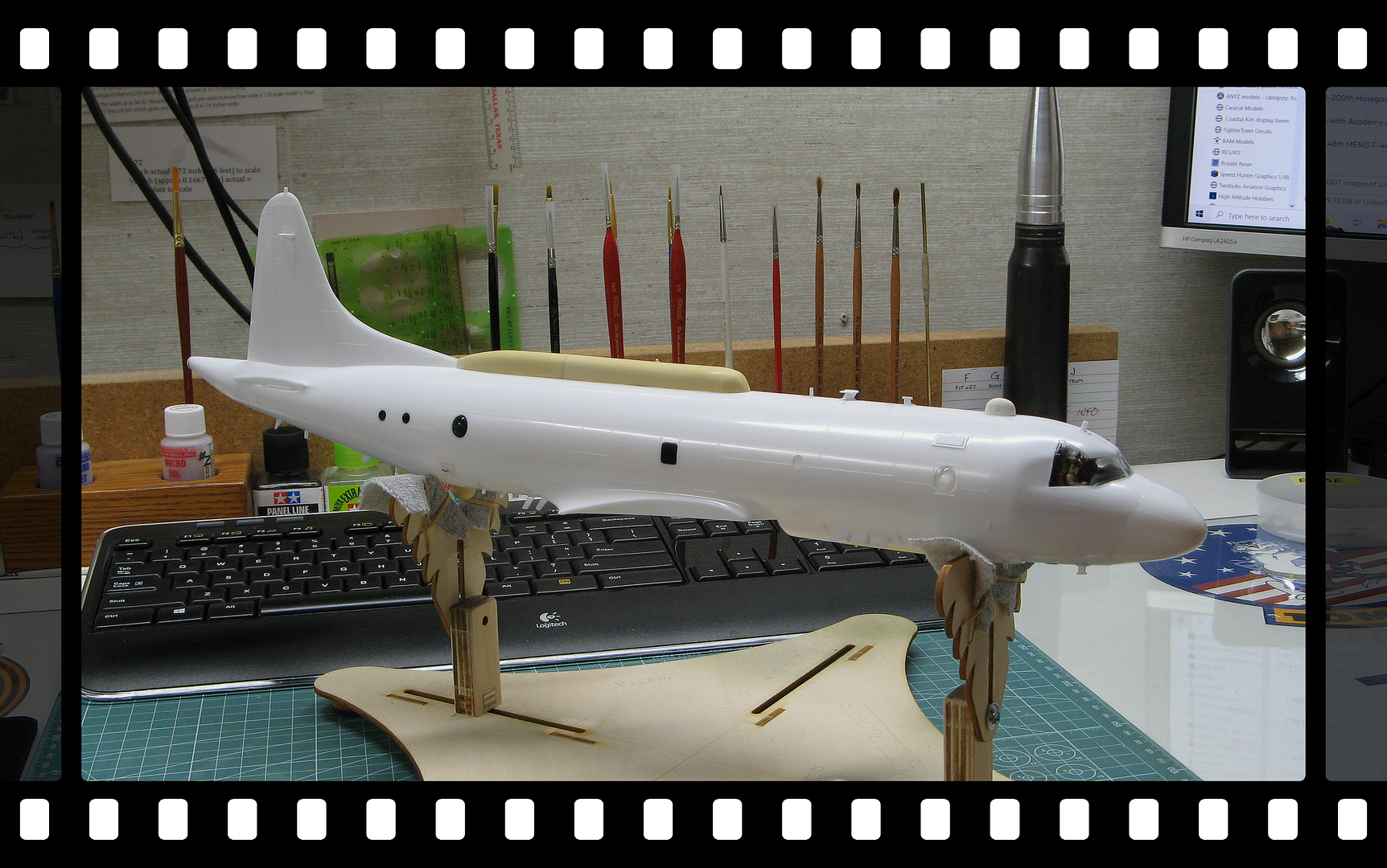

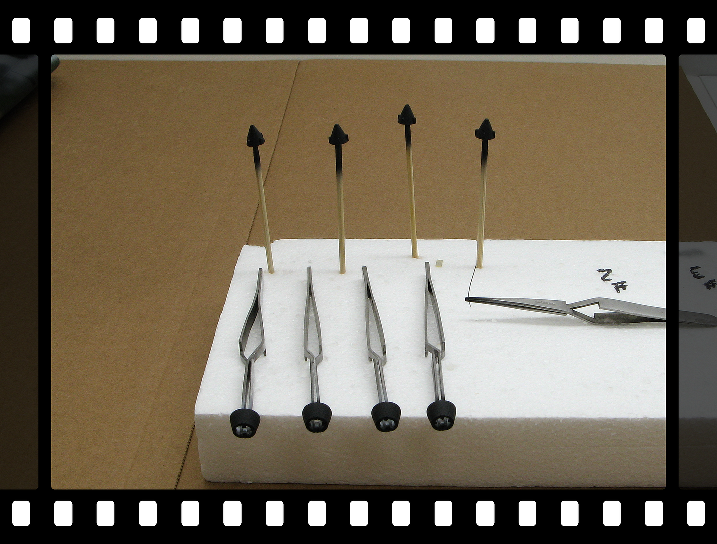

A-10 LOADER Posted July 21, 2023 Author Share Posted July 21, 2023 (edited) After lot's of masking, I managed to get the gloss white on the fuselage this morning, now she's starting to come together. The prop spinners and, the whip antenna, got a coat of flat black. Work still continues on making the "spinning props" look acceptable. Steve Edited July 21, 2023 by A-10 LOADER Quote Link to post Share on other sites
