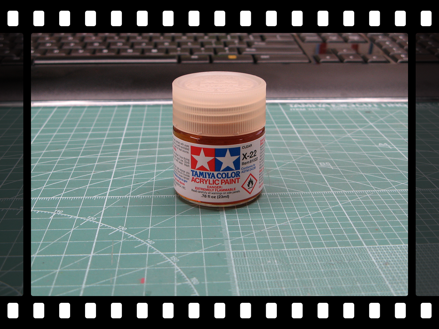

A-10 LOADER Posted September 12, 2024 Author Share Posted September 12, 2024 I forgot to add this yesterday as a side note. This is one of two bottles I purchased to use on the prop disks for my AC-J, I figured I'd be doing the same thing for the EP-3. Has anyone else had this issue with the X-22 clear ?? This bottle hasn't even been opened yet. I hope my prop disks on the AC-J don't turn yellow and, needless to say I'll have to find something else to use on the EP-3 disks. Steve Quote Link to post Share on other sites
Dutch Posted September 12, 2024 Share Posted September 12, 2024 Way to go Steve! I have ruined many a model by not testing as you have done, so lesson learned! Test from now on, especially when mixing paint systems. Quote Link to post Share on other sites
A-10 LOADER Posted September 12, 2024 Author Share Posted September 12, 2024 7 hours ago, Dutch said: Way to go Steve! I have ruined many a model by not testing as you have done, so lesson learned! Test from now on, especially when mixing paint systems. Oh most definitely. Steve Quote Link to post Share on other sites

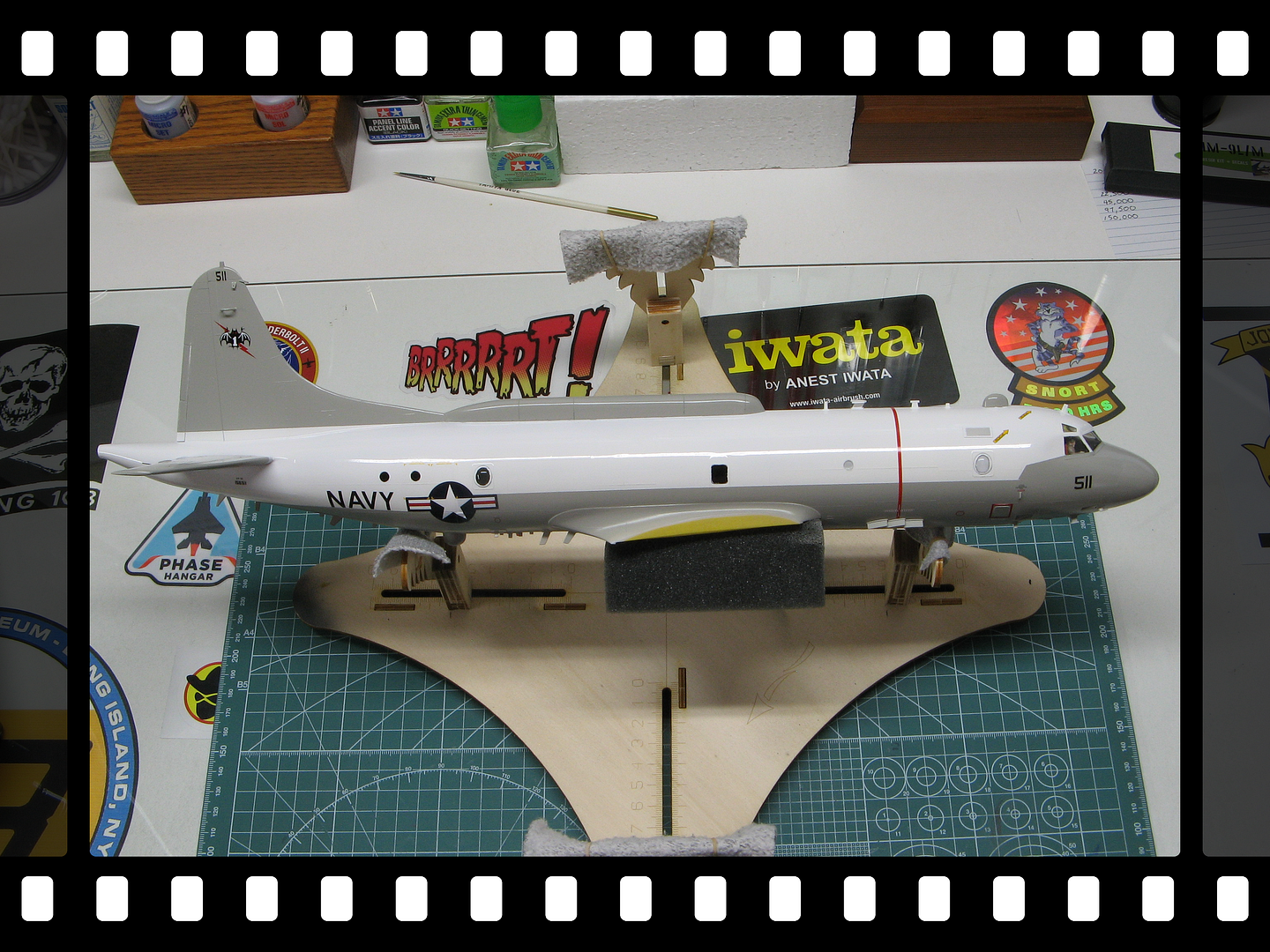

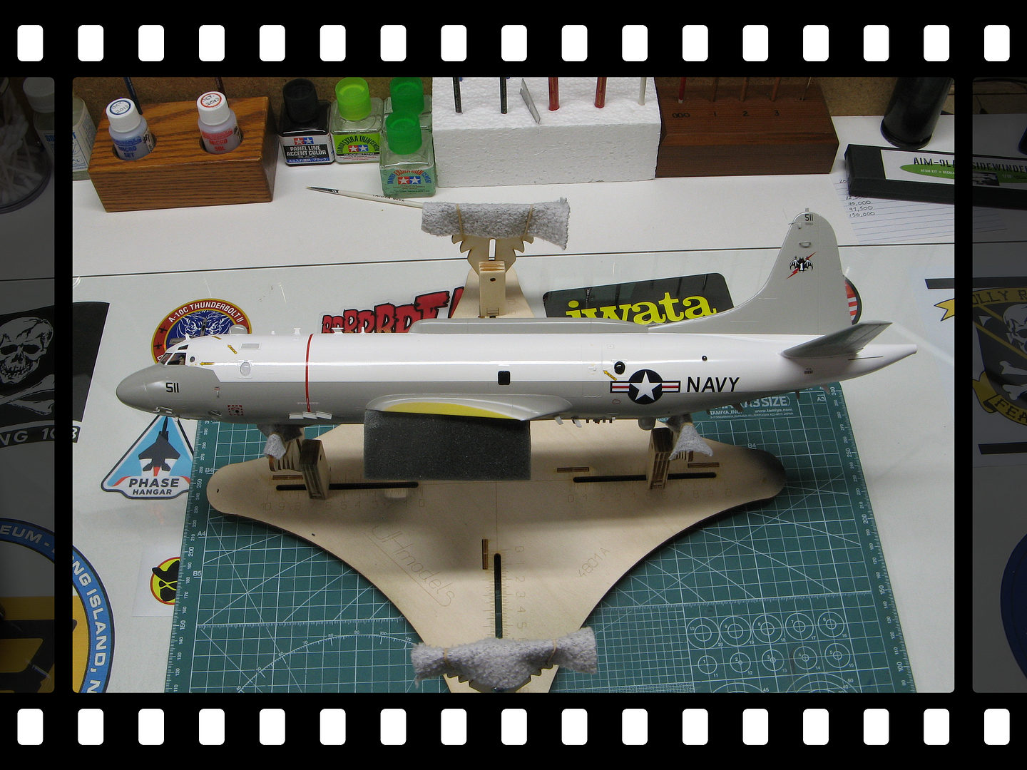

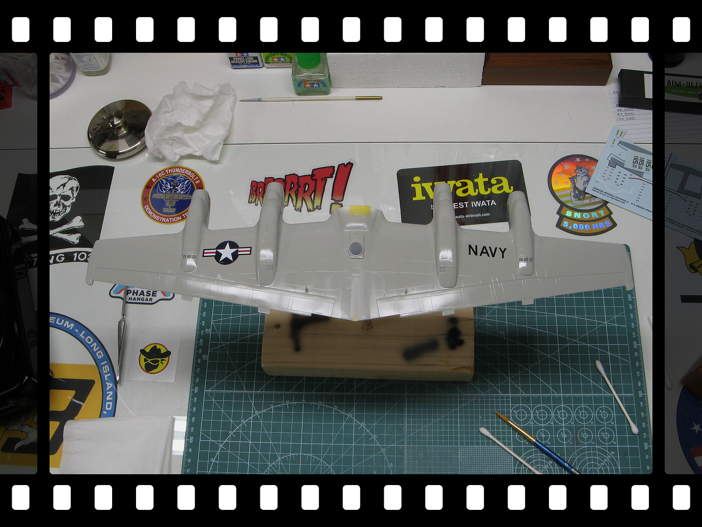

A-10 LOADER Posted September 17, 2024 Author Share Posted September 17, 2024 Managed to get some "personality" added to the old girl last night. My first time using Caracal Decals and they worked very well. The wing walkways were a bit of a challenge as I thought they would be and I had to use one from a second sheet because one tore trying to get it into position ( this is why I purchased 3 sets, just in case ). The "plane of rotation" red stripe I'm avoiding until the end, I think this will be a challenge as well. Hopefully the data and walkways will be offered as separate sheets in the future ? I left off some decals around the wing root areas because the wing still needs to be attached to the fuselage. Once I get the port side decals on, I'll seal them in with another gloss coat then, attach the wing and blend in the gray then add the decals in that area. Steve Quote Link to post Share on other sites

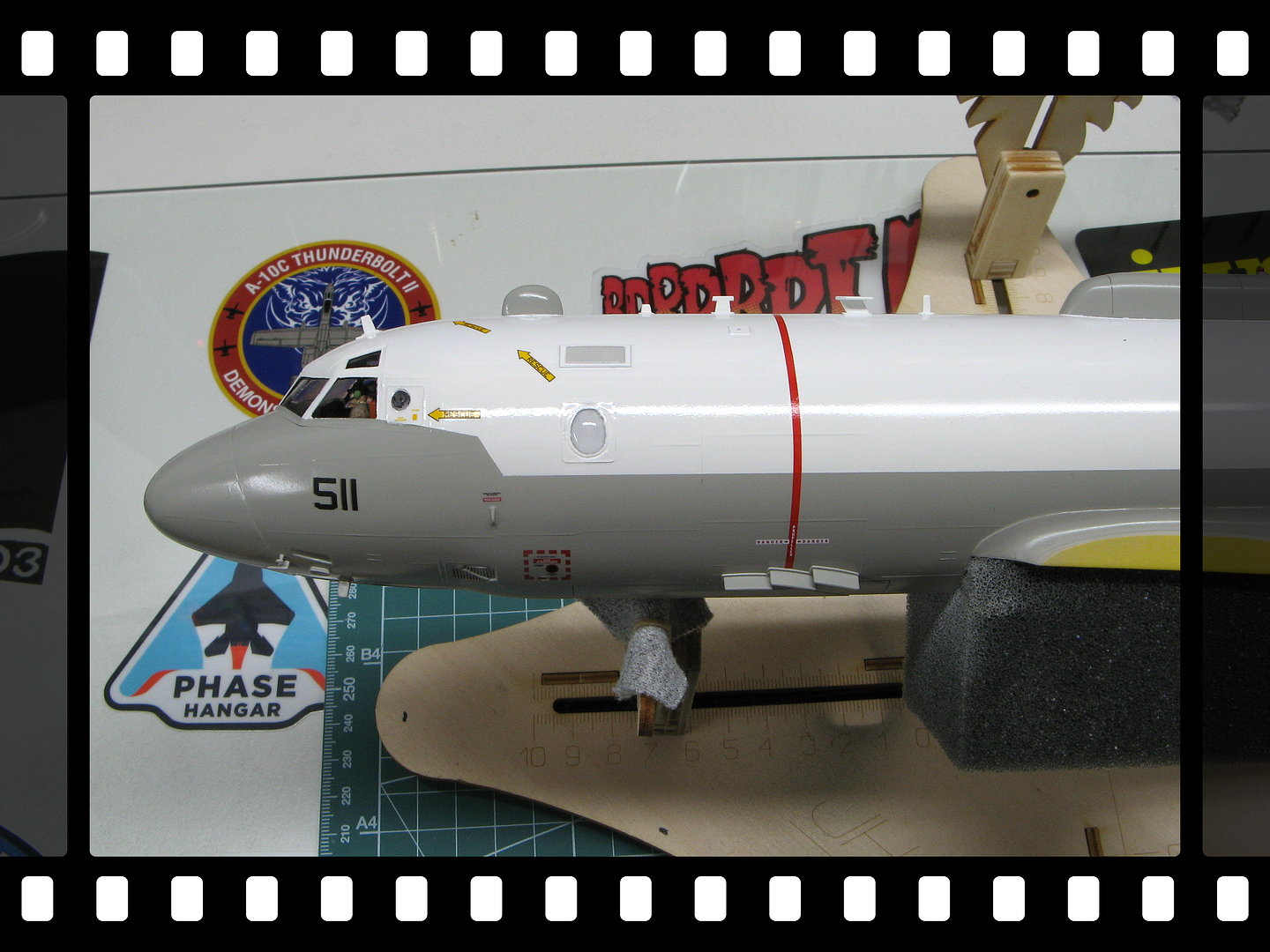

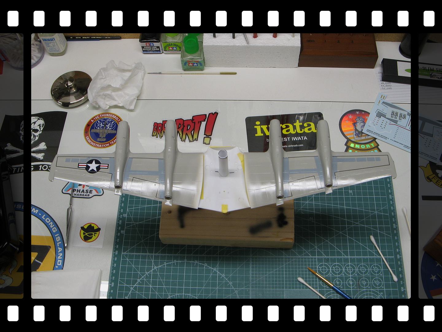

A-10 LOADER Posted September 18, 2024 Author Share Posted September 18, 2024 All the markings that I can put on for now are applied. Once the wings are glued on, I can blend the gray in the wing root area and, add the last few decals around the window above that area. Instead of using the pieces of the red warning stripe for the prop area that's supplied on the decal sheet, I used a piece of red decal strip from my stash. Doing this as one piece is much easier IMO. The nose number, tail fin cap number and, BUNO's were printed by my buddy Dave Aungst. She's getting there. Steve Quote Link to post Share on other sites

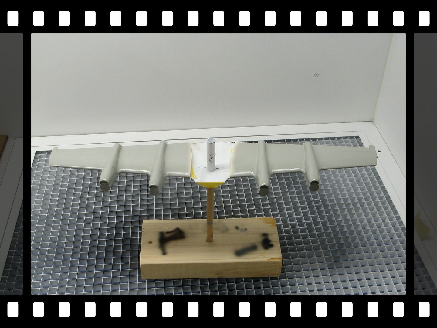

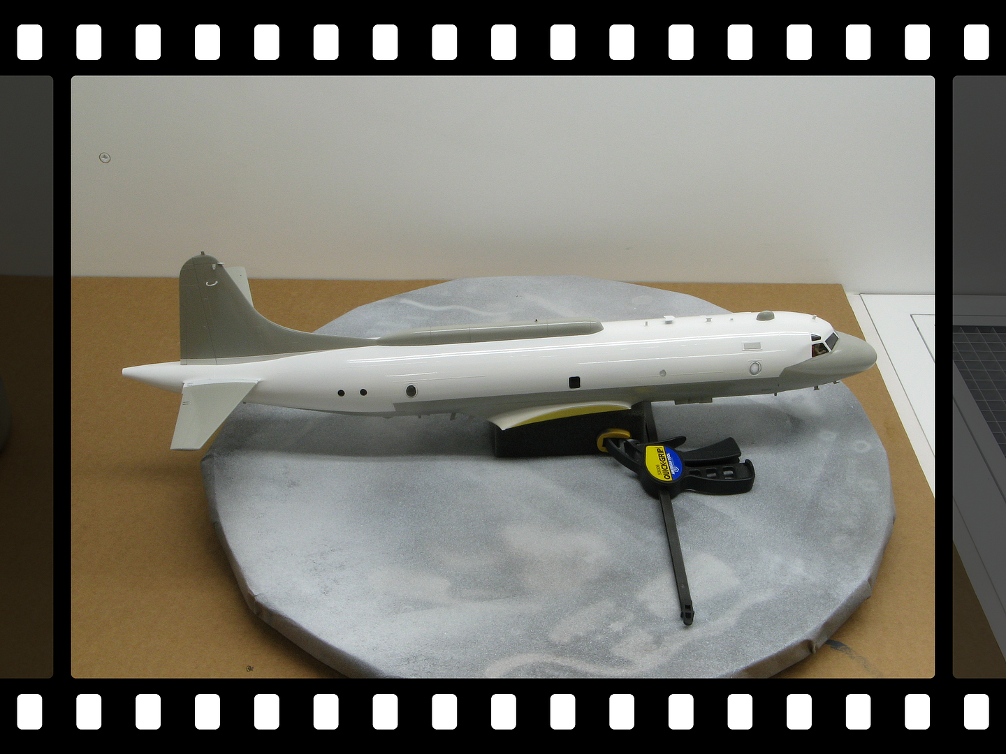

A-10 LOADER Posted September 25, 2024 Author Share Posted September 25, 2024 I got the decals sealed in tonight with another coat of gloss. I had heard that if you put too heavy of a gloss coat on, using the Alclad, the surface could remain tacky when you touched it with your bare fingers. Apparently my first coats before decalling were on the heavy side even though I thought they were light. It was slightly tacky, not enough to leave prints but, I didn't want to risk it so I used gloves to finish the decals. She was originally gloss coated on September 14 and a day or two ago I noticed she was dry. I had placed the fuselage and the wings in my Aviation Room which has a dehumidifier in it and, that really helped. So tonight after glossing her again, very lightly, she went back in the room and we'll see how she is tomorrow. Once dry enough to handle I'll glue the wings to the fuselage and blend the GGG paint in on those wing and belly areas and finish the decals. Steve Quote Link to post Share on other sites

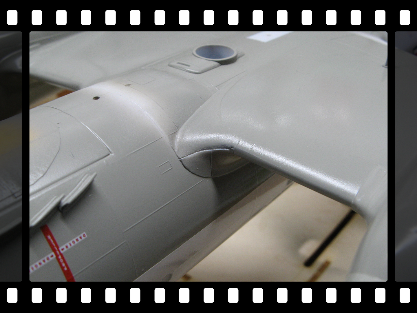

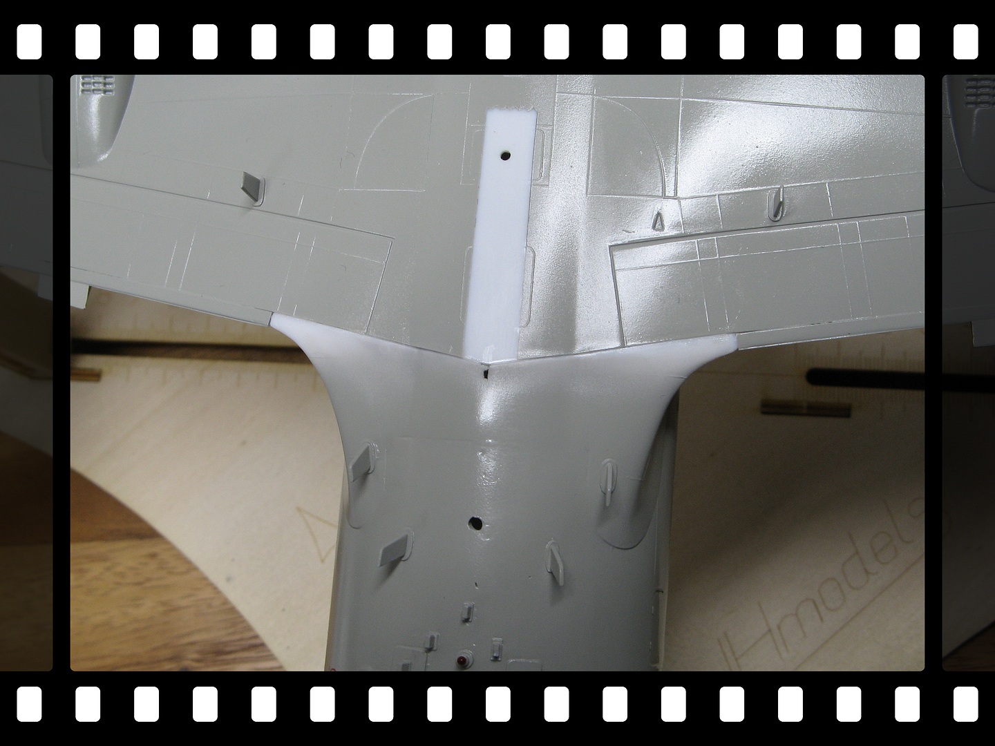

A-10 LOADER Posted September 26, 2024 Author Share Posted September 26, 2024 I got the wings glued to the fuselage. The seams worked out great, hardly any cleanup is needed. Next I'll blend in the Gloss Gull Gray where needed and finish up the decals. She's starting to come together. Steve Quote Link to post Share on other sites
