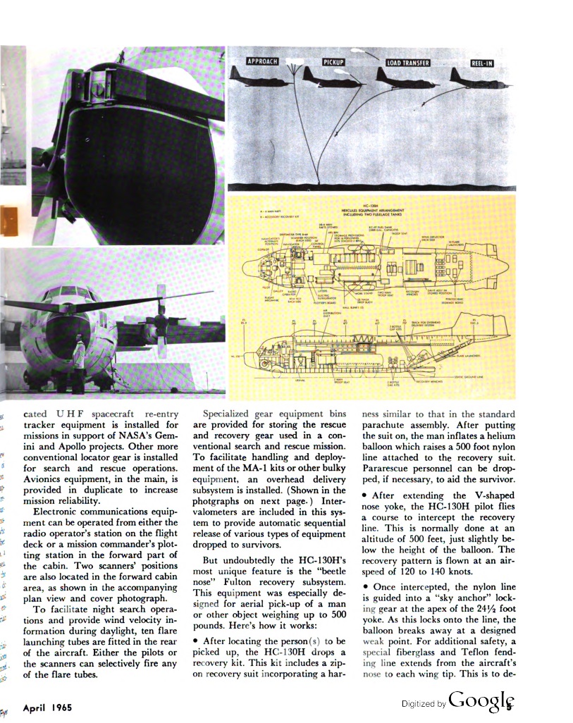

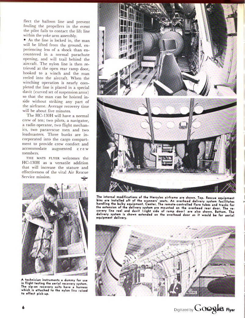

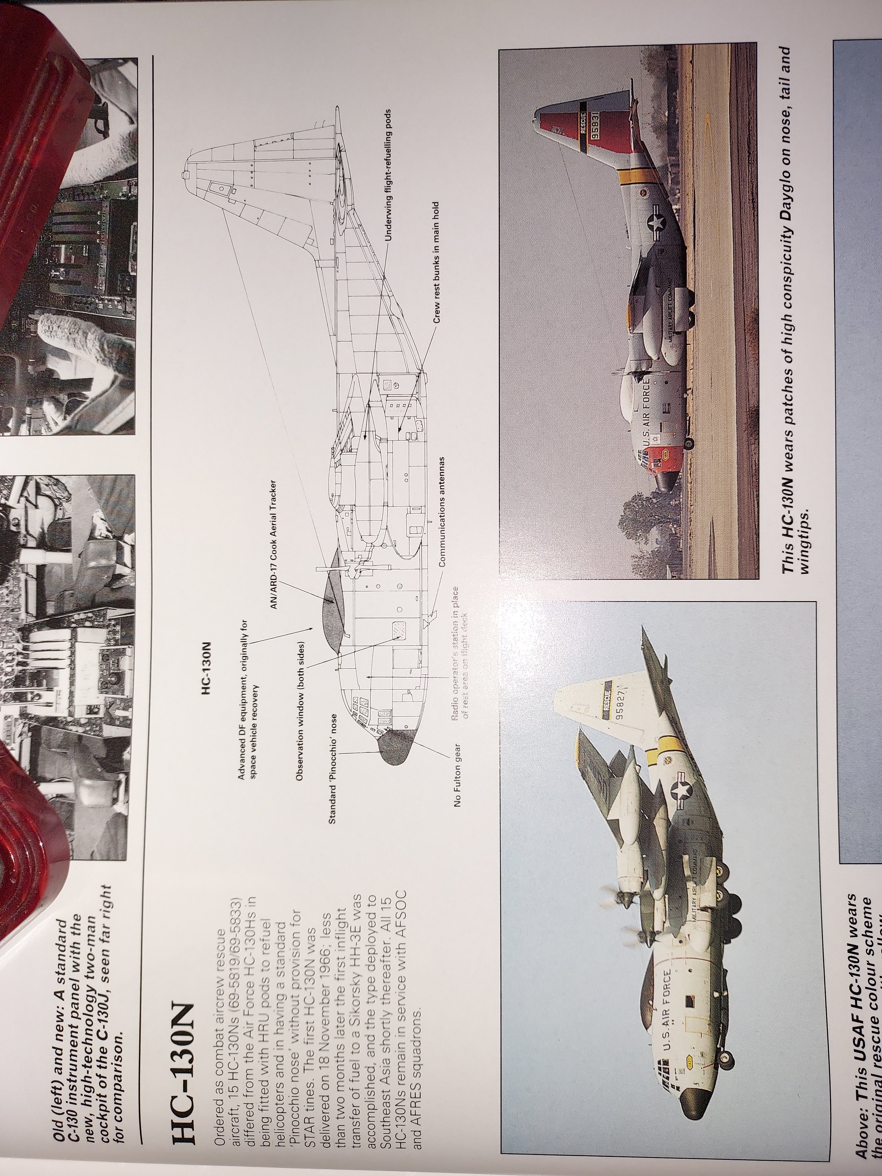

andyf117 Posted April 23 Share Posted April 23 (edited) A few more I found (all enlargeable) - this one's not any better than the first I posted, but it's from another angle, at least: Whilst these might help with shape. size and spacing of the attachment points, along with the flare chutes inbetween in the lower section: Edited April 23 by andyf117 Quote Link to post Share on other sites
aircommando130 Posted April 23 Share Posted April 23 You can get by with some thin angle on the door. They had some gusset plates every few feet to give it strength. The carriage rolled out on the door with the MA-1 rescue kit on it and then dropped all 5 bundles about 1 second apart. Quote Link to post Share on other sites

andyf117 Posted July 25 Share Posted July 25 (edited) Been a few months and you've quite probably finished this by now, but whilst posting in another thread I noticed the photos in the old Airfix Magazine article which I uploaded included a ramp shot: Edited July 25 by andyf117 Quote Link to post Share on other sites

Trojan Thunder Posted July 26 Author Share Posted July 26 23 hours ago, andyf117 said: Been a few months and you've quite probably finished this by now, but whilst posting in another thread I noticed the photos in the old Airfix Magazine article which I uploaded included a ramp shot: Thanks, it shows some nice detail I could not figure out previously. Quote Link to post Share on other sites
andyf117 Posted July 26 Share Posted July 26 4 hours ago, Trojan Thunder said: Thanks, it shows some nice detail I could not figure out previously. Always pleased to help when I can, and glad this wasn't too late after all! Quote Link to post Share on other sites
Buckmeister Posted July 27 Share Posted July 27 On 7/25/2023 at 6:06 AM, andyf117 said: Been a few months and you've quite probably finished this by now, but whilst posting in another thread I noticed the photos in the old Airfix Magazine article which I uploaded included a ramp shot: That’s a fantastic close up shot of the rails on the ramp door, thanks! Quote Link to post Share on other sites
