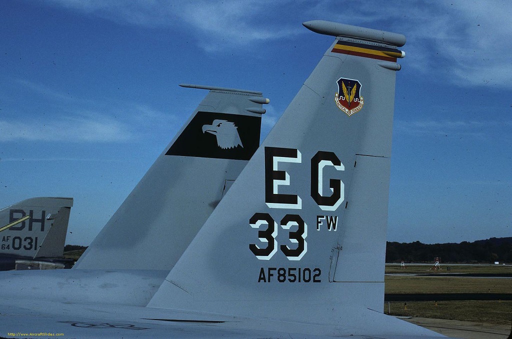

kellyF15 Posted May 2, 2023 Share Posted May 2, 2023 As far as the vertical stabilizer beef up plates, on stike eagles it was a case by case basis depending on cracks when I was on them. I havent been on them since 2008 though..... Quote Link to post Share on other sites
M.F.Lunder Posted May 2, 2023 Author Share Posted May 2, 2023 24 minutes ago, kellyF15 said: As far as the vertical stabilizer beef up plates, on stike eagles it was a case by case basis depending on cracks when I was on them. I havent been on them since 2008 though..... Sounds like they are patches, just out of curiosity, are they custom made for each crack or standard pieces? Quote Link to post Share on other sites
kellyF15 Posted May 2, 2023 Share Posted May 2, 2023 8 minutes ago, M.F.Lunder said: Sounds like they are patches, just out of curiosity, are they custom made for each crack or standard pieces? I dont even remember lol I think it depended where the cracks were at. The verts flex alot in flight. Quote Link to post Share on other sites
M.F.Lunder Posted May 3, 2023 Author Share Posted May 3, 2023 (edited) 18 hours ago, kellyF15 said: I dont even remember lol I think it depended where the cracks were at. The verts flex alot in flight. That makes sense. Considering 85-102 was rather new during Desert Storm, I can only guess the training must have been intensive. Edited May 3, 2023 by M.F.Lunder Quote Link to post Share on other sites

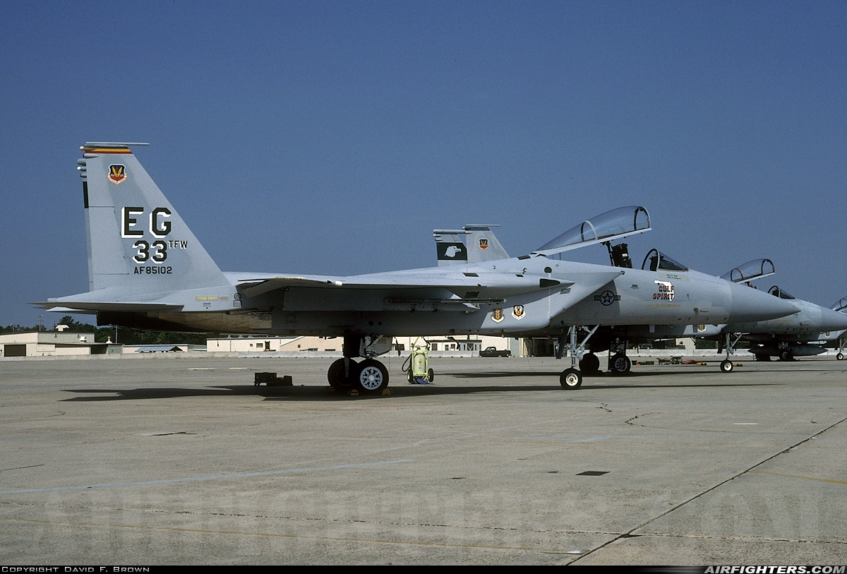

M.F.Lunder Posted January 14, 2024 Author Share Posted January 14, 2024 Hi guys, I've come back for the DS eagles build after months of pause, ths time using the new Finemodls F-15J to build the Gulf Spirit. Of course questions rised when looking at the details Thiw time they are regarding the Cs: 1. There is a bump/antenna (red arrow) betweem the MLG doors which I have never seen on other kits, I did see it on the USAF eagles but they are obviously in later yearsl, Hence the question is whether the antenna was there during DS? 2. I think this is a topic discussed frequetly, was the exhause louver for the JFS removed, more specificly, for the EG birds or on 85-102? I am under the impression that MSIP birds have them removed, but I've seen picture with them on, so I am confused again.... 3. Regarding the chaff/flare dispenser, FM provide 2 type of them as suppliment parts, what kind was used during DS? Thanks, Chris Quote Link to post Share on other sites
jrasia Posted January 15, 2024 Share Posted January 15, 2024 I can't answer questions #2 and #3 for that specific tail number. For your first question however, that bump\antenna is actually just a fuel plug cover for when the centerline pylon and fuel tank is NOT used. Its nice FM actually molded it. Lots of kits just ignore it and assume everyone puts a pylon. Quote Link to post Share on other sites

M.F.Lunder Posted January 16, 2024 Author Share Posted January 16, 2024 13 hours ago, jrasia said: I can't answer questions #2 and #3 for that specific tail number. For your first question however, that bump\antenna is actually just a fuel plug cover for when the centerline pylon and fuel tank is NOT used. Its nice FM actually molded it. Lots of kits just ignore it and assume everyone puts a pylon. Wow, always learn a new thing everyday! I think when FM made the bump they didn't know what it was either, as the instruction never mentioned it when center pylon and tank added. Sadly it has to go as I am doing a 3 tank configeration, 7 hours ago, Murph said: The JFS louvers weren't removed till after Desert Storm. You could use either one of the chaff/flare dispensers. The expendables would vary depending on the mission and chaff/flare availability. Regards, Murph Thanks Murph, you are always the man! Two more questions about the dispensers: 1, this may seem stupid but I assume the dispeners should be flush with the fuselage but not like gluing a part onto the kit - standing out of the fuselage? 2. I read one of your previous post, you posted the picture of the dispenser: chaff in white, flare in red, as the FM parts. When searching internet, they follwong picture always shows, this time the dispensers are black and white. I assume that the black means the chaff/flare was used, and what about the white? Does it mean what's left on the plane was chaff, or chaff and flare are all white at the time? Thanks, Chris Quote Link to post Share on other sites
