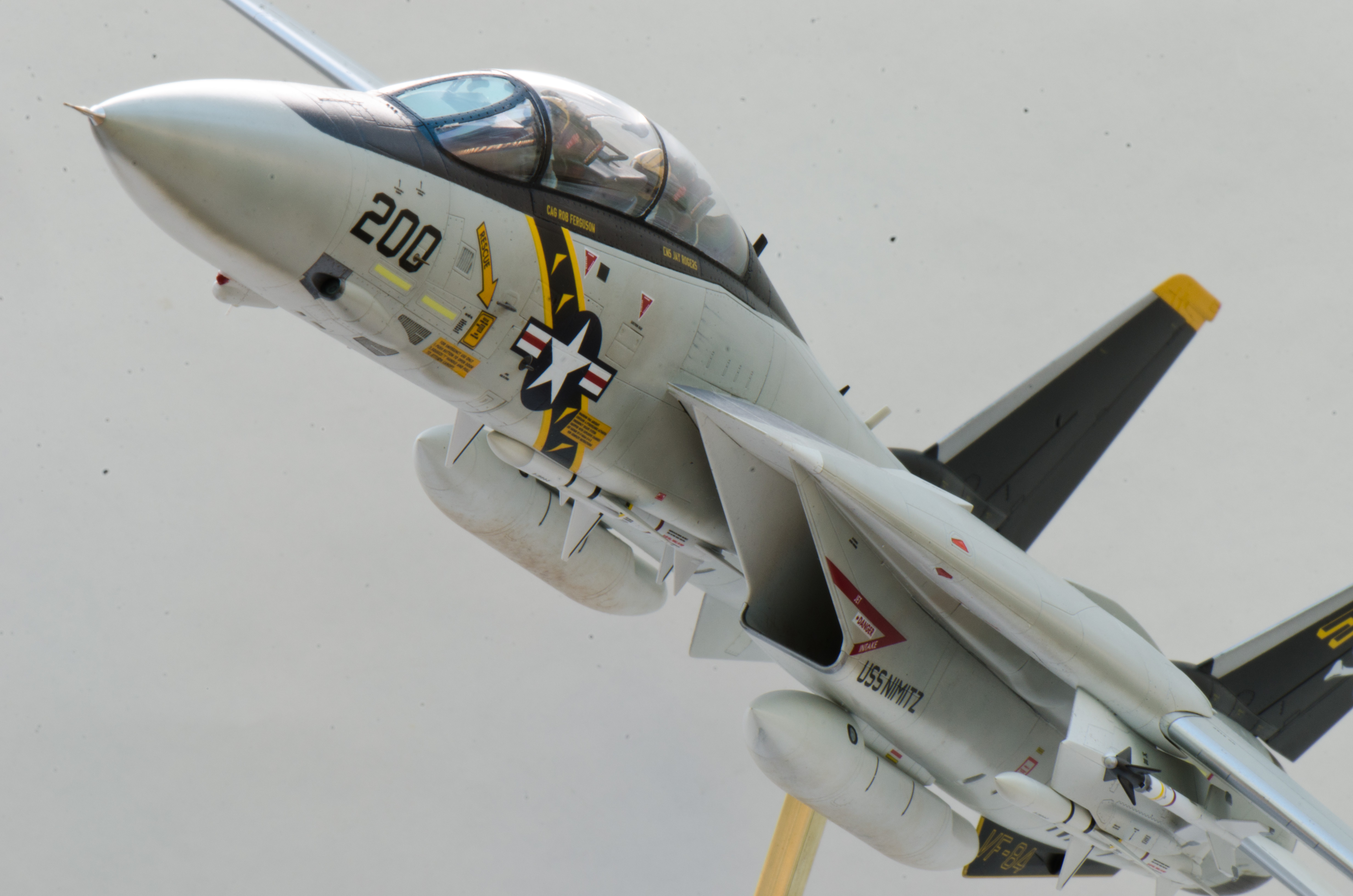

Joe Hegedus Posted May 8 Share Posted May 8 I followed the kit instructions. That's where it came from on my model, (and I'm not going to rip them off the airplane now to change the color). Quote Link to post Share on other sites

Stephen Posted May 9 Share Posted May 9 I'm guilty of this but this is good information for future builds , thanks for sharing it. Quote Link to post Share on other sites
