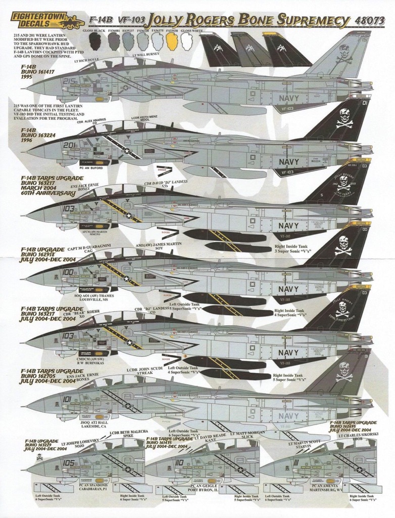

Solo Posted May 23 Share Posted May 23 I am not a Tomcat guy, so I wish to be sure about camouflage colours (second one on the picture, number 17). According to Academy instruction manual, that F-14 is painted with 2 colours: bottom, lighter is just light ghost gray FS36375, top is darker medium gray FS35237. I can't find that those colours are correct on Cybermodeller database, so - should I use that two colours, or maybe that information from manual is wrong? Anybody can help? Quote Link to post Share on other sites
joeltc Posted May 25 Share Posted May 25 (edited) If you have a look at this photo you can see two different colours on the forward fuselage. Look at the line just above the nose landing gear door. So Its most likely the same three colours as the other VF-103 jets from that time. The middle colour being FS36320. Click on the link and theres a few more photos of the same jet in that photo stream. Edited May 26 by joeltc Quote Link to post Share on other sites
Solo Posted May 25 Author Share Posted May 25 I see only two colours: darker (I believe it is 35237, the top of aircraft), and lighter FS36375 - the rest of plane. Quote Link to post Share on other sites
sigtau Posted May 25 Share Posted May 25 According to the Fightertown bone supremacy decal instructions, the VF-103 planes were painted in the 3-tone TPS scheme during this time frame. Quote Link to post Share on other sites
Solo Posted May 25 Author Share Posted May 25 Ok, now I see those 3 colours scheme. I think that is it. The Academy instruction is wrong. Quote Link to post Share on other sites
GW8345 Posted May 26 Share Posted May 26 https://www.pinterest.fr/pin/448671181604963885/ Quote Link to post Share on other sites
Solo Posted May 26 Author Share Posted May 26 That painting is a little bit different from the pictures of real F-14B - the side, darker colour of grey is on the whole sides of cockpit. On the pictures that darker color ends at RIO ejection seat point. Quote Link to post Share on other sites
GW8345 Posted May 26 Share Posted May 26 There were variations in the TPS scheme among the Tomcats so not all Tomcats will have the same TPS scheme. I posted that pic so you can see what colors were used, you can modify the demarcation lines to fit the aircraft you are doing. Quote Link to post Share on other sites
Solo Posted May 27 Author Share Posted May 27 Ok, I got it. So just to be sure: that picture's plane has 3 colour scheme: FS36375 on the bottom, FS36620 on the side of forward fuselage, and top is painted with FS35237? Quote Link to post Share on other sites
GW8345 Posted May 27 Share Posted May 27 Correct For the "official" TPS scheme, download the Mli-Std-2161A; http://everyspec.com/MIL-STD/MIL-STD-2000-2999/MIL-STD-2161A_24653/ Pg 235 (251 of the pdf) Quote Link to post Share on other sites
