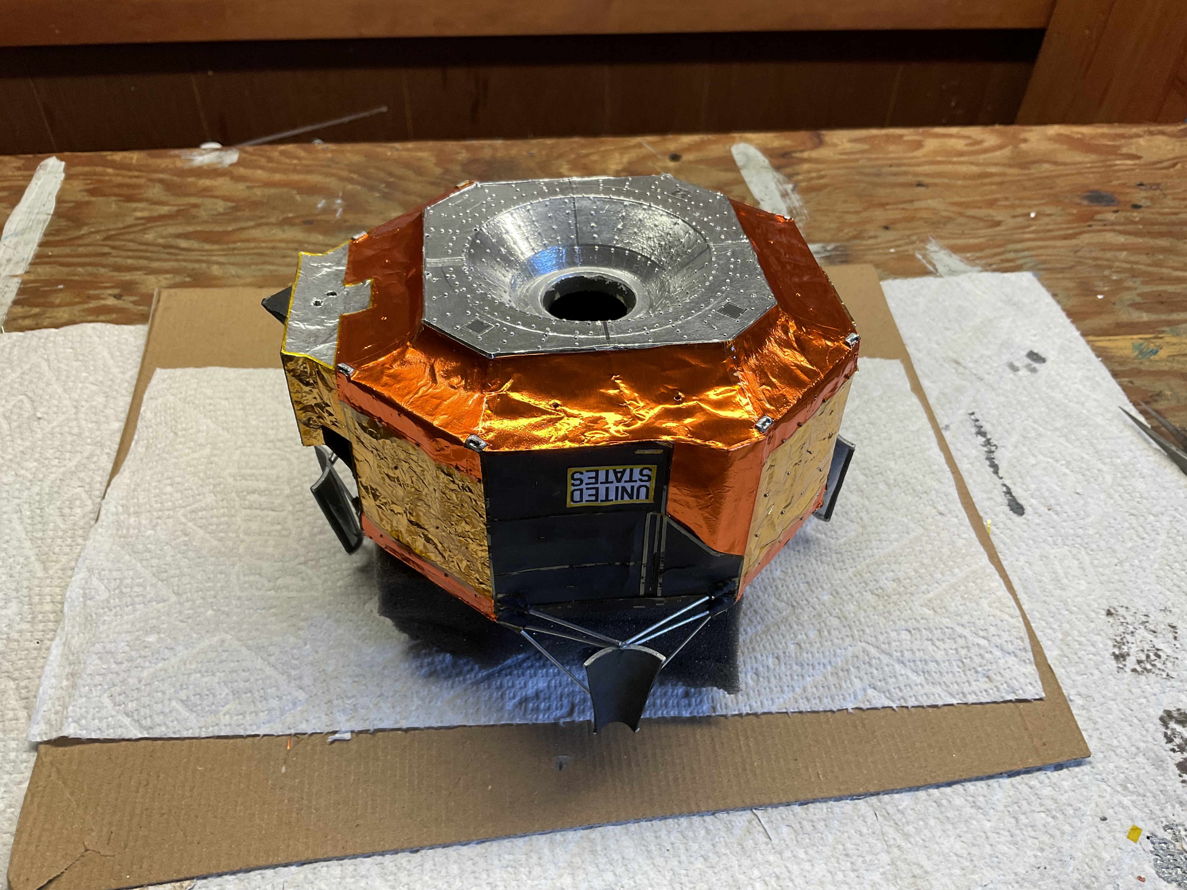

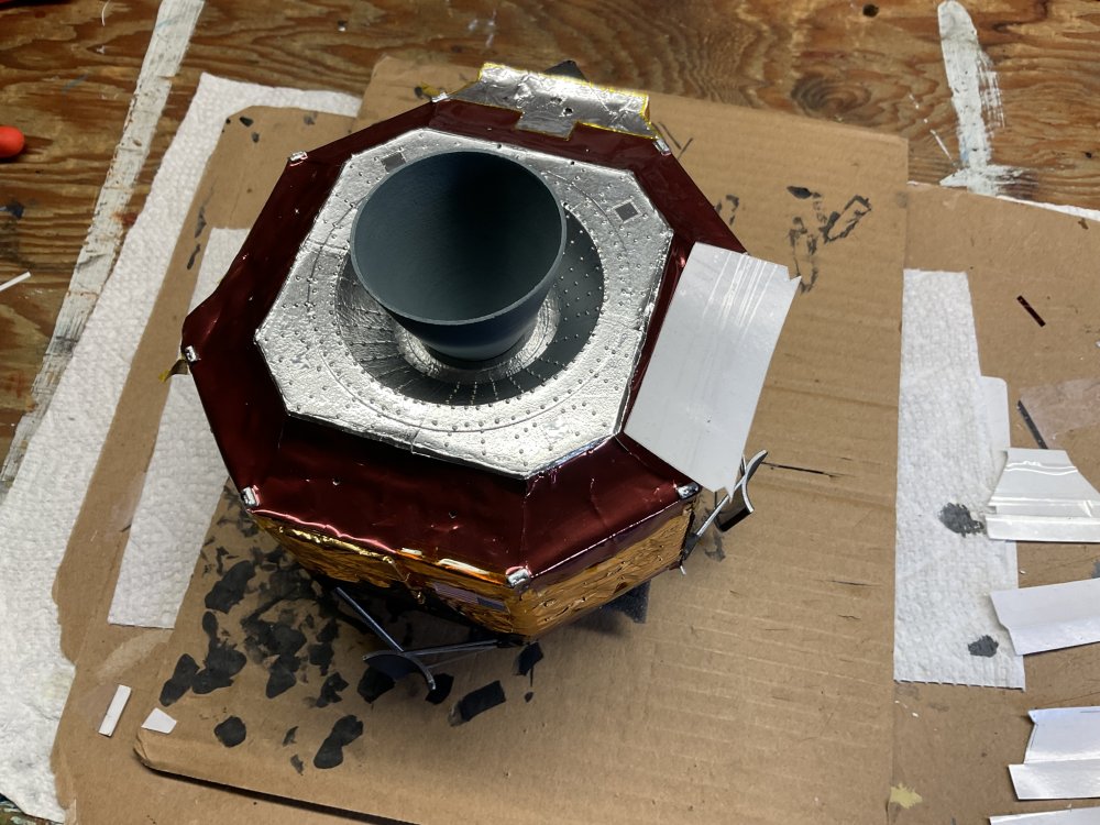

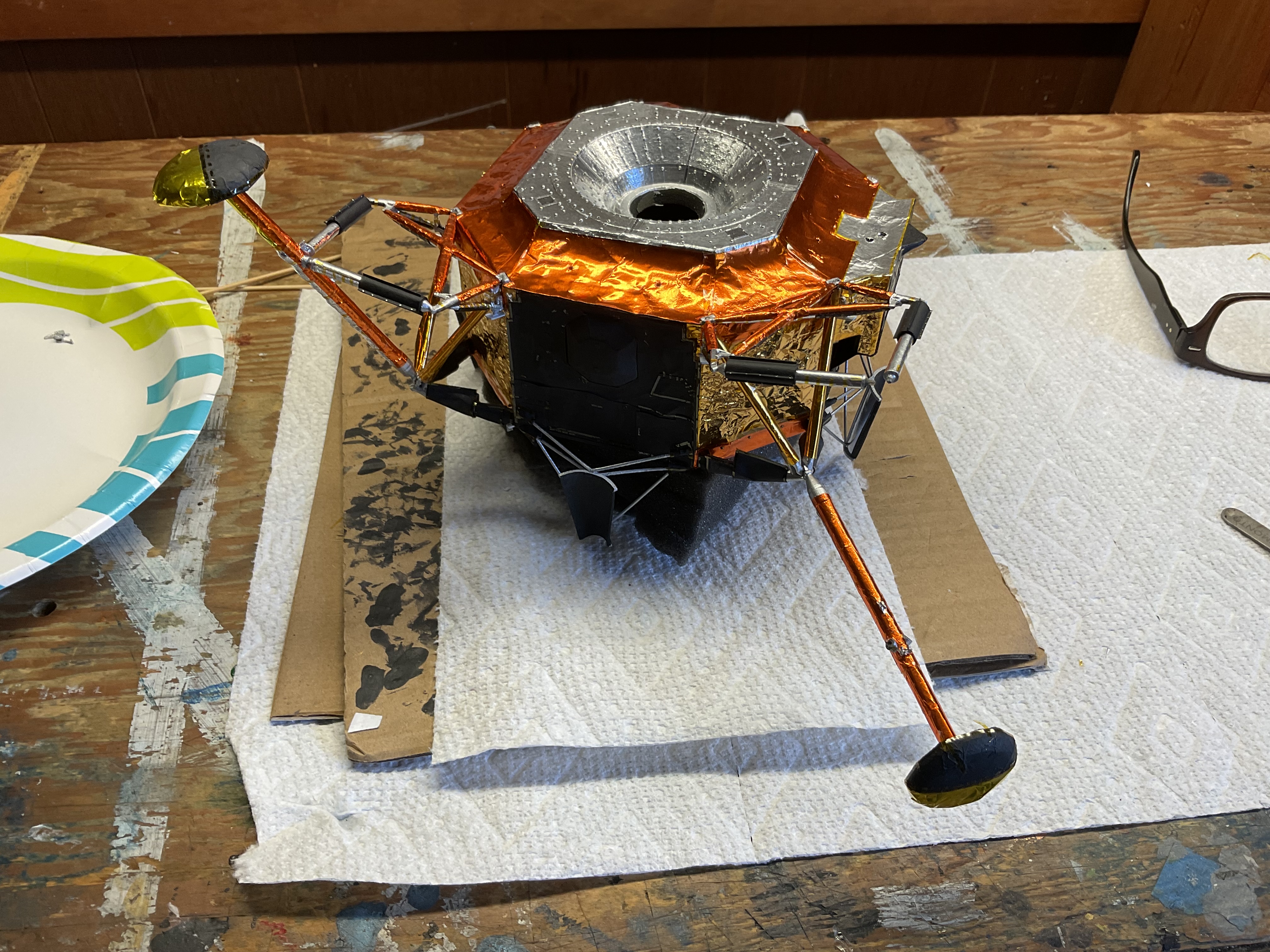

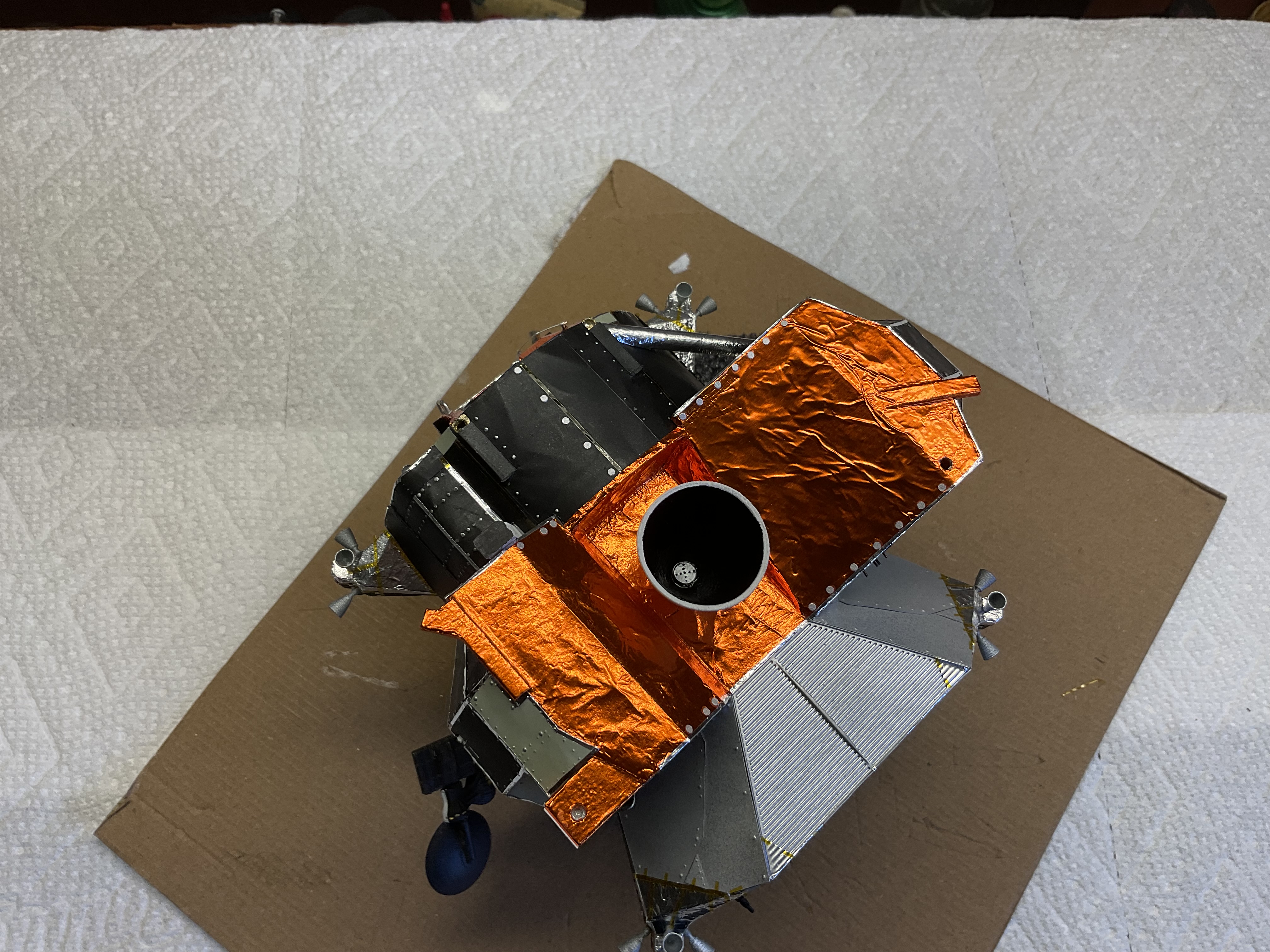

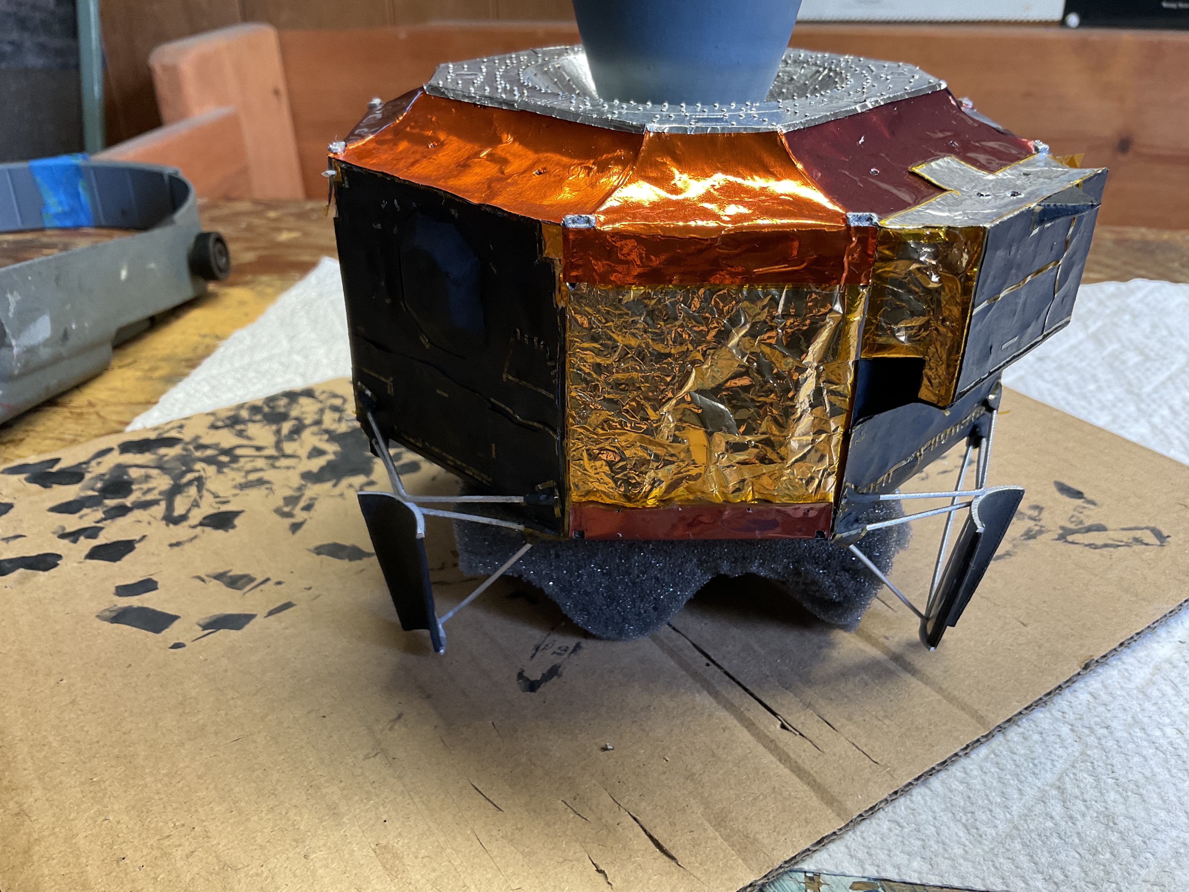

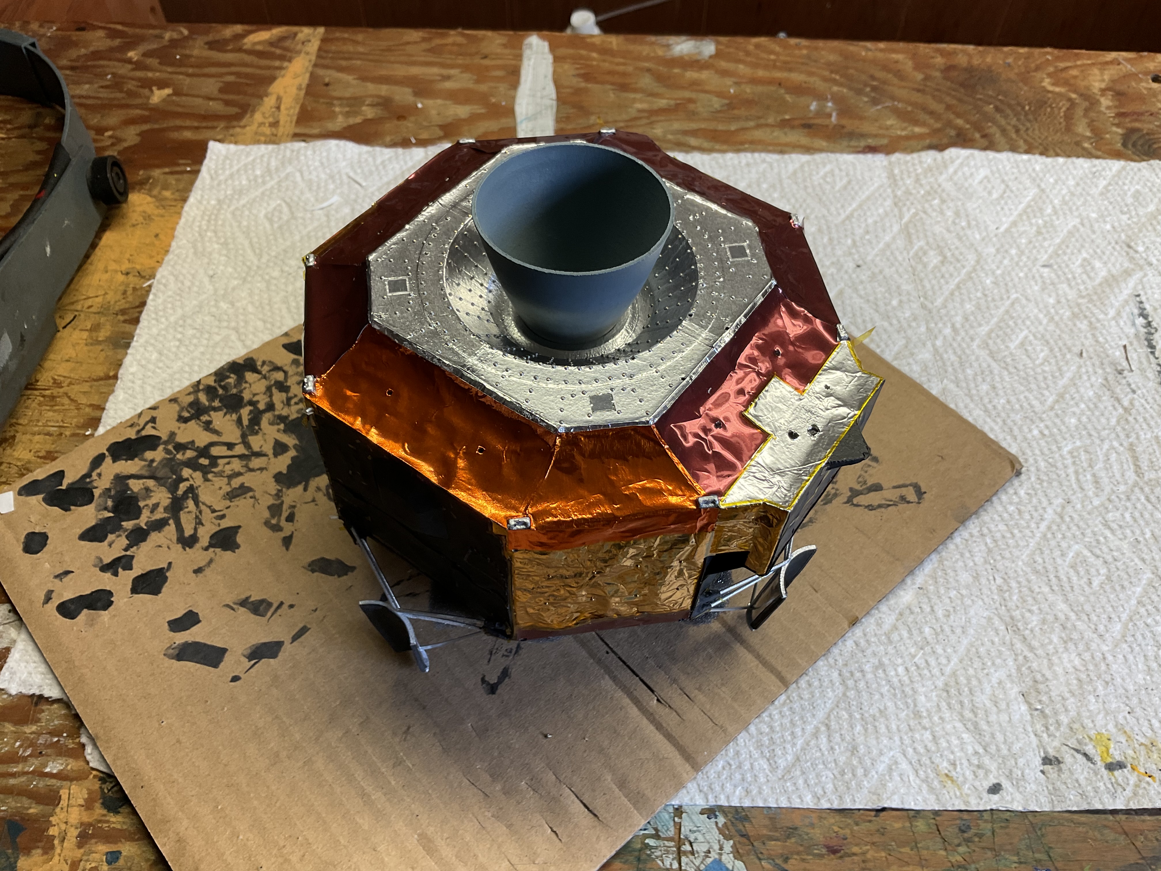

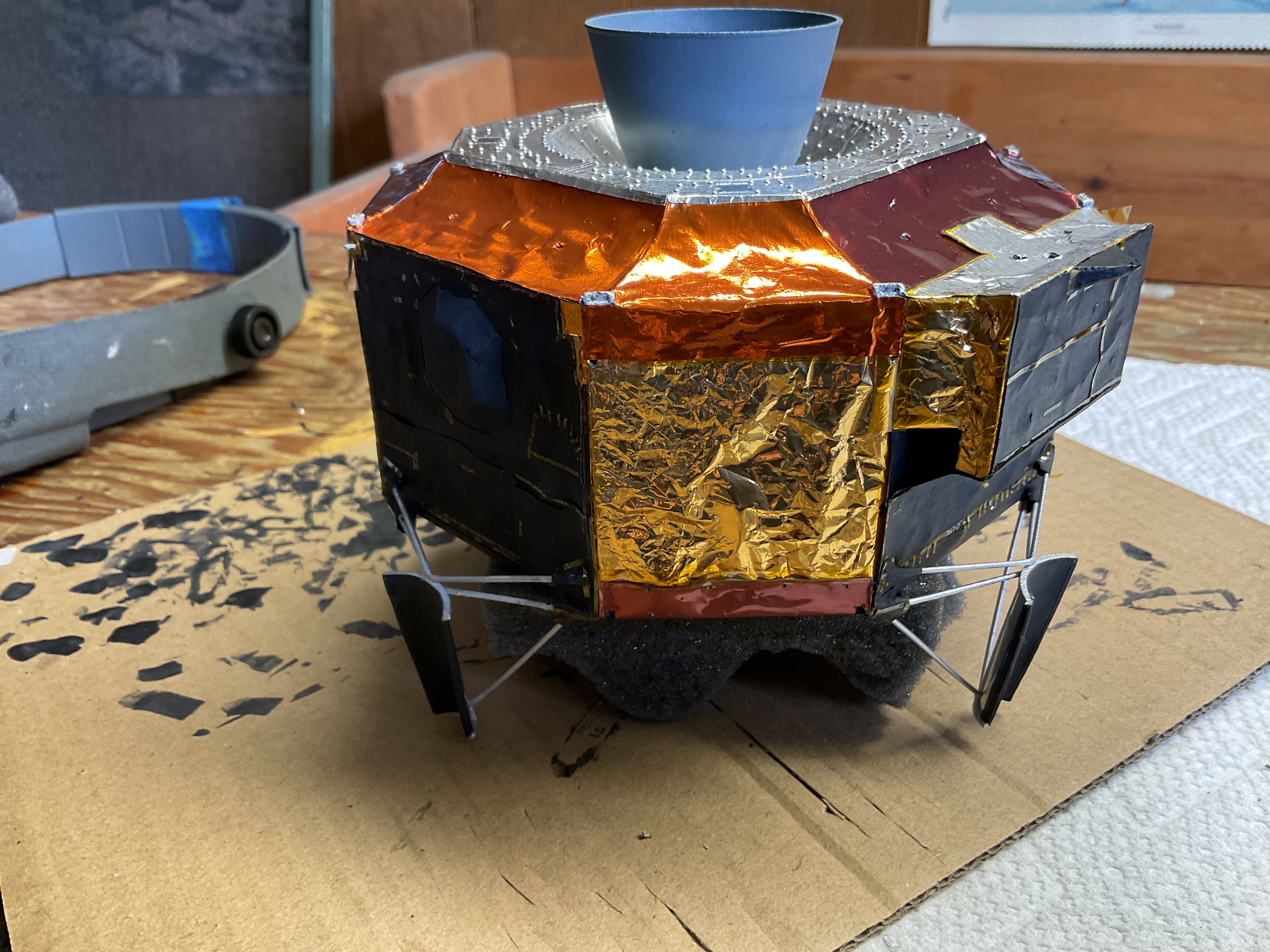

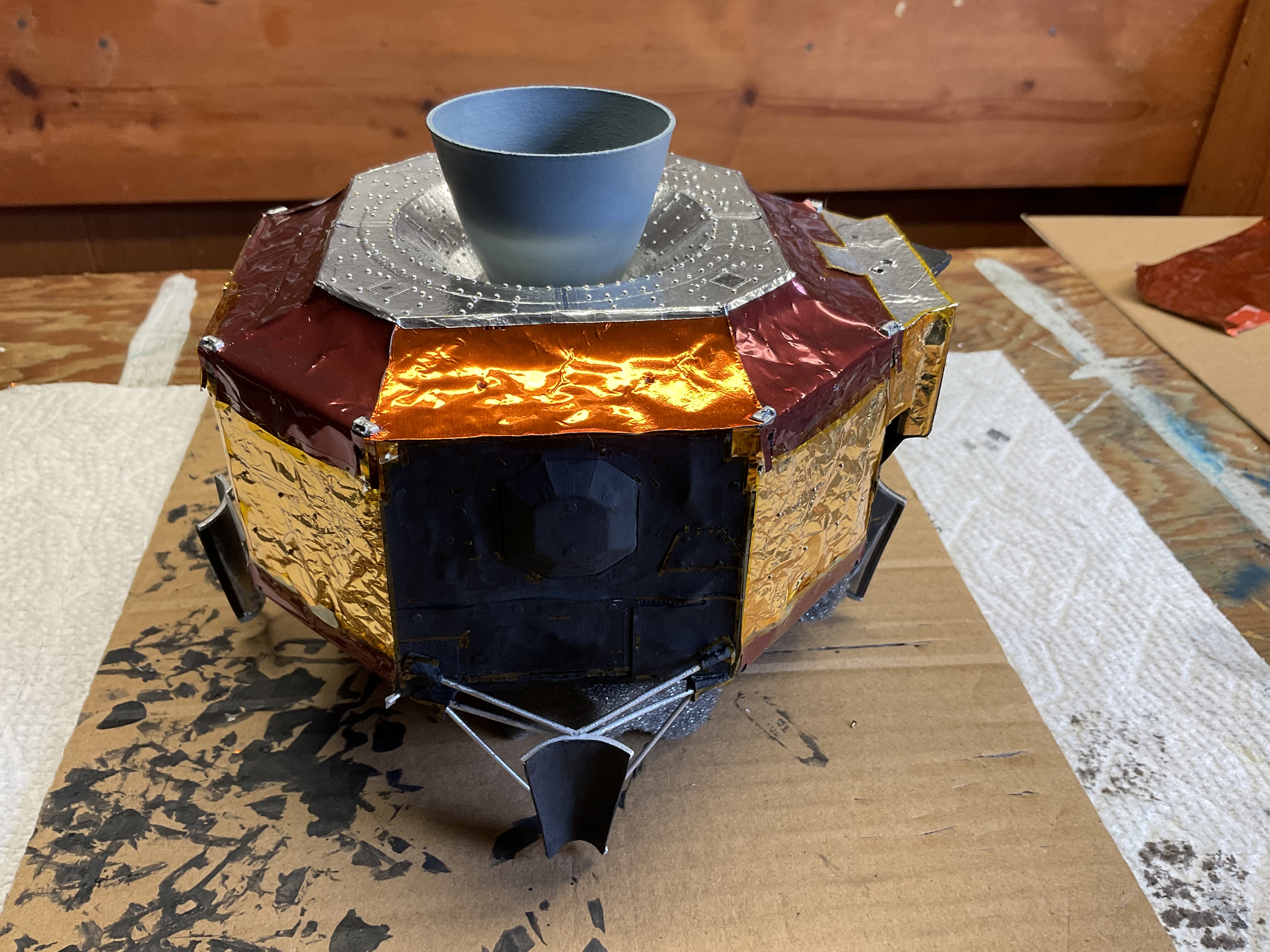

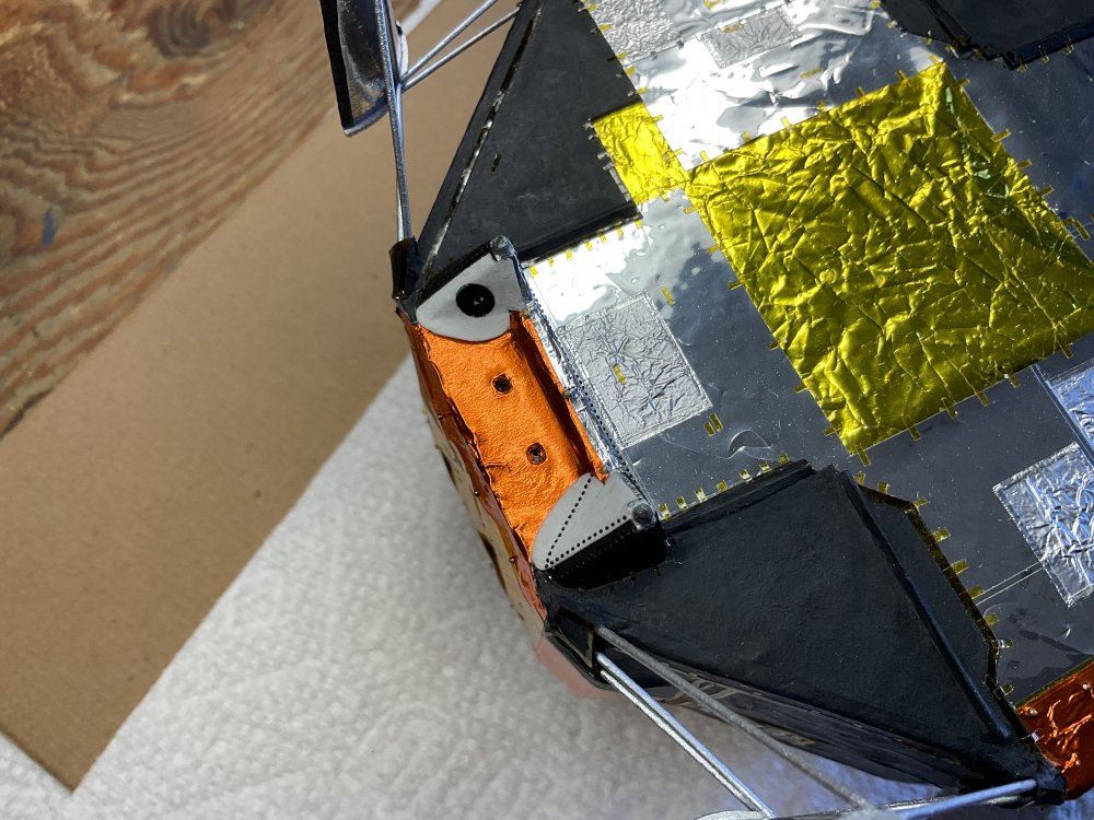

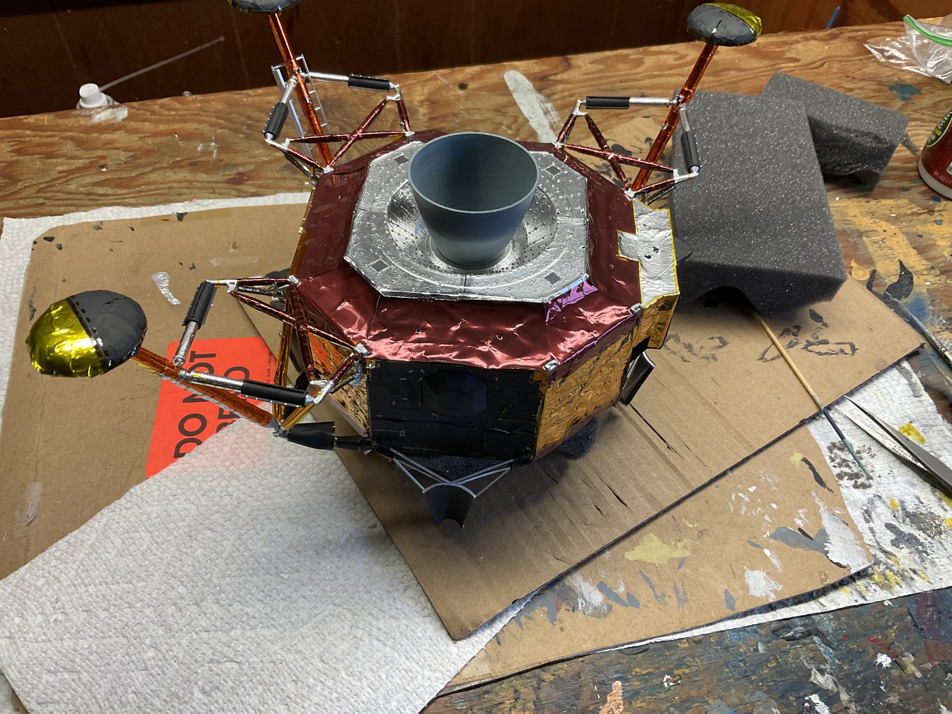

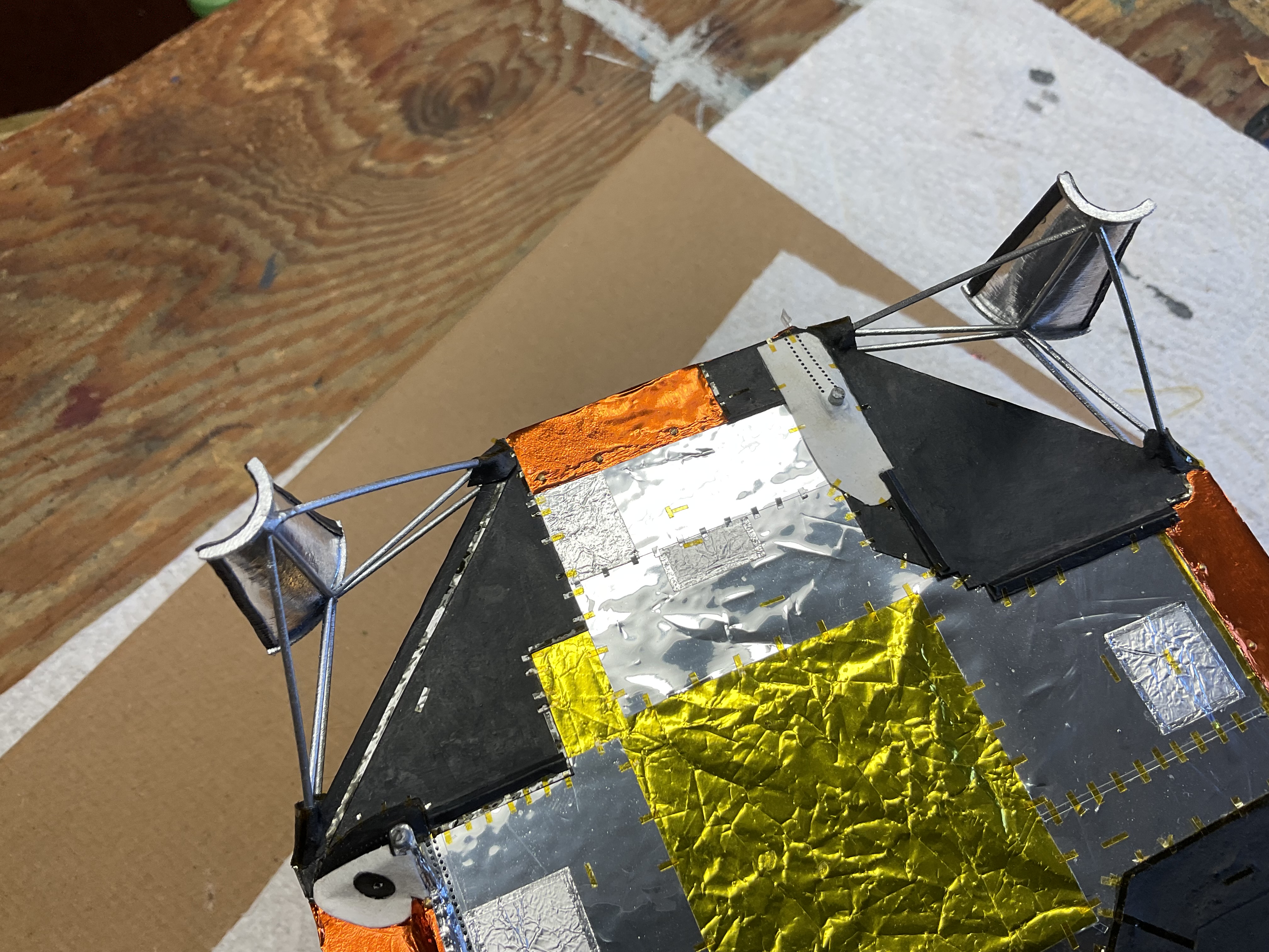

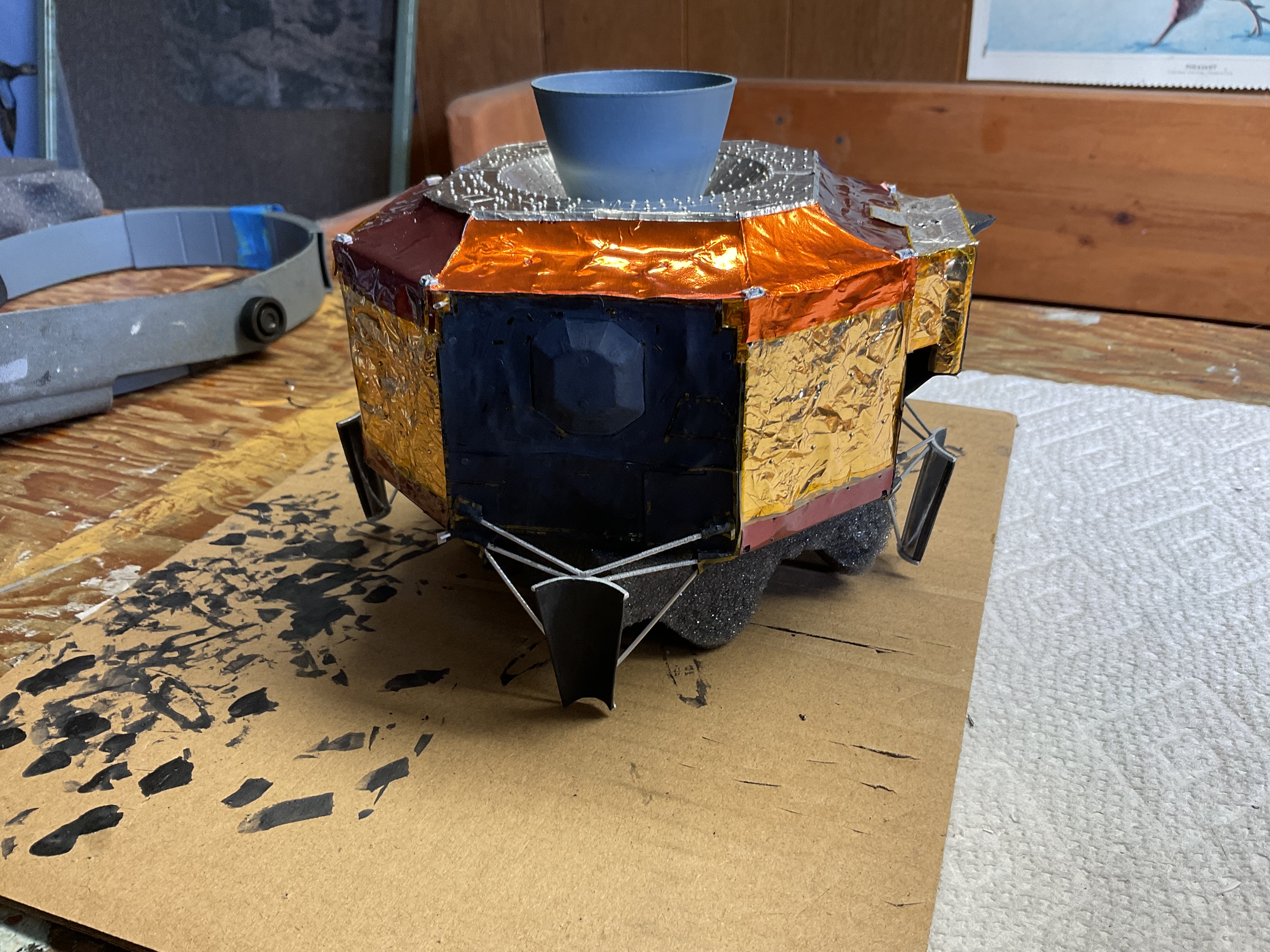

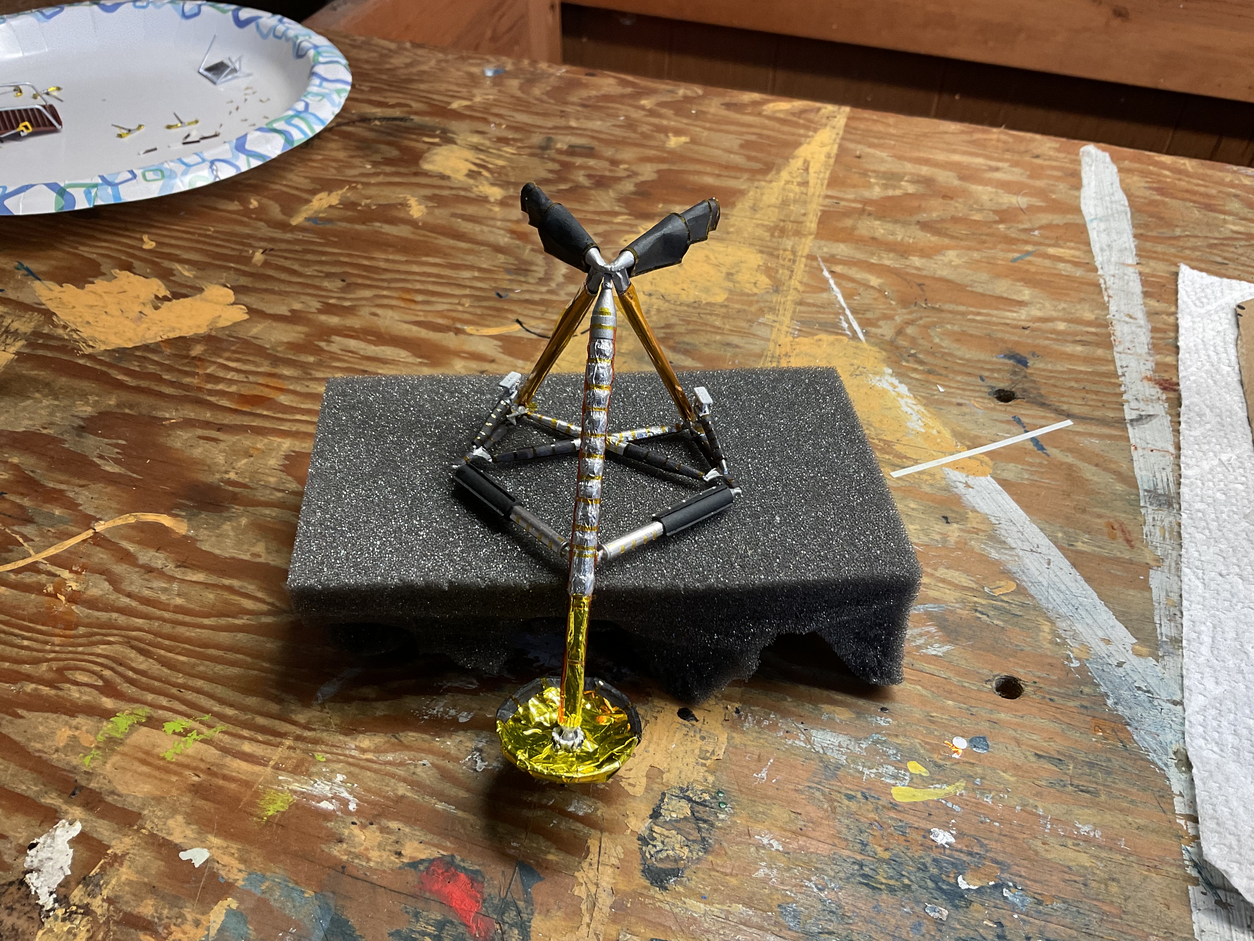

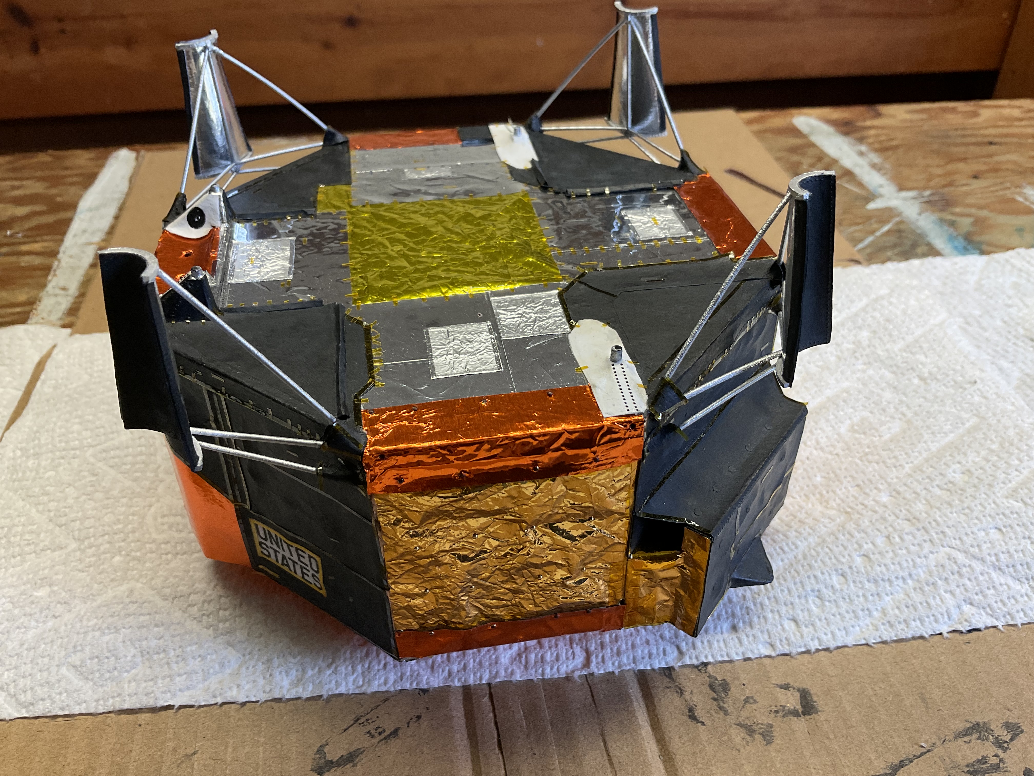

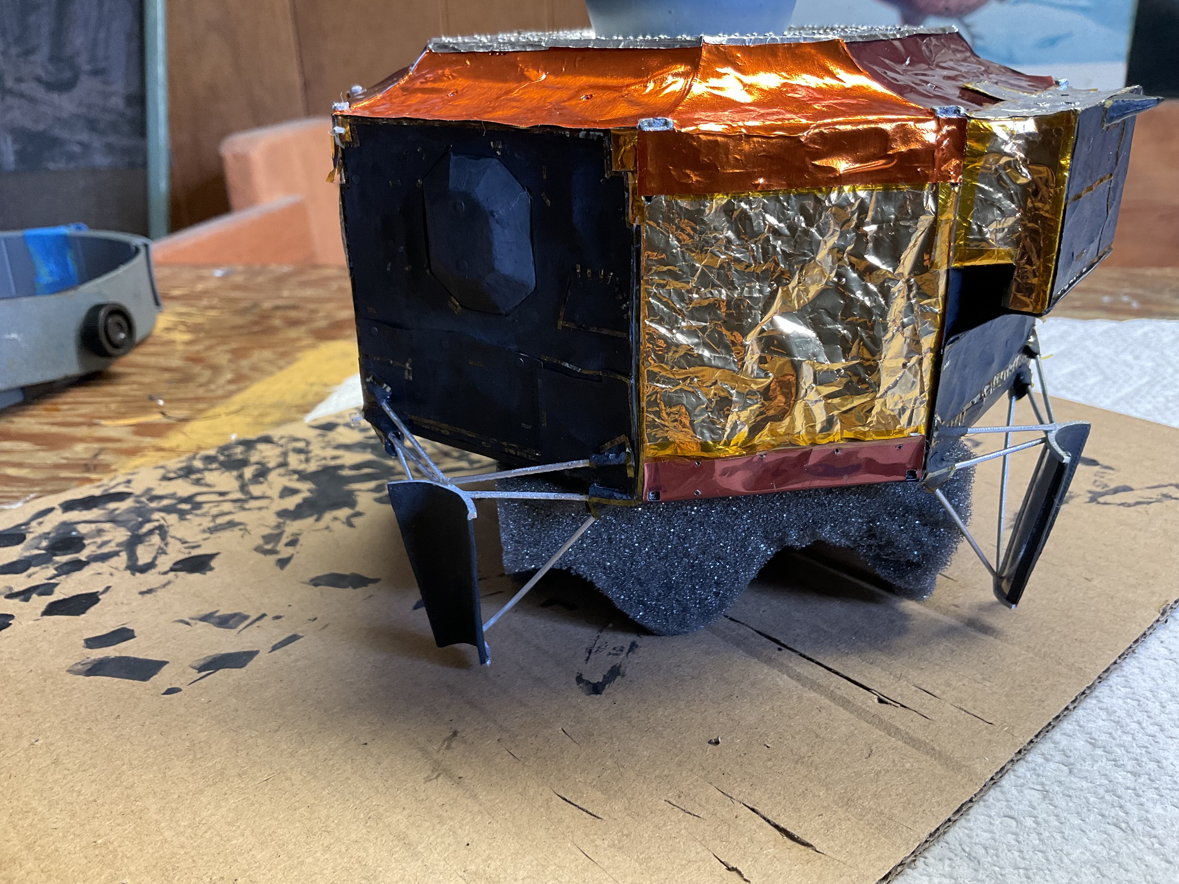

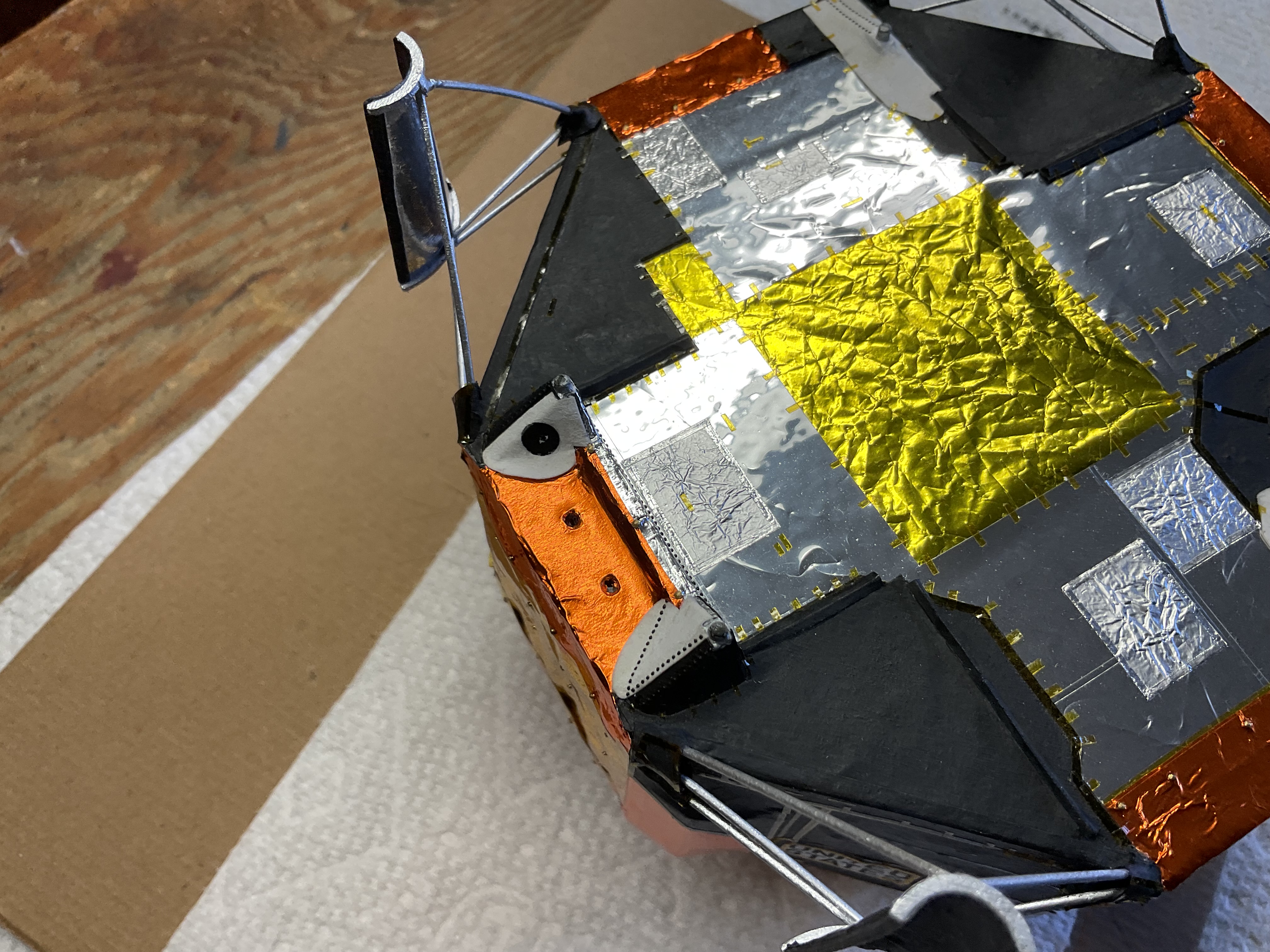

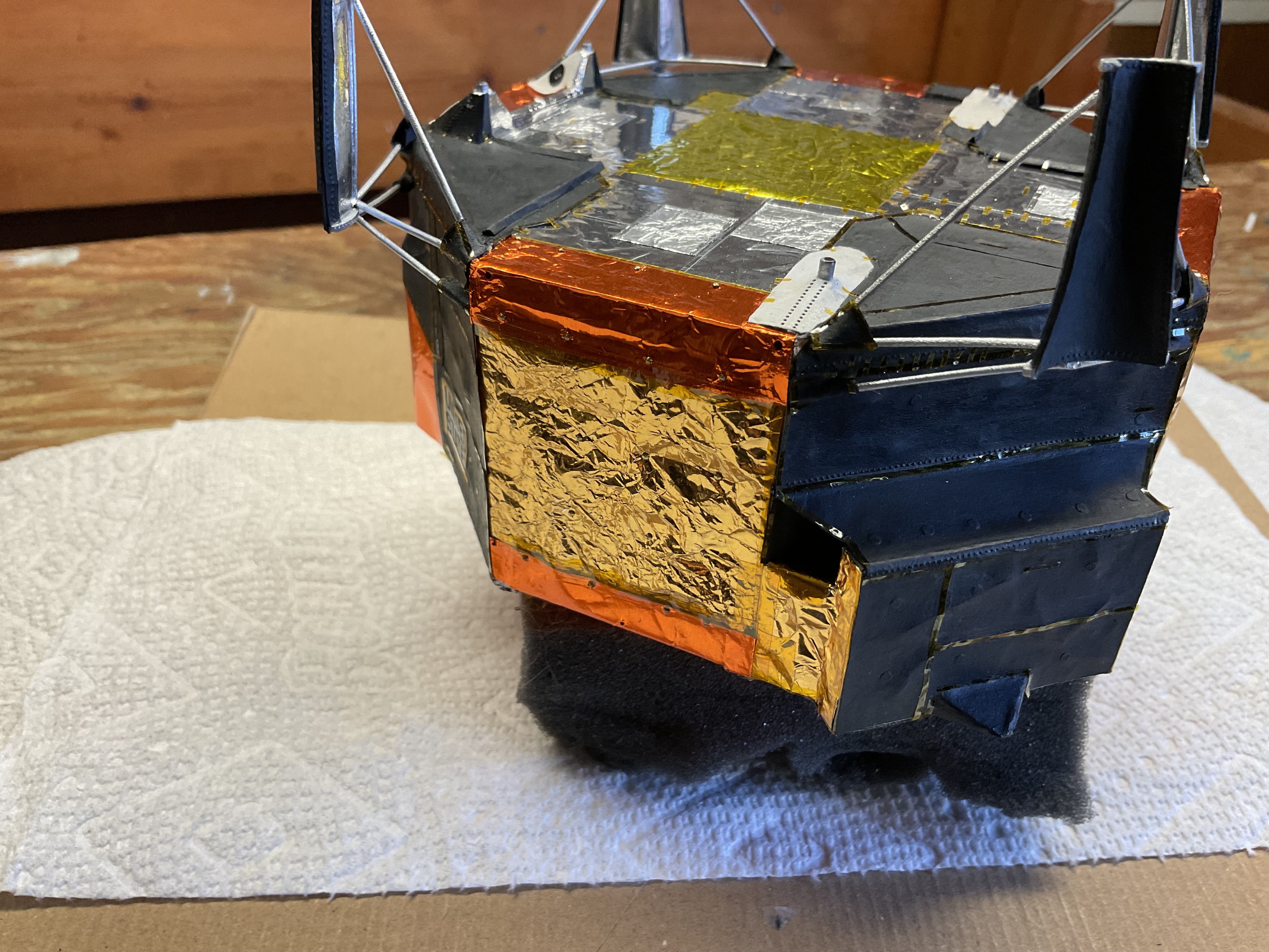

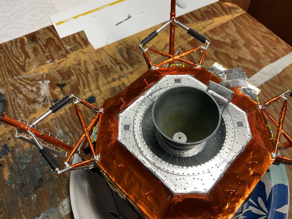

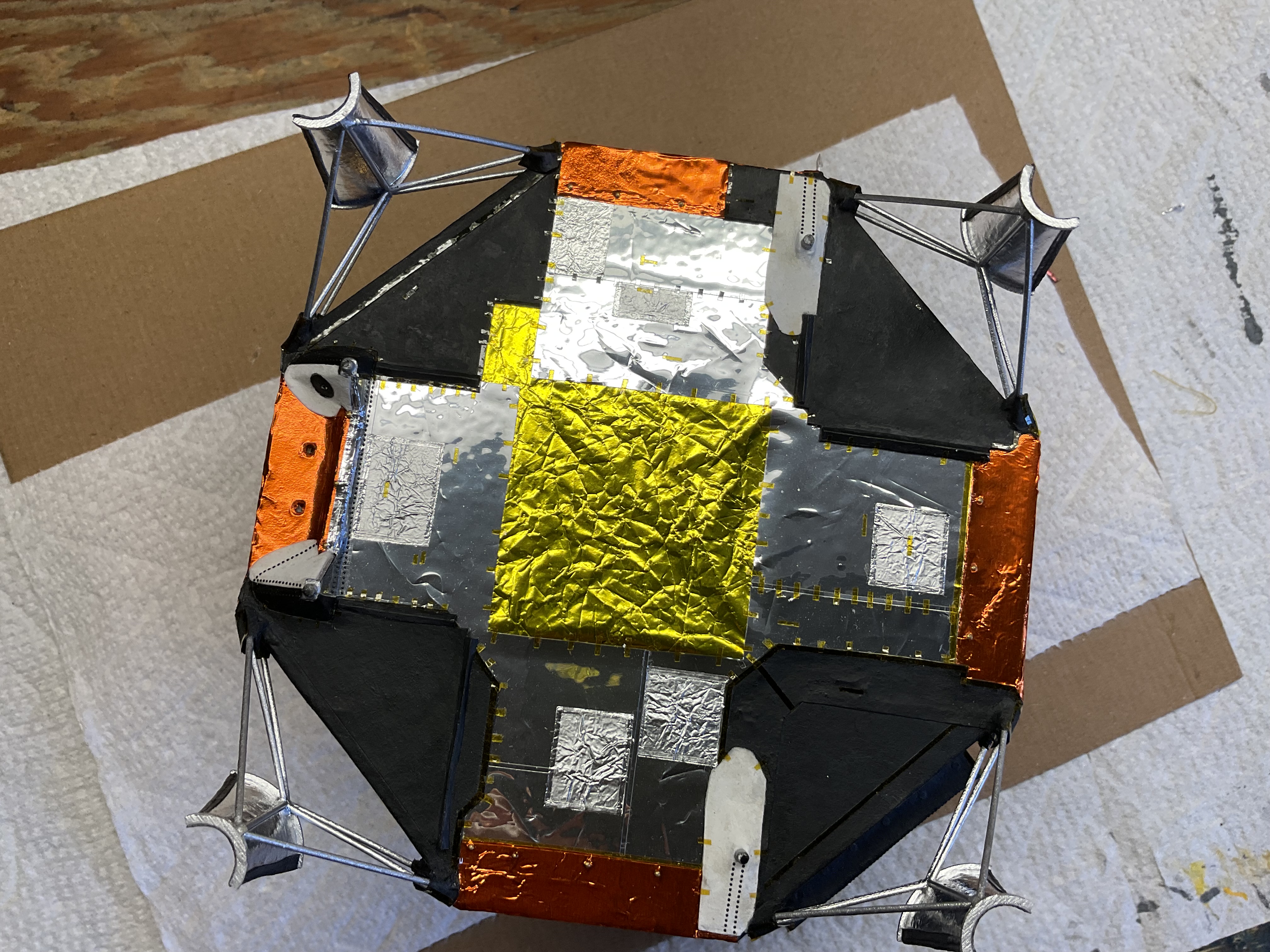

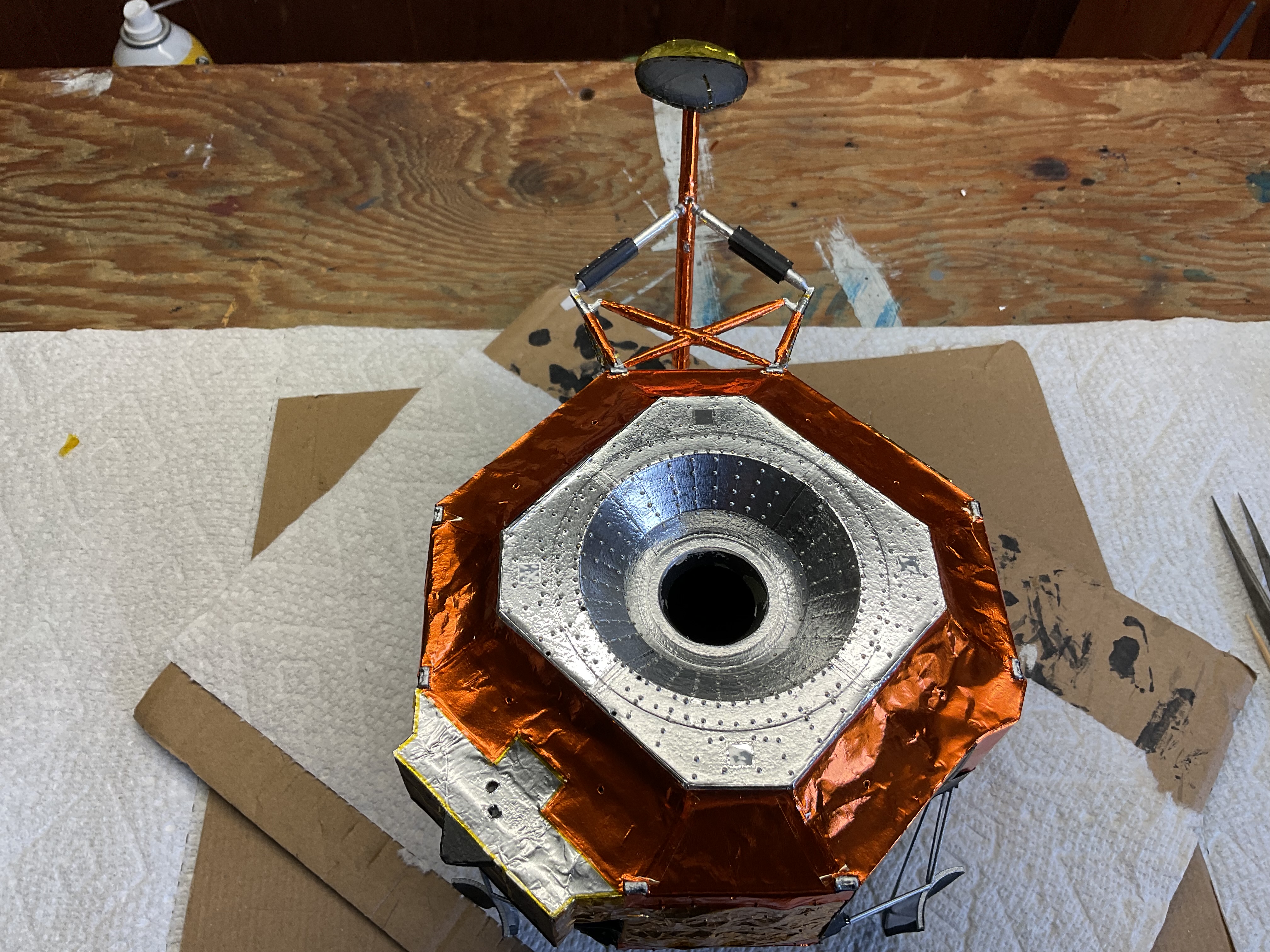

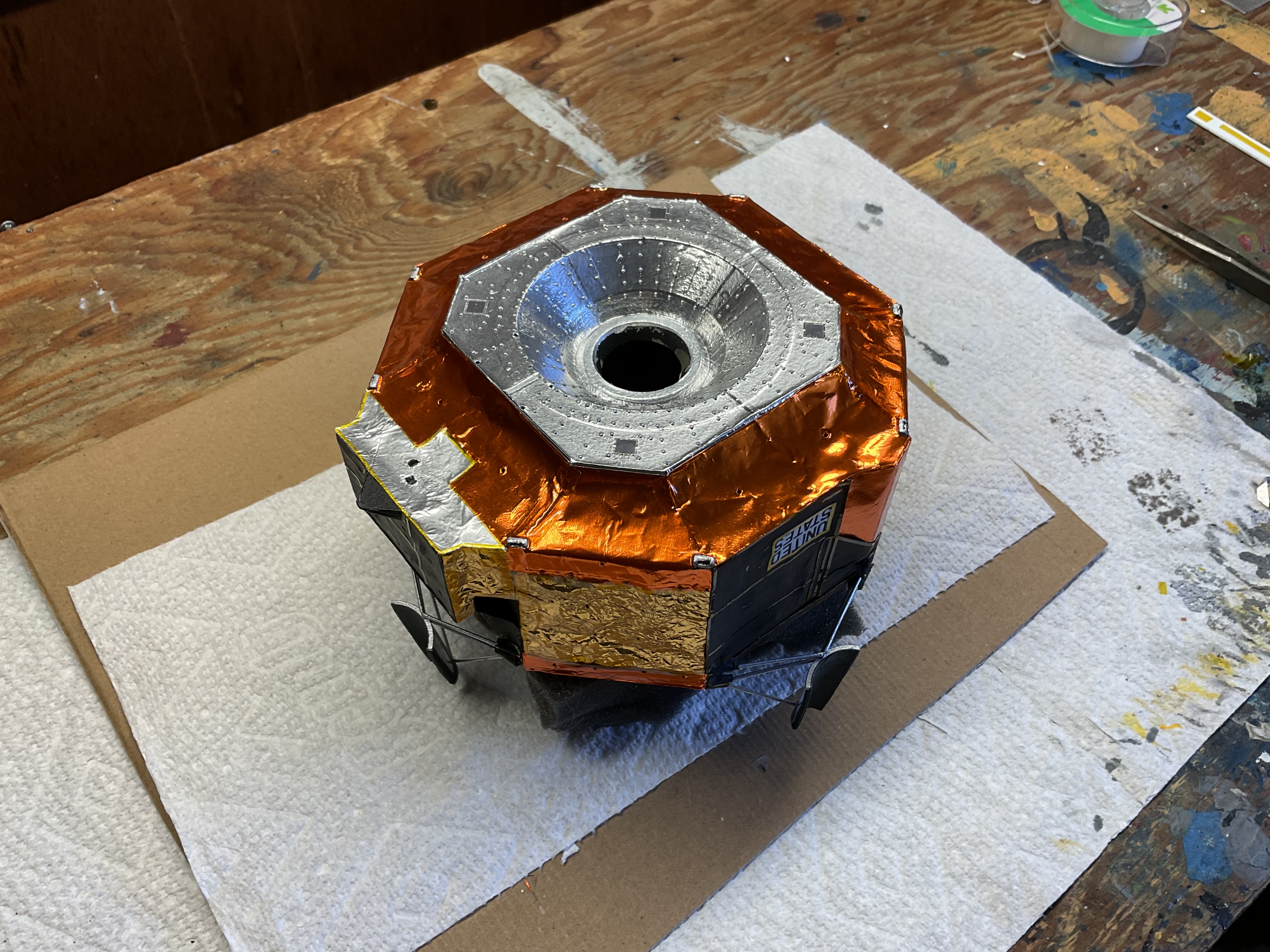

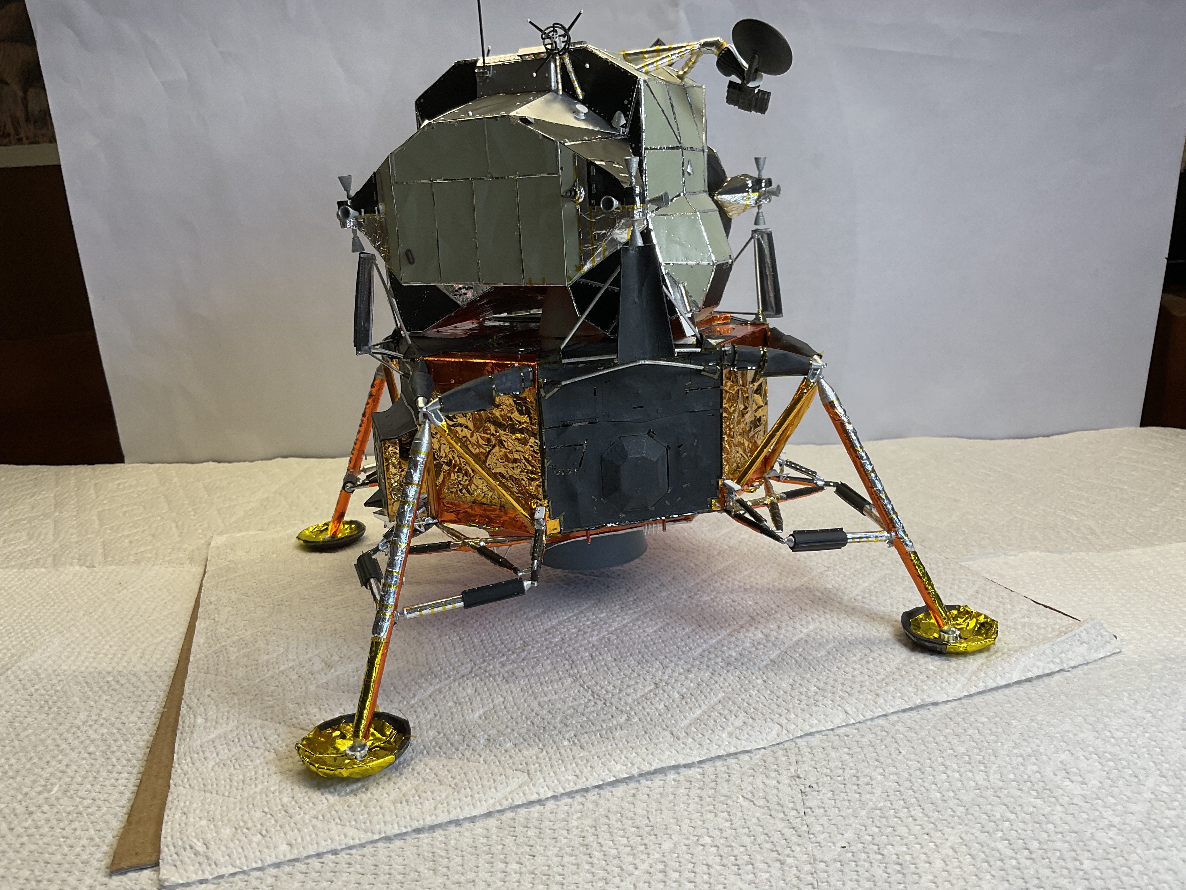

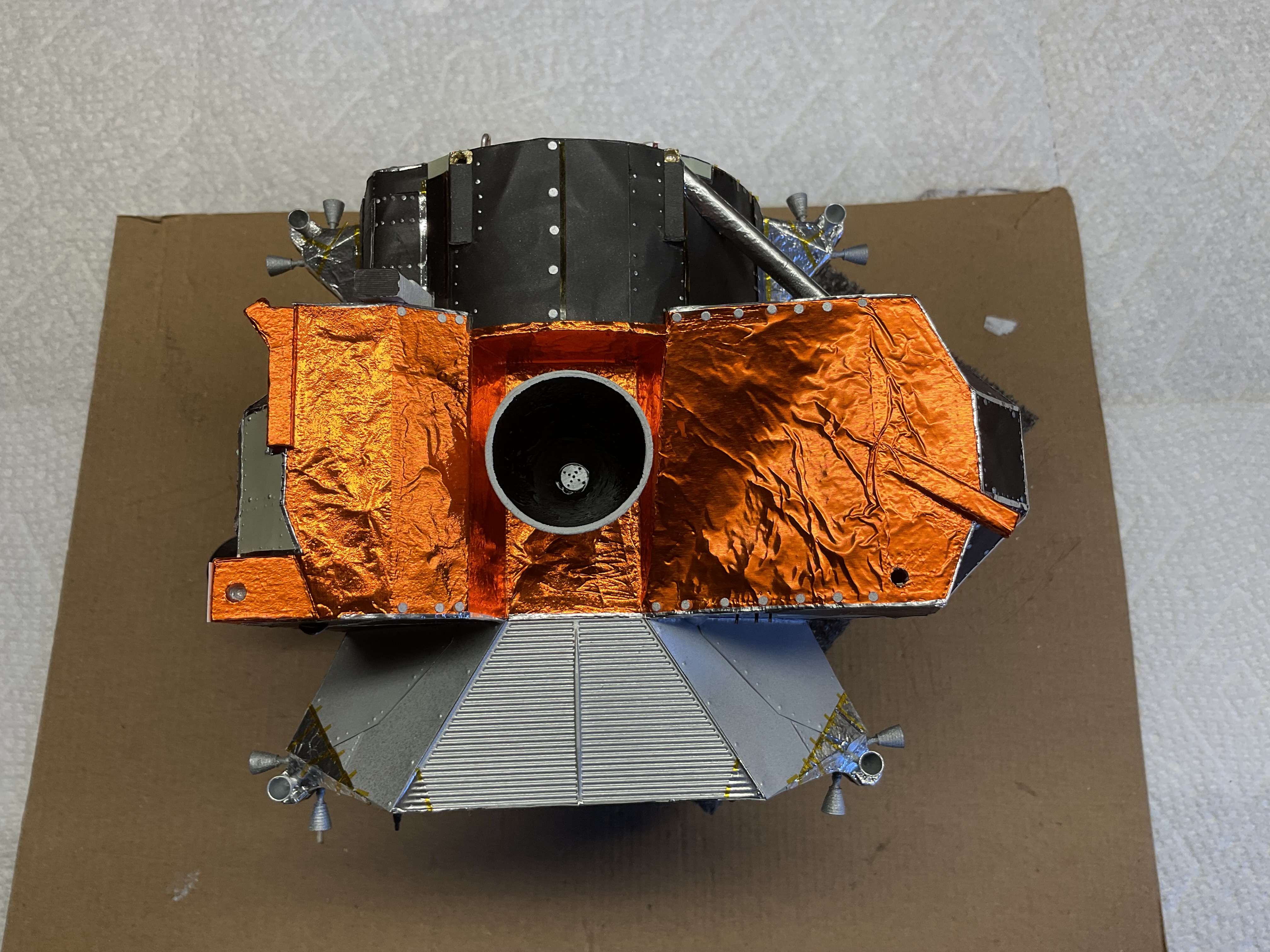

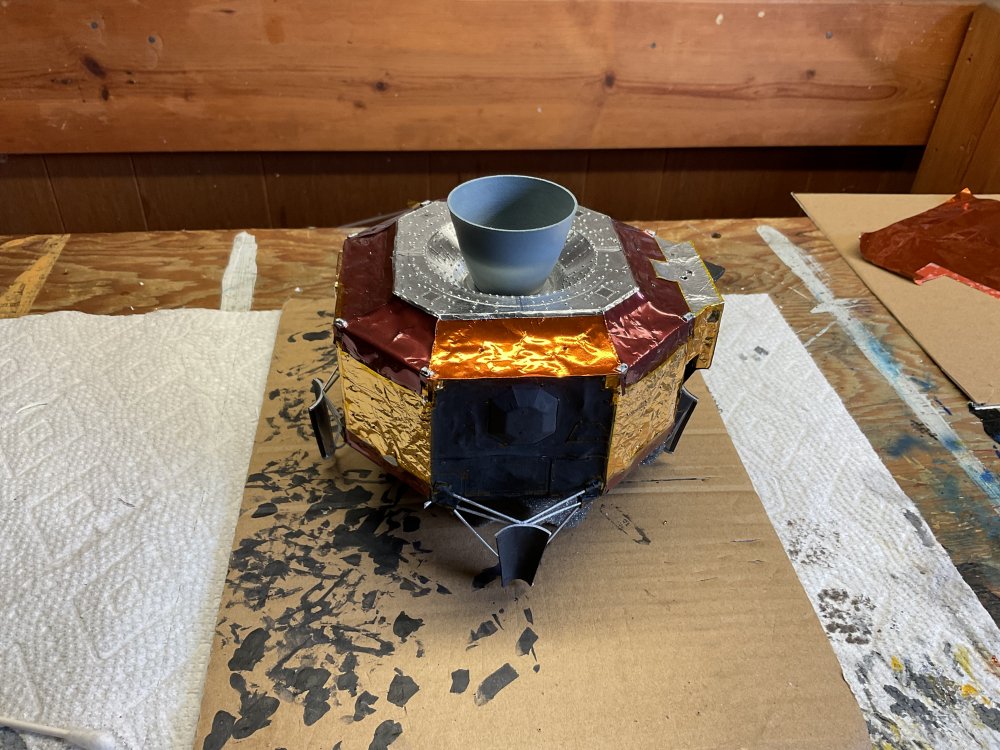

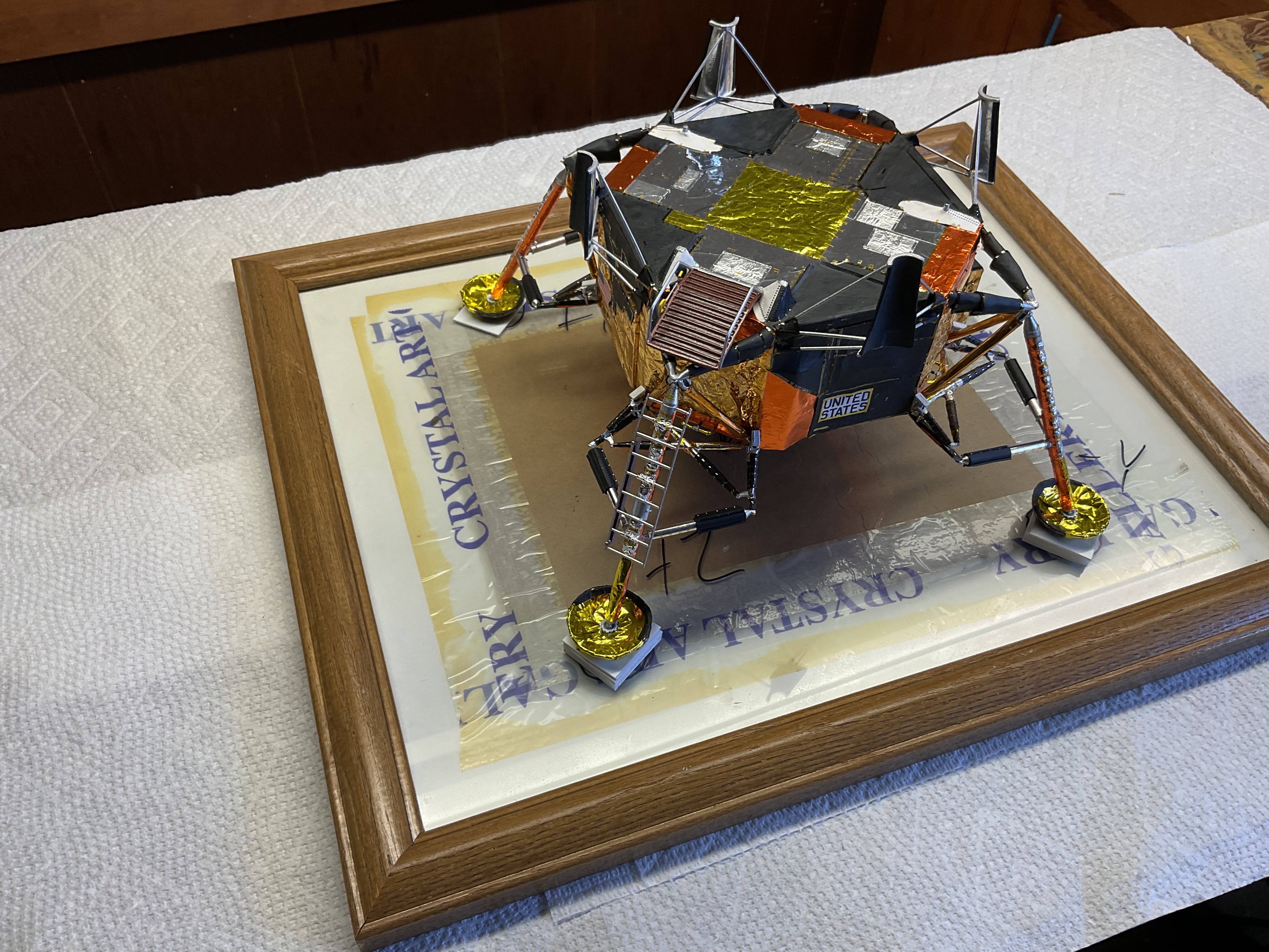

snichols Posted July 21, 2023 Author Share Posted July 21, 2023 (edited) I wouldn’t use the burgundy color, if you look at pictures of LM5 on the moon and in flight you can see a reddish tint from the Kapton in some pictures and in some you cannot but mostly I see an orange red and not a true red color. Looking at two builds, one of Dave Carlton’s LM deconstructed and David Senechal’s both 1/24th scale and both amazing I noticed two distinct colors represented for the 5 mil Kapton by both modelers, one red and one orange. I had that feeling when I went to foil the areas around the hatch but did it anyway so here it goes and hopefully I’ll get a more competent application this time and it pays to keep your patterns ! Now that I’ve applied two panels of the new color look at the last few pictures, depending on lighting and viewing angles it actually appears to be the same color as the burgundy. Edited July 22, 2023 by snichols Quote Link to post Share on other sites

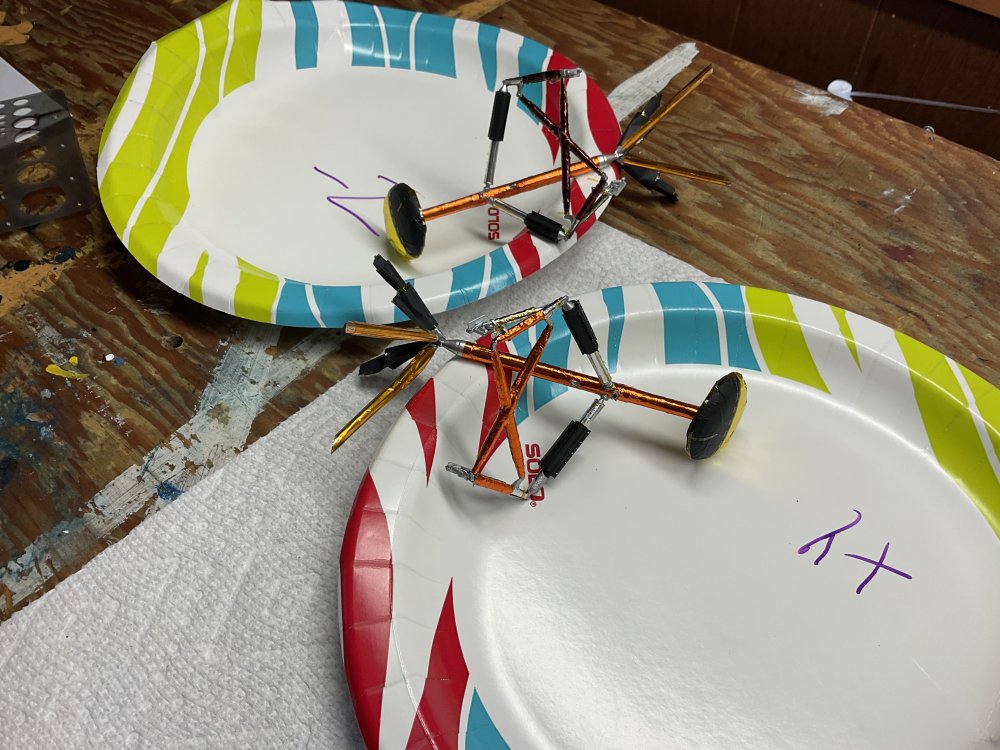

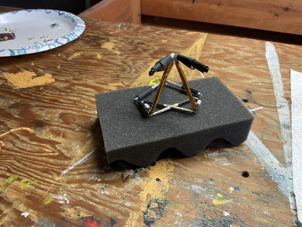

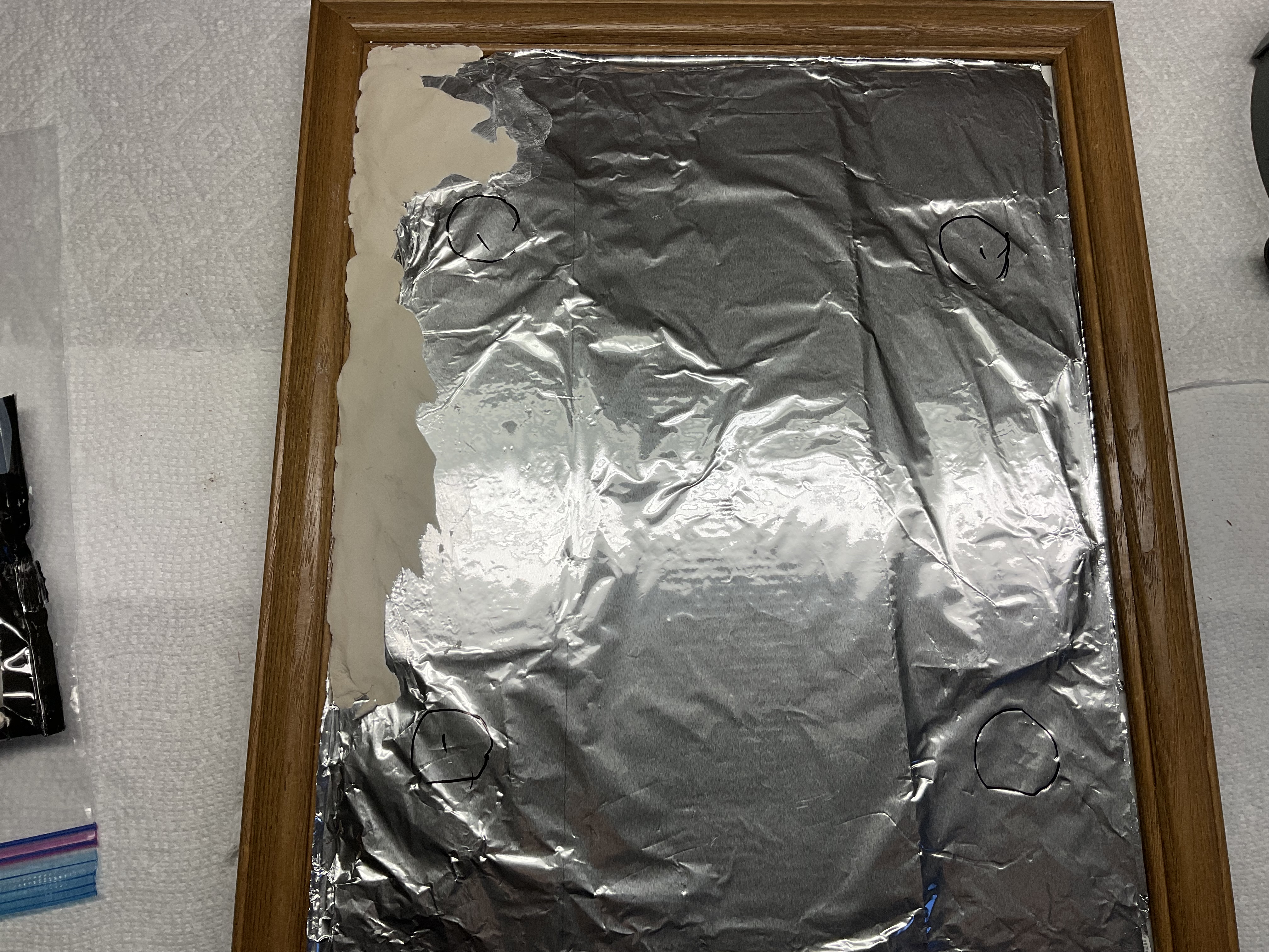

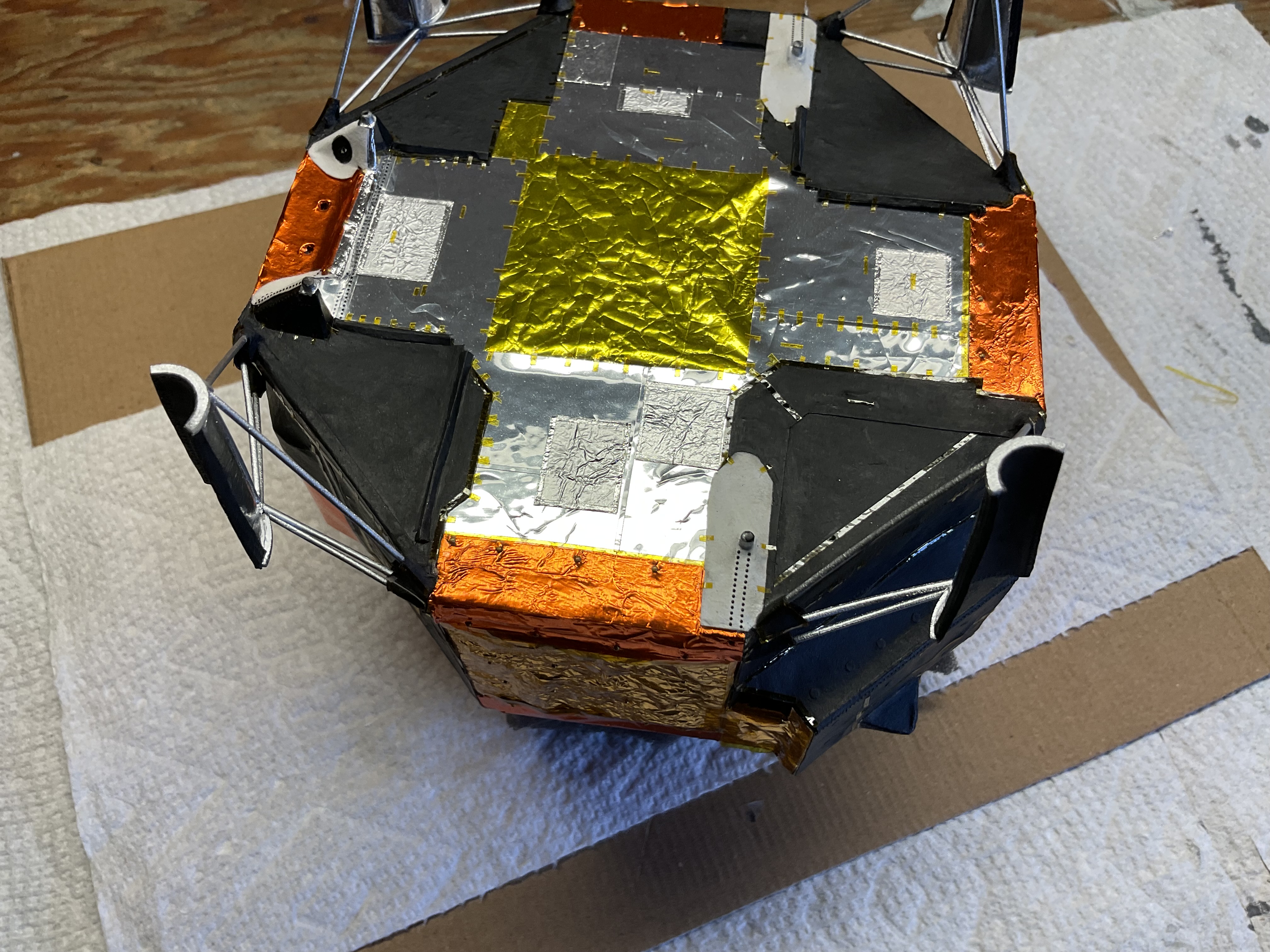

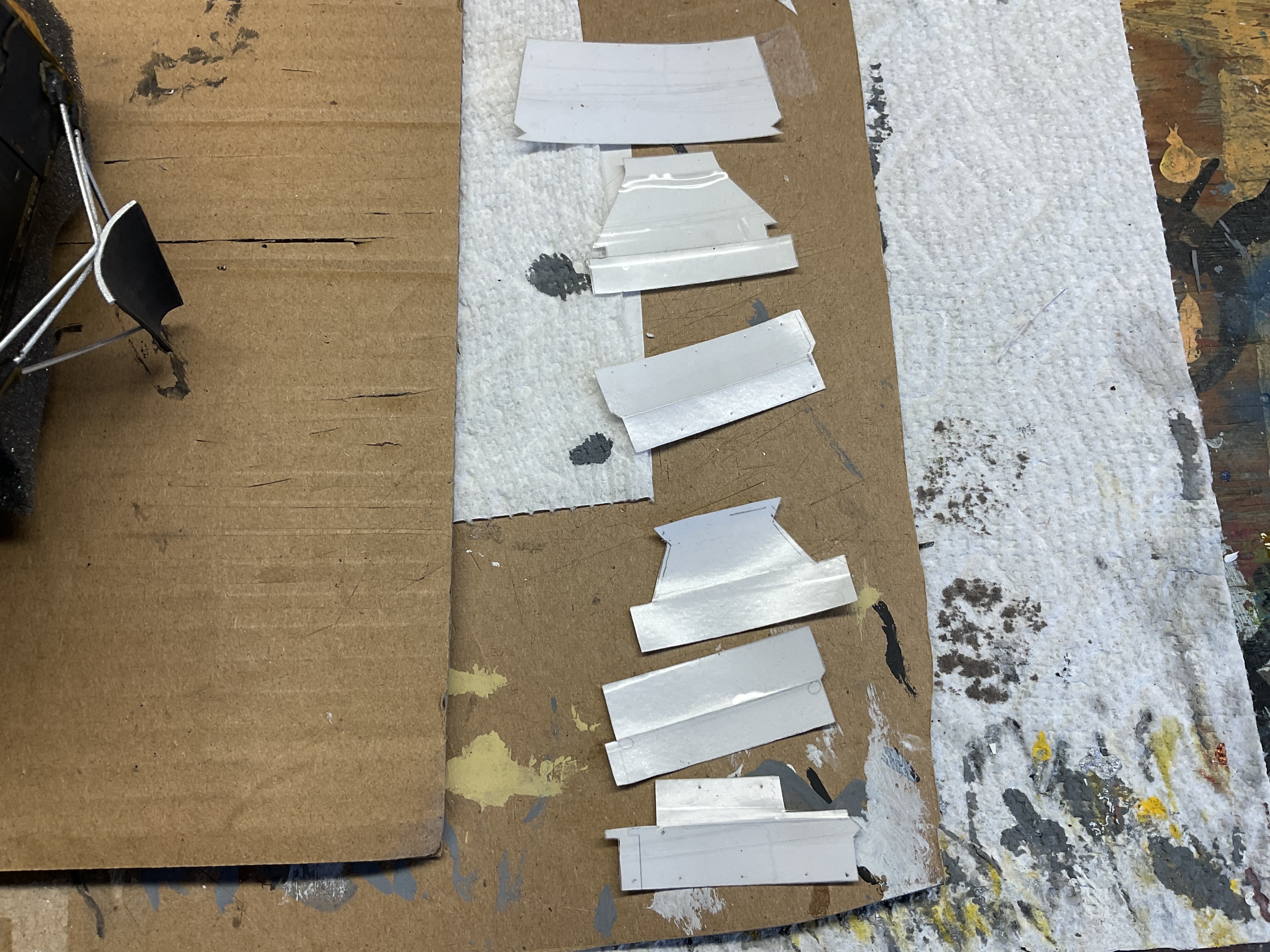

snichols Posted July 23, 2023 Author Share Posted July 23, 2023 (edited) I first have to say that for the 5 mil Kapton on my previous builds this was the color used , next up are the strut crossmembers then they get reattached . Luck was on my side as I was able to tuck all the new foil under existing panels. The rear portion of the strut was initially done with the correct color. Edited July 27, 2023 by snichols Quote Link to post Share on other sites

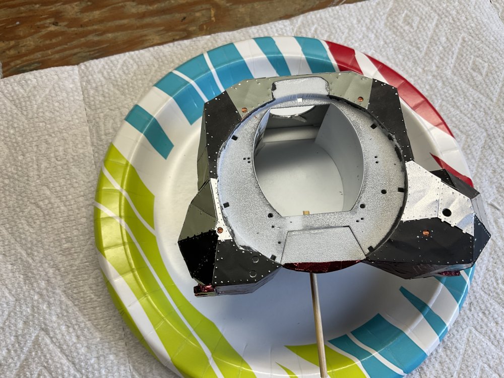

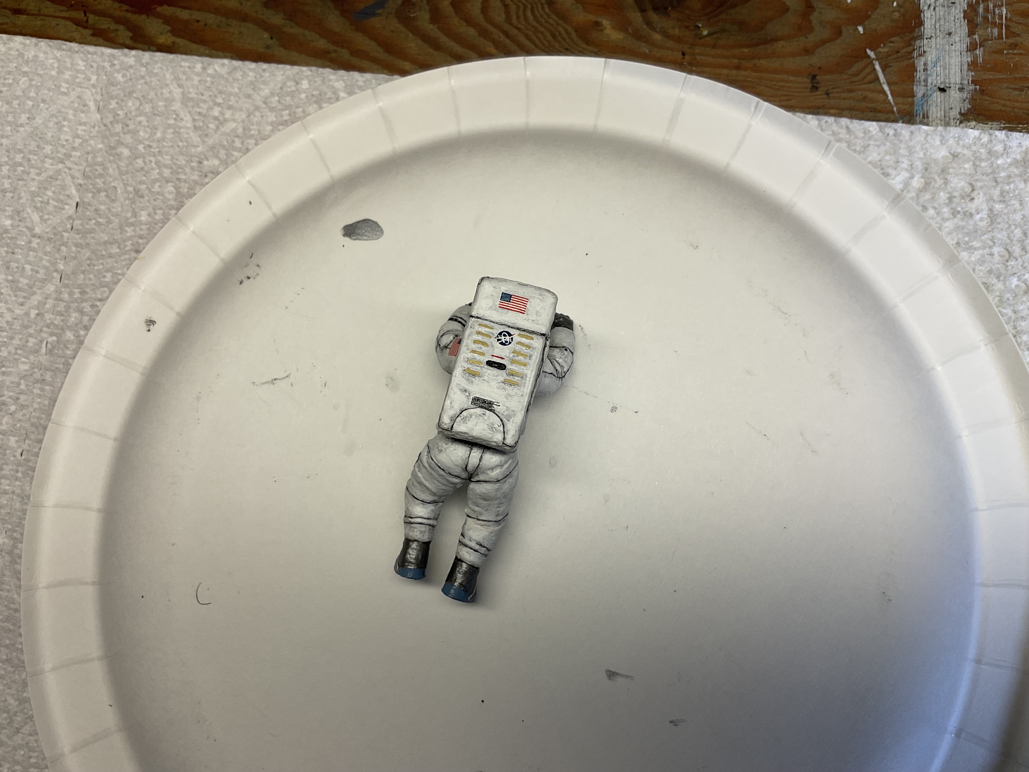

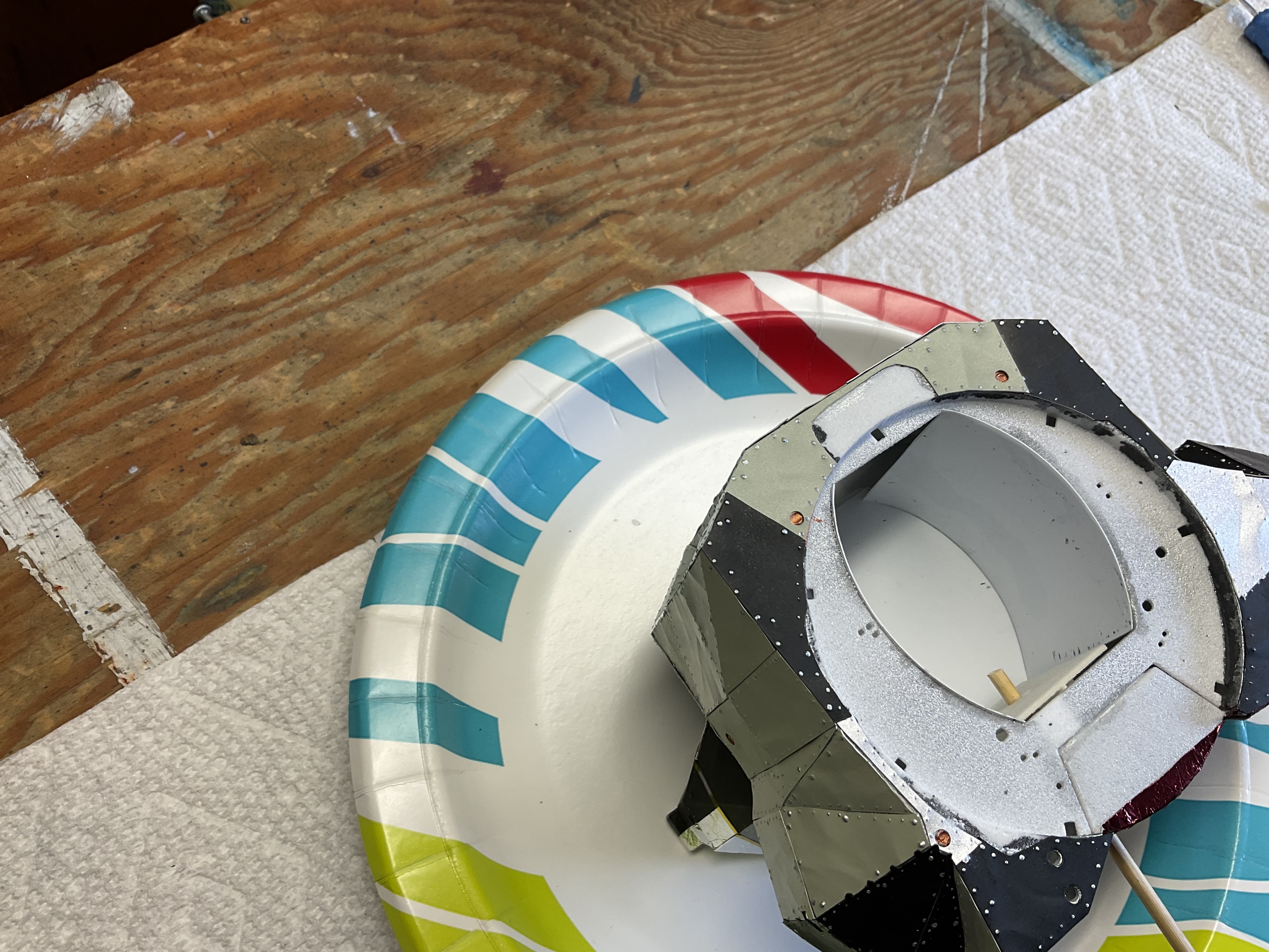

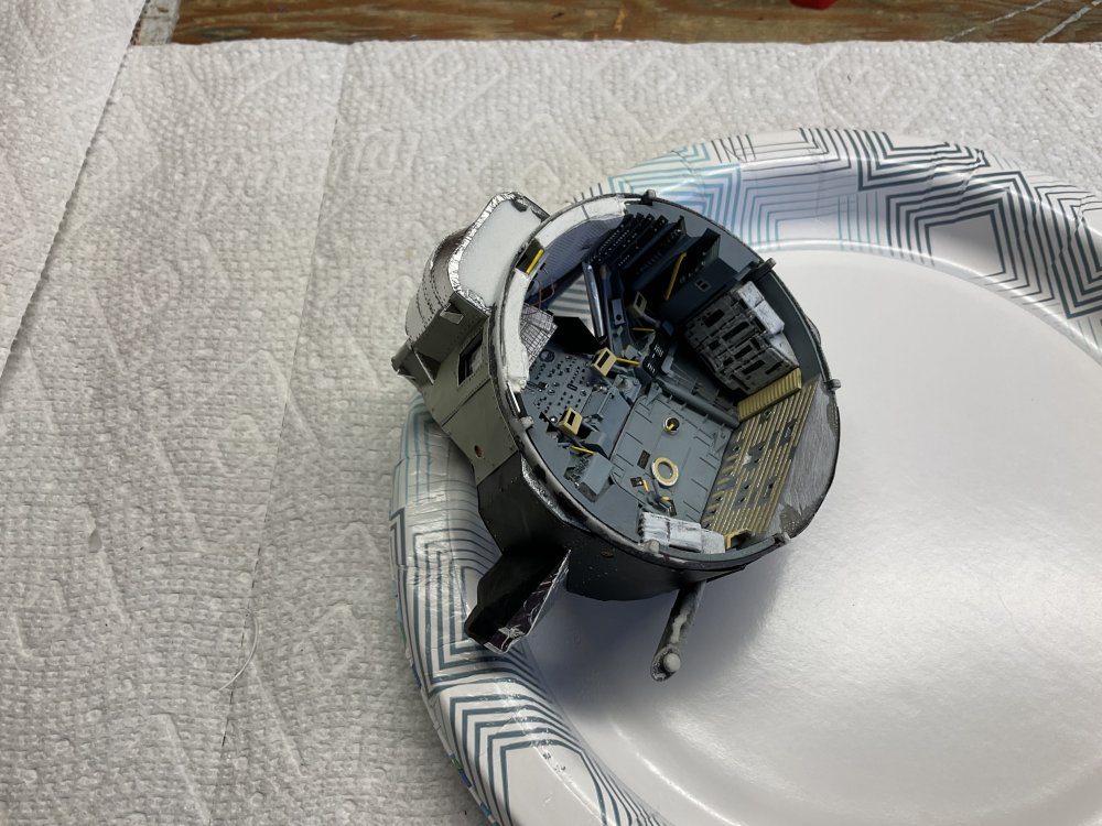

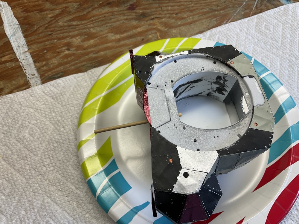

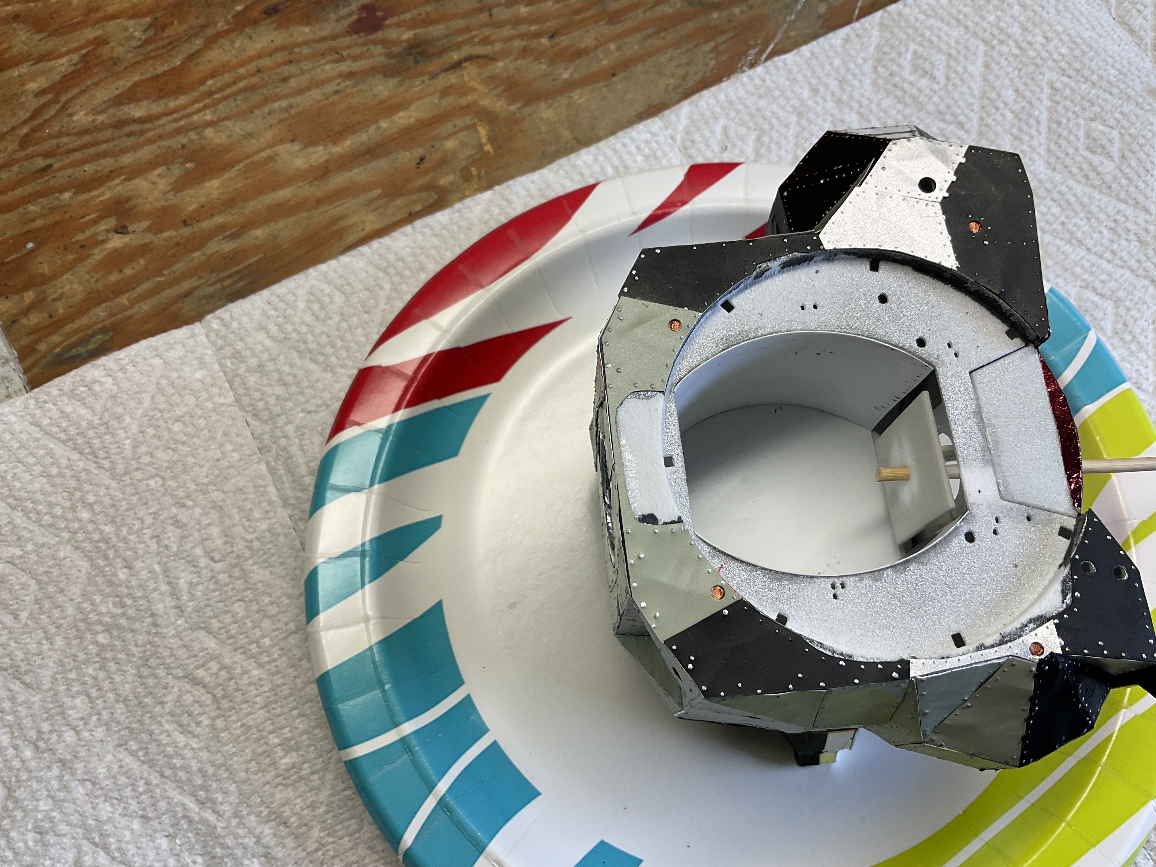

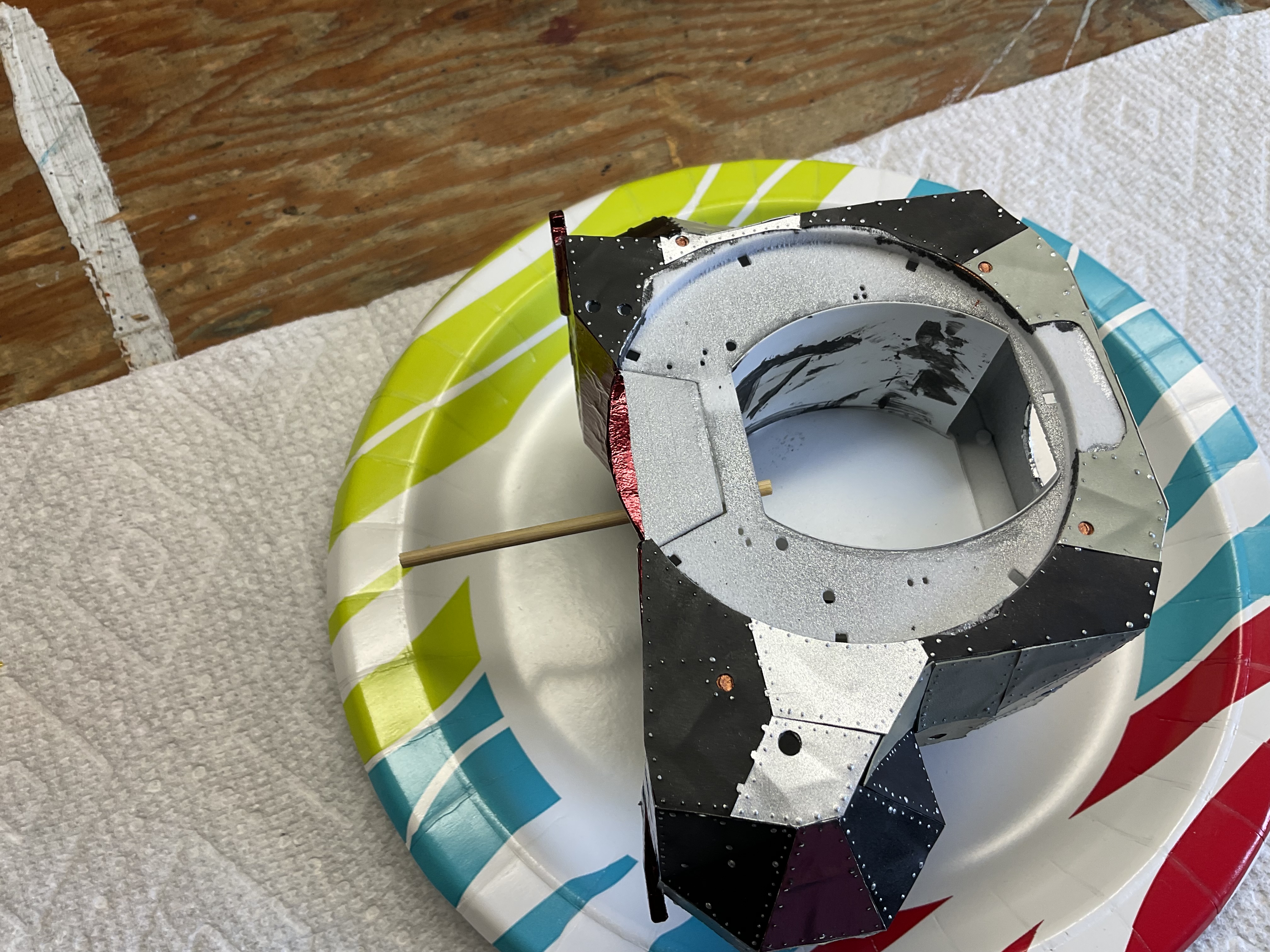

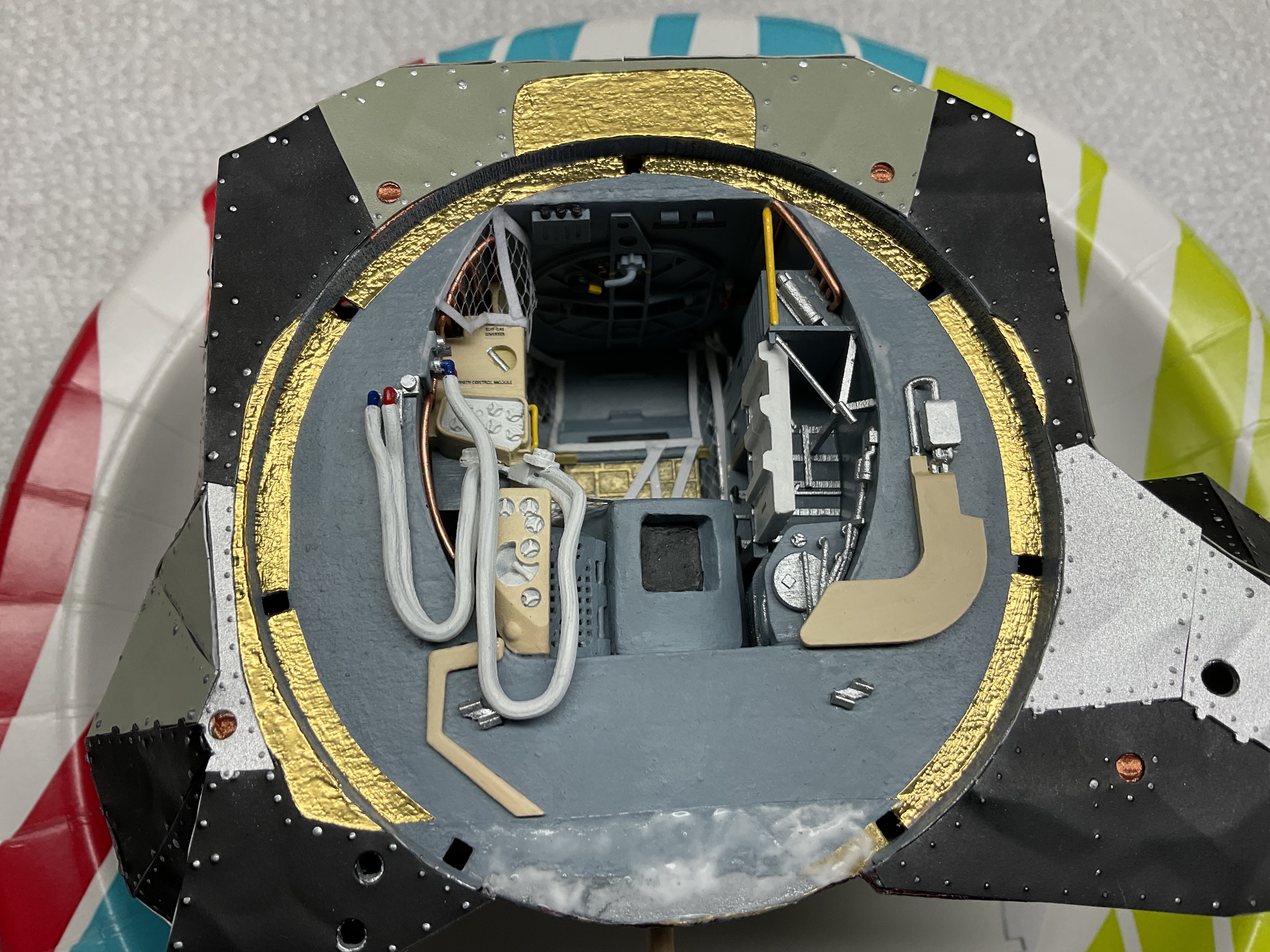

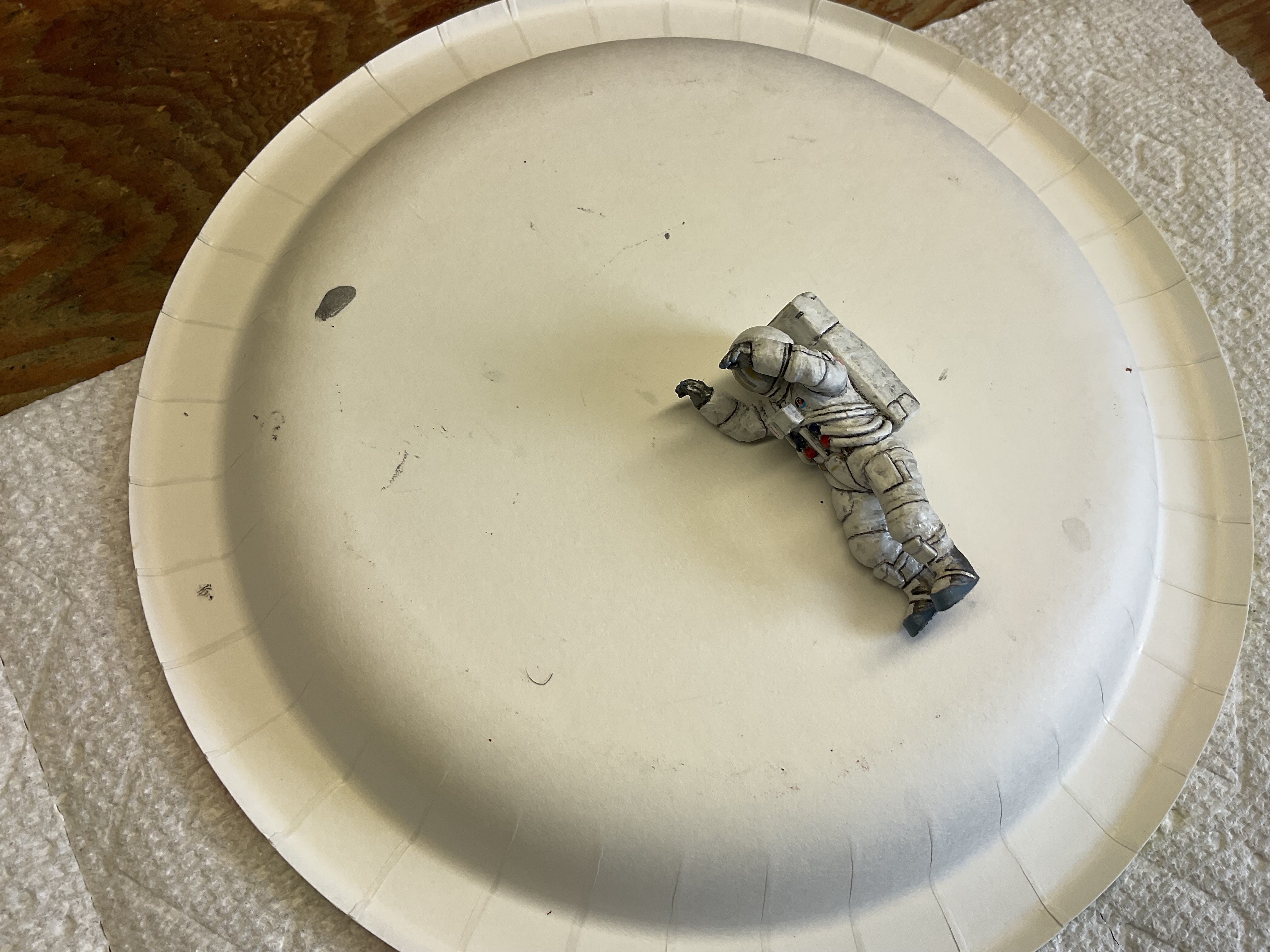

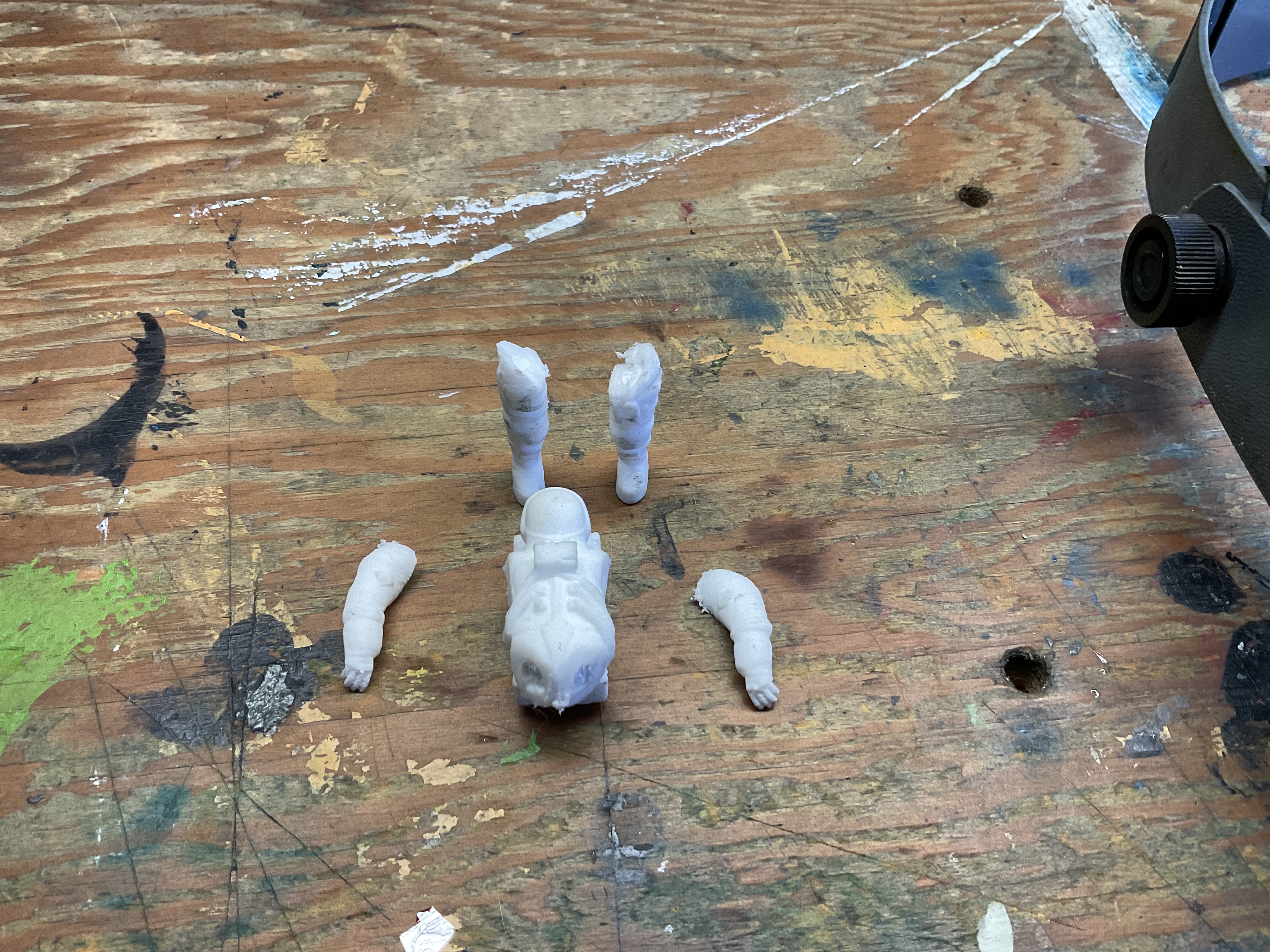

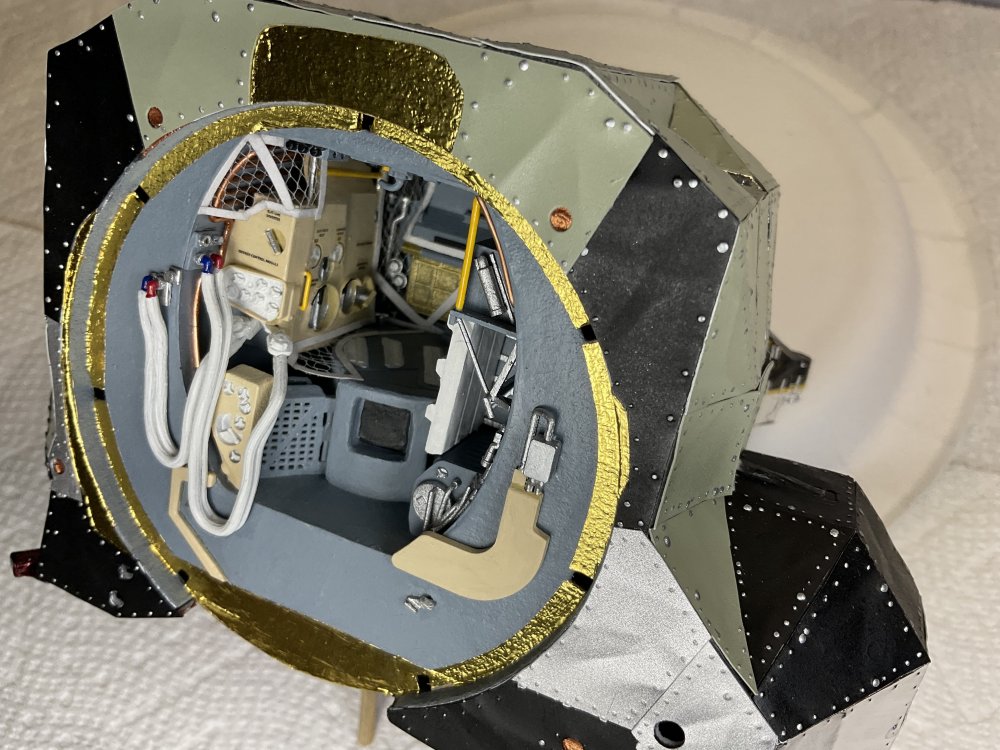

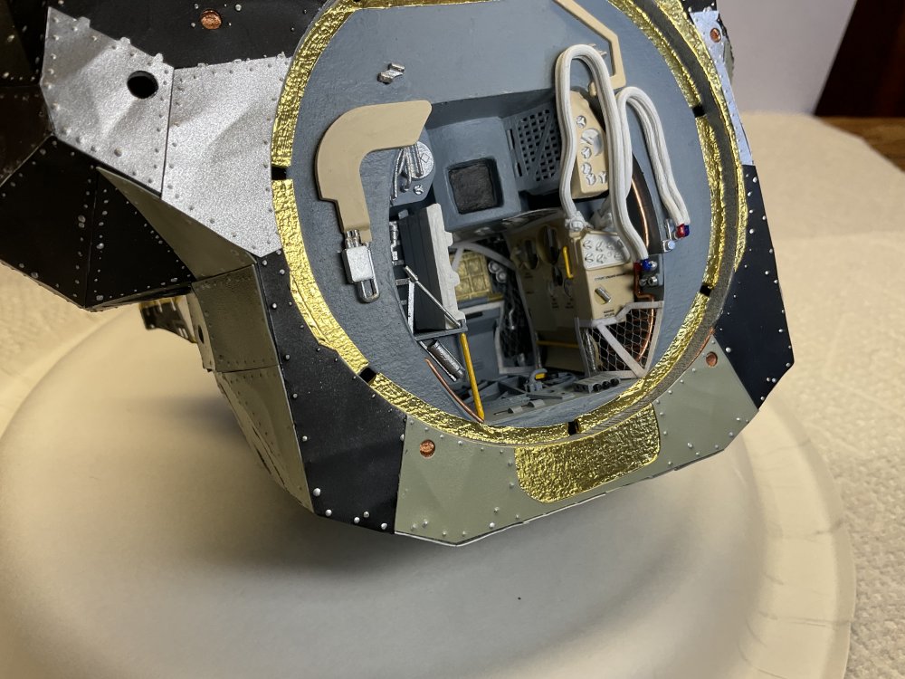

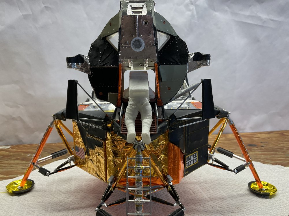

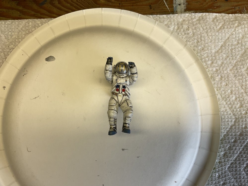

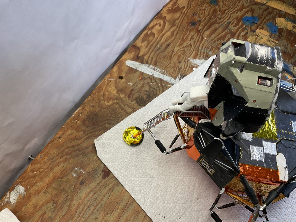

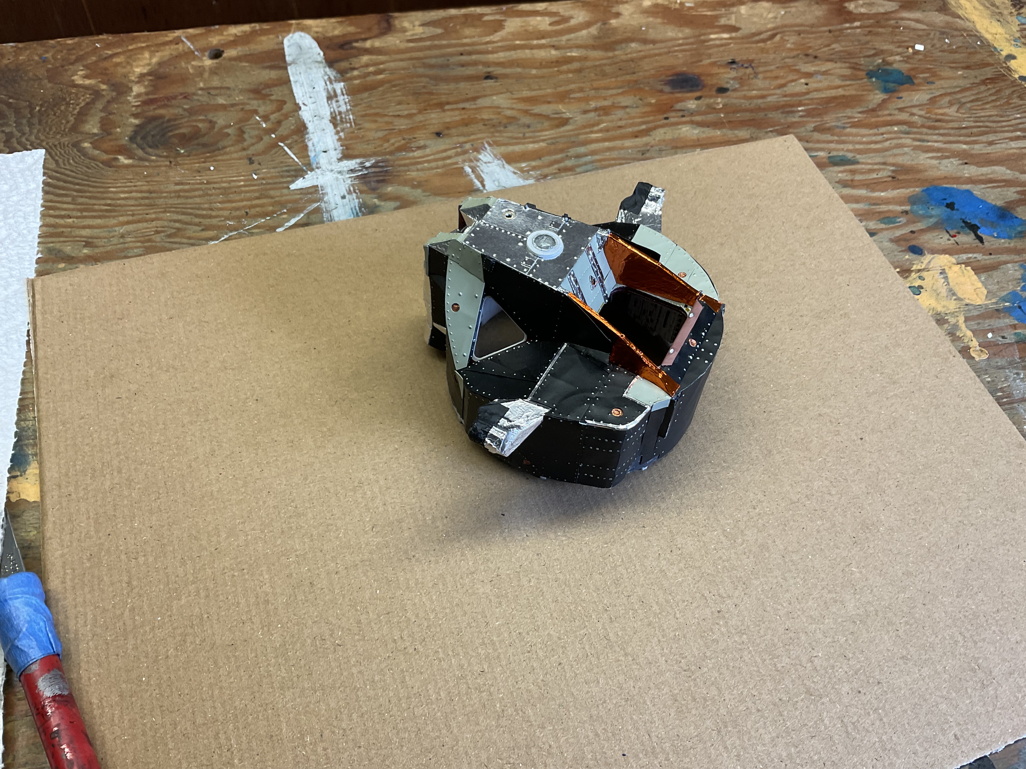

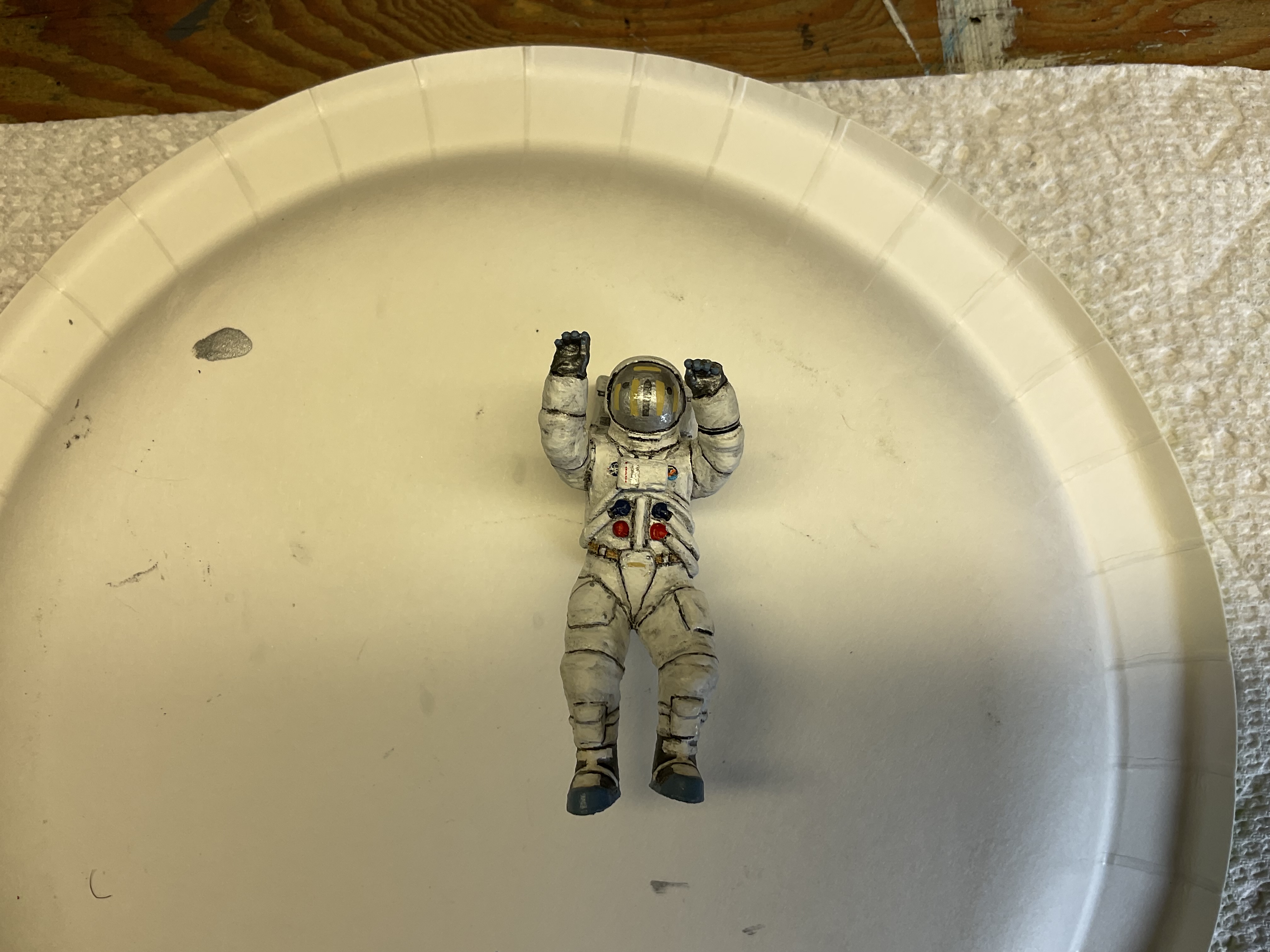

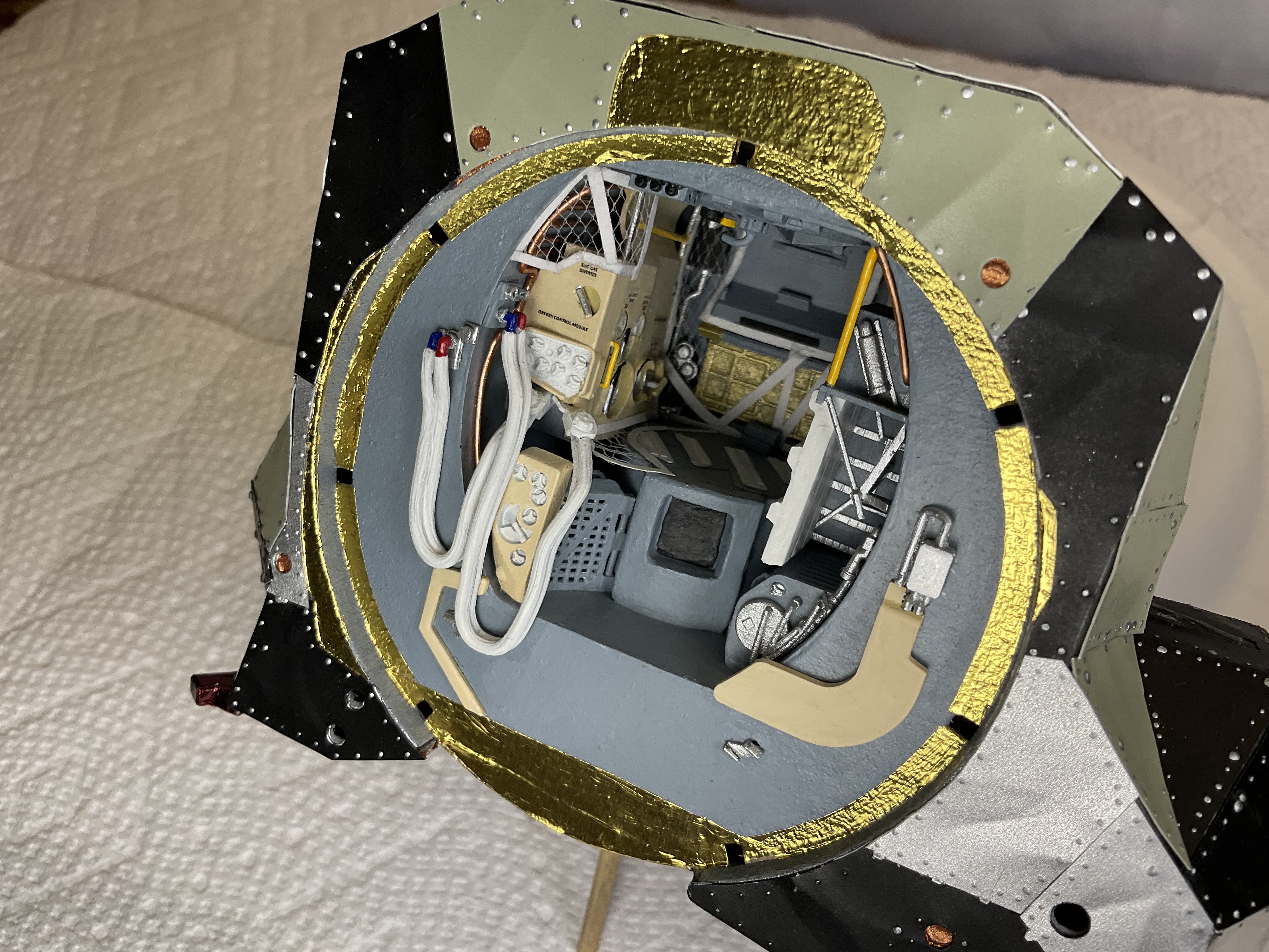

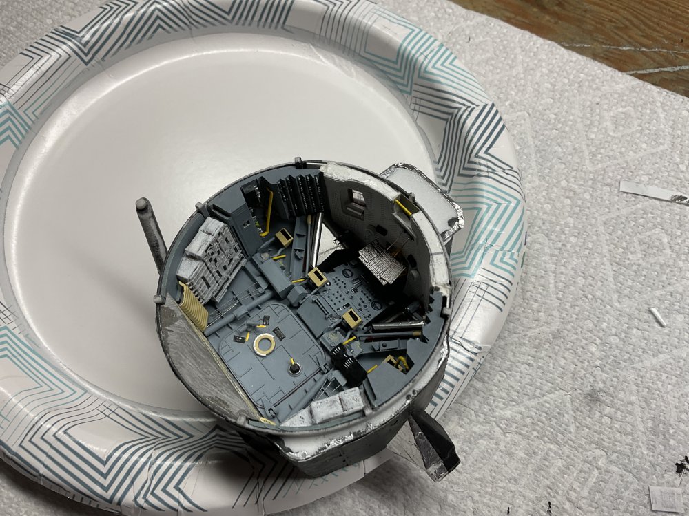

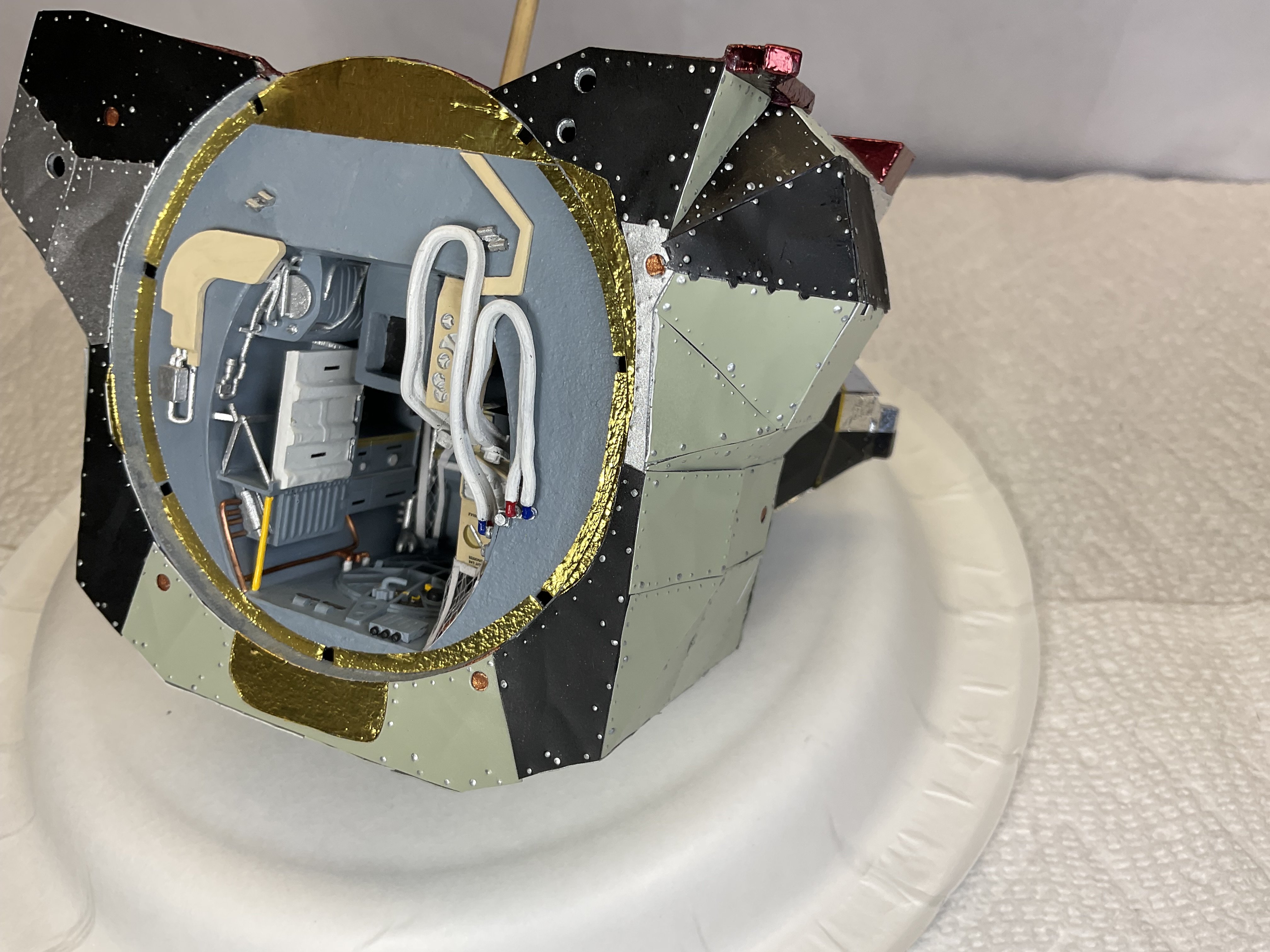

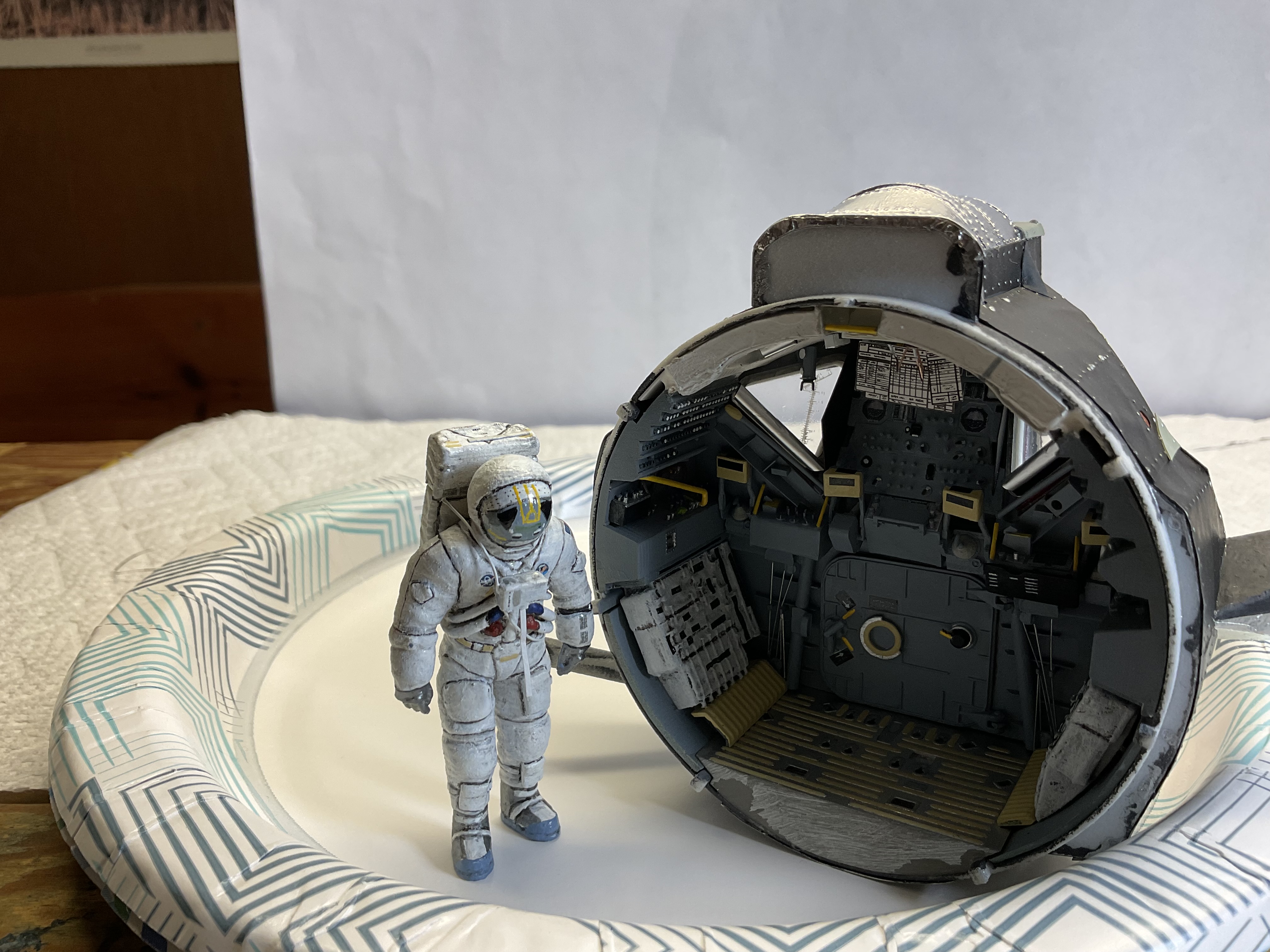

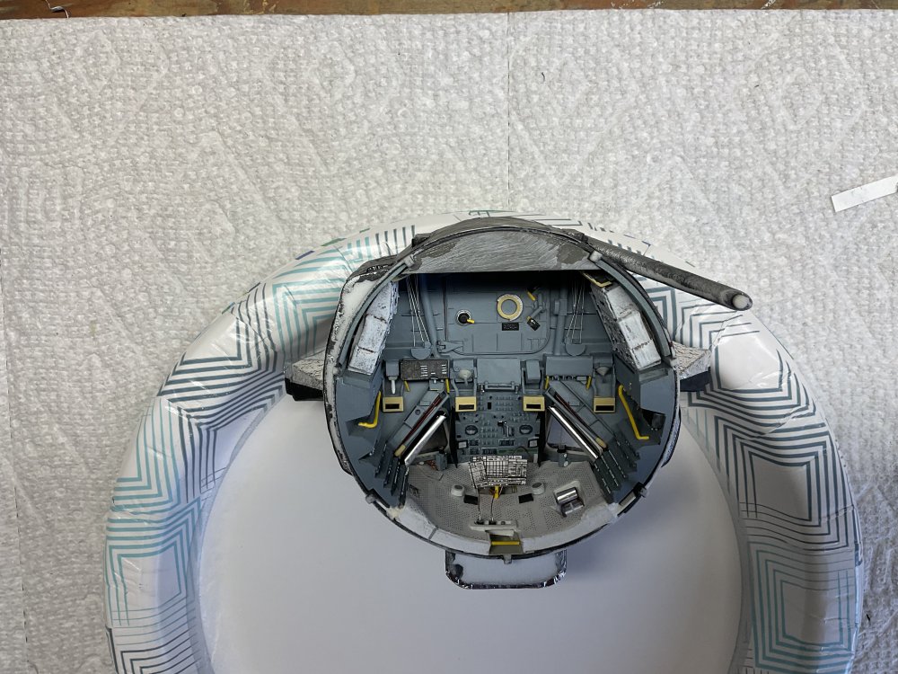

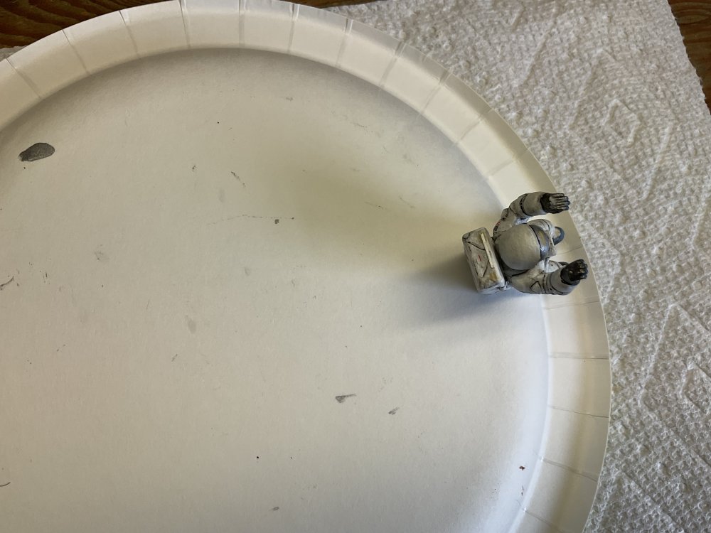

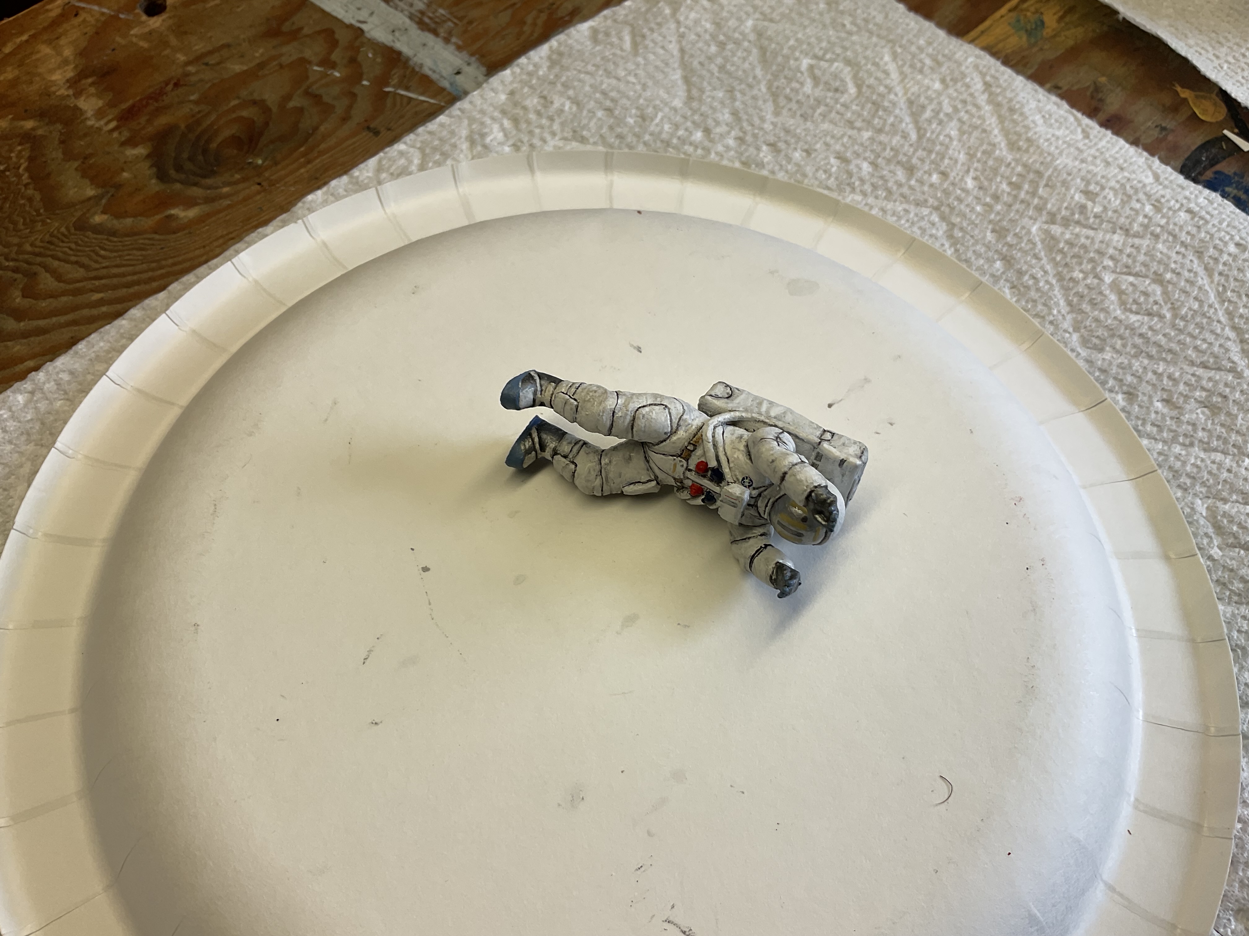

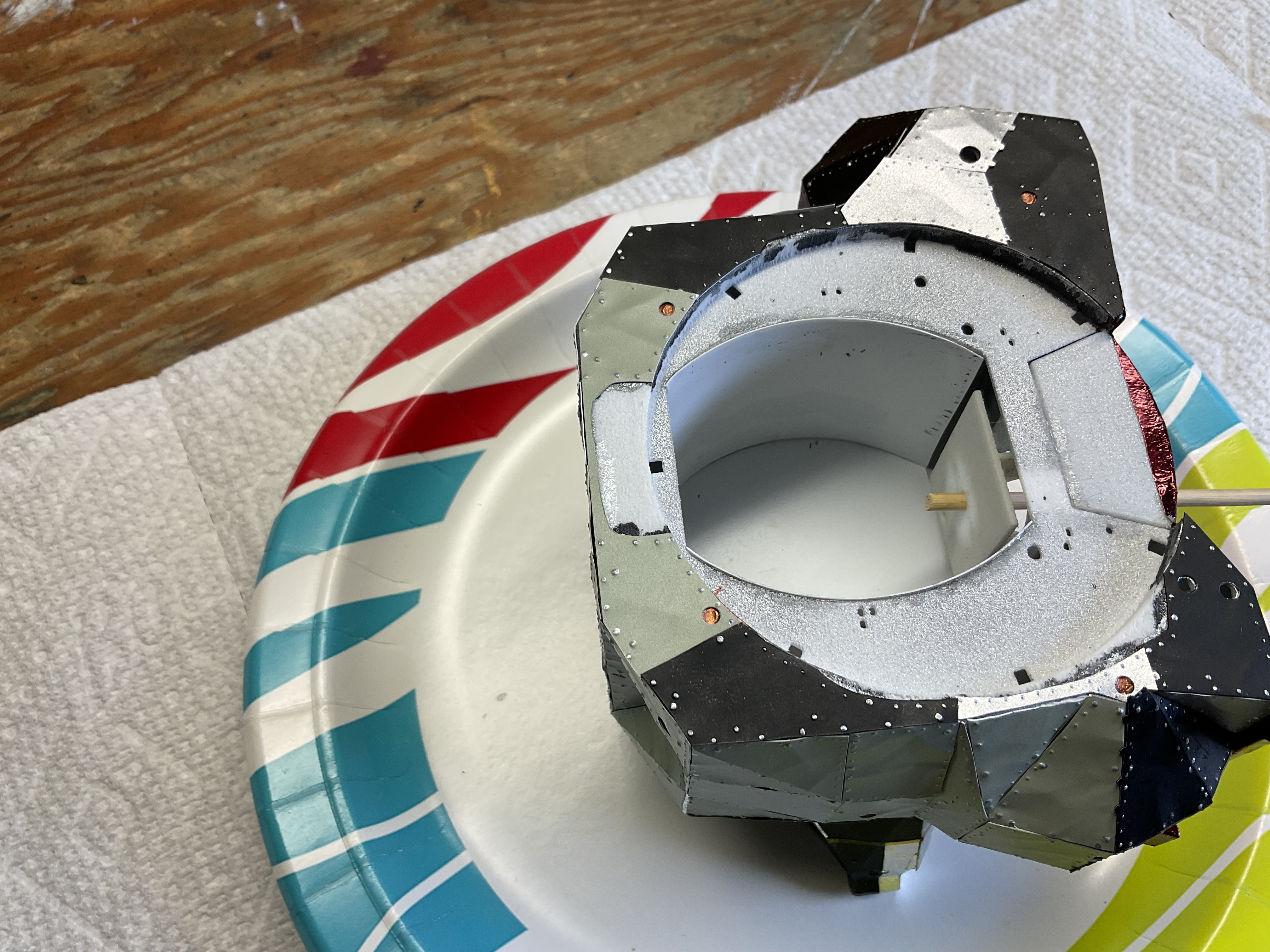

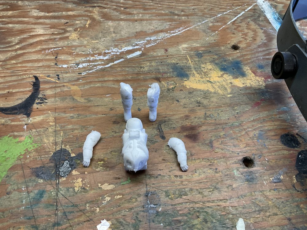

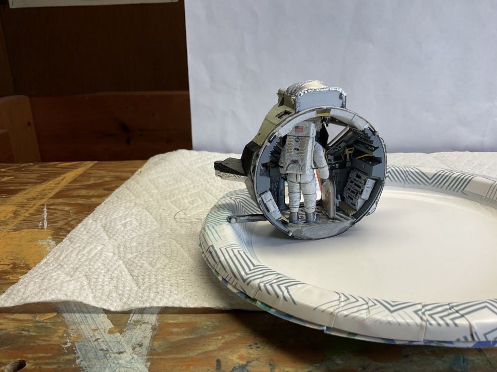

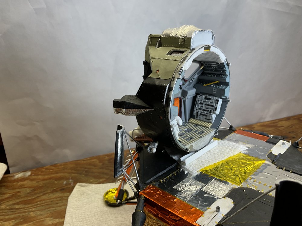

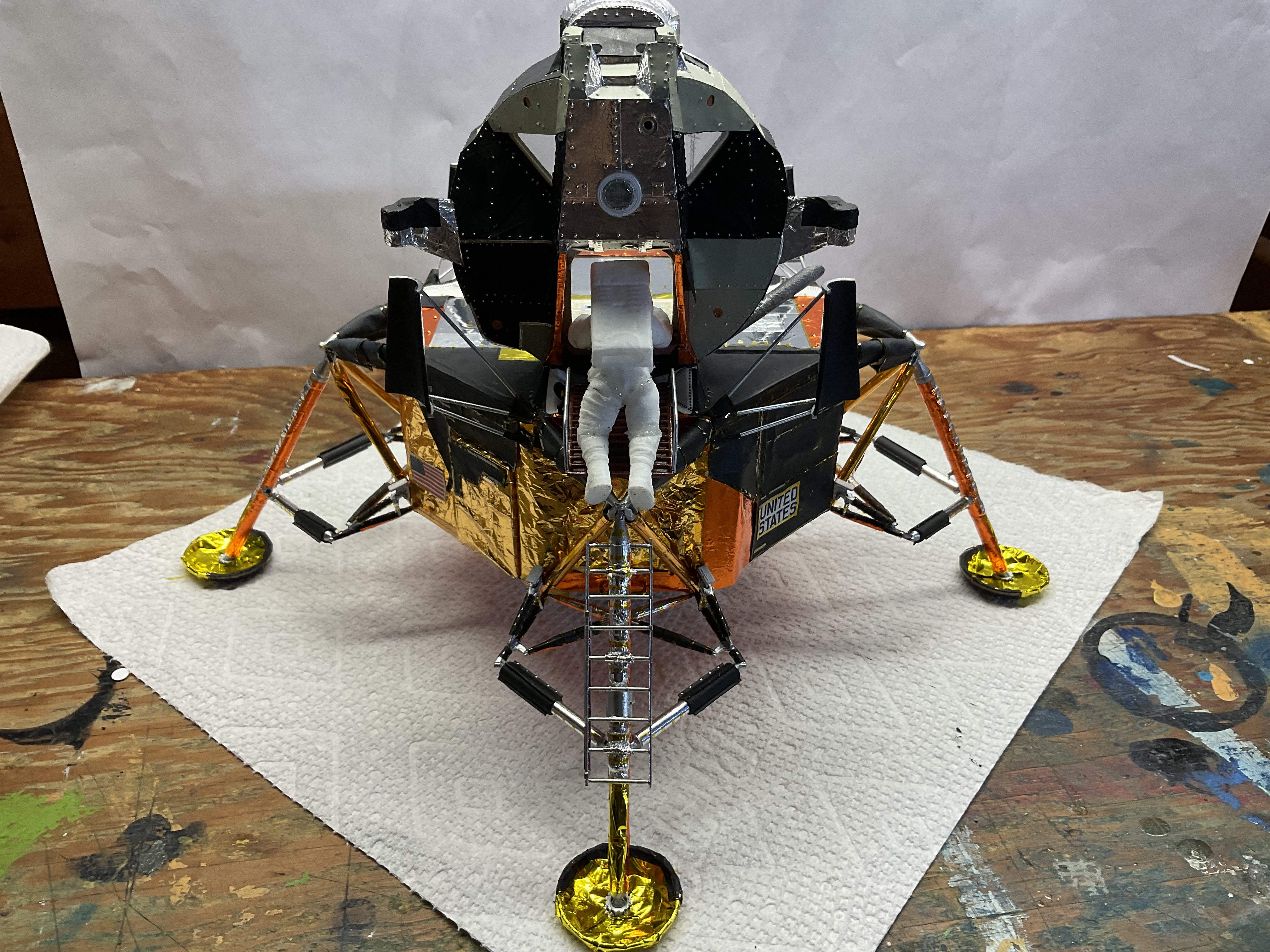

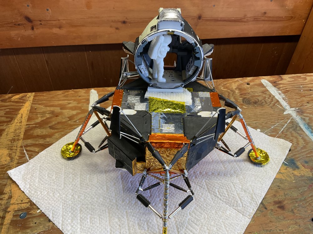

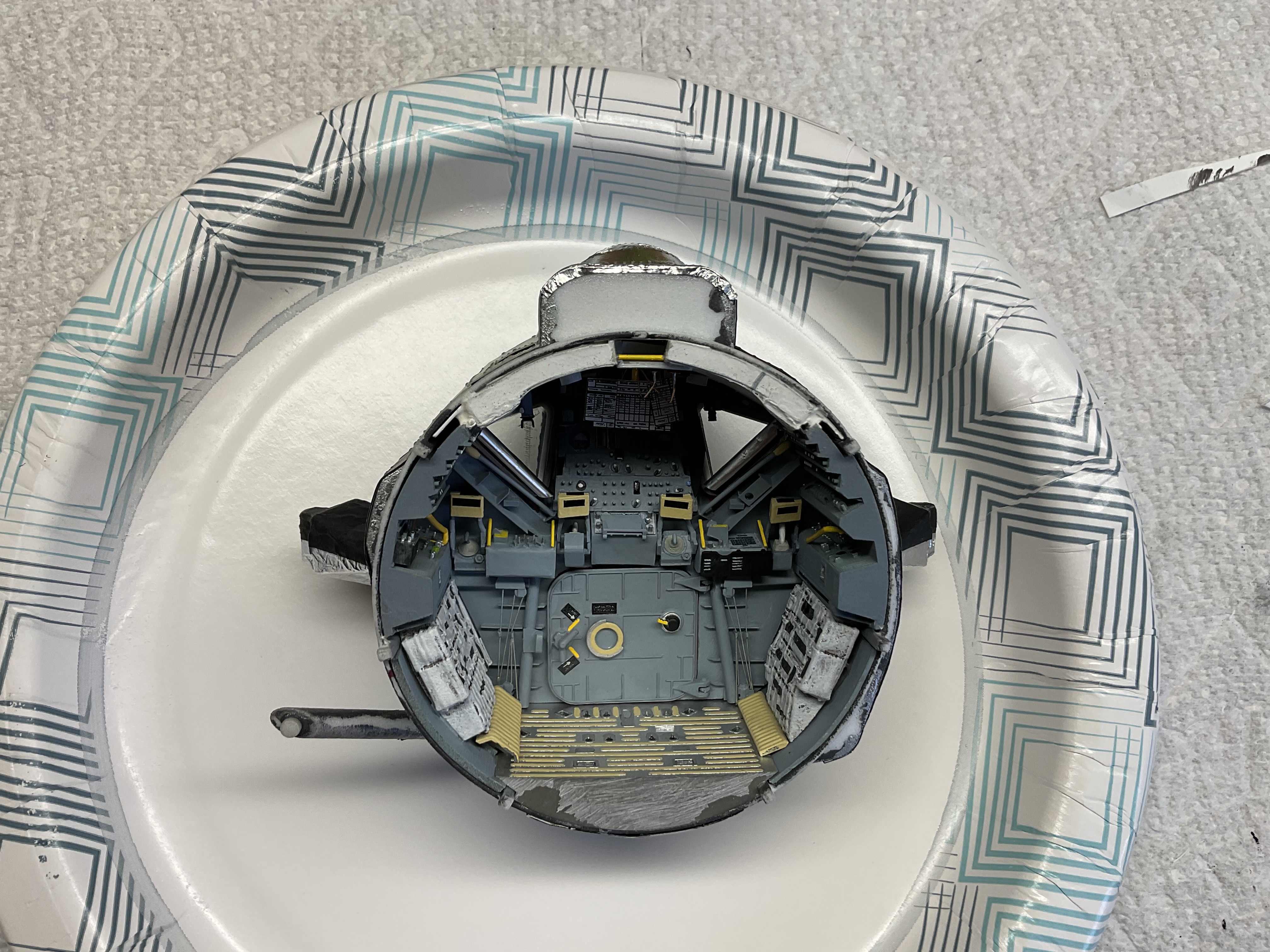

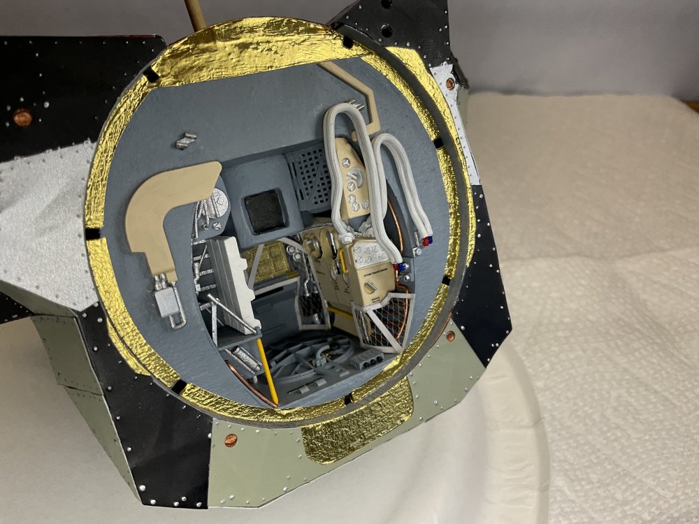

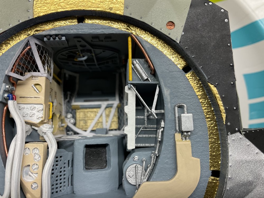

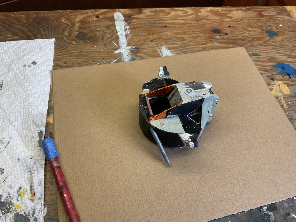

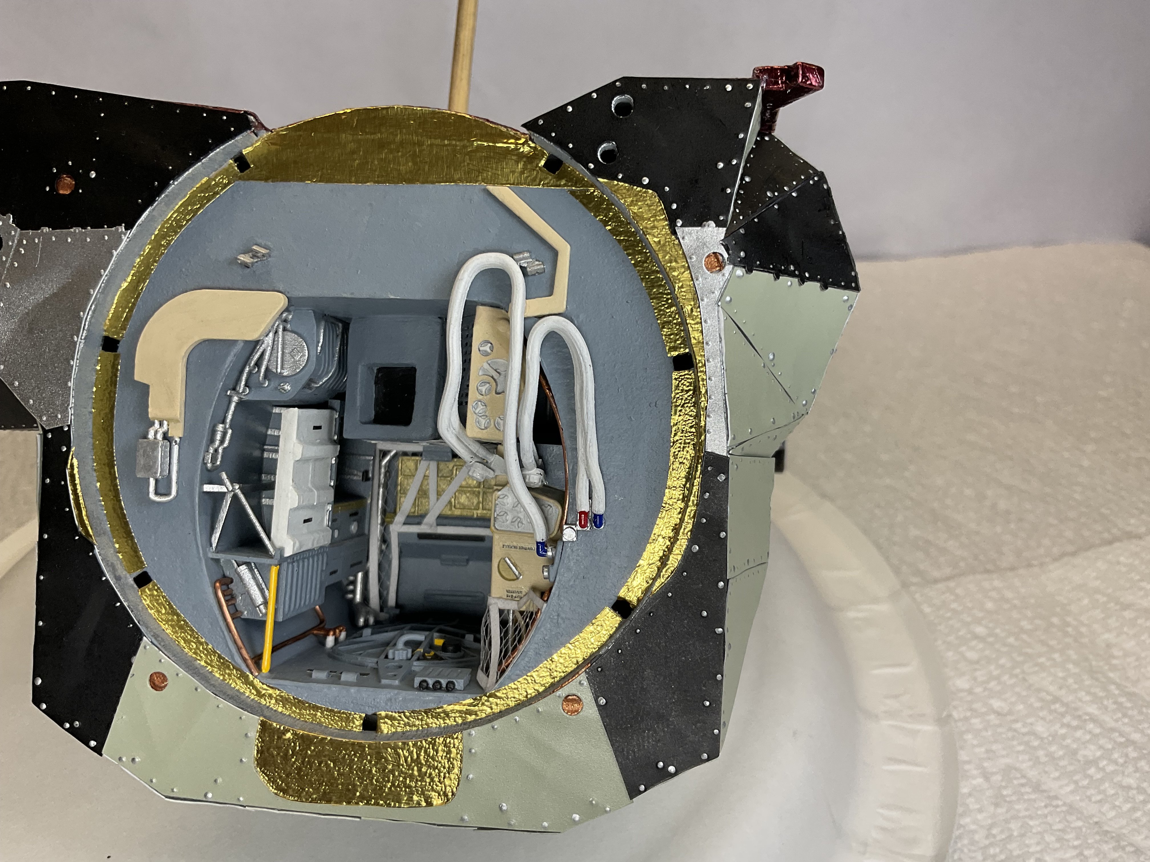

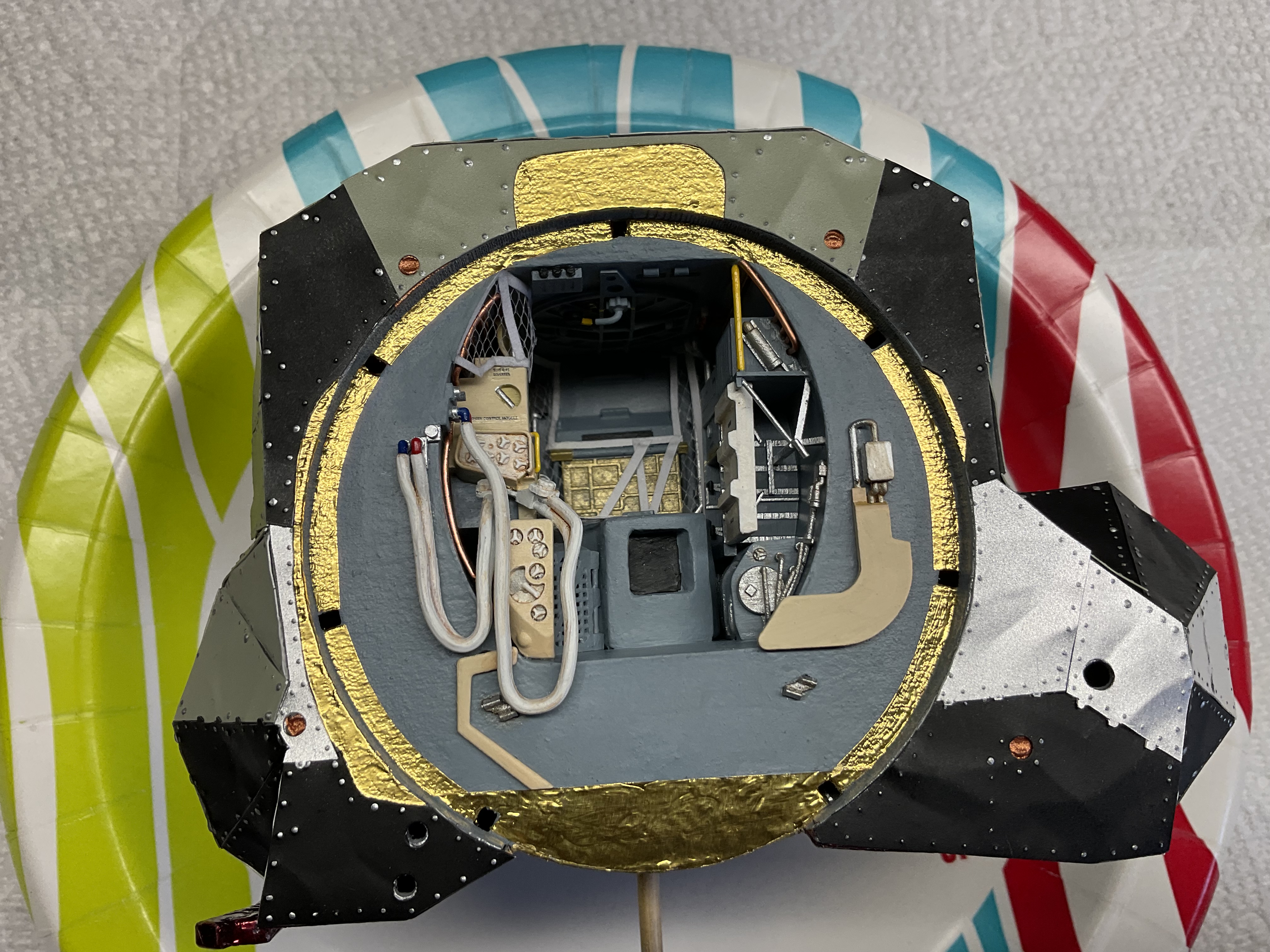

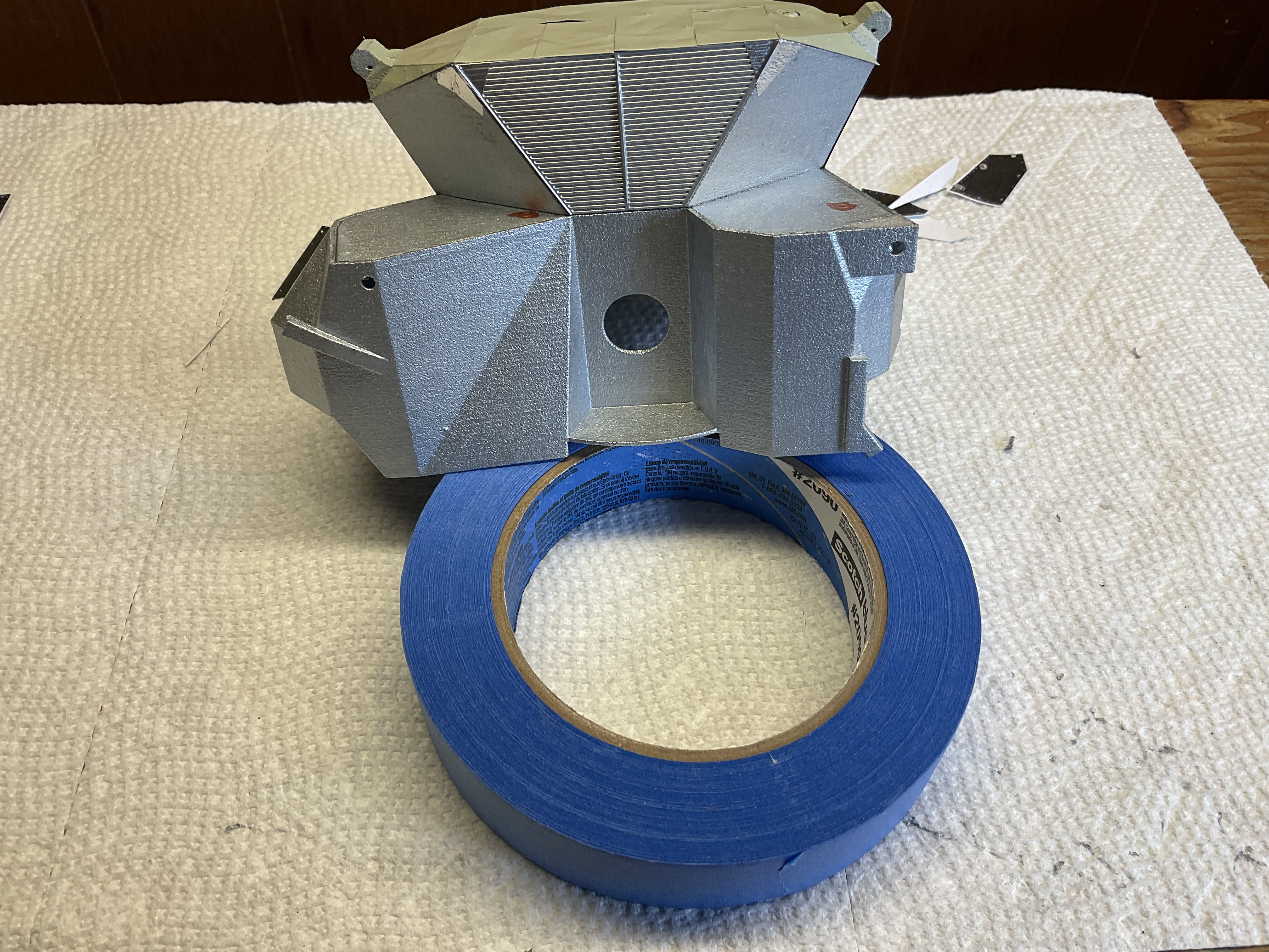

snichols Posted July 27, 2023 Author Share Posted July 27, 2023 (edited) I managed to successfully re-apply the foil so now it’s time to continue on with the ascent stage interior. I have two figures from Max, a set of decals from EVA models and the desire to do some converting. Cockpit interior is a mix of scratch build with Vincent’s parts, panels 1-3 are on the way here as is 2d figure. I had no intention of producing an interior initially so it’s not going to be 100%. The last two pictures show how Neil looked prior to the conversion, I also gave both commanders side and LMP side storage bags an oil paint wash to accentuate the details. Edited July 27, 2023 by snichols Quote Link to post Share on other sites

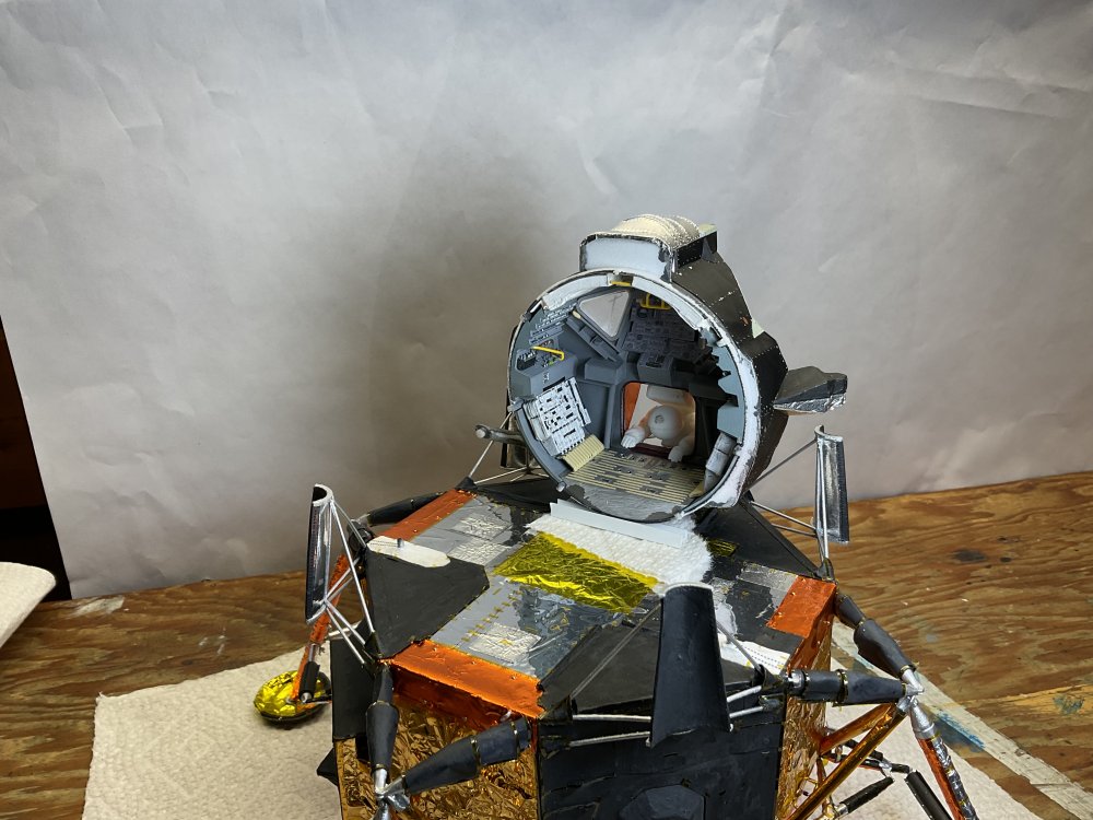

SpacecraftGuy Posted July 28, 2023 Share Posted July 28, 2023 Wow, a beautiful thing, indeed! Now that you see it with the hatch open, I think you'll see how much you'll be able to see of the cabin mid and back. One of the great things about a scale LM interior (and probably more so in larger scales) is actually demonstrating just how tiny that interior space was. Just try to string up two 1/32 sleep stations in there. And imagine just how claustrophobic it must have been for the longer duration surface stays. And cold. And noisy. A masterful and beautiful build!! Quote Link to post Share on other sites
snichols Posted July 29, 2023 Author Share Posted July 29, 2023 (edited) On 7/28/2023 at 7:47 PM, SpacecraftGuy said: Wow, a beautiful thing, indeed! Now that you see it with the hatch open, I think you'll see how much you'll be able to see of the cabin mid and back. One of the great things about a scale LM interior (and probably more so in larger scales) is actually demonstrating just how tiny that interior space was. Just try to string up two 1/32 sleep stations in there. And imagine just how claustrophobic it must have been for the longer duration surface stays. And cold. And noisy. A masterful and beautiful build!! Thank you brother, I see you’ve been busy too and your CSM is looking good! Once I realized how much of the interior that was visible with an open hatch I was a tad upset I didn’t plan more thoroughly , a lesson learned. Speaking of available cockpit and midsection space, can you imagine living in such a confined area surrounded by such a hostile environment ,it would not be on my top ten list of things to do and those guys were made of steel. I did try to save money on parts and made a huge mistake ordering the figures which were produced in the versatile white plastic which is way too grainy to work with. To just get the material smooth enough to paint , Mr. surfacer pretty much erases all surface detail , another lesson learned but I’am a little happy with Neil and wish I would have spent the extra dollars for the better material. For those Eagle eyed viewers I haven’t added the apple to the purge valve on the front of the suit, OPS actuator cable and a couple other items and I almost forgot, visor is painted to mimic the pattern on the floor. Edited August 3, 2023 by snichols Quote Link to post Share on other sites

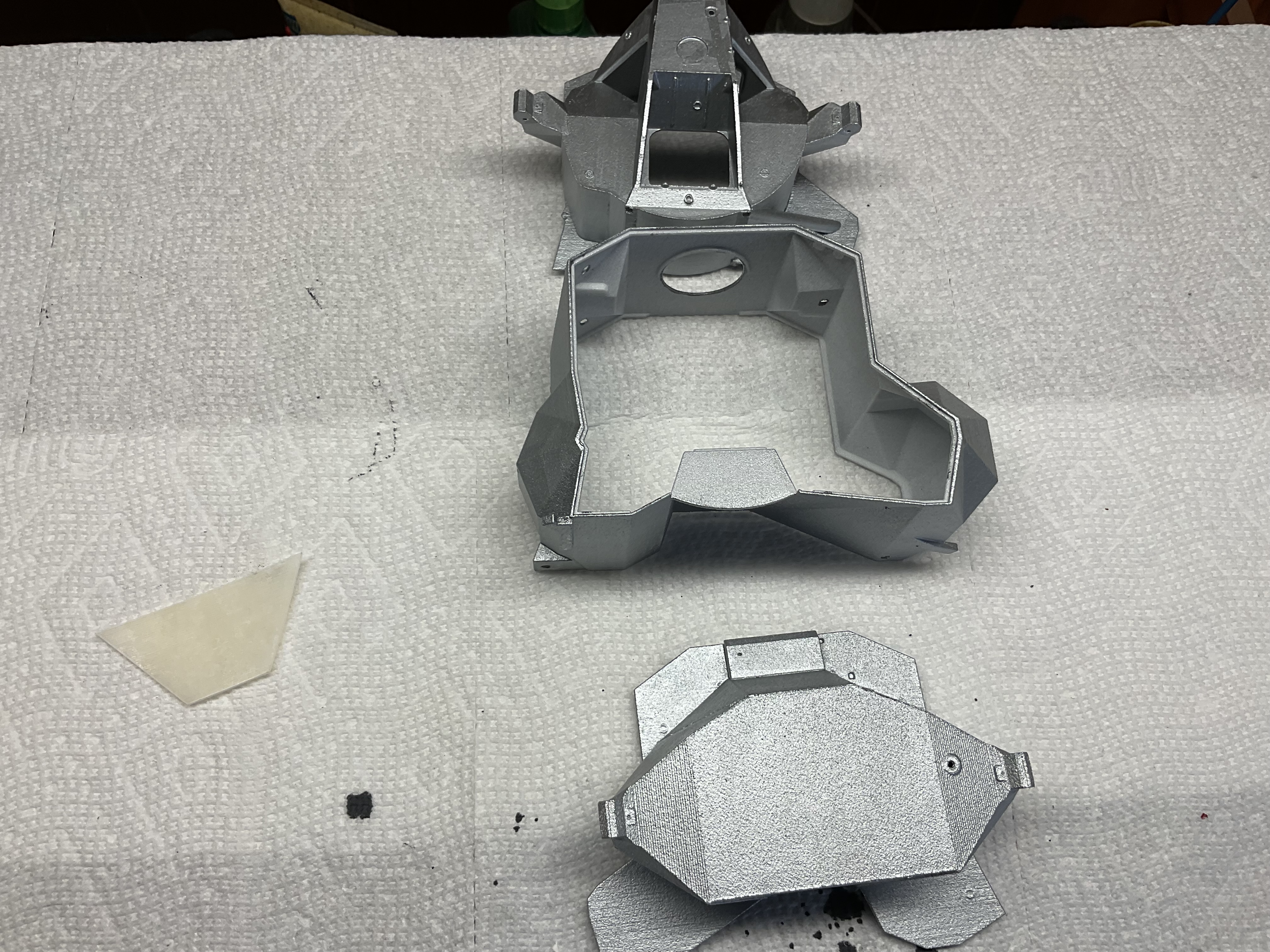

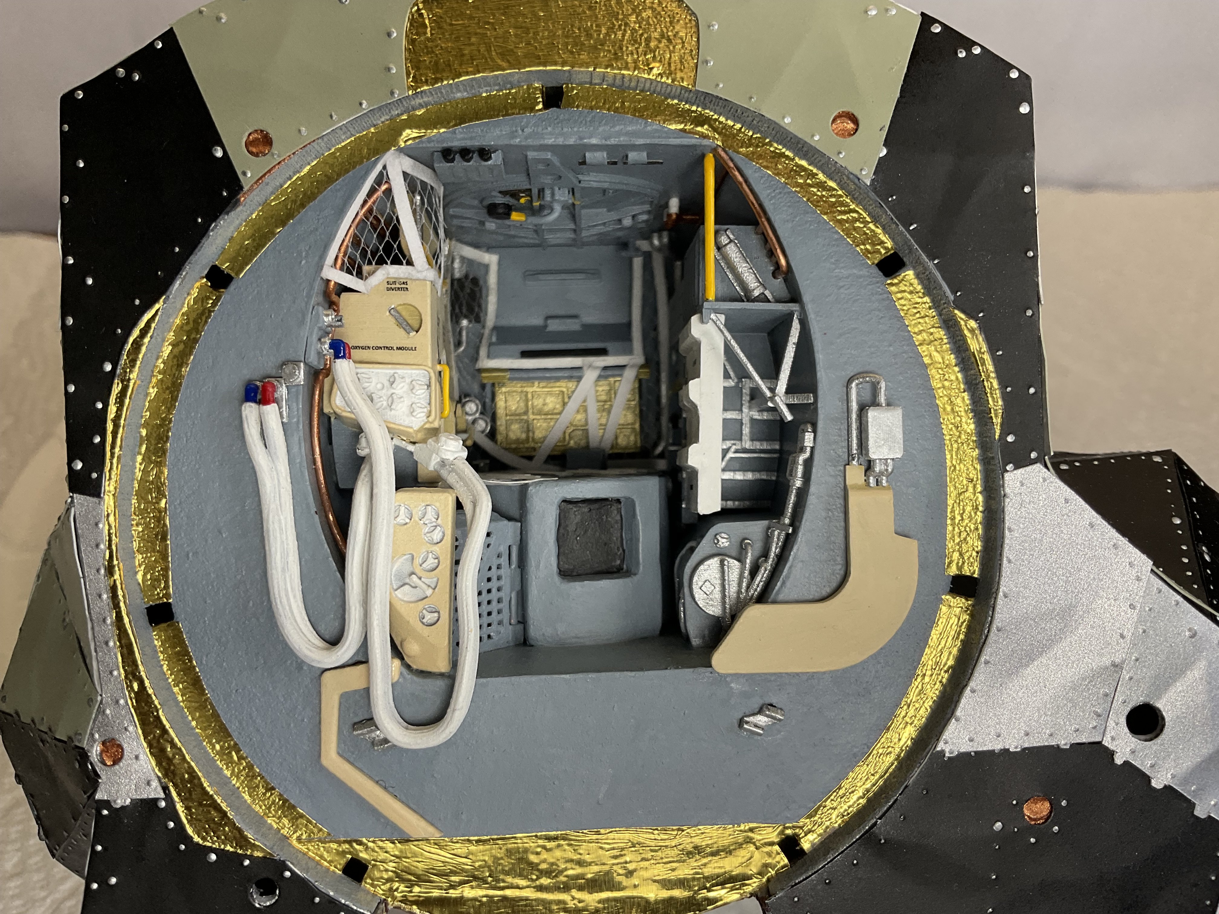

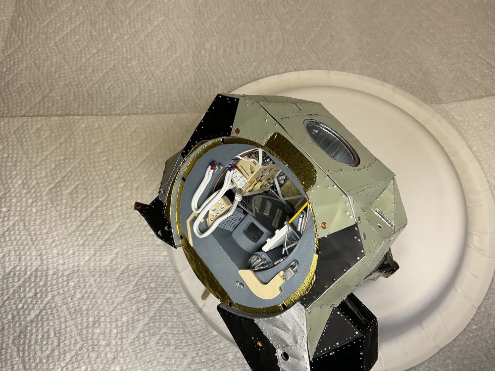

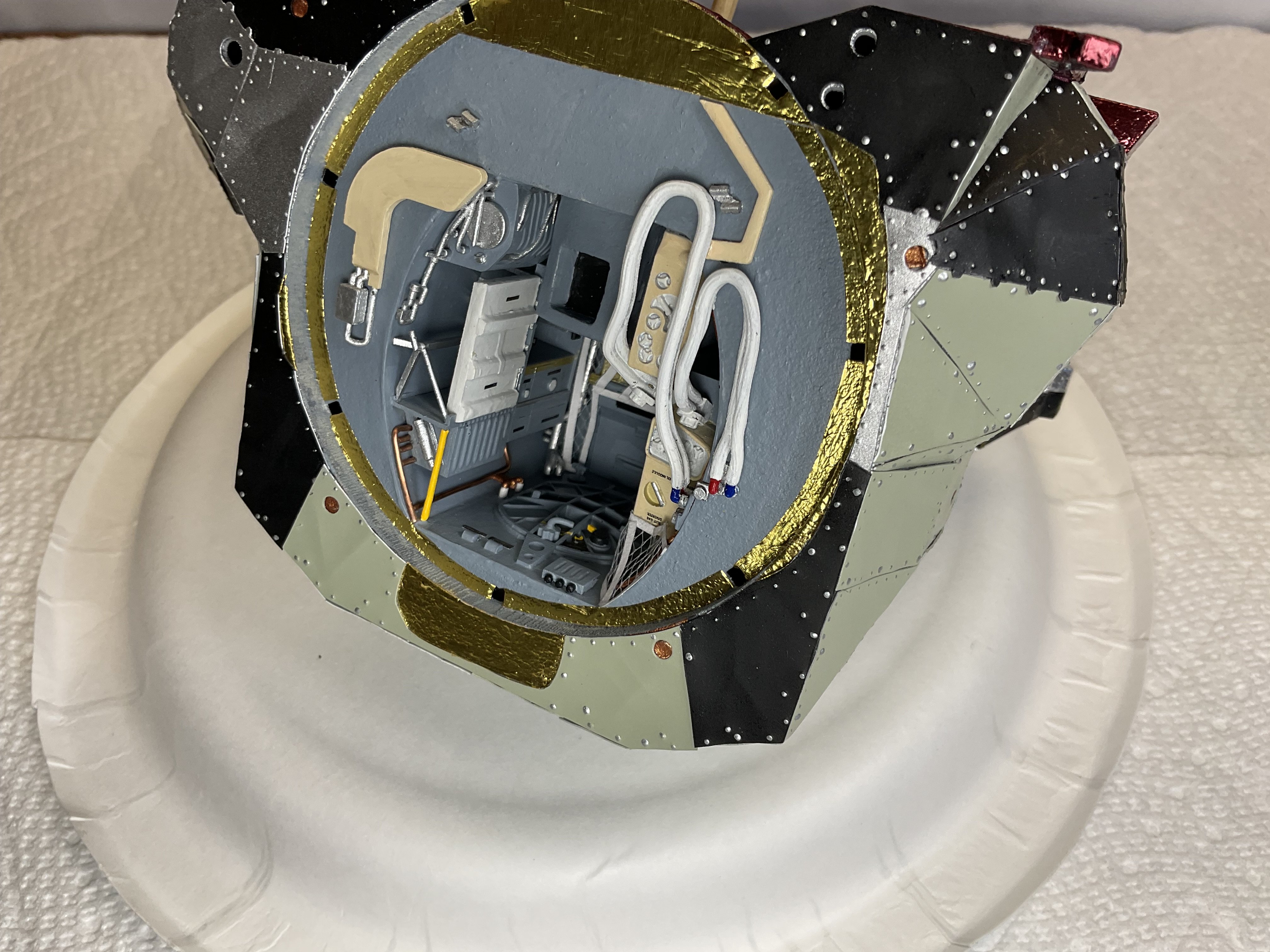

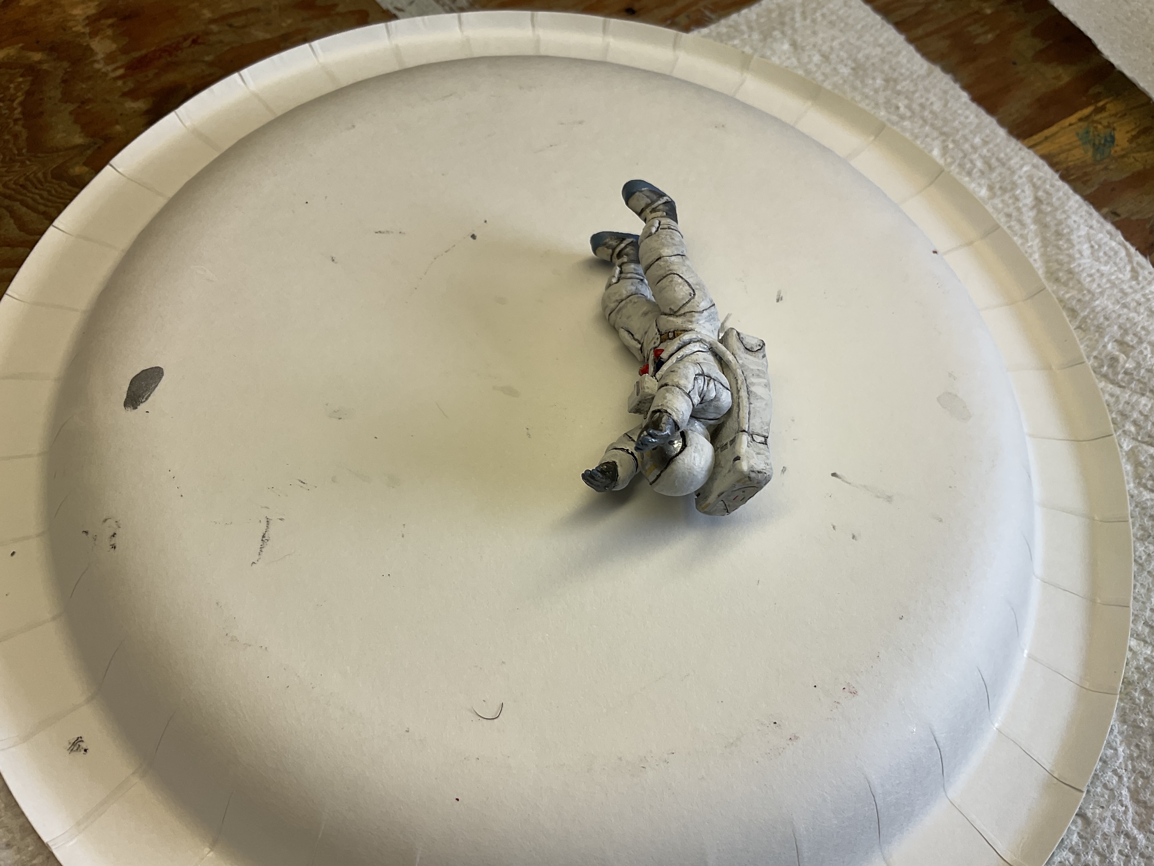

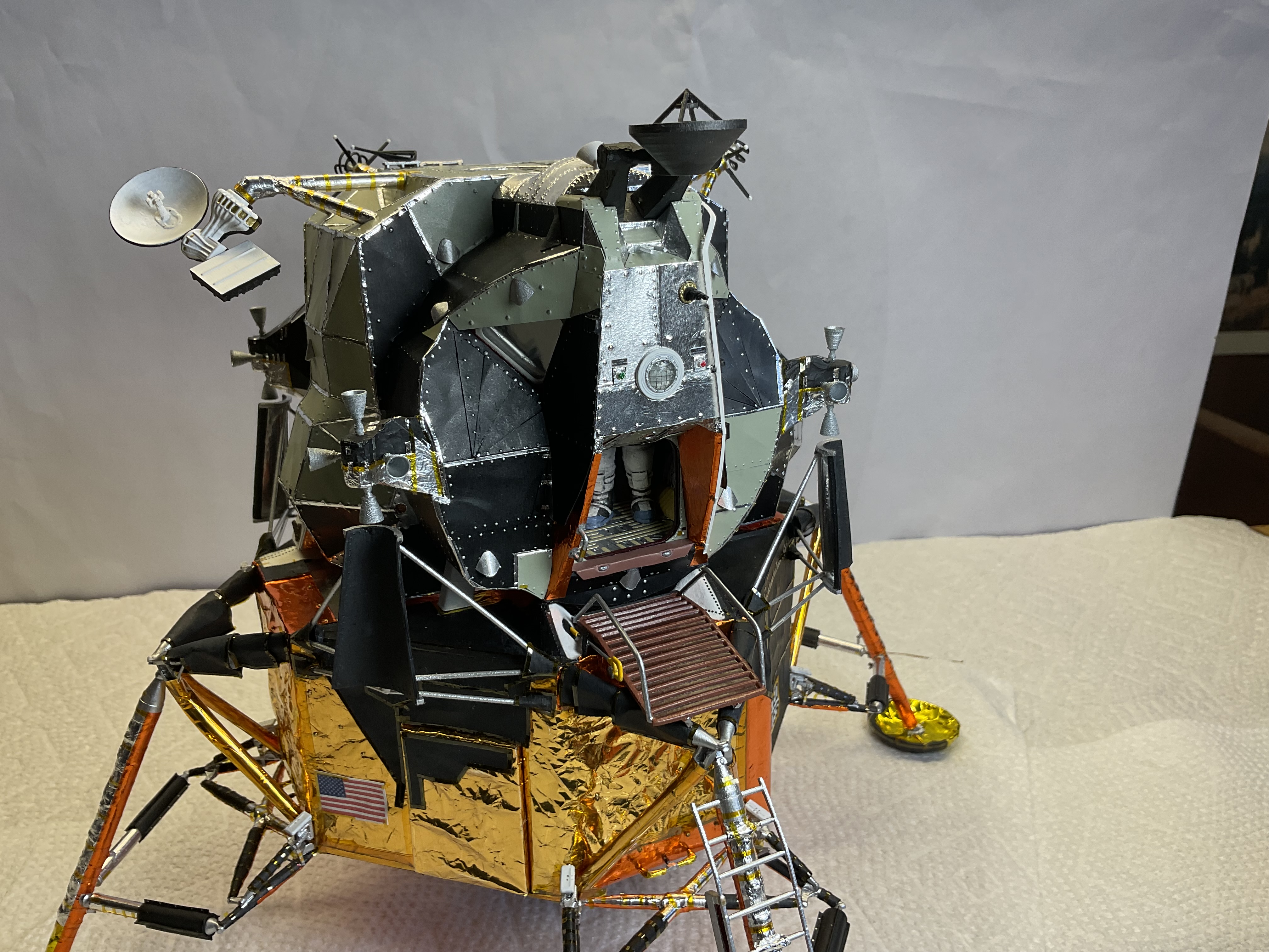

snichols Posted August 4, 2023 Author Share Posted August 4, 2023 (edited) On 7/30/2023 at 2:30 PM, bubble said: very nice steve , looks great this progress Thank you Mr. H , it’s so good to see you here again and your work is legendary. Ascent stage cockpit is now finally completed so now its time to re-paint Buzz’s visor to reflect the changes made inside the cockpit, silver window shades and the charts that are clamped to the AOT. All parts have arrived for the midsection and I’ve started to do some scratch building where I should have completed work before I closed everything up. Heat shield Kapton also needs to be replaced on the midsection and hatch is operable inside cockpit, I used two brass mini nails for the hinge pins. The COAS monacle aligns perfectly with the landing point designator reticle in the commanders window, not sure if luck or skill but betting on luck.😜 Edited August 4, 2023 by snichols Quote Link to post Share on other sites
SpacecraftGuy Posted August 4, 2023 Share Posted August 4, 2023 10 hours ago, snichols said: not sure if luck or skill but betting on luck If 9,999 other things are pure skill, it's a safe bet that that one is as well. That visor is insane! And while the fwd section is photo-realistic (or you have access to Lisa Simpson's miniaturizer), my very favorite thing is something I've never seen before: the charts. Somehow that puts it right over the top. Just read Michael Collin's Carrying the Fire for my Apollo 11 week read this July. He mentions how worried they were about accidentally bumping switches in the confined spaces of the CM, especially as they changed clothing. Your first photo above - can you imagine two of them trying to suit up and put on their PLSSs side by side in That space, with the walls around them made of foil? Amazing photo. If only Max Grueter made a pair of astronauts sleeping in their hammocks to try to hang inside there somehow, above ascent engine cover and the helmets stowed on the floor. The ascent stage coatings on the mid also look photo-realistic. Outstanding. Quote Link to post Share on other sites
snichols Posted August 10, 2023 Author Share Posted August 10, 2023 (edited) On 8/4/2023 at 8:37 AM, SpacecraftGuy said: If 9,999 other things are pure skill, it's a safe bet that that one is as well. That visor is insane! And while the fwd section is photo-realistic (or you have access to Lisa Simpson's miniaturizer), my very favorite thing is something I've never seen before: the charts. Somehow that puts it right over the top. Just read Michael Collin's Carrying the Fire for my Apollo 11 week read this July. He mentions how worried they were about accidentally bumping switches in the confined spaces of the CM, especially as they changed clothing. Your first photo above - can you imagine two of them trying to suit up and put on their PLSSs side by side in That space, with the walls around them made of foil? Amazing photo. If only Max Grueter made a pair of astronauts sleeping in their hammocks to try to hang inside there somehow, above ascent engine cover and the helmets stowed on the floor. The ascent stage coatings on the mid also look photo-realistic. Outstanding. Well thank you sir, after a tough week I can call the midsection interior complete with minimal scratch building which consisted of the engine cover, storage bags behind the commanders section, and the copper conduits on each wall. I forgot to mention in the previous post that the checklists on the AOT are a bit dark as the real computer printouts were pretty lightly printed, I tried making my own but they looked like blank paper. As far as being cramped we used pup tents in the Boy Scouts on our hikes at times and they were very cramped, getting dressed inside was a real pain so I can imagine the LM had the same feeling only 100x worse. Figures need final highlights with some mistakes made on the interior but for the out of sequence construction it didn’t turn out badly. I have to replace the gold foil on the bottom of the midsection , it shows a seam that’s actually a piece of heat shield foil and I doubt I’ll cover the back portion of the forward section since once it’s attached to the midsection it probably wont be removed that often. The last two pictures show the corrections using Testors acrylic dimensional paste which is great stuff . Edited August 11, 2023 by snichols Quote Link to post Share on other sites

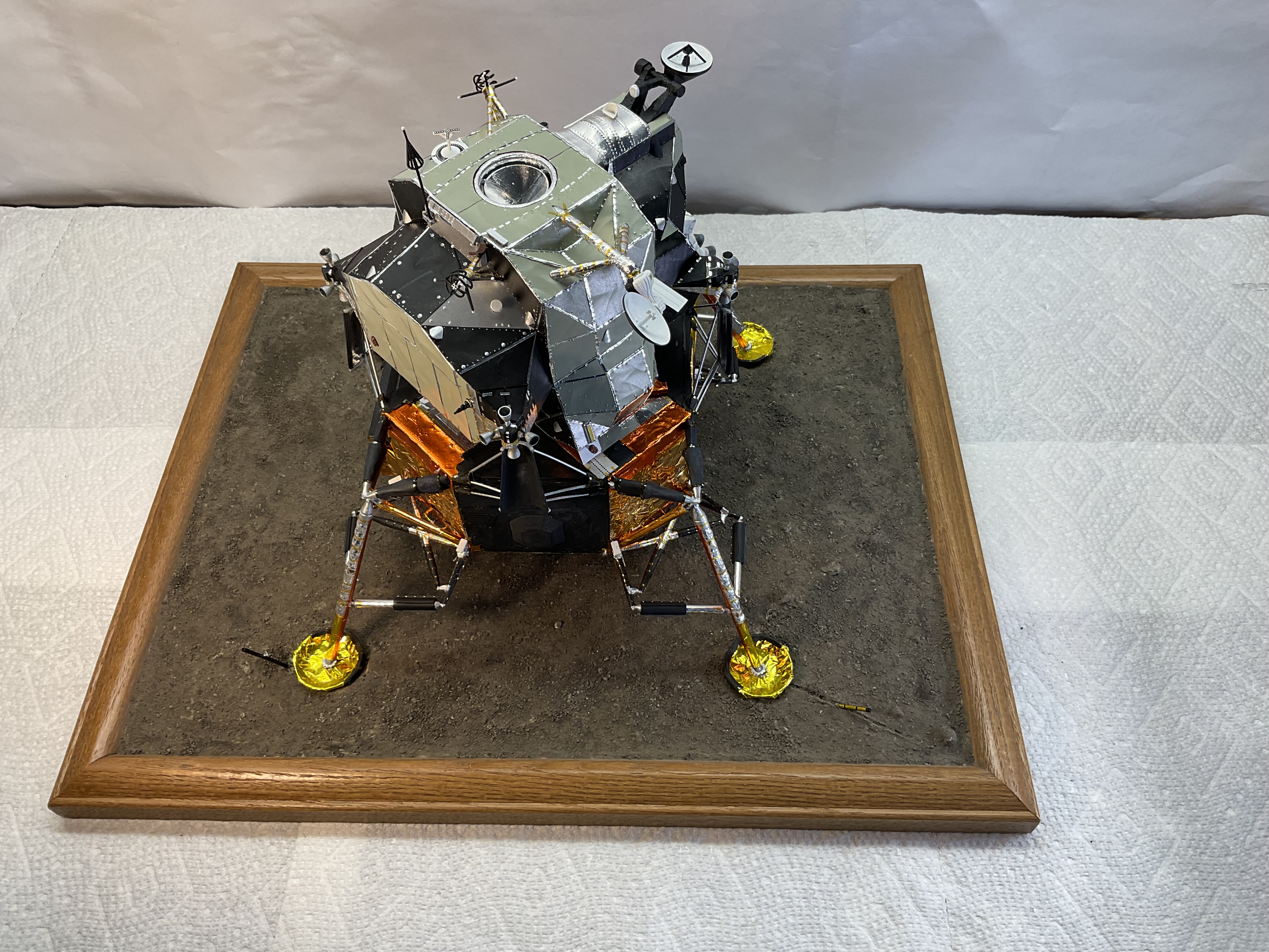

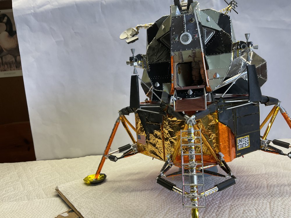

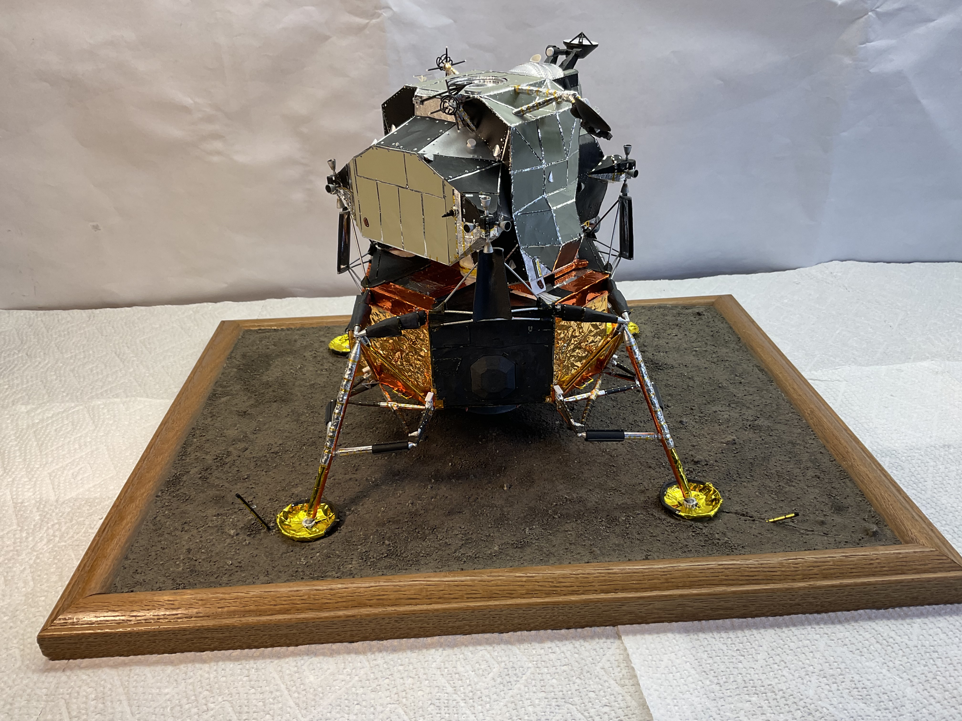

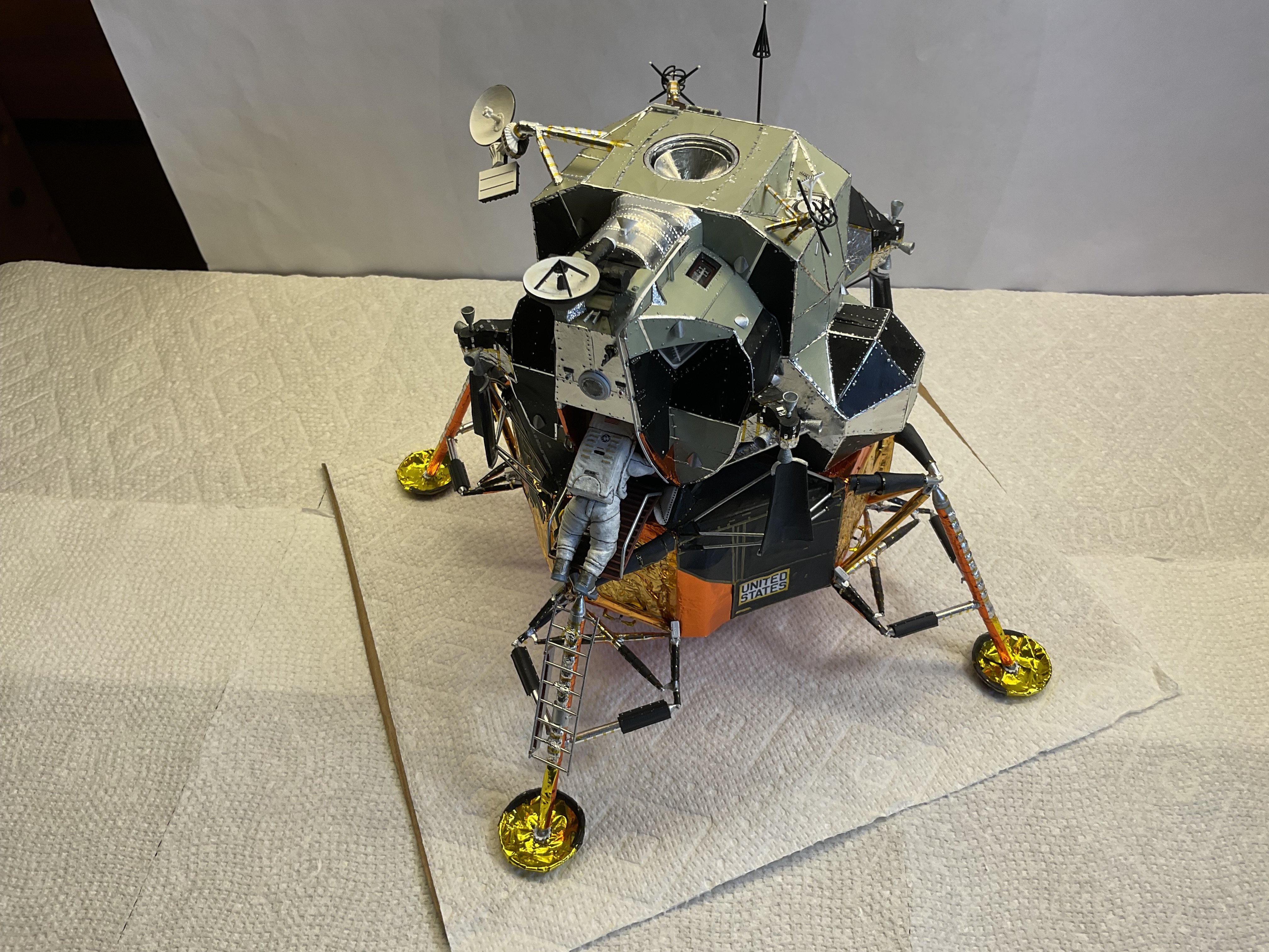

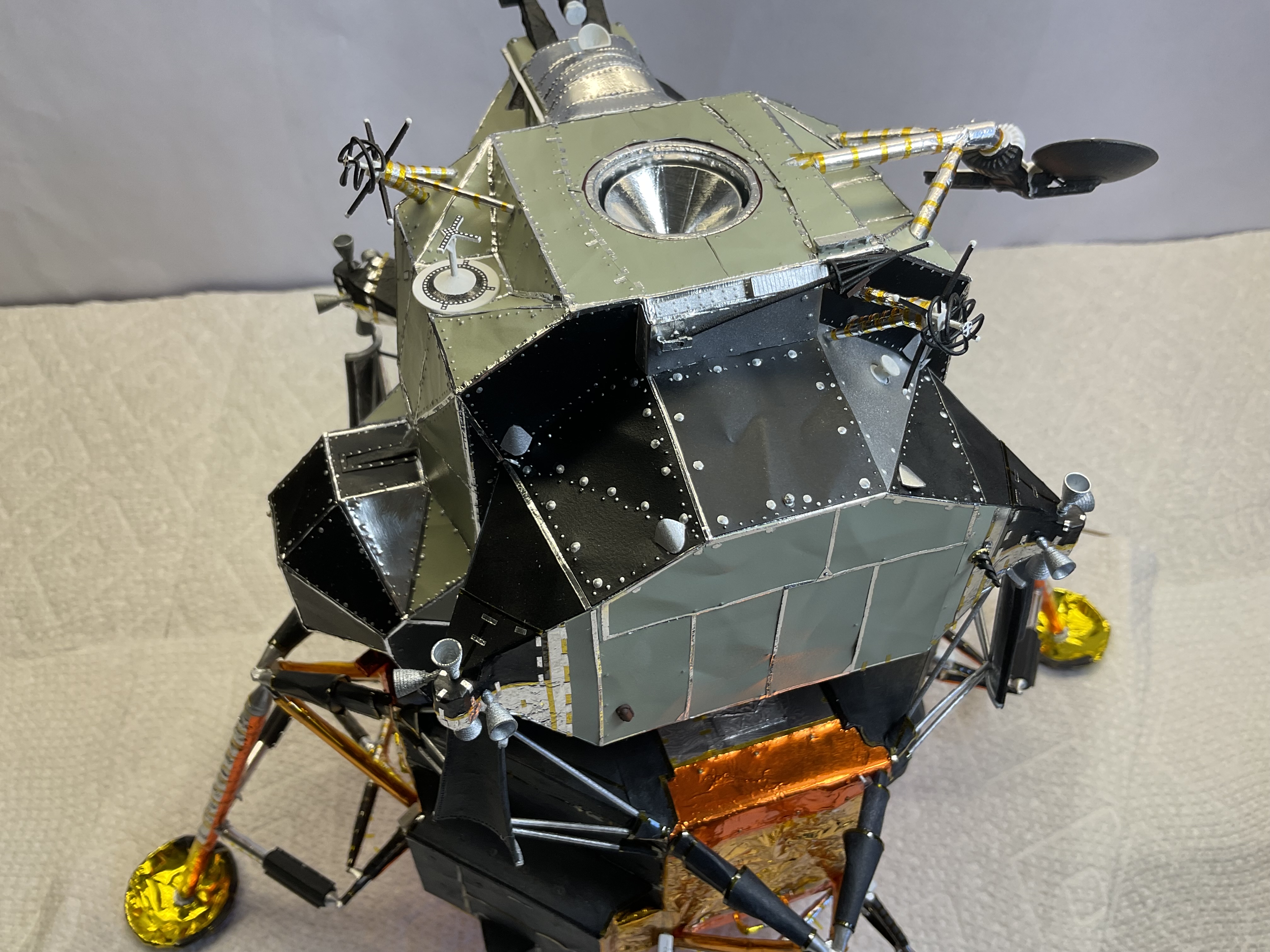

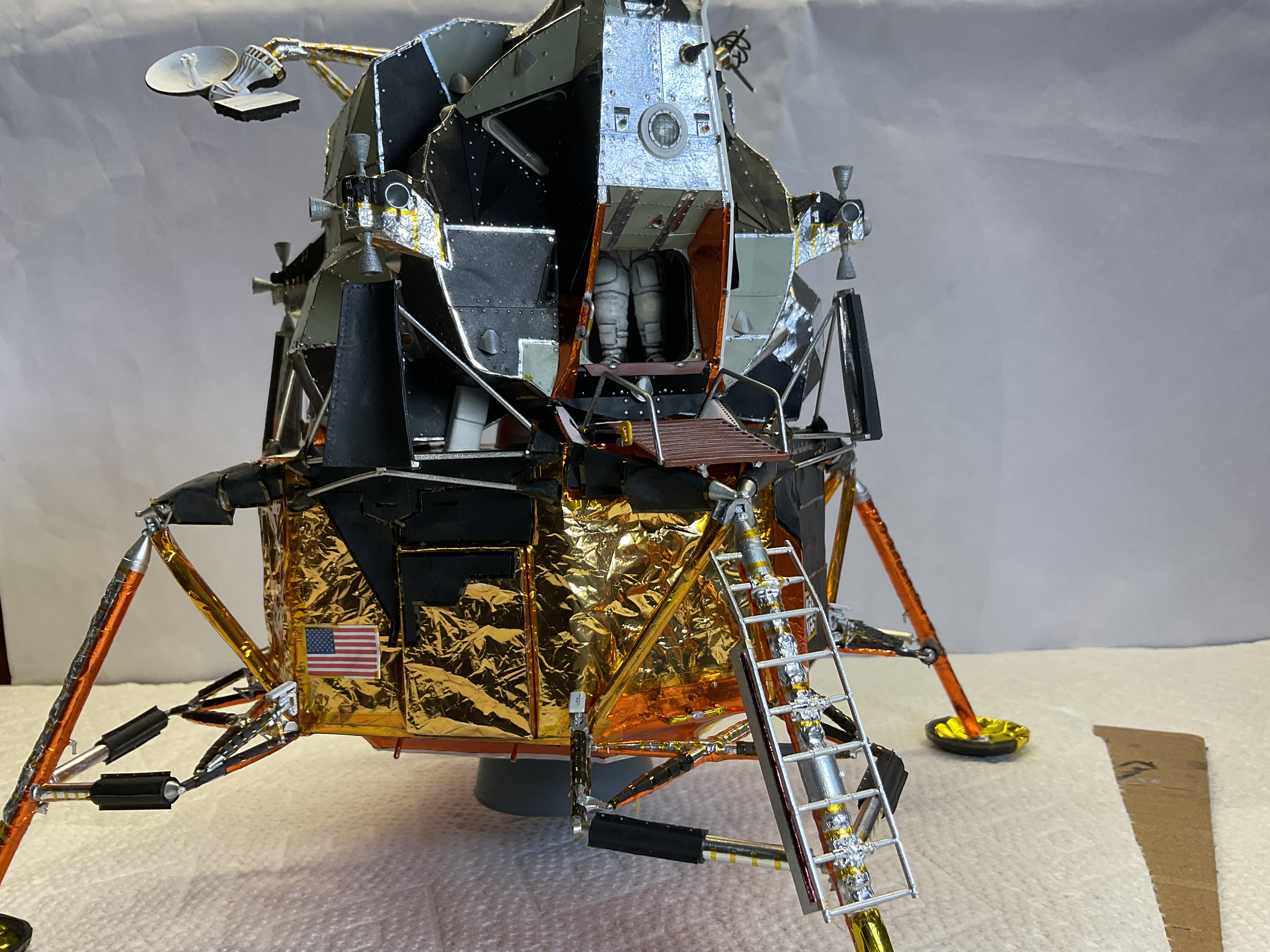

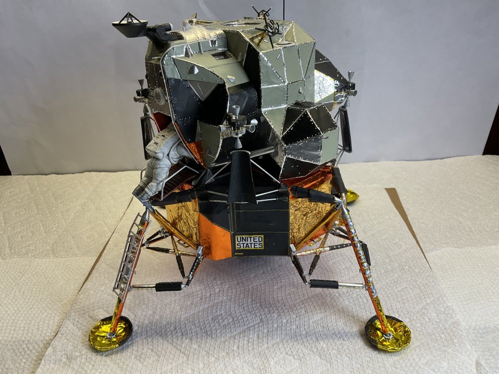

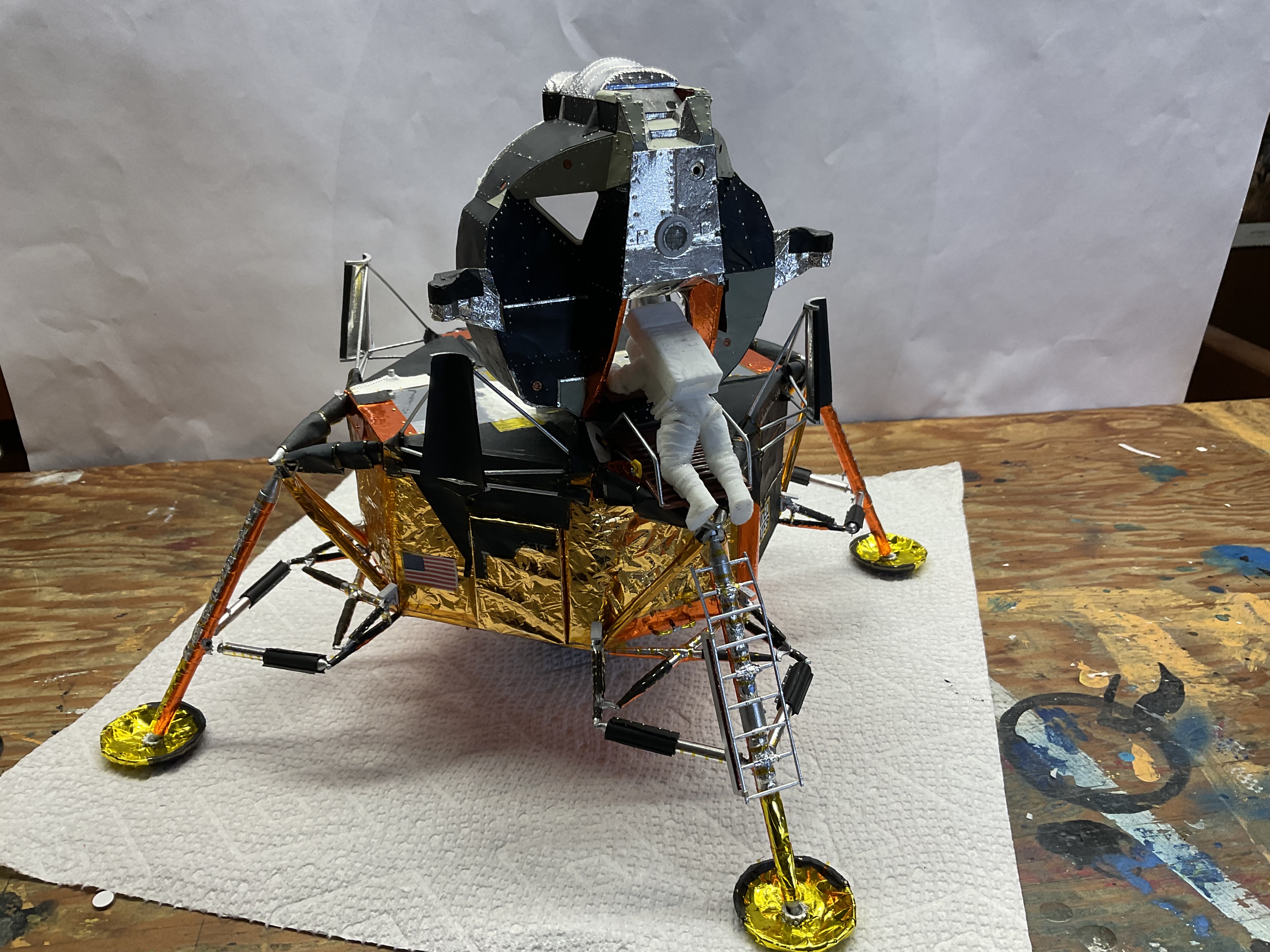

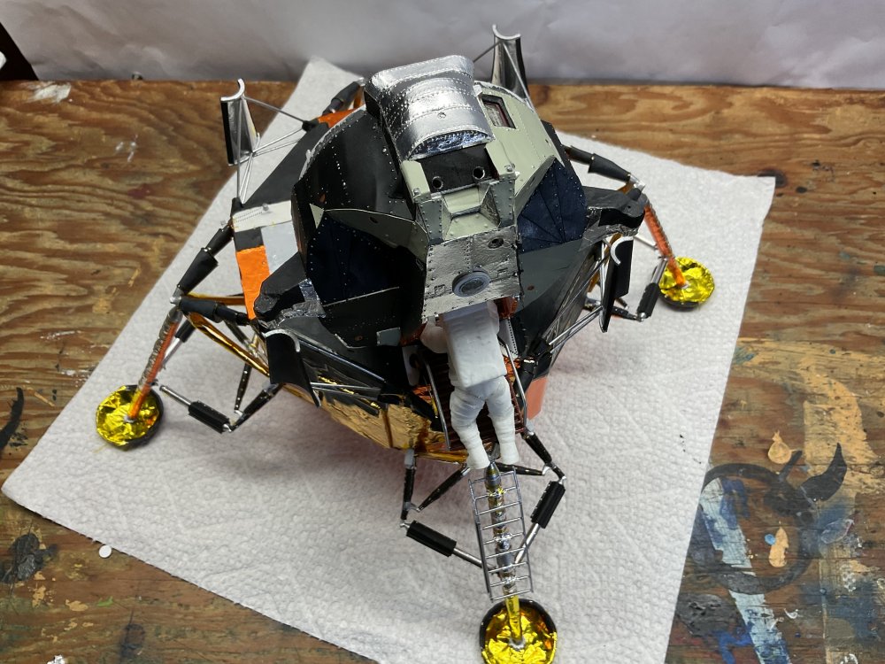

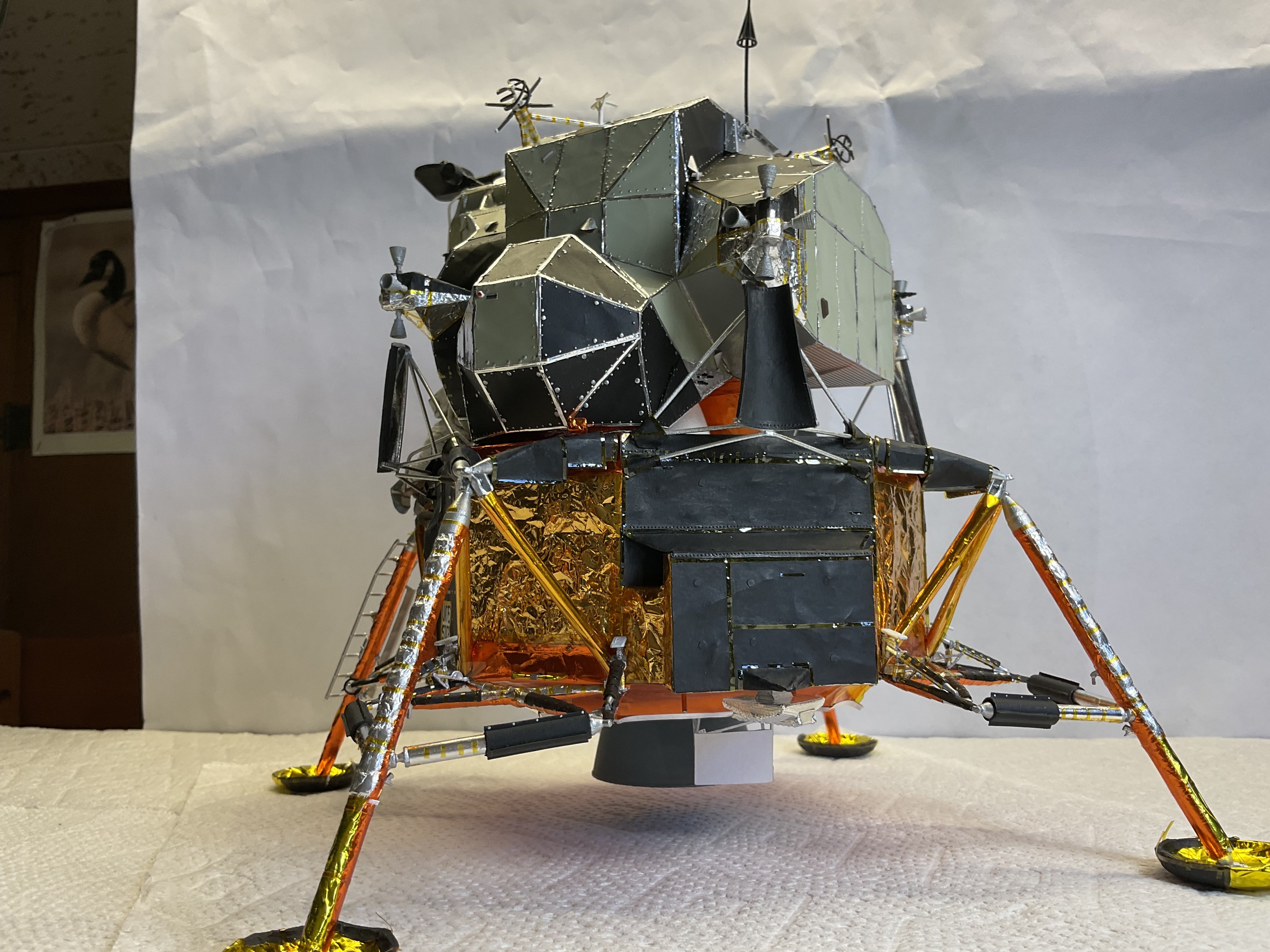

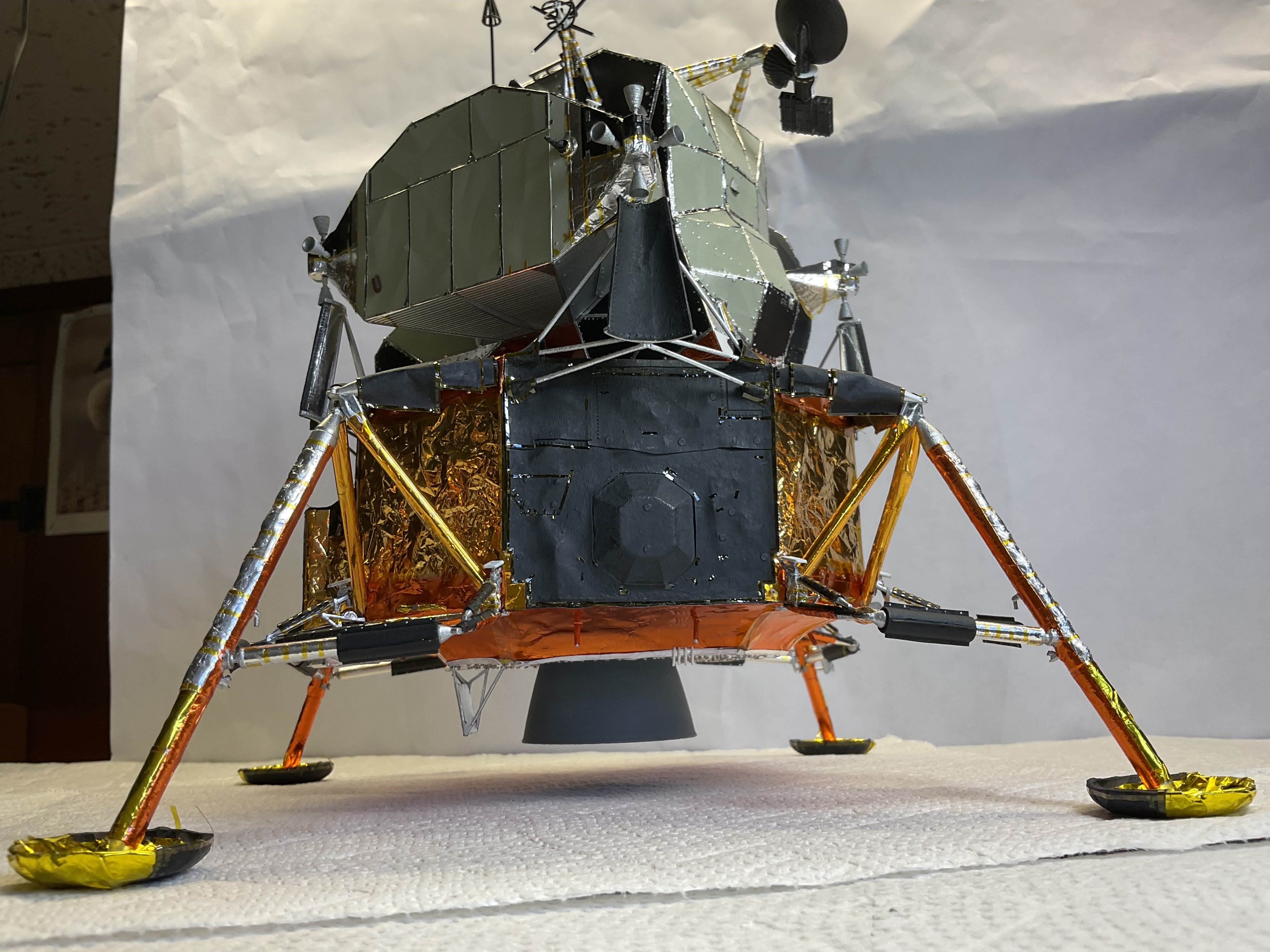

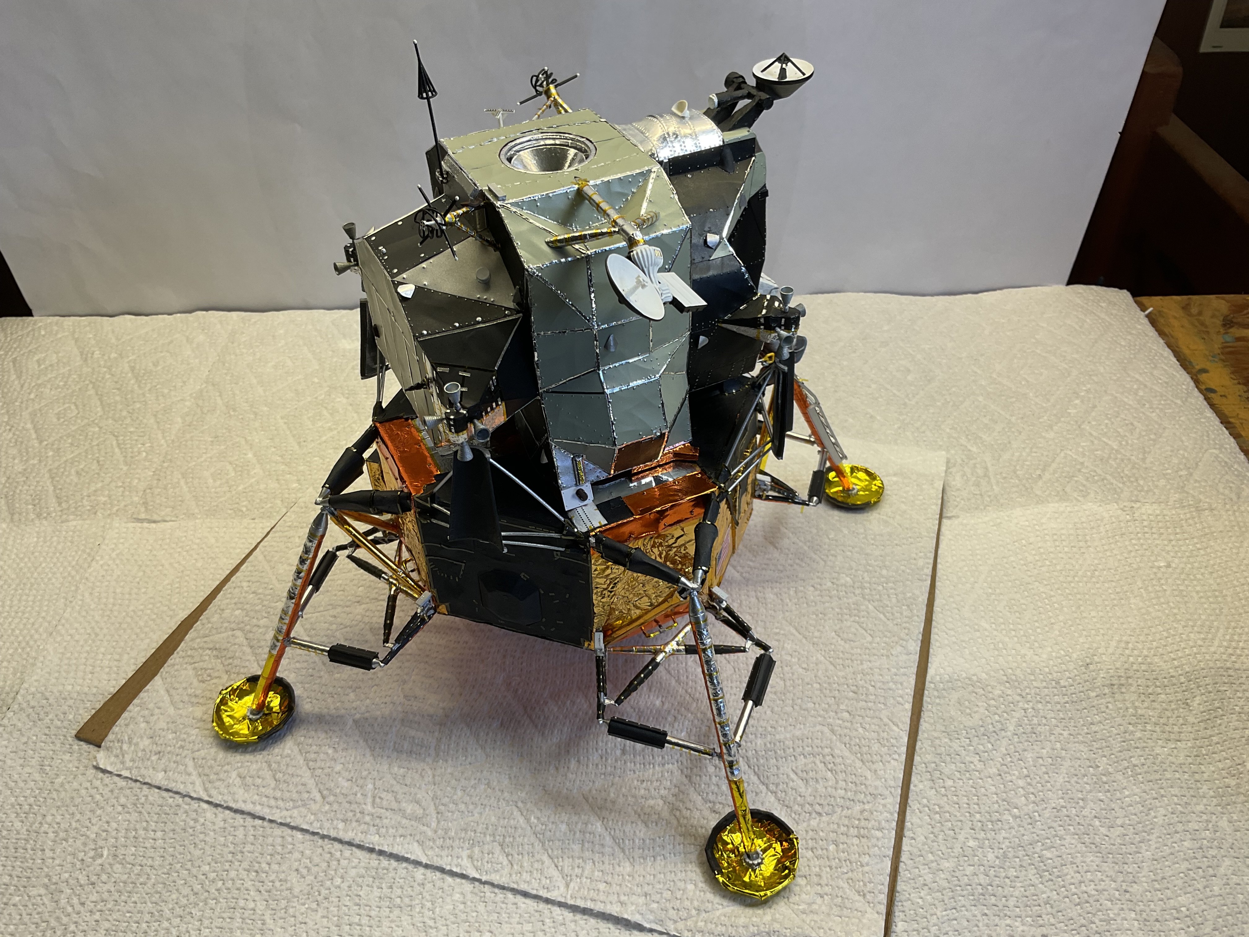

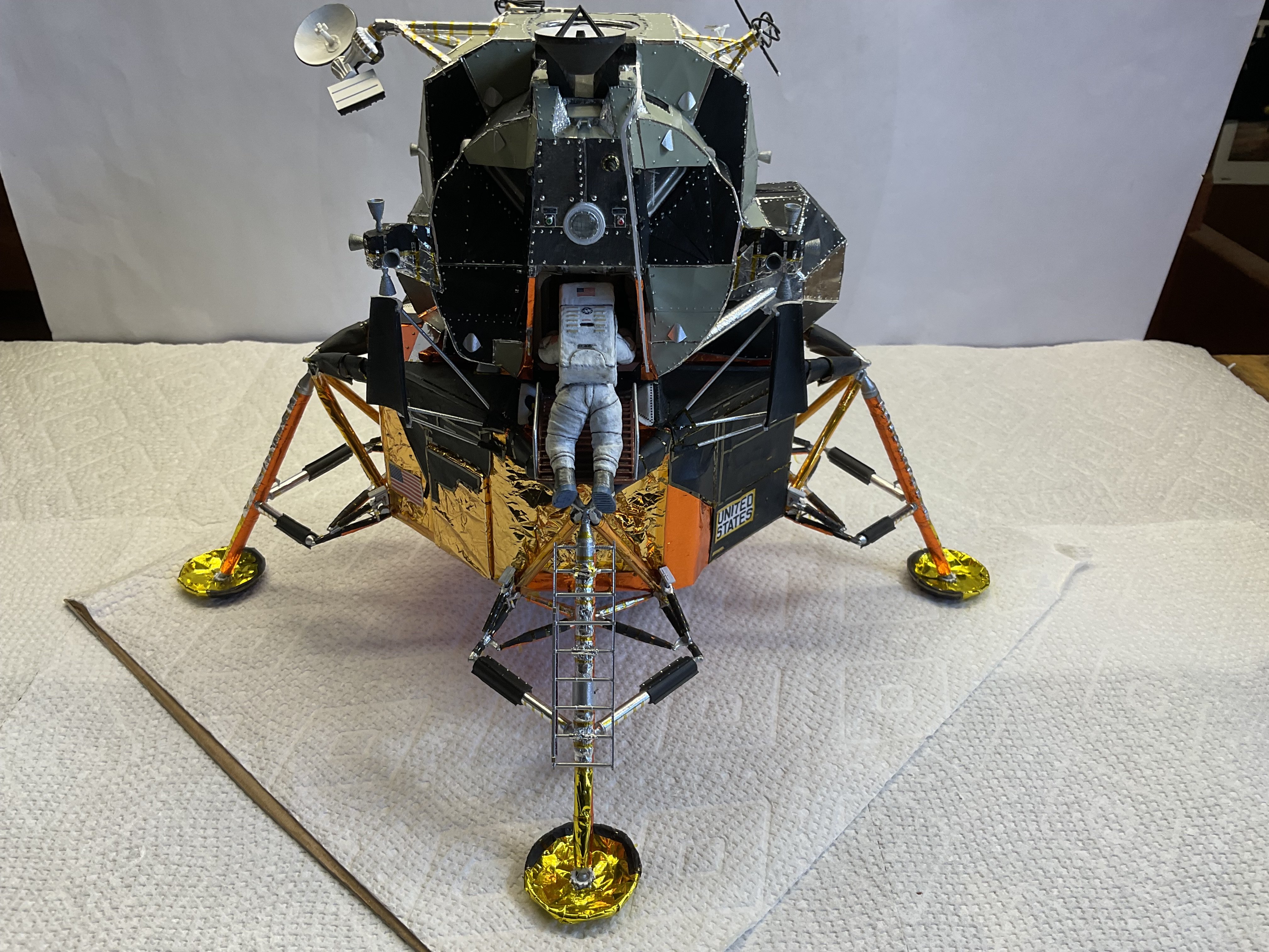

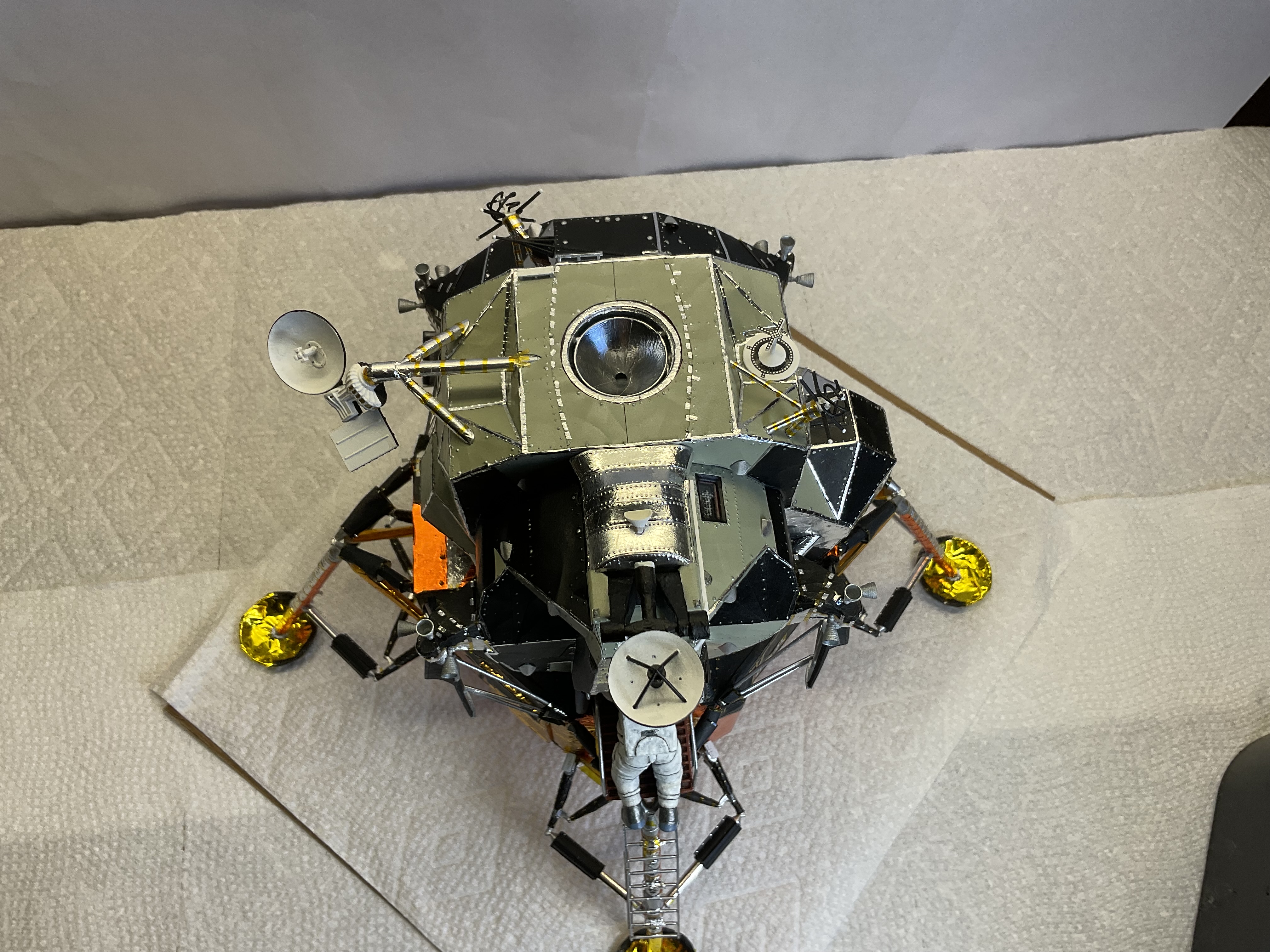

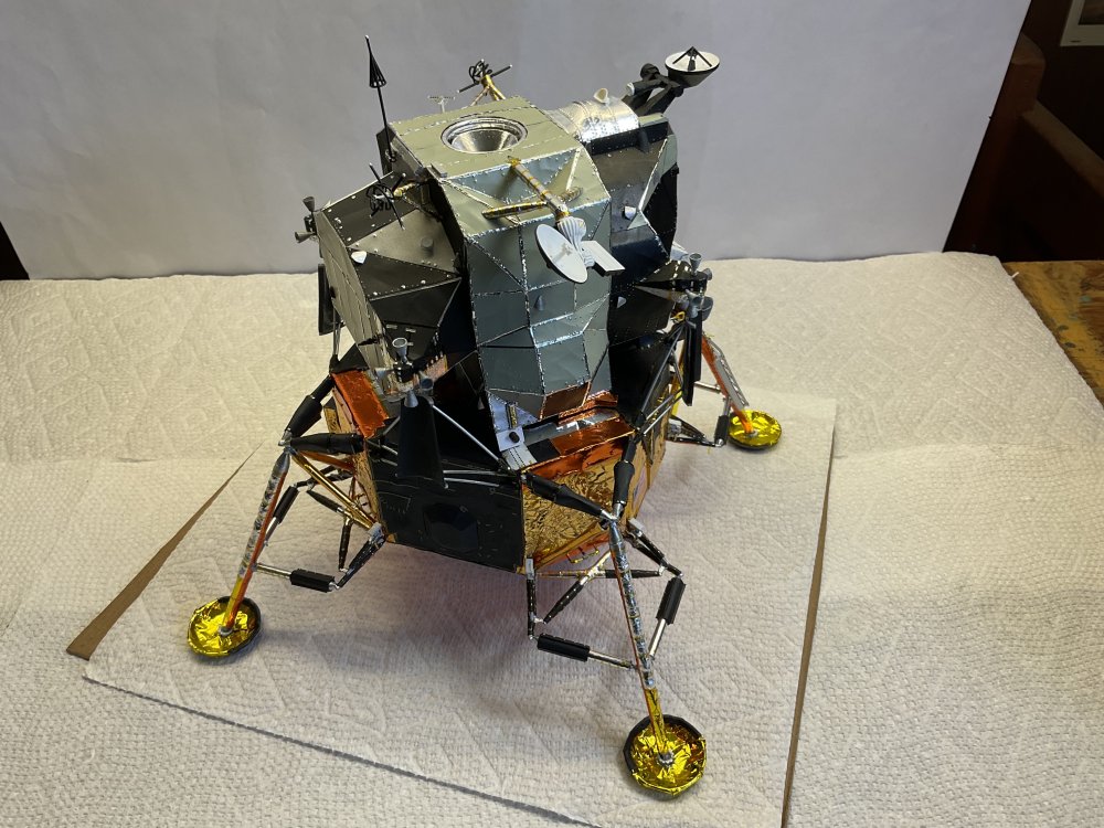

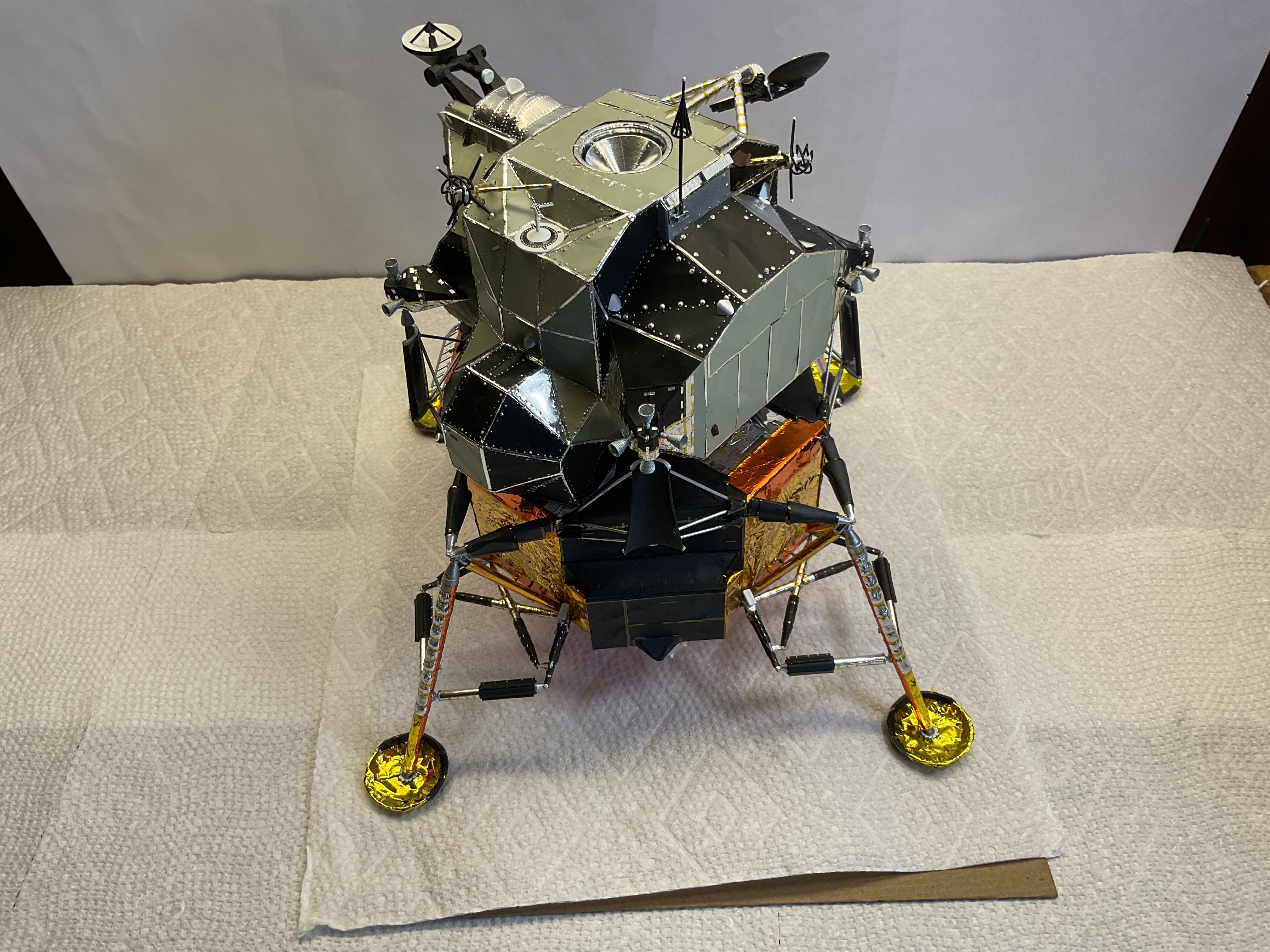

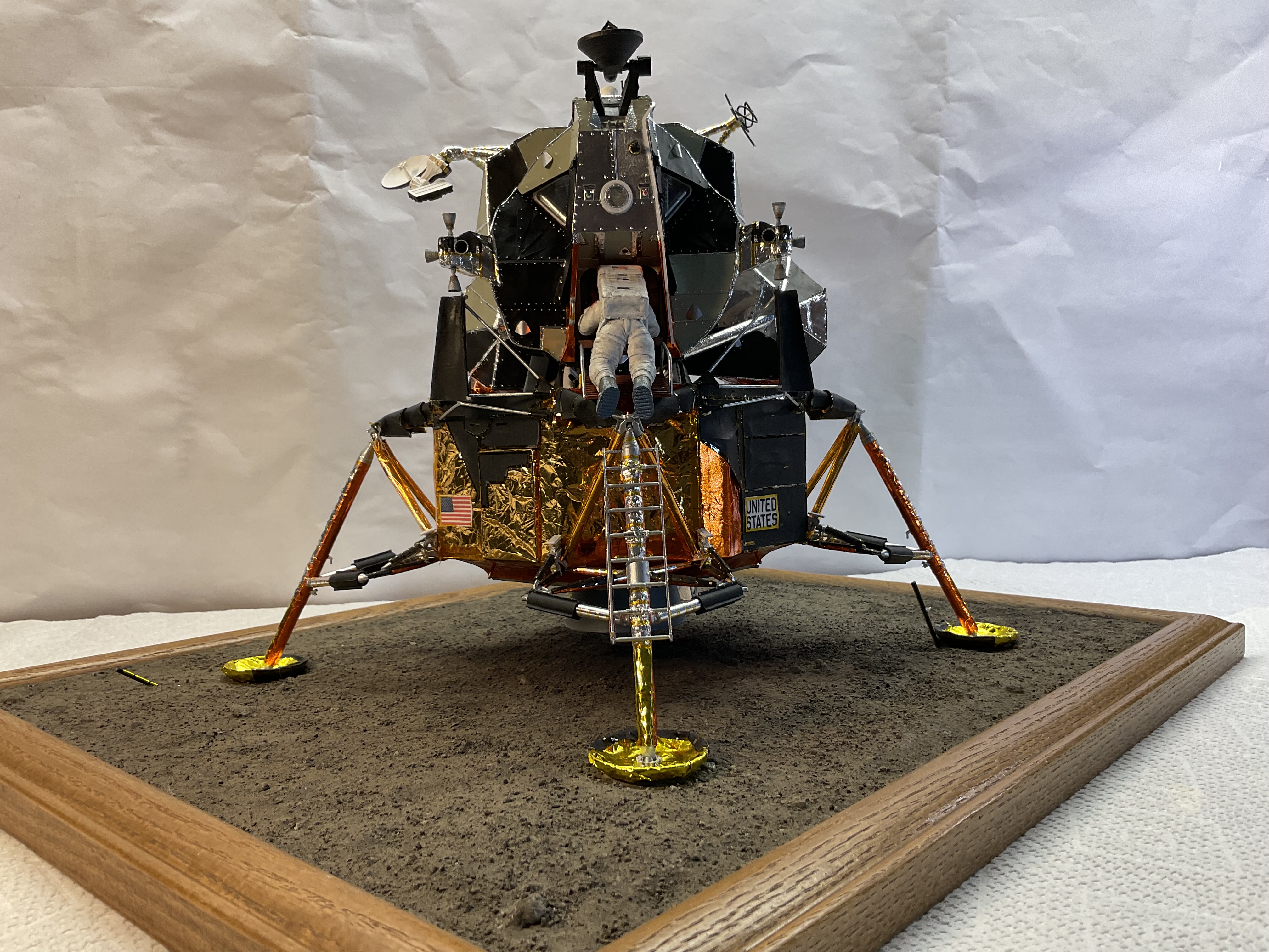

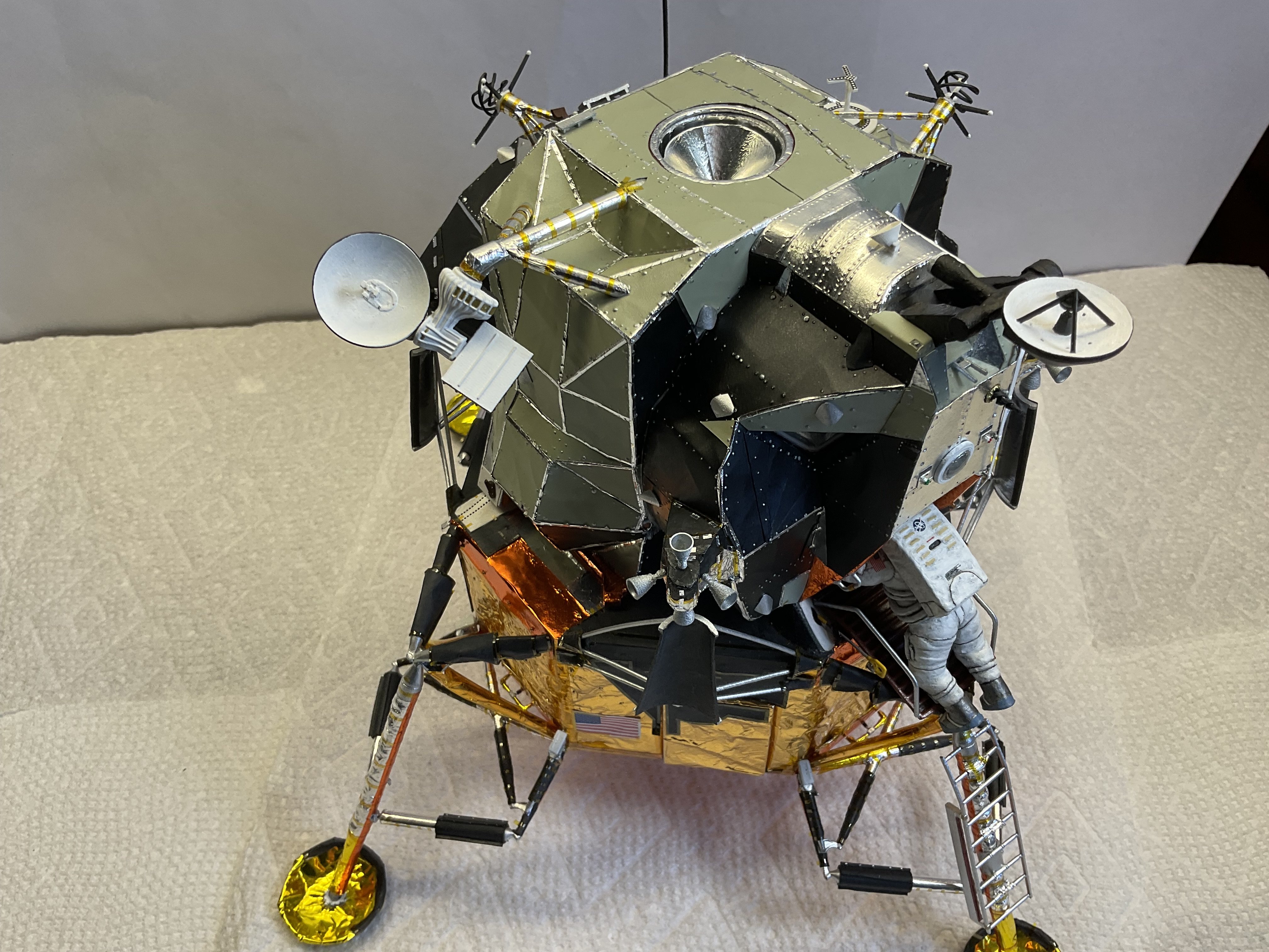

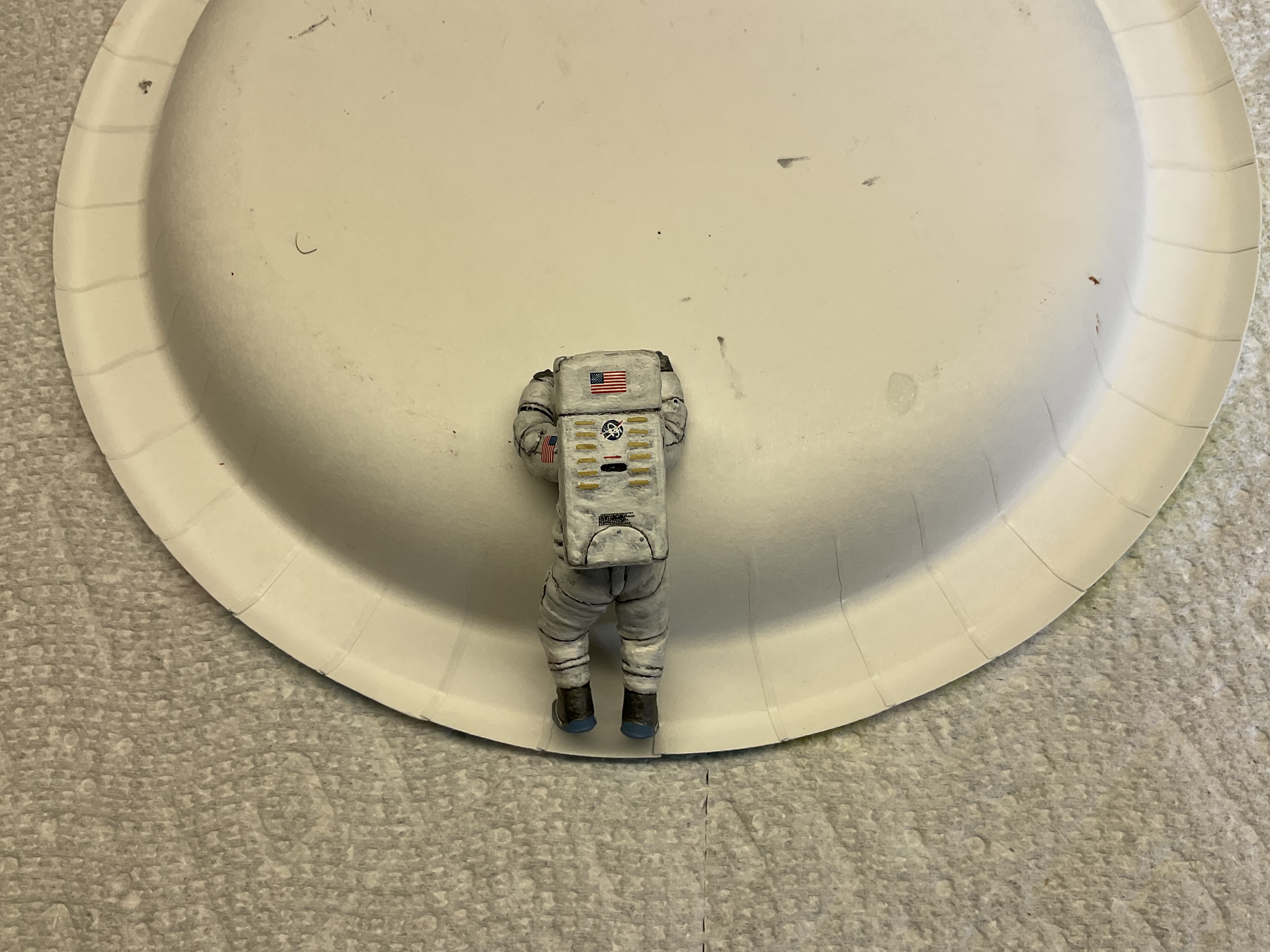

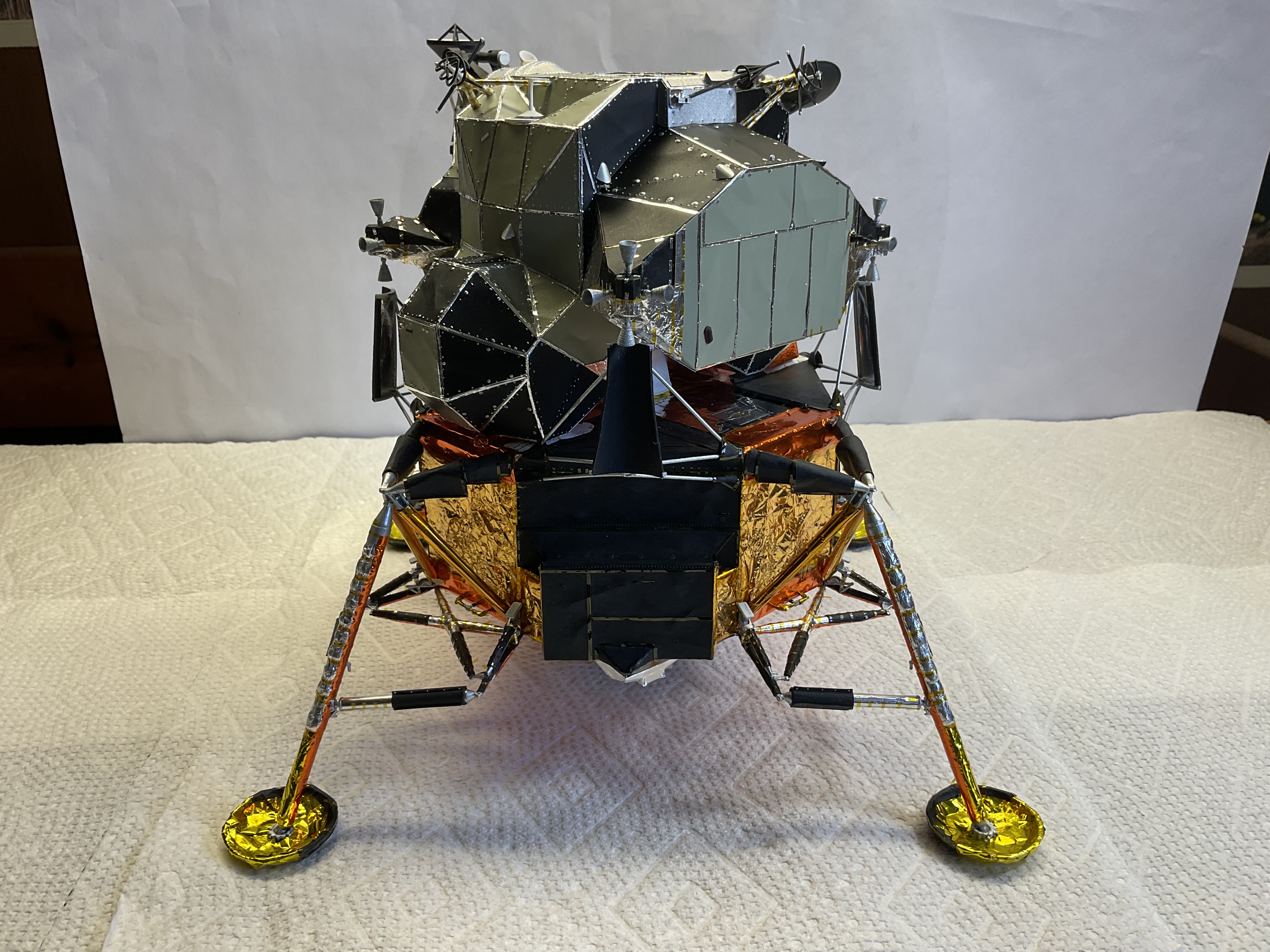

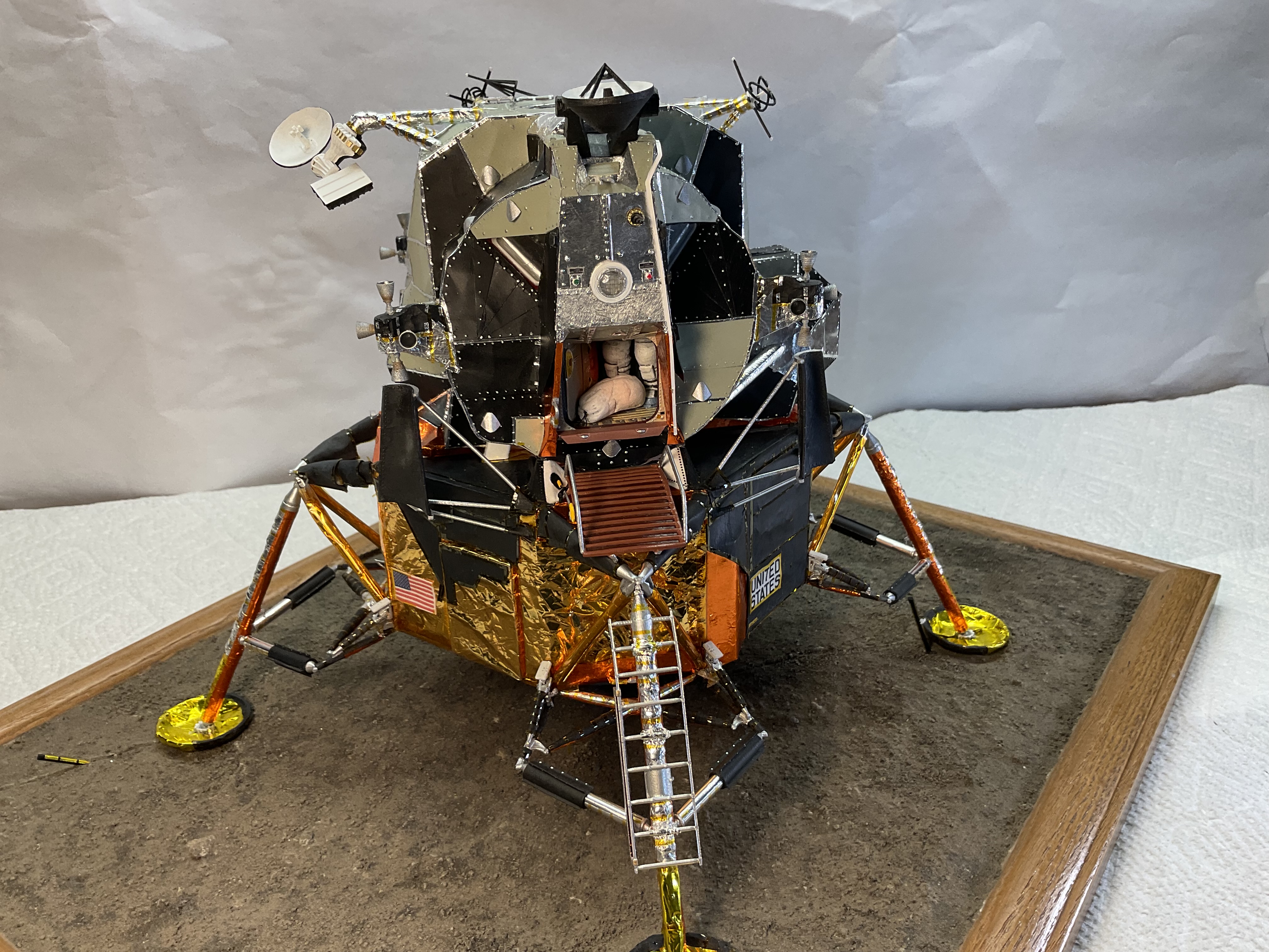

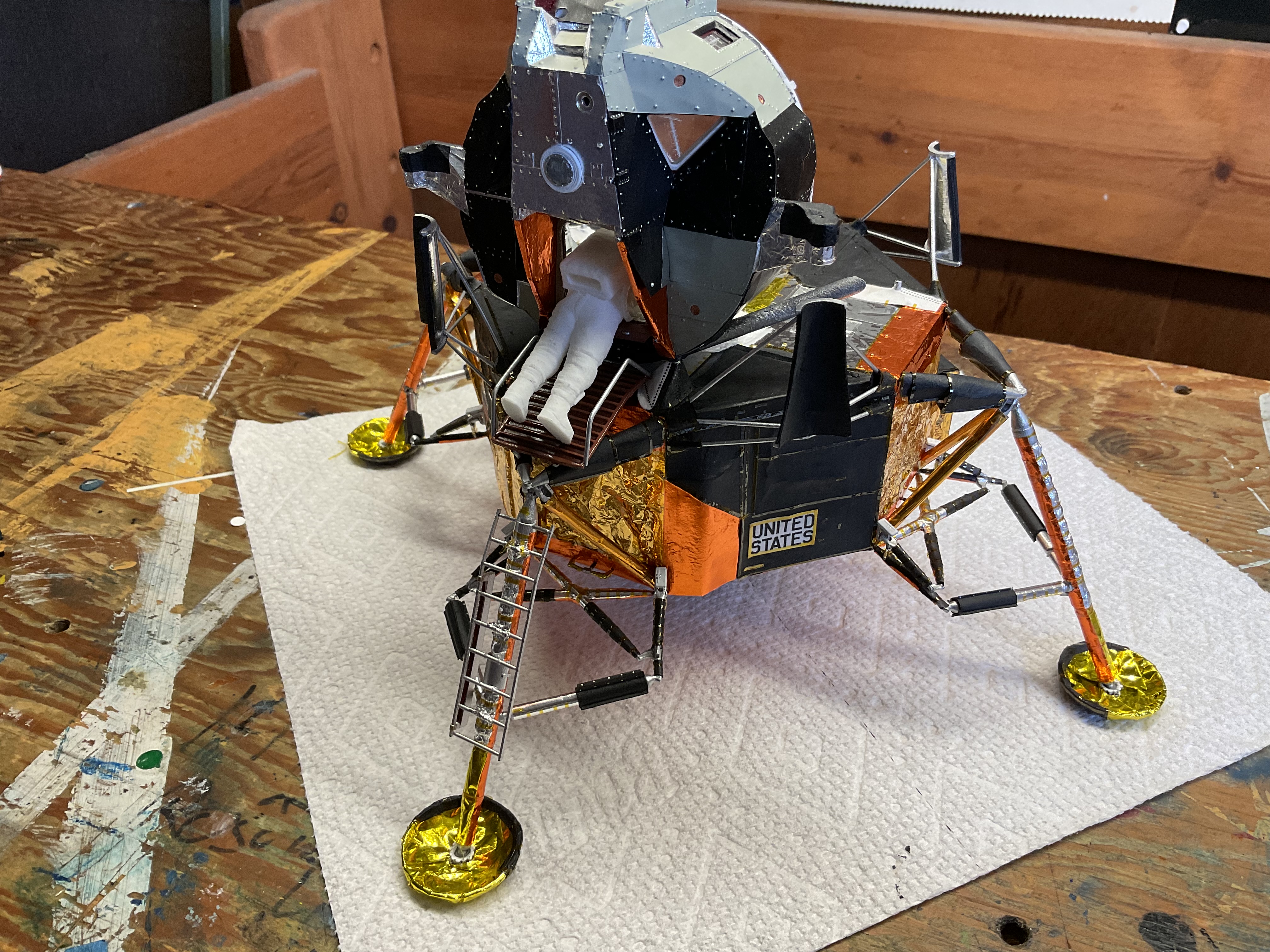

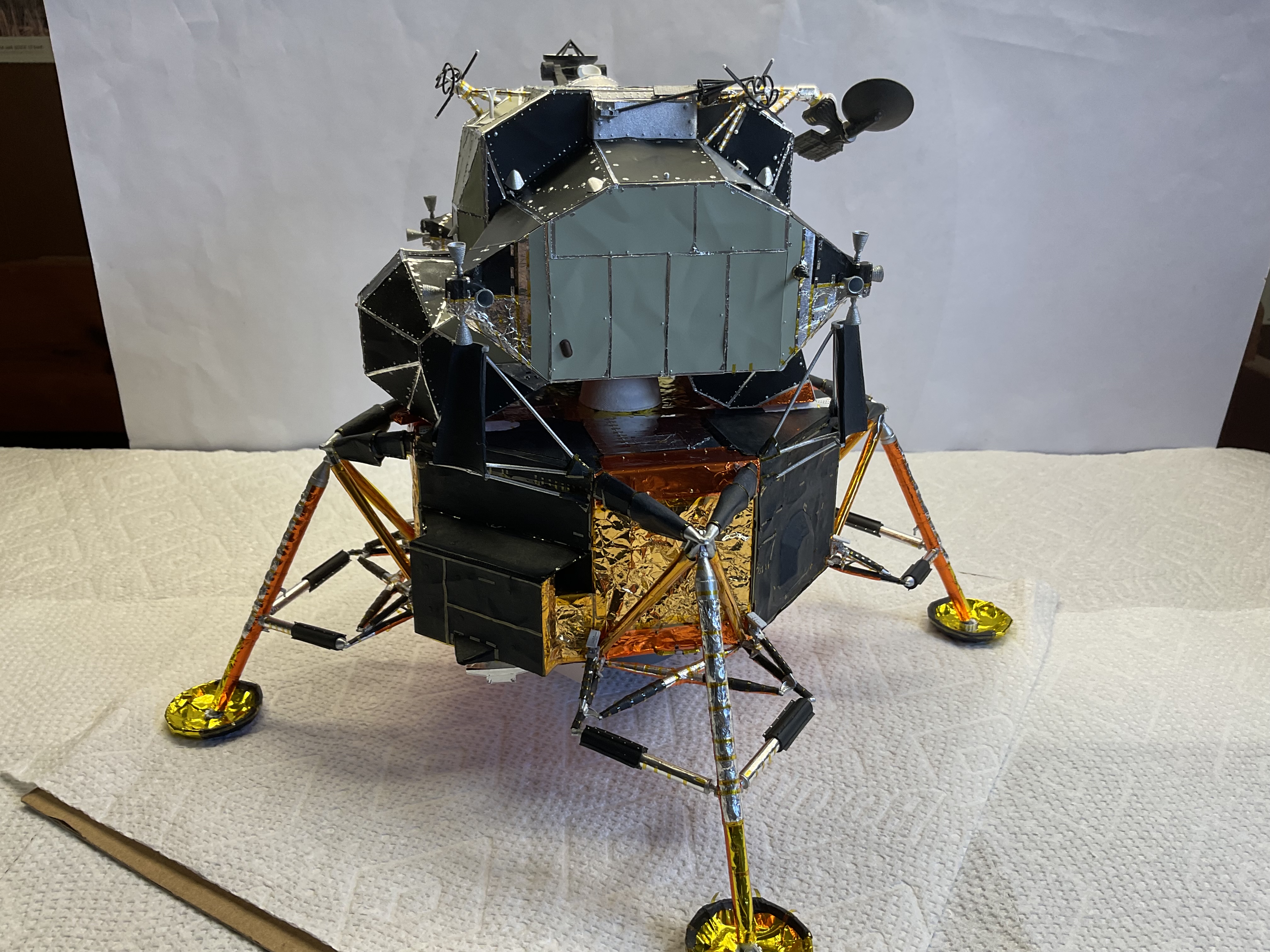

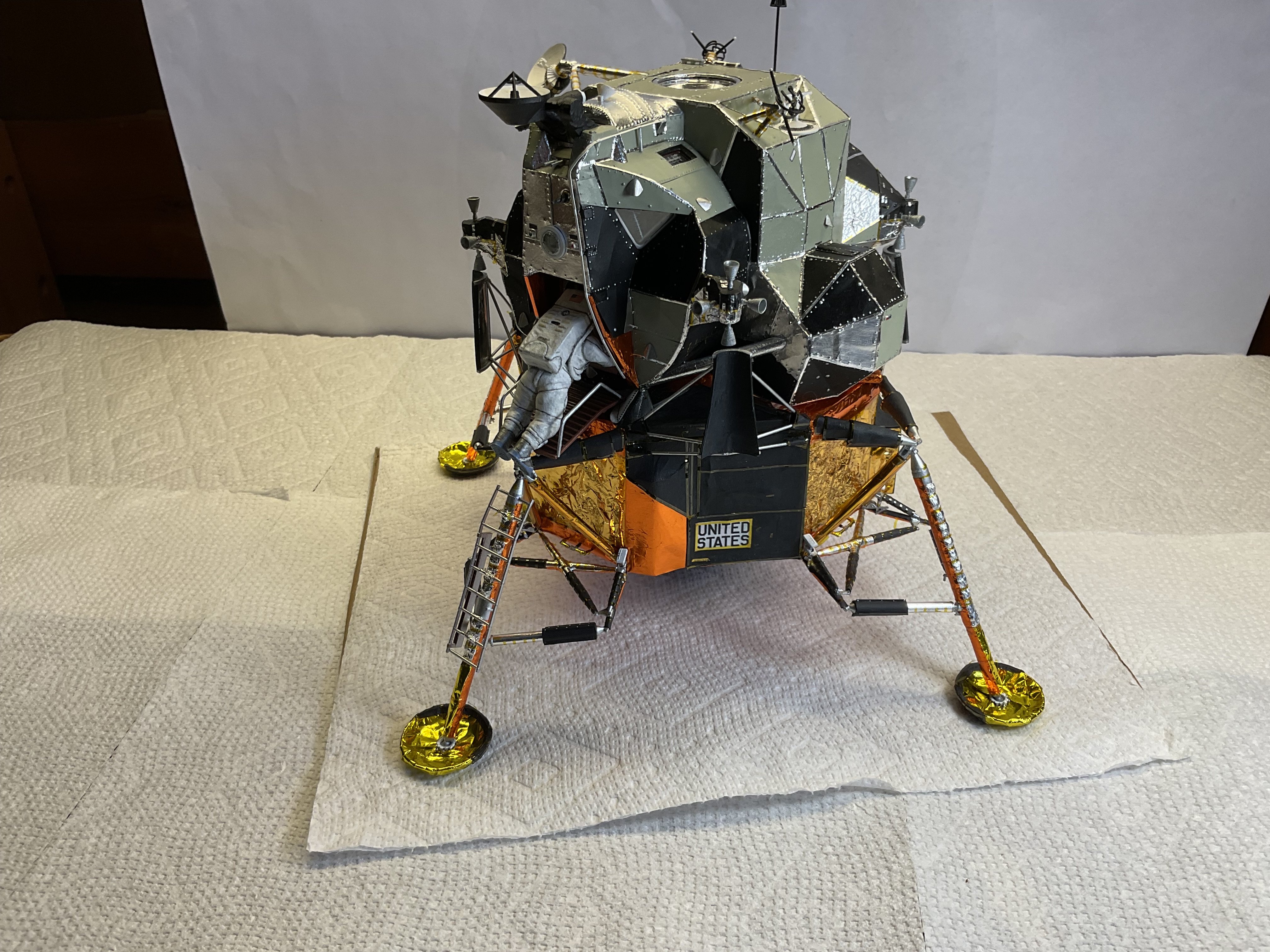

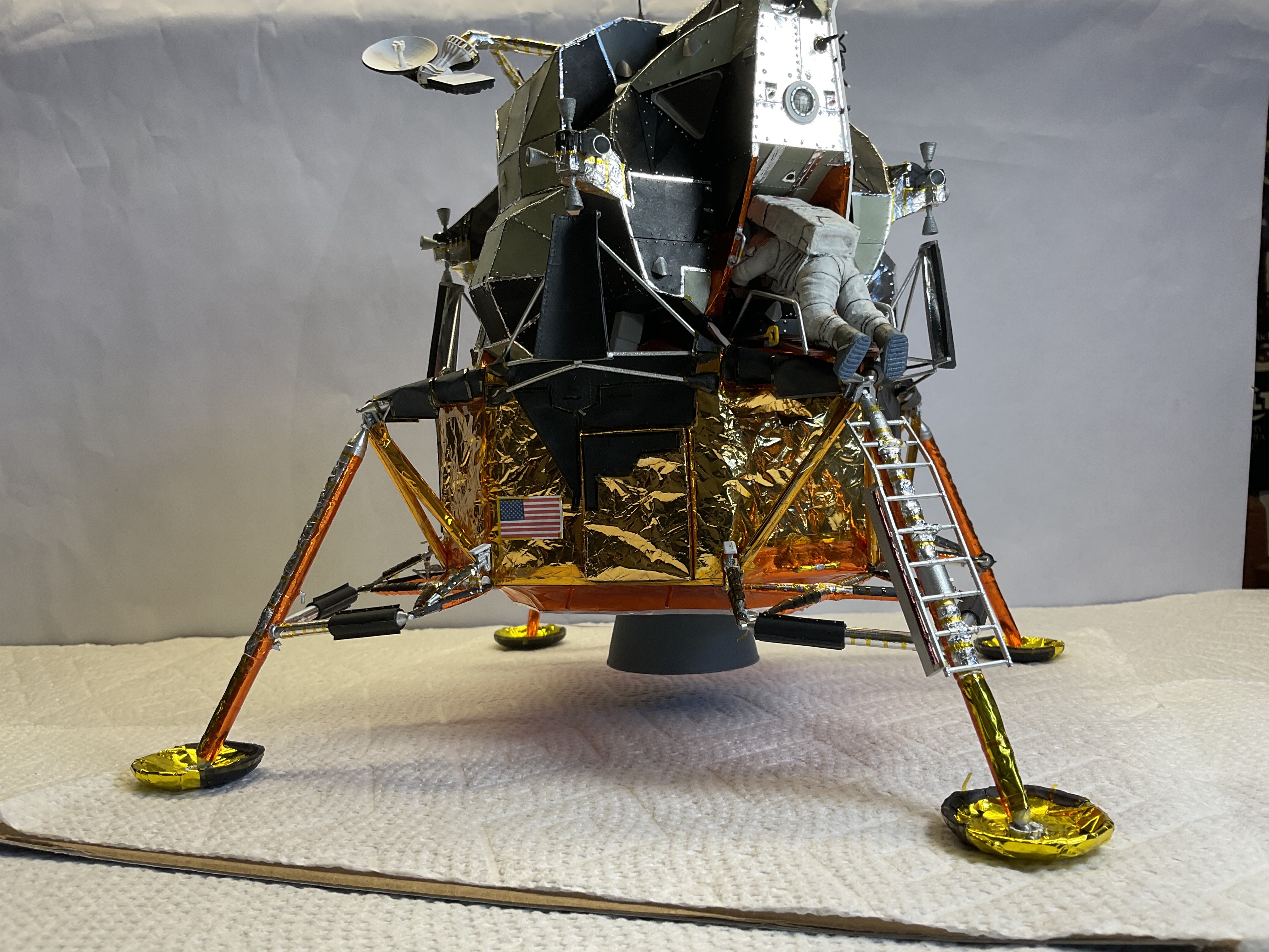

snichols Posted August 18, 2023 Author Share Posted August 18, 2023 (edited) I have to apply final highlights to Neil’s suit yet and start the base but the LM itself is completed, happy with the final result and hopefully I won’t find to many issues with it while looking at the pictures. First issue was the the brown colored umbilical and access panel connector which are now lightened . I also noticed an error with the S band and VHF antennae booms, the coatings need to be wrinkled so they are now being corrected. Edited November 30, 2023 by snichols Quote Link to post Share on other sites
bubble Posted August 18, 2023 Share Posted August 18, 2023 Top work Steve !!! very high detail work Quote Link to post Share on other sites

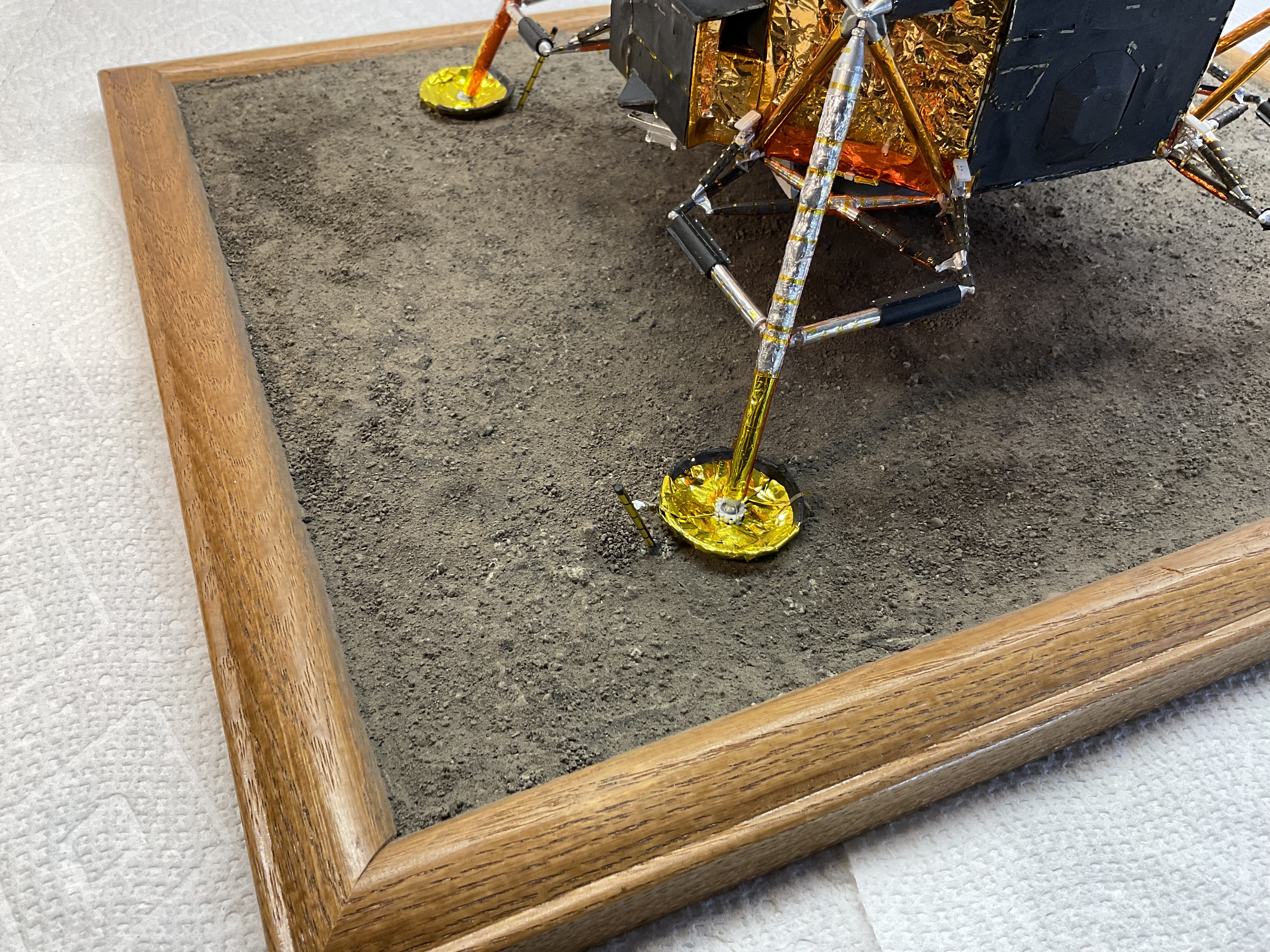

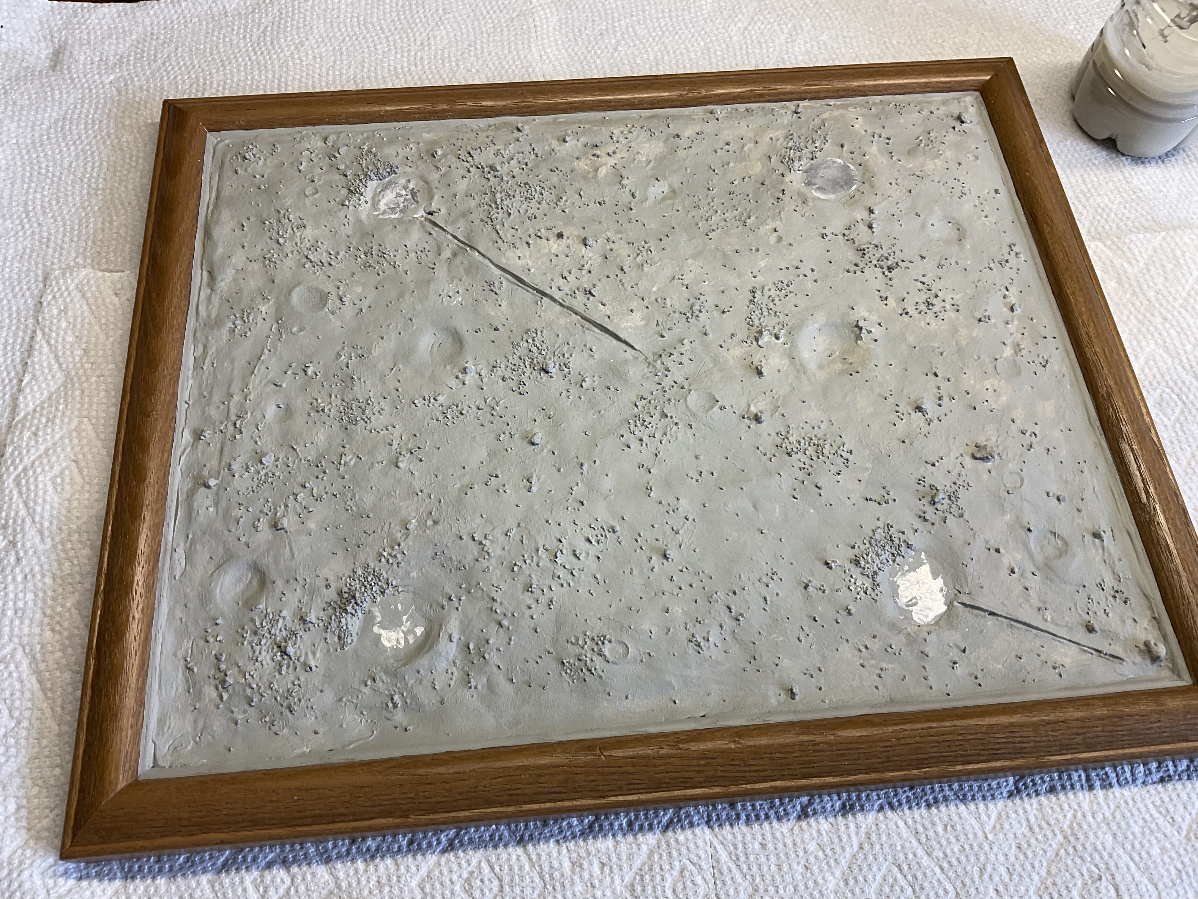

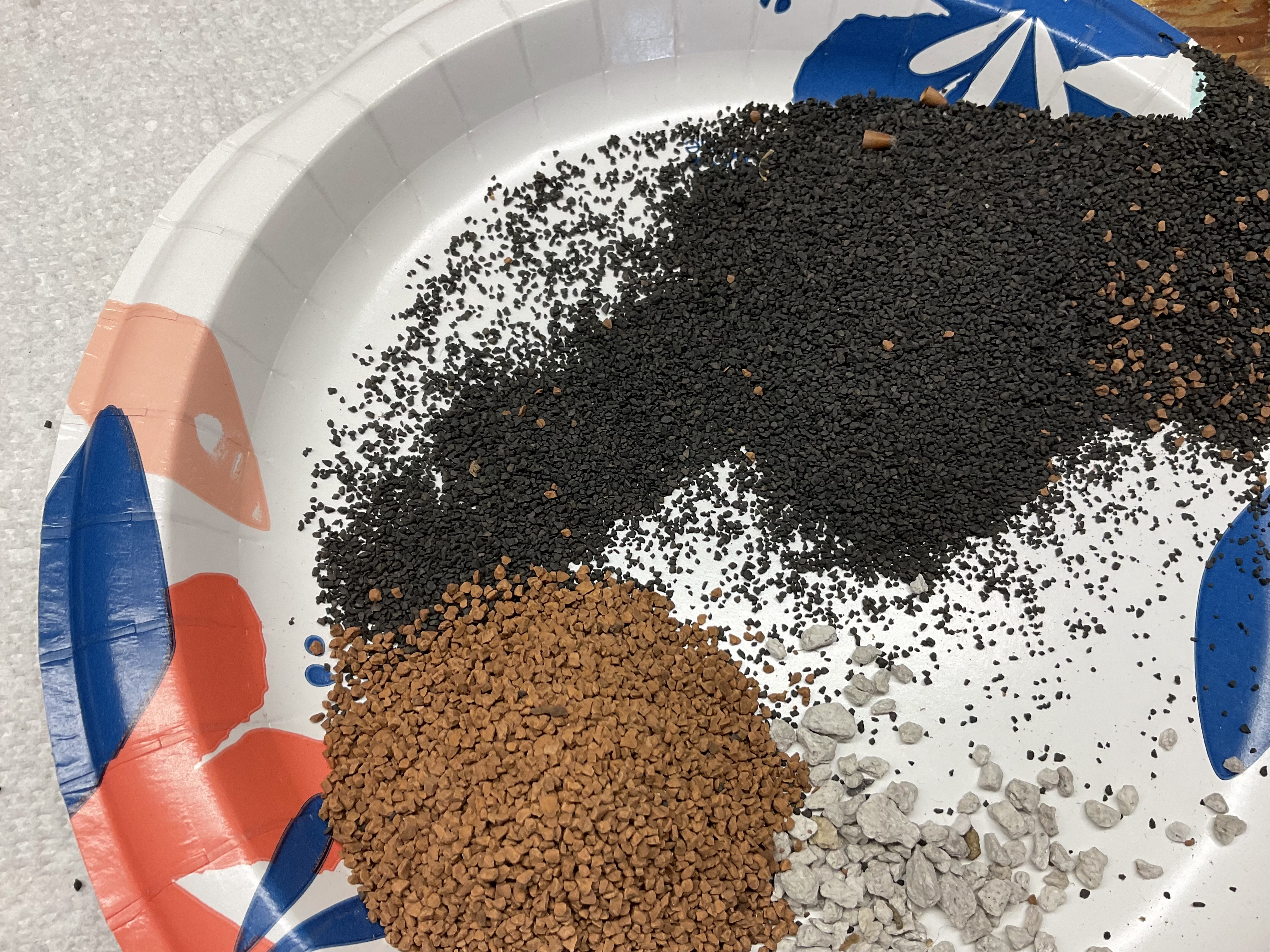

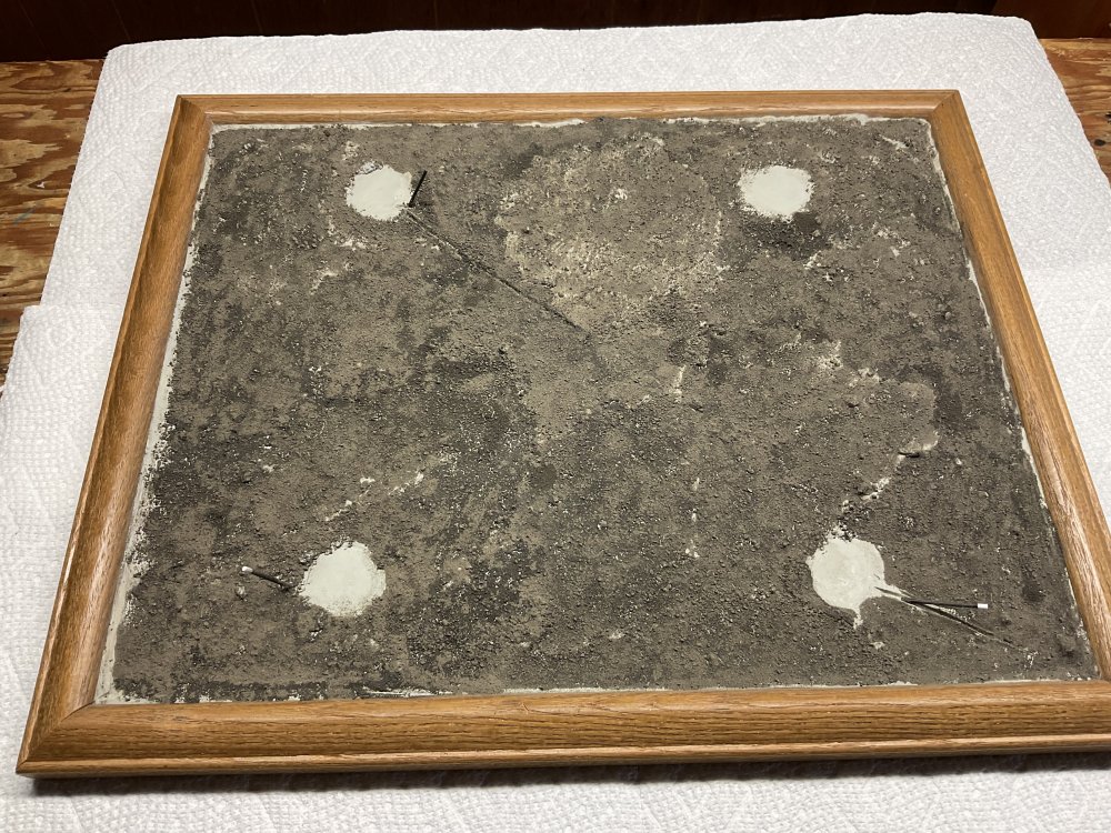

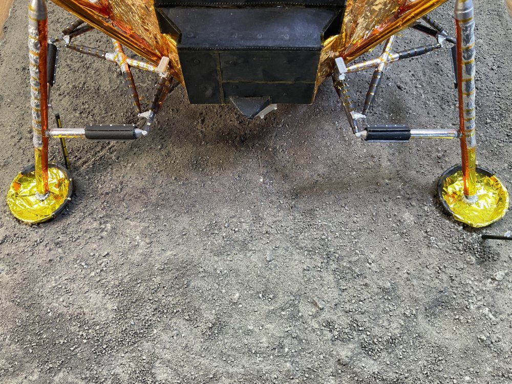

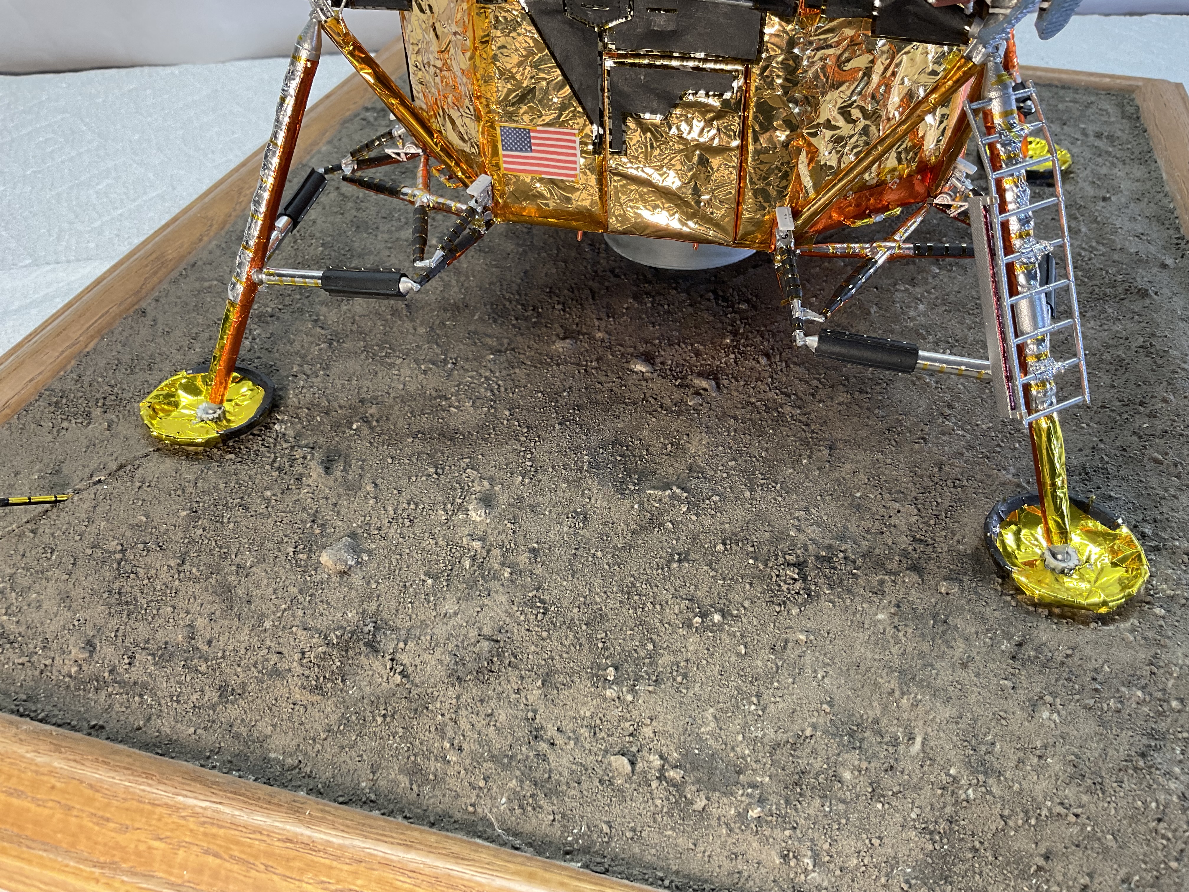

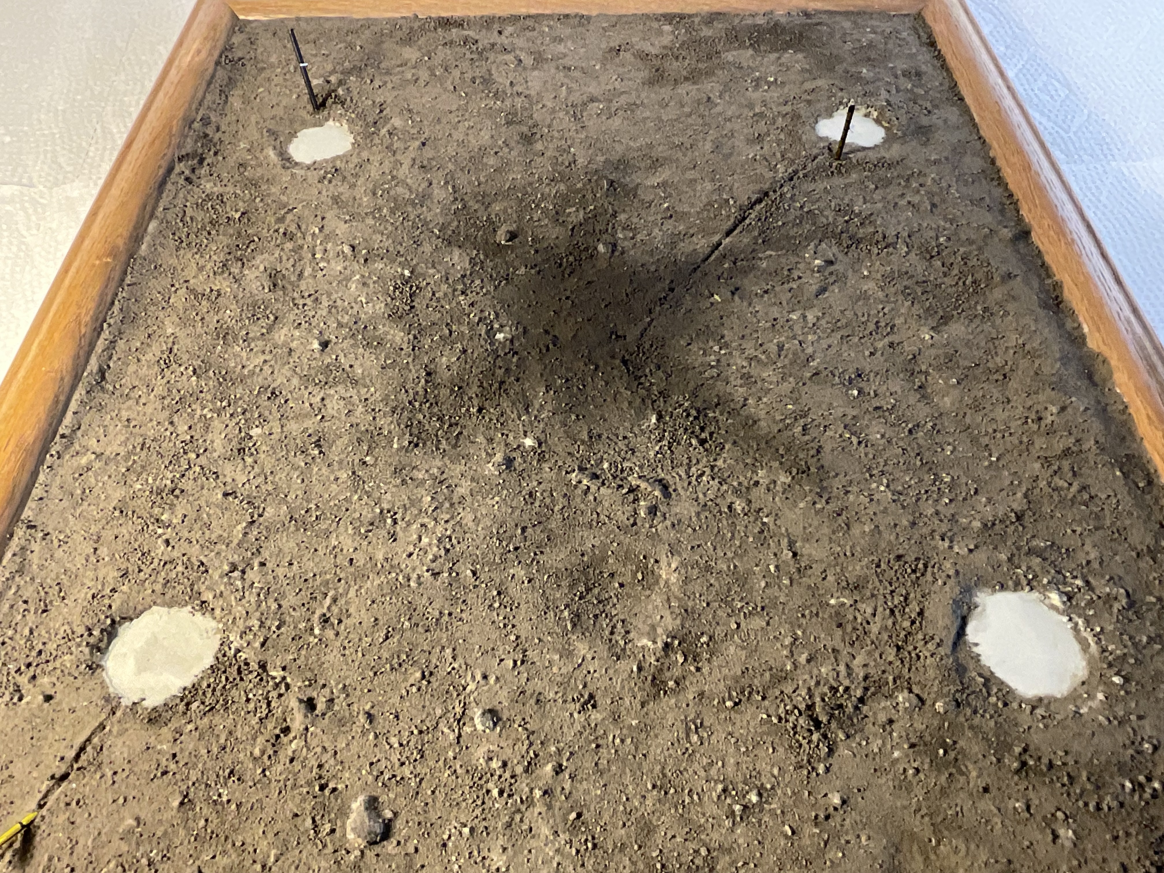

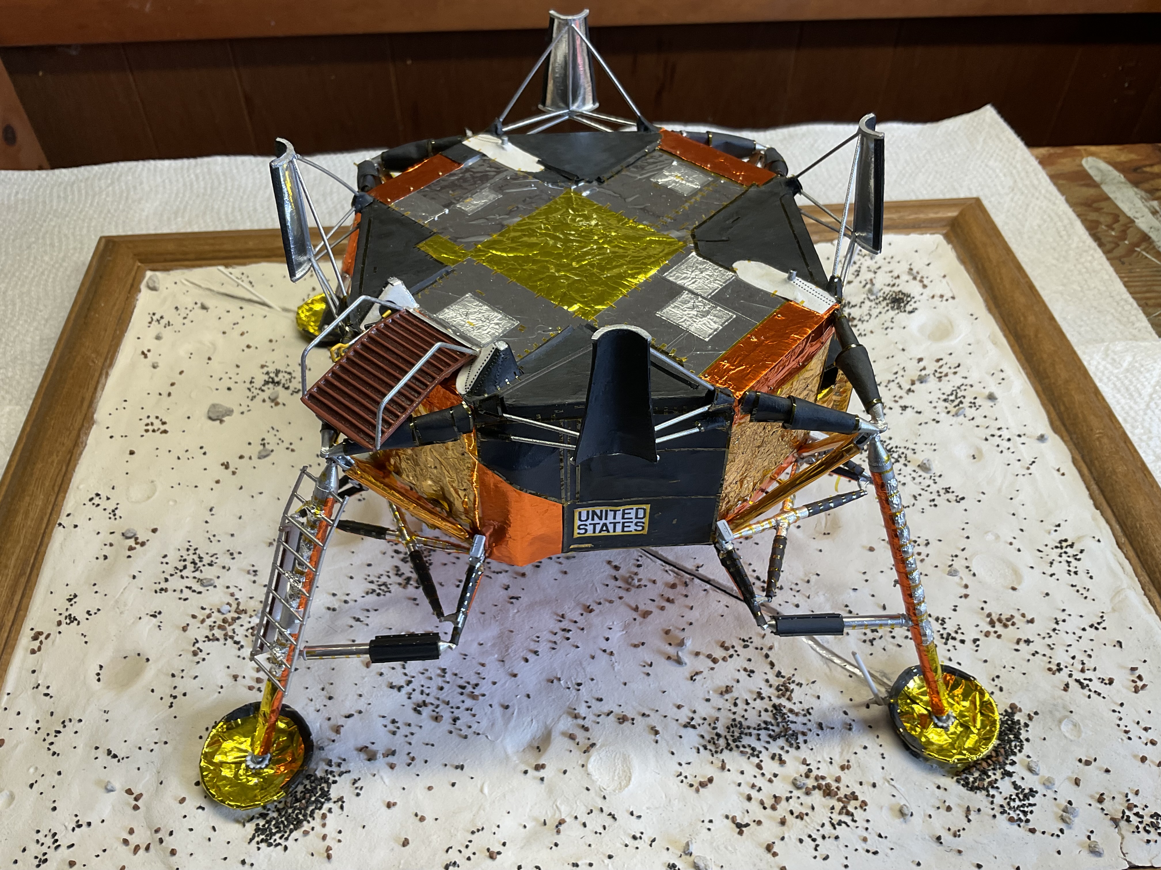

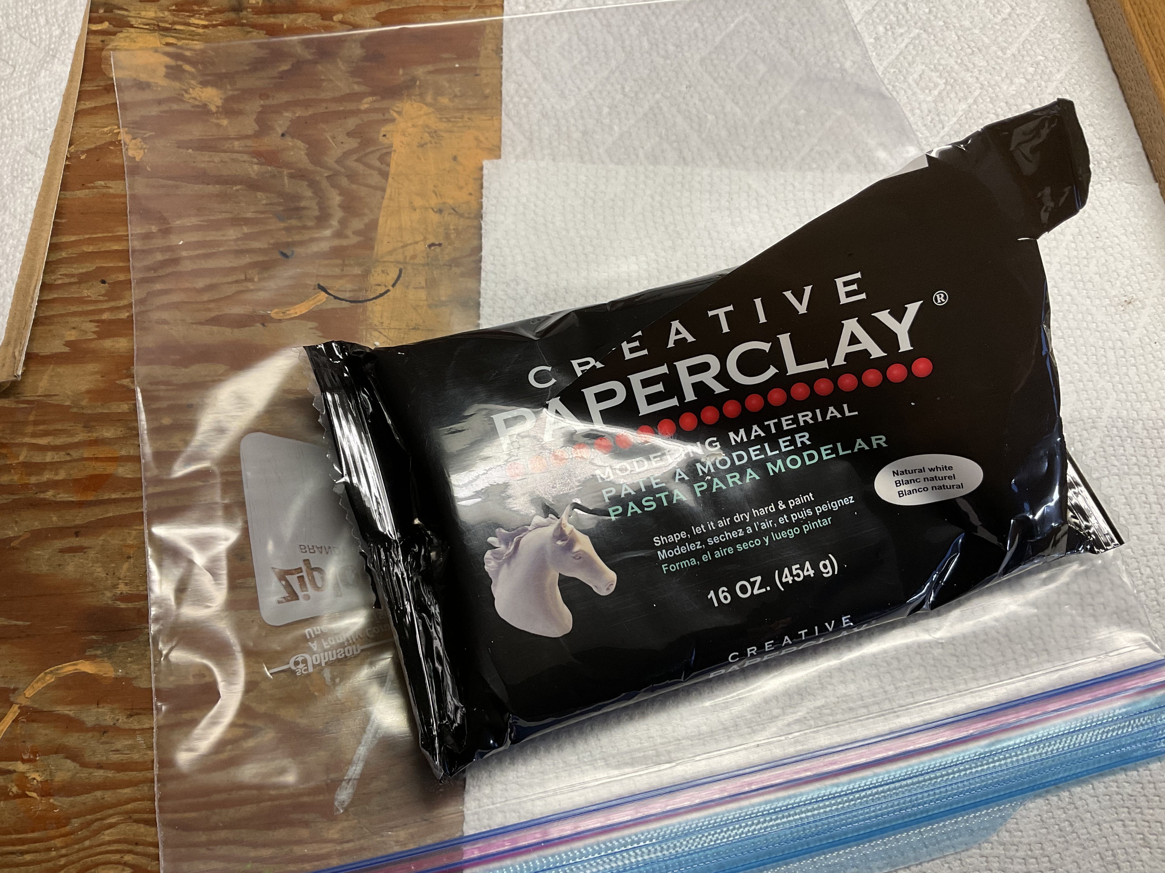

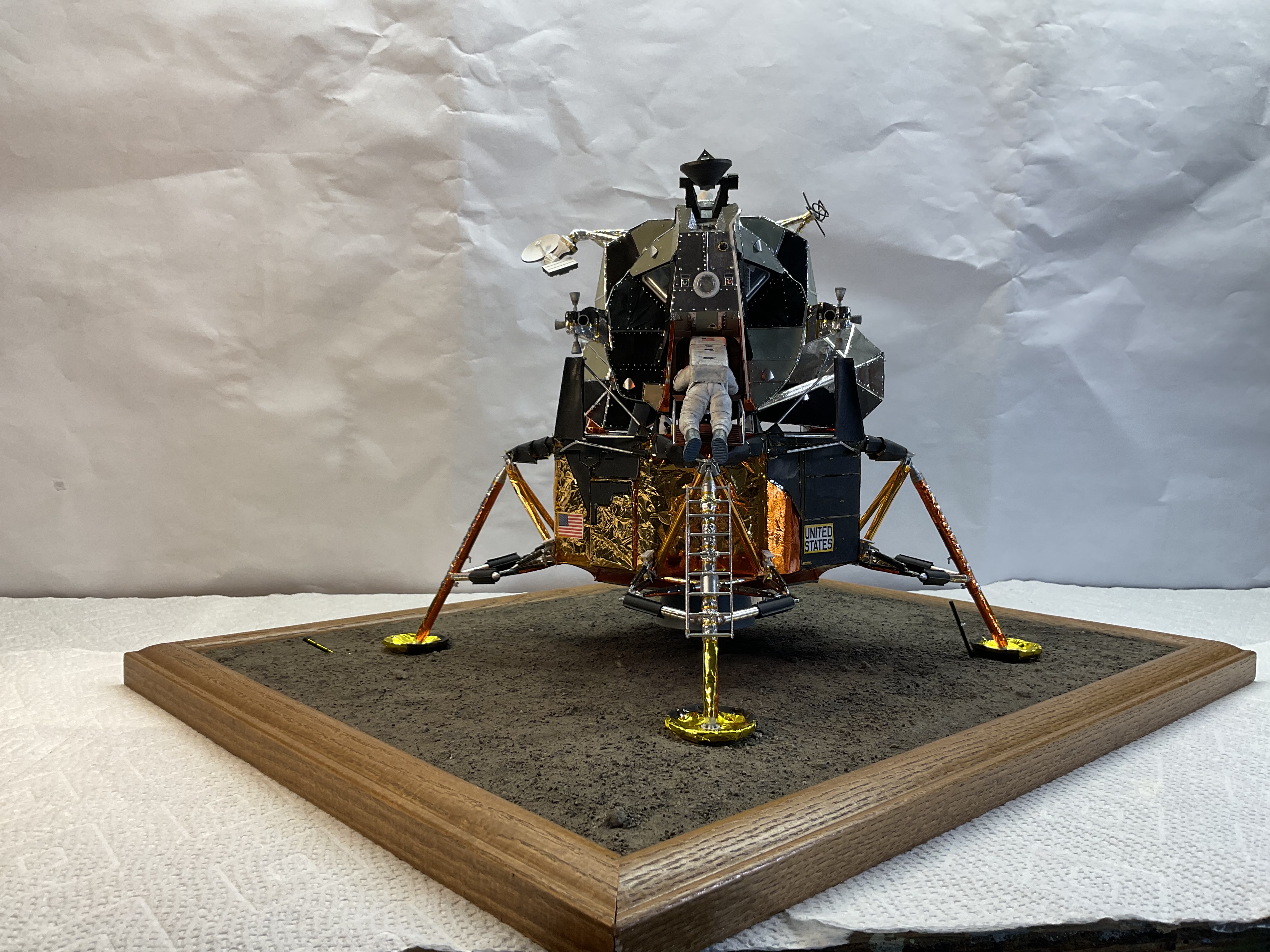

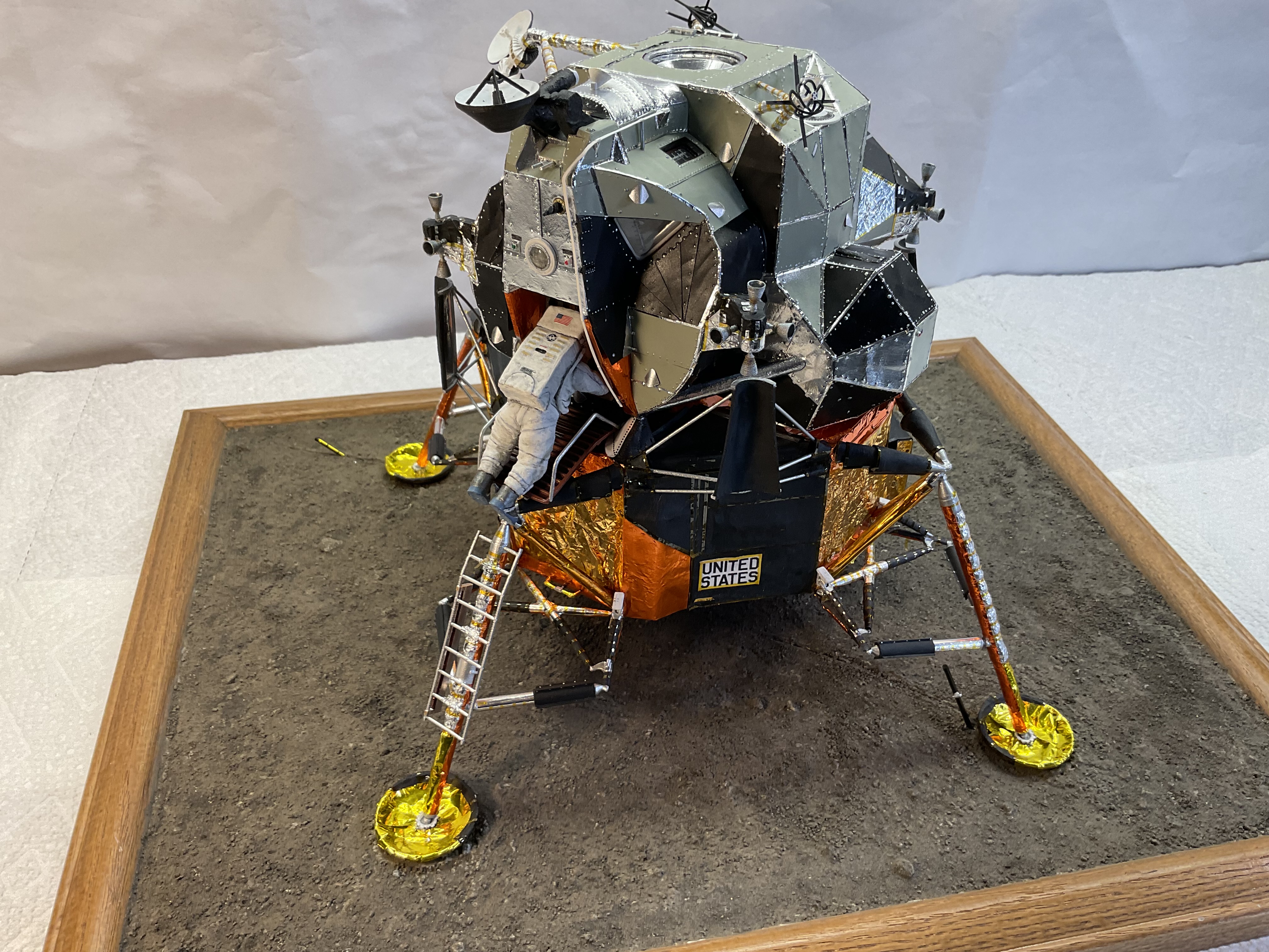

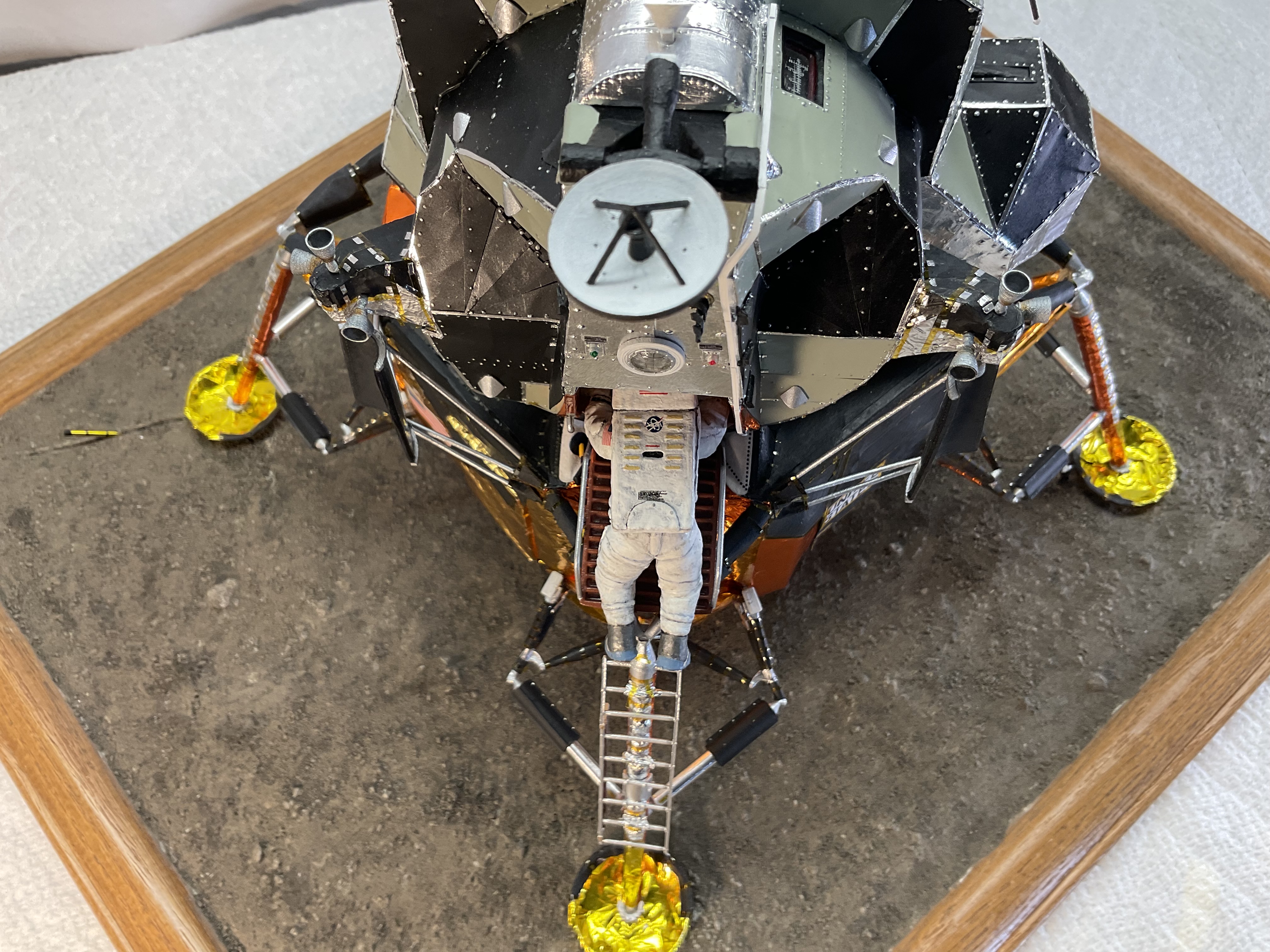

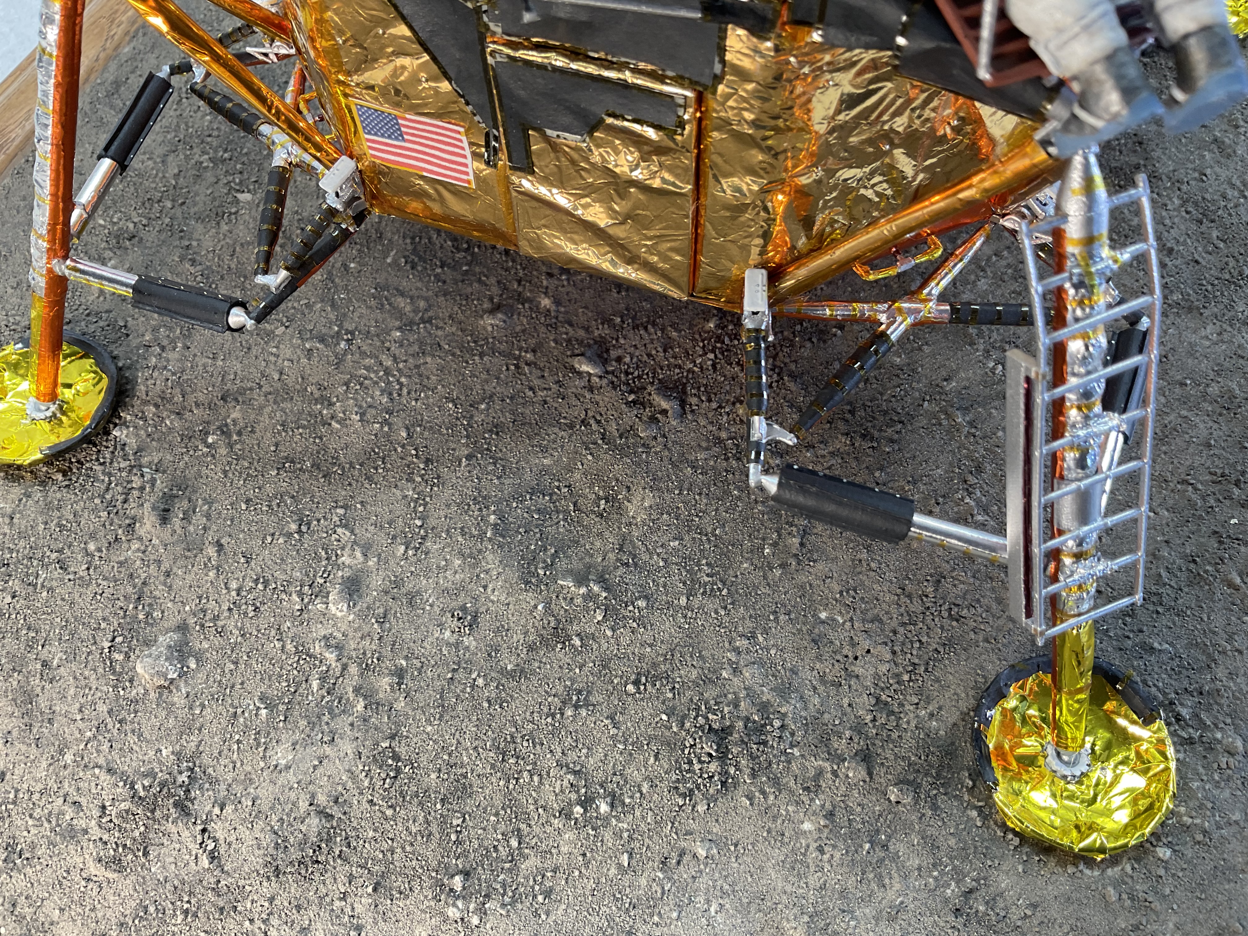

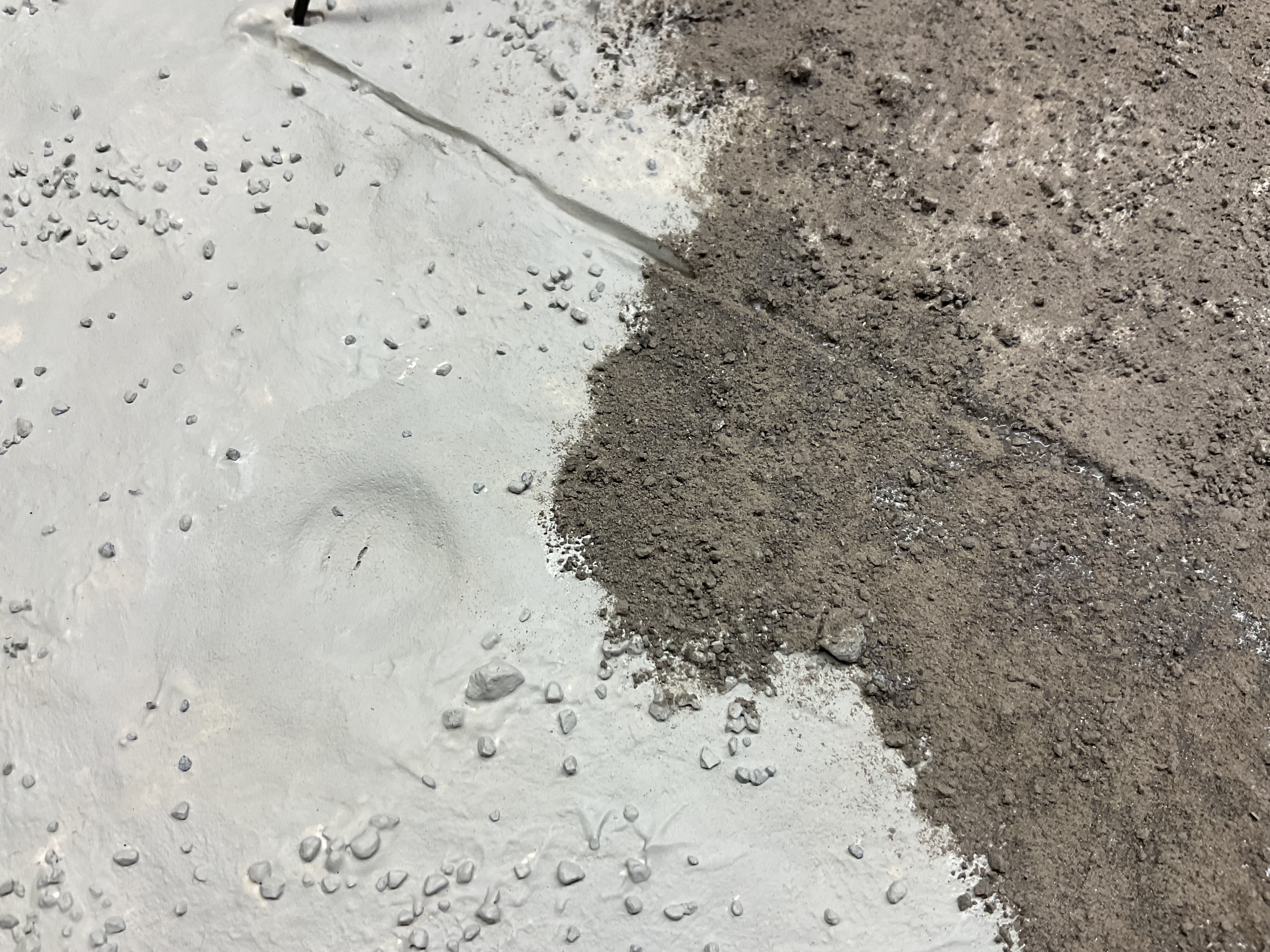

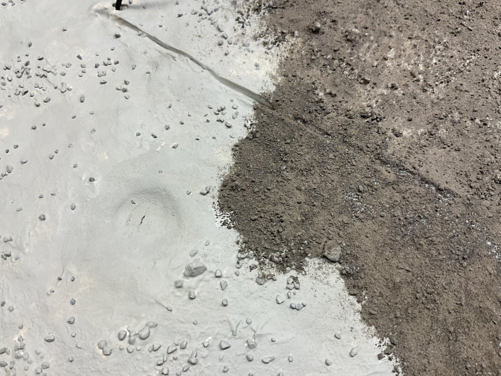

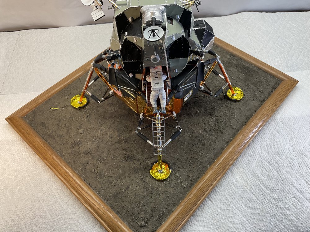

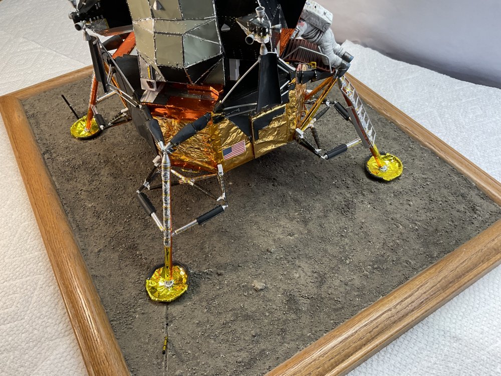

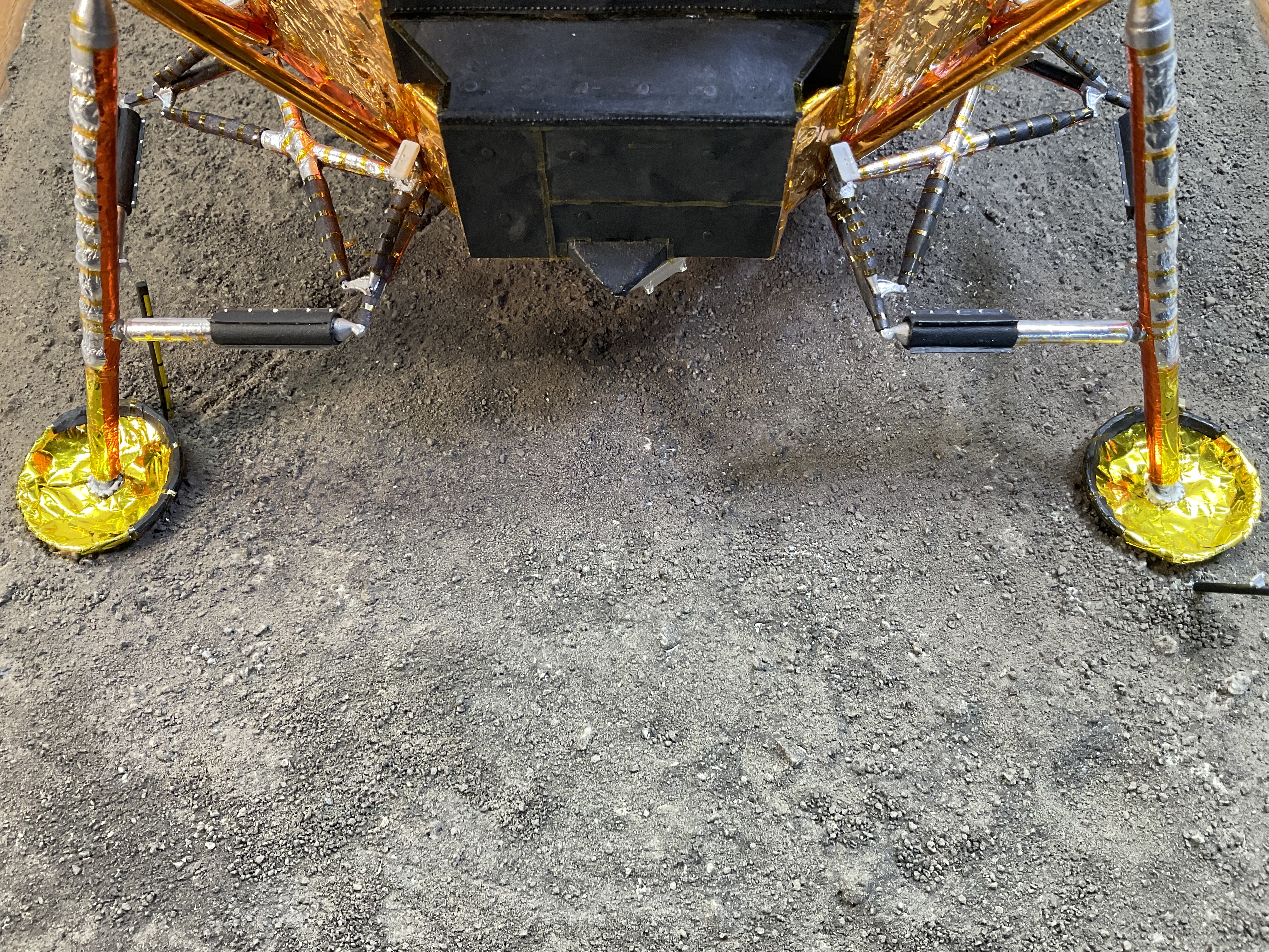

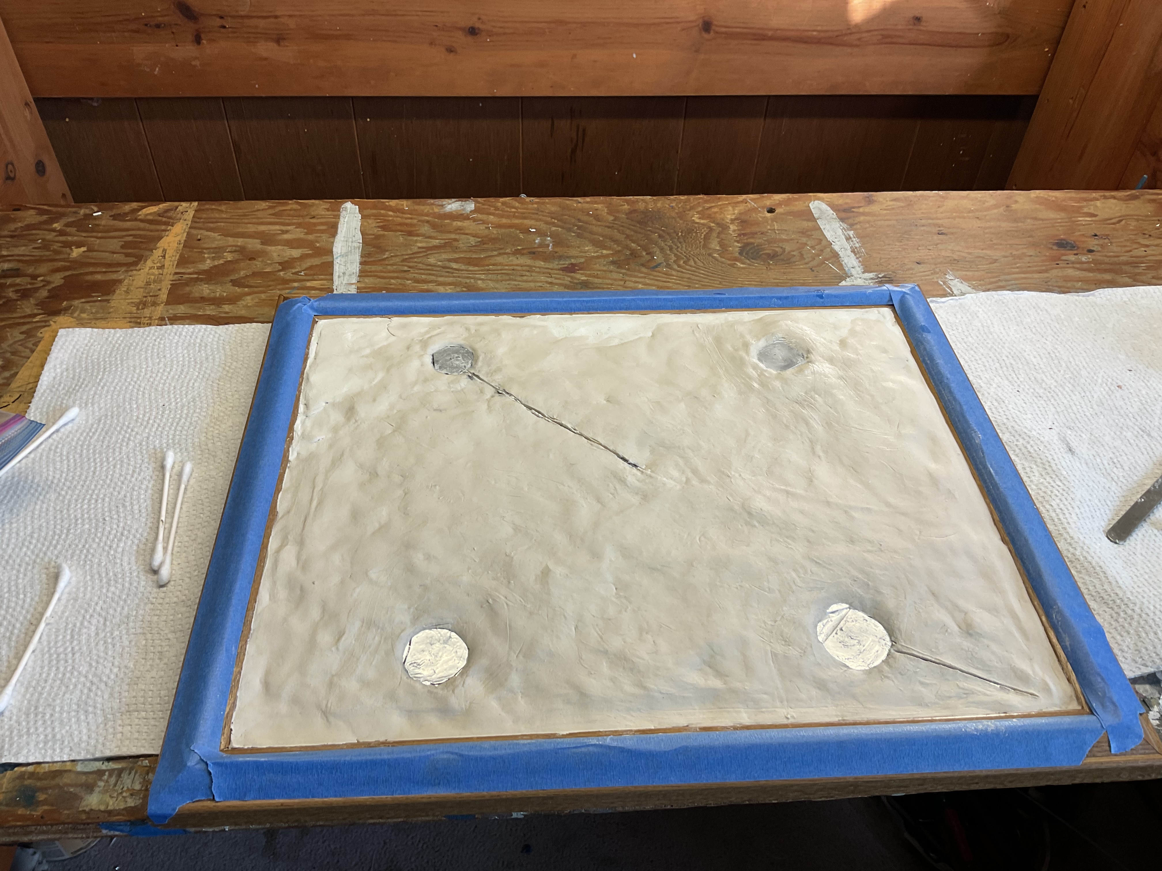

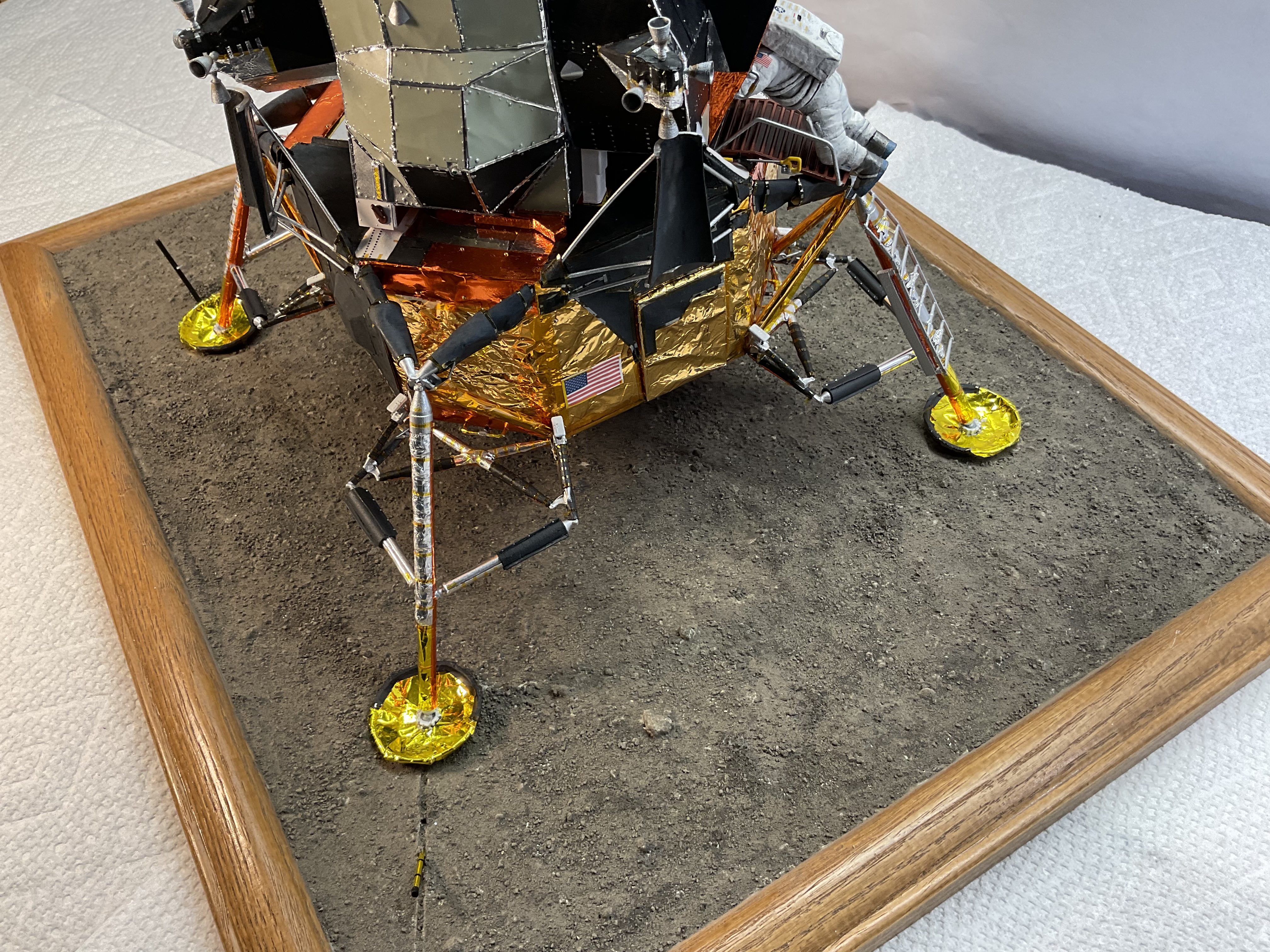

snichols Posted August 24, 2023 Author Share Posted August 24, 2023 (edited) Thank you everyone and thanks bubble for taking a look and commenting on this build, it’s now complete and this is the last entry into the build log. Base was fun but quite a bit of research went into it also. The descent stage engine distributed 1k lbs of thrust out of a bell that had an area of 2730 square inches which translated to 6 oz’s of pressure per square inch that meant not much scorching on the landing site. I also read the paper on soil mechanics and didn’t realize Mare Tranquillitatis bordered the highlands which was only 50 km away , most of the regolith from Tranquillity base consisted of basalts but the discovery of non mare lithologies was an indication of breccia’s which produces a lighter color regolith seen in the highlands so I used a lighter color gray under the regolith simulant with more on the way to sprinkle on the footpads so technically it’s almost done😜. Eagle had a pitch of 4.37 degrees on the +Z axis and a 0.33 degree roll on the +Y axis that you can just determine in some pictures. I might dry brush a little burnt umber over the black scorch mark at some point . I haven’t been to an IPMS event since the 1996 NATs In Va. beach and received a plaque for a 2d place(non spacecraft build) but I believe it’s time to change that . I see a small indentation on the bottom of Neil’s PLSS ! , I applied so much filler and checked it a number of times and to see that ….. oh well time for more I suppose. Edited November 30, 2023 by snichols Quote Link to post Share on other sites

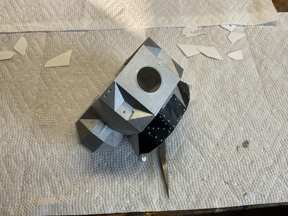

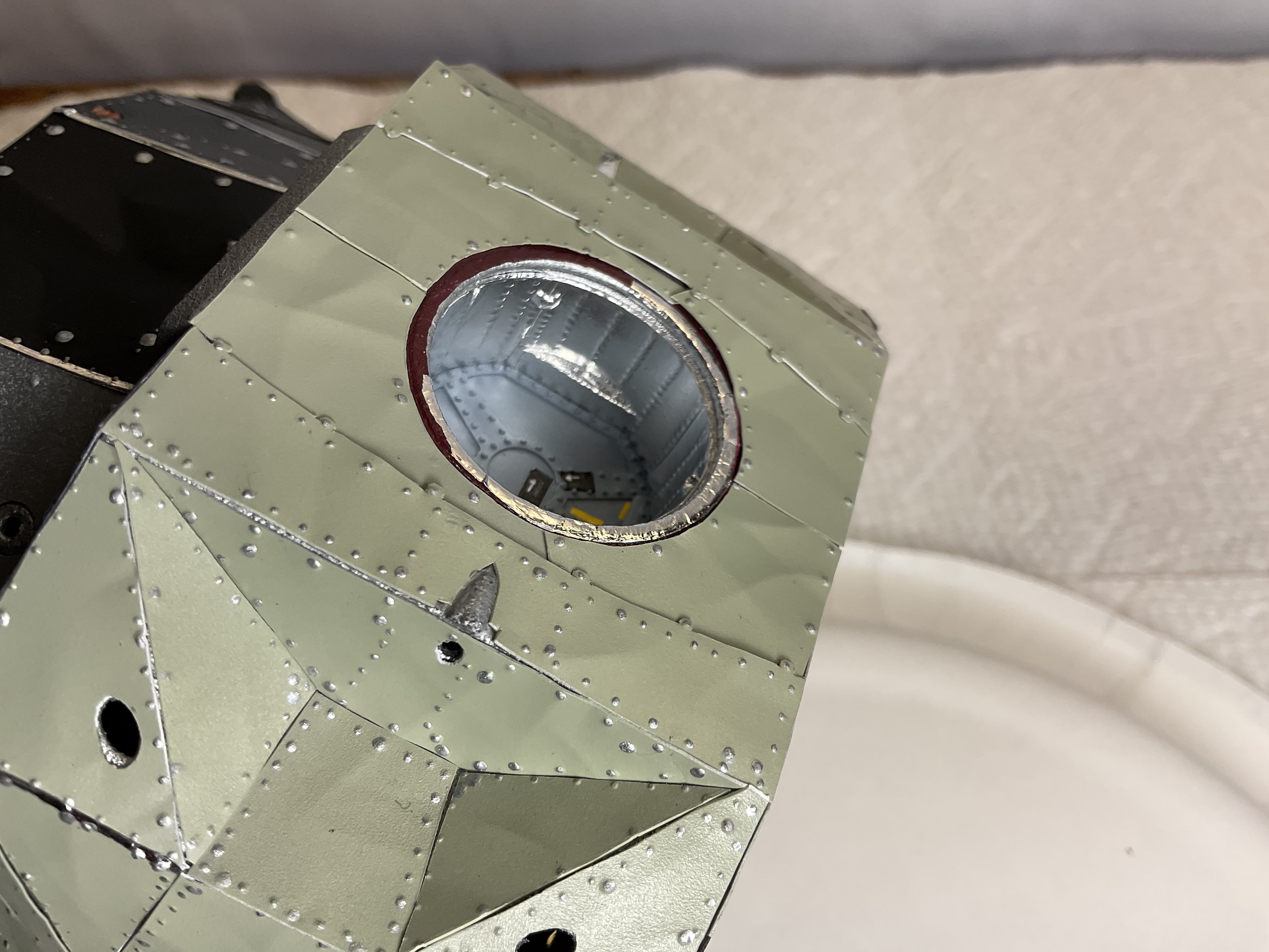

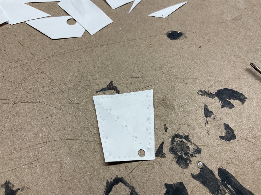

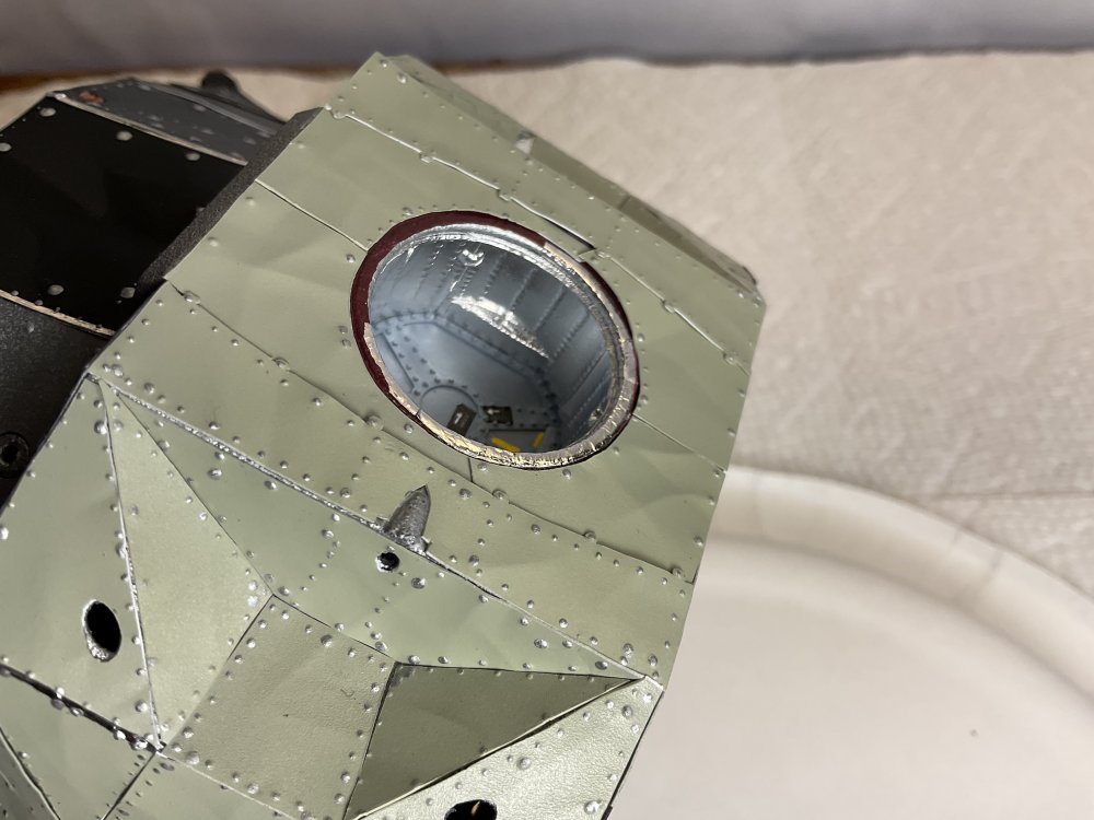

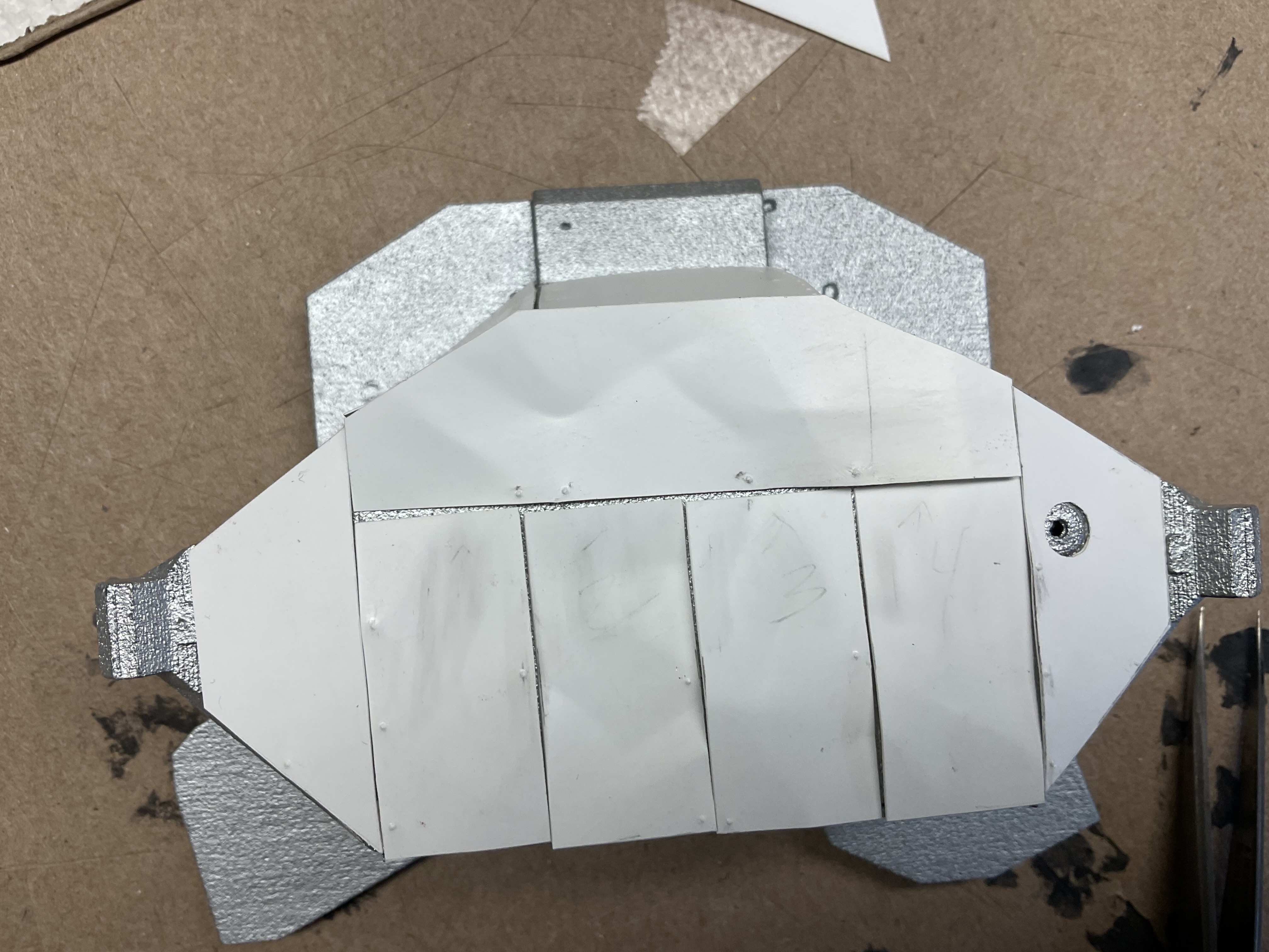

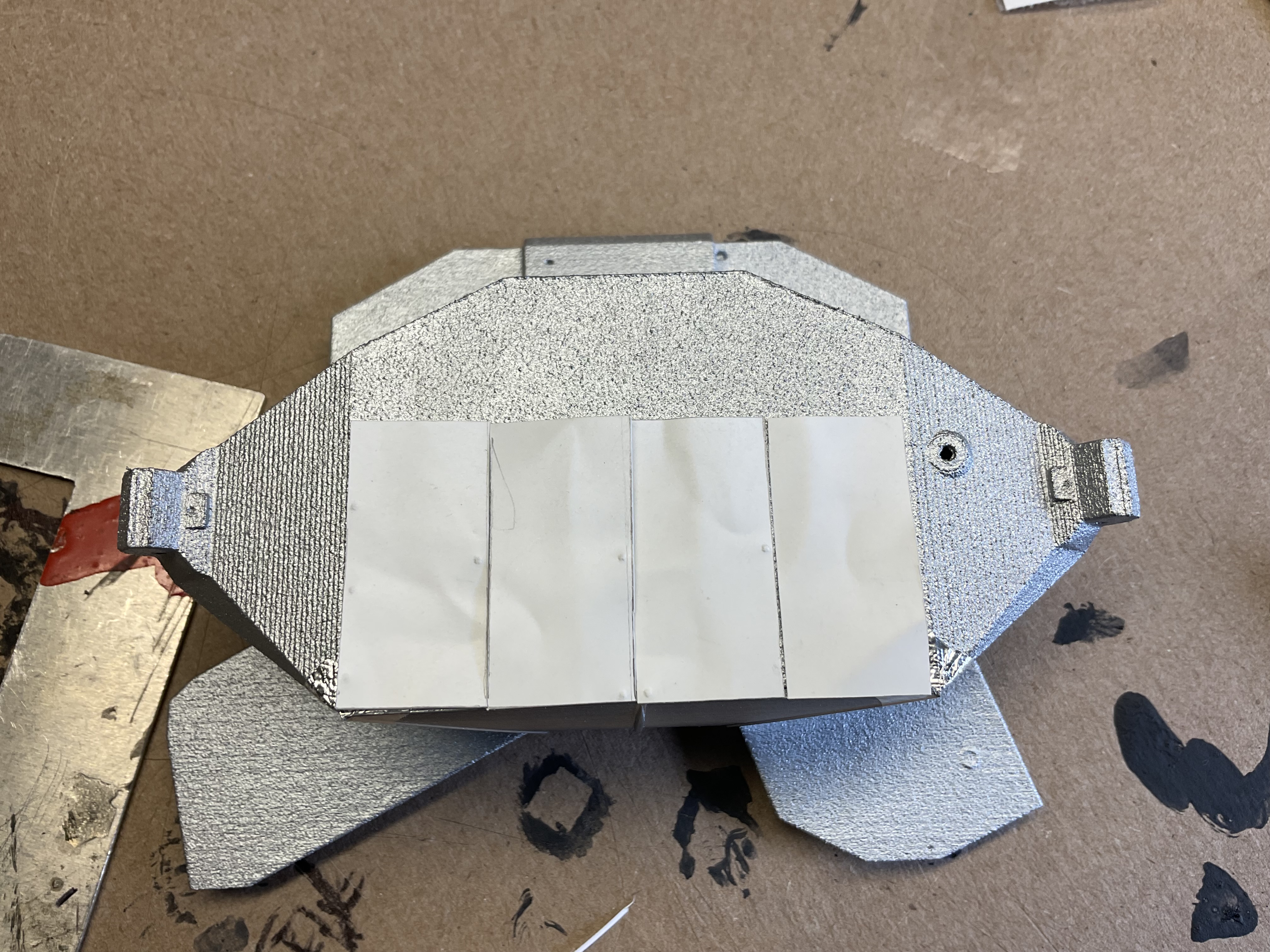

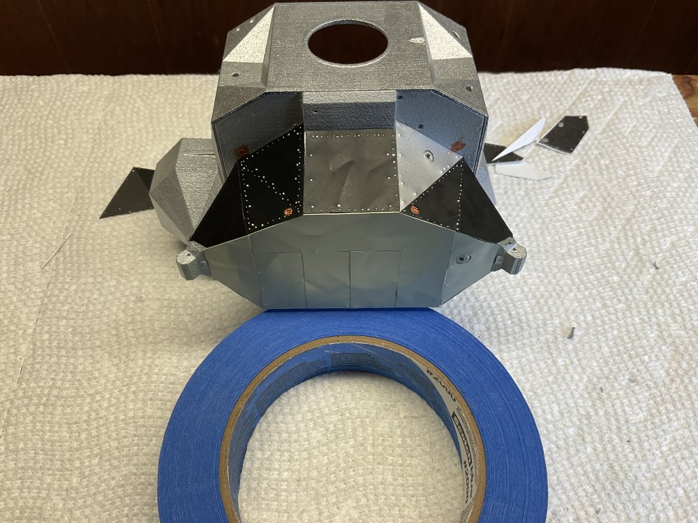

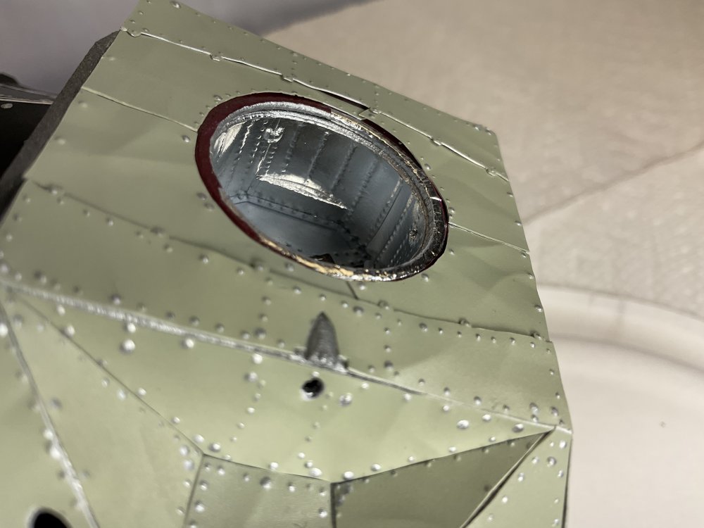

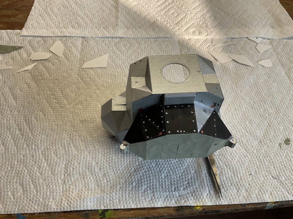

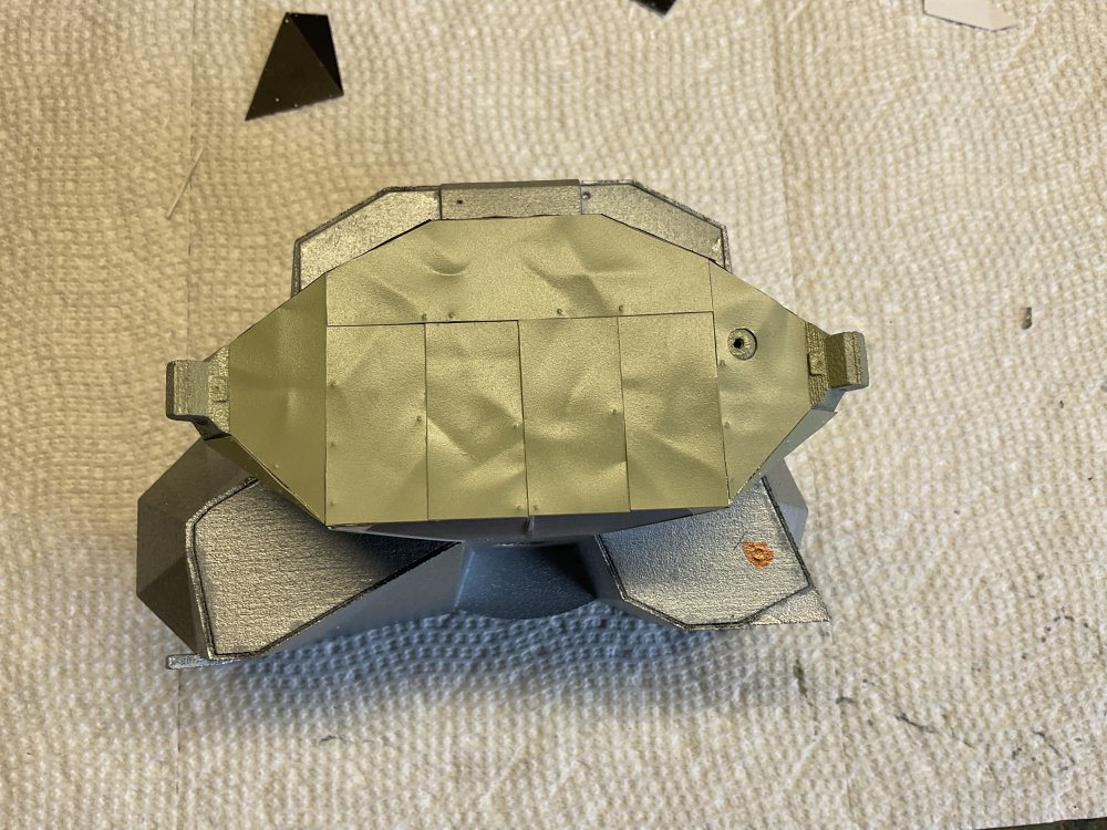

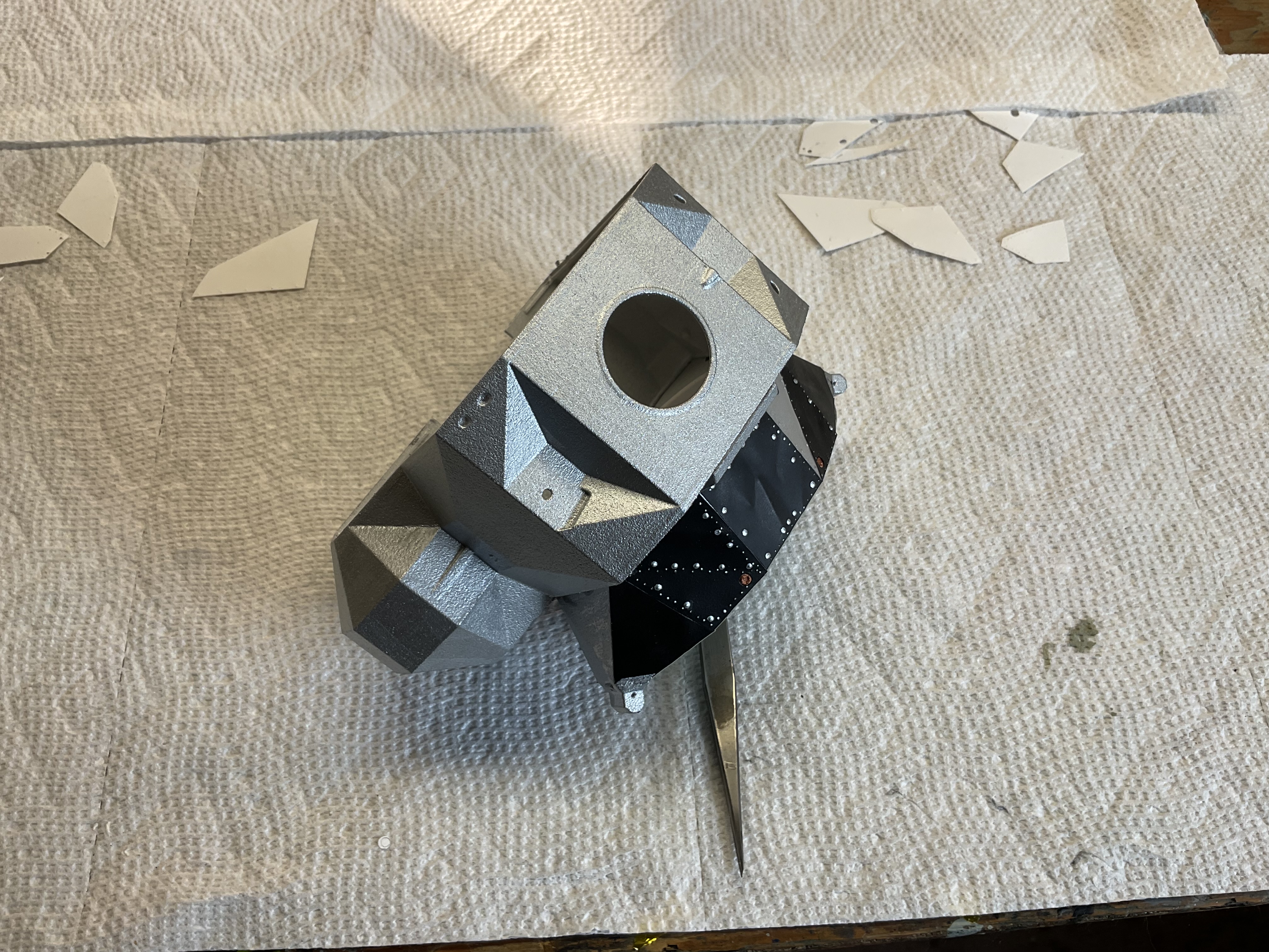

Ricardo Salamé Posted December 8, 2023 Share Posted December 8, 2023 On 6/18/2023 at 11:05 AM, snichols said: Thank you so much! Here’s an update with the Ascent stage, I’ve built LM ‘s before but the attempts fell far short and as I said I wanted to finally dedicate myself to building one correctly so I’ll show what I’ve accomplished. I didn’t want to use the printed colored paper patterns provided by Vincent for the ascent stage shingles as I’ve done in the past so I used plastic sheet dimpled with the rivet patterns taken from Vincent’s coatings guide. The foil that outlines each panel worried me simply because BMF doesn’t stick all that well so I had to make sure the joints fit together precisely while still maintaining the wrinkled appearance of each shingle. I used CA directly in the center of each panel to tack it in place then carefully secured the rest of each panel using CA and a toothpick. Next up was the color dilemma, so Testors acryl flat gull gray was mixed with Tamiya sky and when I tried Tamiya semi gloss for the correct sheen afterwards it only made it more dull. To get the correct semi gloss sheen visible on the anodized aluminum I had to use Krylon acrylic gloss clear with each rivet being painted with a toothpick. The rivet looks amazing. They really highlight the model. You make a fantastic job with this LM! No you raise the bar again. Thanks for shearing the pictures! Regards Ricardo Quote Link to post Share on other sites

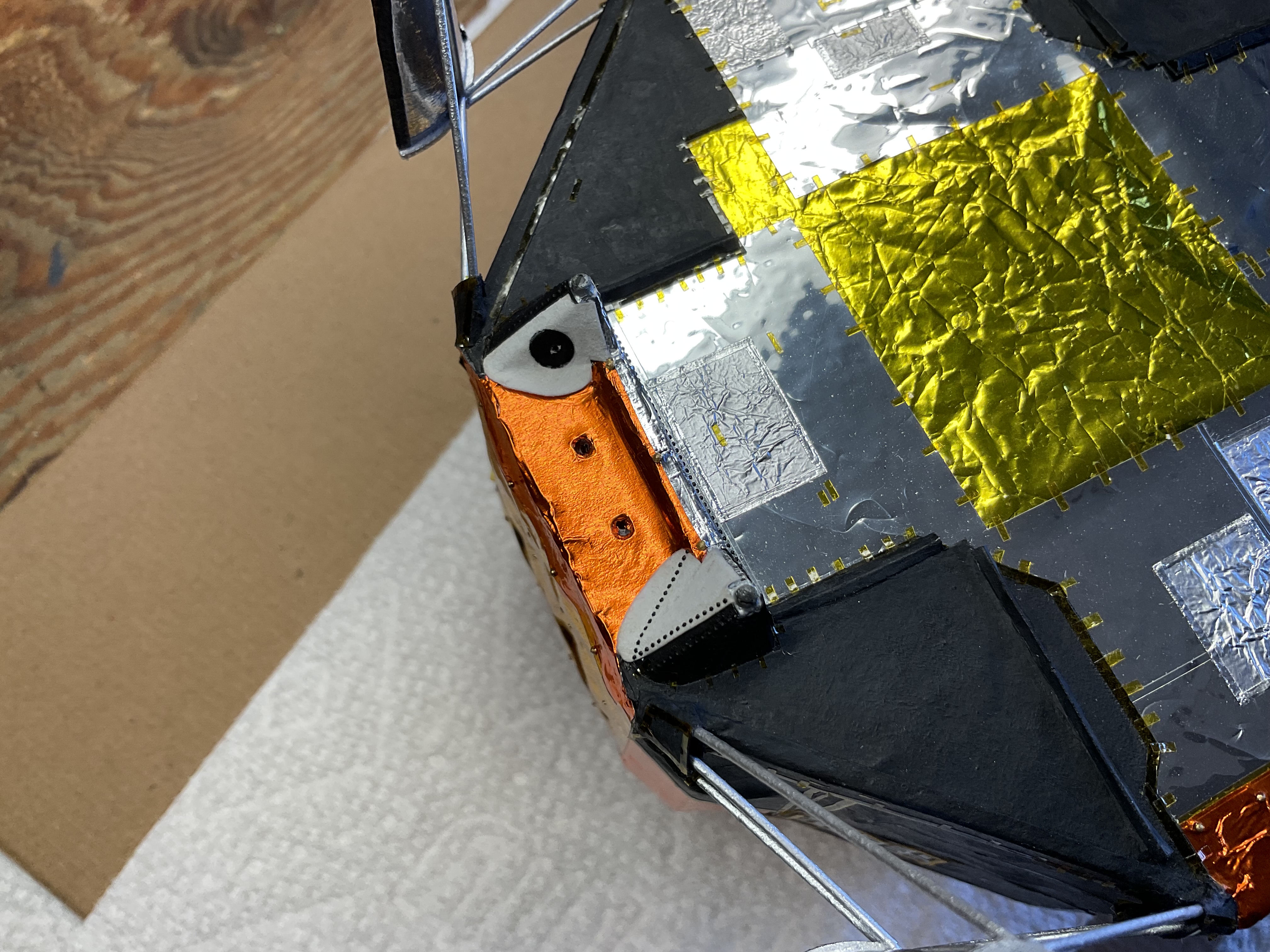

Nasa man Posted September 19, 2024 Share Posted September 19, 2024 (edited) Hey there - big fan of your work on the 1/32 Meens LM. I was wondering about the amber colored foil on either side of the surface egress hatch. Where did you get that? Also - the ascent stage windows. Can you tell me about where you got the decals? And, the ascent stage light? Where did you get that or is that just made from whole cloth. Thanks. AND - again, great work. Edited September 19, 2024 by Nasa man Quote Link to post Share on other sites

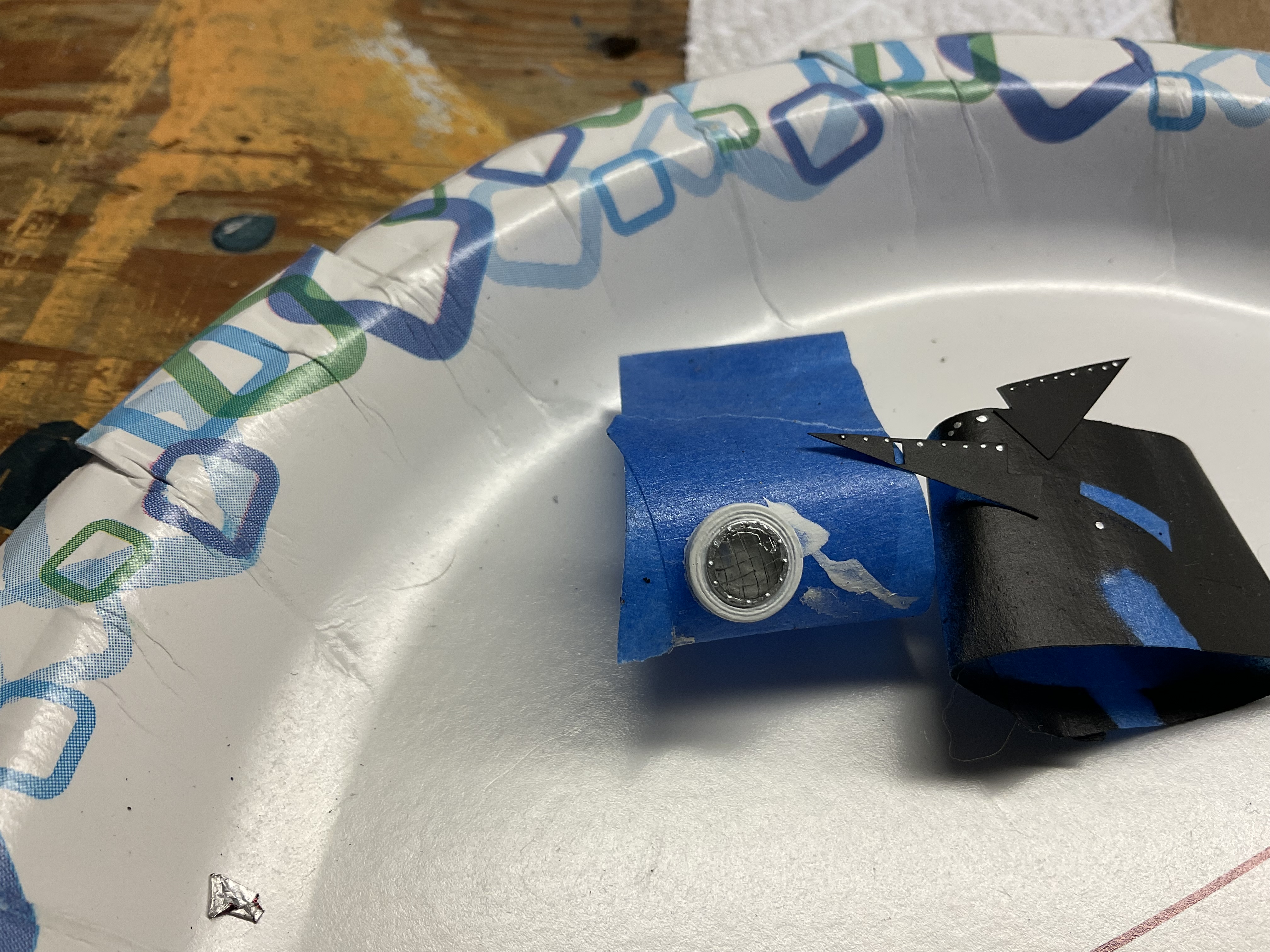

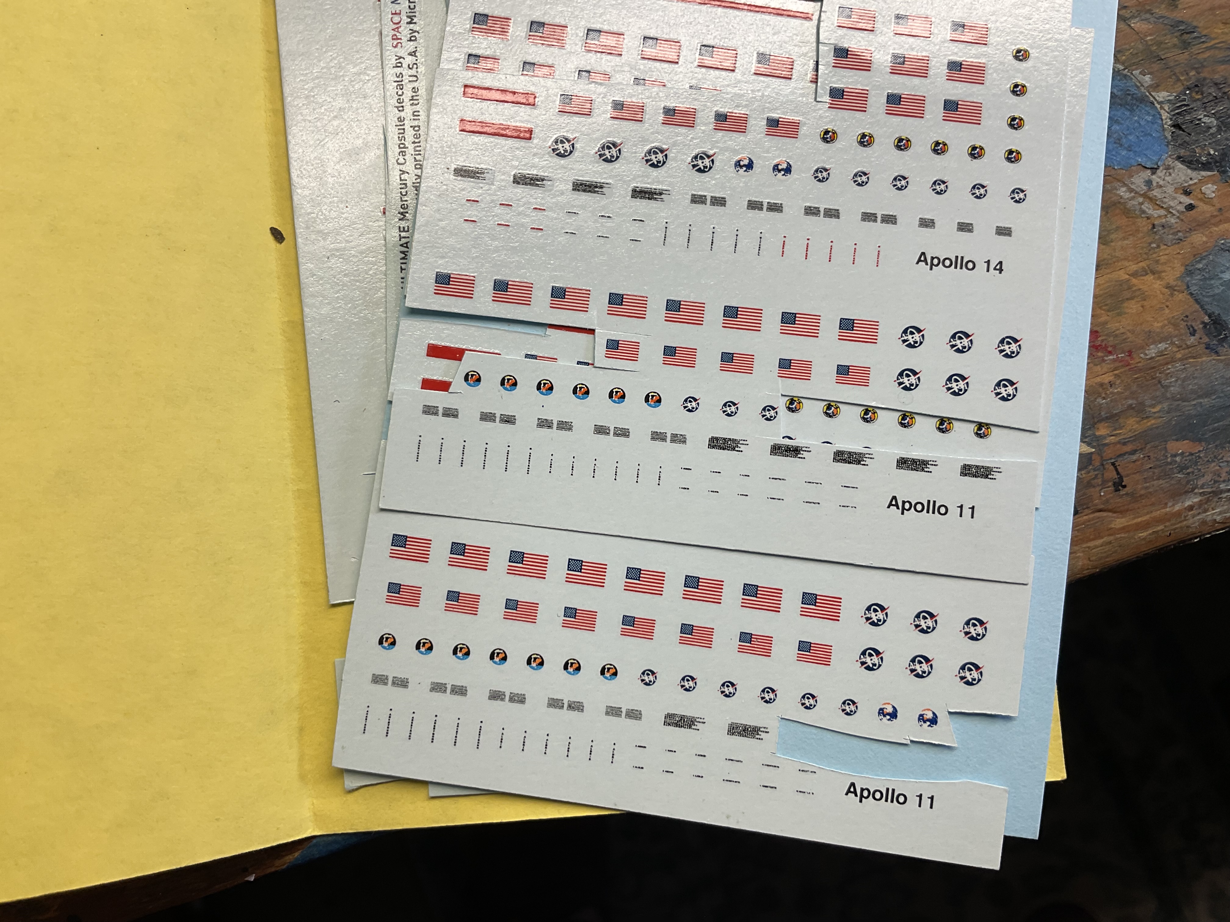

snichols Posted September 20, 2024 Author Share Posted September 20, 2024 (edited) On 9/18/2024 at 8:05 PM, Nasa man said: Hey there - big fan of your work on the 1/32 Meens LM. I was wondering about the amber colored foil on either side of the surface egress hatch. Where did you get that? Also - the ascent stage windows. Can you tell me about where you got the decals? And, the ascent stage light? Where did you get that or is that just made from whole cloth. Thanks. AND - again, great work. Well thank you very much, building this LM model was a lot of fun but a ton of work and Vincent really did all the hard work creating such a beautiful model. It’s unfortunate that Shapeways is no longer in business which led me to buy a 3d printer (2 actually) and you know the saying “when one door closes”. Product used around the ingress/egress hatch are candy foils and I’ll look for the manufacturer. All markings are provided on Vincent’s webpage were he has the instructions listed, the window reticles were etched then given a white acrylic wash to accentuate the reticles. Ascent stage light is a Shapeways part that I modified by etching the vertical and horizontal lines on the face then detail painting ending with washes. 8 hours ago, SpacecraftGuy said: An absolute stunner!! Thank you so much! It was quite the challenge but a lot of fun! Edited September 20, 2024 by snichols Quote Link to post Share on other sites

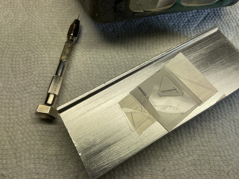

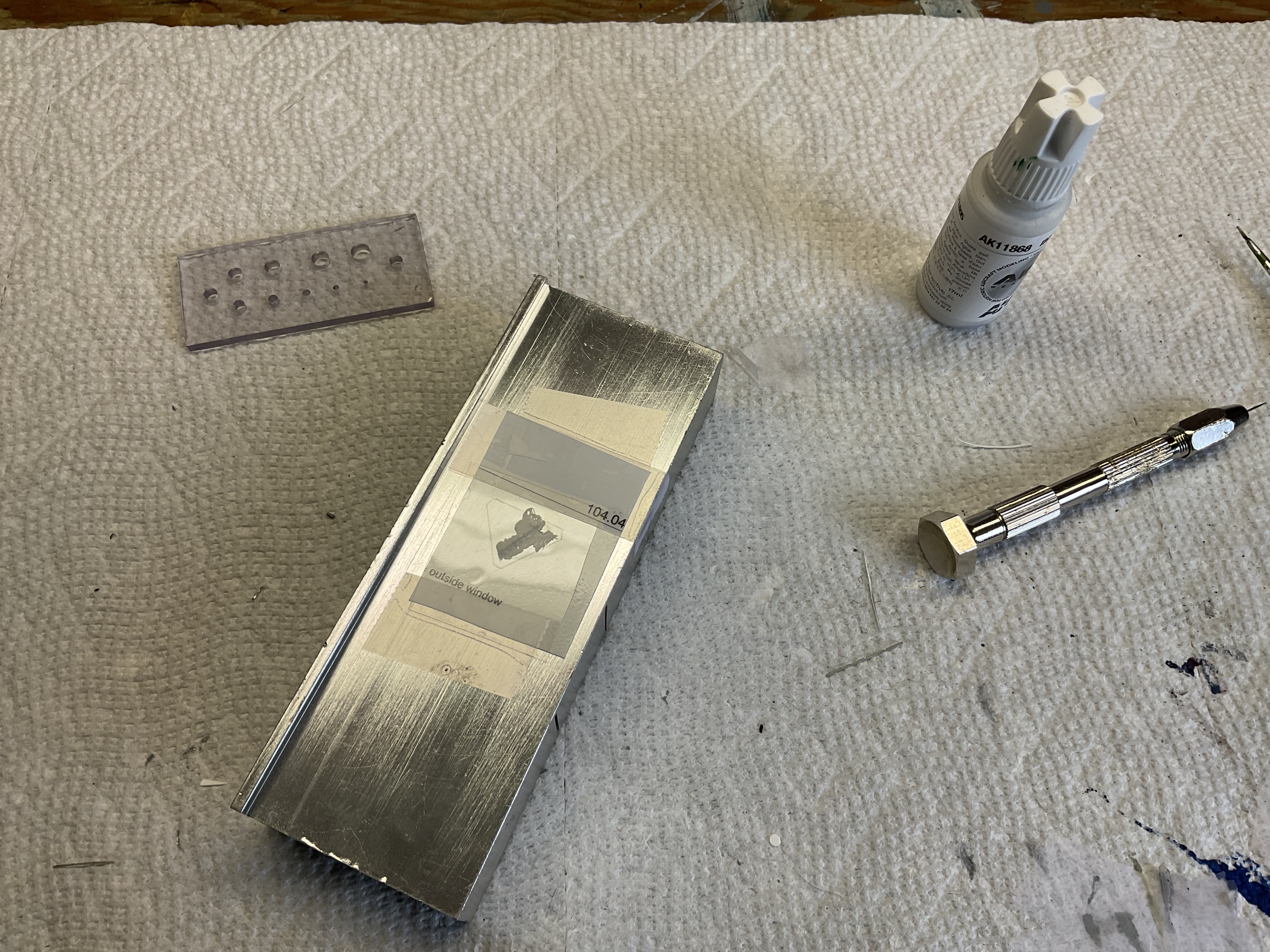

Nasa man Posted September 22, 2024 Share Posted September 22, 2024 On 9/20/2024 at 6:27 AM, snichols said: Well thank you very much, building this LM model was a lot of fun but a ton of work and Vincent really did all the hard work creating such a beautiful model. It’s unfortunate that Shapeways is no longer in business which led me to buy a 3d printer (2 actually) and you know the saying “when one door closes”. Product used around the ingress/egress hatch are candy foils and I’ll look for the manufacturer. All markings are provided on Vincent’s webpage were he has the instructions listed, the window reticles were etched then given a white acrylic wash to accentuate the reticles. Ascent stage light is a Shapeways part that I modified by etching the vertical and horizontal lines on the face then detail painting ending with washes. Thank you so much! It was quite the challenge but a lot of fun! Is it this Orange foil? https://confectioneryhouse.com/collections/candy-foil-wrappers/products/6-x-6-in-orange-foil-candy-wrappers When you say you etched the windows - you mean by hand? To be honest, every time I look at your model I keep hoping it is really a 1/24 scale. It would make me feel a lot better about mine. Quote Link to post Share on other sites

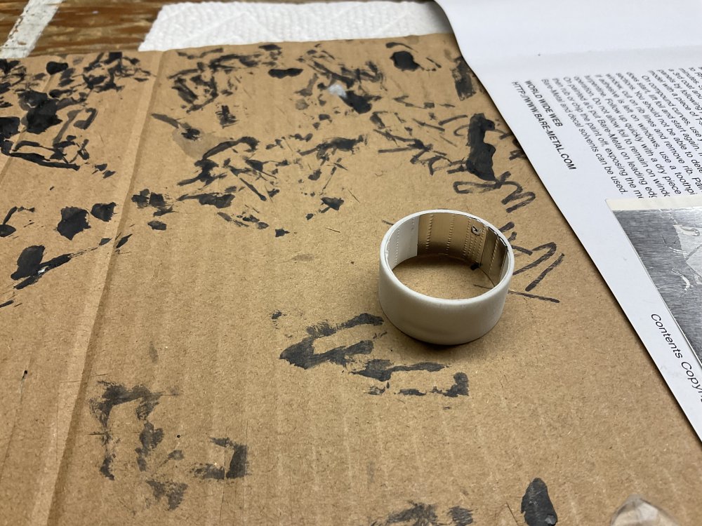

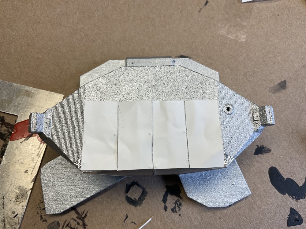

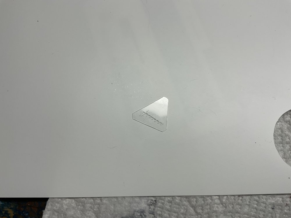

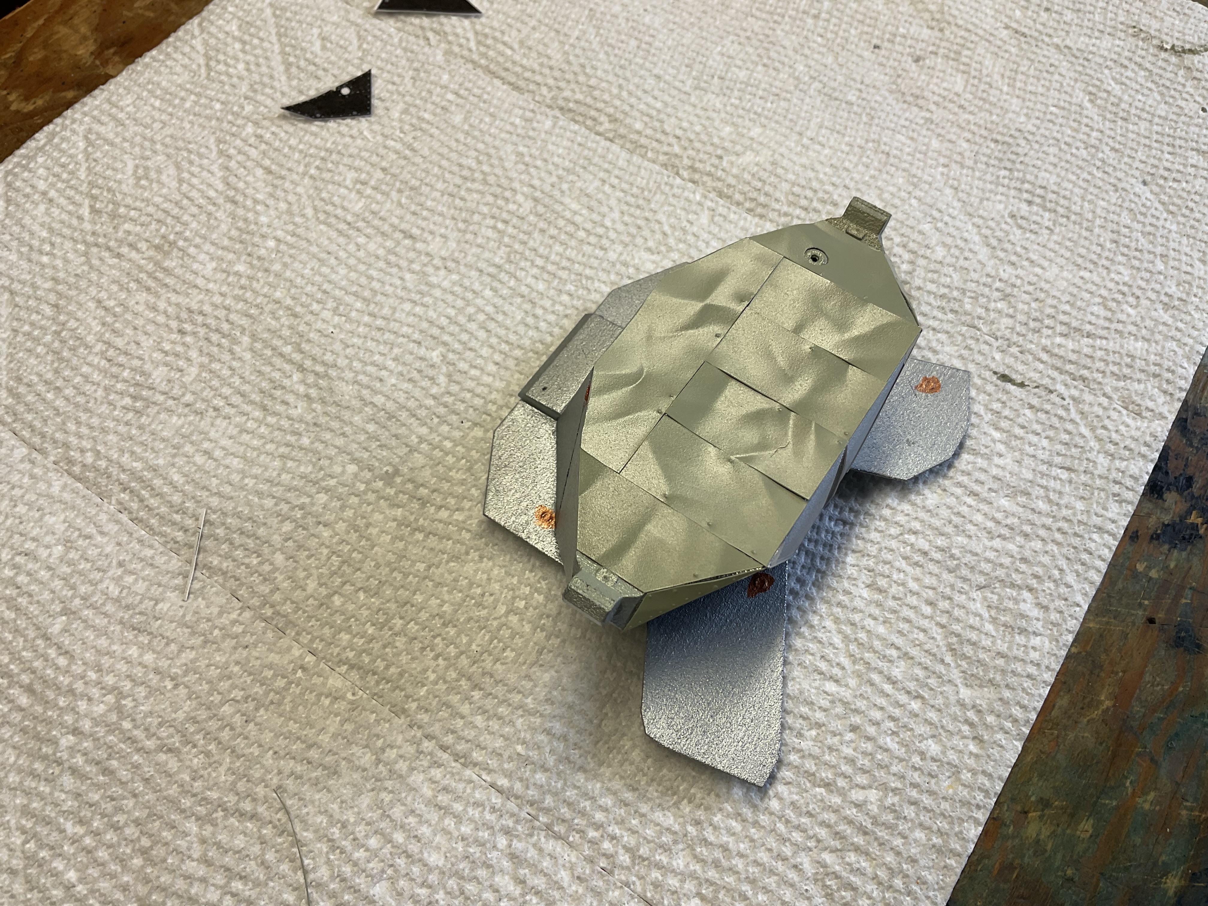

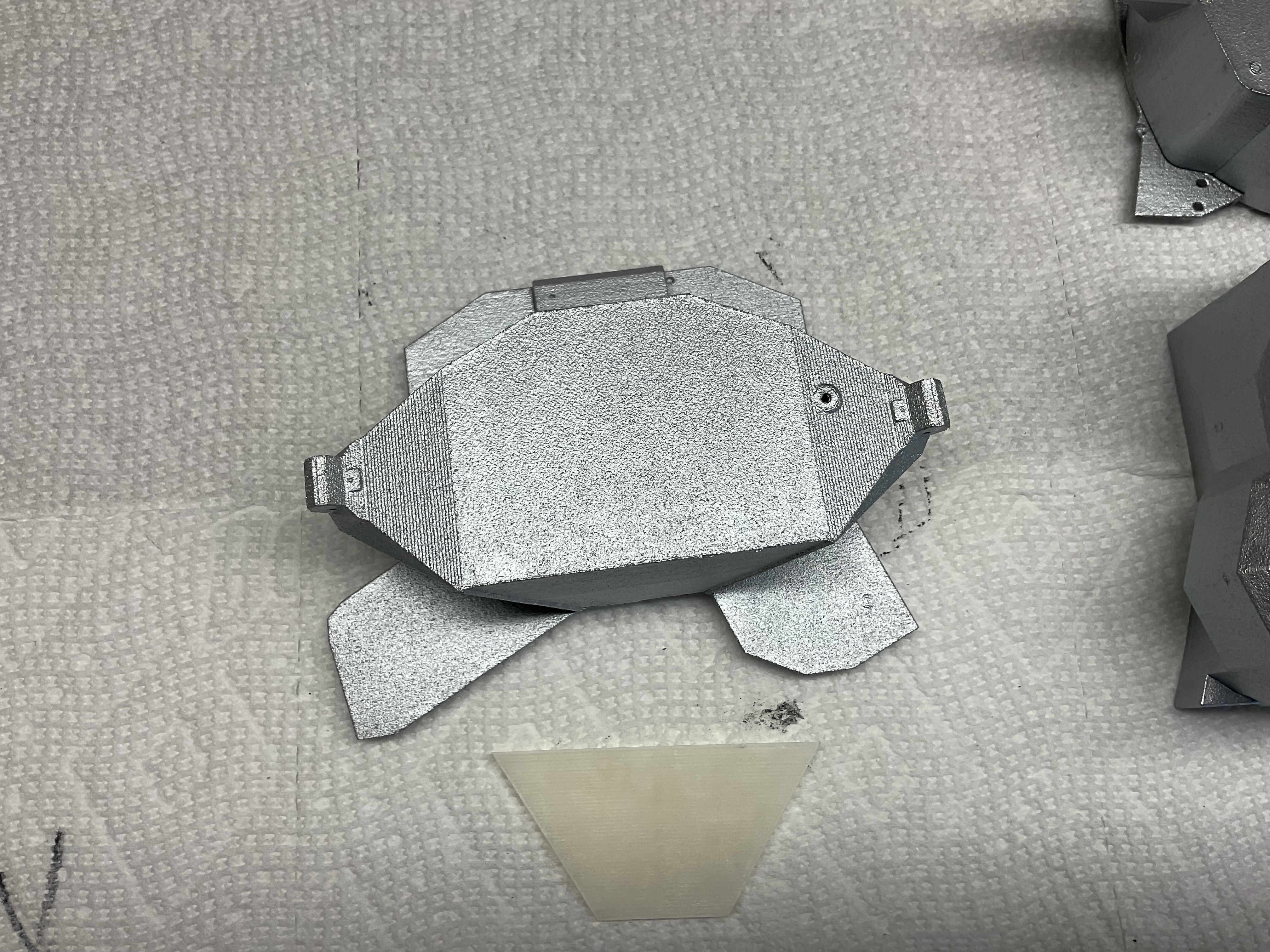

snichols Posted September 23, 2024 Author Share Posted September 23, 2024 20 hours ago, Nasa man said: Is it this Orange foil? https://confectioneryhouse.com/collections/candy-foil-wrappers/products/6-x-6-in-orange-foil-candy-wrappers When you say you etched the windows - you mean by hand? To be honest, every time I look at your model I keep hoping it is really a 1/24 scale. It would make me feel a lot better about mine. Yes that’s the foil and is exactly where it was purchased from, I’ll include some construction pictures of the windows too so get a brand new sewing needle and chuck it up in your pin vise and go to town. I used a set of 32d scale LM decals and traced the reticles from them, applied a wash of white acrylic paint let it dry then sanded off the residue. Quote Link to post Share on other sites
