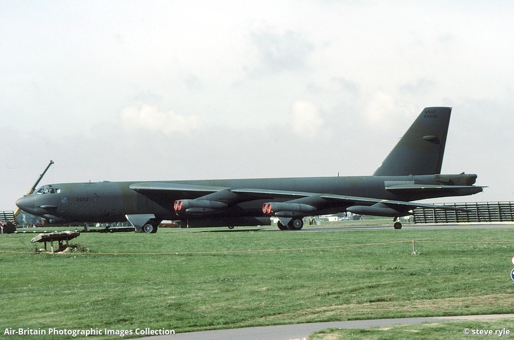

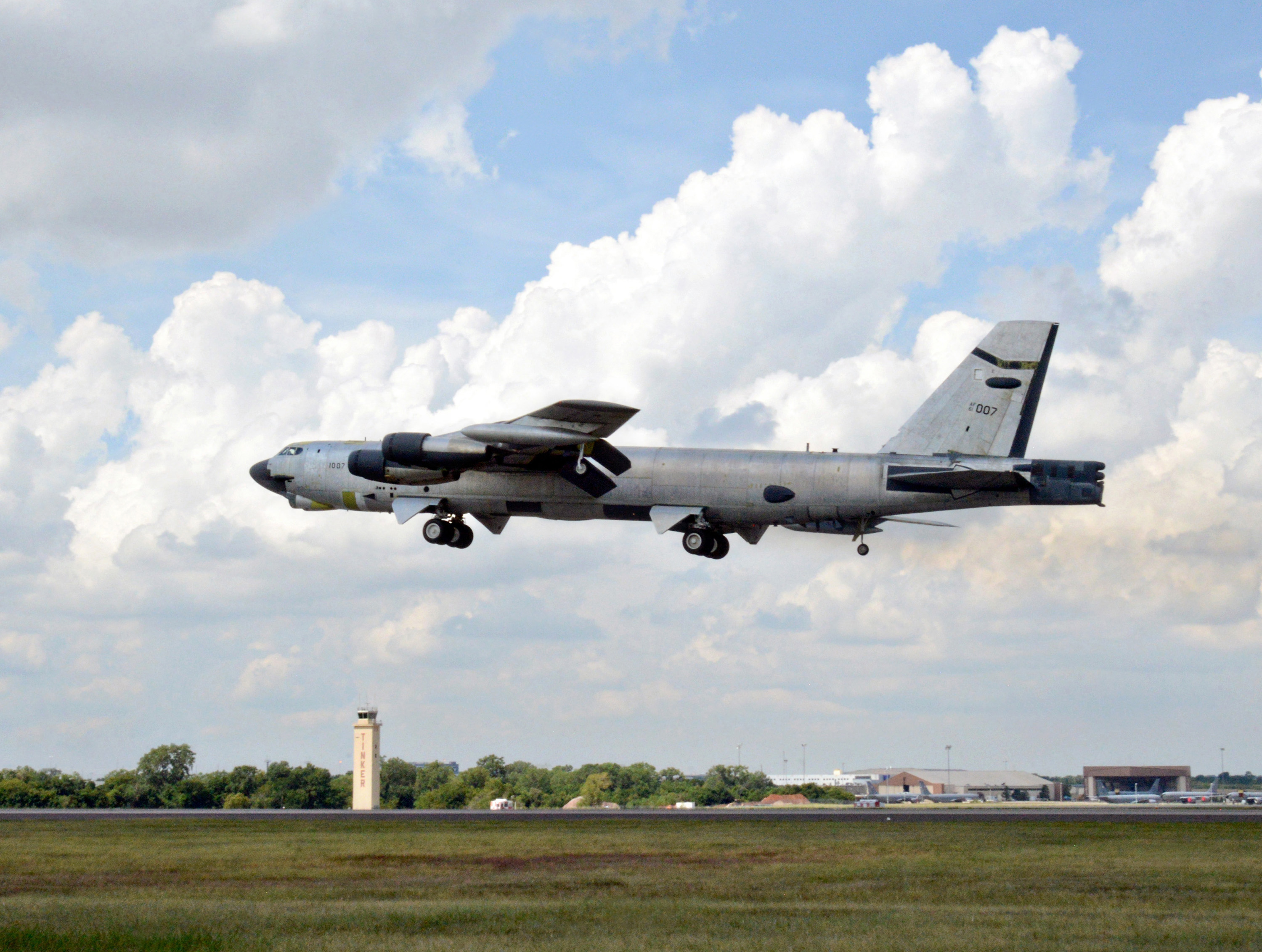

USAFsparkchaser Posted June 22, 2023 Share Posted June 22, 2023 Any idea what color the rectangular panels on the fuselage where the Horizontal stabs butt up to is? Is this a canvas or aluminum material also? Quote Link to post Share on other sites
Dutch Posted June 22, 2023 Share Posted June 22, 2023 (edited) Hmm, looks bare aluminum on FS36081 background (Strat Camo) jet and ... FS36081 on bare aluminum jet. Go figure! Edited June 22, 2023 by Dutch Quote Link to post Share on other sites
Gator52 Posted June 22, 2023 Share Posted June 22, 2023 (edited) Describing a strat-camo jet (like in Dutch's first photo) the Aerofax G/H book states the "rub area on fuselage where stabilizer pivots is FS 36118 gray." For my 1/144 H in overall FS 36081, I used Expert’s Choice Wing Walk Gray trim film, which is close to 36118 and is just the right amount of contrast to my eye. Chrsi Edited June 22, 2023 by Gator52 Quote Link to post Share on other sites
Chriss7607 Posted June 24, 2023 Share Posted June 24, 2023 Well, they're two different airplanes. The top one is a B-52G and the bottom one is a B-52H. I can say for certainty that the bottom photo was taken here at Tinker AFB and the aircraft had just gone through depot maintenance and has yet to go through the paint hangar. The dark gray areas (including the one in question) are all fresh F.S. 36118 Gunship Gray. Quote Link to post Share on other sites
