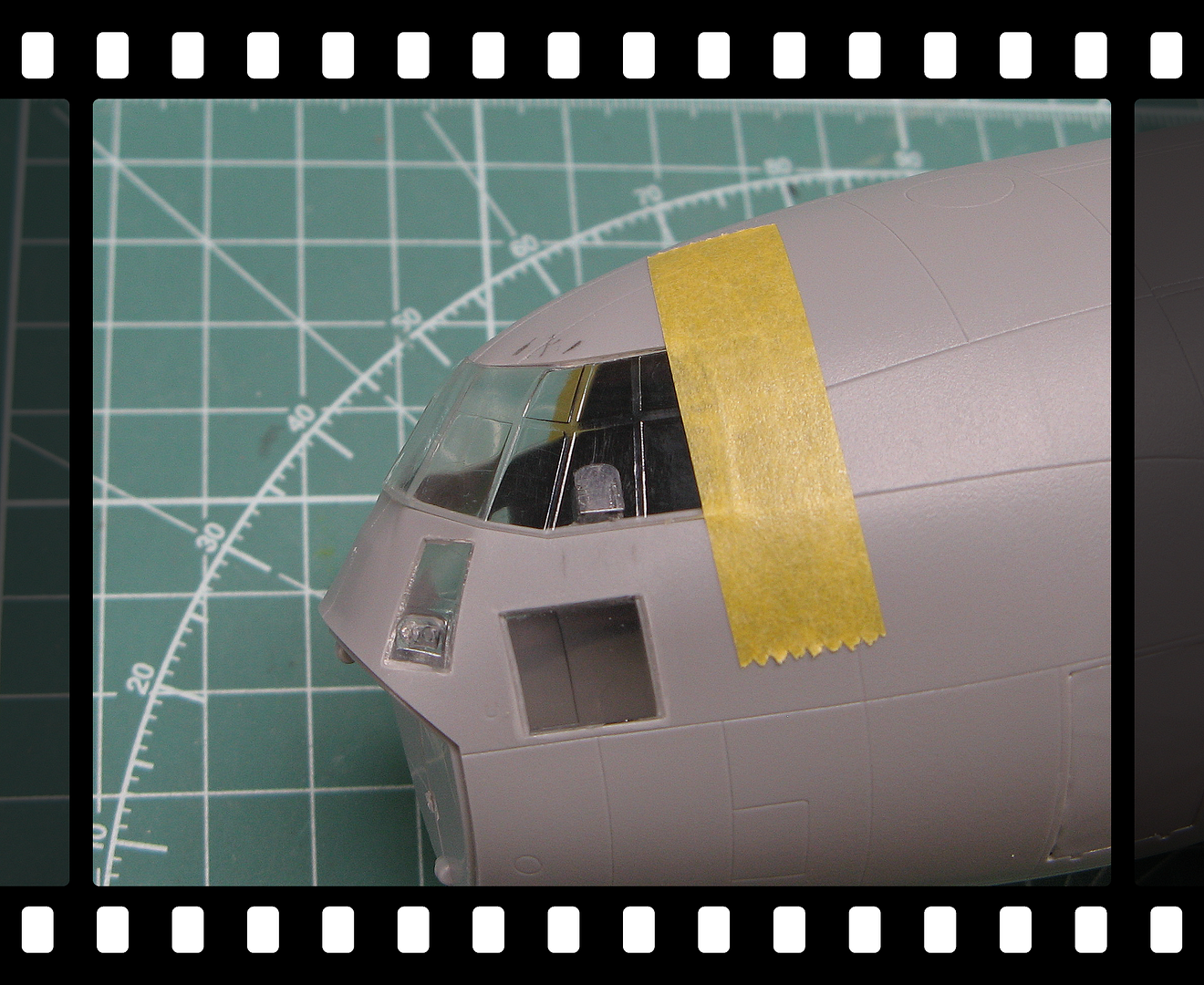

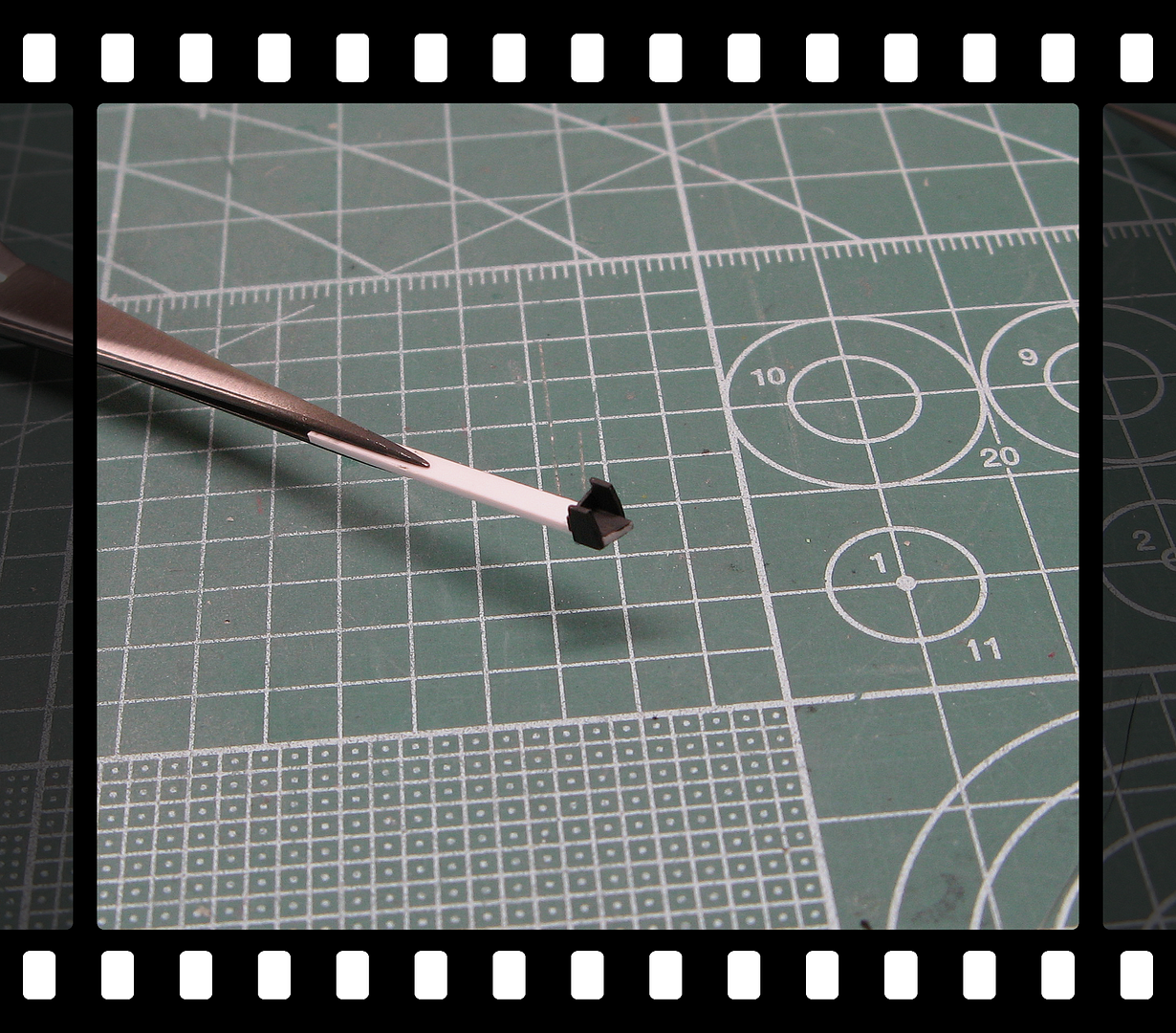

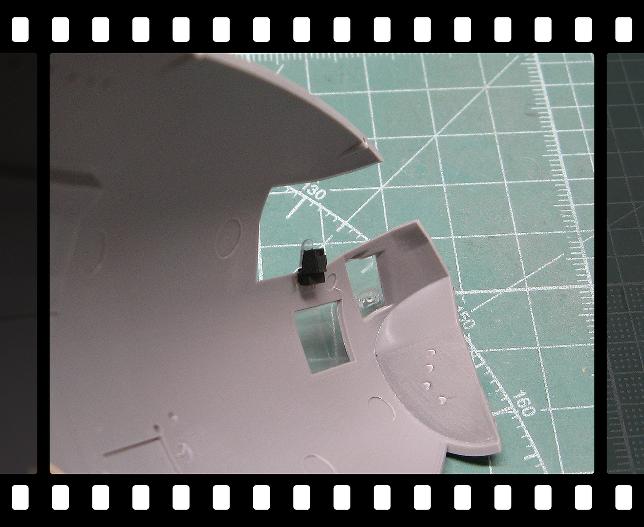

A-10 LOADER Posted September 7, 2023 Author Share Posted September 7, 2023 (edited) This might not look like much but, this took me most of the day to finish. I had to walk away from time to time because I was getting very frustrated but, the pilot's side HUD is installed. Looking at the windshield it's very noticeable so, I had to add it. Sometimes I'm my own worst enemy. Close enough for government work but, more importantly, it shows thru the proper pain of glass. I still need to come up with something for the pilot and co-pilot's forward looking HUD's but, that will have to wait until my replacement windshield shows up. Steve Like my EP-3, the inside of the windows got some paint as per my reference pics. Getting closer to closing up the fuselage. Edited February 4, 2024 by A-10 LOADER Quote Link to post Share on other sites

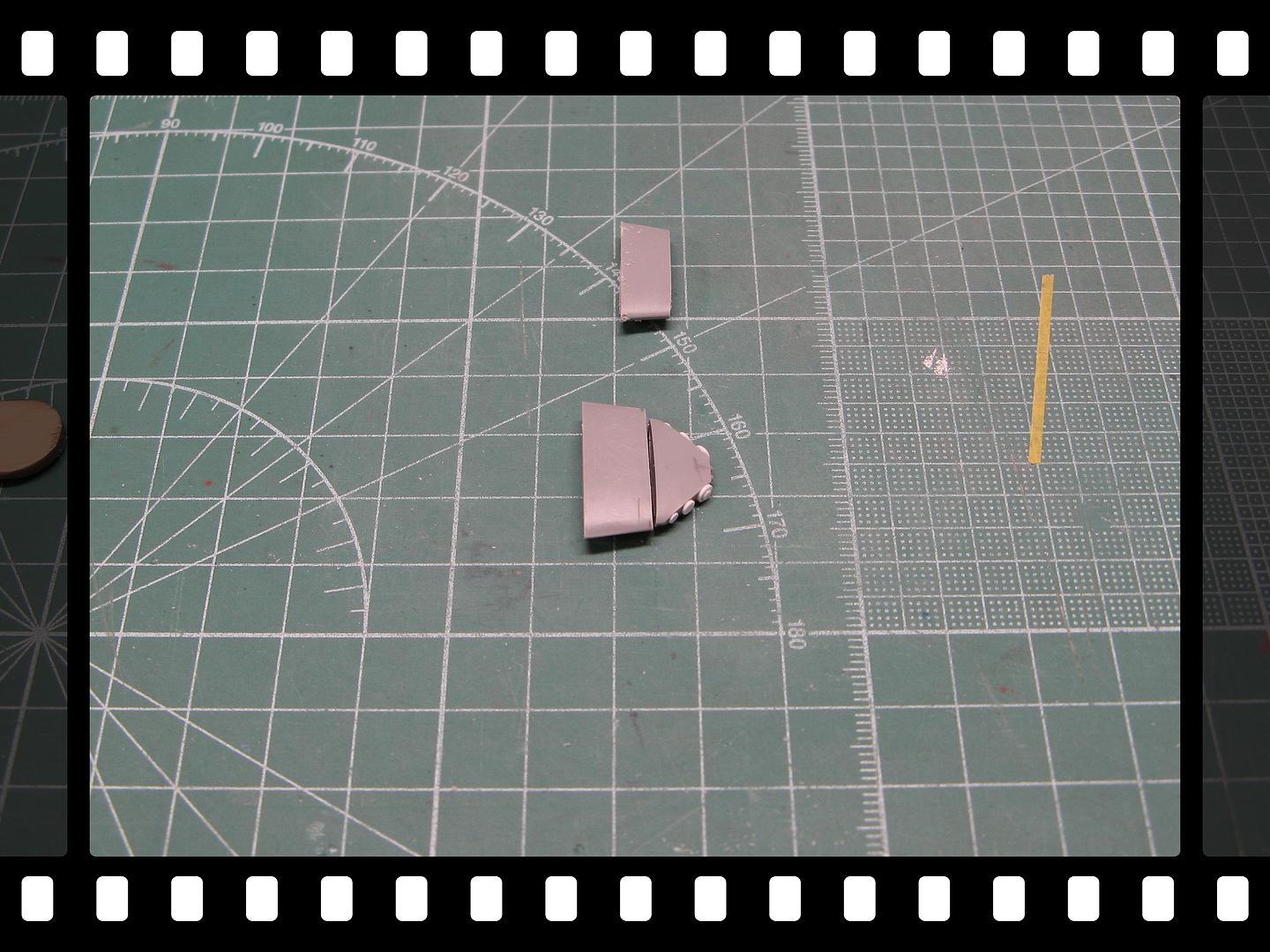

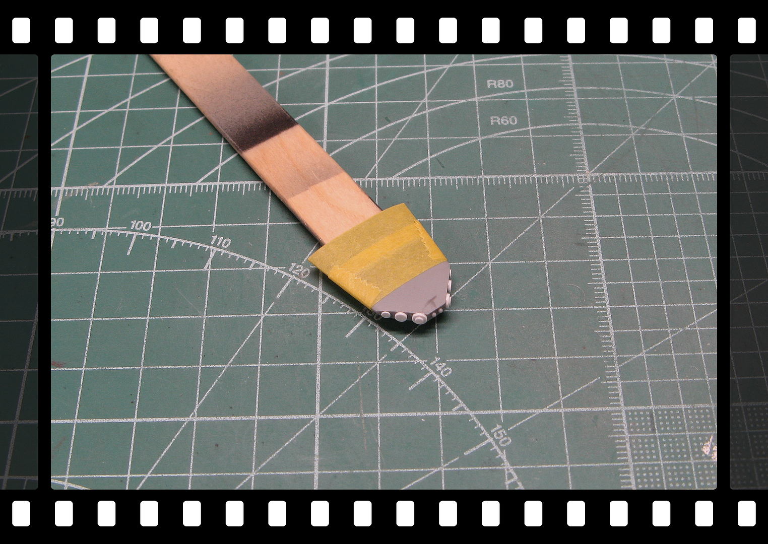

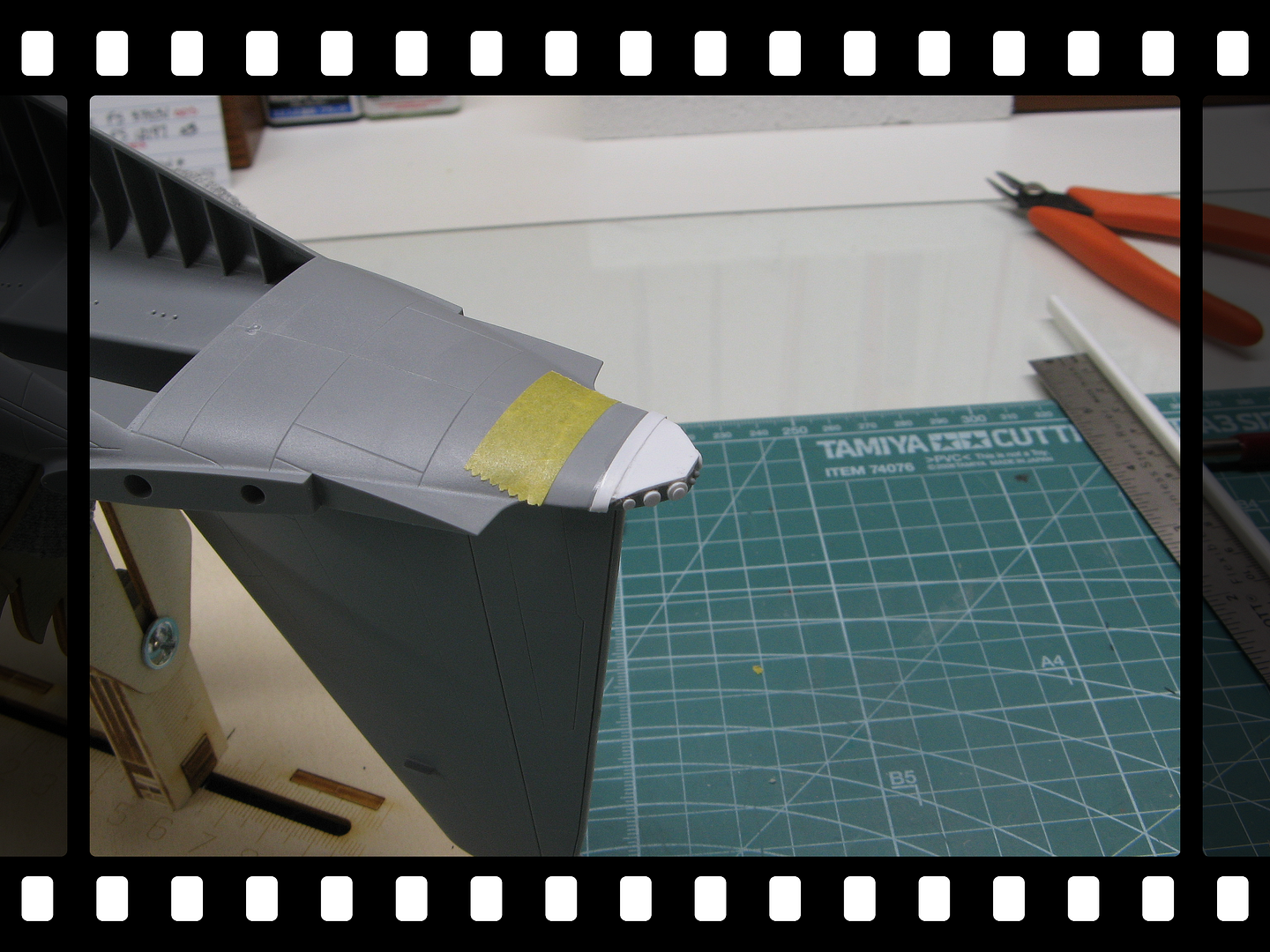

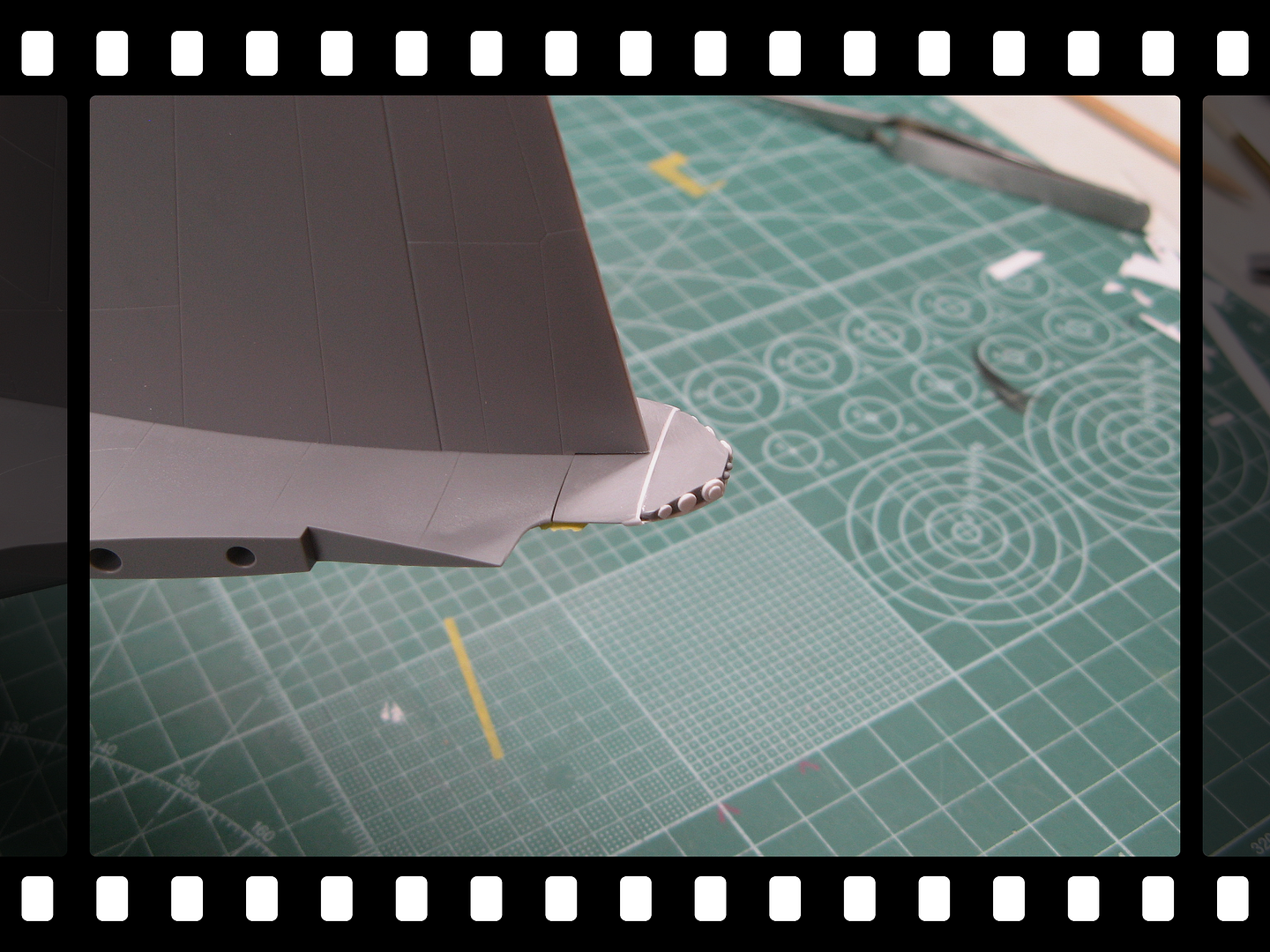

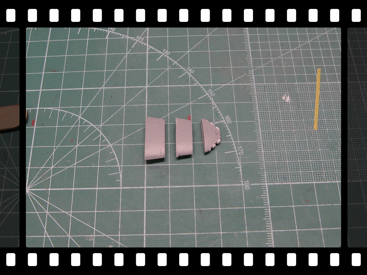

A-10 LOADER Posted September 8, 2023 Author Share Posted September 8, 2023 Thank you Tom. Today I worked on the "beaver tail" for the Gunship. The one in the kit is not appropriate for the AC-J. I had already added the sensors to the back of it and while I was dry-fitting it to the fuselage, I noticed according to my reference pics, it was too long. I decided to shorten the "beaver tail" by cutting a section out of the middle and grafting the remaining sections back together. The tape helped me with keeping my cuts straight but, they were not at 90 degrees, I REALLY struggle with this. This required me to add a .015" shim on the top edge which brought things back to level on top. I also had to add .015"plastic to the bottom because there was a step between the two pieces. Finally a small strip of .010" plastic to represent the attachment area where the end part attaches to the "beaver tail", as per my reference pics. Now that it's shorter it looks much better. All of this would have been easier without those disks in the way. I figured I'd try doing all this with them in place. It still needs work but, the basic shape is there. After some primer we'll see how it looks, I still may have to redo those disks if the seams don't disappear. Steve Quote Link to post Share on other sites

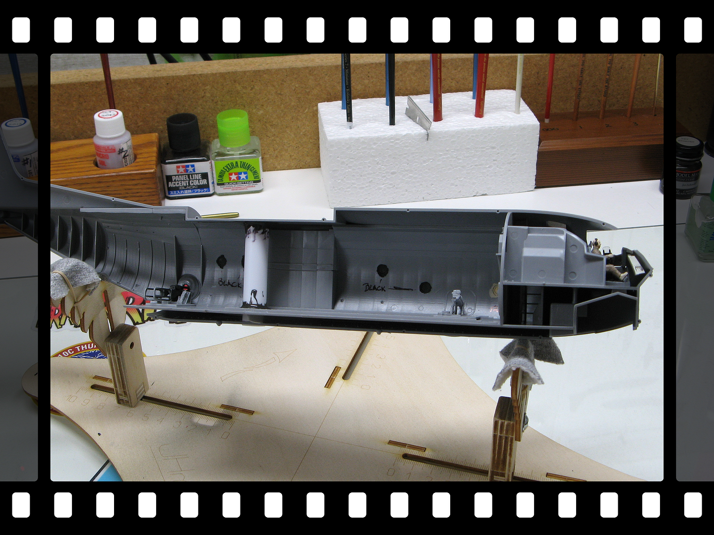

A-10 LOADER Posted September 8, 2023 Author Share Posted September 8, 2023 Gunship update for today, I glued in the main cabin floor/cockpit, the 105mm and, the plastic sleeve to the port side fuselage half. I used JB Weld 5 minute epoxy, where the sleeve attaches to the fuselage roof and cabin floor for a good, strong bond since the entire aircraft will be hanging on this point. The fuselage halves are not glued together as of yet and again, everything just fits so nicely. Steve Quote Link to post Share on other sites

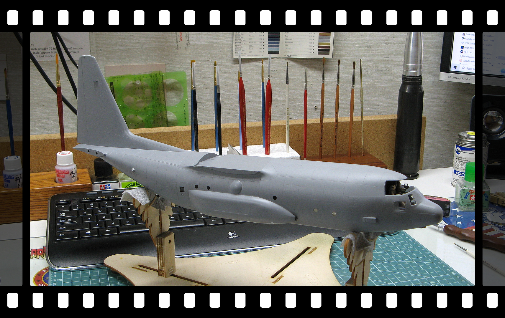

A-10 LOADER Posted September 9, 2023 Author Share Posted September 9, 2023 18 hours ago, HERC164 said: Steve- Great catch on the details, the firing HUD, the right side blister and the beaver tail. Looking really great so far! Looking forward to more. Thanks HERC appreciate that. I finally got the fuselage halves glued together last night. I chose to add some .030" plastic strips to help aid with the up/down alignment, now I just had to focus on holding the hales together as I glued. I took it slow and worked small areas at a time, like I usually do. The less sanding the better especially on this soft plastic. Once again, everything just fit perfectly. Once the seams are finalized I'll start adding all the antennas, I'll have to scratch-build a few the kit left out, and other items to the rest of the aircraft. Thanks to all who are following along. Steve Quote Link to post Share on other sites

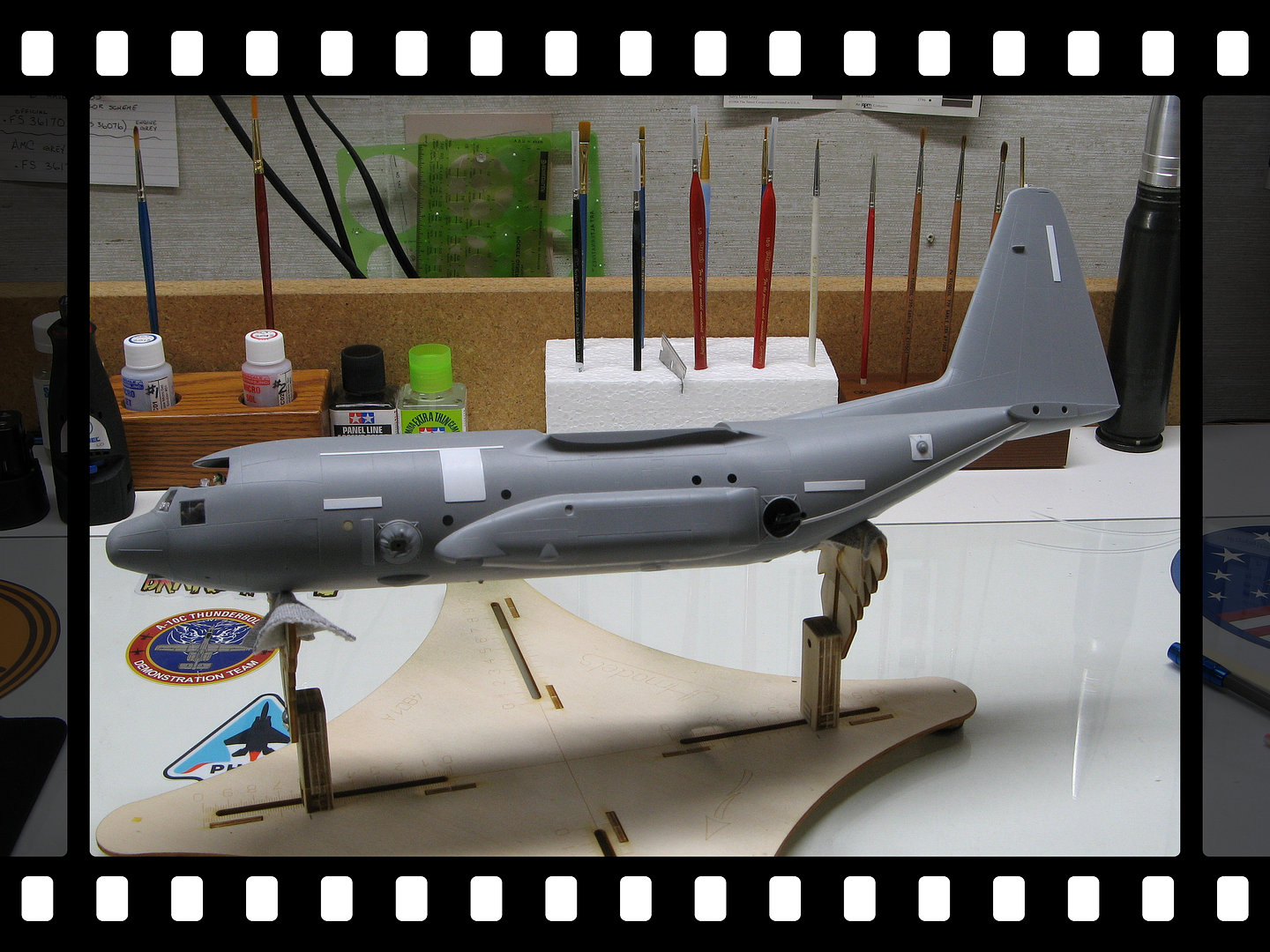

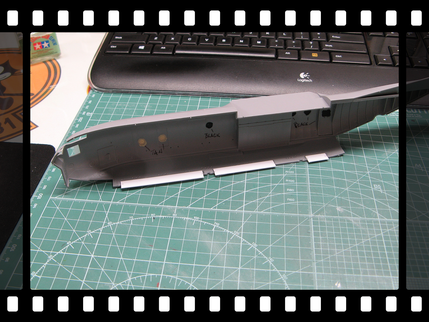

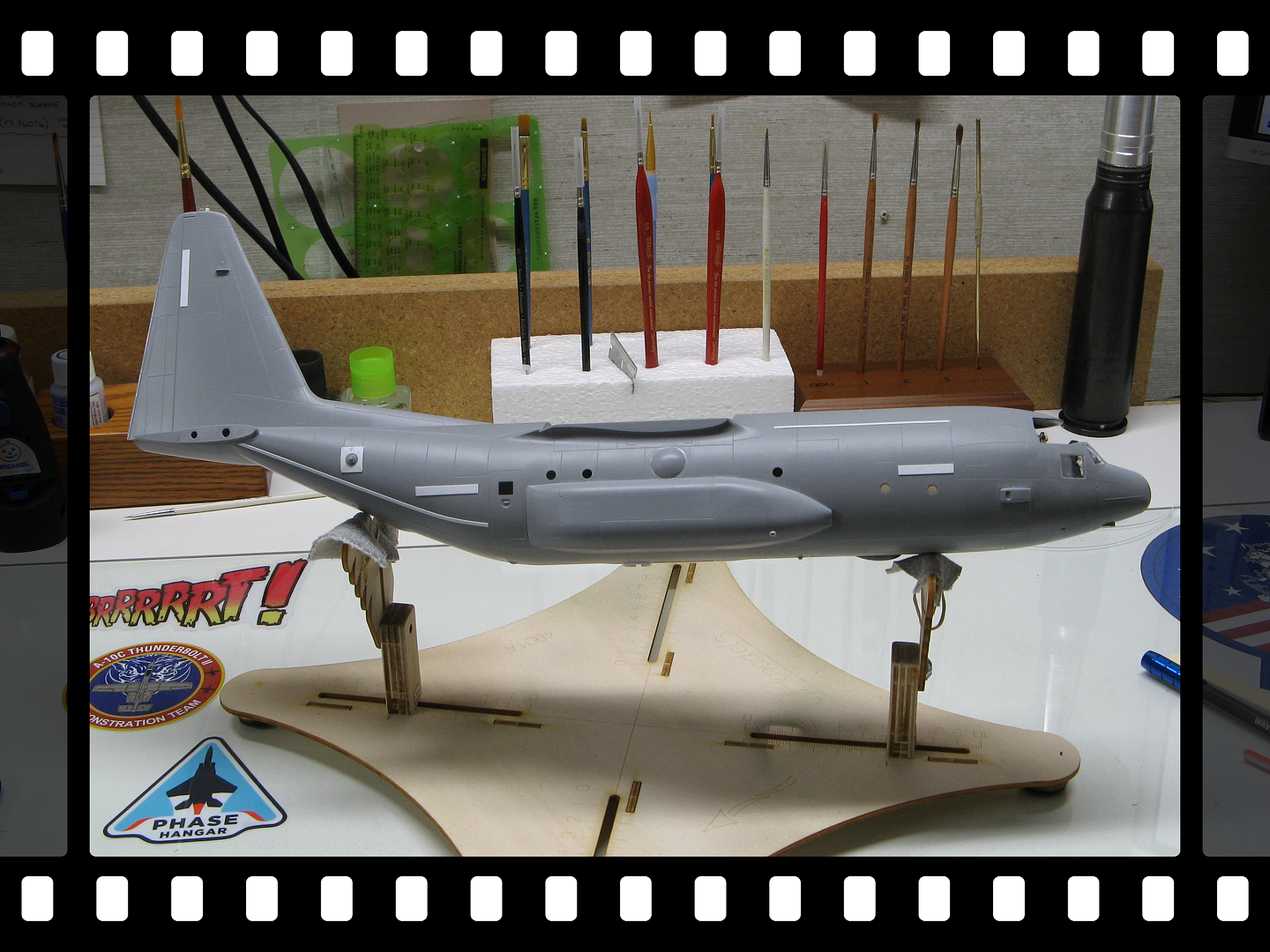

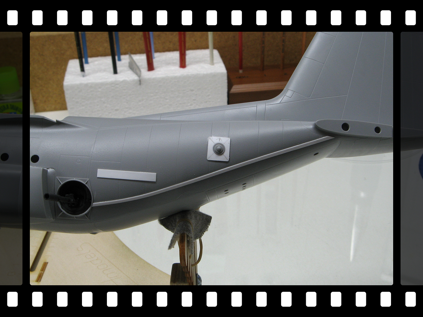

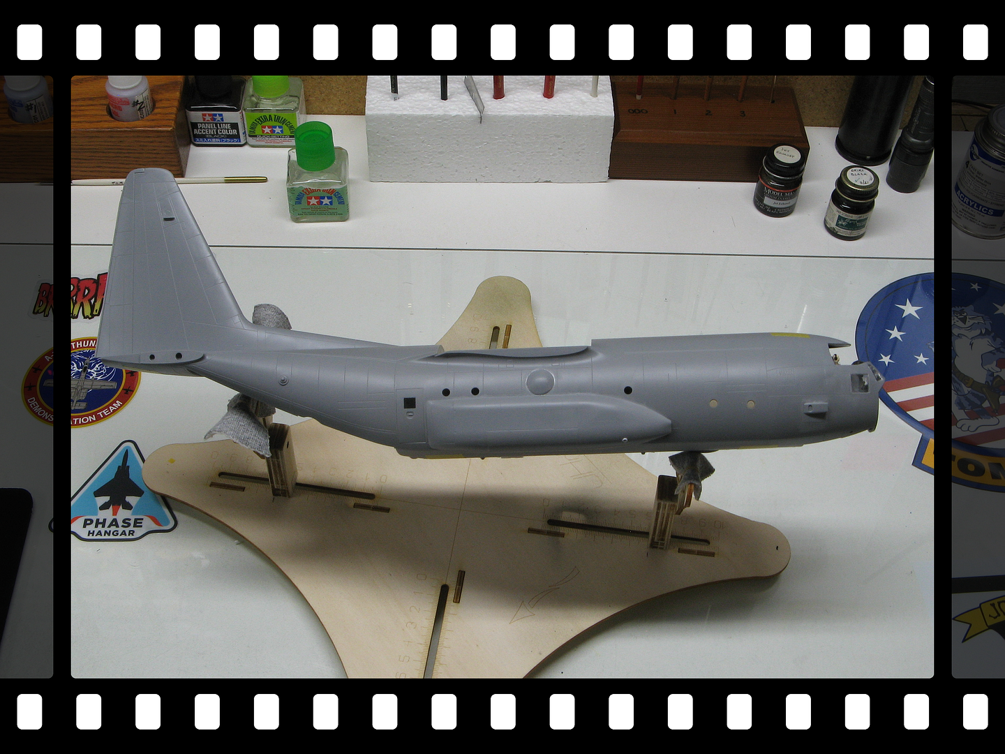

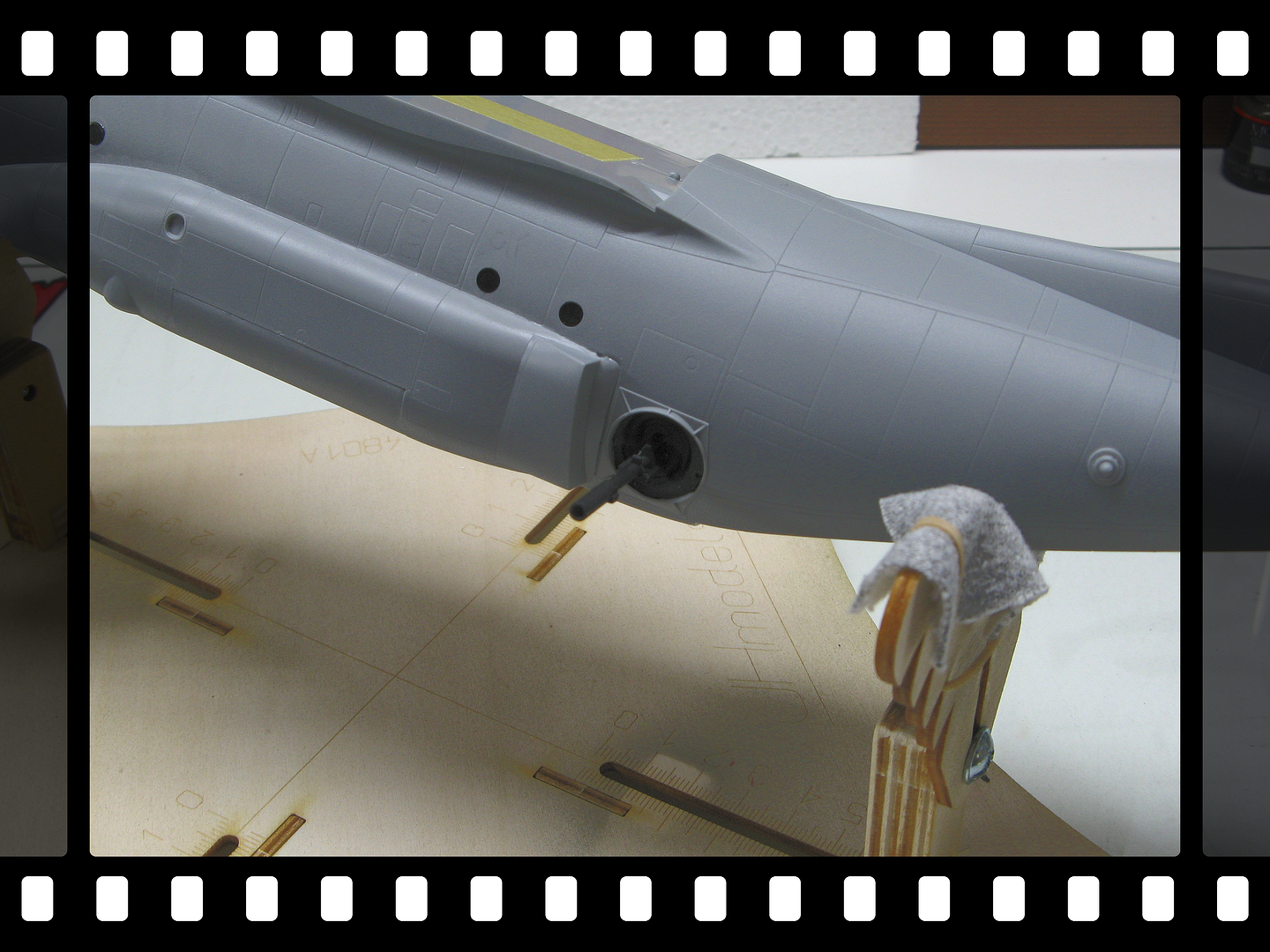

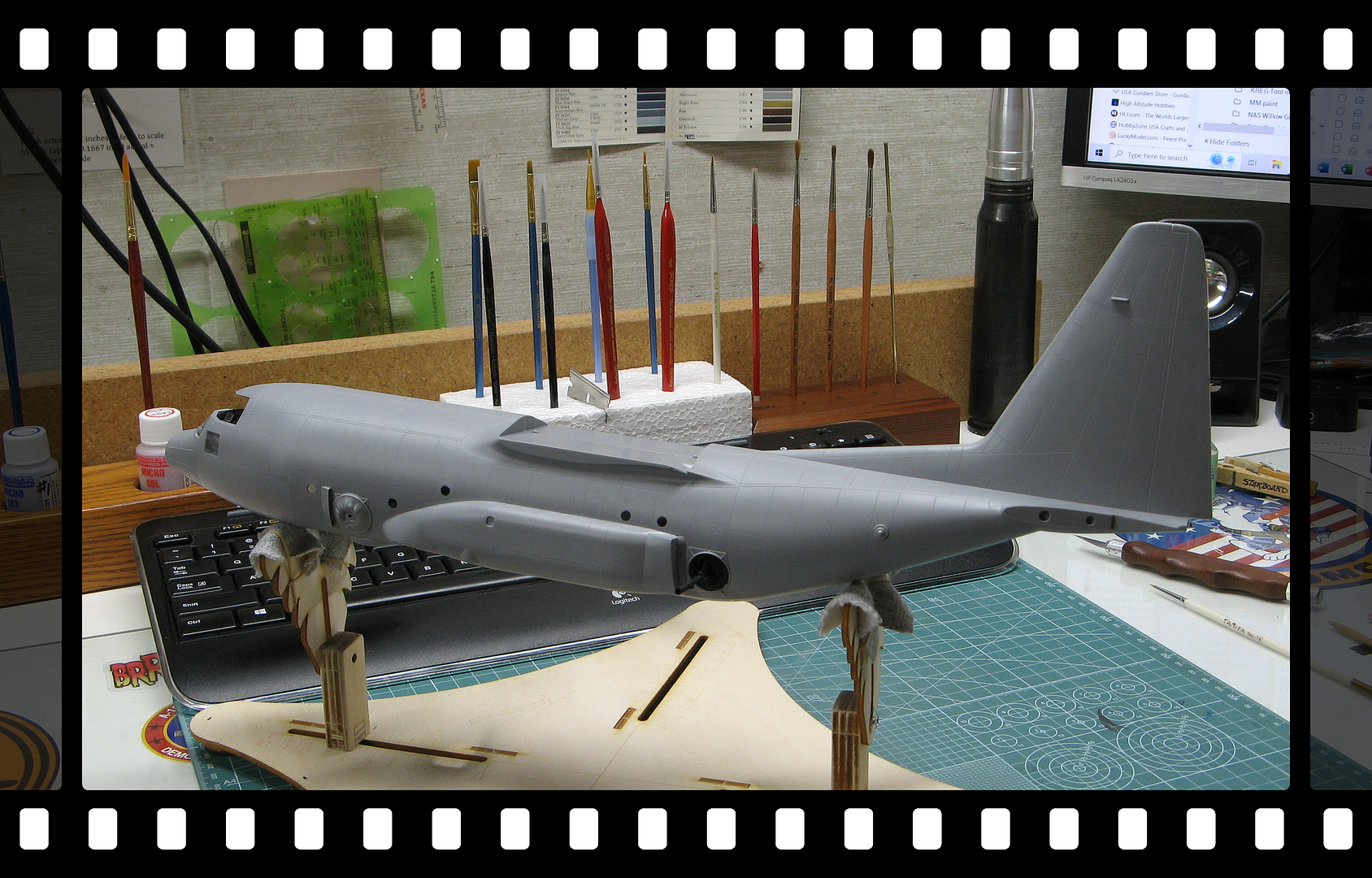

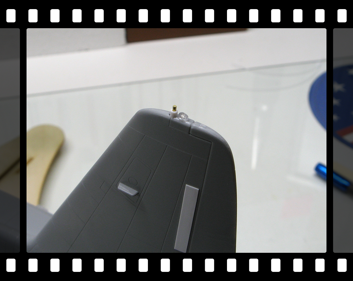

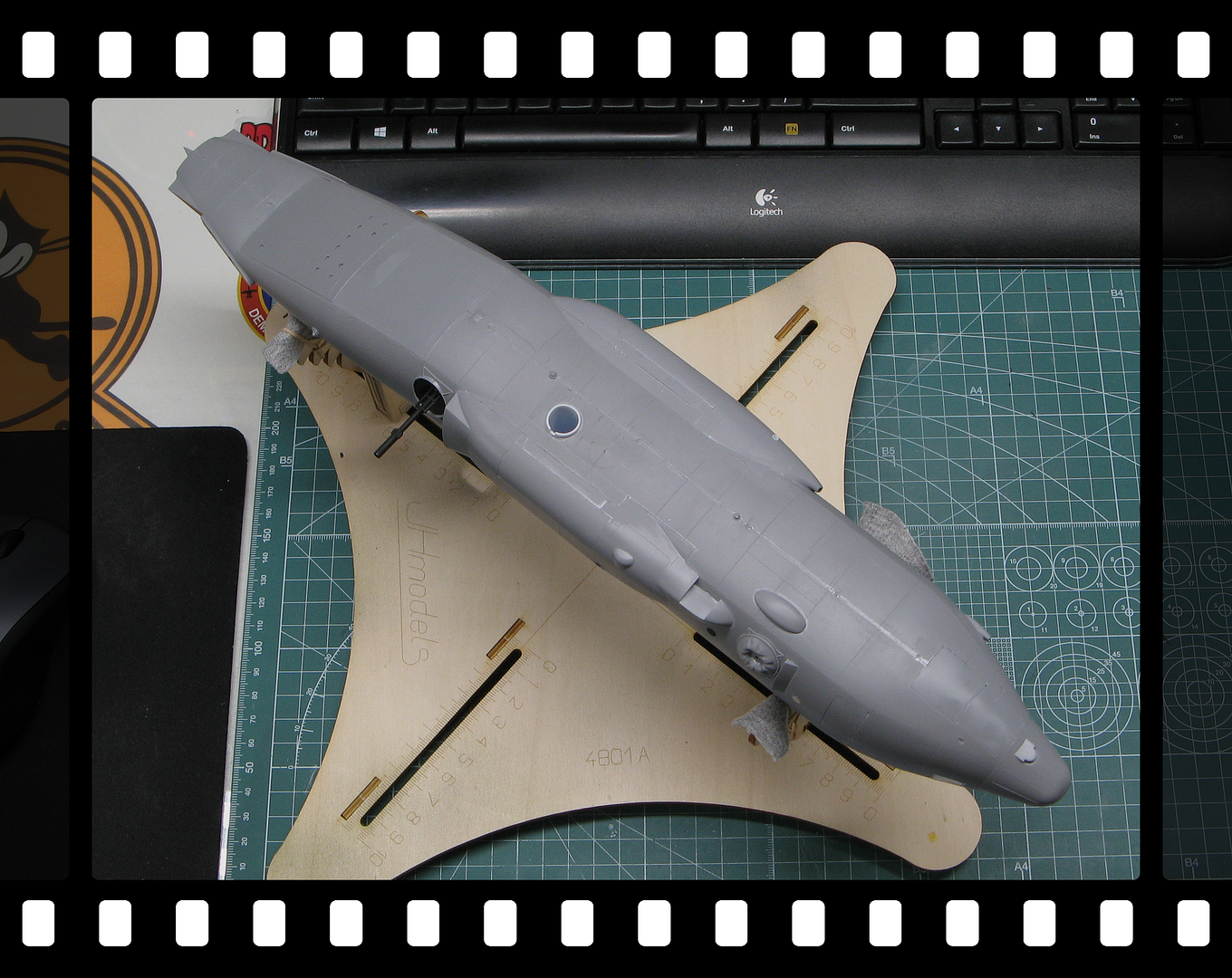

A-10 LOADER Posted September 11, 2023 Author Share Posted September 11, 2023 (edited) With all the seams addressed I started on the fuselage modifications. I wasn't really sure if I was going to tackle this but, here we are. My reference pics show a lot of reinforced areas on the AC-J's. I used Evergreen .010" sheet plastic, which I sanded down slightly with some 400 grit, before applying the pieces. I'll sand them down a little more before the primer coat. There's still more to do but, I got a pretty good jump on the air-frame today. I'm hoping my replacement windshield shows up soon. Steve I added the anti collision light to the top of the tail so I could gauge the height of the tail antenna ??, I believe that's what it is. This was made using a section of 1/16" rod that I drilled and added a piece of .031" brass wire then drilled the tail and glued it in place. Edited September 12, 2023 by A-10 LOADER Quote Link to post Share on other sites
