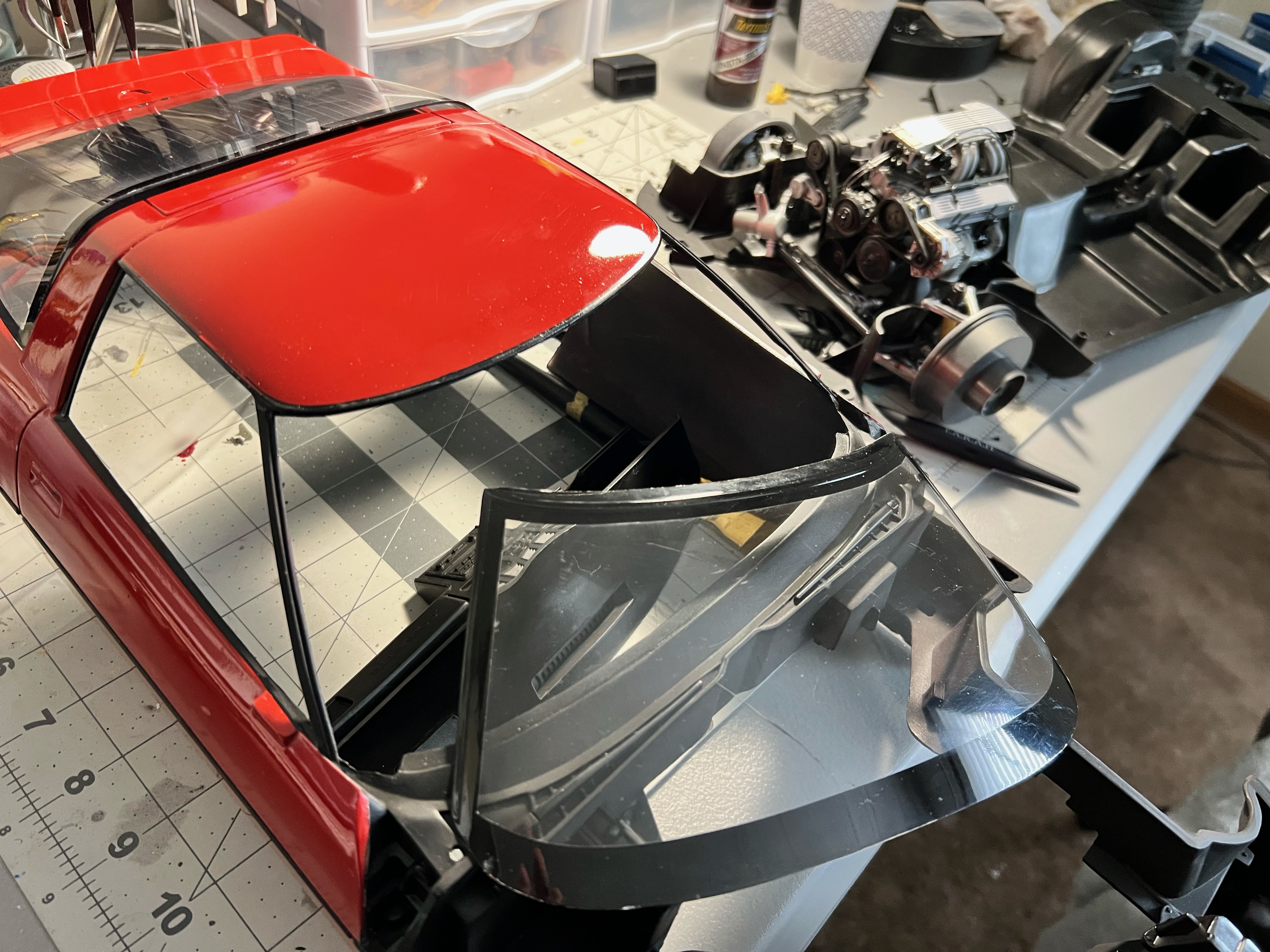

Boomstick Posted August 15 Share Posted August 15 Hello all. Hopefully someone still browses this category. I'm working on Monogram's 1/8 1985 Corvette and need some advice on gluing in the windshield and hatch glass. This is thick plastic and they don't fit perfectly. What adhesives work best in this situation, not wanting to fog the clear plastic using CA. Any input is appreciated. Quote Link to post Share on other sites
Bob Beary Posted September 18 Share Posted September 18 I'd use good old Elmers white glue. Or Formula 560 canopy glue. RC modelers use that. I think it is just a thicker version of Elmers. Bob Quote Link to post Share on other sites
Drifterdon Posted November 27 Share Posted November 27 I've used 5-minute epoxy. I'll tape it in place and tack corners down. Once the epoxy dries, you can then use the canopy glue on the rest to firmly seal it in place. Quote Link to post Share on other sites
