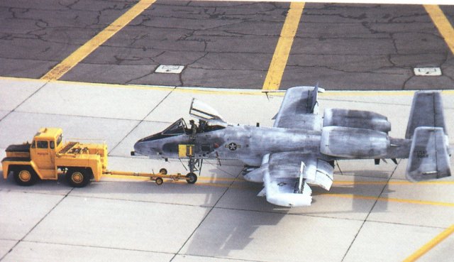

Wild Weasel V Posted October 7, 2023 Share Posted October 7, 2023 While the answers above refer to the JAWS exercise schemes, the OP is referring to one of the early evaluation schemes as used on aircraft 73-1668 and 73-1669. This is the picture of 73-1668 linked in the first post (73-1669 had an assymetric scheme with the right wing darker than the left and only the lightest grey on the forward fuselage): As has been mentioned these were created by applying white at various densities over a black layer. The Detail & Scale book 'Colors & Markings of the A-10 Warthog' Vol 24 has lots of information on the early schemes and has the patterns for both 73-1668 & '69 along with the levels of spray over and paint thicknesses. These are (lightest to darkest): 60% Grey (1.0-1.1 mils white thickness) 50% Grey (0.5-0.7 mils white thickness) 40% Grey (0.25-0.33 mils white thickness) These aren't the same as the MASK 10A greys used on the early production A-10s which were based on a reflectance value of 30% and 50% to achieve solid grey tones. These were unique to the A-10 and didn't have Federal Standard numbers, being specified by Fairchild Republic themselves. When the scheme was re-adopted to replace Euro 1 the nearest equivalent FS 'Ghost Grey' shades were used. I've often wondered how to achieve the different shades and thought of trying the same approach by misting white over black to build up the desired tones, but haven't drummed up the will to tackle it. As mentioned, the approach used for weathered TPS is probably the way to go to get to the finished look. HTH, Jonathan Quote Link to post Share on other sites

paulsbrown Posted October 9, 2023 Share Posted October 9, 2023 On 10/7/2023 at 2:15 PM, Wild Weasel V said: While the answers above refer to the JAWS exercise schemes, the OP is referring to one of the early evaluation schemes as used on aircraft 73-1668 and 73-1669. My bad, I got excited with the topic. On 10/7/2023 at 2:15 PM, Wild Weasel V said: I've often wondered how to achieve the different shades and thought of trying the same approach by misting white over black to build up the desired tones, but haven't drummed up the will to tackle it. As mentioned, the approach used for weathered TPS is probably the way to go to get to the finished look. I have considered this scheme with another Tamiya that I have been preparing. I thought that the white over black could be gently built up with the airbrush but to avoid the soft 'look' of airbrushing (and those airframes' paint jobs had a rough and weathered look) one could do some fine grade sanding over the layers of white. Perhaps starting with a good strong lacquer type black primer base with a weaker acrylic white sprayed on top to aid in the 'roughing up' process and losing the fuzzy all airbrush look. Quote Link to post Share on other sites

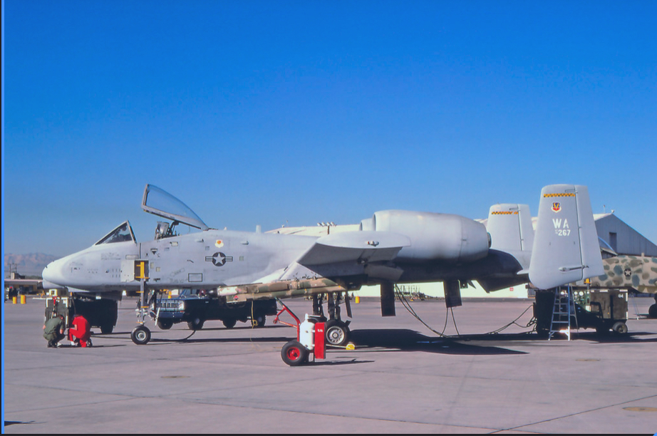

paulsbrown Posted October 17, 2023 Share Posted October 17, 2023 4 hours ago, Spinnaker said: What about an A-10 in the MASK scheme with an AN/ALQ-119 in the JAWS spots? Good photo and another scheme(?) it seems if my photo below is the same aircraft. I'm more likely to build this scheme highly weathered than the mottled finish. This time add differently spotted Maverick and AN/ALQ-119. Quote Link to post Share on other sites
