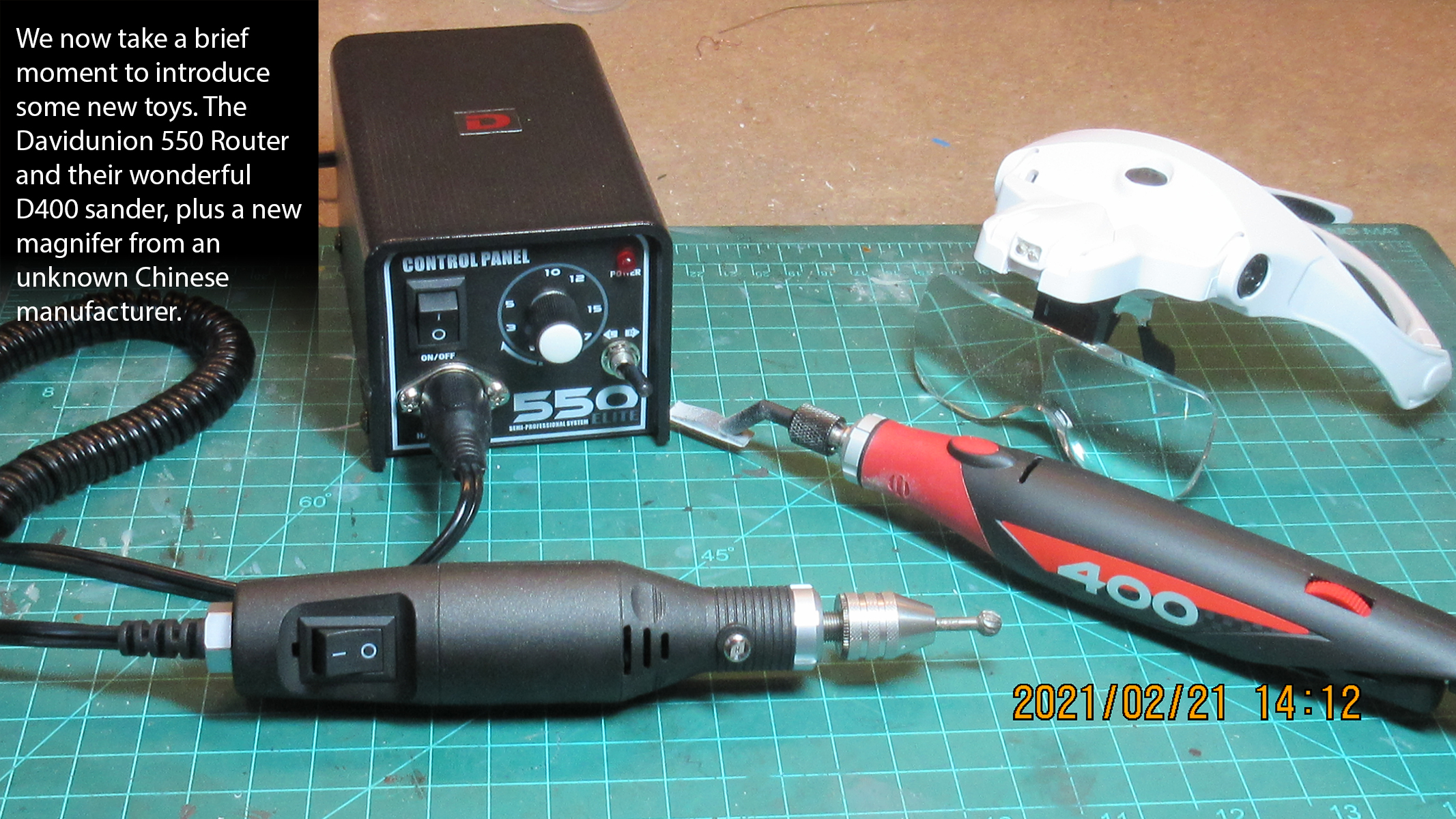

chukw Posted October 7, 2023 Share Posted October 7, 2023 David Union Router with speed control- best motor tool I've ever used. The reciprocating sander is a go-to also! Quote Link to post Share on other sites

chukw Posted October 15, 2023 Share Posted October 15, 2023 3 minutes ago, breadneck said: This one looks very interesting.. https://www.ebay.com/itm/284148278673?hash=item42288ea591:g:~9oAAOSw3Ate0uzh That's the person I bought mine from- Troy Mollitor. He's an excellent seller- I'm a member at Large Scale Planes and bought directly from him. He's always ready to answer any questions you might have about the products. Quote Link to post Share on other sites
