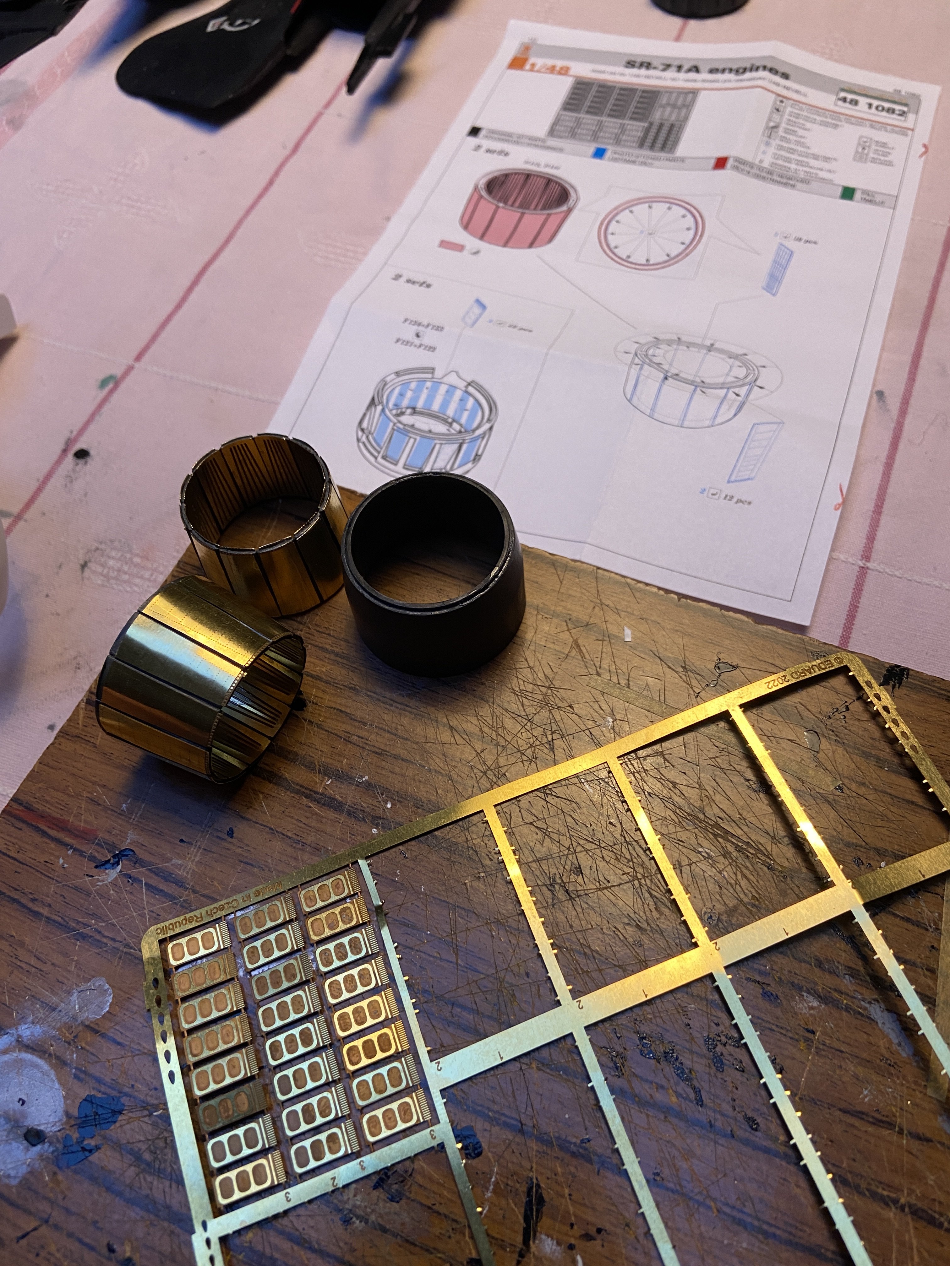

BastianD Posted December 23, 2023 Author Share Posted December 23, 2023 Two burner cans ready with metal etched parts. Now the inside to be done. Quote Link to post Share on other sites

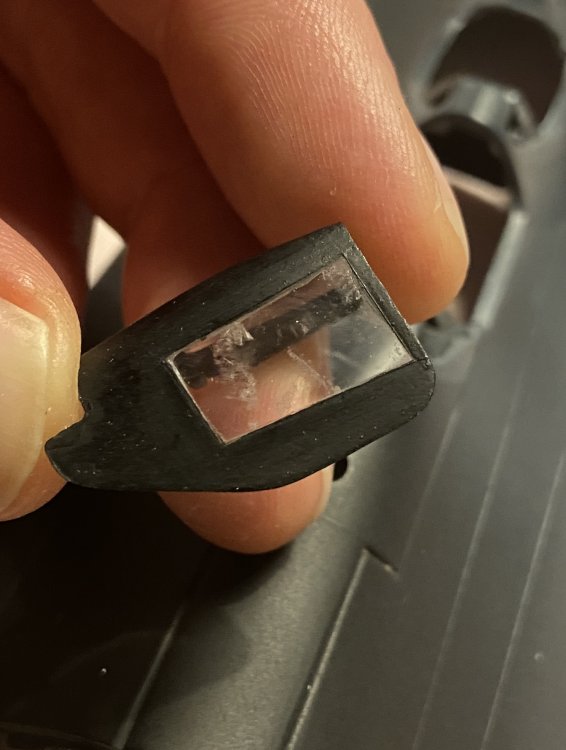

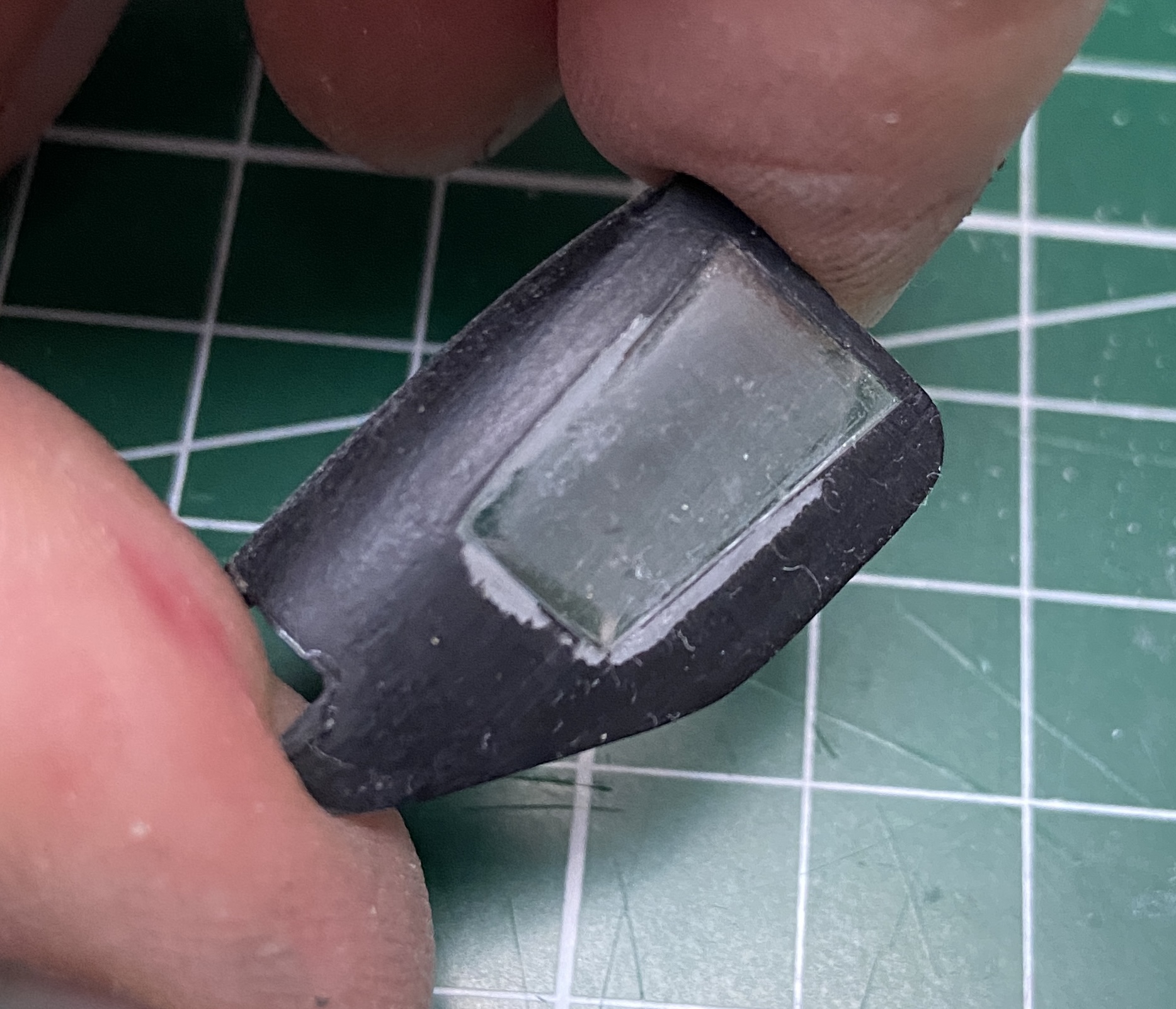

BastianD Posted December 27, 2023 Author Share Posted December 27, 2023 Front canopy has some glue stains on it, see picture. Any advice how to get rid of this, sanding it off and rework with multiple grades of sanding paper and finally making it gloss with polishing compound? Quote Link to post Share on other sites
Robert Garelli Posted December 27, 2023 Share Posted December 27, 2023 Sand it down with polishing pads and then buff it with some wax. That’s what I normally do. Quote Link to post Share on other sites
my favs are F`s Posted December 27, 2023 Share Posted December 27, 2023 33 minutes ago, BastianD said: ...sanding it off and rework with multiple grades of sanding paper and finally making it gloss with polishing compound? Yep, that's it. And maybe some rescribing, depending on how deep is the glue/you need to sand... Assuming it is CA glue. Quote Link to post Share on other sites
BastianD Posted December 28, 2023 Author Share Posted December 28, 2023 Thanks guys, it is CA glue Quote Link to post Share on other sites

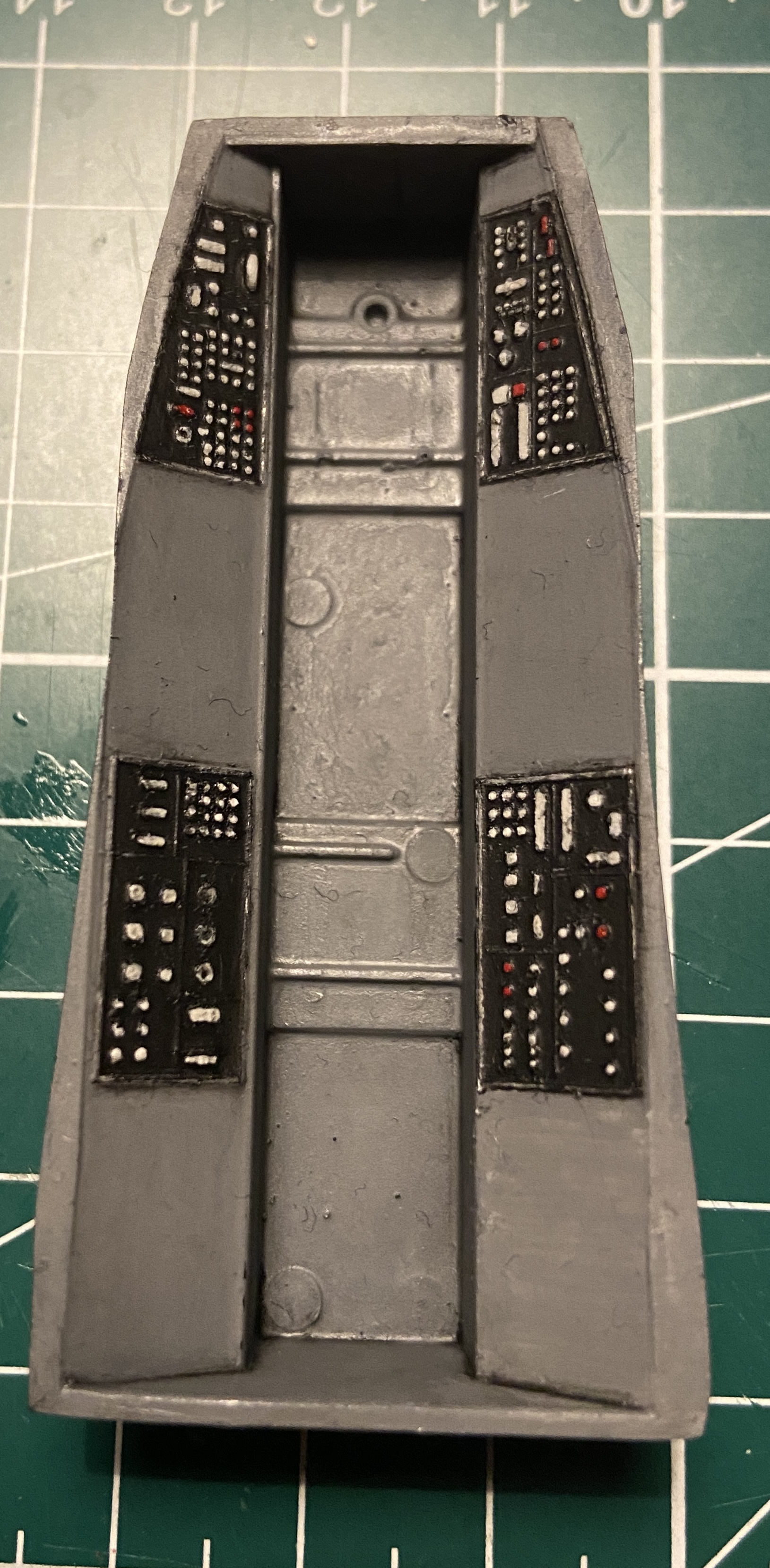

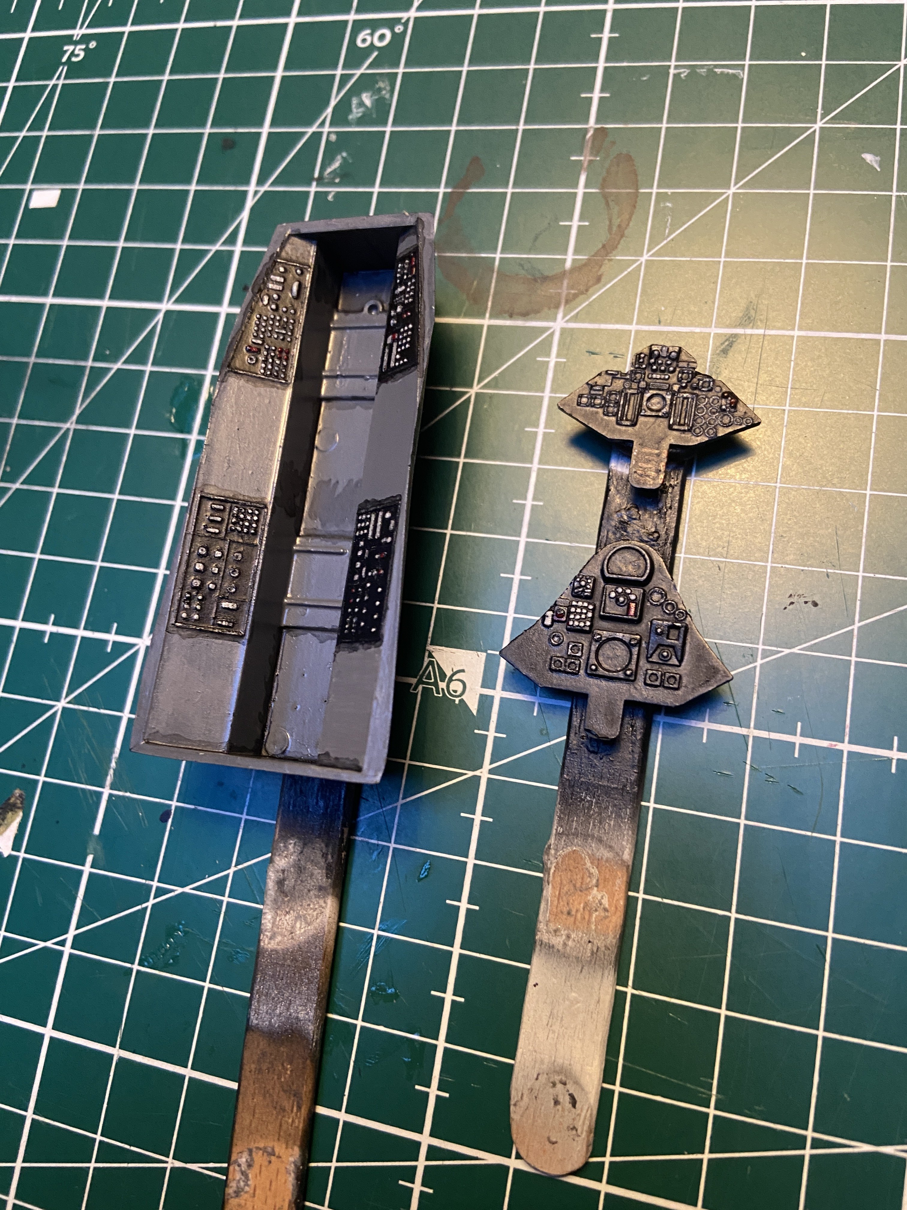

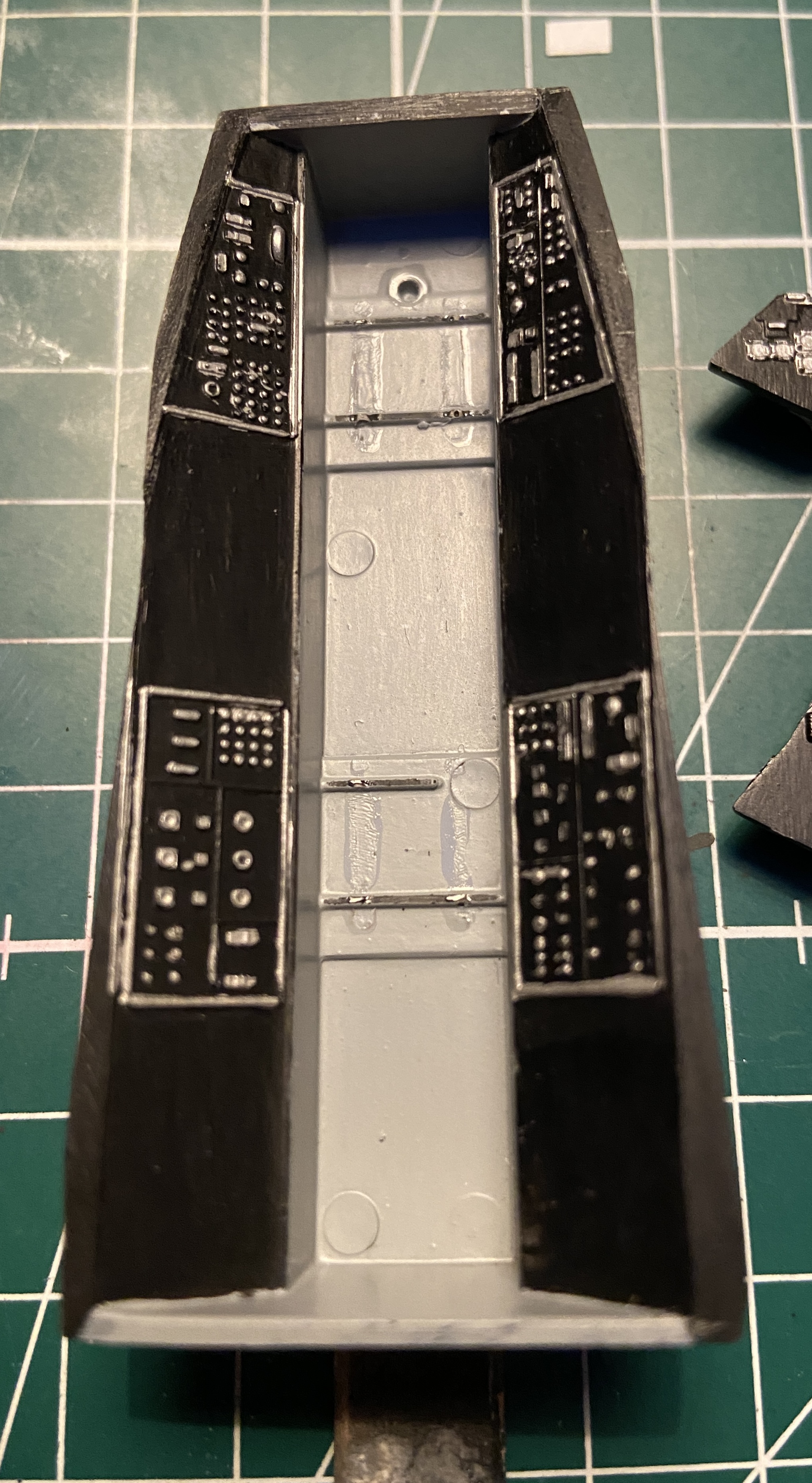

BastianD Posted December 28, 2023 Author Share Posted December 28, 2023 Cleaning up the panels and the tub after the wash on a gloss coat Quote Link to post Share on other sites
BastianD Posted December 28, 2023 Author Share Posted December 28, 2023 Added some liquid mask on the screens, to protect the gloss for a matte coat on the panels. Quote Link to post Share on other sites

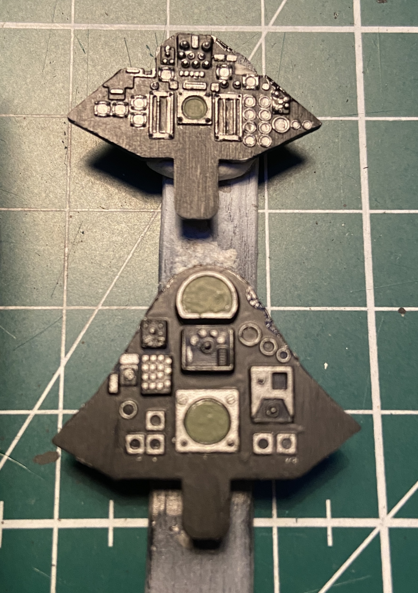

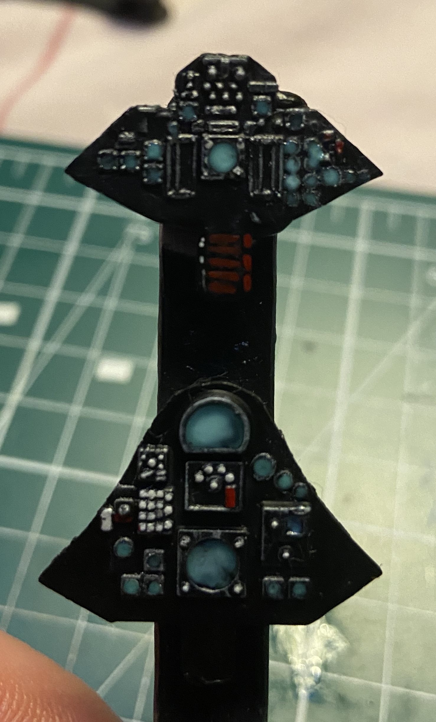

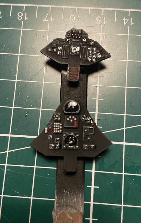

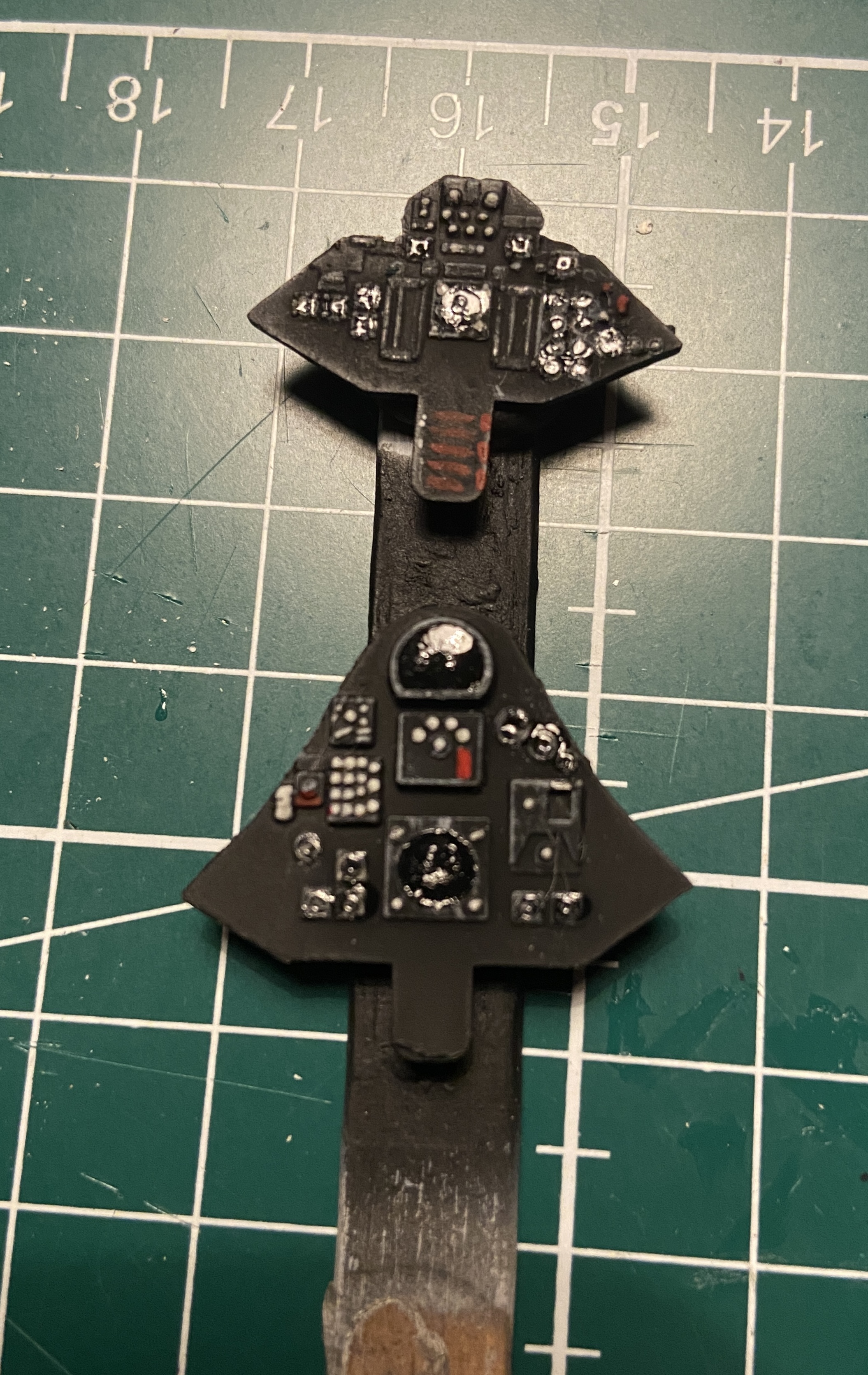

BastianD Posted December 29, 2023 Author Share Posted December 29, 2023 Cockpit panels done: old vs new Quote Link to post Share on other sites
BastianD Posted December 29, 2023 Author Share Posted December 29, 2023 Tub also ready, seats and stick to be placed later. old vs new: Quote Link to post Share on other sites

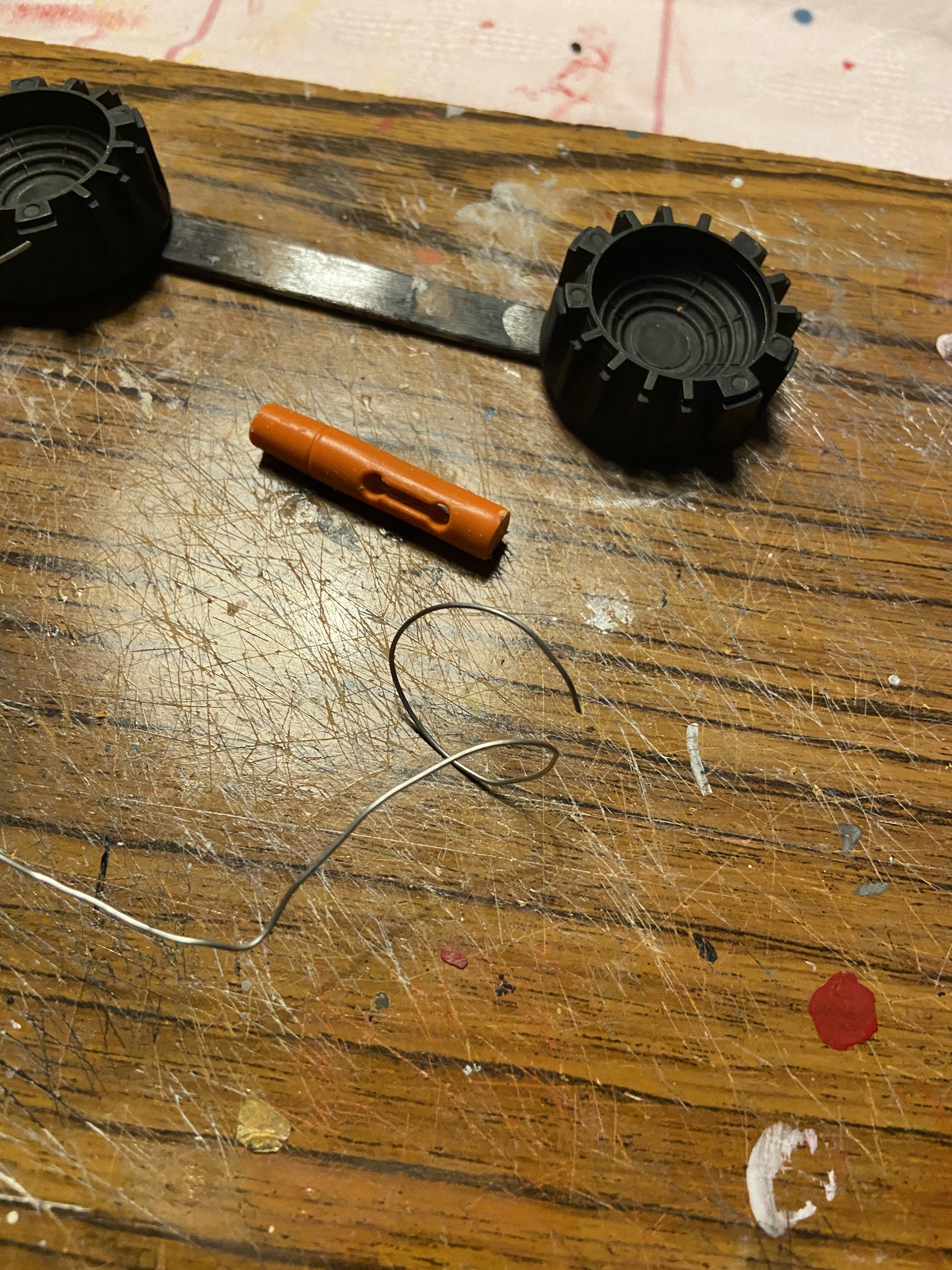

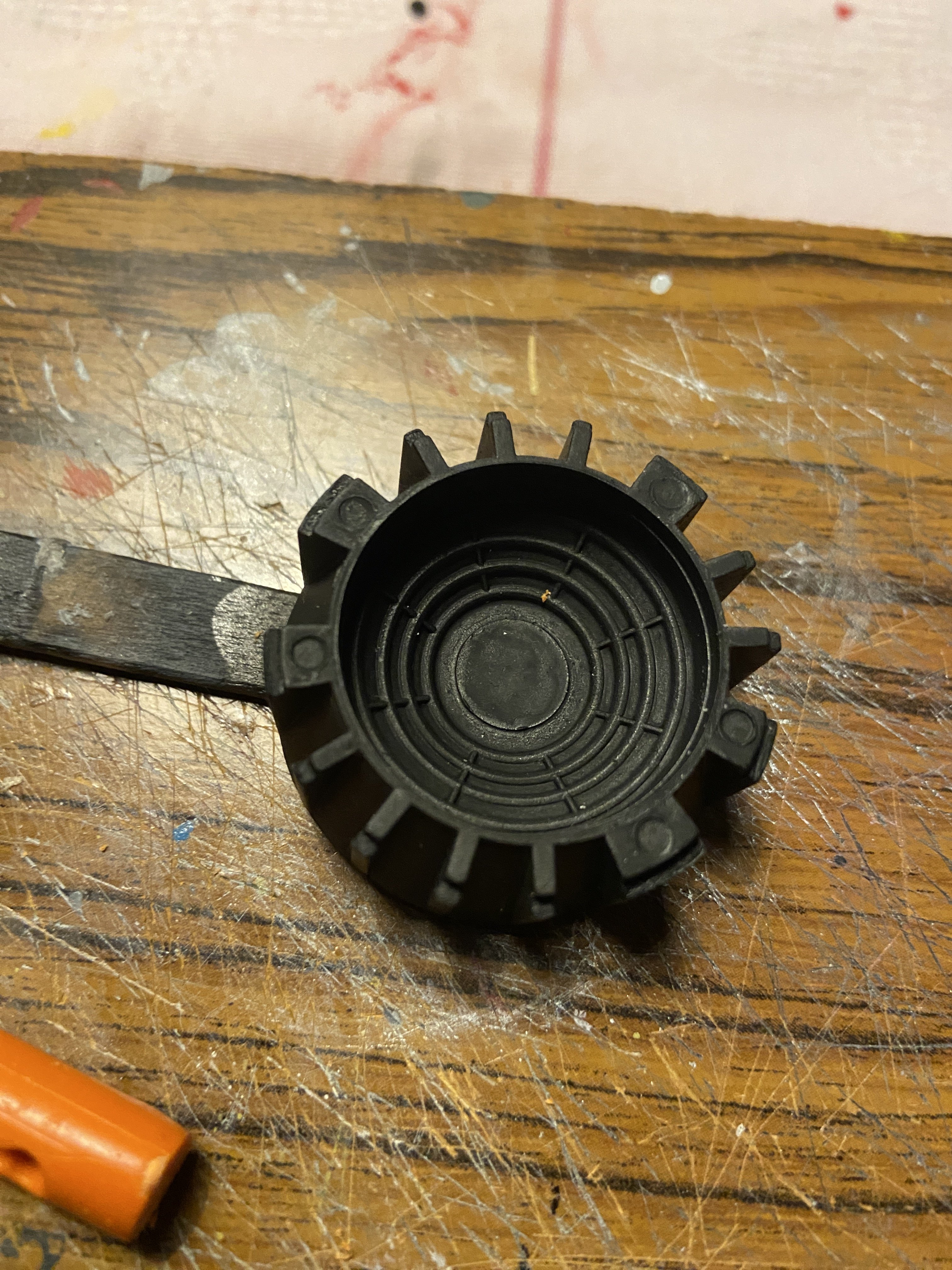

BastianD Posted January 6, 2024 Author Share Posted January 6, 2024 Working on the interior of the exhaust, it lacks the bright rings and the small cone as on example pictures. trying to replicate this with wiring and a scratch built cone. Quote Link to post Share on other sites
dsahling Posted January 10, 2024 Share Posted January 10, 2024 Use "Great Planes CA Glue Debonder" put a little on a q-tip and you may have to rub/roll it over the CA glue for a while but it will remove the CA glue and won't damage the plastic. Just make sure you don't apply it over paint cause it will remove that too, but it's easy enough to just remark, prime, paint, etc. stuff works like a charm and really comes in handy. On 12/28/2023 at 2:28 AM, BastianD said: Thanks guys, it is CA glue Quote Link to post Share on other sites
utley Posted January 10, 2024 Share Posted January 10, 2024 you mean theres something not acetone that dissolves CA glue and nothing else??? I cant tell you how often that has driven me nuts because Ive destroyed nary a part -resin or otherwise. Quote Link to post Share on other sites

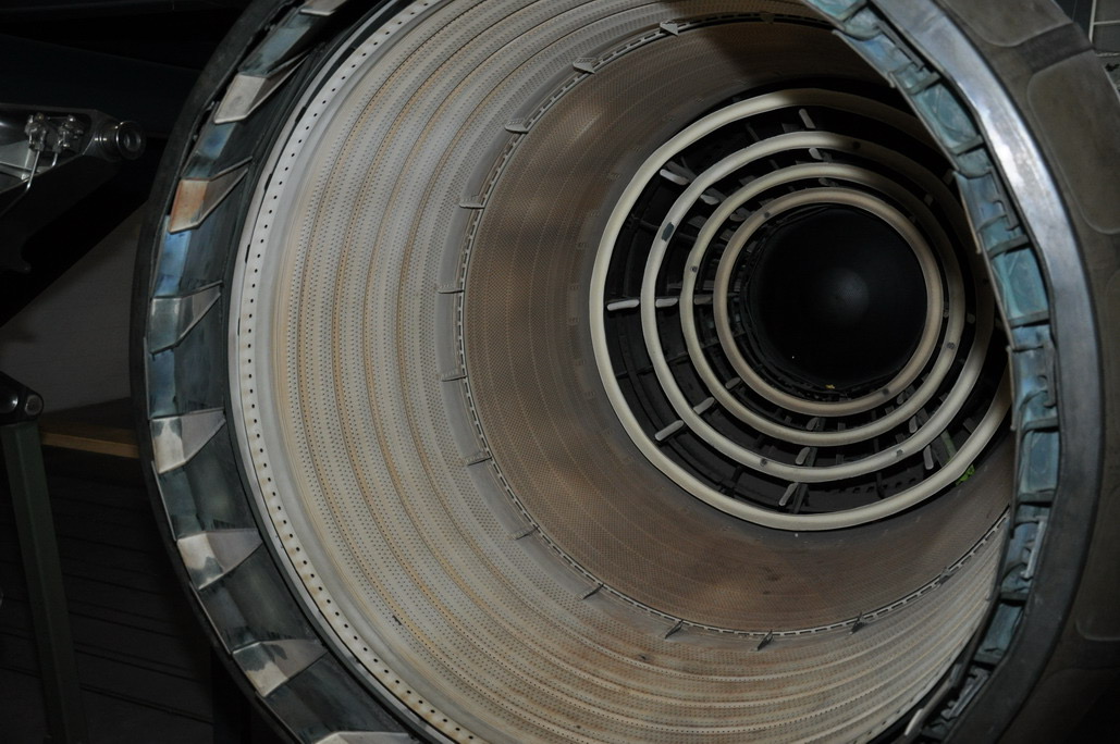

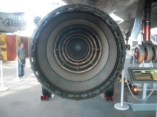

BastianD Posted January 17, 2024 Author Share Posted January 17, 2024 Who knows the exact colour of the exhaust exterior? Should not be burnt metal, looks on pictures more like matte black? Quote Link to post Share on other sites
ExchefAndy Posted January 17, 2024 Share Posted January 17, 2024 I've been using a walk around on prime portal, and the pictures there look to me as though the colour is a consistent matte black. See link below! It's what I'll be doing once I've gotten past the fill, sand and prime process. HTH Andy http://www.primeportal.net/hangar/luc_colin3/sr-71_17959/ Quote Link to post Share on other sites
habu2 Posted January 17, 2024 Share Posted January 17, 2024 I posted a ton of pics in this thread, including the engine: Quote Link to post Share on other sites
BastianD Posted January 18, 2024 Author Share Posted January 18, 2024 10 hours ago, ExchefAndy said: I've been using a walk around on prime portal, and the pictures there look to me as though the colour is a consistent matte black. See link below! It's what I'll be doing once I've gotten past the fill, sand and prime process. HTH Andy http://www.primeportal.net/hangar/luc_colin3/sr-71_17959/ Really great help, many thanks! Quote Link to post Share on other sites
BastianD Posted January 18, 2024 Author Share Posted January 18, 2024 10 hours ago, habu2 said: I posted a ton of pics in this thread, including the engine: Also very helpful stuff! Very much appreciated, as it also contains lots of details of landing gear and bays and engine interior. Quote Link to post Share on other sites
davetur Posted January 18, 2024 Share Posted January 18, 2024 18 hours ago, habu2 said: I posted a ton of pics in this thread, including the engine: Wonderful set of pictures! I missed it in the Research Corner at the time you published. Thank you Davide Quote Link to post Share on other sites

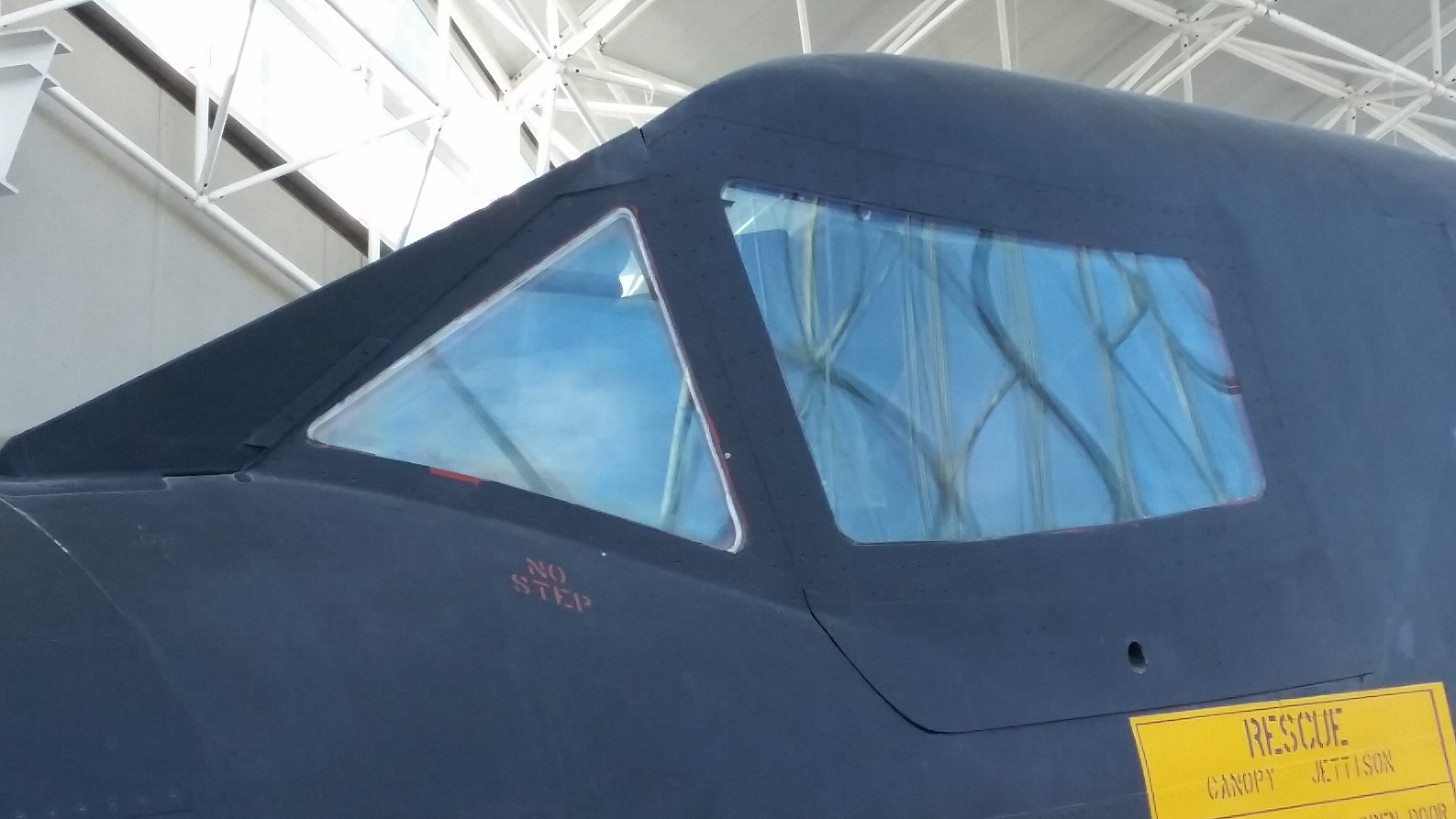

davetur Posted January 18, 2024 Share Posted January 18, 2024 Hi Bastian, from this pic in that wondeful thread, you see a major inaccuracy of the Testors/Italeri kit: the intersection of the triangular windscreen with the nose is straight and horizontal, instead of curved and going downward as it should be. Not an easy fix, though. Davide Quote Link to post Share on other sites

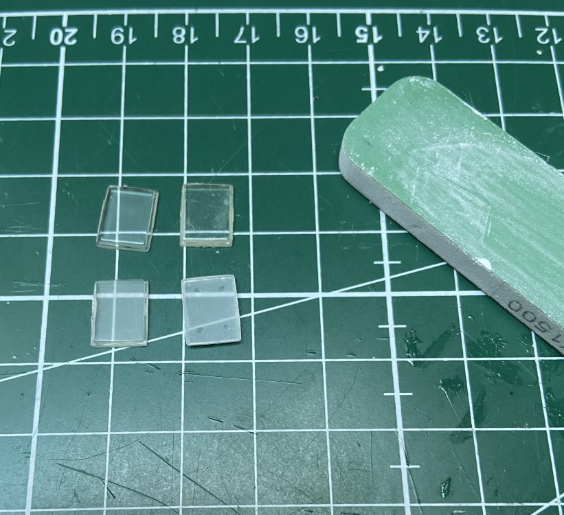

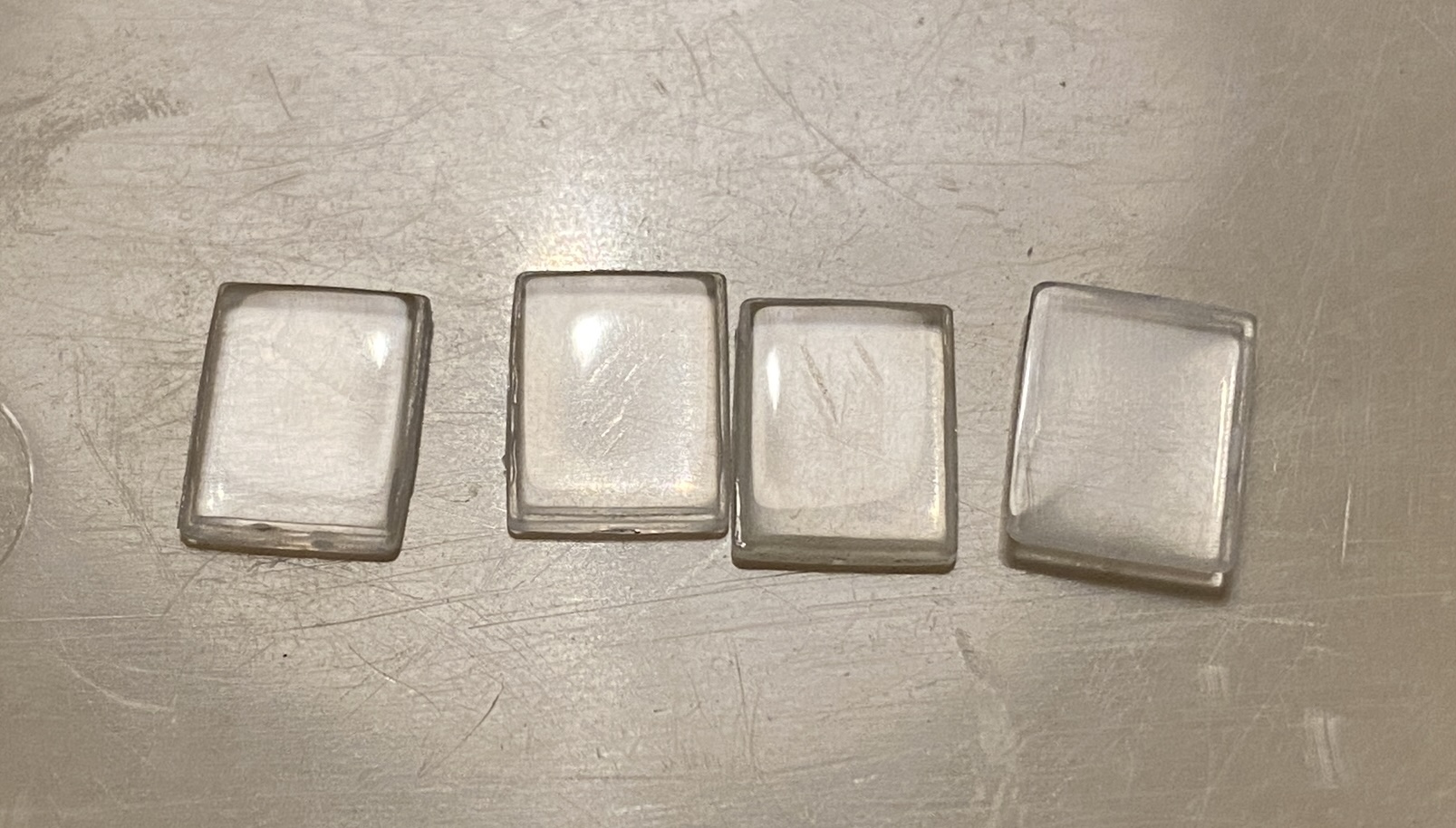

BastianD Posted January 20, 2024 Author Share Posted January 20, 2024 Reworking the glass screens for the cameras, get rid of all old glue strings and scratches Quote Link to post Share on other sites
BastianD Posted January 20, 2024 Author Share Posted January 20, 2024 Followed by the front canopy as well, to get rid of glue spots from the past Quote Link to post Share on other sites
BastianD Posted January 24, 2024 Author Share Posted January 24, 2024 Camera screens have been sanded and sanded and sanded, grit to grit and finally polished. Smooth as melted butter again. Just dipping them in Pledge before glueing them in place. Quote Link to post Share on other sites
