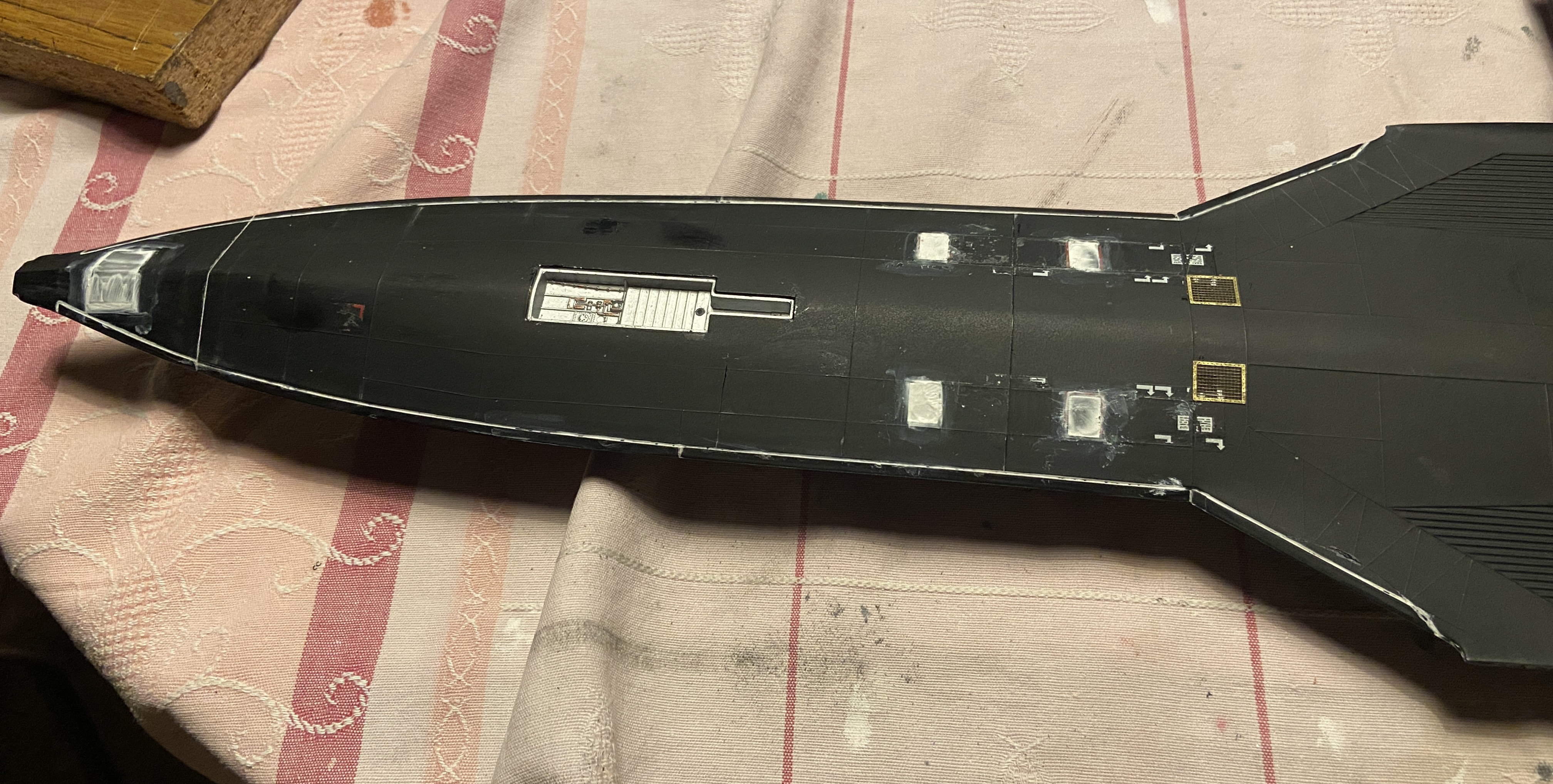

BastianD Posted February 15, 2024 Author Share Posted February 15, 2024 Getting her back in shape: glueing the fuselage in several steps together again. Quote Link to post Share on other sites
BastianD Posted February 15, 2024 Author Share Posted February 15, 2024 And the repair joint for the right tail works and fits as well: Quote Link to post Share on other sites

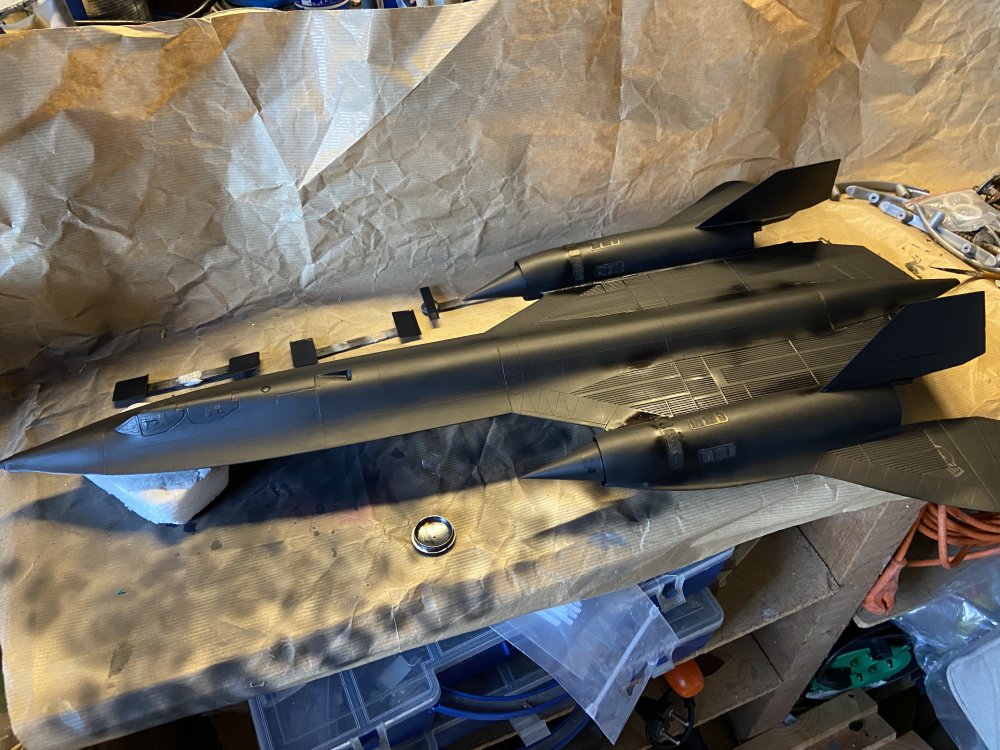

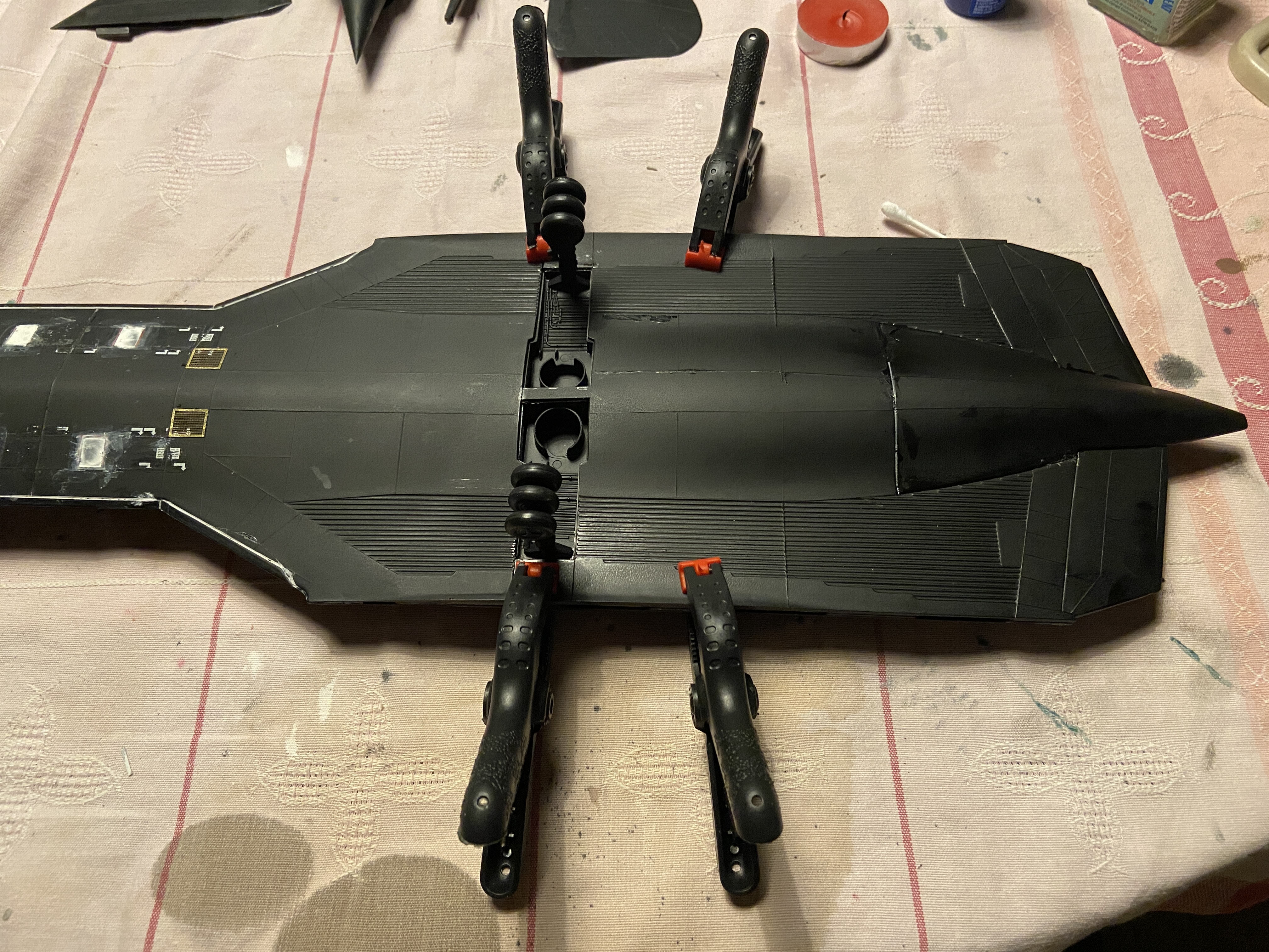

BastianD Posted February 18, 2024 Author Share Posted February 18, 2024 Both engine bays re-attached. I thought I could correct the fit of especially the right engine bay, the fit is so terribly bad. Looks like I have to start filling differently, with stretched sprue and a lot of putty. Anyway, the Sled gets her shape back. Quote Link to post Share on other sites

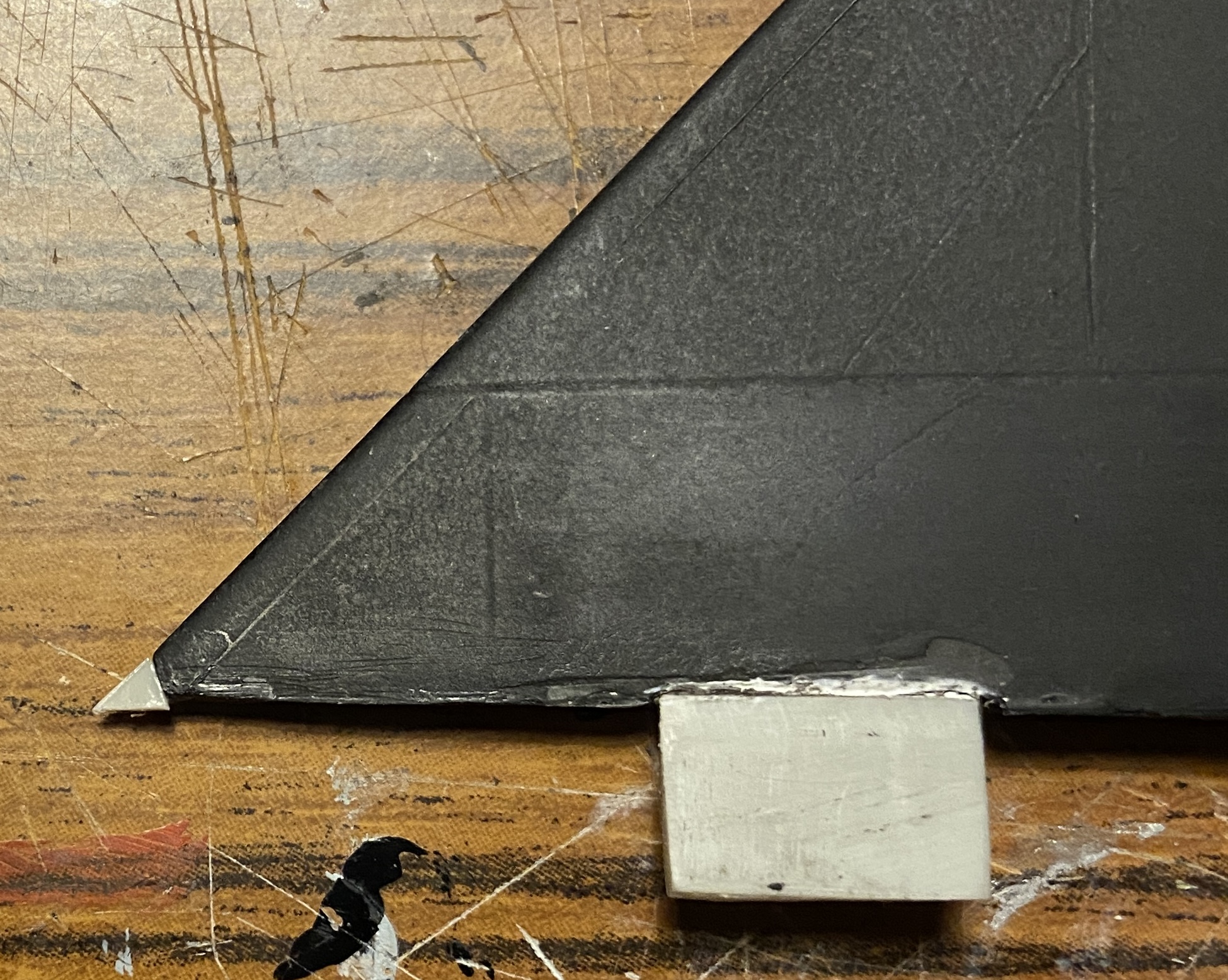

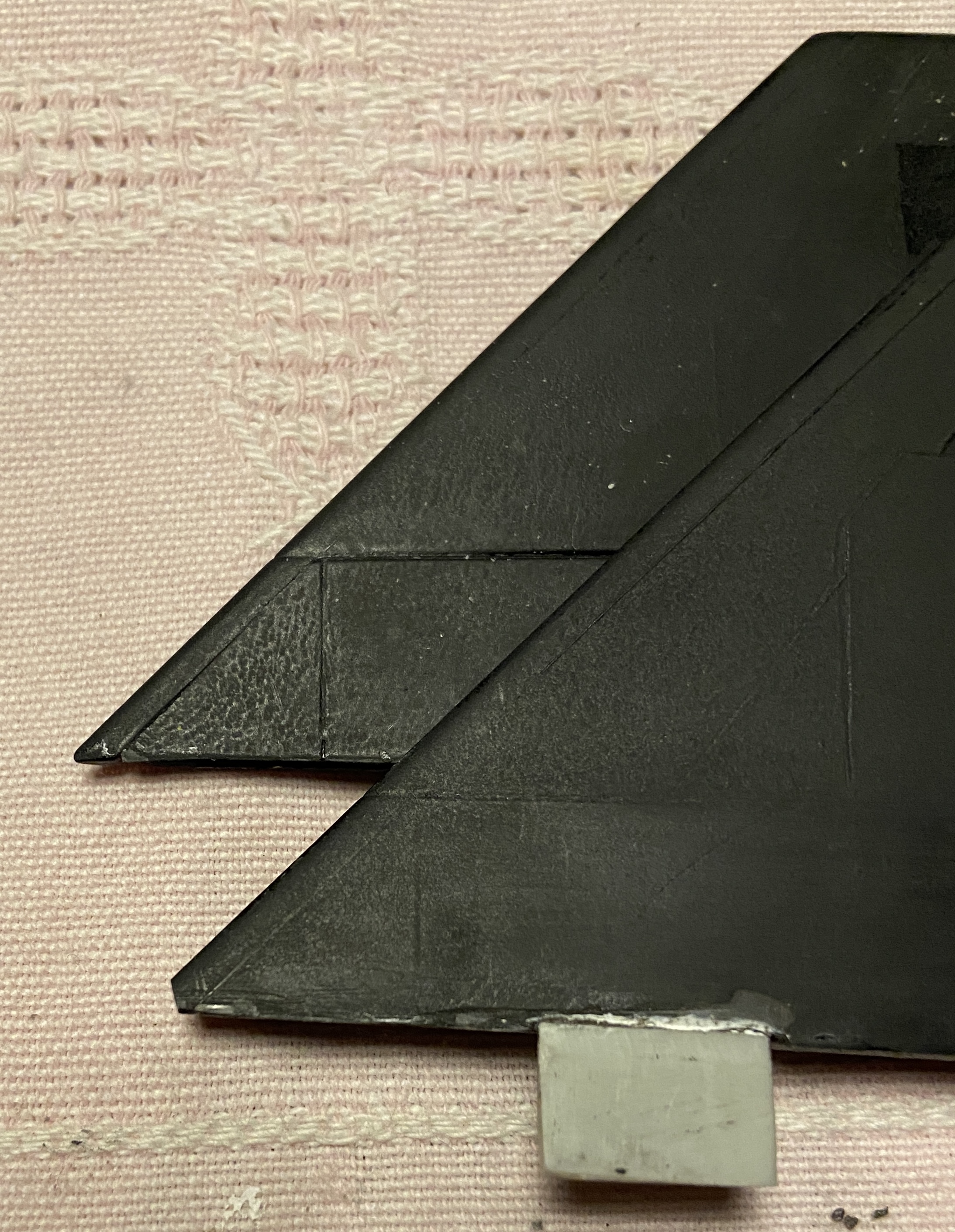

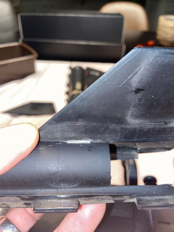

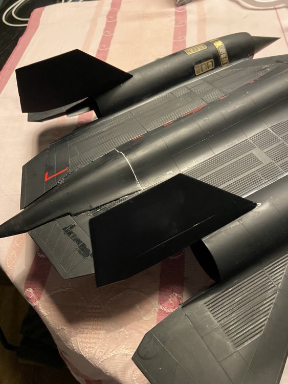

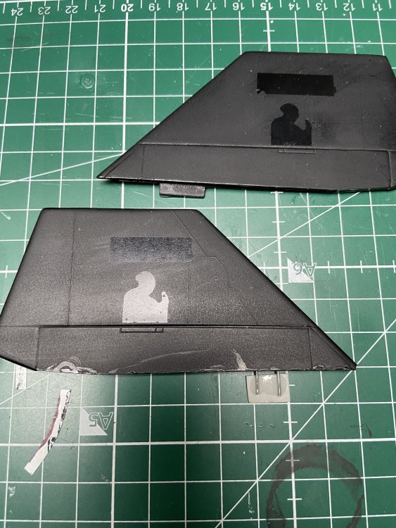

BastianD Posted February 19, 2024 Author Share Posted February 19, 2024 The right tail fin misses a piece at the front, let’s see if we can correct this. Quote Link to post Share on other sites
BastianD Posted February 19, 2024 Author Share Posted February 19, 2024 Found and used an old fin from my stash, corrected to fit. Just rescribing to get the right fit. Quote Link to post Share on other sites

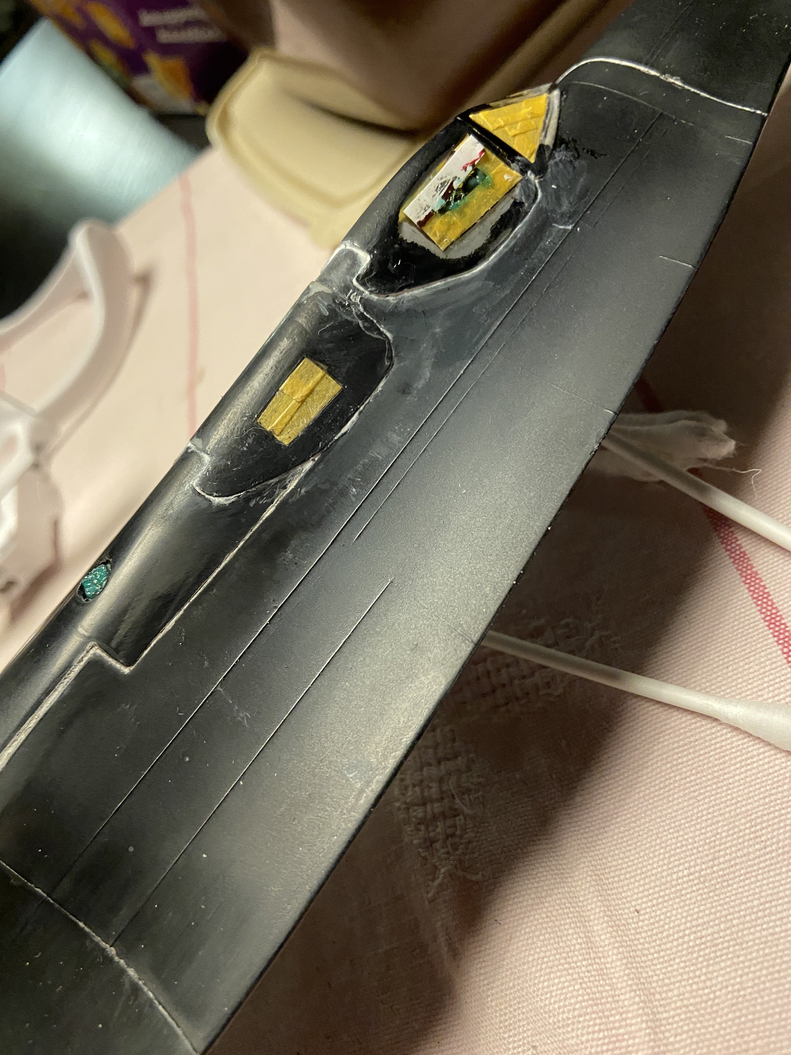

BastianD Posted February 22, 2024 Author Share Posted February 22, 2024 Short update: both tails are on, and filled the gaps with putty. Also the canopies and the windscreen have been glued on, after being masked. The gaps around the canopies have also been filled with putty. Next is a first black primer to discover any deviations and correct where needed, before really doing the right color on the Bird. Quote Link to post Share on other sites

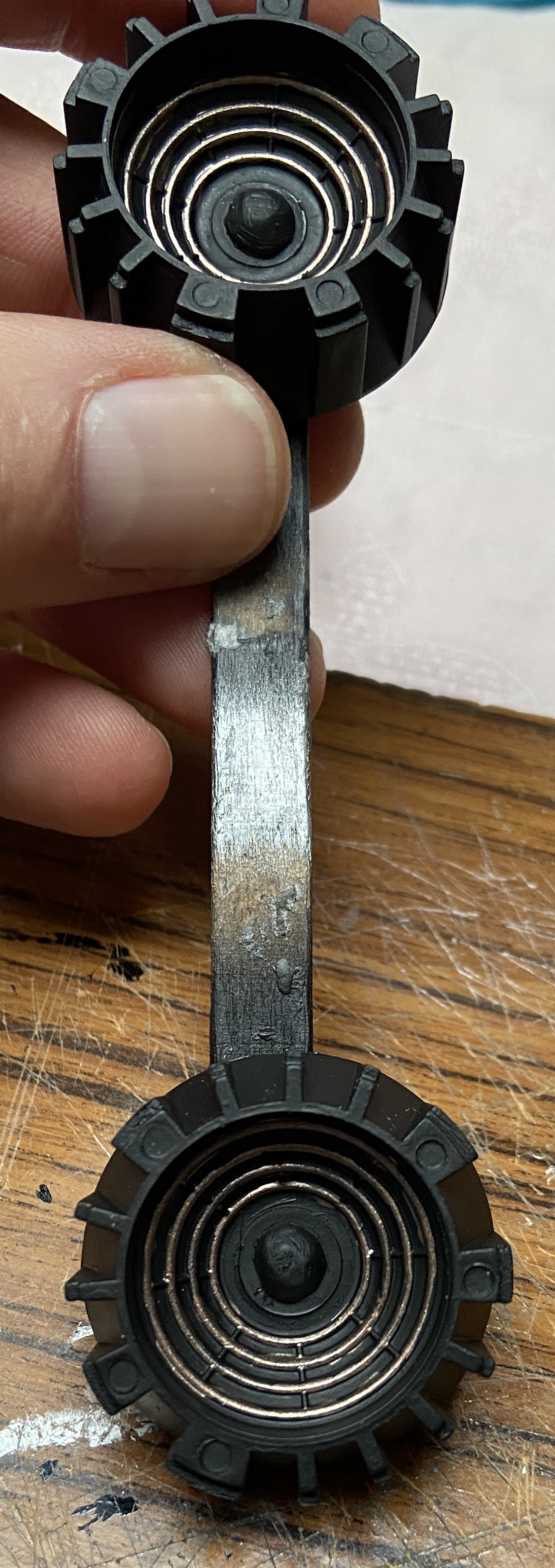

BastianD Posted February 23, 2024 Author Share Posted February 23, 2024 And started with interior of the massive engines, thanks also by watching the techniques via this YouTube: Quote Link to post Share on other sites

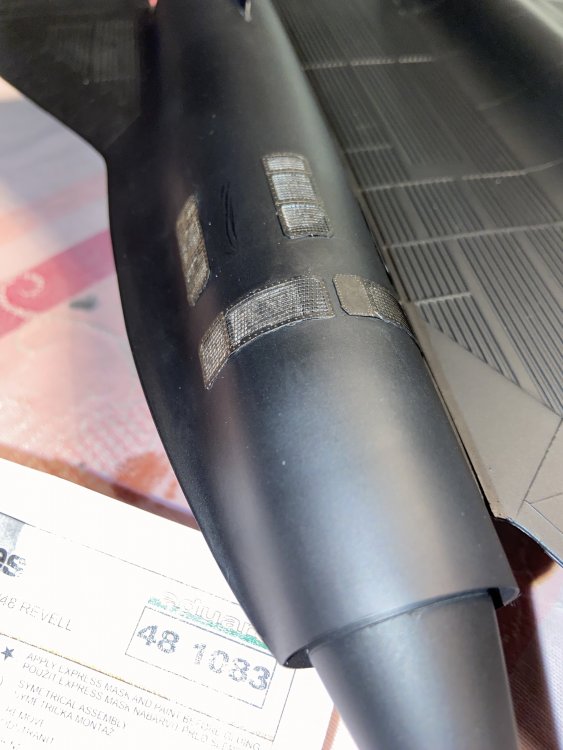

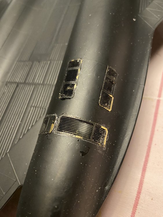

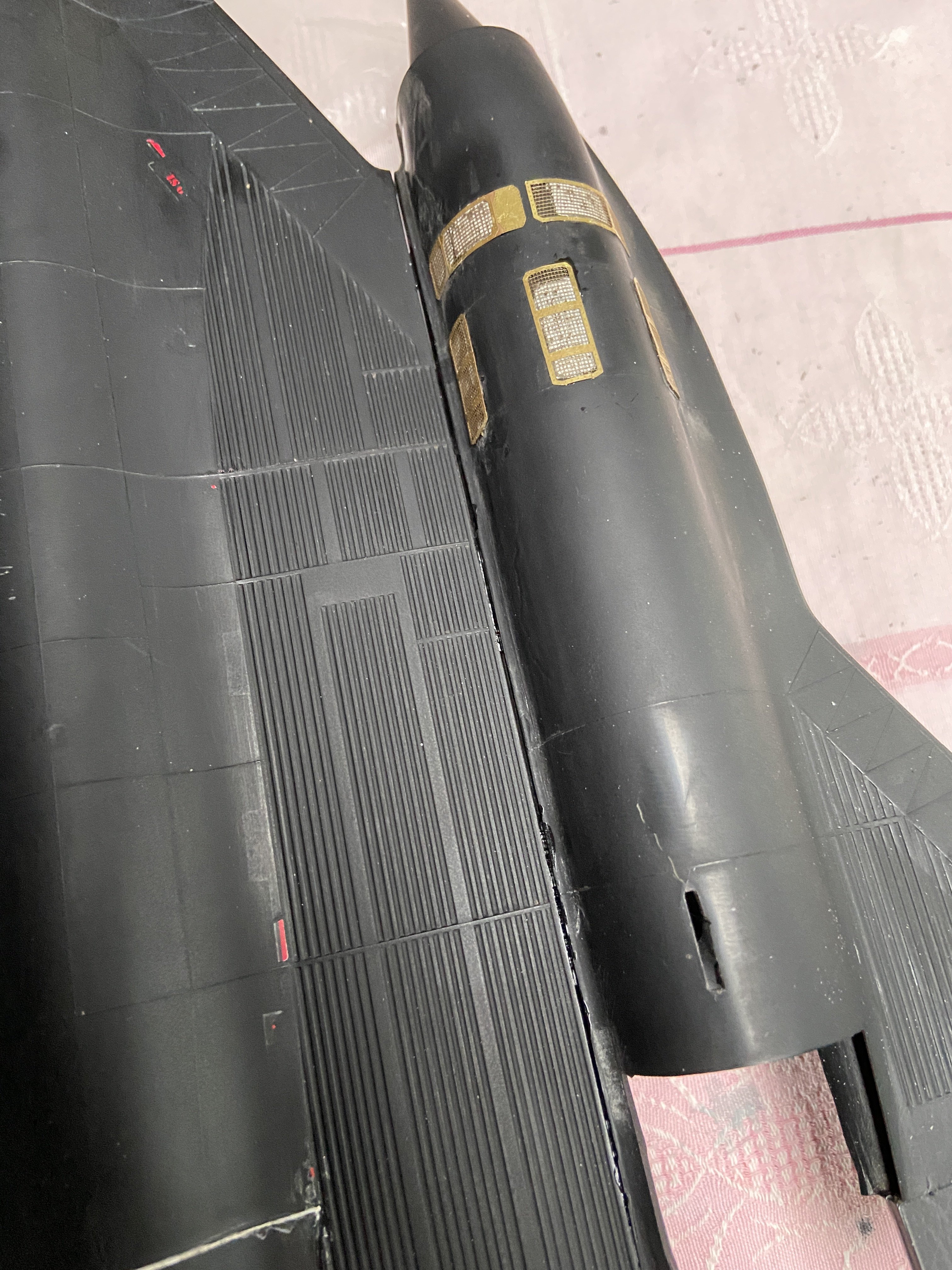

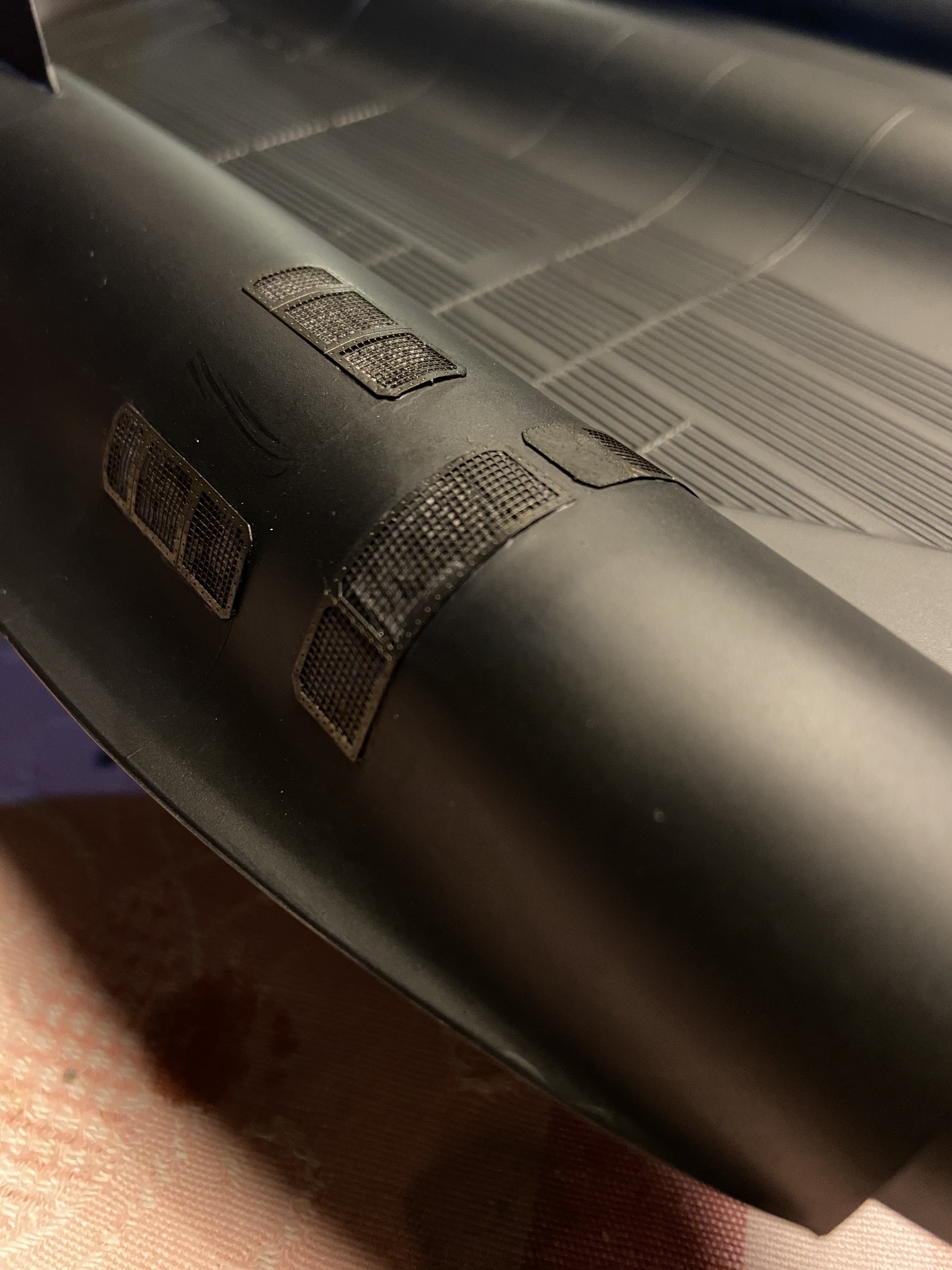

BastianD Posted February 25, 2024 Author Share Posted February 25, 2024 Acc Eduard instructions, the new photo etched grilles should be placed over the kits’ grilles, by filling them first with putty. However, they don’t align with the surface, and are just a little higher. I found this thread of another build where original grilles were cut out so that nee ones could be placed inside, and align with a smooth surface. Worth a shot? https://www.britmodeller.com/forums/index.php?/topic/235027443-i-couldnt-resist-sr-71a-blackbird/page/2/ Quote Link to post Share on other sites

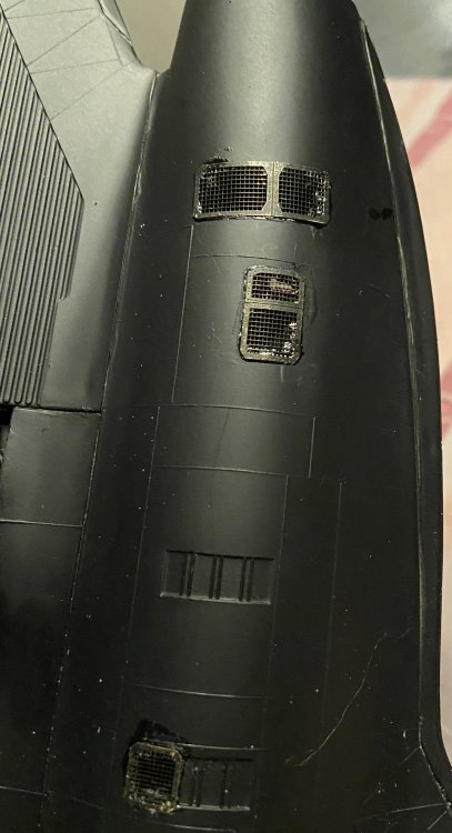

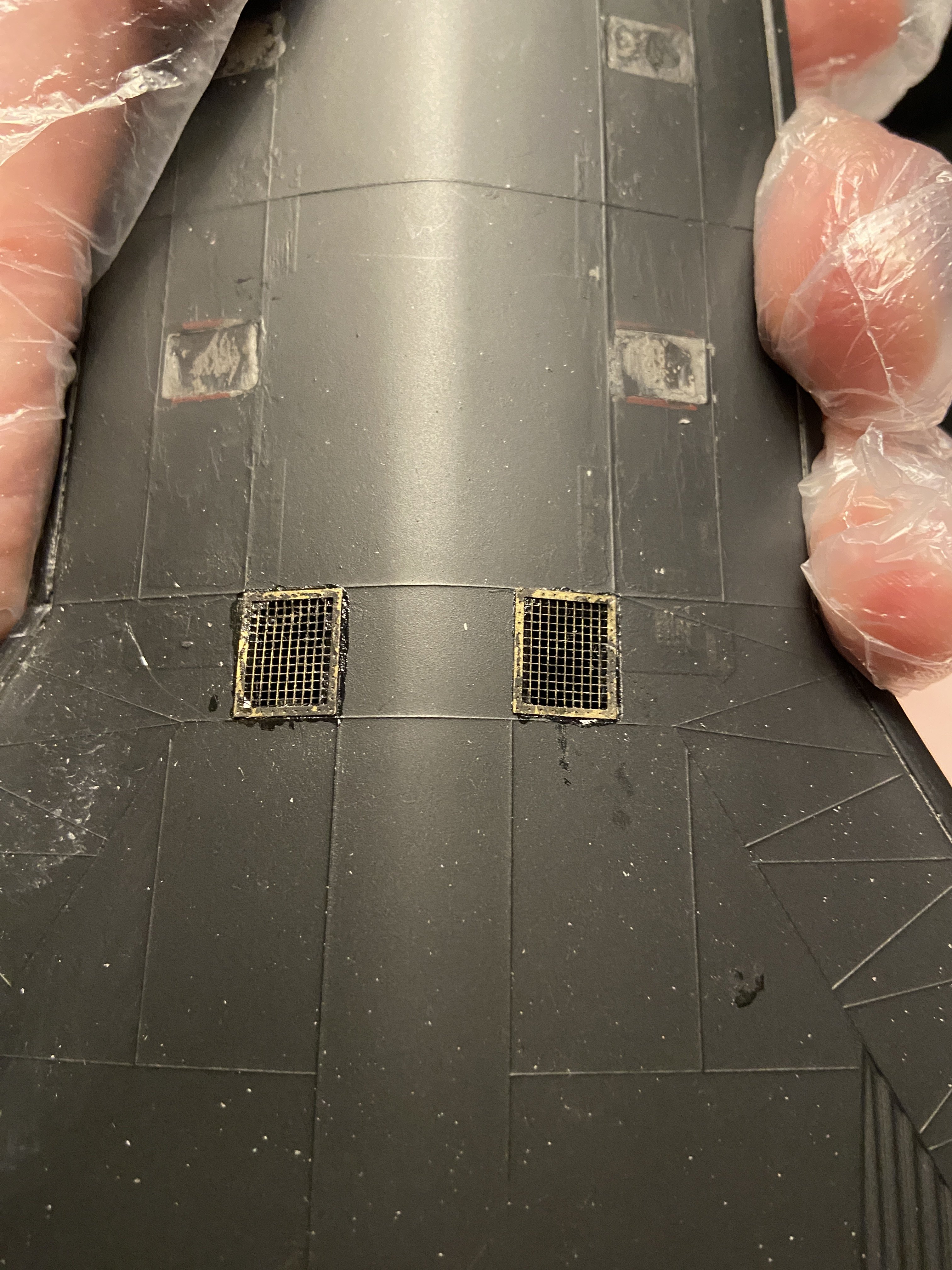

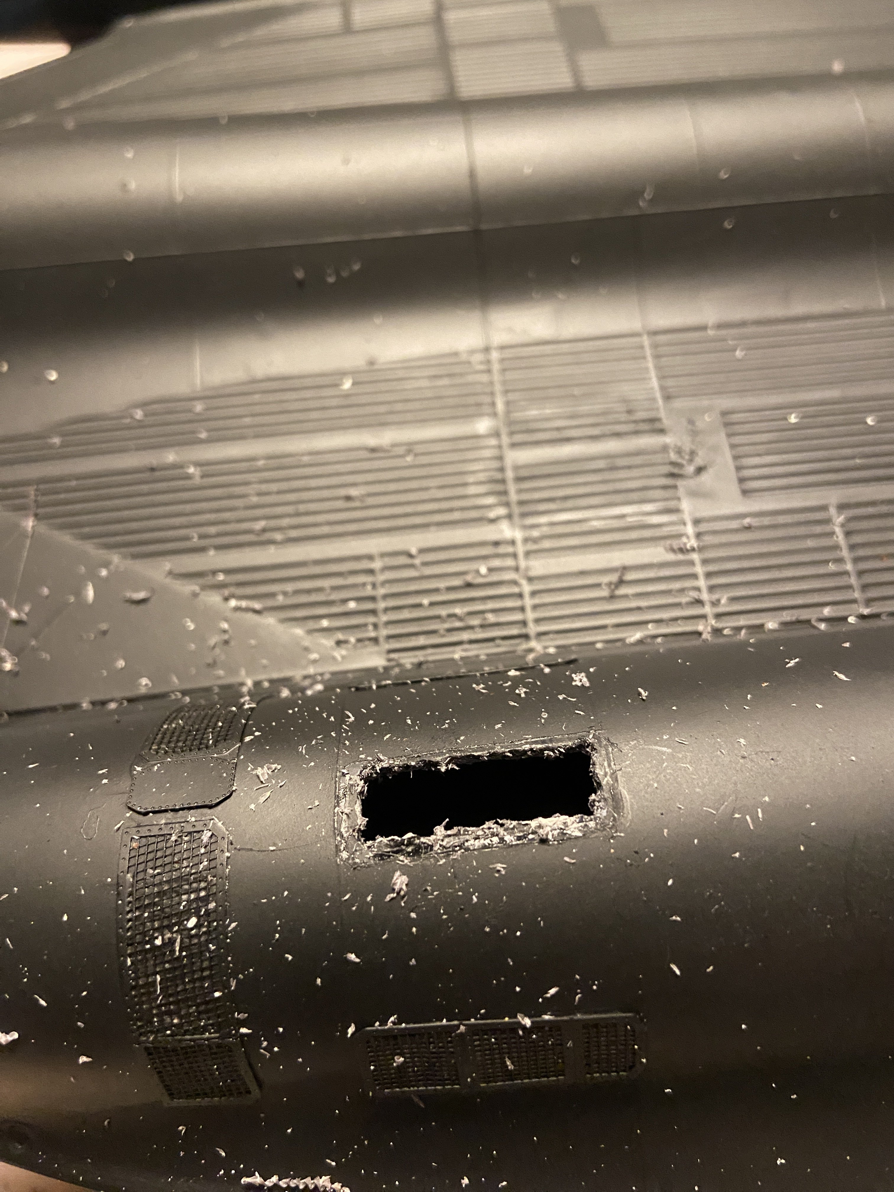

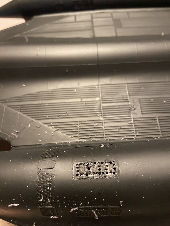

BastianD Posted March 8, 2024 Author Share Posted March 8, 2024 Not so happy yet with the appearance of the grilles on the engines. They would give a far better picture if they are open from underneath. Im going to take 1 off and try to make it open underneath to see the difference. At least somebody did it before… 🤔 Quote Link to post Share on other sites
utley Posted March 8, 2024 Share Posted March 8, 2024 Yeah Id think those should be slightly recessed in and somewhat flush. As for the vents being open, why not use a .02mm drill bit and open the holes up? Use a pin to layout the holes? Quote Link to post Share on other sites
BastianD Posted March 8, 2024 Author Share Posted March 8, 2024 1 at a time, let’s see if it delivers 😅 Quote Link to post Share on other sites
BastianD Posted March 8, 2024 Author Share Posted March 8, 2024 (edited) 20 minutes ago, utley said: Yeah Id think those should be slightly recessed in and somewhat flush. As for the vents being open, why not use a .02mm drill bit and open the holes up? Use a pin to layout the holes? Exactly, but leave some borders a little recessed so the grilles can rest on those borders and end up smoothly with the skin. Edited March 8, 2024 by BastianD Quote Link to post Share on other sites

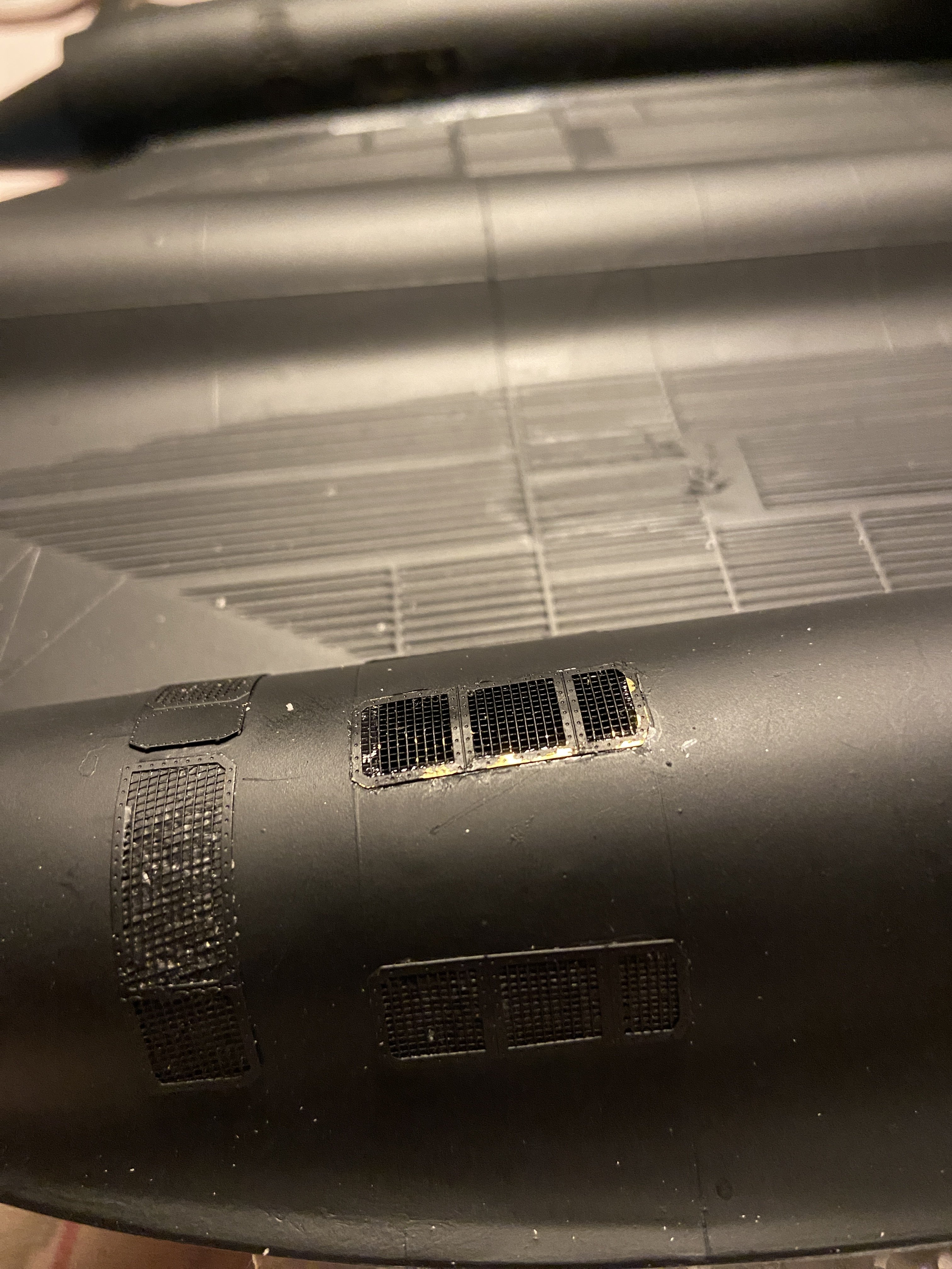

BastianD Posted March 8, 2024 Author Share Posted March 8, 2024 Well, at least it’s open… 😅 15 to go! Quote Link to post Share on other sites
BastianD Posted March 8, 2024 Author Share Posted March 8, 2024 Now we’re talking! A nice open space behind the grille. Now lower the side areas so the grill can flush with the skin of the beast. Quote Link to post Share on other sites

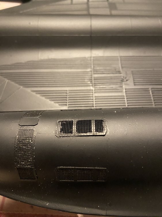

BastianD Posted March 8, 2024 Author Share Posted March 8, 2024 It did work! First grill glued in place and looks quite flat! Quote Link to post Share on other sites

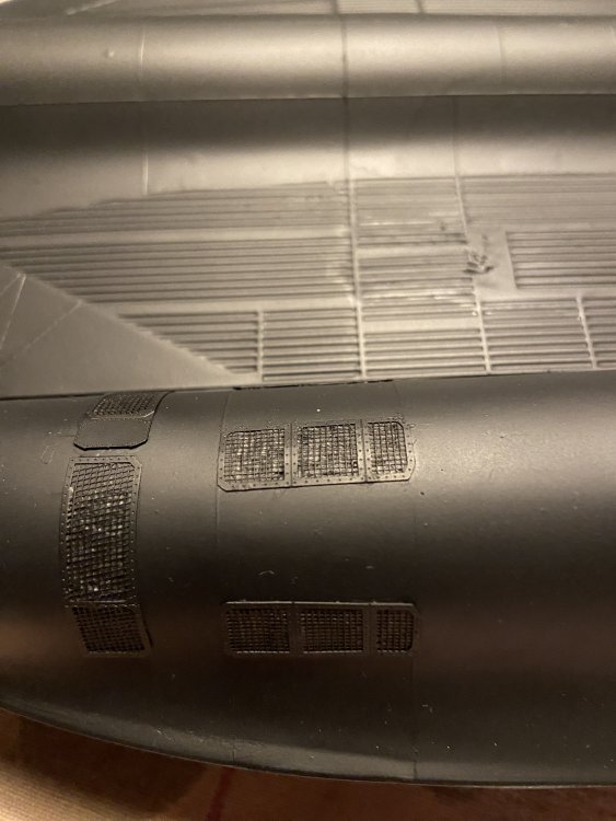

BastianD Posted March 17, 2024 Author Share Posted March 17, 2024 Small update: passed the 50% mark of opening the surface behind the grills and reinstalling them 😅 Right engine to go. Quote Link to post Share on other sites
