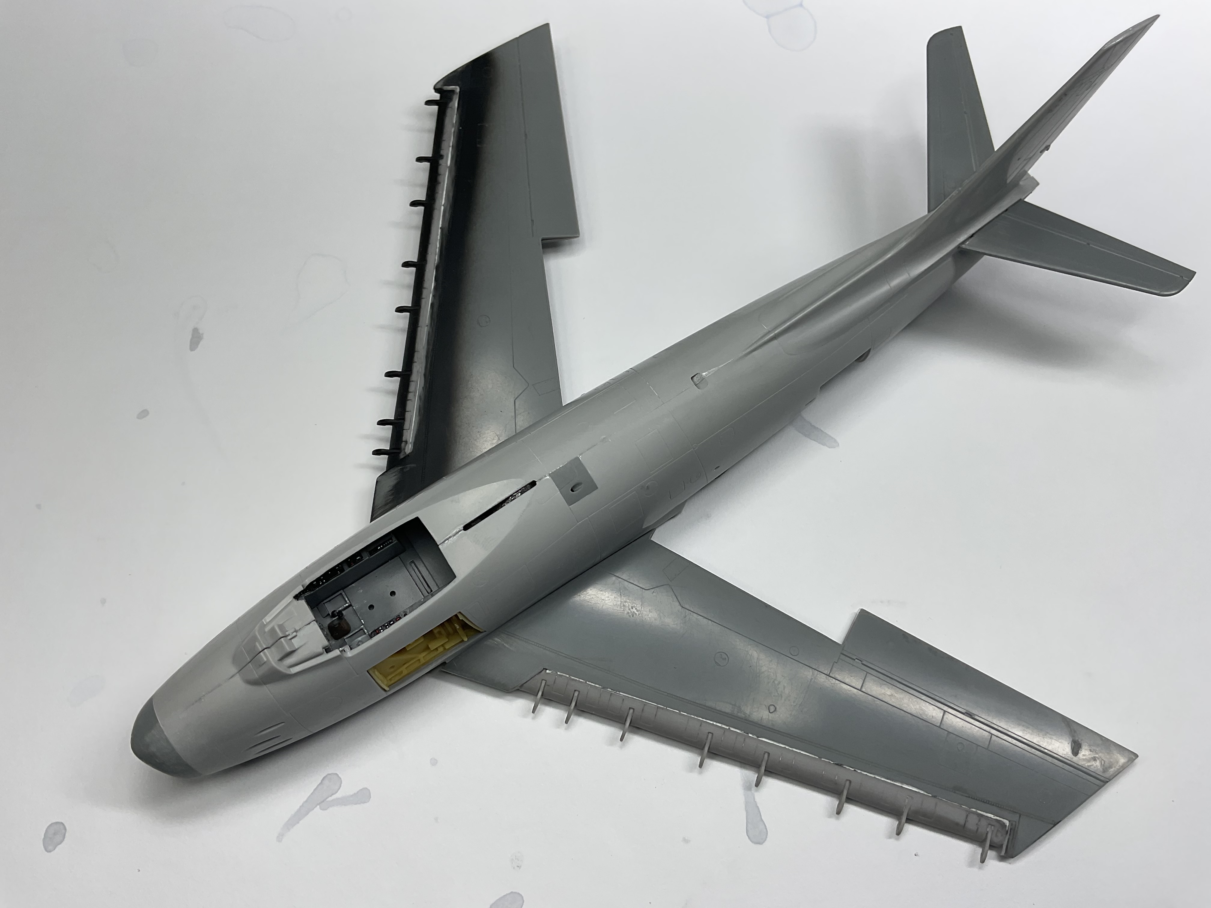

dai phan Posted January 4, 2024 Author Share Posted January 4, 2024 Howdy all, I discover the wing tips on the F-30 wing fit much better than the resin tips as these are short of 2 mm. I have some spare F-30 wings so that is what I will do. Should be able to re-start on this project next week. Dai Quote Link to post Share on other sites

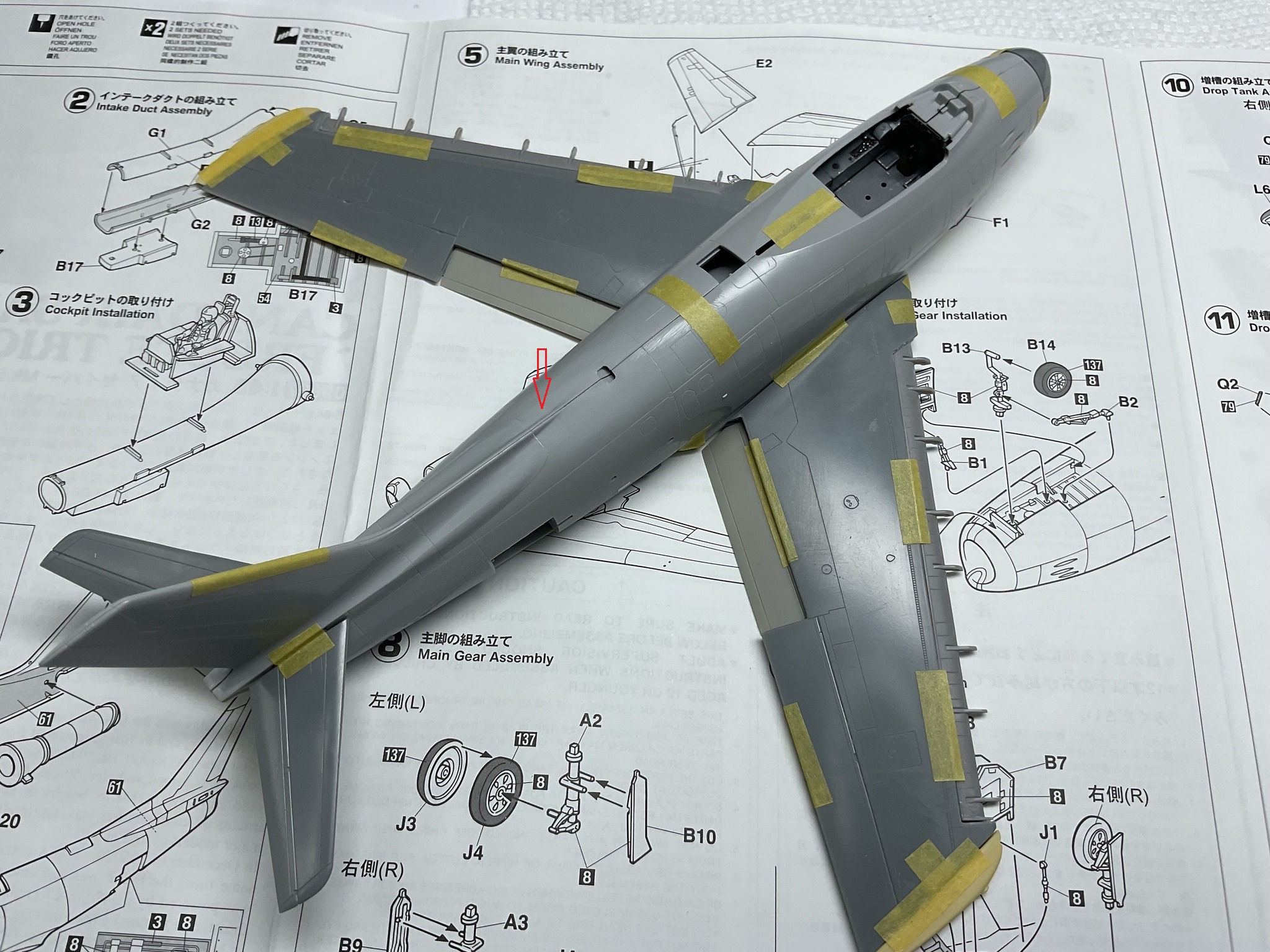

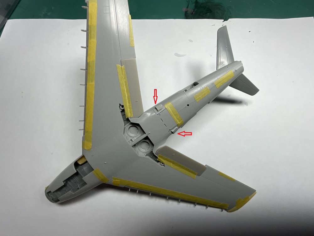

dai phan Posted January 7, 2024 Author Share Posted January 7, 2024 (edited) Hello everyone, Continued on with the conversion. Sanded the raised rectangular panel in front of the vertical tail and removed the scoop on the right side. Refined sugar scoops. Now I come to think about it. Some companies just slap on decals and call it another version without really modifying the parts to make it the CORRECT version that the model is supposed to be. Although in this case Hasegawa did correct the wings with slats but left a bunch out. Another example is the S3A/B Viking that Italeri reboxed. It says S3 A/B but the B cannot be build unless a bunch of mods are needed. You can see my mods on the build here on ARC. Dai Edited January 8, 2024 by dai phan Quote Link to post Share on other sites

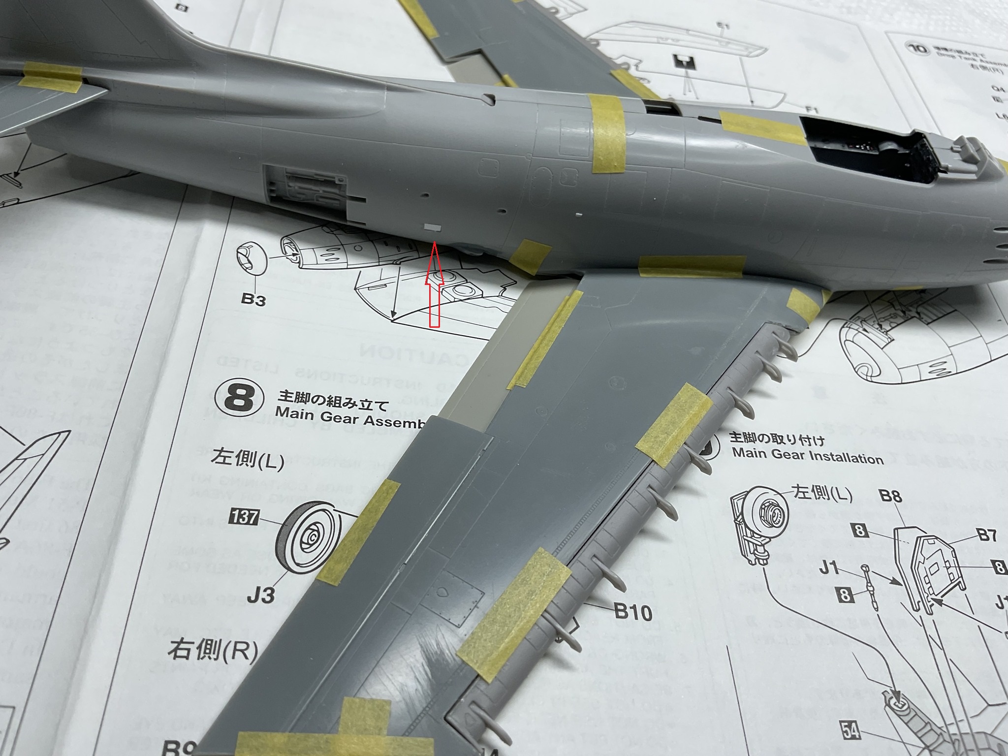

Snowbird3a Posted January 9, 2024 Share Posted January 9, 2024 while you're at it , delete the LH rear fuel filler and add a RH fuel filler in almost the same location (RH side ), as per; Quote Link to post Share on other sites
dai phan Posted January 9, 2024 Author Share Posted January 9, 2024 10 hours ago, Snowbird3a said: while you're at it , delete the LH rear fuel filler and add a RH fuel filler in almost the same location (RH side ), as per; I am at work so I cannot see the image. Is this something easy to do because scribing and scratch building are something beyond my ability. Dai Quote Link to post Share on other sites
Snowbird3a Posted January 9, 2024 Share Posted January 9, 2024 yes, it is very easy Quote Link to post Share on other sites
dai phan Posted January 10, 2024 Author Share Posted January 10, 2024 14 hours ago, Snowbird3a said: yes, it is very easy Hi, How do you scribe of such intricate details of the fuel filler? This is beyond my ability. Dai Quote Link to post Share on other sites
dai phan Posted January 10, 2024 Author Share Posted January 10, 2024 Hi all, I look at the decal on the German MK6 kit and it has the fuel filler decal on the right side. This will be of great help as it is beyond my ability to scribe with such intricate details. Dai Quote Link to post Share on other sites

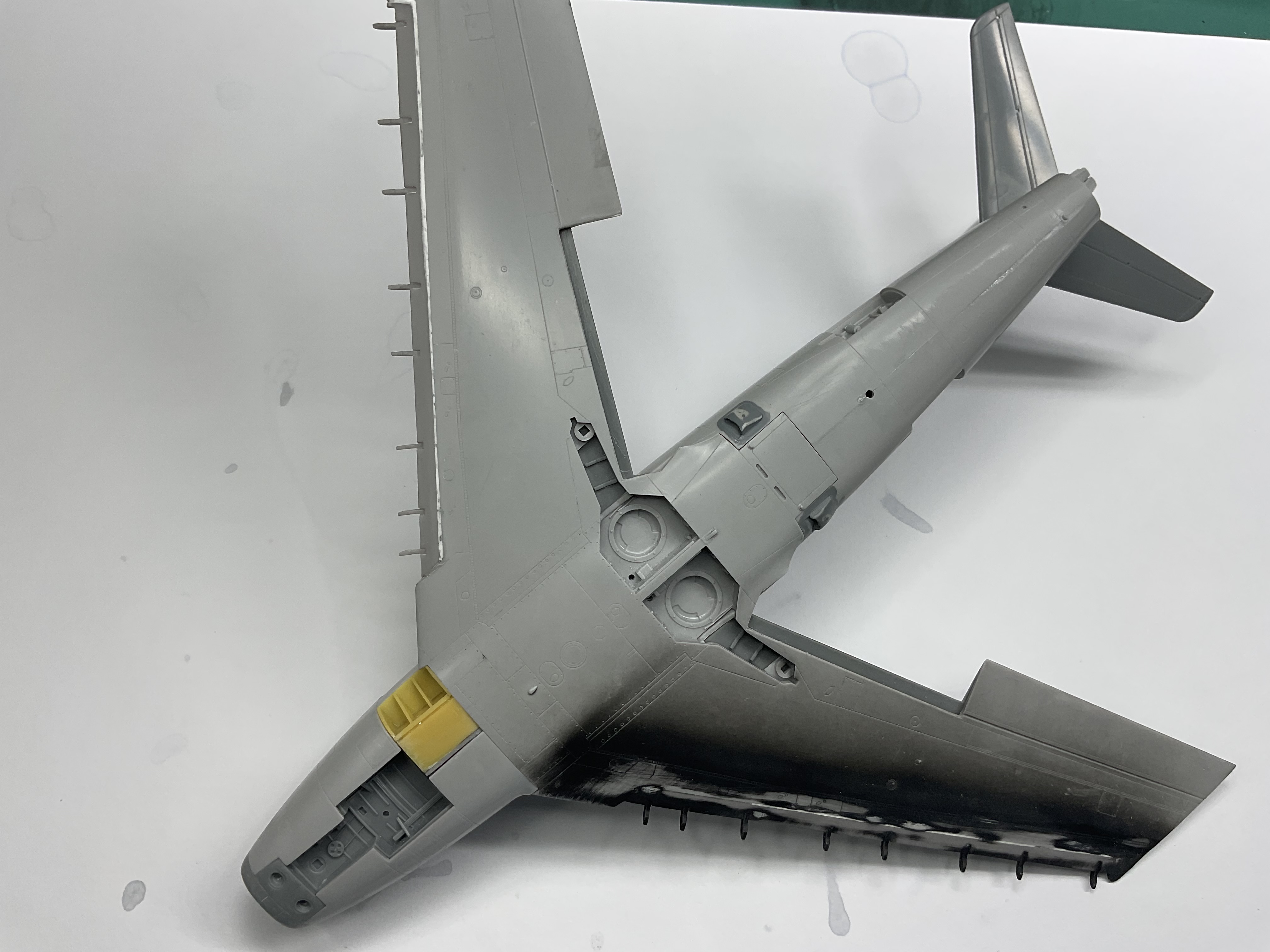

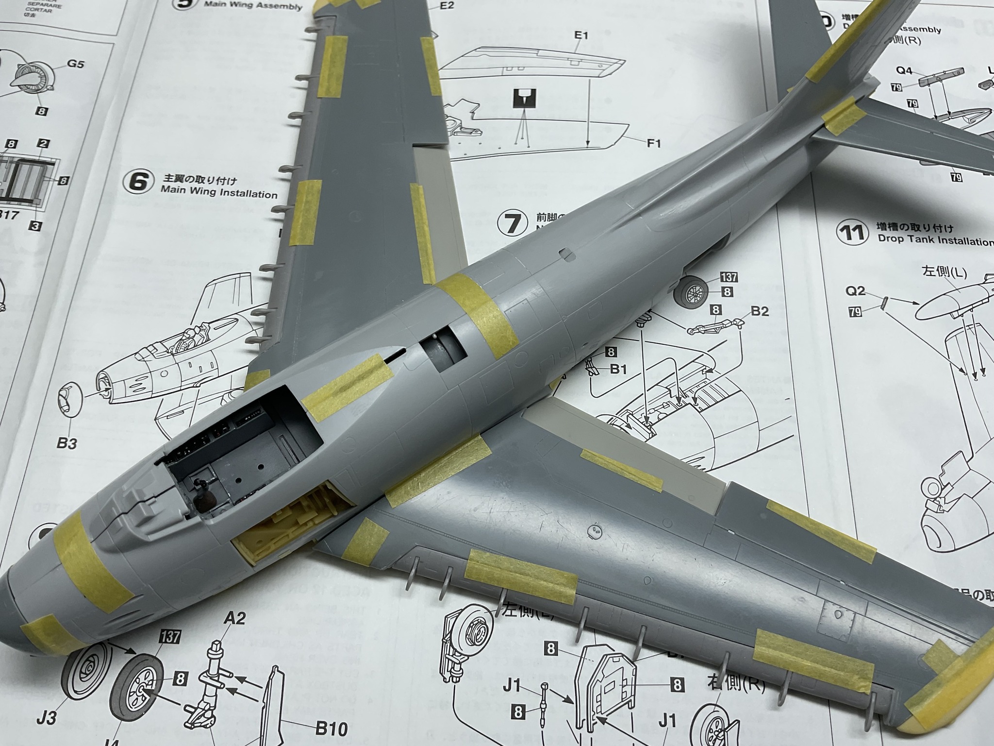

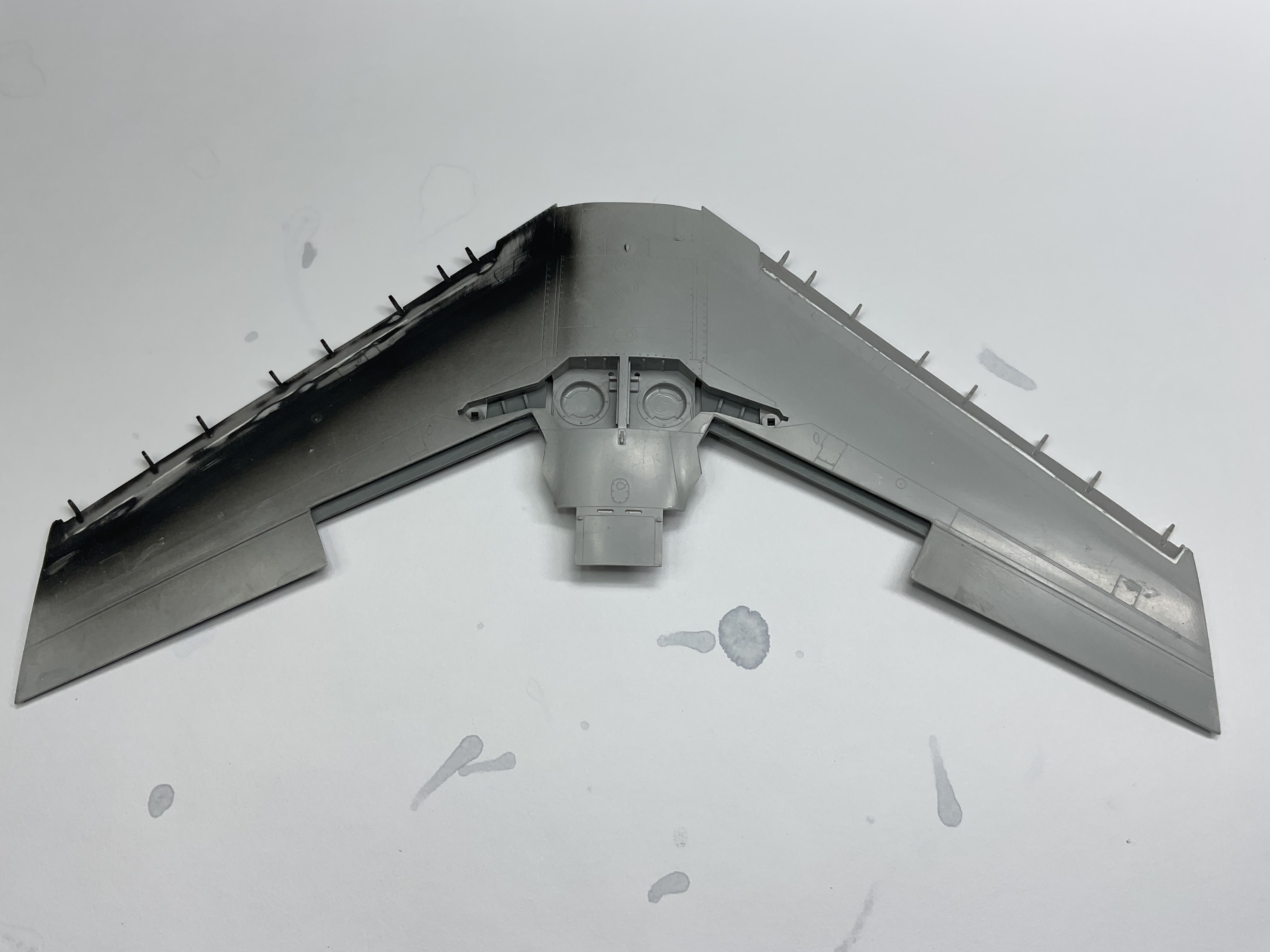

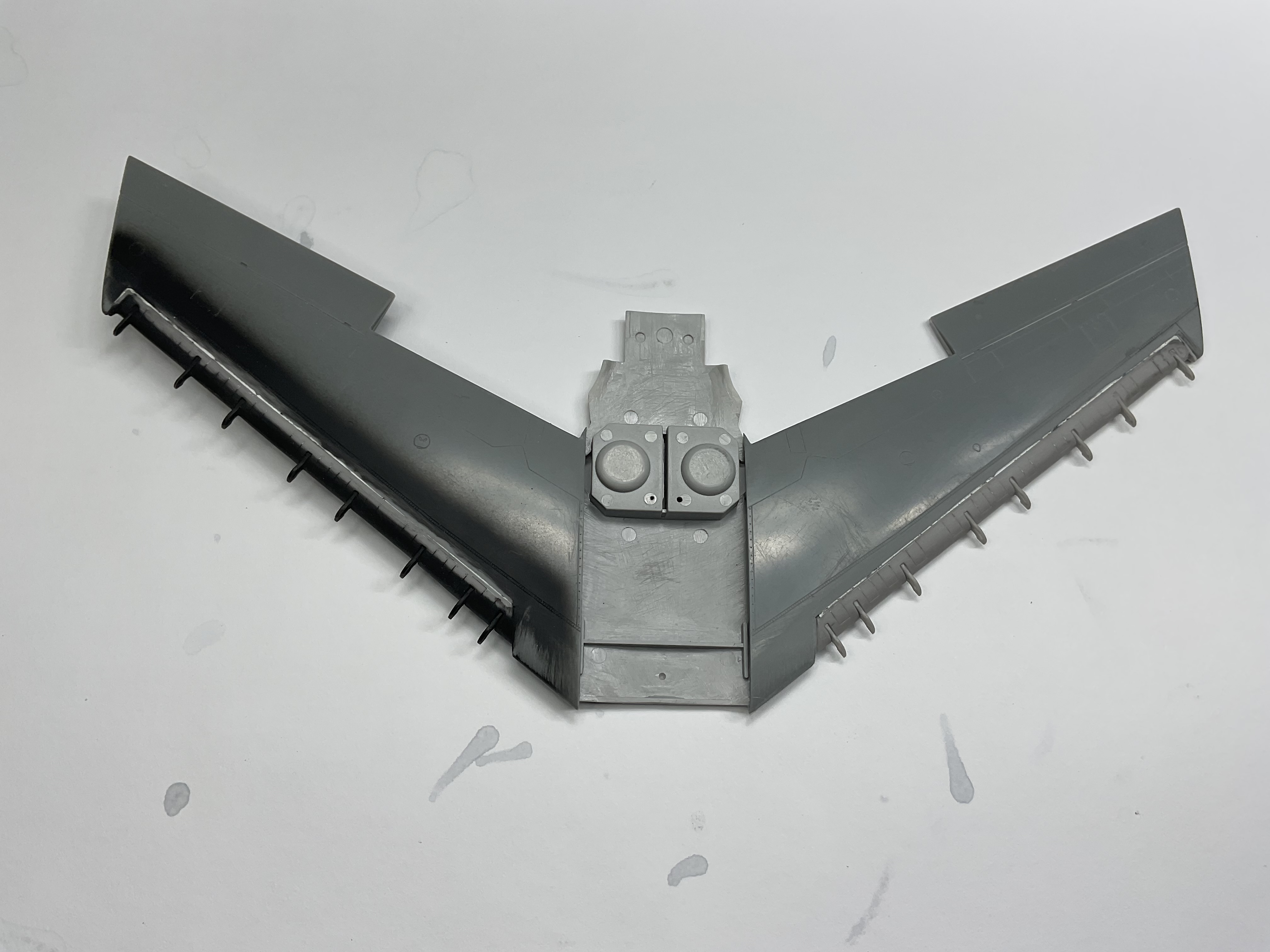

dai phan Posted January 16, 2024 Author Share Posted January 16, 2024 (edited) Hello all, Installing the slats. Lots of sanding is needed in order to make everything flushed with each other. I refrain from joining the wings to the fuselage until the wings are acceptable. With so much sanding on the bottom wing, I wonder if the airfoil is now correct at all ? Dai Edited January 16, 2024 by dai phan Quote Link to post Share on other sites
dai phan Posted January 16, 2024 Author Share Posted January 16, 2024 (edited) Greetings, Upon examination, I sanded so much on the bottom wing that I lost the profile. Toward the leading edge the profile should be a gentle curve rather than flat. Luckily I have a spare set and a spare F-40 wings that I will try again. Now I know where to cut so it should be much better second time around. I will post the photos of the cuts so you can see where you need to cut to make things fit. The slat length is a little bit shorter than the outline of the slats molded onto the plastic toward the tip. Dai Edited January 16, 2024 by dai phan Quote Link to post Share on other sites

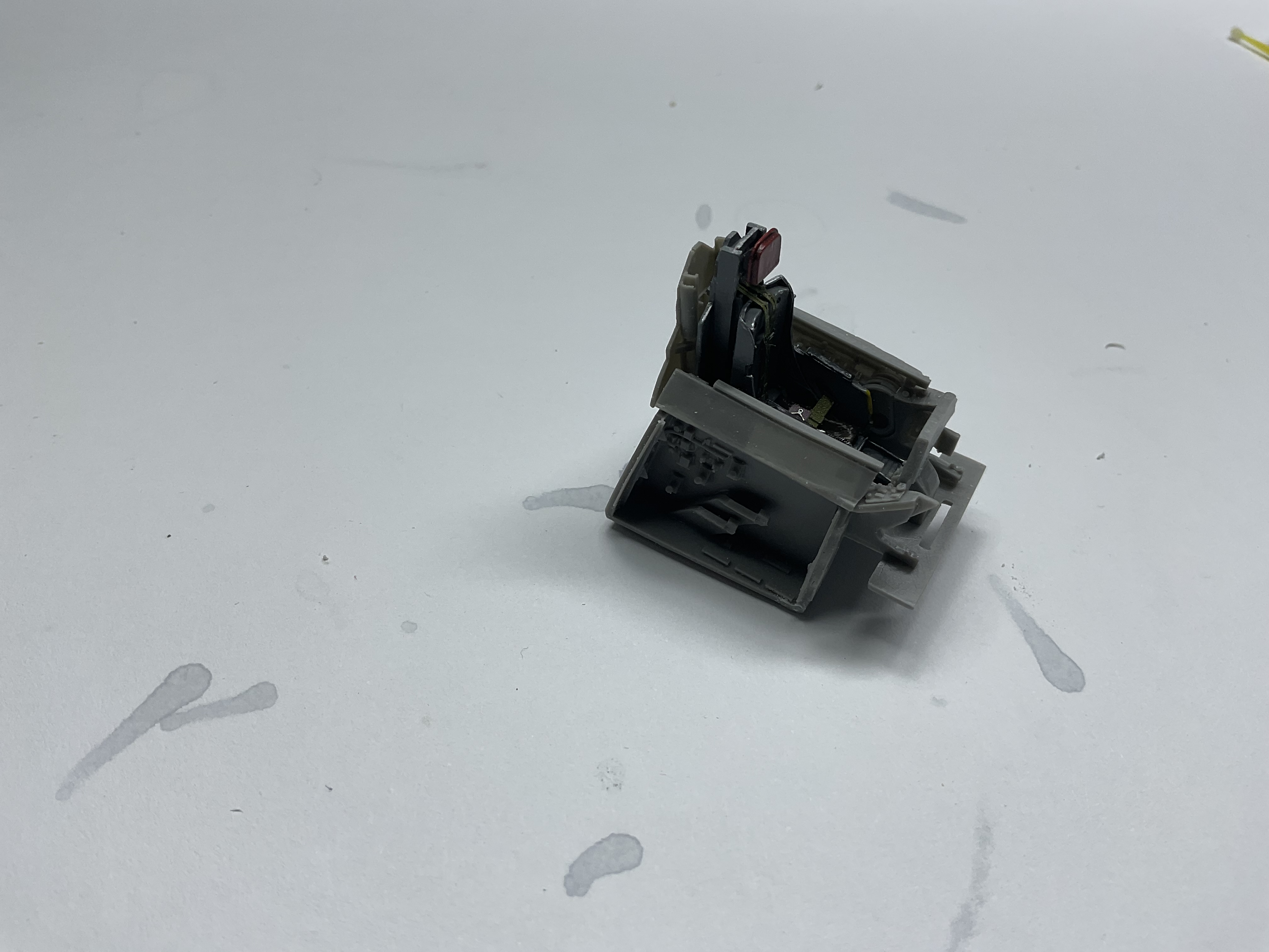

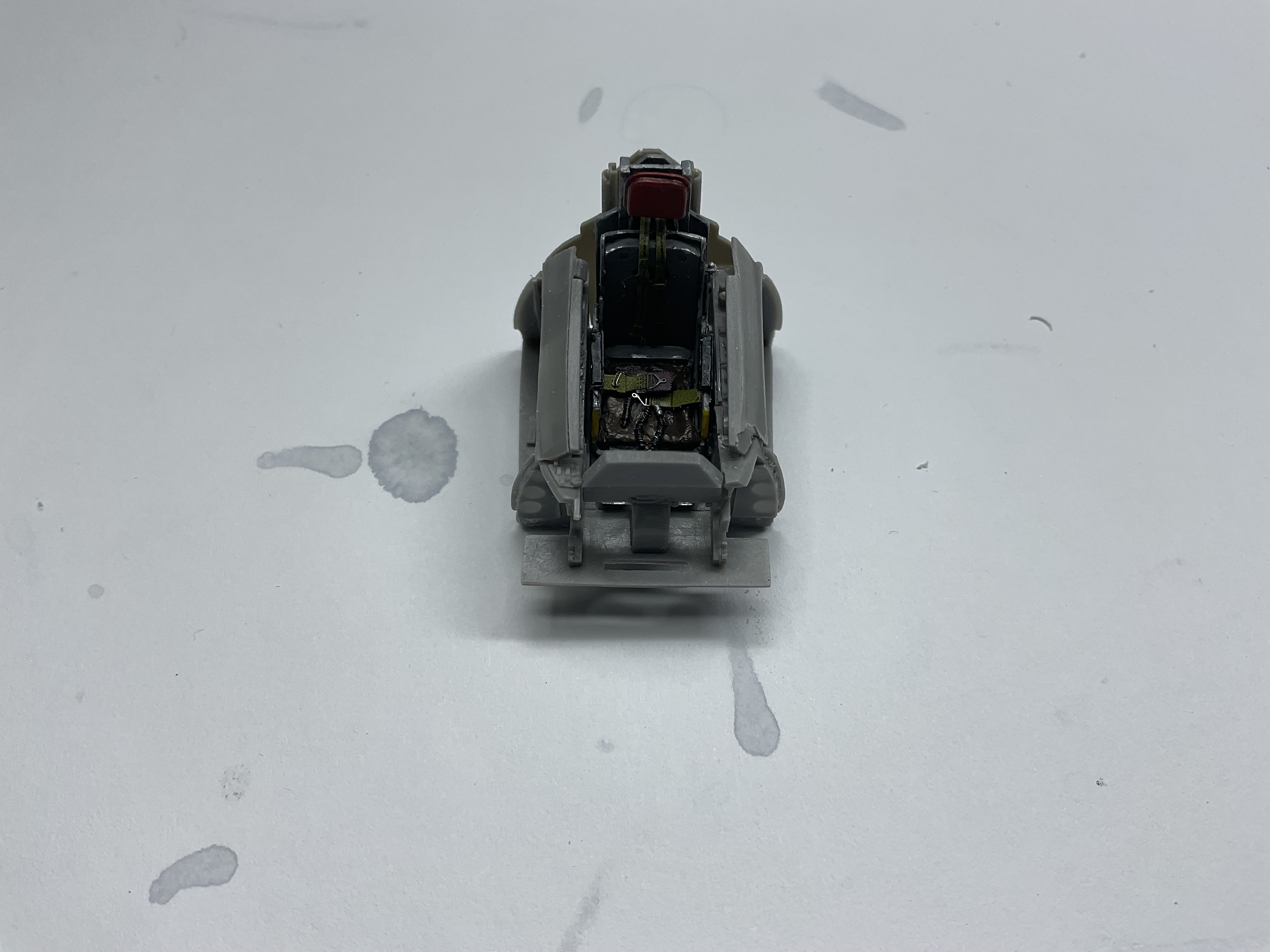

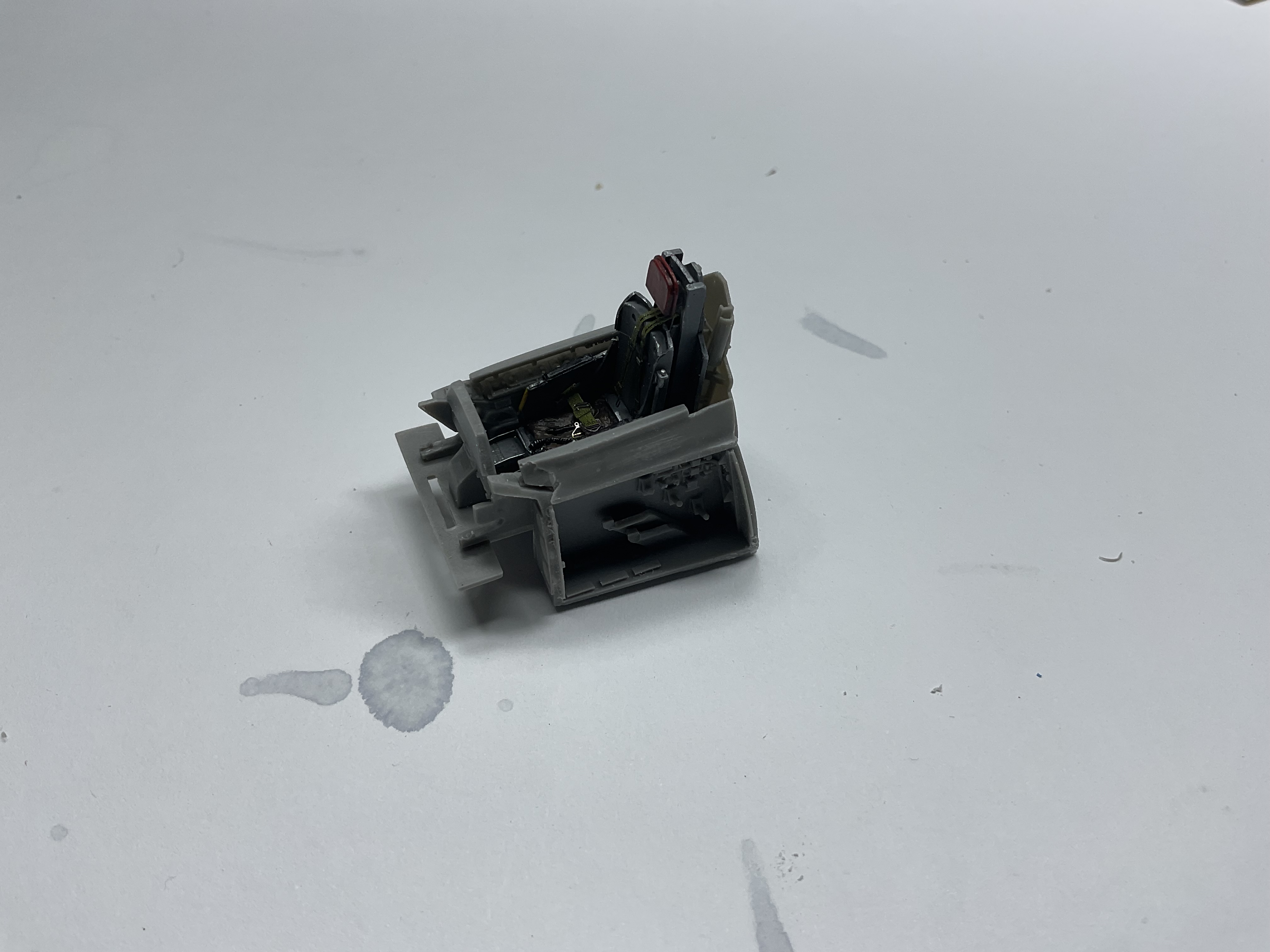

dai phan Posted January 18, 2024 Author Share Posted January 18, 2024 (edited) Hi all, Tonight I assembled the CMK gun bay/cockpit to see how it fits. Impossible as the tub interferes massively with the intake trunk even with serious sanding to make things fit. I have tried many after market cockpit kits. If you install the gun bay then these will NOT work as they interfere with the bays. The only combination that works is the left Verlinden bay with kit's tub. Even with that I had to sand massively on the bay to allow the tub to sit. So if you want the bays along with resin cockpit, I would look into the Academy kit. Dai Edited January 18, 2024 by dai phan Quote Link to post Share on other sites
