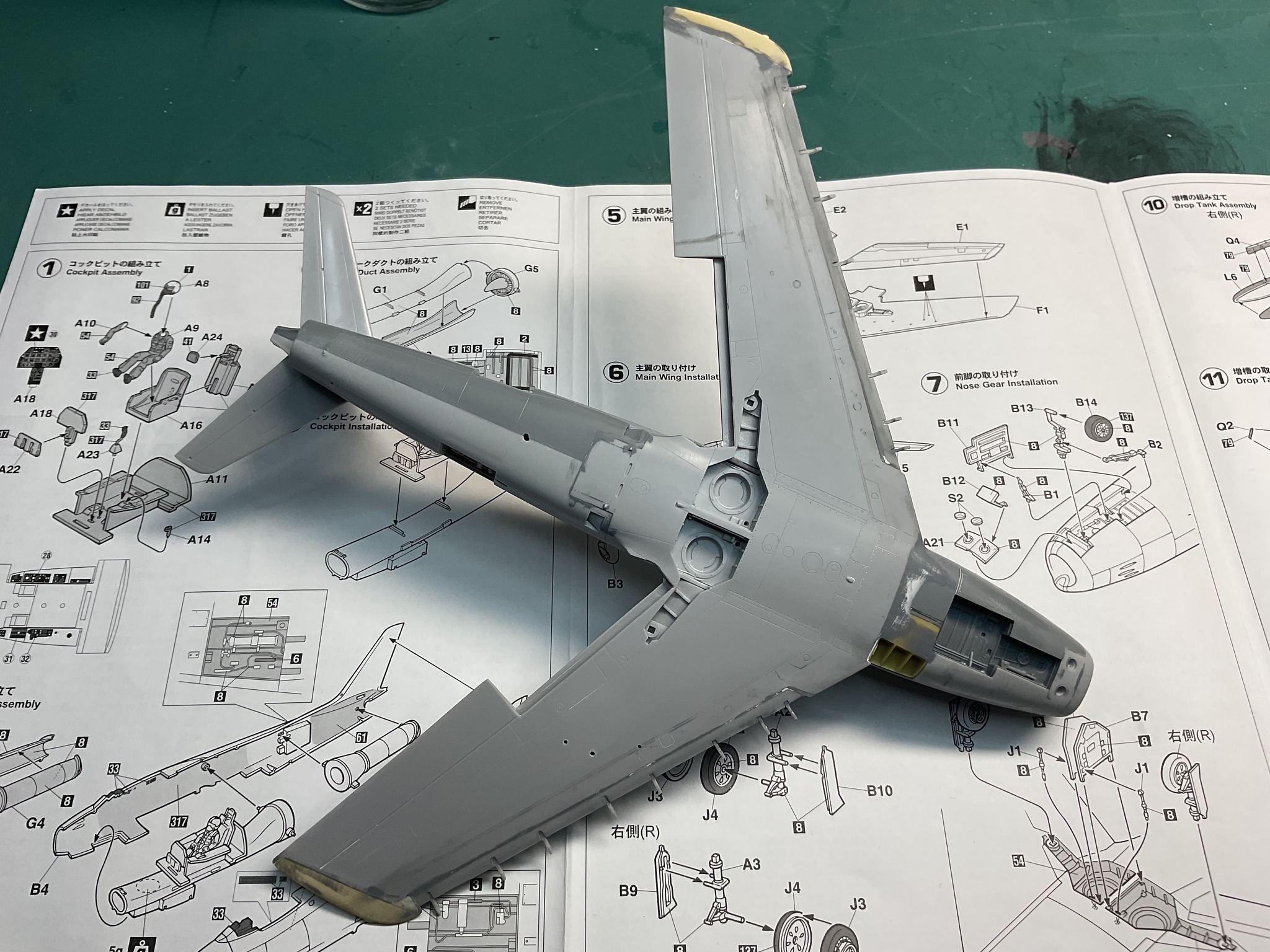

dai phan Posted January 22, 2024 Author Share Posted January 22, 2024 (edited) Howdy all, The plane is now ready to be primed as I have installed another set of slats. This second time is much easier than the first and I will post some pictures showing the easiest way to install them. I just discovered Flightdecks in Canada produced F86 decals that has the scheme I want to build (Luftwaffe MK 6) and the decals come with a MUCH more accurate sugar scoops than the AMS ! Needless to say I ordered them right away. I will go ahead and prime the model/fix surface flaws then pay attention to the scoops after they are installed. These photos are from ARC and LF Models. Dai Edited January 22, 2024 by dai phan Quote Link to post Share on other sites

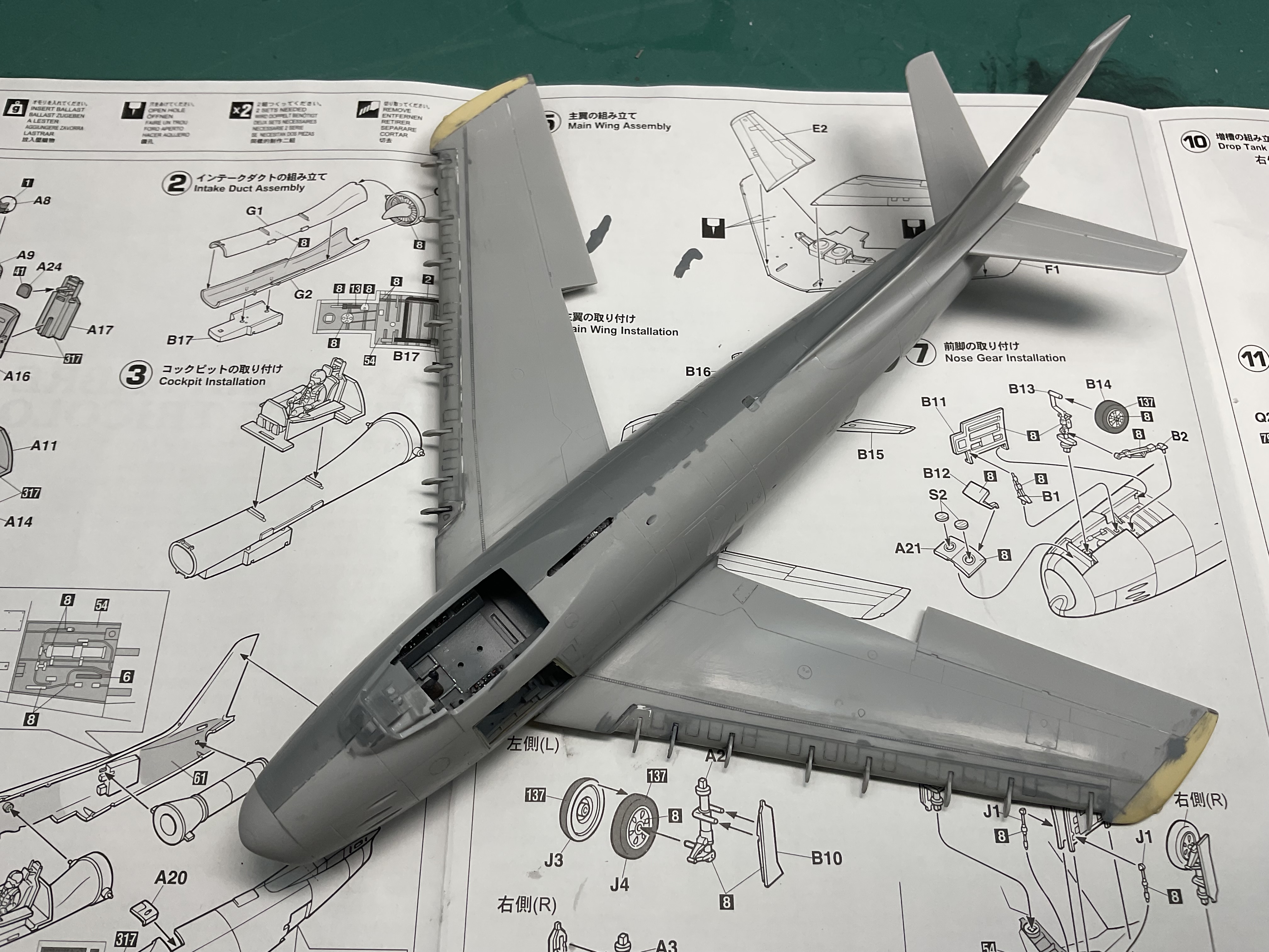

dai phan Posted January 23, 2024 Author Share Posted January 23, 2024 Hi all, Ready to prime. Dai Quote Link to post Share on other sites

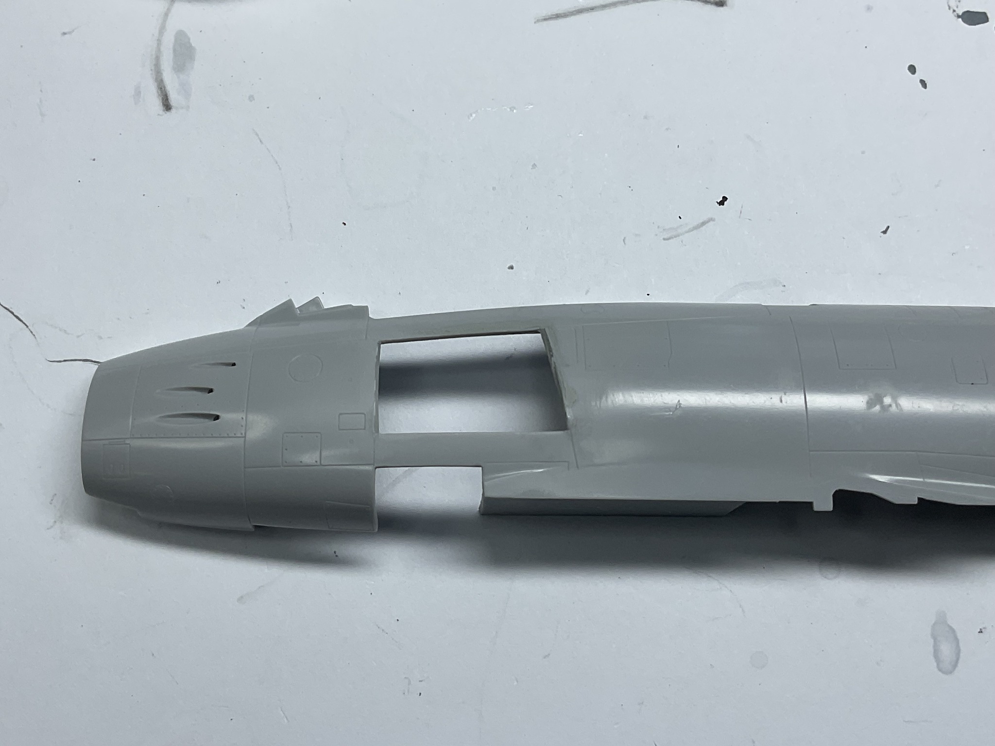

Snowbird3a Posted January 23, 2024 Share Posted January 23, 2024 are you going to add the engine compartment vents on both sides of the fuselage, all Canadair Sabres had them. Tony Quote Link to post Share on other sites
dai phan Posted January 23, 2024 Author Share Posted January 23, 2024 5 hours ago, Snowbird3a said: are you going to add the engine compartment vents on both sides of the fuselage, all Canadair Sabres had them. Tony Hi Tony, I do not think so because my skill is not adequate for any of scratch building job. Maybe you can guide me? A picture would be helpful. Dai Quote Link to post Share on other sites

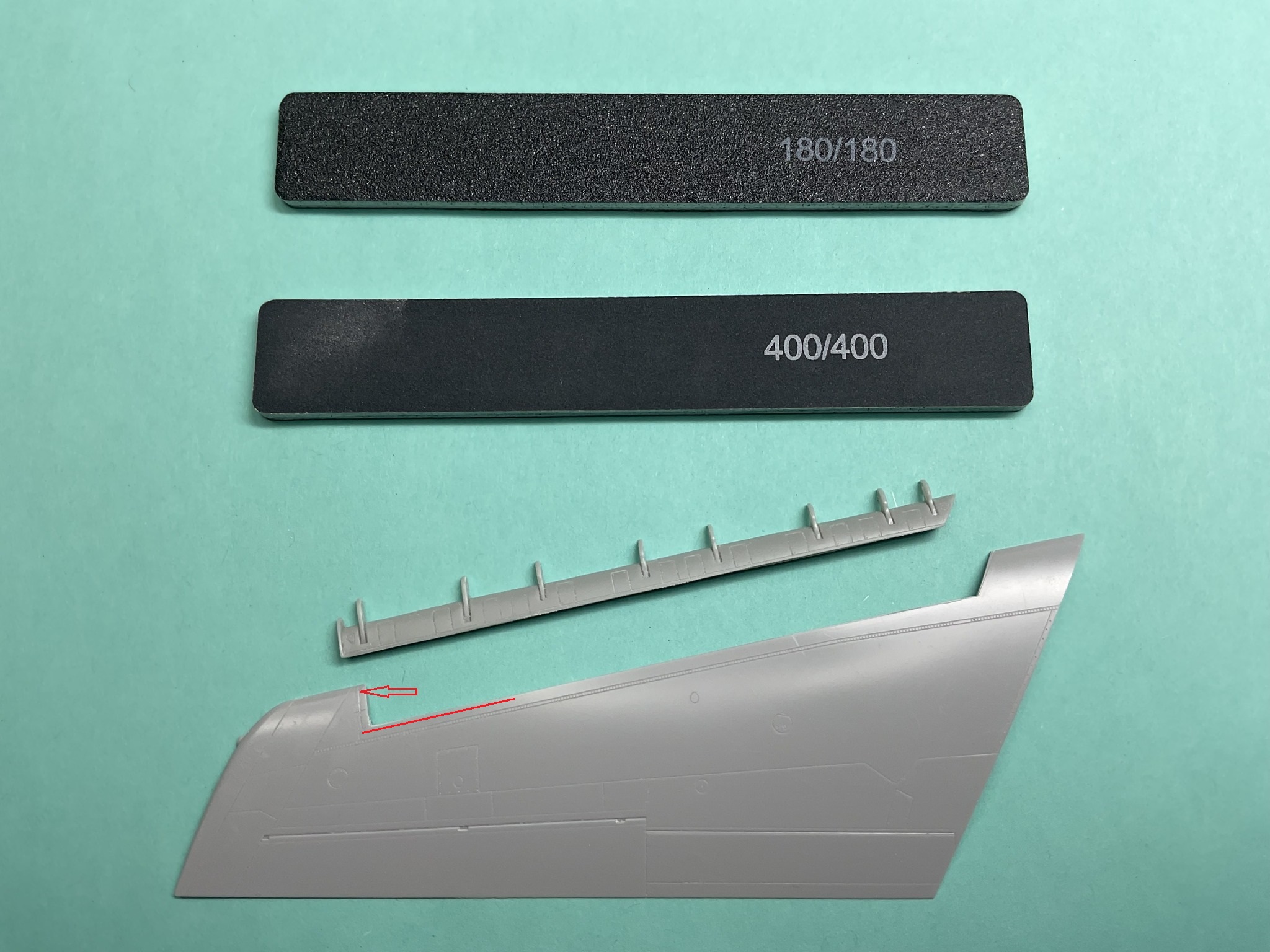

dai phan Posted January 23, 2024 Author Share Posted January 23, 2024 (edited) Hi all, When installing the slats, know the slats are shorter than the slat panel lines of the wing. So cut at the line toward the tip (the placement is correct- see red arrow) but leave 4 mm from the line nearest to the fuse. Also cut behind the line of 1 mm (see red line) as this will place the slat base at the correct position in relative to the leading edge. Mine is slightly placed too forward as I discovered the error too late. Make sure you fine tune to get a best fit possible of the mating surfaces. This will minimize sanding so you do not lose the profile of the lower wing. I use straight sanding sticks 180 for rough sanding and fine tune with 400. I will look into using the Revell F86D slats as that may be easier than this job. Dai Edited January 23, 2024 by dai phan Quote Link to post Share on other sites

dai phan Posted January 23, 2024 Author Share Posted January 23, 2024 8 hours ago, Snowbird3a said: are you going to add the engine compartment vents on both sides of the fuselage, all Canadair Sabres had them. Tony You suggested adding the right fuel filler. To me it is impossible to scribe with that precision. I have hard time scribing straight line as is. Dai Quote Link to post Share on other sites
Snowbird3a Posted January 23, 2024 Share Posted January 23, 2024 Port side shown, RH side identical; quite an easy job considering all the work you are accomplishing elsewhere. Quote Link to post Share on other sites
Snowbird3a Posted January 23, 2024 Share Posted January 23, 2024 Quote Link to post Share on other sites

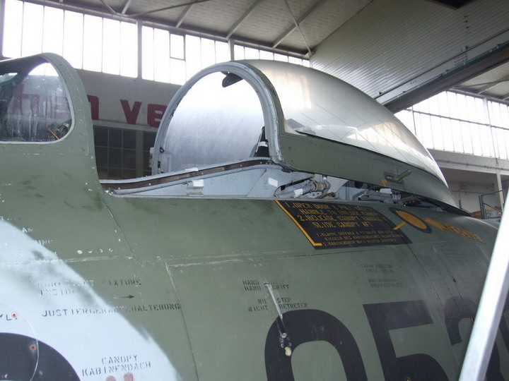

dai phan Posted January 24, 2024 Author Share Posted January 24, 2024 Hi all, The German MK 6 has the Martin Baker seat so opening and closing of the canopy has a different path than the F-40. That means positioning the rear canopy straight back is not accurate then? This photo is from the link. Dai Quote Link to post Share on other sites

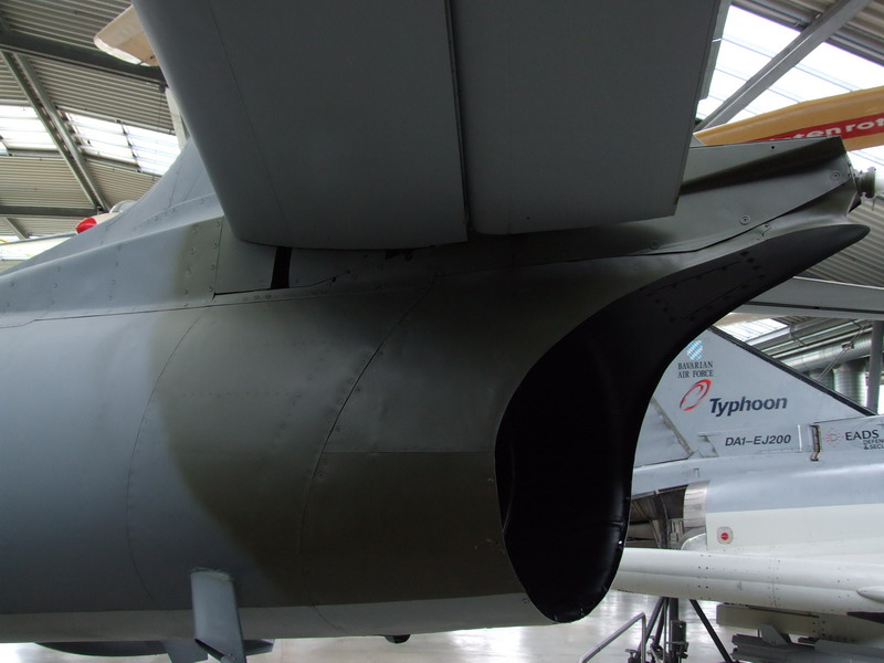

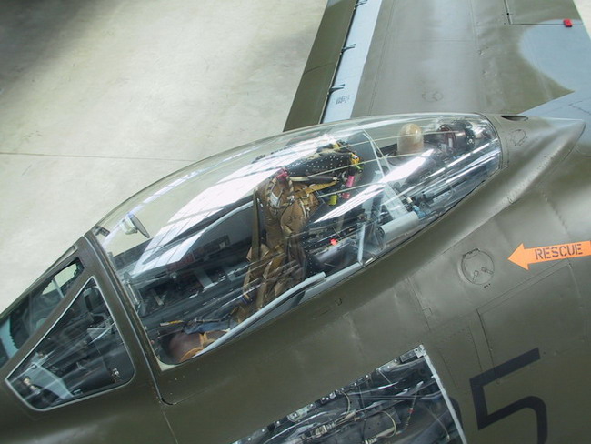

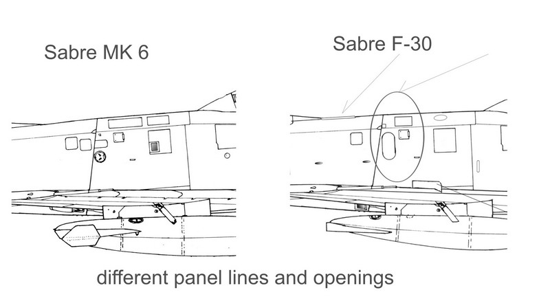

dai phan Posted January 24, 2024 Author Share Posted January 24, 2024 (edited) Hi all, Some more from the link provide some insights into the MK 6. The MK 6 has much difference in fuselage panel lines. One interesting thing is on the German plane, the demarcation between the green and the grey is soft. But yet between this and the underside blue is hard. I wonder if this is due to restoration at the museum paint shop? If so during its operational life, that will make my painting much easier. Dai Edited January 24, 2024 by dai phan Quote Link to post Share on other sites
