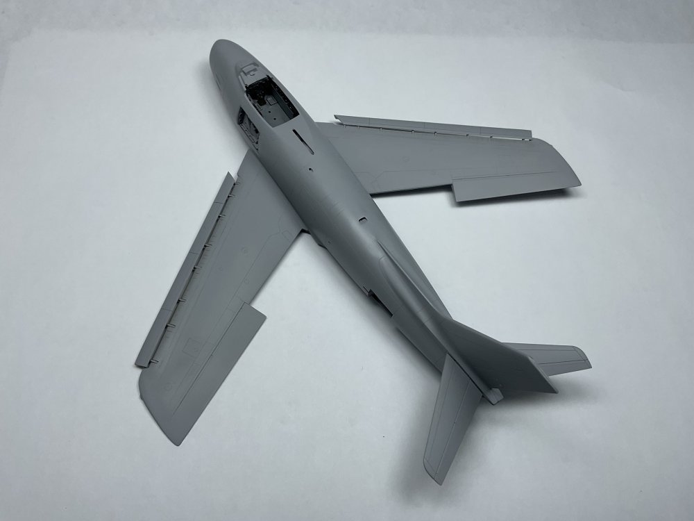

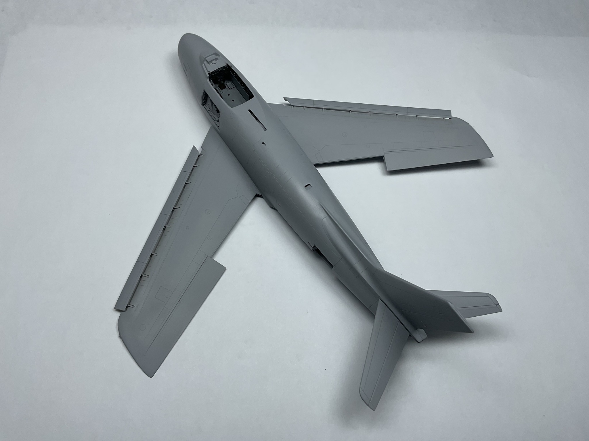

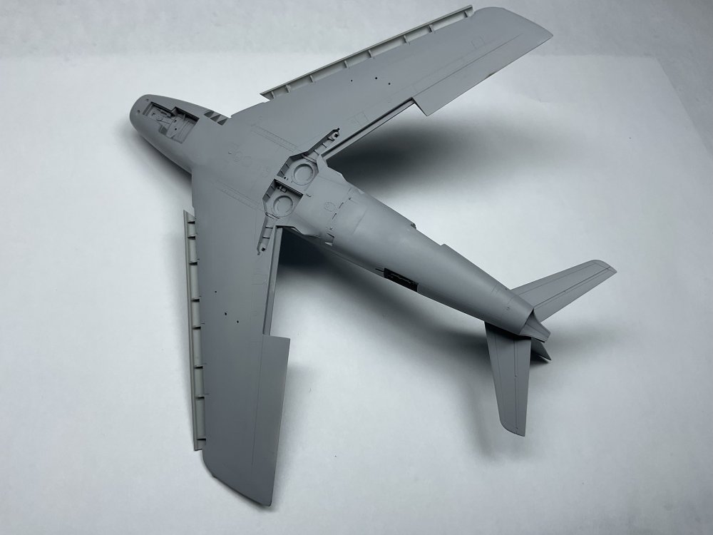

dai phan Posted January 29, 2024 Author Share Posted January 29, 2024 (edited) Hi all, Ready to paint the top colors. Will deal with sugar scoops when they arrive from Czech. I was lucky to secure 2 Flightdecs decal sheets with the scoops through LF Models. These are much more accurate than the AMS ones. The slats are just tacked on via white glue for photos. Dai Edited January 29, 2024 by dai phan Quote Link to post Share on other sites
Snowbird3a Posted January 30, 2024 Share Posted January 30, 2024 (edited) that seam inside the top fuselage vent sticks out like a sore thumb; also a seam at the boat tail behind the rudder HTH Tony PS move the locating holes for the wing pylons in so they measure 53mm from centerline, they are in the wrong place-every manufacturer puts them in that spot for a late F-86F Edited January 30, 2024 by Snowbird3a Quote Link to post Share on other sites
dai phan Posted January 30, 2024 Author Share Posted January 30, 2024 (edited) 12 hours ago, Snowbird3a said: that seam inside the top fuselage vent sticks out like a sore thumb; also a seam at the boat tail behind the rudder HTH Tony PS move the locating holes for the wing pylons in so they measure 53mm from centerline, they are in the wrong place-every manufacturer puts them in that spot for a late F-86F Thank you Tony and I will take care of that right away. Also will need to replace lost panel lines. Dai Edited January 30, 2024 by dai phan Quote Link to post Share on other sites

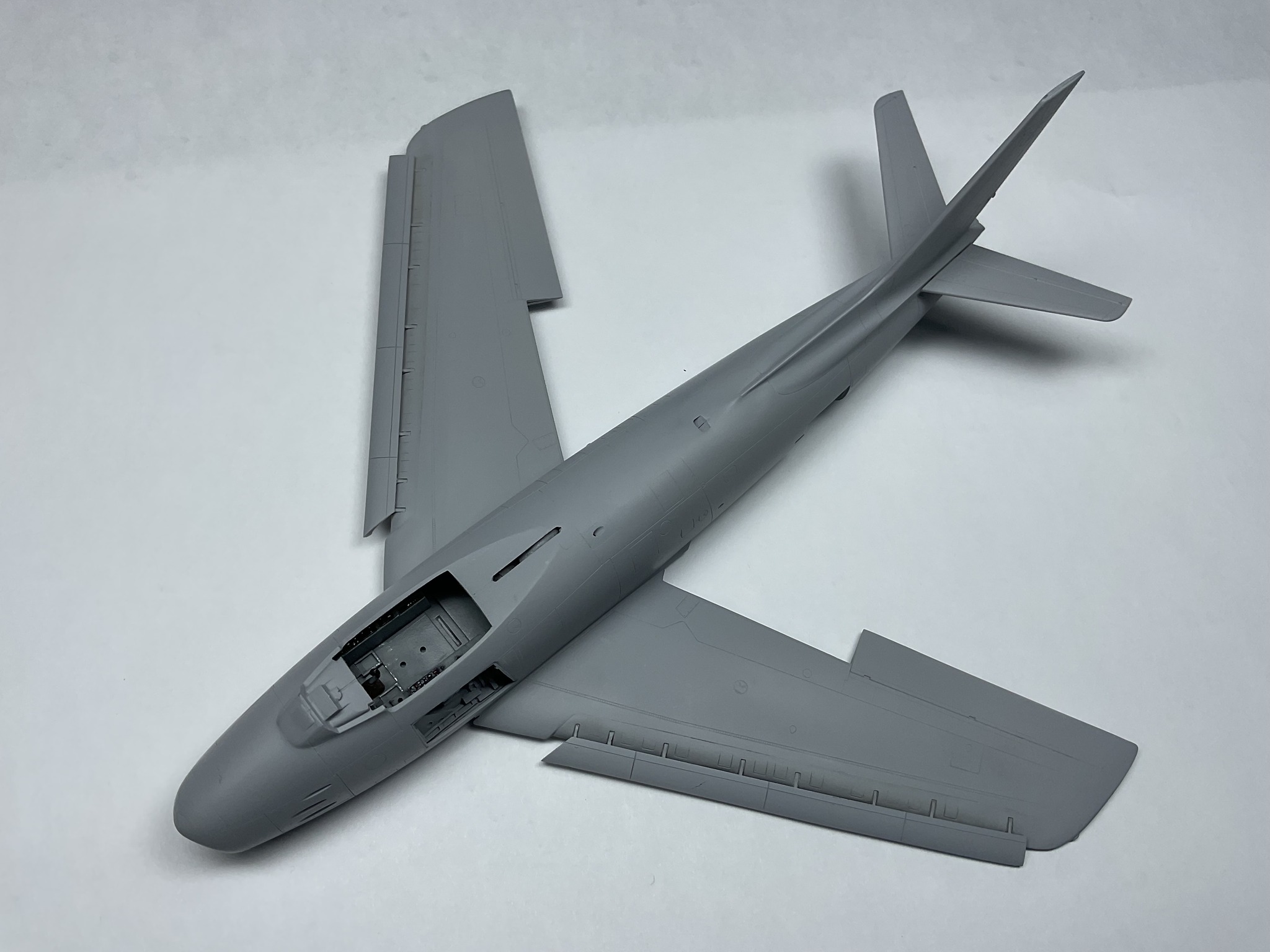

dai phan Posted February 5, 2024 Author Share Posted February 5, 2024 (edited) Hello all, Not happy with the top fuselage air vent so I refined the outline (the kit's is not accurate) for better accuracy. The sloped ramp was glued via CA from outside with the correct angulation then sanded smooth. The corners of the top fuselage toward the nose is rounded as opposed to the ones on the sides of the fuselage. This rounded feature was created by a tiny dab of thick CA into the corners. Now I do not have to deal with the ugly seam that tend to plaque many of the online builds. Dai Edited February 5, 2024 by dai phan Quote Link to post Share on other sites

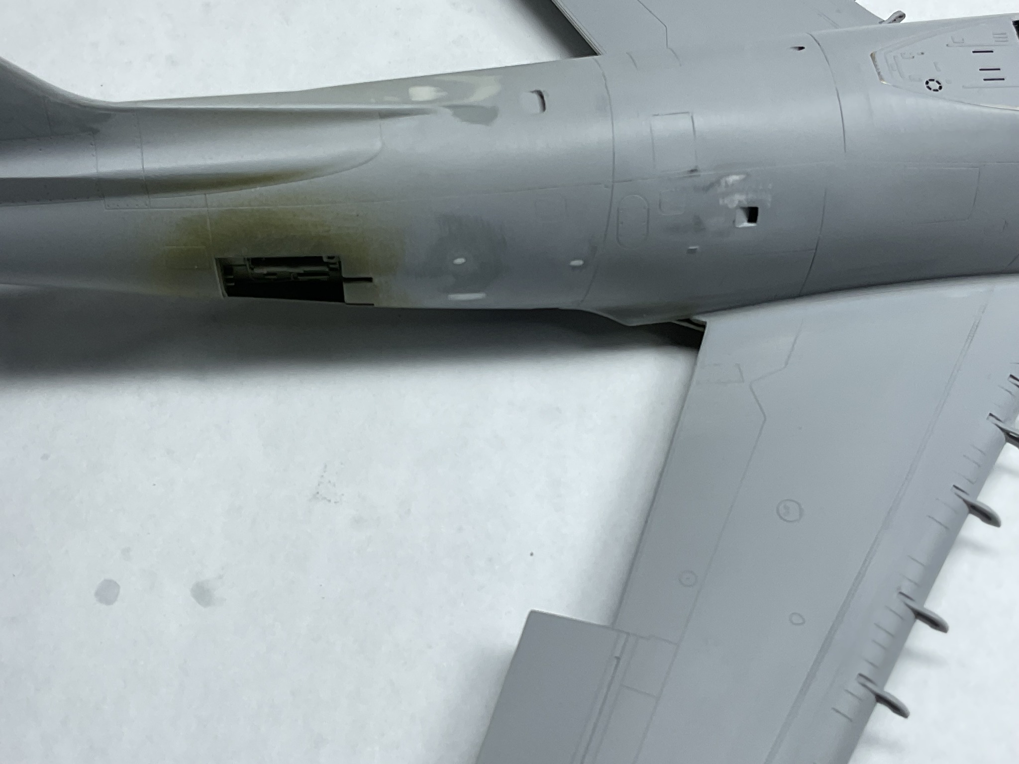

dai phan Posted February 5, 2024 Author Share Posted February 5, 2024 (edited) With the top fuselage vent completed and that experience gave me valuable practice to do the fuselage sides. MK6 does not look right without the sugar scoops or side vents. Interestingly not all side vents are identical to each others. Some have more square then being rectangular. Dai Edited February 5, 2024 by dai phan Quote Link to post Share on other sites
dai phan Posted February 6, 2024 Author Share Posted February 6, 2024 (edited) Hi all, Added both side fuselage vents. Still waiting for the sugar scoops to be arrived from Czech. Dai Edited February 6, 2024 by dai phan Quote Link to post Share on other sites

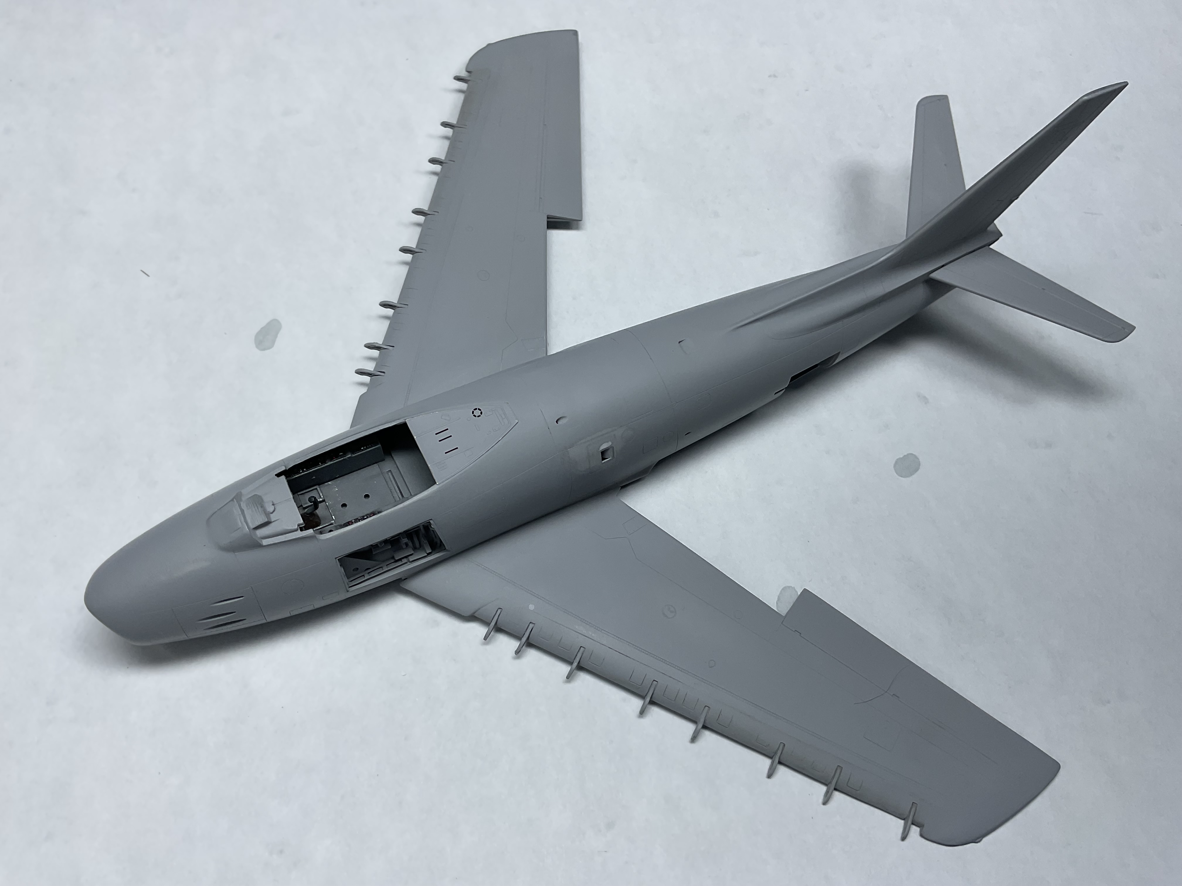

dai phan Posted February 13, 2024 Author Share Posted February 13, 2024 (edited) Hi all, Still waiting for the sugar scoops to arrive from CZ. In the mean time rescribe some lost panel lines and painted some areas. Dai Edited February 13, 2024 by dai phan Quote Link to post Share on other sites
Snowbird3a Posted February 13, 2024 Share Posted February 13, 2024 Those small vent holes (1 LH, 2 RH) on the aft section should not be there on a Canadair Mk6. Tony Quote Link to post Share on other sites
dai phan Posted February 13, 2024 Author Share Posted February 13, 2024 (edited) 12 hours ago, Snowbird3a said: Those small vent holes (1 LH, 2 RH) on the aft section should not be there on a Canadair Mk6. Tony Thank you so much and I will close them. Please let me know what else before I start painting the plane this week. Dai Edited February 13, 2024 by dai phan Quote Link to post Share on other sites
dai phan Posted February 13, 2024 Author Share Posted February 13, 2024 (edited) On 1/29/2024 at 8:19 PM, Snowbird3a said: Tony PS move the locating holes for the wing pylons in so they measure 53mm from centerline, they are in the wrong place-every manufacturer puts them in that spot for a late F-86F Hi all, I should have taken advise from Tony instead of going ahead with the tanks pylons. The picture of the Canada Aerobatic Team shows the pylons are at much more toward the center line than the kit's location. The red line is where the kit has you installed the pylons. But yet in some other Mk 6 photos, the pylons are not so as far inward. Are there different positions where the tanks are to be attached? The second photo I believe is the MK 6 with more outward position than the first. The third also shows more outward positions of the pylons. Dai Edited February 13, 2024 by dai phan Quote Link to post Share on other sites

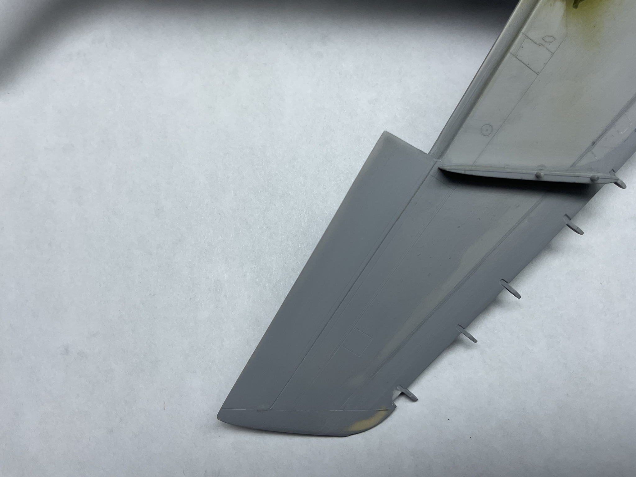

dai phan Posted February 13, 2024 Author Share Posted February 13, 2024 (edited) Hi all, No more small vent holes. Thank you Tony for pointing this out to me. Dai Edited February 13, 2024 by dai phan Quote Link to post Share on other sites

Snowbird3a Posted February 13, 2024 Share Posted February 13, 2024 (edited) Don't use the 'Hawk One' Sabre as a measure of the wing pylon position. It has a late Mitsubishi built wing with the later 2-pylon locations, and it's tanks are located on the inner most The pylons on a standard Sabre 6 are at Sta 99.5" and in 1/48 scale that is approx 53mm from centerline. this image shows at top, the later wing and the lower is the early wing applicable to F-86 A,E, Fs and Canadair models Tony Edited February 13, 2024 by Snowbird3a Quote Link to post Share on other sites

dai phan Posted February 14, 2024 Author Share Posted February 14, 2024 20 hours ago, Snowbird3a said: Don't use the 'Hawk One' Sabre as a measure of the wing pylon position. It has a late Mitsubishi built wing with the later 2-pylon locations, and it's tanks are located on the inner most The pylons on a standard Sabre 6 are at Sta 99.5" and in 1/48 scale that is approx 53mm from centerline. this image shows at top, the later wing and the lower is the early wing applicable to F-86 A,E, Fs and Canadair models Tony Hi Tony, Do you have a real photo of the underside as I would like to know how off I am from the kit's position. Unless it is drastic I will leave as is. Dai Quote Link to post Share on other sites
Snowbird3a Posted February 14, 2024 Share Posted February 14, 2024 4 hours ago, dai phan said: Hi Tony, Do you have a real photo of the underside as I would like to know how off I am from the kit's position. Unless it is drastic I will leave as is. Dai you don't need a 'real photo', the graphic I posted and my explanation is quite clear, the kit uses the outer pylon position of the later F-86F wing, while you need to move then inboard to a position of 53mm from centerline as per the earlier wing. Quote Link to post Share on other sites
dai phan Posted February 19, 2024 Author Share Posted February 19, 2024 On 2/14/2024 at 1:11 PM, Snowbird3a said: you don't need a 'real photo', the graphic I posted and my explanation is quite clear, the kit uses the outer pylon position of the later F-86F wing, while you need to move then inboard to a position of 53mm from centerline as per the earlier wing. Thank you very much and I will correct the placement as advised. I look at the F-30 wing and the holes are identical in positions like the F-40 wings too. That means Hasegawa had the pylons wrong in their kits ? Dai Quote Link to post Share on other sites
