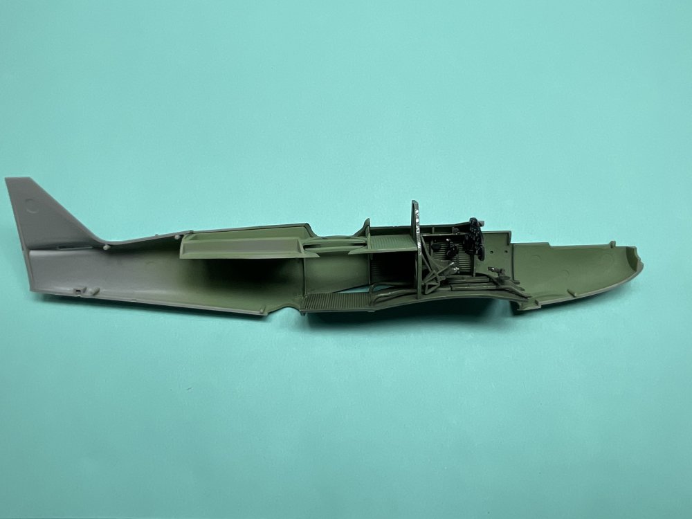

dai phan Posted December 23, 2023 Author Share Posted December 23, 2023 (edited) Hi all, While waiting for the KASL slat kit to arrive on the F-86, I went ahead and started on this project. So far the fit is good. One very odd thing is there are call outs for paint numbers on the instruction sheet but there is no reference to what these numbers mean? Hard to believe such omission that was not caught prior to printing. Luckily British interior consisted of green and black panels so easy to figure out. The CMK engine is very simple and the engine sits on the block so there is no headache should the engine mounts on the truss assembly. The Eduard PE set oddly does not include the seat belts. Dai Edited December 23, 2023 by dai phan Quote Link to post Share on other sites
dai phan Posted December 23, 2023 Author Share Posted December 23, 2023 Greetings, When using the CMK engine kit, do NOT cement the V struts until the firewall is cemented. The mating surface between the firewall and the struts is pin head. You will knock it off in no time by handling. When the firewall is cemented, the struts cannot be knocked off. Dai Quote Link to post Share on other sites

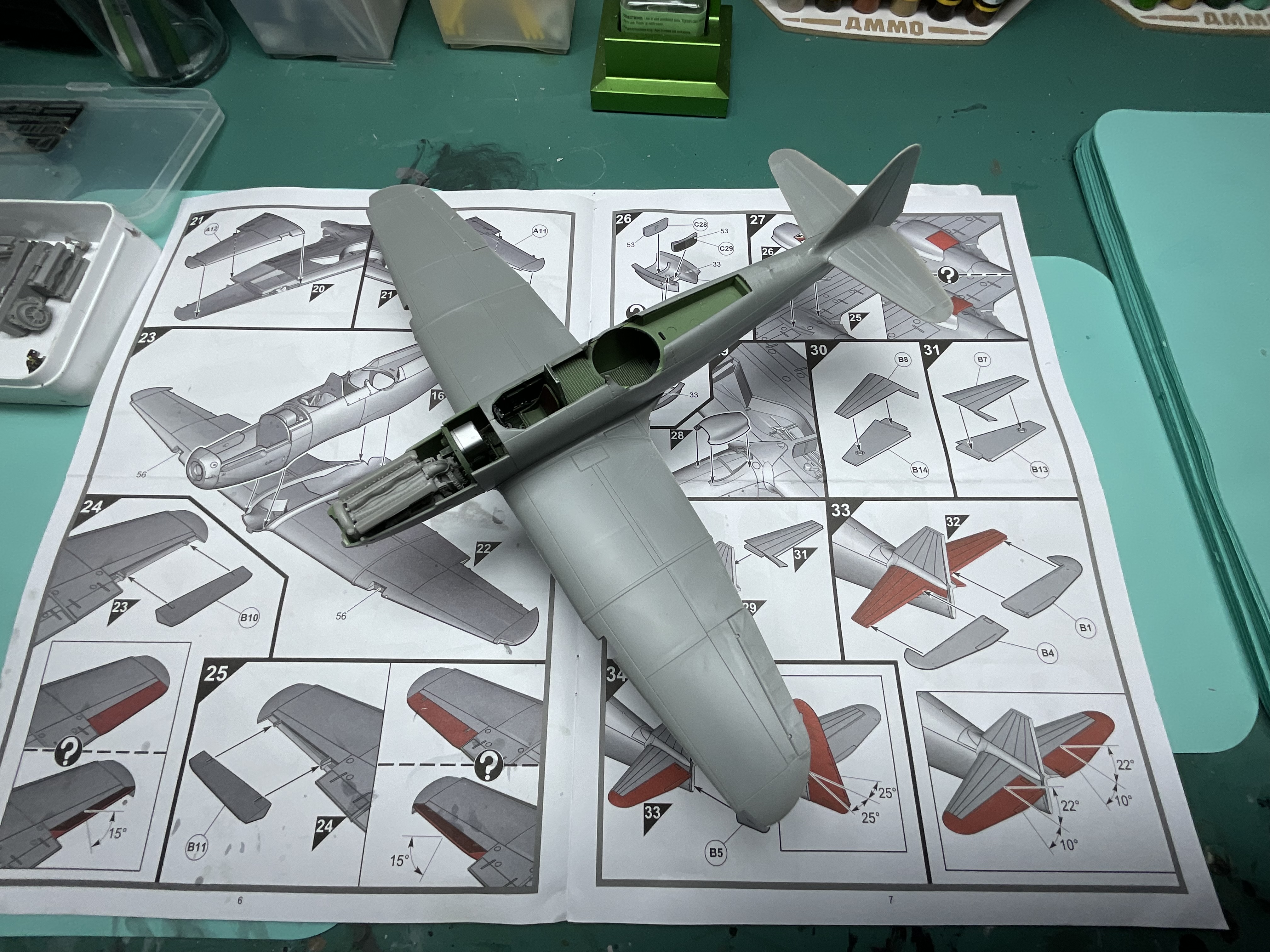

dai phan Posted December 24, 2023 Author Share Posted December 24, 2023 (edited) Happy Holidays friends, Continue on with the build. The fit is good and I had to trim a little bit of the front of the cockpit floor to make room for the resin firewall. I really appreciate the instruction that shows the correct placement of the parts in different colors. Dai Edited December 24, 2023 by dai phan Quote Link to post Share on other sites

dai phan Posted December 25, 2023 Author Share Posted December 25, 2023 (edited) Merry Christmas everyone, Continue working on the project. So far the fit is good without any surprises. The turret is a work of art and Kudos to Airfix designer team. I like the fact the turret is removable after the whole airframe is assembled to make painting easy. You need to do some light sandings at the turret surface where it touches the fuse so it can rotate freely but still with friction. On the bottom of the fuse, there is a ovoid panel line where the wing joins the fuse and I am not sure if this exists on the real aircraft or not. So far I am quite pleased with the fit and engineering. I wish the surface details can be a bit more finesse rather than being clunky. Dai Edited December 26, 2023 by dai phan Quote Link to post Share on other sites
dai phan Posted December 25, 2023 Author Share Posted December 25, 2023 (edited) Hi all, There are long sink marks on the top wing that must be filled and sanded. I apply a layer of medium CA then sanded smooth. Dai Edited December 25, 2023 by dai phan Quote Link to post Share on other sites

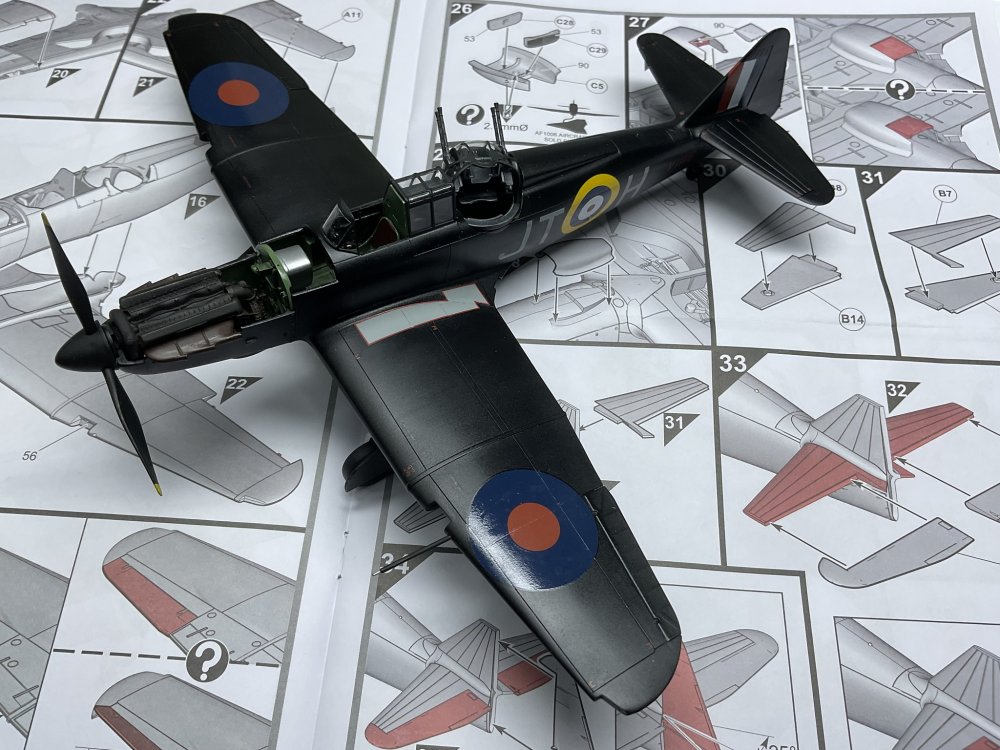

dai phan Posted December 29, 2023 Author Share Posted December 29, 2023 (edited) Hi all, I used Eduard''s mask but I am unable to get sharp edges this time. However when installed on the model, these defects are not evident. There are multiple masking pieces to apply but do not need to. They can cut down numbers of masks and still get the desired result. Like 2 pieces to mask a square area. Dai Edited December 29, 2023 by dai phan Quote Link to post Share on other sites
dai phan Posted December 29, 2023 Author Share Posted December 29, 2023 (edited) Hi all, The plane is now ready for the clear coat and application of decals. The engine and canopies are just tacked on for photo shot. Dai Edited December 29, 2023 by dai phan Quote Link to post Share on other sites

dai phan Posted January 6, 2024 Author Share Posted January 6, 2024 (edited) Hello friends, Applied the decals today. I use the Xtradecal and the decals are thin, strong and respond to Mark Fit Strong. However they suffer from off registry on some decals, wrong spacing and sizing. Also the clear film is affected from solution as you can see from the photos. I think once the clear coated applied, wash, weathering the issue will be resolved. I do not understand why many decal companies got the decals wrong with references easily are at hand. It seems like the illustrator just looked at the photos once then draw from memories ! I had to trim way oversized rudder decals to make them acceptable. Dai Edited January 7, 2024 by dai phan Quote Link to post Share on other sites
dai phan Posted January 14, 2024 Author Share Posted January 14, 2024 Hi all, Weathering time. The Prisma pencil works very well over the black base. Dai Quote Link to post Share on other sites
DIO Posted January 15, 2024 Share Posted January 15, 2024 (edited) Nice one. Check the national insignia on the port side. It is not sitting well in the wing panel line. I have never made those pencils work for me. Edited January 15, 2024 by DIO Quote Link to post Share on other sites
