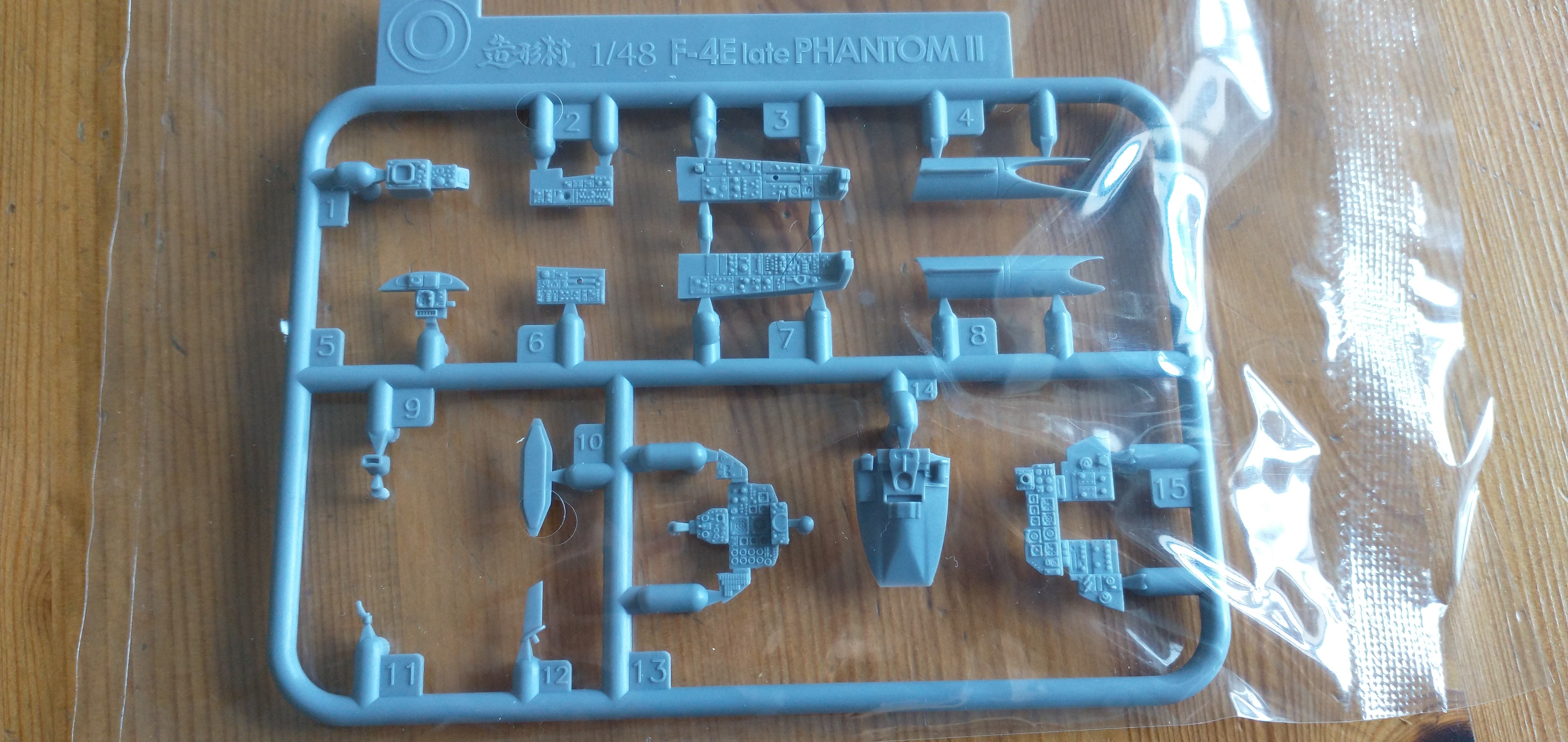

Miramar Road Posted April 28, 2024 Author Share Posted April 28, 2024 I just grabbed this kit from the Volks Shop at the Radio Kaikan building in Akihabara yesterday. Overall it has most of the sprues you'd see in the early F-4E kit, but with the late F-4G sprue that includes the slatted wing with the belly strap. If you're doing a pre-1971 F-4E airframe you'll be ok since those had belly straps. However, if you are doing one after the "71-" serial cutoff point, those Phantoms don't have the strap. The option in the kit is the MO ANG commemorative with MiG kills 68-338 so you have what you need in the kit for that particular Phantom. If you wanted to do a strap-less F-4E, one option is to order the strapless wing sprue used in the early F-4E or F-4EJ Kai kit from ZM themselves and fit the slatted wingtips to those parts. The most notable sprue is the new "O" tree, which includes later F-4E instrument panels and side-consoles. Most importantly it includes the TISEO and the ARN-101 antenna mods used on some F-4E's. Even though ZM doesn't have you using these parts since the MO ANG Phantom doesn't have them, its a nice extra. If I were to guess, ZM might issue a later boxing with decals for an F-4E that has the TISEO and ARN-101. They've done different boxings for the F-4J and the F-4EJ with different decals so it would make sense. They also could do a huge variety of foreign F-4E's since most exported E Phantoms were the slatted-wing types. If not ZM, the aftermarket can provide parts for other foreign F-4E's like the Greek AUP, Turkish Terminator 2020 and Israeli Kurnass 2000. I do remember hearing that the German F-model Phantoms are next up on the long-nose Phantom pipeline, so that's probably what we will see next from ZM. Then they will move on to the recon Phantoms down the line. Quote Link to post Share on other sites
JeffreyK Posted April 29, 2024 Share Posted April 29, 2024 52 minutes ago, Miramar Road said: I just grabbed this kit from the Volks Shop at the Radio Kaikan building in Akihabara yesterday. Overall it has most of the sprues you'd see in the early F-4E kit, but with the late F-4G sprue that includes the slatted wing with the belly strap. If you're doing a pre-1971 F-4E airframe you'll be ok since those had belly straps. However, if you are doing one after the "71-" serial cutoff point, those Phantoms don't have the strap. The option in the kit is the MO ANG commemorative with MiG kills 68-338 so you have what you need in the kit for that particular Phantom. If you wanted to do a strap-less F-4E, one option is to order the strapless wing sprue used in the early F-4E or F-4EJ Kai kit from ZM themselves and fit the slatted wingtips to those parts. The most notable sprue is the new "O" tree, which includes later F-4E instrument panels and side-consoles. Most importantly it includes the TISEO and the ARN-101 antenna mods used on some F-4E's. Even though ZM doesn't have you using these parts since the MO ANG Phantom doesn't have them, its a nice extra. If I were to guess, ZM might issue a later boxing with decals for an F-4E that has the TISEO and ARN-101. They've done different boxings for the F-4J and the F-4EJ with different decals so it would make sense. They also could do a huge variety of foreign F-4E's since most exported E Phantoms were the slatted-wing types. If not ZM, the aftermarket can provide parts for other foreign F-4E's like the Greek AUP, Turkish Terminator 2020 and Israeli Kurnass 2000. I do remember hearing that the German F-model Phantoms are next up on the long-nose Phantom pipeline, so that's probably what we will see next from ZM. Then they will move on to the recon Phantoms down the line. I'm going to pick up y box soon as well. Based on the engravings on the wing panels for mounting the TISEO I'm a bit suspicious about the size of the part, but I'll hold judgement until I have the plastic in my hands. ZM have not (yet) tooled a strapless, slatted wing. If they want to release the F-4F for example, or make boxings for later block types they will have to thoguh. To build a stap-less slatted wing for the moment means sanding down the strap. If you took a strapless lower wing part from a previous release you need to remove the slatted leading edge from this kit and transplant it to the other lower wing as the leading edge construction is quite different. Sanding down the strap is work and requires skill but the slat transplant isn't easy either and you'd have to get another wing sprue. J Quote Link to post Share on other sites
Ben Brown Posted April 29, 2024 Share Posted April 29, 2024 (edited) I see they didn’t include a rear instrument panel and WSO’s right console with the displays and keypad for an ARN-101 jet. @JeffreyK, perhaps you could release those parts from your excellent slat conversion set. I think the Z-M LORAN doghouse might be a bit too short or wide. It looks odd. Thanks for posting the photo, @Miramar Road! Ben Edited April 29, 2024 by Ben Brown Quote Link to post Share on other sites
