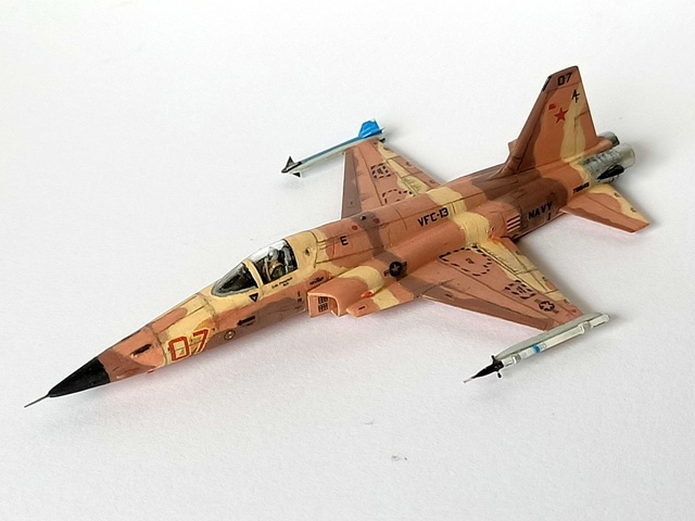

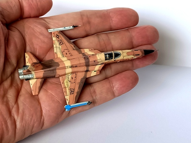

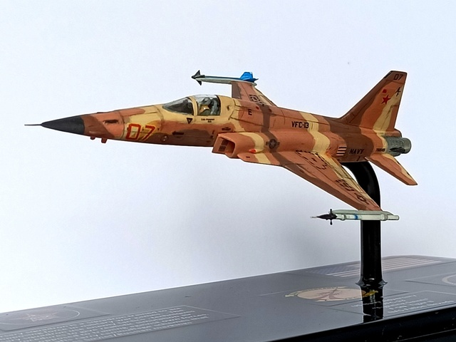

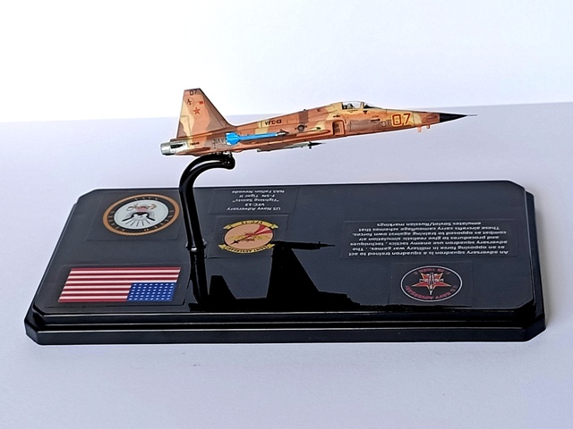

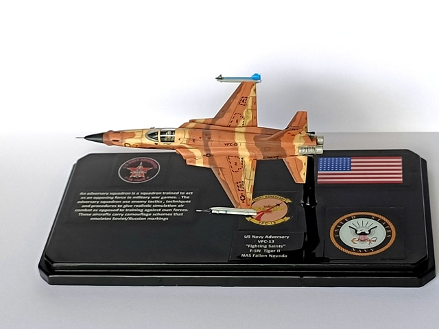

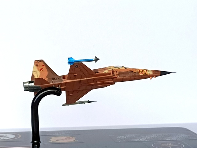

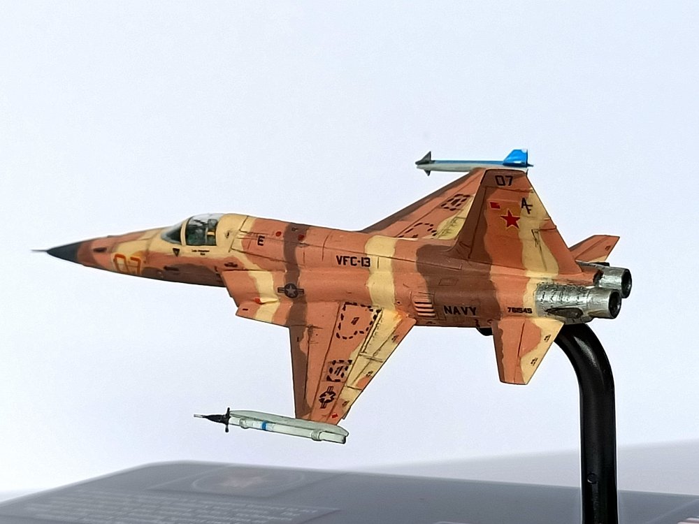

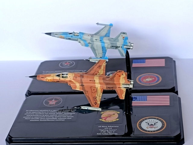

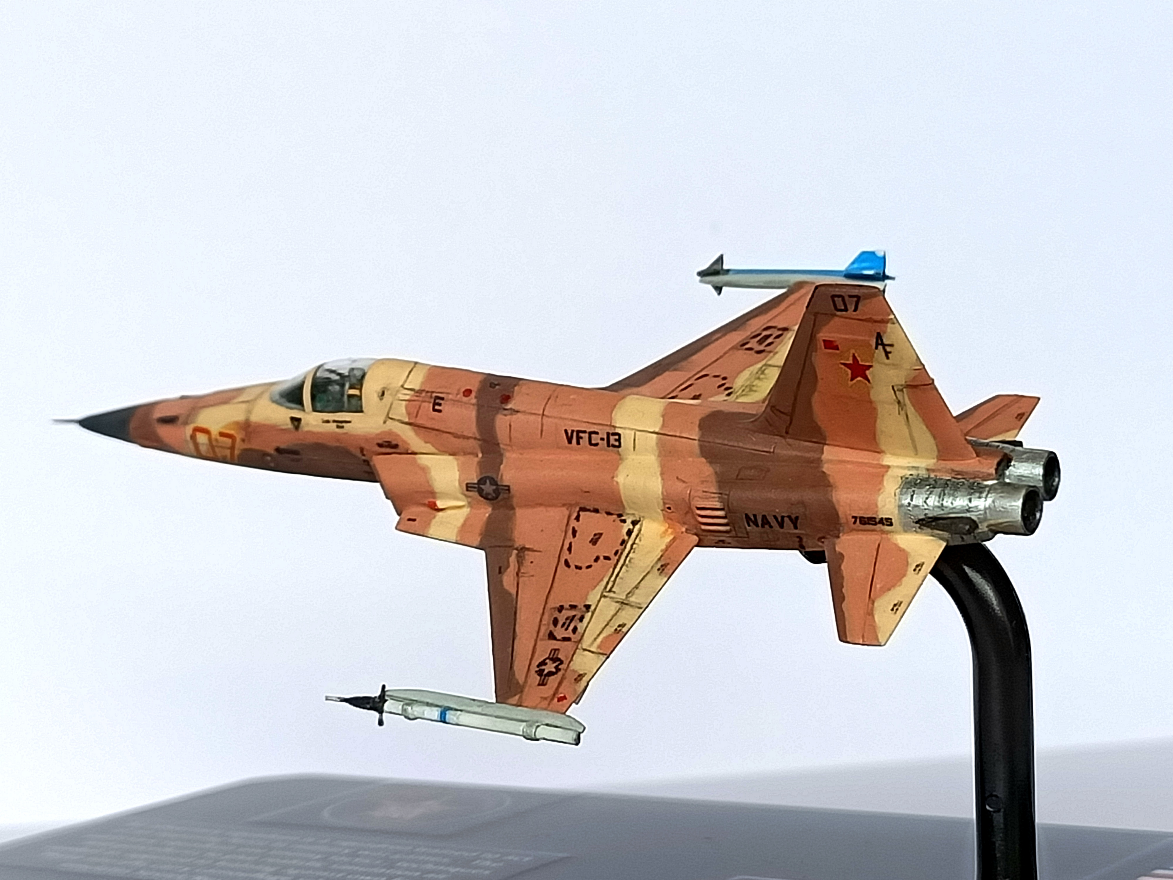

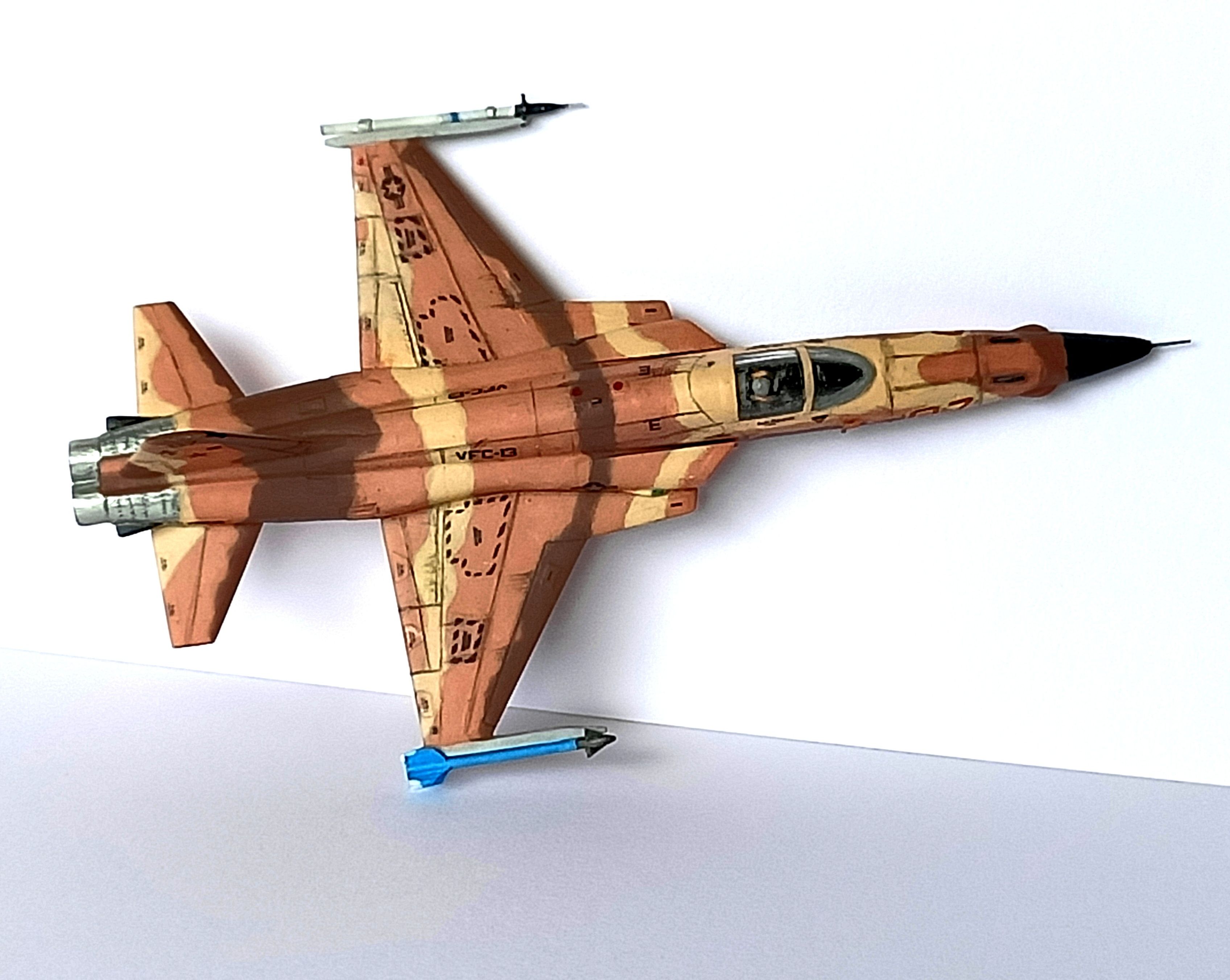

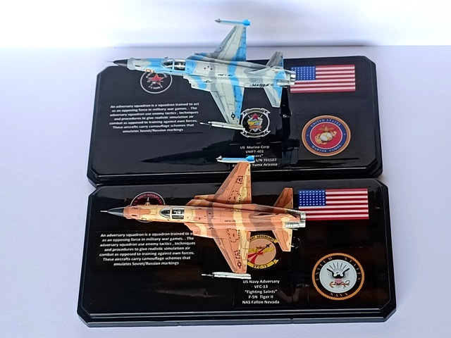

Here's another build using the Revell F-5E kit to convert it to a VFC-13 F-5N Fighting Saints. The build approach is similar to my earlier build of the VMFT-401 F-5N. I decided to have it painted in the lizard scheme as I quite liked the colour scheme.

The paint scheme is really sharply done. I've noticed you fixed the kit's backwards Sidewinder rails - is there any other modification you make to the kit?
Yes. The sidewinder rails were moulded wrong way round. Re-build the nose for the shark nose style using plastic strip. Replaced the original exhaust which appeared too tapered with 4mm size tube thinned down from the inside. And then the RWRs and AOA add- ons. Created an ECS vent on the left side of the canopy.
