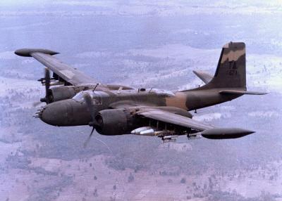

Hi folks! I have a few questions one the counter invader, mostly centered around weapons carriage. First off, was a standard MER used for carriage of the flares, illustrated on the outer wing station in this picture? The carriage device in the ICM kit looks like it wants to be a MER, but I wasn’t sure if this is a unique A-26 piece of hardware.

Doing an educated guess here but it looks like the rack on the wing is a MBR (Multiple Bomb Rack) and not a MER.
You can find a few pics of an MBR here;

For what rack was used for flares on the wings, the manual lists it as the MAU-63/A. Now, what exactly is the MAU-63/A..........good question, I couldn't find any information online for the MAU-63/A.

There’s also a few pics of the “MAU-63/A” used for flares, looks like a Douglas MBR bomb rack to me.

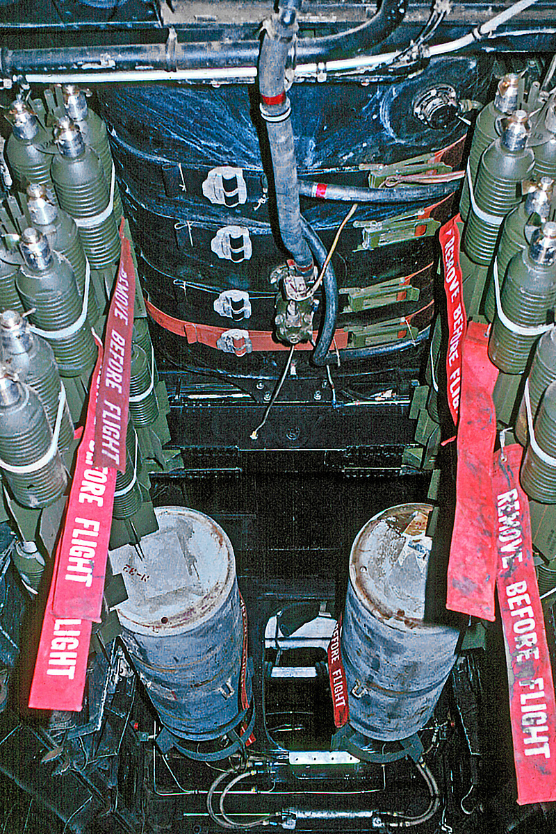

Here's a better photo of the bomb bay load: 4 funny bombs and six frag bomb racks. C.E.M. has 1/48 M31 funny bombs and M4 20Lb frag racks in 1/48.
I'm also looking for a photo of the jump seat on the right side of the cockpit behind the copilot/navigators seat. I assume it's just a seat cushion with a lap belt, but I can't find a photo.
I also suggest the book "The Nimrods." It's a good narrative on B-26K operations over Laos.
Mig
It looks like there is also a fuel tank at the top of the bomb bay.
That's correct. The filler is on the top of the fuselage just behind and to the left of the VHF antenna. It's a 100 gallon tank.
