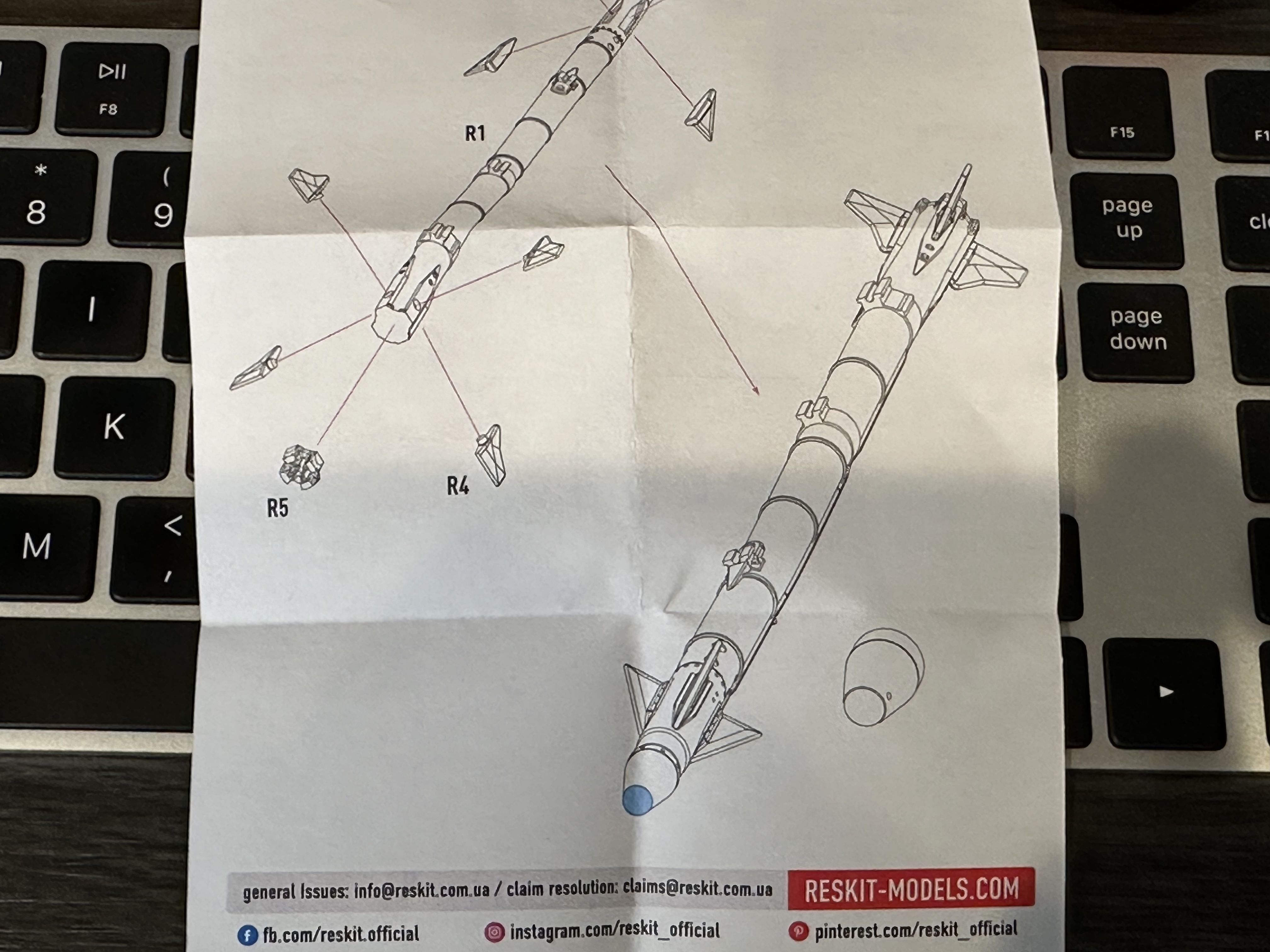

Kazu Posted February 16, 2024 Share Posted February 16, 2024 I had a set of resin BRASSIN 1/48 AIM-9X. They molded the tiny tail end piece separately. It's the R5 in the image, and that piece has 4 parts protruding from a base that's a mere fraction of a millimeter. Just trying to cut the base can sometimes shatter the resin, ruining the piece. If you saw it off, you still have to sand off the base (standard procedure, right?), and in the process, the piece breaks. I managed to break all 4 parts so had to throw out the BRASSIN set. So I order a Reskit version, but I found it used the same mold, so same problem. Ugh!!! I consider myself pretty good with handing even the smallest parts of 1/48 aircraft, but this has me baffled. Who thought a design for a detail kit like this would work? Am I missing some fundamental technique, or do you need an ultrasonic knife? If so, could someone please recommend one that works well and is reliable? Quote Link to post Share on other sites

ExchefAndy Posted February 16, 2024 Share Posted February 16, 2024 I recently did some amraams myself in the same scale, and right now I don't remember the make. My only suggestion would be what I ended up doing, use something like blutak or what ever you have to stick posters to walls. A small piece on the end of a toothpick or something like it and stick it to the piece on the sprue. Then using the sharpest blade you have, slowly and with repeated attempts... seperate each piece from the sprue. No rush, just a gentle cut each time. Let the weight of the blade do the job, and it may take 10 to 15 passes but it will work. The blutak will also prevent the small piece jumping off and disappearing. It can be done, just take your time doing it. Andy Quote Link to post Share on other sites
Kazu Posted February 16, 2024 Author Share Posted February 16, 2024 Thanks, Andy! That was a brilliant suggestion. I embedded the piece in Blu-Tack and after sawing off most of the base, I sanded the rest down to the 0.5mm thin piece. Contrary to what I initially thought, this Reskit version isn't the same mold as the BRASSIN. It's broken into even more parts. Fortunately, the resin seems to be a bit less brittle and softer, so it took almost no time to sand things down. I probably could have sanded all the way without using a saw, which would have been even easier. But Blu-Tack was the way to go! Quote Link to post Share on other sites

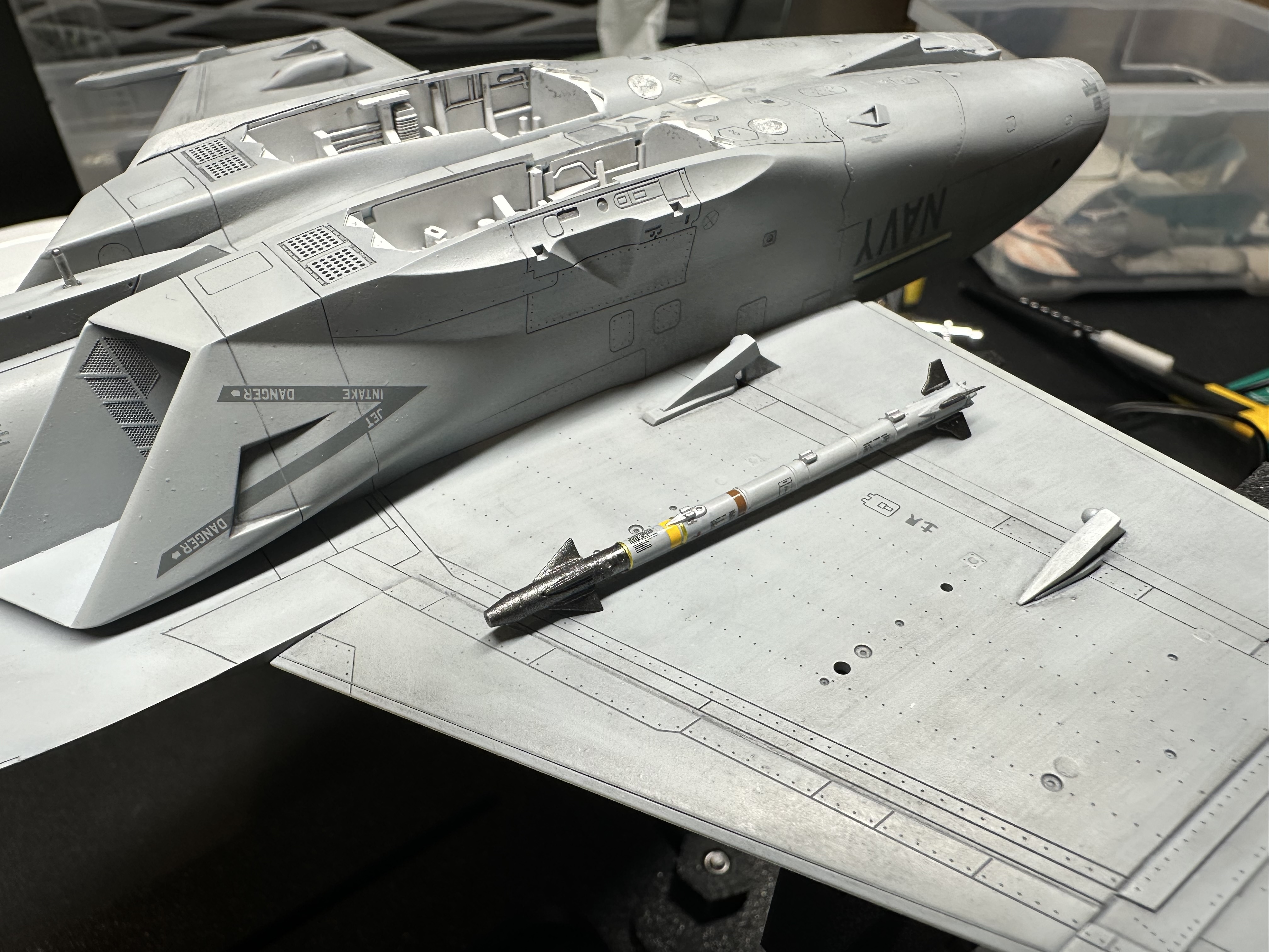

Kazu Posted February 18, 2024 Author Share Posted February 18, 2024 Hand painted the details and applied the decals. Still have to clear coat, panel line, etc., but here's how it's coming along. The tail fins are so fragile... Quote Link to post Share on other sites

ExchefAndy Posted February 19, 2024 Share Posted February 19, 2024 That turned out rather well, nice work! Andy Quote Link to post Share on other sites
