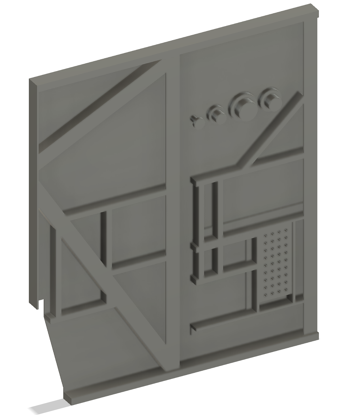

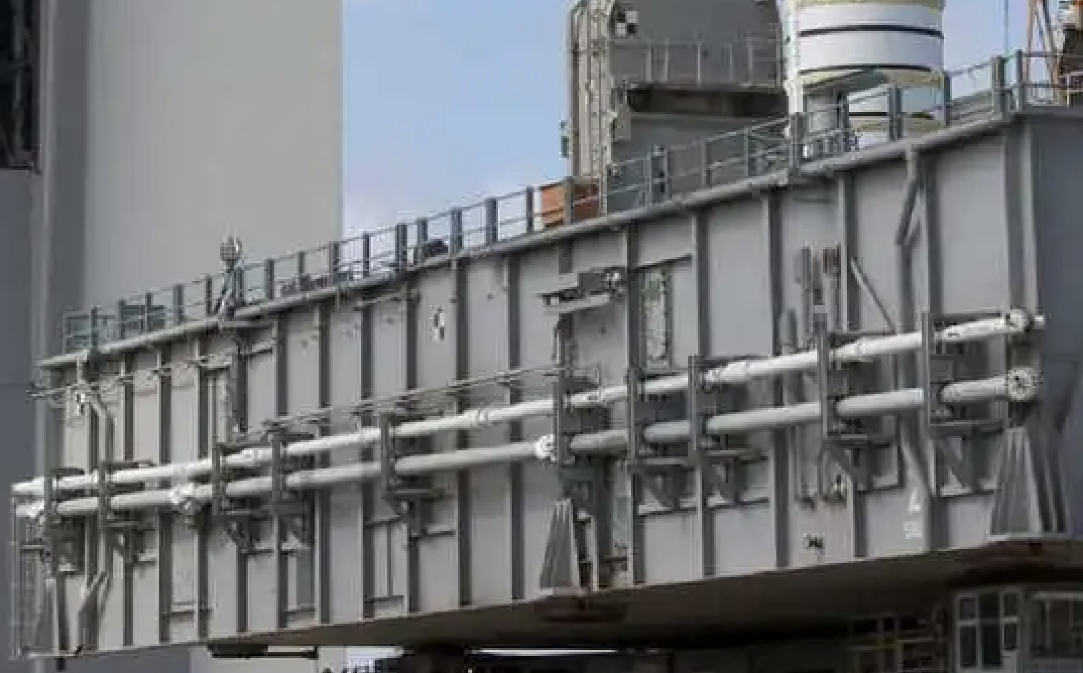

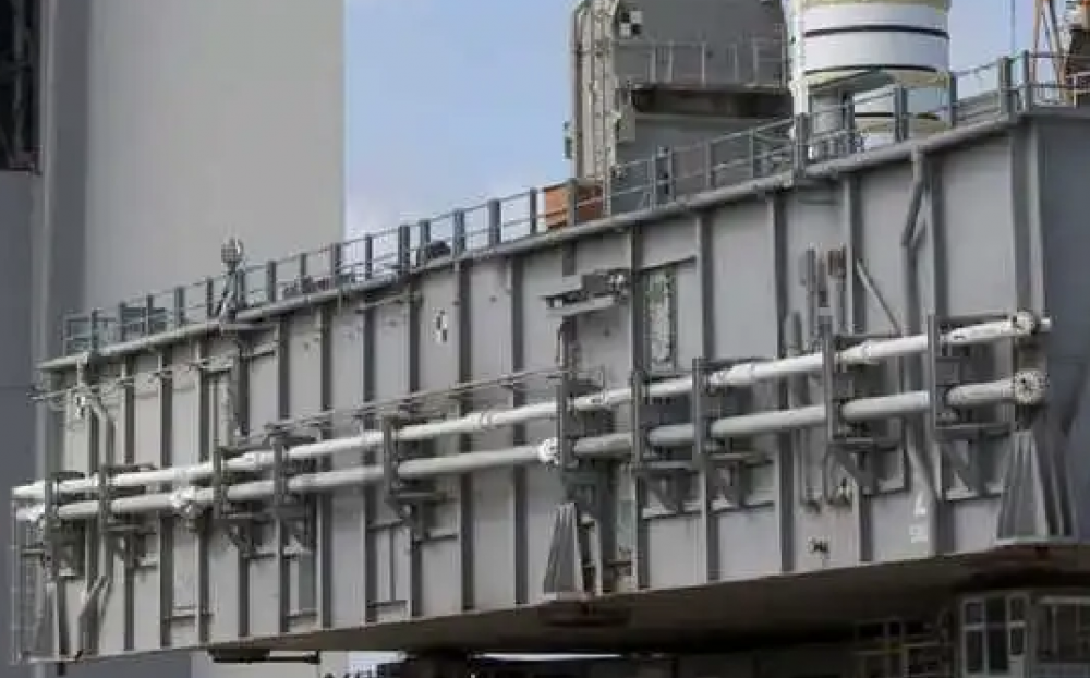

On to side 4.  It looks like these pipes gradually slope down from side 1 to side 3.  When they turn the corner they are close together.  It looks like the first 5 pipe brackets are the same.  The next 5 brackets have a spacer between the pipes.  I will go ahead and make two pipe bracket types for this side.

It's nice that you're using photos from my STS-6 construction report, but then you should cite the source too, that's just part of the game. :whistle:

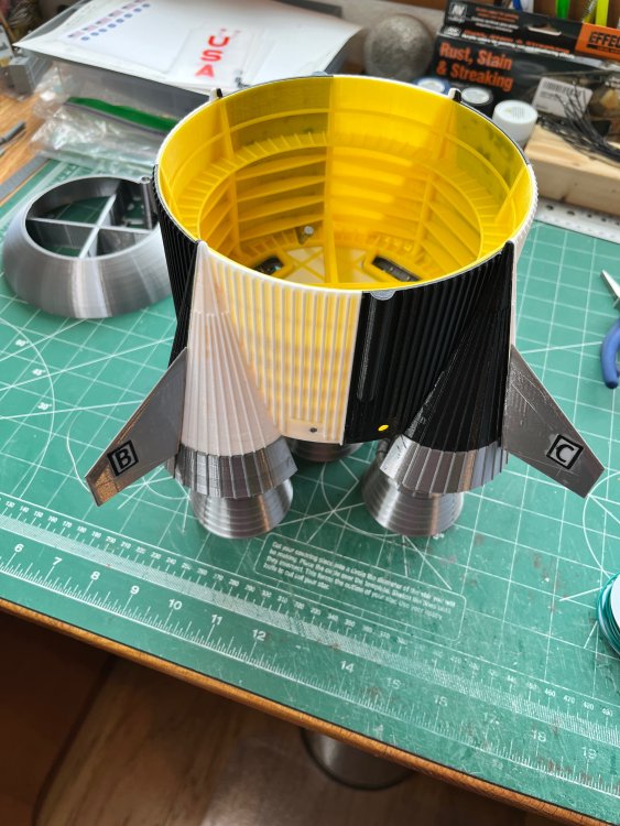

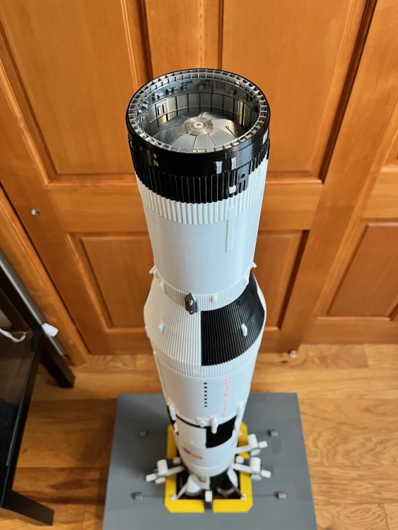

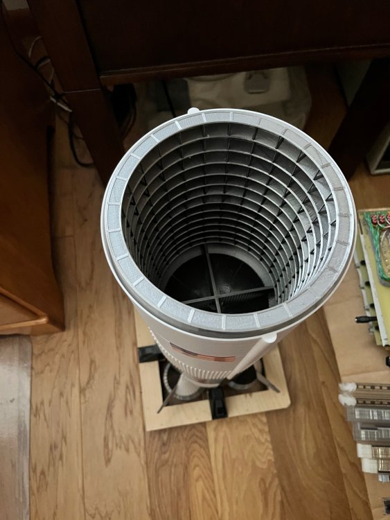

I am very impressed by the various Amphioxus models.  I would highly recommend these models.  For those that need a link here is a home page https://www.chronic3d.com/assembly-instruction/ and the print files can be downloaded for a minimal fee at https://cults3d.com/en/users/theamphioxus/3d-models  It appears the Saturn V model can be seen at various NASA museums around the country.
 Many model rockets only model the exterior.  These models have the detail on the interior as well.  The Saturn V had a great deal of detail.  The various rocket sections are not glued together so you can display the parts on stands in the horizontal position or stacked in the vertical postition.

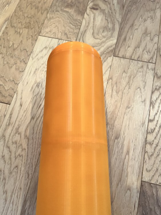

The shuttle external tank consists of only two tanks.  This large part of the model only separates into two parts, the two tanks.  There is detail in the inter tank region that is visible when the two tanks are separated.  On the Saturn V there are many upper and lower tank ends that consist of 8 parts that have to be glued together.  This model has two of these tank ends that can ether be printed as separate parts or printed as one part (which I did).  This made for a much easier assembly.  The lower tank consists of three parts.  after gluing them together I sanded the joints and then sprayed it with Tamiya acrylic orange with a bit of flat black added to darken the color a bit.
