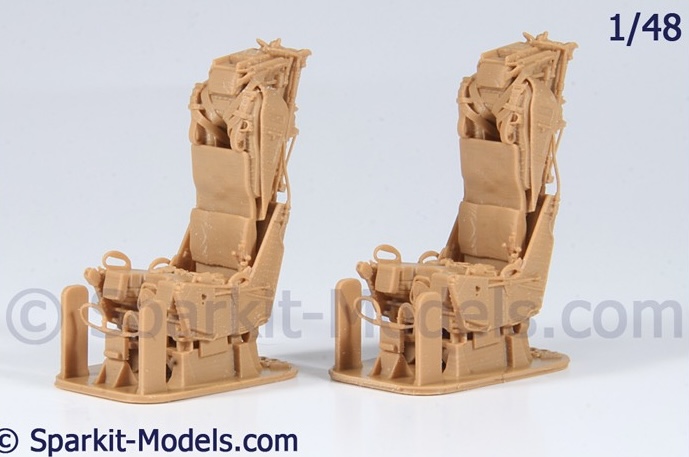

www.hypersonicmodels.com has a rather nice Mk.H5A seat for about $7, and the IRST pod for around $4.  Just have to make sure you order the USN seat (or the USAF seat), on your build.

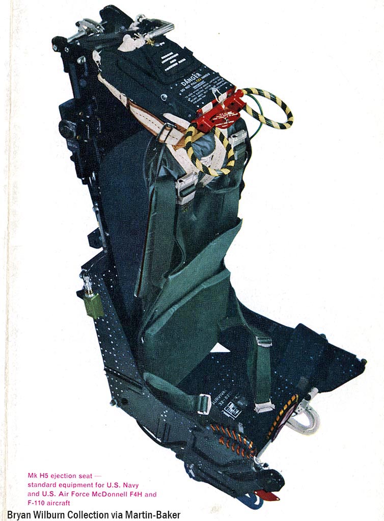

12 hours ago, Phil not the one already used said:
Looks like Eduard makes an early ejector seat: 648709 but they don't say what it is.  Is it the martin baker H5?
The Eduard seat is a MB Mk.H5A seat.  Desighan'd to work with the integrated harness the pilots would put on before they got to the birds.  If you want to do a  bird with the Mk.H5 seat you're going to need to replace the harness, but they switched over to the Mk.H5A after a short period of time.  They are nice, but a bit spendy.  Hypersonic has a nice seat, and it's a bit more reasonable.  But take note when you order it to make sure you select the Navy seat!
Eduard lists their seat as an F-4B seat, but it will work for any Navy F-4 from around 1963 to April 1968.  The F-4J aircraft initially started out with the Mk.H5A seat for the initial production birds, and switched during the production.  Although they didn't complete upgrading the Mk.H5 ballistic seats to Mk.H7 rocket seats for a few years.

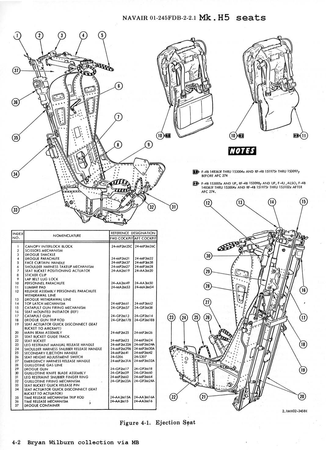

This thread will pretty much tell you everything you need for the seat.
Jet AC ejection seats - Jet Modeling - ARC Discussion Forums (arcforums.com)
