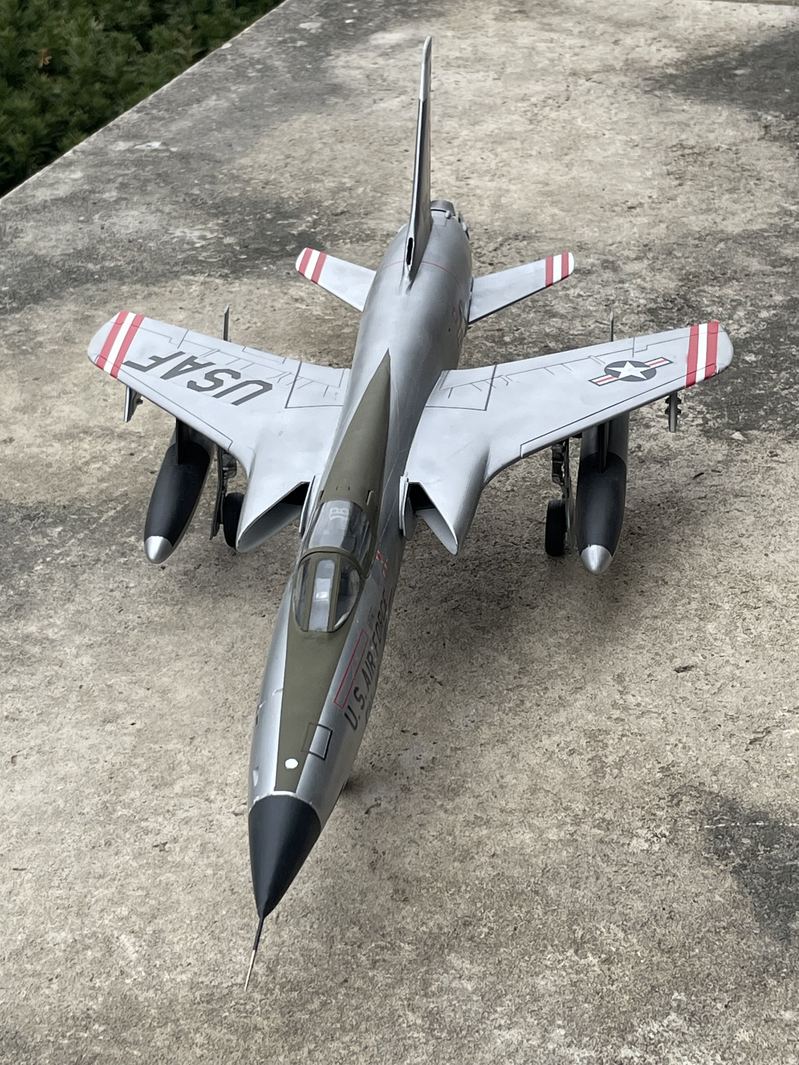

IAGeezer Posted March 29, 2024 Share Posted March 29, 2024 I can't help with the OPs question, but I agree about the Monogram Thud. The real A/C has an ogive, Mono provides a cone. I made myself crazy over a fix until I simply added a .030 shim on the BACK side to eliminate that step between fuselage and cone, filled the pitot hole in the front, and filed the fwd half to taper to a point. Now the length is correct for the cone itself. I then drilled a hole, and inserted new pitot made from 1mm Albion NiSilver tube, with a needle in the end. A better modeler may have come up with a more elegant solution, but this is what I did. Cheers! Quote Link to post Share on other sites

JackMan Posted March 30, 2024 Author Share Posted March 30, 2024 5 hours ago, IAGeezer said: That looks very good. I think you did a good job because it looks way better than simply out of the box. Very nice metallic finish, too 2 hours ago, Gwen Phoenix said: Hi Jack, I don't think the ResKit radome will wholly solve the lack of ogive-shaped curve on the forward fuselage of the Trumpeter Thud kits because both the whole forward fuselage and radome on that kit is too straight. Back in the day, there was a good fix by DMold Modelworks for either the Trumpeter or Monogram kits in 1/48th scale. I missed the chance to get mine because Dmitri Malkov ceased selling these jewels when the pandemic broke out. Anyway, I recall him telling me that the fix for the Monogram kit was long OOP by early 2020, and the Trumpeter fix (which was still available), wouldn't fit the Monogram kit. But here's a good picture of the fix for the Trumpeter kit; check the ogive-shaped forward fuselage and radome in that correction set, which is quite distinctive in the Thud. Wish Dmitri Malkov were still in business Does anyone have news regarding him? Hope this helps. Cheers, Gwen Gwen, I see what you mean. the first two photos of Dmitri's set really shows the difference of how the entire front fuselage should be contoured. I think I'll hold off from getting the ResKit sets because....looking at D-Molds set....I think it's not just the nose that should be replaced. Roger Jackson addressed this with a spare Mig-25 nose and did an awesome job: https://modelingmadness.com/review/viet/jackson105i.jpg https://modelingmadness.com/review/viet/jackson105h.jpg https://modelingmadness.com/review/viet/jackson105.htm Compared to the un-modified nose (WARNING: NSFW): https://www.hyperscale.com/features/2001/images/F-105D_PussyGalore-14.jpg https://www.hyperscale.com/features/2001/images/F-105D_PussyGalore-03.jpg https://www.hyperscale.com/features/2001/f105dda_2.htm It's subtle, but to me, it's like the nose of the F-14 Tomcat or the F-15. Quite noticeable. Thanks everyone, for the inputs. Quote Link to post Share on other sites

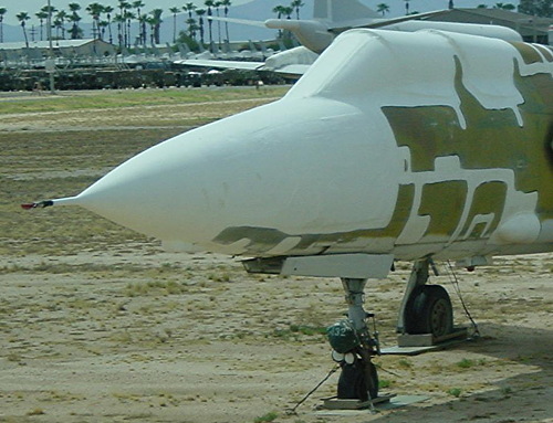

mrvark Posted April 8, 2024 Share Posted April 8, 2024 I think this picture I took at AMARC really shows the contours of the F-105's nose to great effect. The spraylat coating gets rid of all the distractions caused by camouflage and radomes to reveal the shape of the nose. Quote Link to post Share on other sites
Drifterdon Posted April 8, 2024 Share Posted April 8, 2024 1 hour ago, mrvark said: I think this picture I took at AMARC really shows the contours of the F-105's nose to great effect. The spraylat coating gets rid of all the distractions caused by camouflage and radomes to reveal the shape of the nose. Great pic. It also highlights the distictive shape of the canopy that the model manufacturers got wrong. Quote Link to post Share on other sites
JackMan Posted April 9, 2024 Author Share Posted April 9, 2024 22 hours ago, mrvark said: I think this picture I took at AMARC really shows the contours of the F-105's nose to great effect. The spraylat coating gets rid of all the distractions caused by camouflage and radomes to reveal the shape of the nose. I agree. Almost F-14-ish nose shape. This pic really does show ogive-shape contour to good effect, particularly against the darker background. Quote Link to post Share on other sites

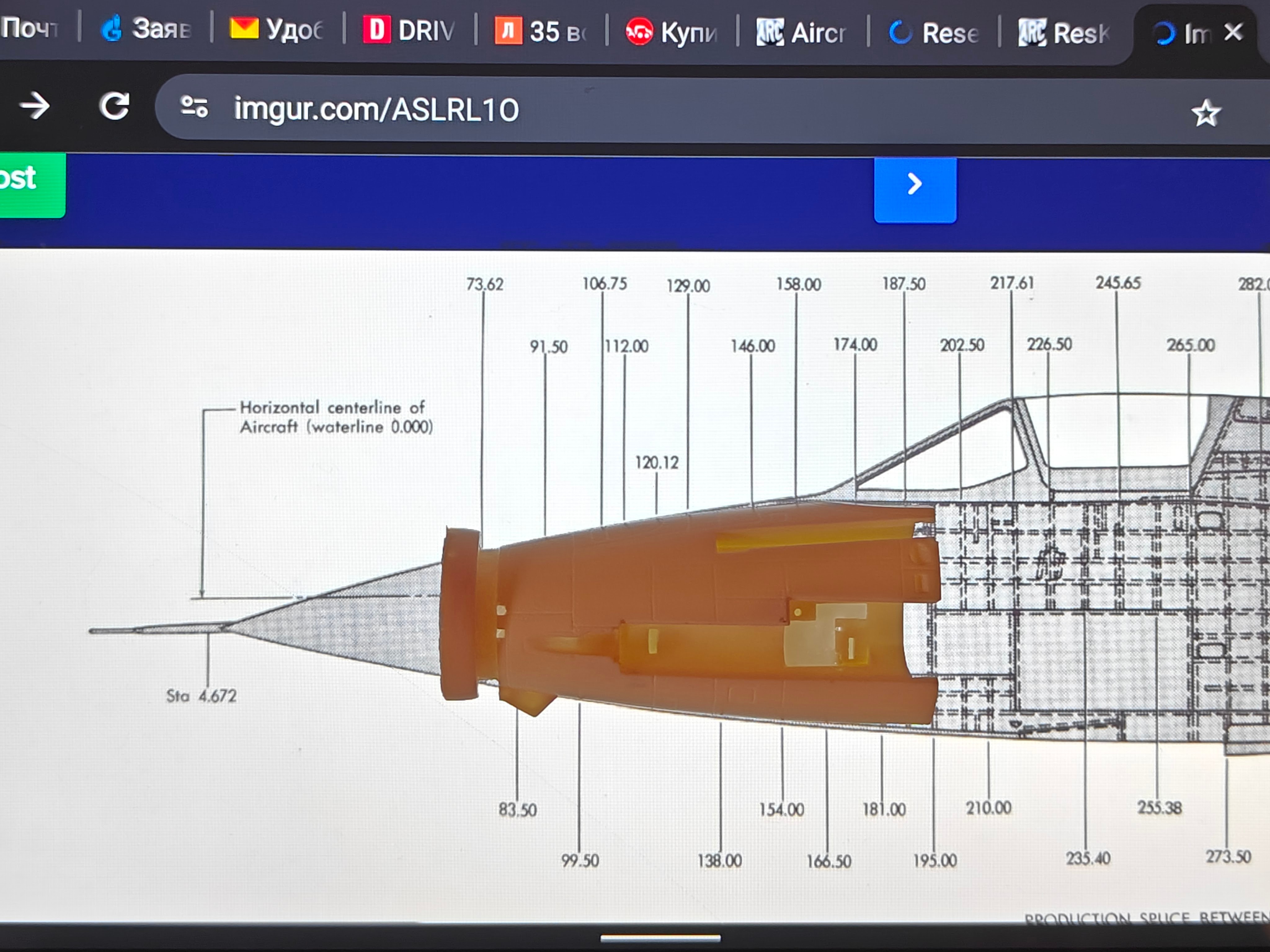

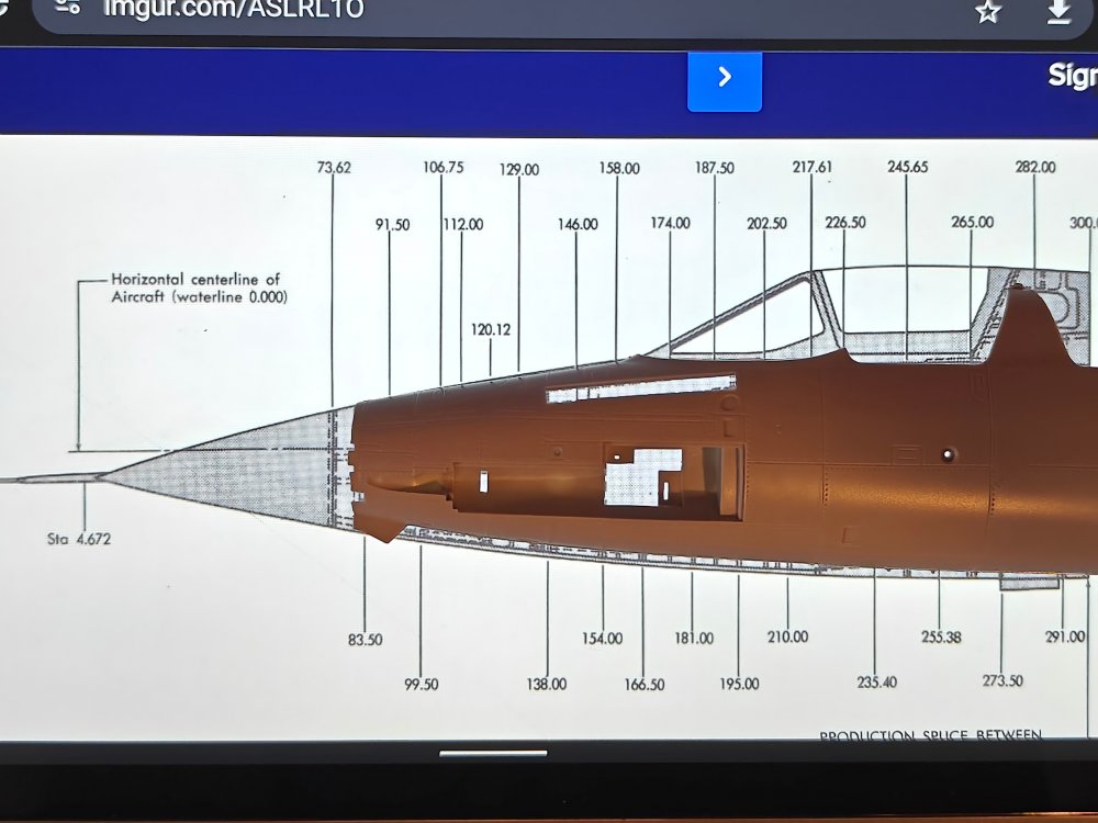

Sergei Galicky, Russia Posted June 16, 2024 Share Posted June 16, 2024 Hi all! Quick comparison of Dmold nose kit and HB fuselage kit. Quote Link to post Share on other sites
JackMan Posted June 17, 2024 Author Share Posted June 17, 2024 Thanks Sergei It looks like Dmold captured the shape better. Quote Link to post Share on other sites
Ben Brown Posted June 17, 2024 Share Posted June 17, 2024 Yikes! If that lower drawing is 1/48 scale, Trumpeter/Hobby Boss really missed the mark on the fuselage shape. Ben Quote Link to post Share on other sites
