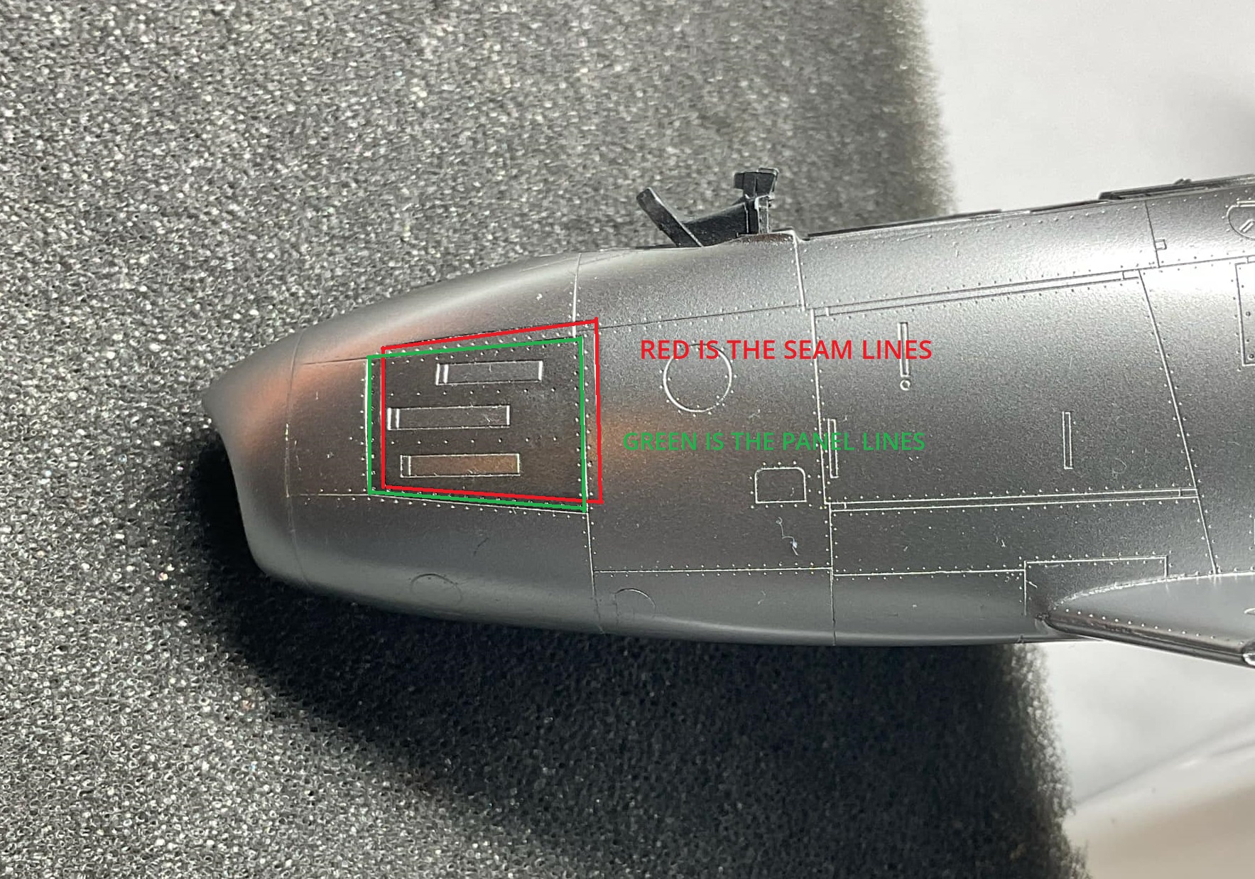

dai phan Posted January 8 Share Posted January 8 If the gun blast panels seam lines are in line with the panel lines, then a simple swipe or two with 1000 grit sponge will give you perfect panel lines. But because the seam lines are positioned, by trying to fill the seams (red lines) you will affect the panel lines (green) that may require re-scribing and re-placement of rivets. I find the engineering in this area is flawed. My goal is to provide constructive criticism and not bashing anyone. Dai Quote Link to post Share on other sites

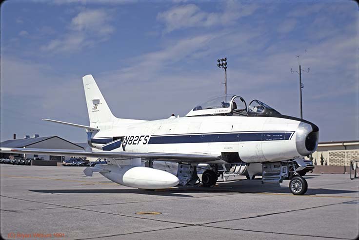

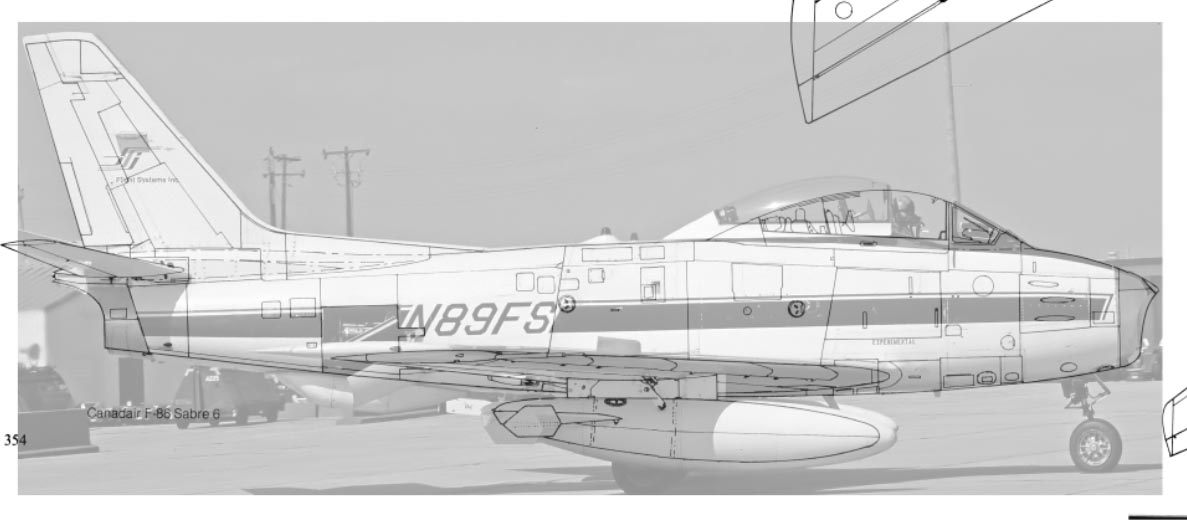

BWDenver Posted January 8 Share Posted January 8 (edited) 21 hours ago, Sabrejet said: Sabre 6, ex-Luftwaffe. 😉 The wing fence threw me... So, if I want to do a FSI Canadair “Mk6”, and I start with the Hasegawa Canadair Sabre Mk.5 Frecce Tricolori Kit, I have to do some re-scribing on the fuselage and adding the lower fuselage scoops? The kit has the 6-3 wing and fences. Below is some rework of a photo overlayed onto the profile plans out of Larry Milberry’s “The Canadair Sabre”, ostensibly to get a pattern for the FS fuselage stripe. The shot was taken at Tyndall in 91, with a bit of “Lens Perspective” correction, as the shot was not a good “profile” picture. I want to do either this bird, N89FS or N86FS with that huge data boom on the nose, as I saw and photographed the bird at Mojavi on the FSI ramp. I think N86FS was a Canadian bird and lacks the Martin-Baker canopy rail mod. Edited January 8 by BWDenver Quote Link to post Share on other sites
Sabrejet Posted January 8 Author Share Posted January 8 Pretty much: N86FS was a Sabre 5 that Bob Laidlaw effectively upgraded to a Sabre 6 (engine) but it retained the Sabre 5 wing for most of its life. Main parts to look for are the mid-fuselage re-scribings for the revised engine trunnions etc. Also the Hasegawa kit should need the fuselage top intake/vent panel sanding/removing so that you have just a vent forward of the dorsal fin extension. I can't recall if the 'Frecce' kit has the TACAN cooling duct forward of the RH speed brake (it shouldn't) but either way it shouldn't be there. Then finally a lot of those target tugs had the aft fuselage tow reel fairing added. FSI had a few Sabres with nose booms including N186F (early corporate scheme) and the two QF-86Es used in the Mill Race explosive effects tests. Quote Link to post Share on other sites
dai phan Posted January 8 Share Posted January 8 1 hour ago, BWDenver said: The wing fence threw me... So, if I want to do a FSI Canadair “Mk6”, and I start with the Hasegawa Canadair Sabre Mk.5 Frecce Tricolori Kit, I have to do some re-scribing on the fuselage and adding the lower fuselage scoops? The kit has the 6-3 wing and fences. Below is some rework of a photo overlayed onto the profile plans out of Larry Milberry’s “The Canadair Sabre”, ostensibly to get a pattern for the FS fuselage stripe. The shot was taken at Tyndall in 91, with a bit of “Lens Perspective” correction, as the shot was not a good “profile” picture. I want to do either this bird, N89FS or N86FS with that huge data boom on the nose, as I saw and photographed the bird at Mojavi on the FSI ramp. I think N86FS was a Canadian bird and lacks the Martin-Baker canopy rail mod. Greetings, You may find this thread useful. Dai Quote Link to post Share on other sites
JeffreyK Posted January 9 Share Posted January 9 9 hours ago, dai phan said: If the gun blast panels seam lines are in line with the panel lines, then a simple swipe or two with 1000 grit sponge will give you perfect panel lines. But because the seam lines are positioned, by trying to fill the seams (red lines) you will affect the panel lines (green) that may require re-scribing and re-placement of rivets. I find the engineering in this area is flawed. My goal is to provide constructive criticism and not bashing anyone. Dai I can't answer the blast panel decision right away, need to look at it more closely, but I'm sure there is a technical reason behind this... I agree it's not ideal, I had to deal with very similar problems on their D-21 kit recently (i.e. part joins running through other surface detail). But if it hadn't been for a generally poor fit of the wing-fuselage joint, clean up wasn't actually that bad and as I said, sanding smooth a joint and then partially restoring panel and rivet detail ADJECENT or PERPENDICULAR to the join I find much easier than trying to re-create a neat and clean panel line right in that joint. You mentioned the nose intake ring and where the joint is on the inside: This is a clear example of tooling/moulding limitations. If CP had put the inner part split where the panel line between nose ring and intake trunk is, they would have had to put a massive draft angle on the inner opening of the nose intake, i.e. at the end (at that panel line) the opening would have had to be much smaller, creating a conical shape of the nose opening so that the ring can be extracted safely from the mould. This would have created a funny looking intake with an underscale intake trunk diameter. To get around this they moulded part of the inner nose ring to the intake trunk, thus creating a much more accurate replica. But you need to fill that inner joint seam... J Quote Link to post Share on other sites

dai phan Posted January 9 Share Posted January 9 34 minutes ago, JeffreyK said: I can't answer the blast panel decision right away, need to look at it more closely, but I'm sure there is a technical reason behind this... I agree it's not ideal, I had to deal with very similar problems on their D-21 kit recently (i.e. part joins running through other surface detail). But if it hadn't been for a generally poor fit of the wing-fuselage joint, clean up wasn't actually that bad and as I said, sanding smooth a joint and then partially restoring panel and rivet detail ADJECENT or PERPENDICULAR to the join I find much easier than trying to re-create a neat and clean panel line right in that joint. You mentioned the nose intake ring and where the joint is on the inside: This is a clear example of tooling/moulding limitations. If CP had put the inner part split where the panel line between nose ring and intake trunk is, they would have had to put a massive draft angle on the inner opening of the nose intake, i.e. at the end (at that panel line) the opening would have had to be much smaller, creating a conical shape of the nose opening so that the ring can be extracted safely from the mould. This would have created a funny looking intake with an underscale intake trunk diameter. To get around this they moulded part of the inner nose ring to the intake trunk, thus creating a much more accurate replica. But you need to fill that inner joint seam... J Greetings Jeffery, You have much more knowledge than me about injection molded technology so I am learning everything from you. However I have built models since 1978 everything from Lindberg to Monogram to Tamiya. And in my limited knowledge CP could easily had saved modelers lots of extra work by placing the blast panels seam lines at the panel lines. The fit is so good like Tamiya that a simple swipe with sand paper will make the seam lines as perfect as the panel lines. CP could easily place the mating surfaces of the airelons, flaps and fuselage at the leading and trailing edges rather than dead smack center where the fine panel lines and rivets run through. It is heart breaking when these fine details are lost when it is easily avoided. And the joint line between the intake lip and nose piece can easily be joined at the correct seam line (molded in the intake lip) rather at the weird curve away from the actual panel line . I have built hundreds over 47 years and I can tell you it does not have to be this way. It seems like I am bashing and not being appreciative but all I want is to provide constructive feedbacks. The kit has very good fit and fine details. But the engineering negates all the pluses the kit has to offer. In my opinion, CP could easily set a landmark as the best absolute F-86A but too bad the engineering is a let down for me. Just a constructive suggestion. Dai Quote Link to post Share on other sites
BWDenver Posted January 9 Share Posted January 9 (edited) 6 hours ago, Sabrejet said: Pretty much: N86FS was a Sabre 5 that Bob Laidlaw effectively upgraded to a Sabre 6 (engine) but it retained the Sabre 5 wing for most of its life. Main parts to look for are the mid-fuselage re-scribings for the revised engine trunnions etc. Also the Hasegawa kit should need the fuselage top intake/vent panel sanding/removing so that you have just a vent forward of the dorsal fin extension. I can't recall if the 'Frecce' kit has the TACAN cooling duct forward of the RH speed brake (it shouldn't) but either way it shouldn't be there. Then finally a lot of those target tugs had the aft fuselage tow reel fairing added. FSI had a few Sabres with nose booms including N186F (early corporate scheme) and the two QF-86Es used in the Mill Race explosive effects tests. I reviewed the threads offered and it left a few questions with the wing on N89FS and N86FS. Would both of these have the 6-3 hard wing as seen in the photos? I don’t see any evidence of slats drooping. Is N86FS an Ex RCAF bird or German??? Edited January 9 by BWDenver Quote Link to post Share on other sites

jonbryon Posted January 9 Share Posted January 9 17 hours ago, dai phan said: I find the reasoning hard to accept because if the seam lines end on the panel lines simple swipe or two with sponge sandpaper will be just fine. Lots of modellers think they can do this and it will be fine. The reality is often very different. Getting a joint on a seam line to look invisible close up is extremely difficult (to the point where I've almost never seen it done to my satisfaction). Eliminating a seam is *much* easier than making it look like moulded recessed detail. Jon Quote Link to post Share on other sites
Sabrejet Posted January 9 Author Share Posted January 9 6 hours ago, BWDenver said: I reviewed the threads offered and it left a few questions with the wing on N89FS and N86FS. Would both of these have the 6-3 hard wing as seen in the photos? I don’t see any evidence of slats drooping. Is N86FS an Ex RCAF bird or German??? Yes 6-3 wing in both photos. N86FS was an ex-RCAF bird. Quote Link to post Share on other sites

dai phan Posted January 9 Share Posted January 9 (edited) 10 hours ago, jonbryon said: Lots of modellers think they can do this and it will be fine. The reality is often very different. Getting a joint on a seam line to look invisible close up is extremely difficult (to the point where I've almost never seen it done to my satisfaction). Eliminating a seam is *much* easier than making it look like moulded recessed detail. Jon Tamiya places seam lines on the panel lines and you cannot tell which is which? The fit of the CP panels fit like Tamiya so CP can easily do what Tamiya does. If CP place the seam lines away from the panel lines with the reason you mentioned, then place them far away rather than 1 mm from the panel lines. For expert modeler like you, a 1 mm or a mile does not make a difference. But for an average modeler like me at best, it is very difficult to fill the seam lines without wiping away the panel lines and rivets. As such I had to re-scribe and re-placed rivets. Some were too hard so I left alone. Interestingly on the 72 scale version, the gun panels rests on the panel lines. Dai Edited January 9 by dai phan Quote Link to post Share on other sites

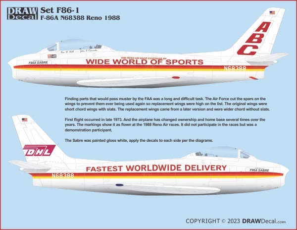

dai phan Posted January 9 Share Posted January 9 (edited) Greetings, I am thinking of doing this unique scheme as I have 2 extra kits. This is an A but it had wider chord and no slats. The Air Force destroyed the original wing spar so it cannot be flown again,. Therefore this A does not have the original slatted wings as on the CP kit. I wonder if I can graft the Hasegawa/Academy F-30 wing onto this to produce an accurate model? It seems that will work assuming the graft is done correctly. Because the F-30 has wider chord and no slats. Thank you for your expert replies. Happy New Year everyone... Dai From Draw Decal: Description In the late 1960s Ben Hall found the remains of an F-86A in a reclamation yard in Fresno CA. After purchasing it he trucked it to Paine Field, North of Seattle, WA and started a very long and involved rebuild to flying status. Finding parts that would pass muster by the FAA was a long and difficult task. The Air Force cut the spars on the wings to prevent them ever being used again, so replacement wings were high on the list. The original wings were short chord wings with slats. The replacement wings came from a later version and were wider chord without slats. First flight occurred in late 1973, and the airplane has changed ownership and home base several times over the years. The markings show it as flown at the 1988 Reno Air races. It did not participate in the races but was a demonstration participant only. Edited January 9 by dai phan Quote Link to post Share on other sites
Sabrejet Posted January 9 Author Share Posted January 9 It's an F-86A with narrow-chord wing, slats bolted shut and a wing fence. Hence a unique configuration. All you need to do is add the fence to the CP kit. The aircraft is still airworthy, and still flying. Quote Link to post Share on other sites
dai phan Posted January 9 Share Posted January 9 1 hour ago, Sabrejet said: It's an F-86A with narrow-chord wing, slats bolted shut and a wing fence. Hence a unique configuration. All you need to do is add the fence to the CP kit. The aircraft is still airworthy, and still flying. In that case, install the slats onto the wings instead of the slat bases then add fences. Simple enough but the description on Draw site says it is a wider chord wings? I am not doubting you as you are an expert but I wanted to make double sure. Thank you Duncan. Dai Quote Link to post Share on other sites

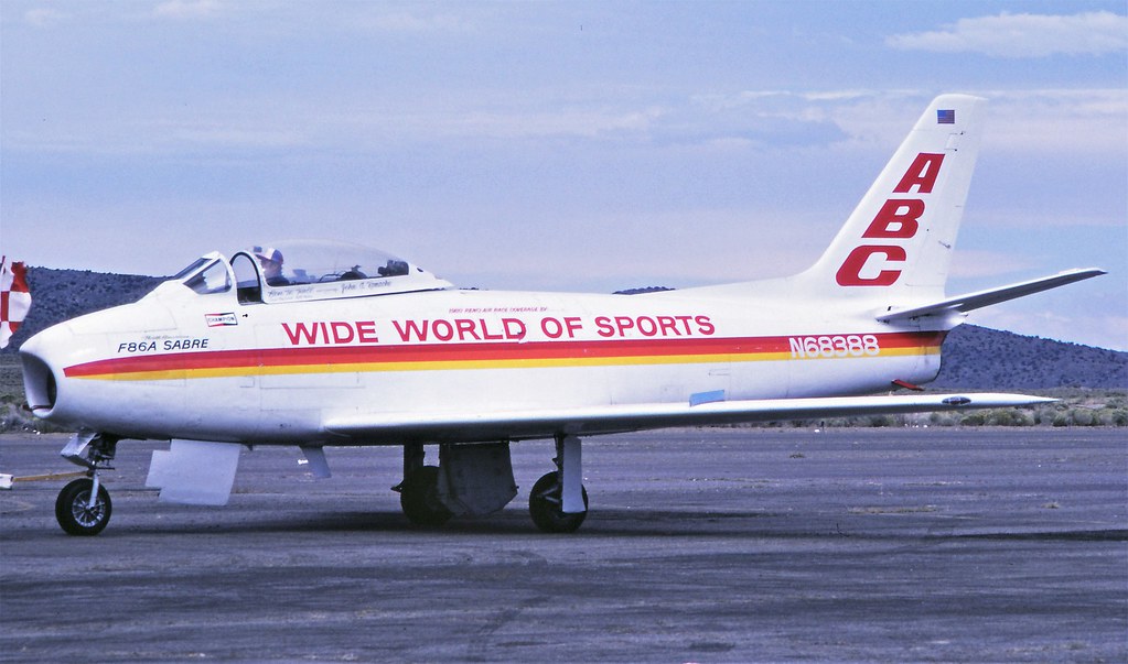

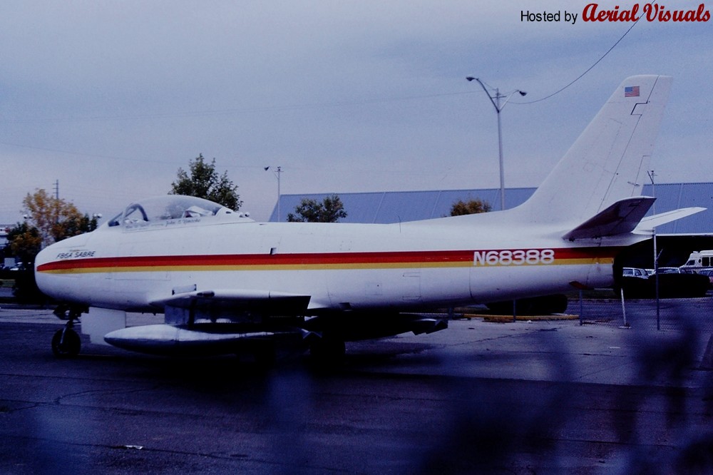

dai phan Posted January 9 Share Posted January 9 (edited) 1 hour ago, Sabrejet said: It's an F-86A with narrow-chord wing, slats bolted shut and a wing fence. Hence a unique configuration. All you need to do is add the fence to the CP kit. The aircraft is still airworthy, and still flying. I could only find these 2 photos on the Net. Dai Edited January 9 by dai phan Quote Link to post Share on other sites
